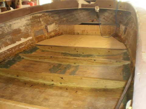

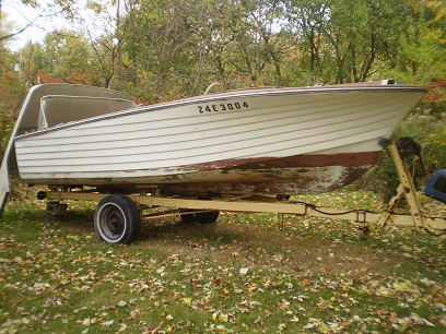

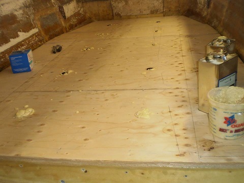

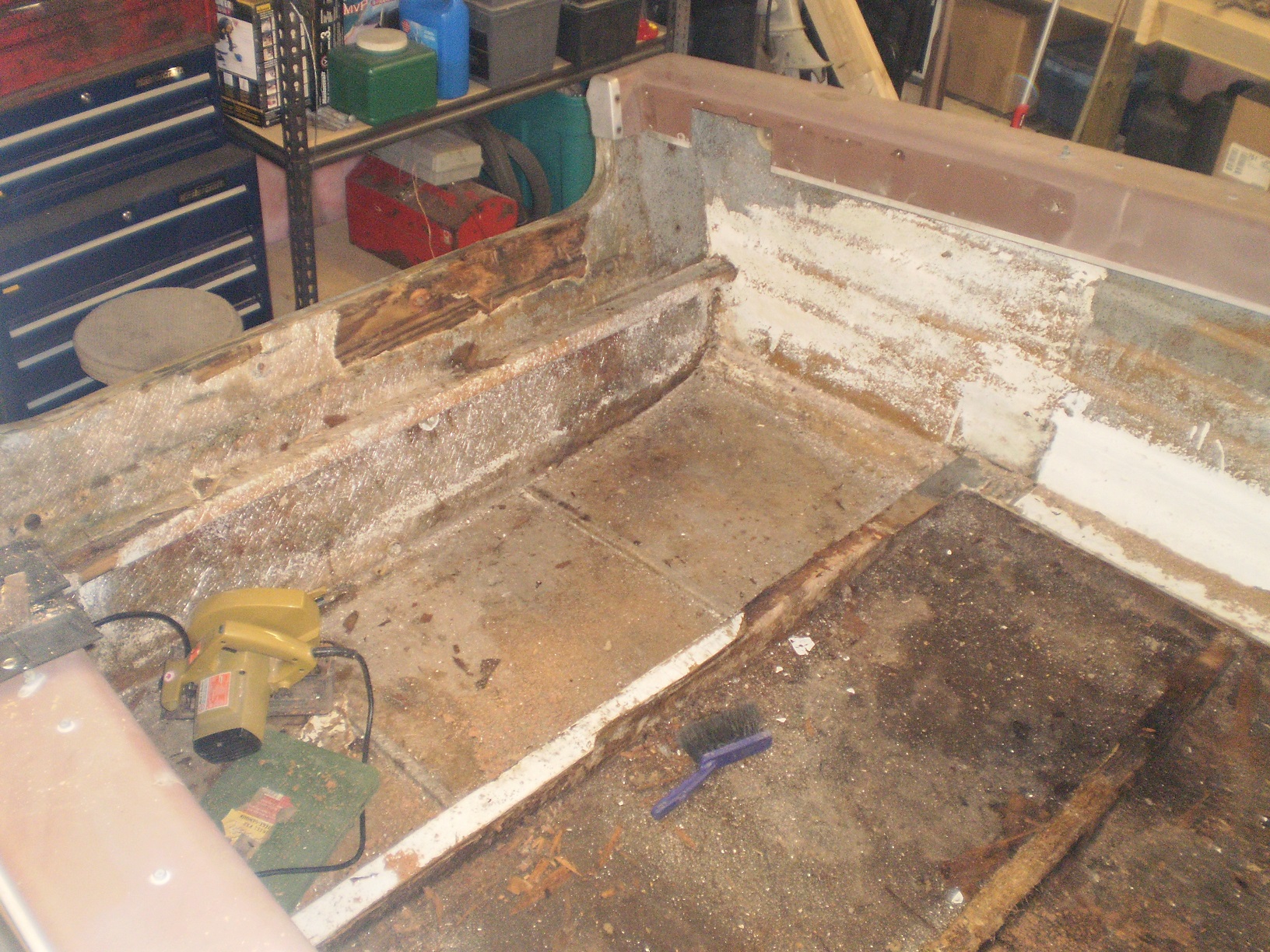

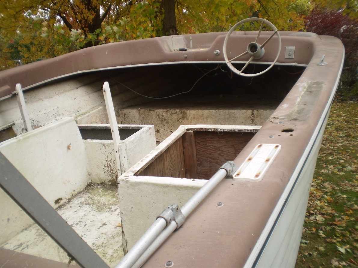

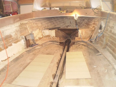

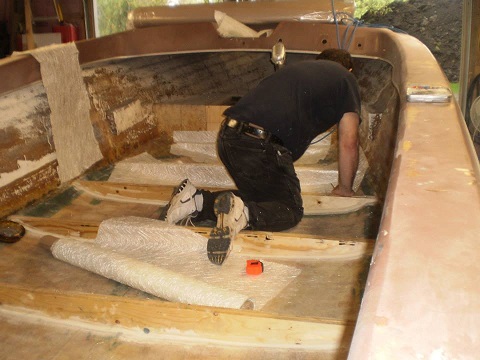

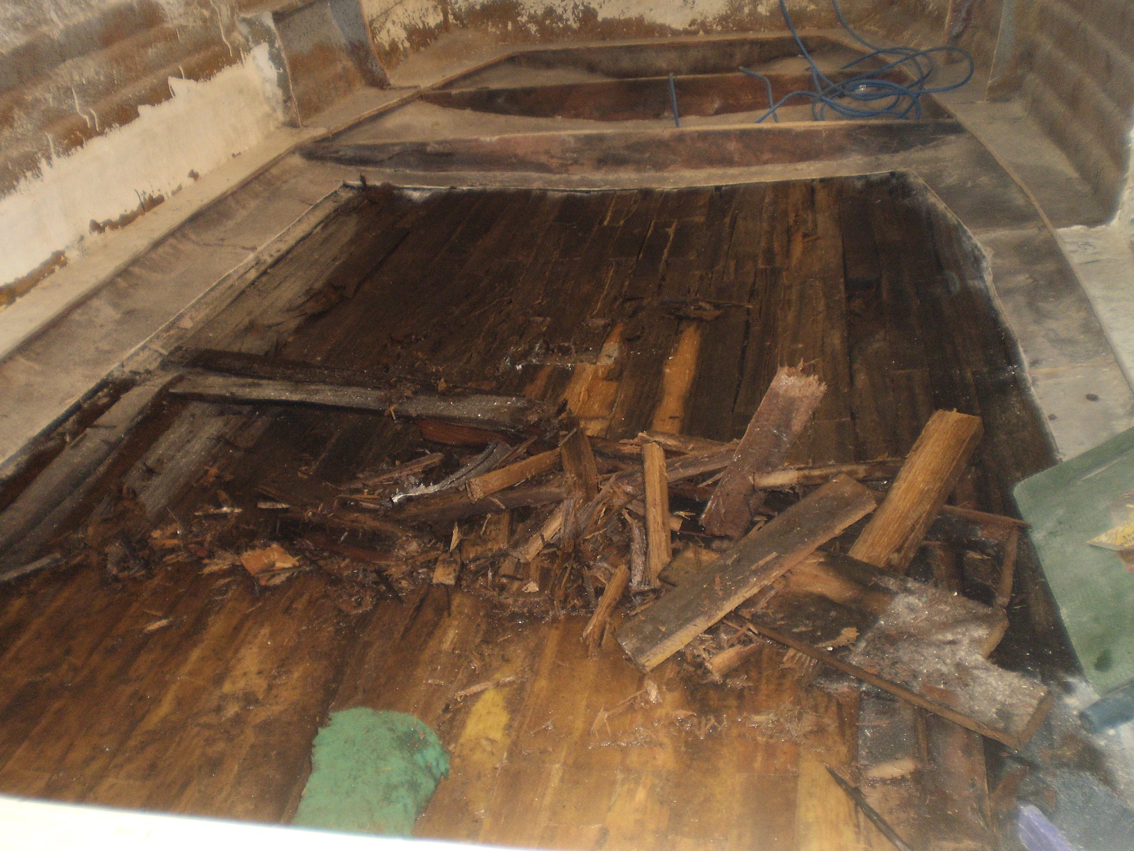

Doing a total restore on her...has a double hull..not quite sure how to do this one..never seen the like lol [img] [img]http://www.fiberglassics.com/media/kunena/attachments/legacy/images/pic3.jpg

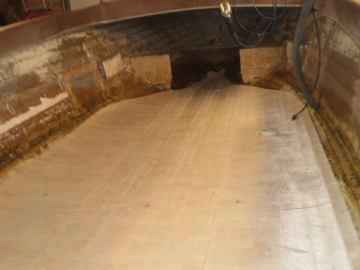

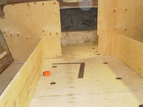

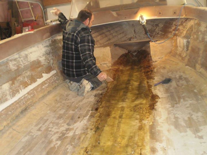

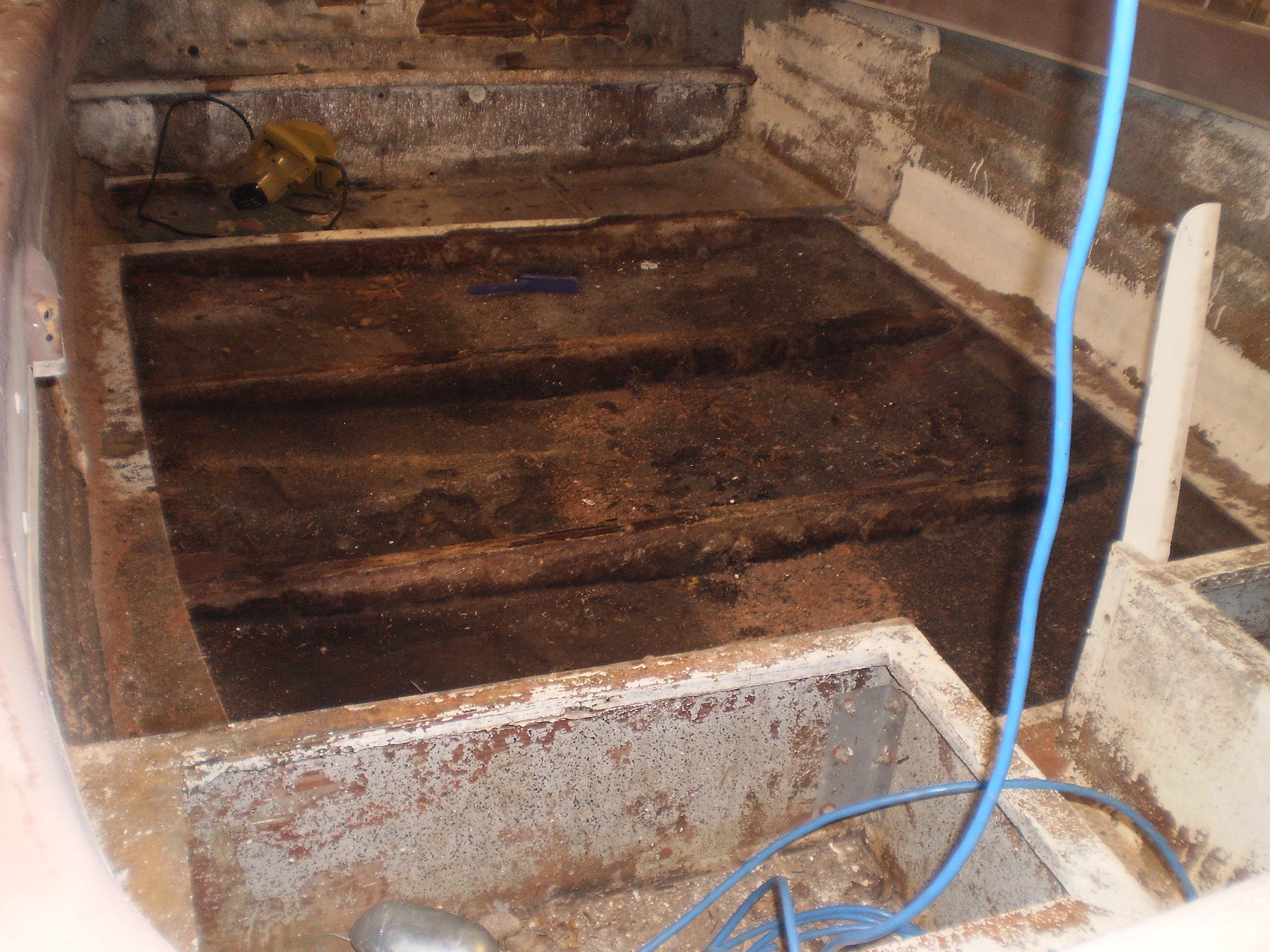

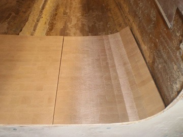

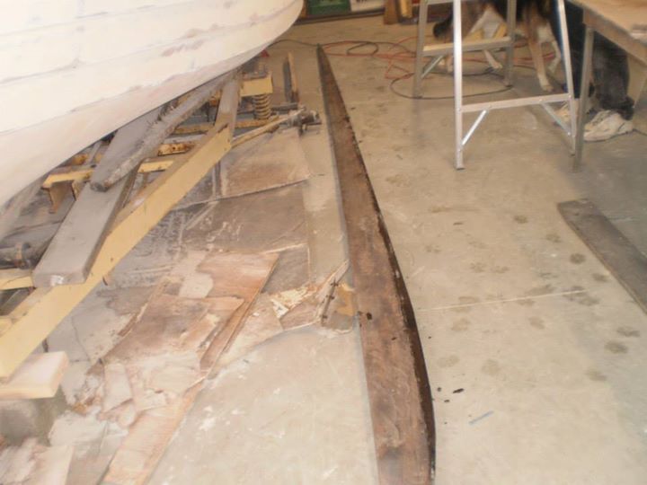

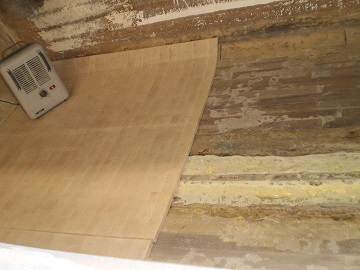

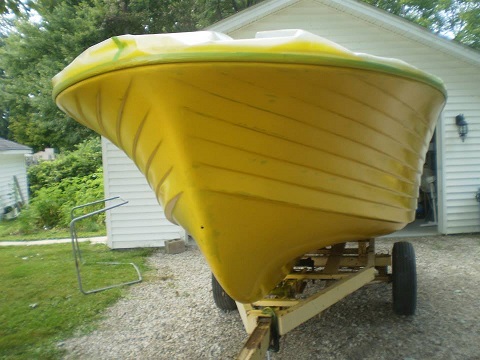

Re:1958 Arkansas Traveller 18 12 years 8 months ago #89818
added some pics...

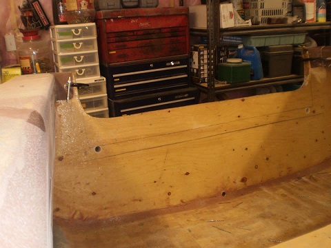

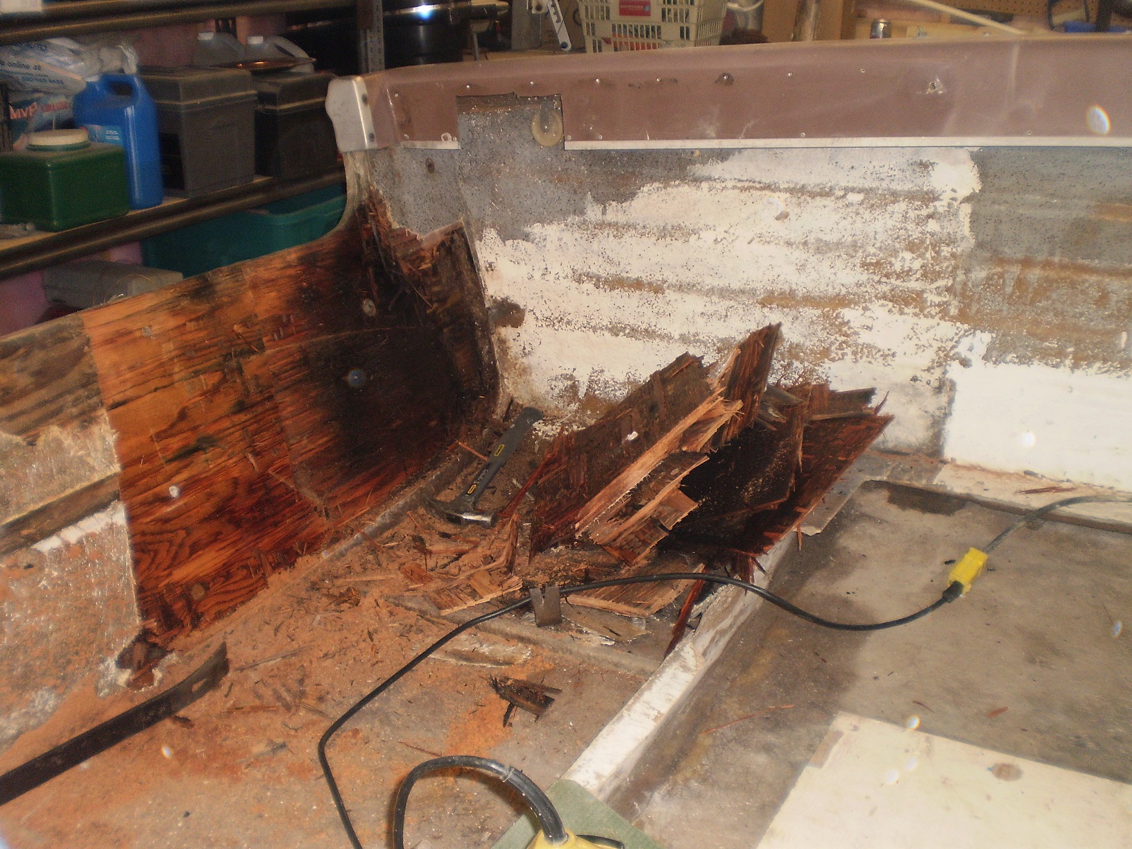

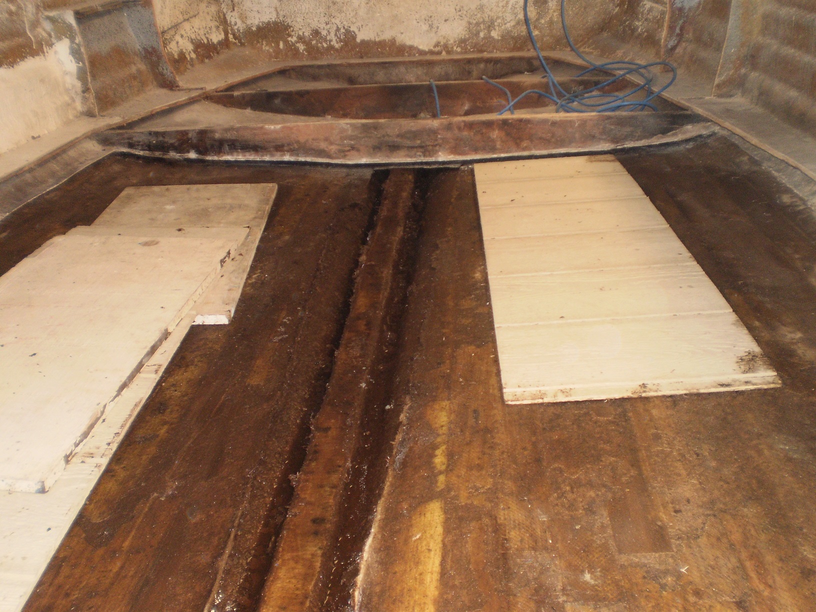

Re:1958 Arkansas Traveller 18 12 years 8 months ago #89844
What you have there is a cored hull. Between the fiberglass floor and fiberglass hull would be a layer of foam or balsa. Can be replaced with core matt (a fiberglass product), closed cell foam core material, or balsa core mat. Try a google search on any of these products.

Great progress.
Re:1958 Arkansas Traveller 18 12 years 8 months ago #89849
That's going to be a super project and lovely fiberglassic.

Re:1958 Arkansas Traveller 18 12 years 8 months ago #89866
Thanks for the heads up on the floor...It was 60 year old balsa soaking wet and had a ...unique smell to it. Not too surprising though, poor old girl sat for 20 yrs outside and had racoons living in it.

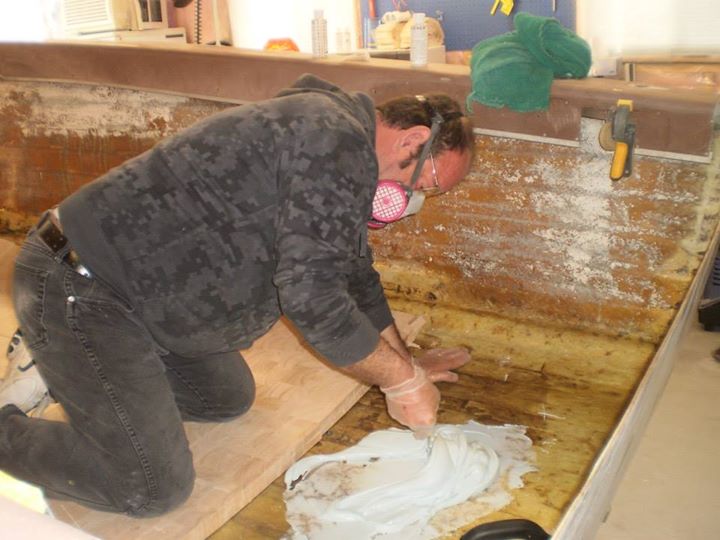

Thanks Bob. Working every weekend since October on her. Been a long cold sub zero winter here.
Re:1958 Arkansas Traveller 18 12 years 8 months ago #89907
Yeah unfortunately it makes it very hard to get to get a good amount of work done when your freezing to death! LOL

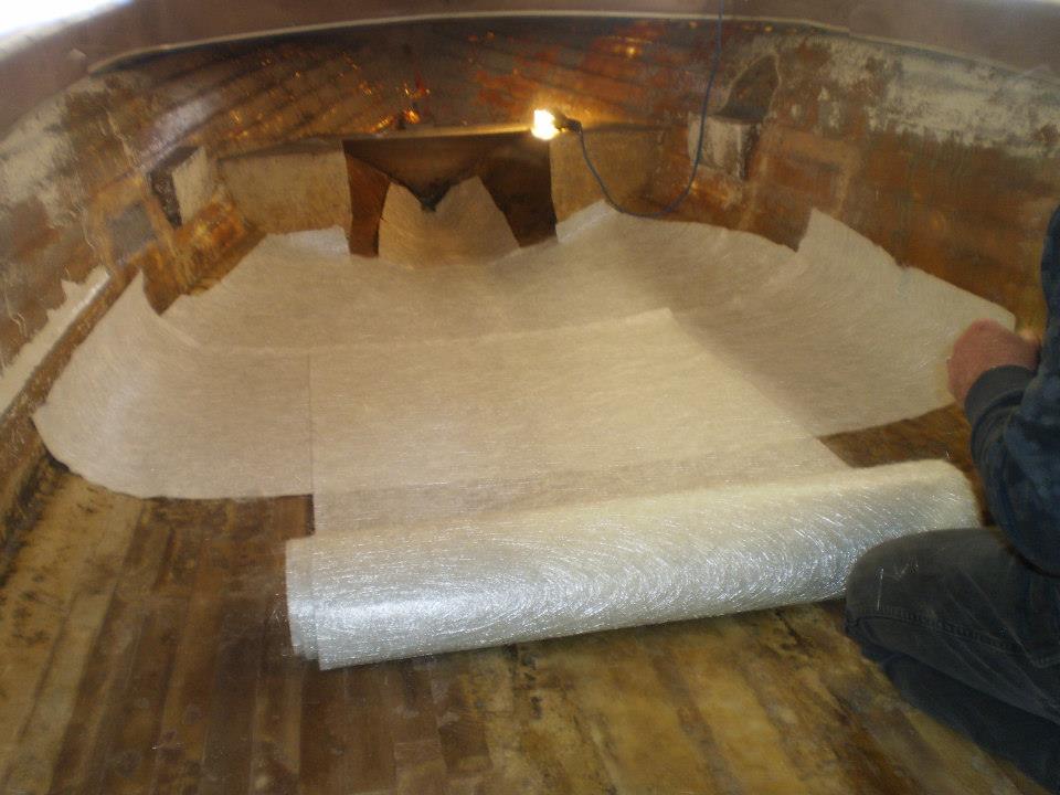

Re: 1958 Arkansas Traveller 18 12 years 7 months ago #91494
Re:1958 Arkansas Traveller 18 12 years 6 months ago #93444
Re:1958 Arkansas Traveller 18 12 years 6 months ago #93476
Nicely done, great work so far!

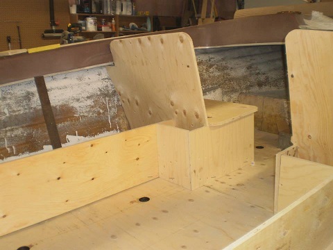

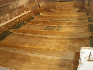

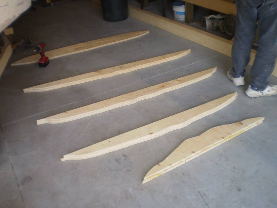

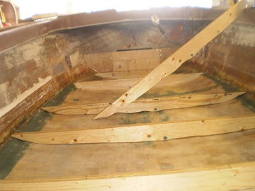

Re:1958 Arkansas Traveller 18 12 years 6 months ago #93752

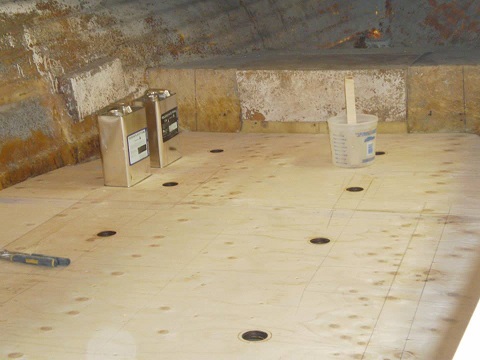

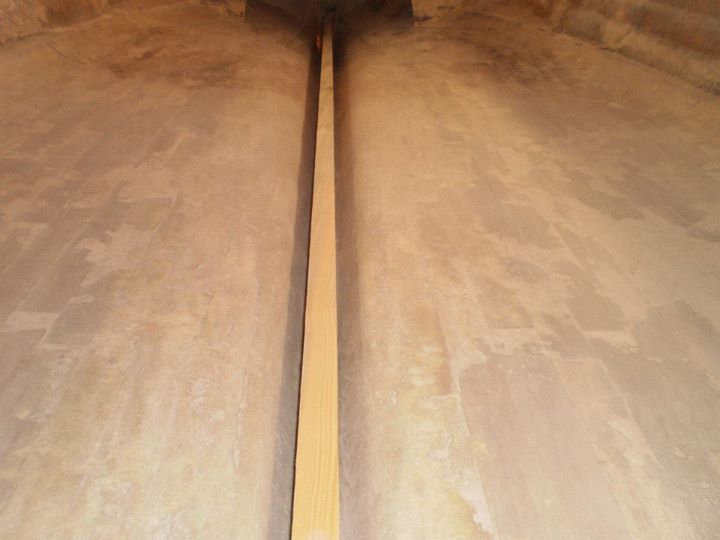

[img][img]http://www.fiberglassics.com/media/kunena/attachments/legacy/images/1948040_10152197417982880_117969995767575993_n.jpg

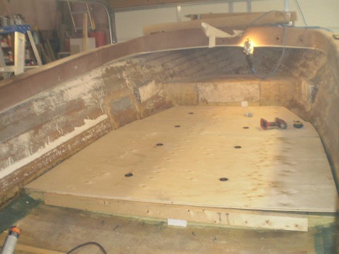

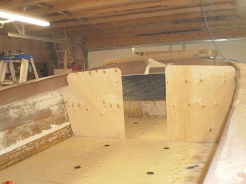

starting to come together [img] [file/] [img]http://www.fiberglassics.com/media/kunena/attachments/legacy/images/pic.jpg

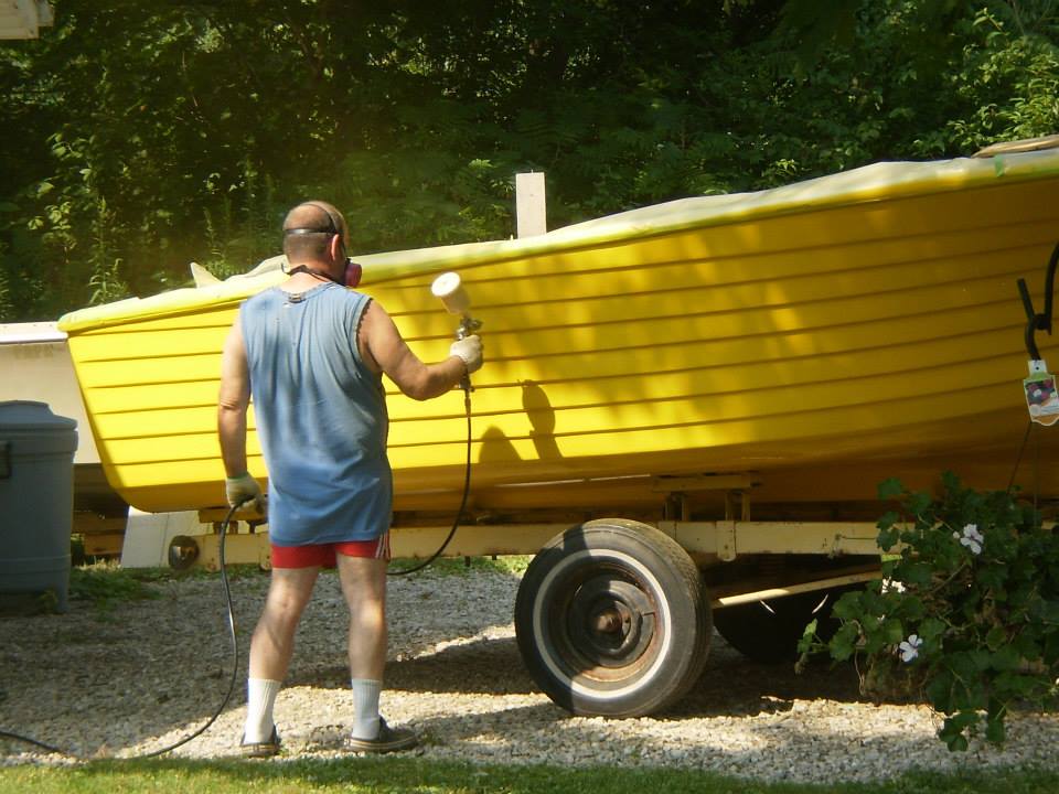

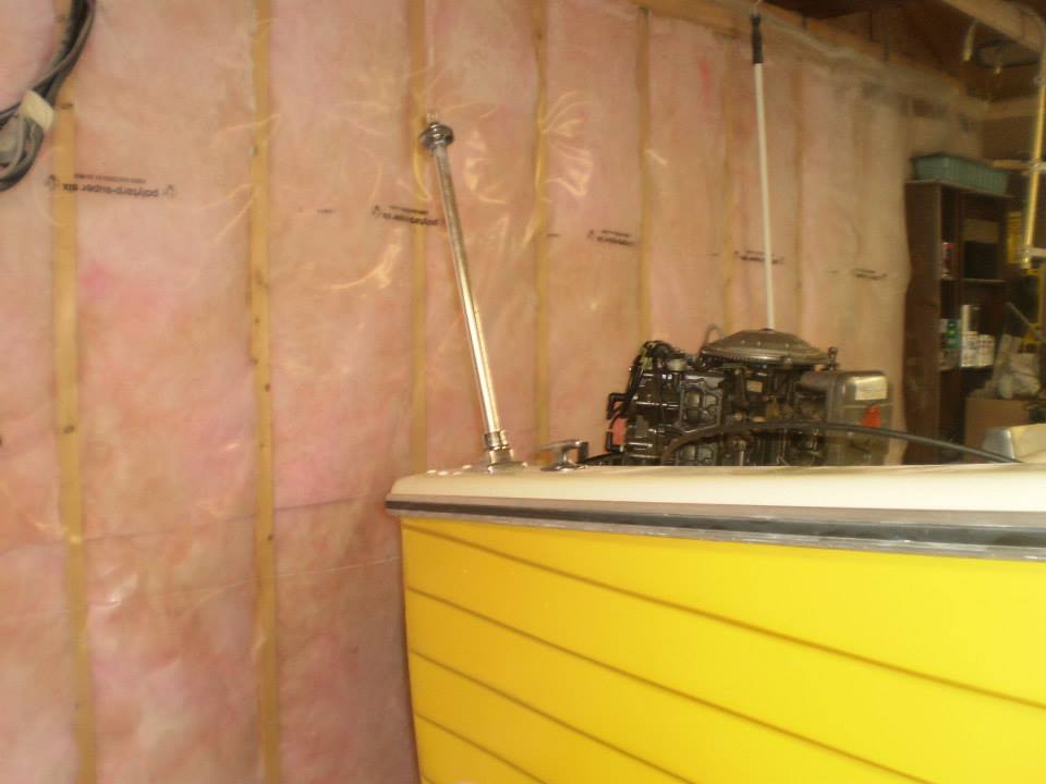

Re:1958 Arkansas Traveller 18 12 years 5 months ago #94758

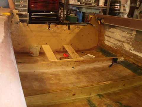

Starting to see some progress..may actually hit the water this year

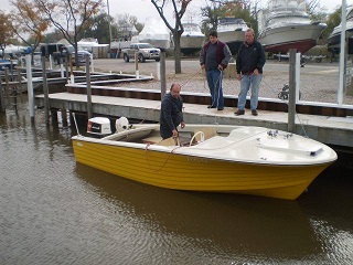

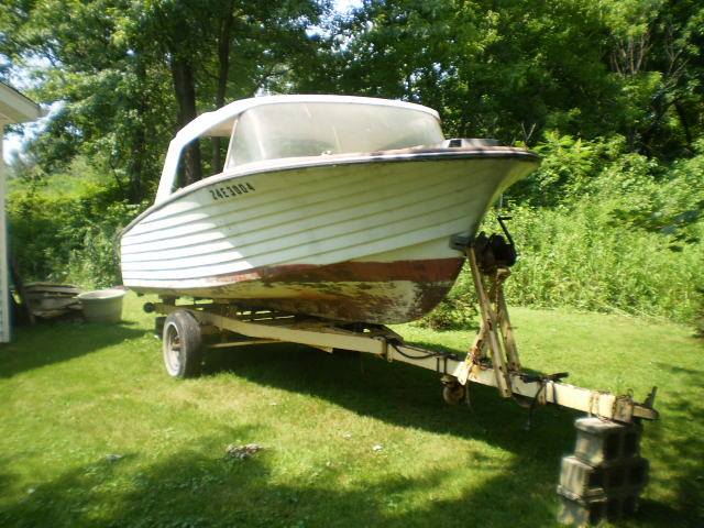

Re:1958 Arkansas Traveller 18 12 years 1 week ago #101879

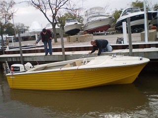

[/quote Hey Guys....It Floats!! Interior work this Winter
