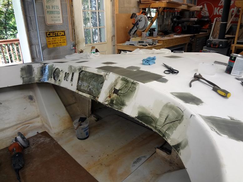

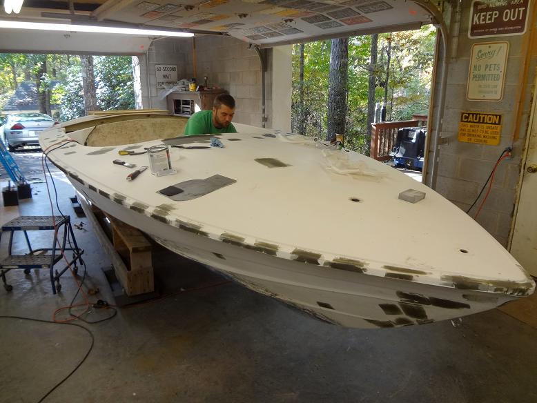

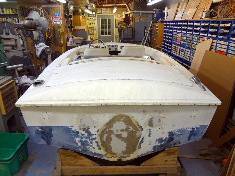

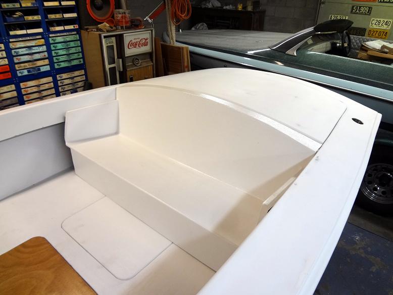

We're currently restoring a 1968 Performance (the actual name of the manufacturer) runabout. Apparently, it was designed using the Donzi Sweet 16 hull profile but stretched an additional foot to 17. We received in it fairly rough condition, no engine and the transom had been closed-over as seen in the accompanying photos.

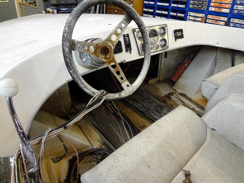

There were many areas of gouges, scrapes and severe gelcoat failure which were ground into small V shapes and repaired with epoxy. The dash was in such bad shape that we decided to just start over completely.

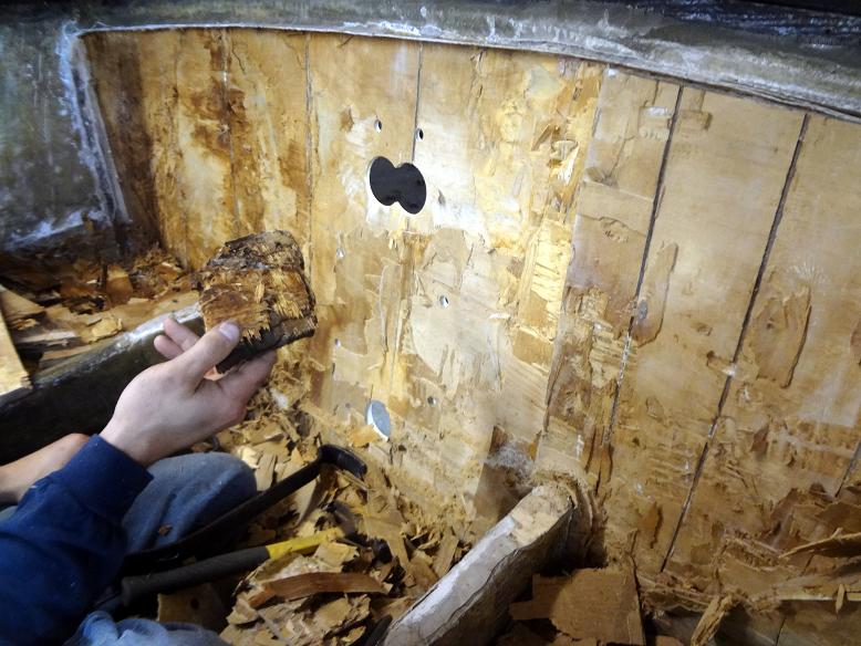

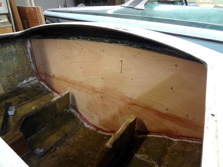

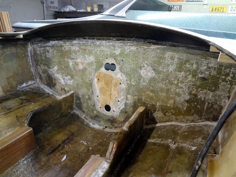

After drilling the initial holes for mounting the outdrive, it became obvious that the transom was mushy plywood and so replacement was necessary before we could proceed. I decided to leave the fiberglass transom intact and remove all the rotten and water-logged plywood from within.
The transom is curved and since the exterior was in such bad shape already, I decided that thru-bolting with 10/24 screws was the best way to ensure that the replacement plywood conformed to the shape of the transom. The first layer of 3/8" okoume marine plywood, divided longways in order to be installed in back of the stringers, was pulled into shape against a heavy and complete coating of 3M 5200 and allowed to cure unmolested for five days. It's an unorthodox method but it worked perfectly. All edges were subsequently fiberglassed to the bottom and hull sides with heavy fiberglass cloth.

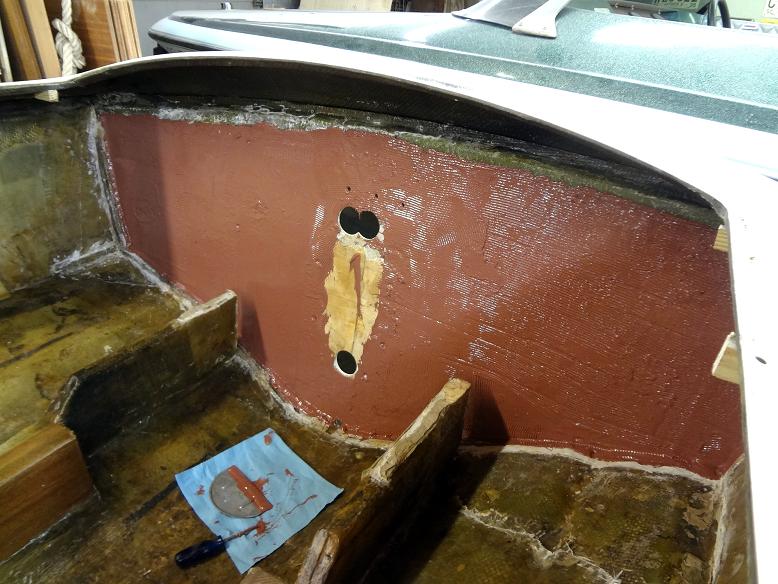

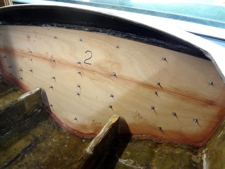

The second layer of plywood was fastened in the same way, using the same holes, screws and full coating of 3M 5200. The horizontal cuts were staggered on each piece. We allowed this plywood layer to cure for an additional five days before the screws were removed. Layers three and four were then fastened from the inside to layers one and two with 5200 and 1" stainless steel screws. The 4th and final layer of 3/8" okoume marine plywood was completely covered in fiberglass which extends several inches onto the bottom and sides.
The topsides were about as bad as the dash and we felt that epoxy and primer just weren't going to cut it. We applied three coats of gelcoat, wet on wet, and sanded smooth. Two coats were applied to the interior surfaces and rear seat. Interior will be buffed; exterior painted.

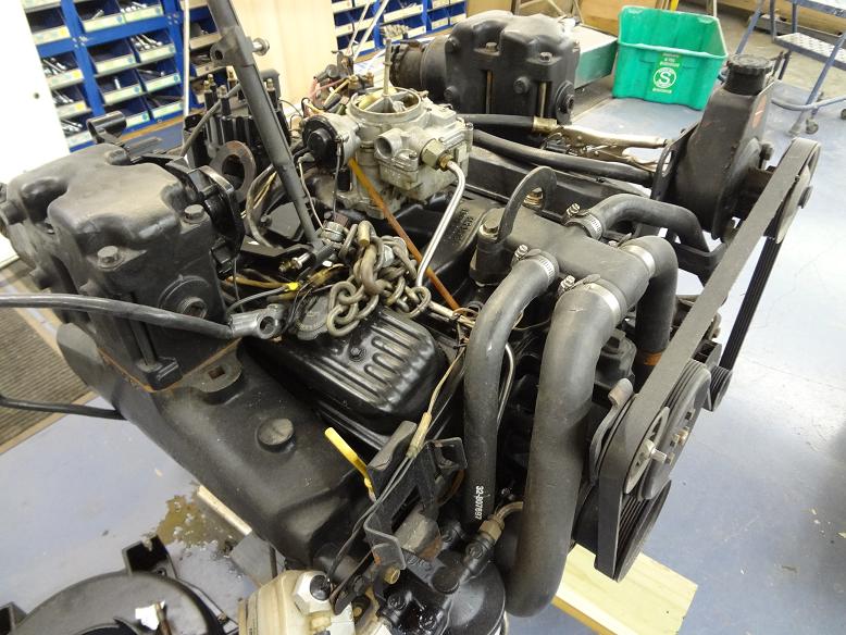

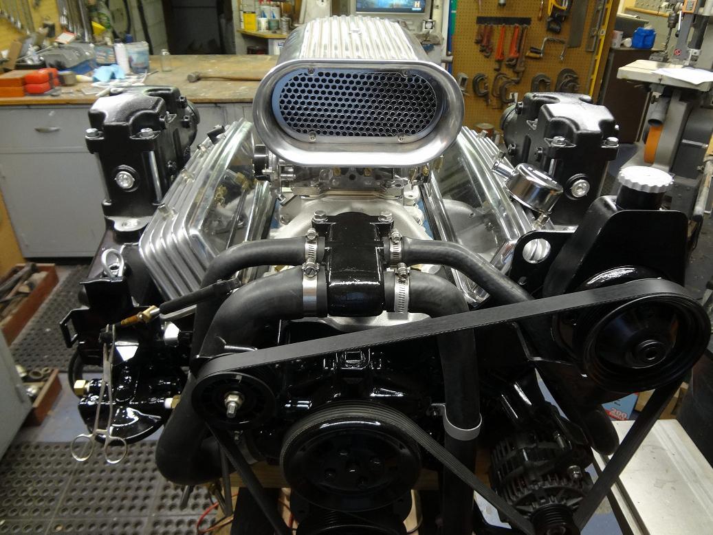

It's always amazing to me how cheap engines and outdrives can be if they have a boat wrapped around them. Rather than buy a Gen II outdrive and then a 5.7L donor motor, I bought a donor boat that had both for less than half what those items would have cost separately. So...I got every single thing I needed to build another driveline, a mess of re-useable boat parts and a dual axle trailer! Anyway, here's the engine from the boat and using many of the parts, here's what I built. The intake and exhaust manifolds are aluminum, saving me about 80-90 lbs of engine weight.

A sweet project, for sure! Looks like a proper power plant for a "Performance" boat.
Can't help but notice one of the Carlsons in the background, now you've really got me salivating Capt. Jan! :)
Re:1968 Performance (Donzi) Restoration 12 years 10 months ago #87704
I love the engine cover you built from scratch also. This boat is going to be marvelous when finished!

Well, the "bird catcher" won't fit under the engine hatch but it it did, it would stay. The owner nixed the idea of a scoop sticking out through the top...too bad! It came with left steering and he wants it to stay that way. We are going to put the exhaust through the transom so it should sound pretty mean. Also, he stated that he wants no windshield so I guess he'd better get some goggles.
The transom has very little rake. The boat must have had a stringer outdrive or Volvo Penta. Anyway, the Mercruiser outdrive isn't going to work without opposing twin wedges set inside/outside. As it sits right now, the 350 Chevy drops down about 3" in the front...unacceptable. I'll post some photos early next week to show how we handled the problem.
