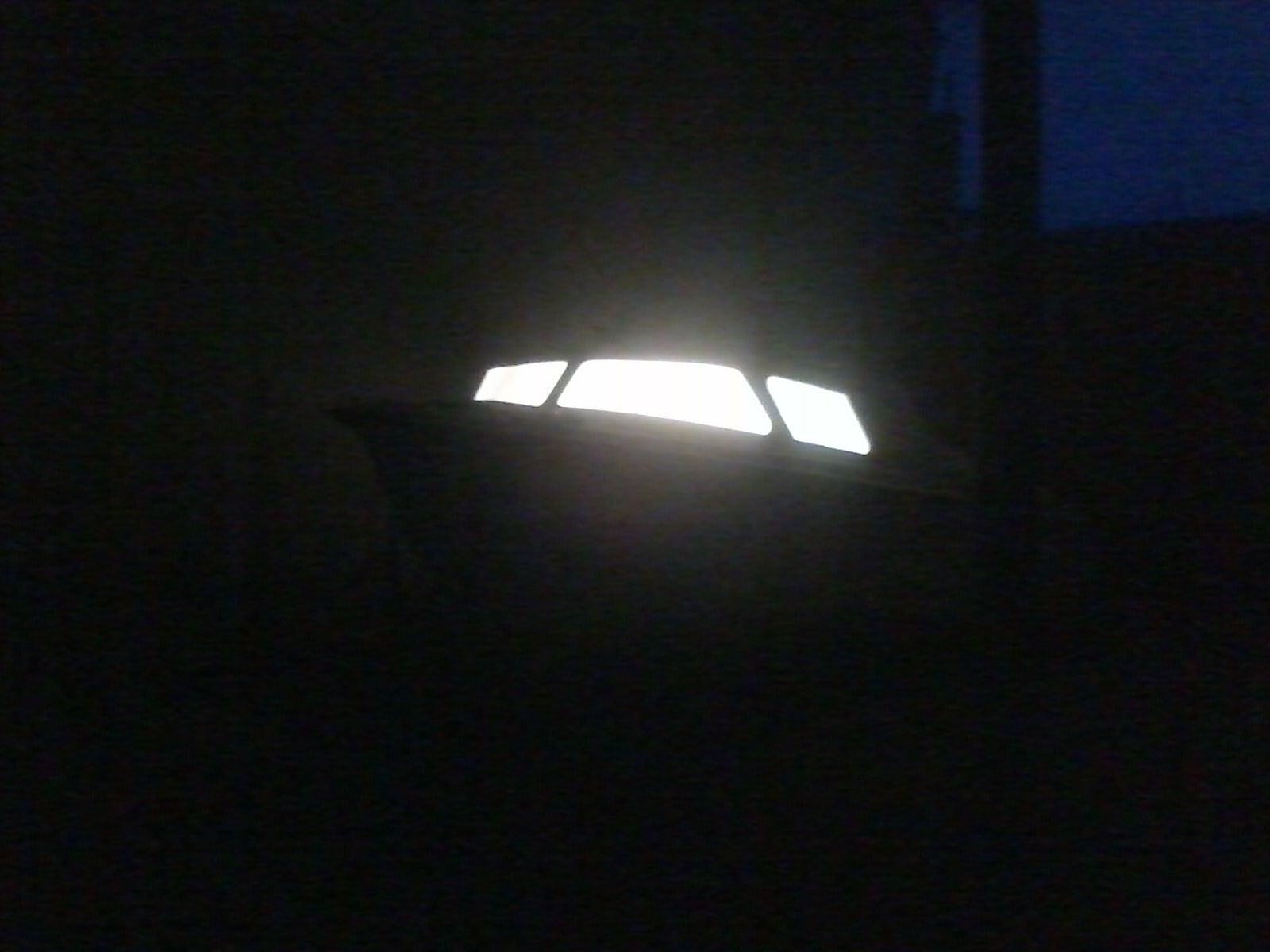

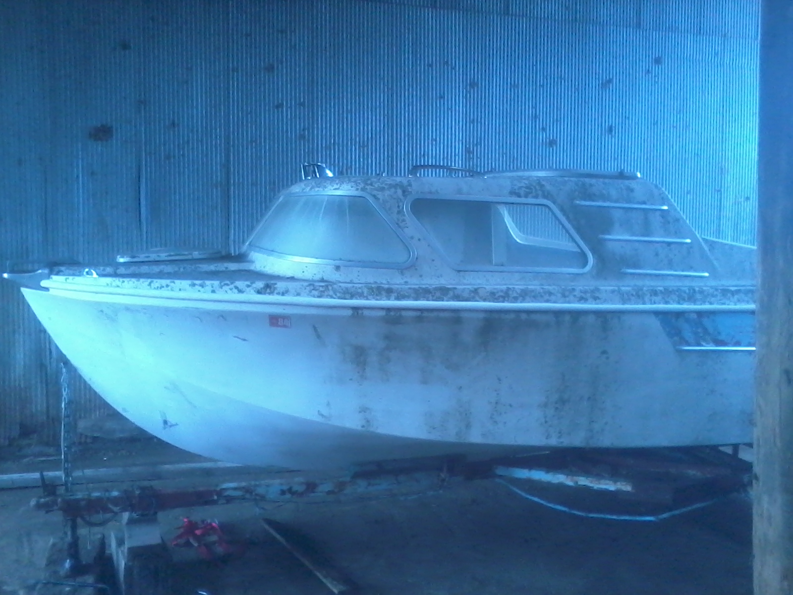

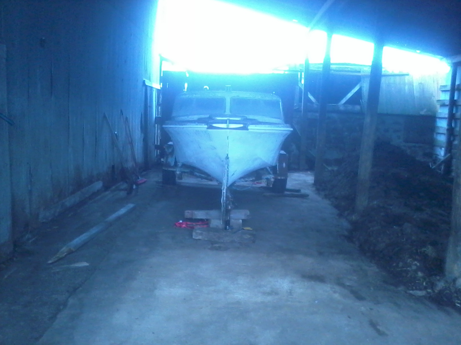

as seen on the sightings forum, I buckled and nabbed this one up.
www.fiberglassics.com/glassic-forums/home/sightings/what-the-heck-is-this-thing

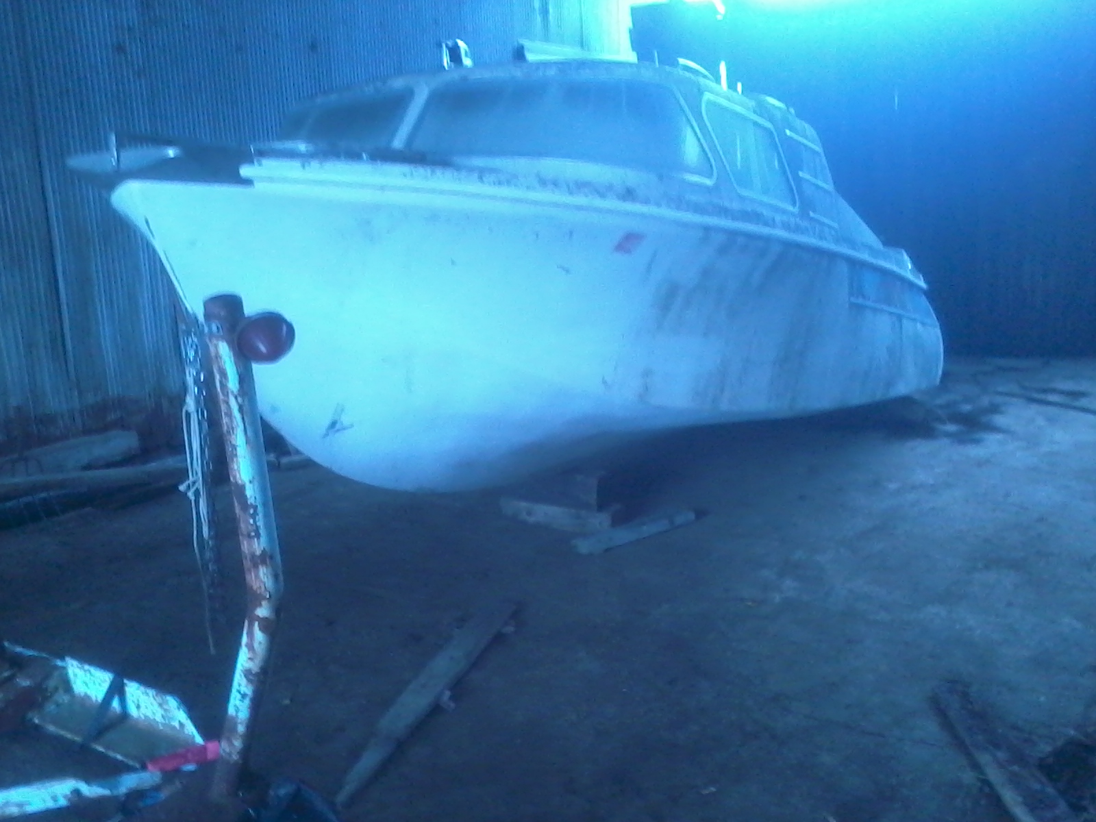

annnd now I have her safely at home and in the shed, off the trailer, so now it's time to relax and enjoy my evening.

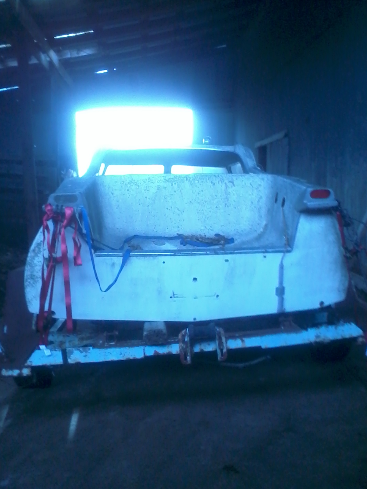

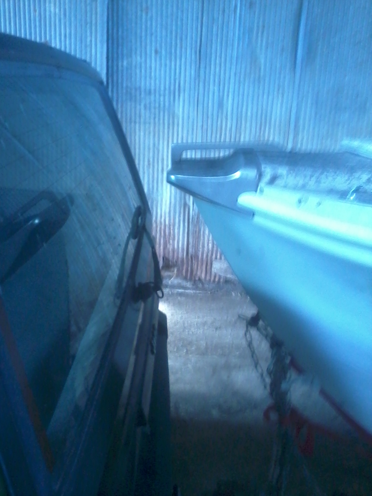

The ride home was a little nerve racking, as she was sitting pretty close to the back window of the jeep and no trailer lights....

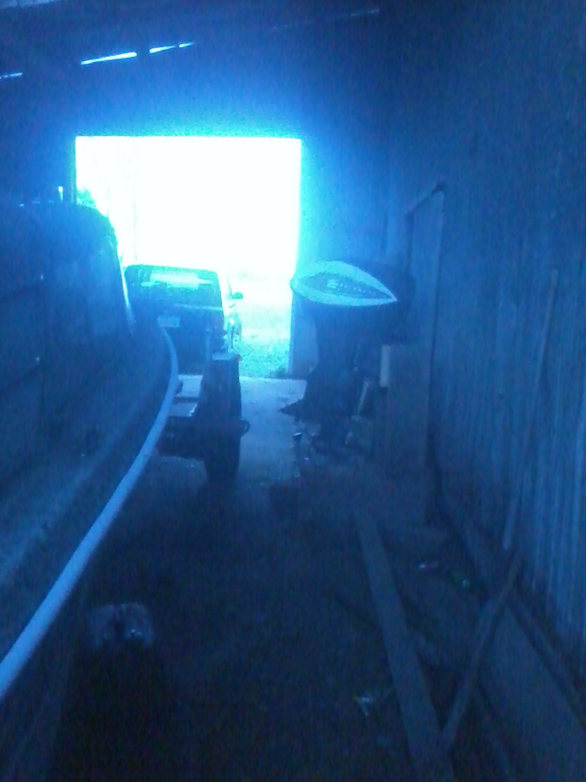

I know, my shed needs a bit of attention and I aim to get to that as soon as I can, I've a bit over 8,000 square feet of 30 year old cow manure, hay, misc junk and the little ladies stuff, can be a bit overwhelming at times.

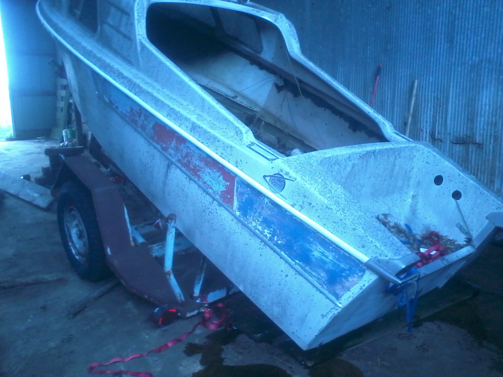

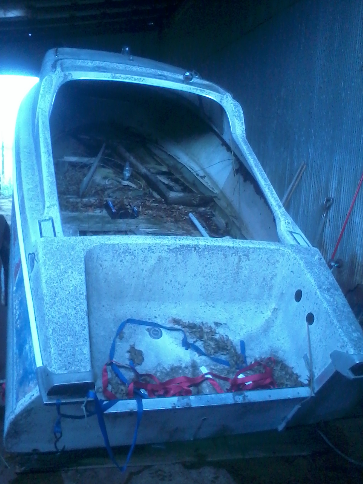

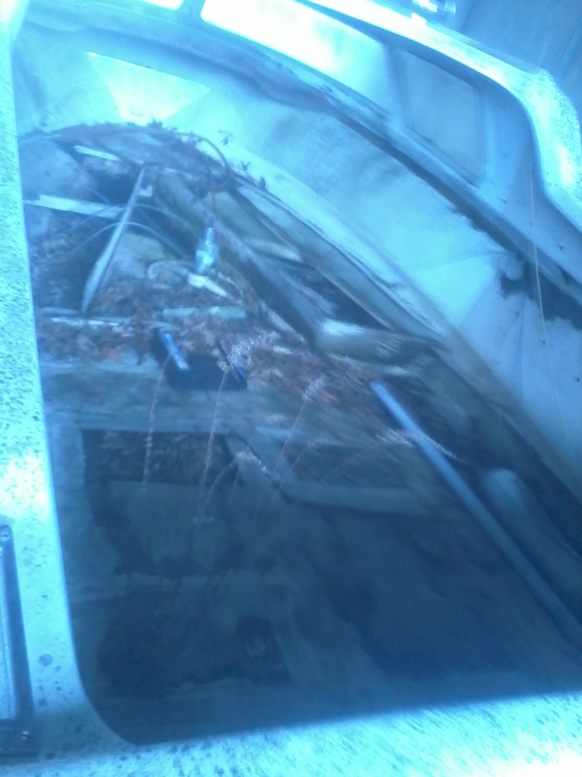

as you can see in the picture above, I am going to have to crack this egg wide open and play in the bilge, once again, story of my life. :/

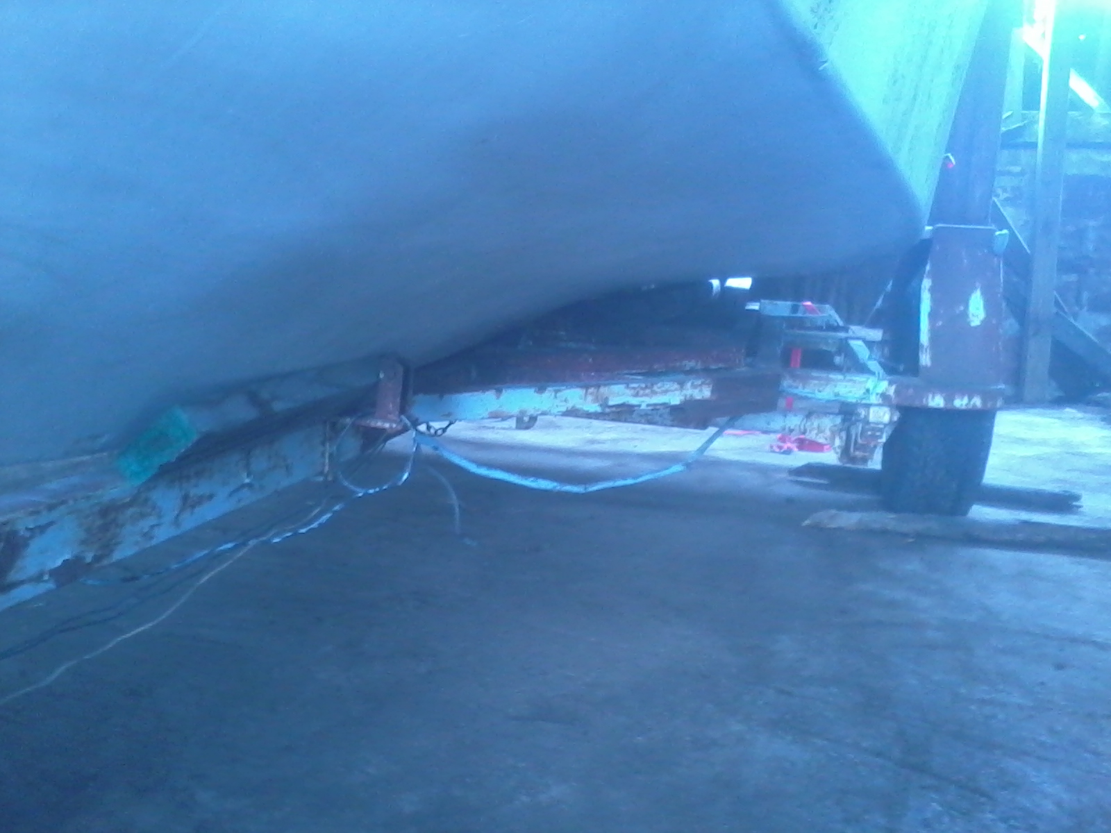

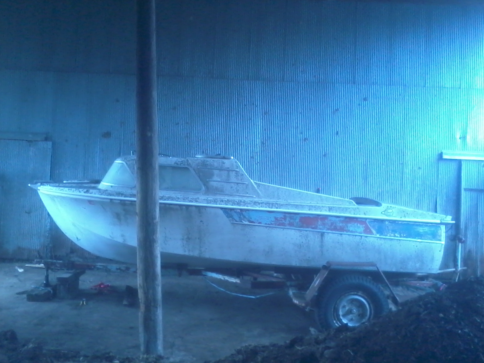

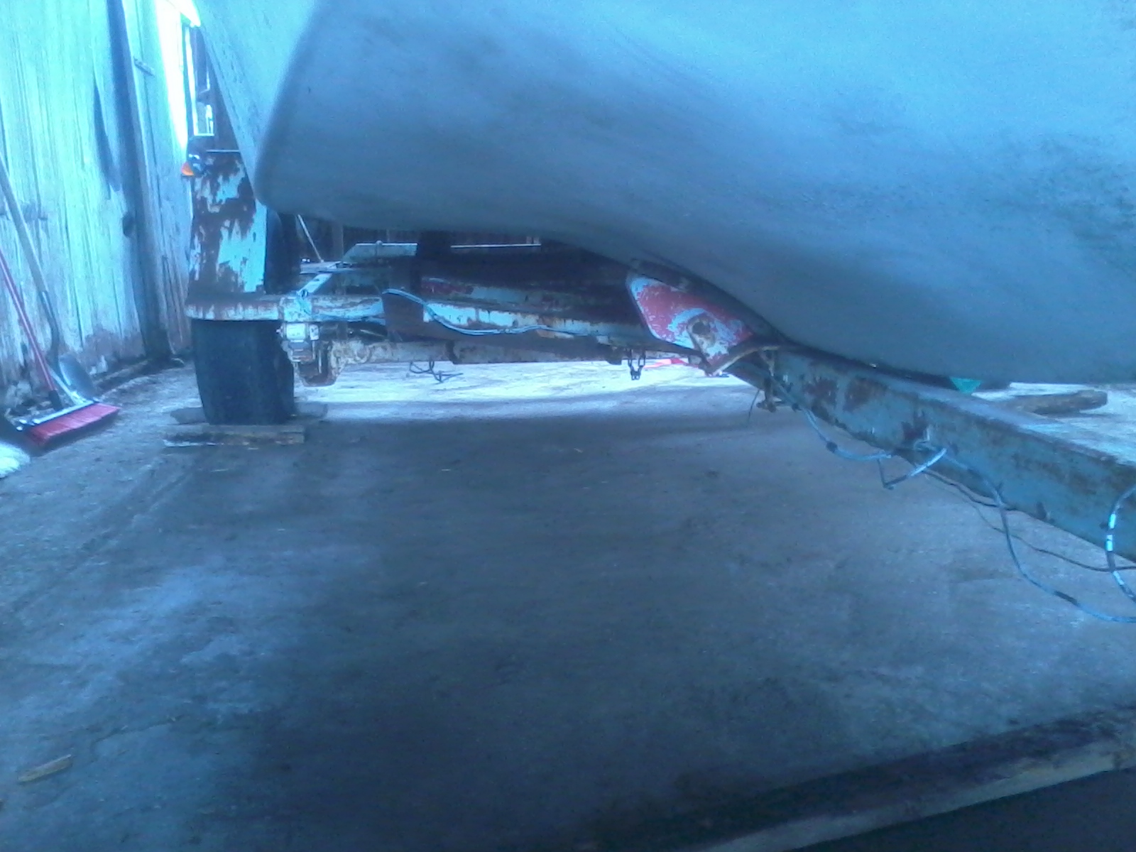

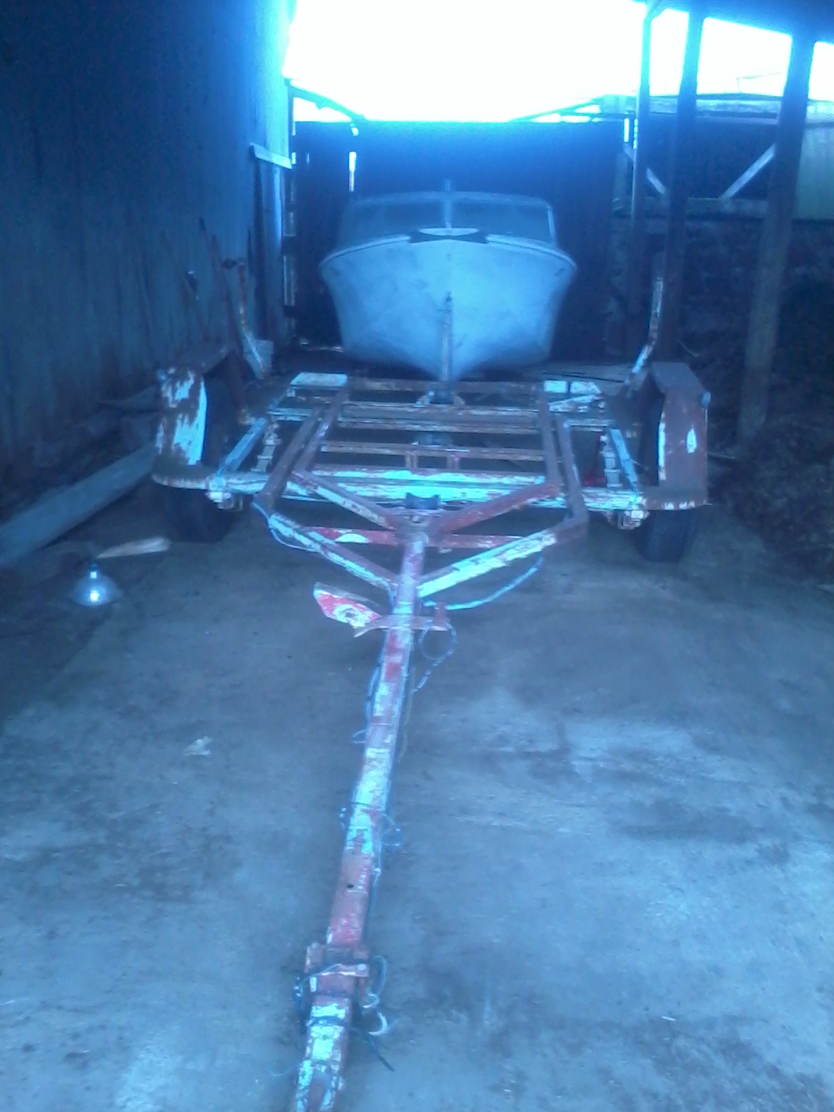

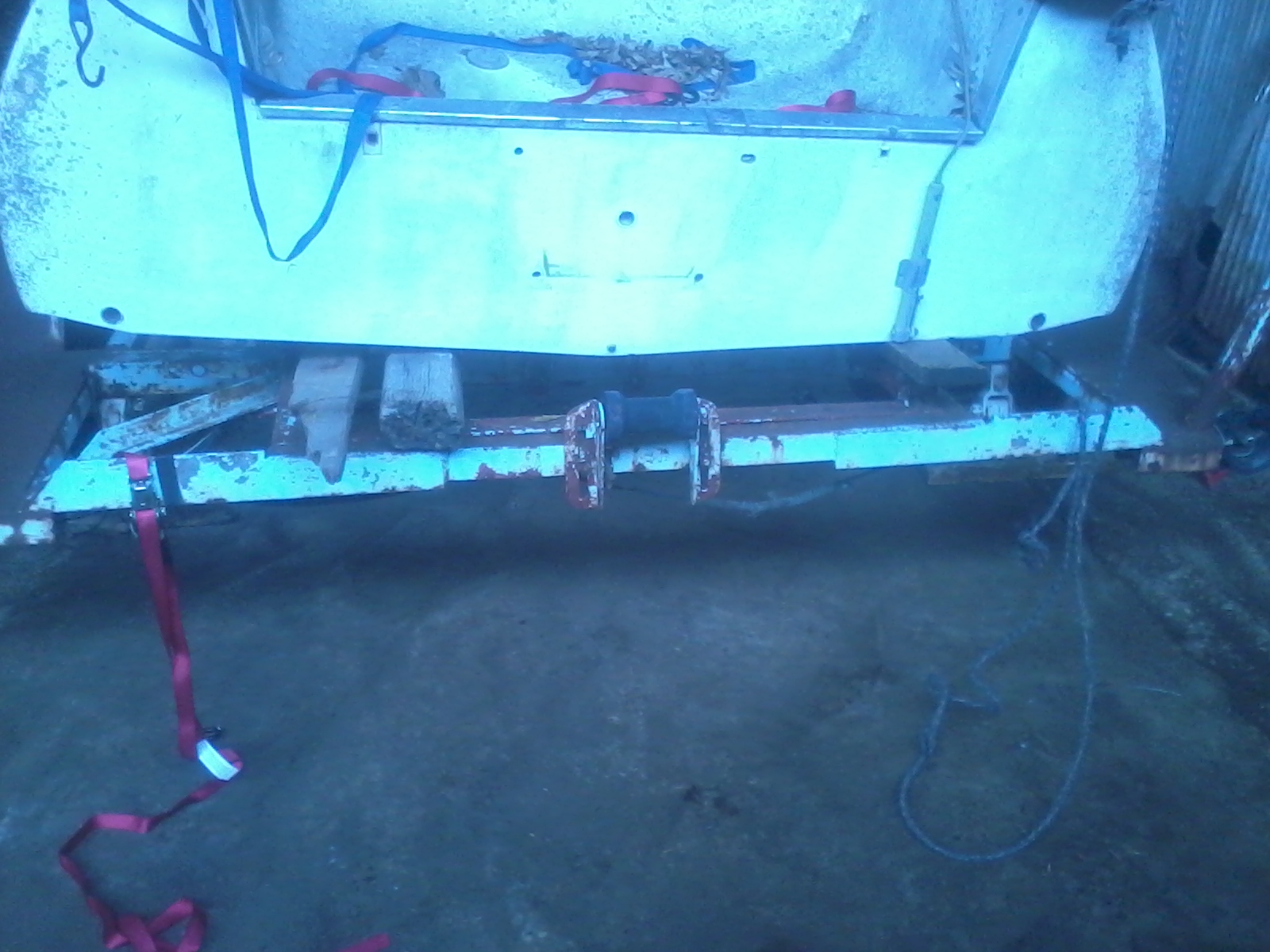

as you can see, the trailer needs a lot of attention, funny this boat doesn't have any holes in the bottom of it from all those bunk brackets sticking up everywhere!
Re:And so it begins, 1959 Dorsett Catalina 13 years 4 days ago #86009
  • Shake
  • Shake's Avatar Topic Author
  • Posts: 983
  • Karma: 29
starboard side trailer.

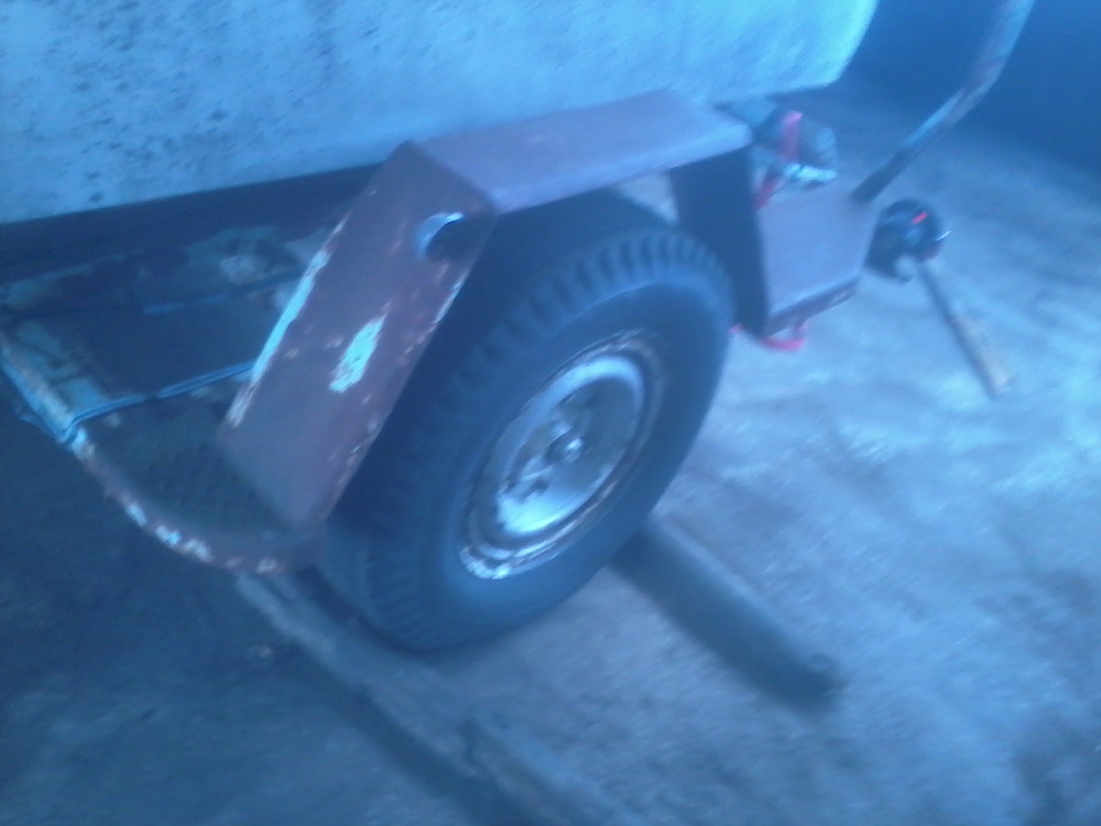

split ring rims, yeah this is an old home jobby for sure, but they did do a great job making this trailer.

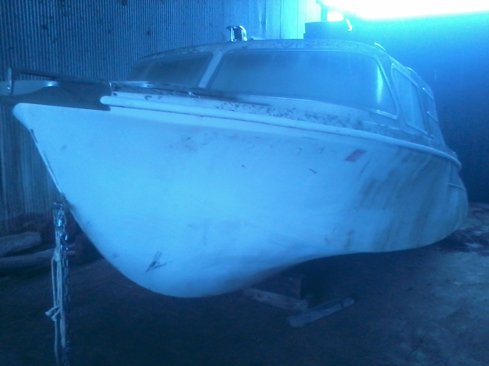

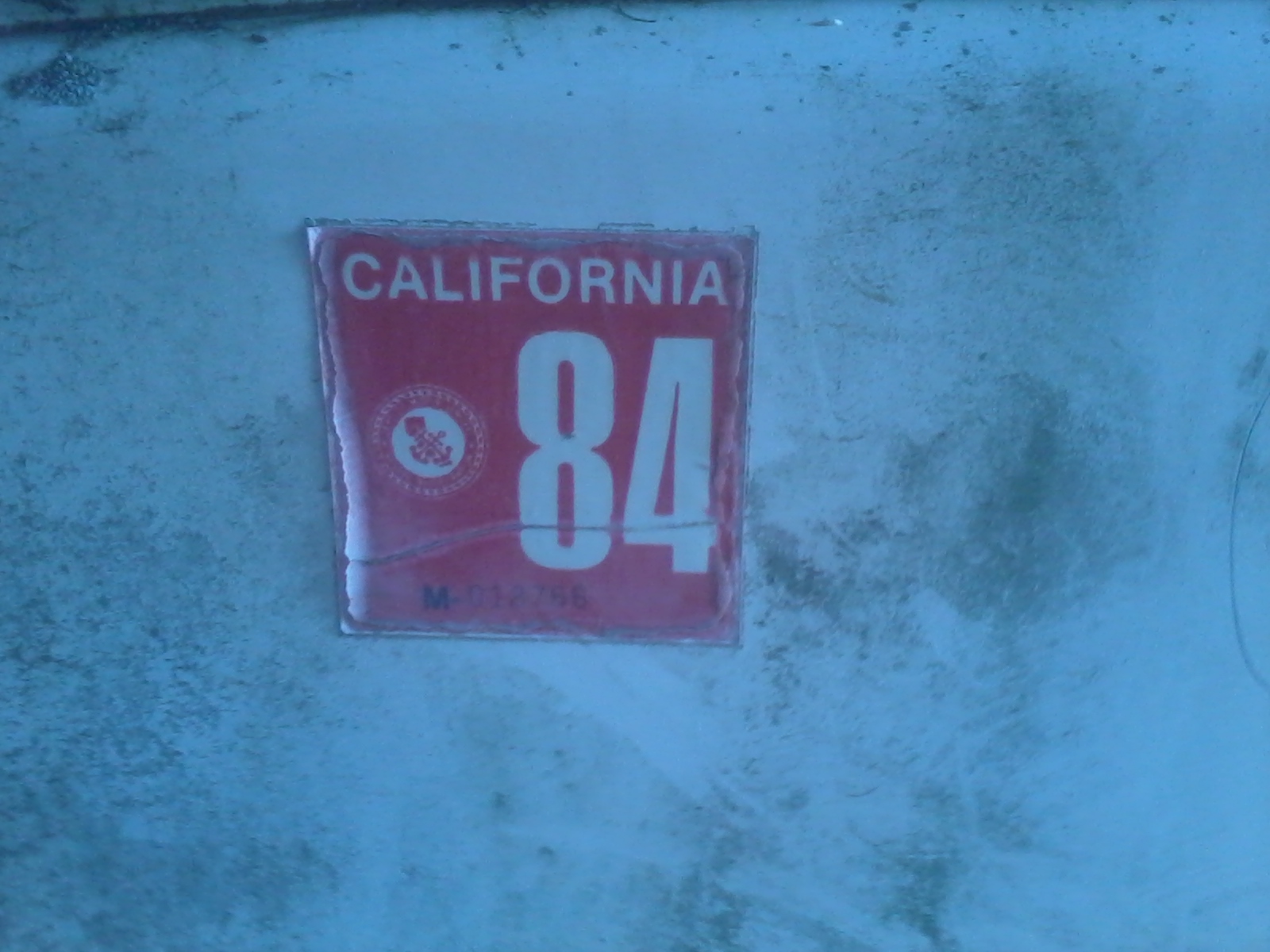

sitting there on the blocks like she is, I can see that the cabin bulkhead must be a key integral component to her structure. she twists a little when I push on the side of the bow.
Re:And so it begins, 1959 Dorsett Catalina 13 years 4 days ago #86016
  • Shake
  • Posts: 983
  • Karma: 29
closeup

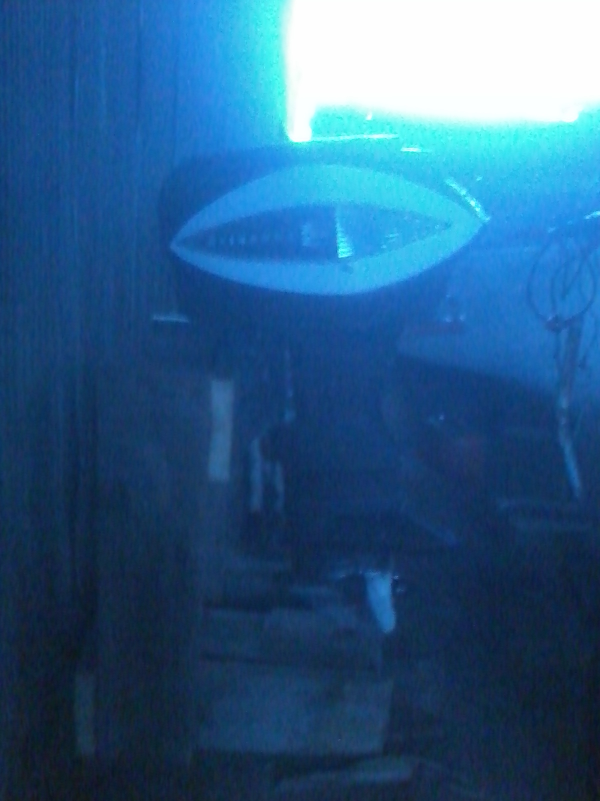

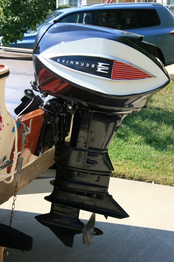

Thanks to Jetflight I now have a motor for the catalina. Thank you Jet.

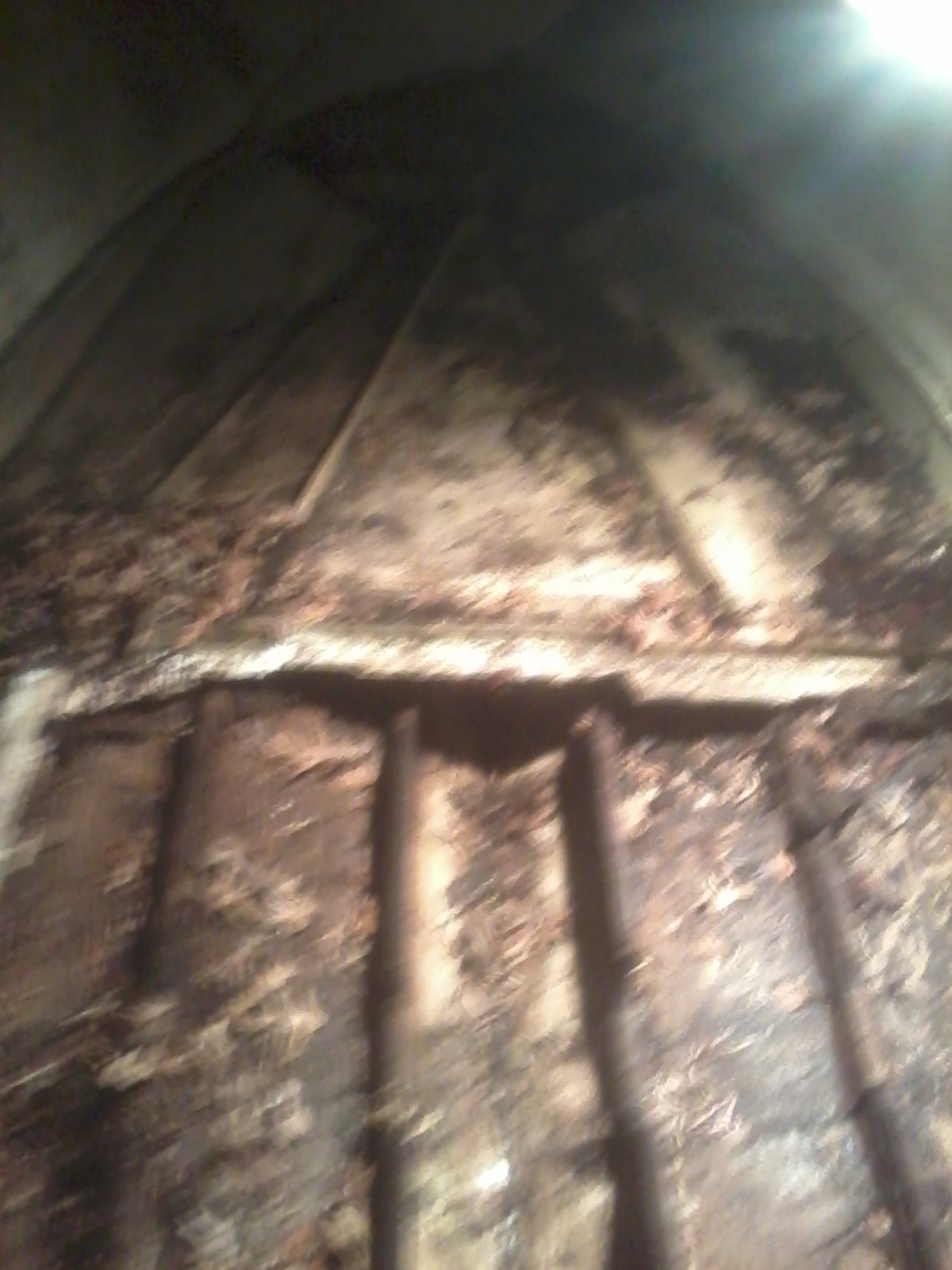

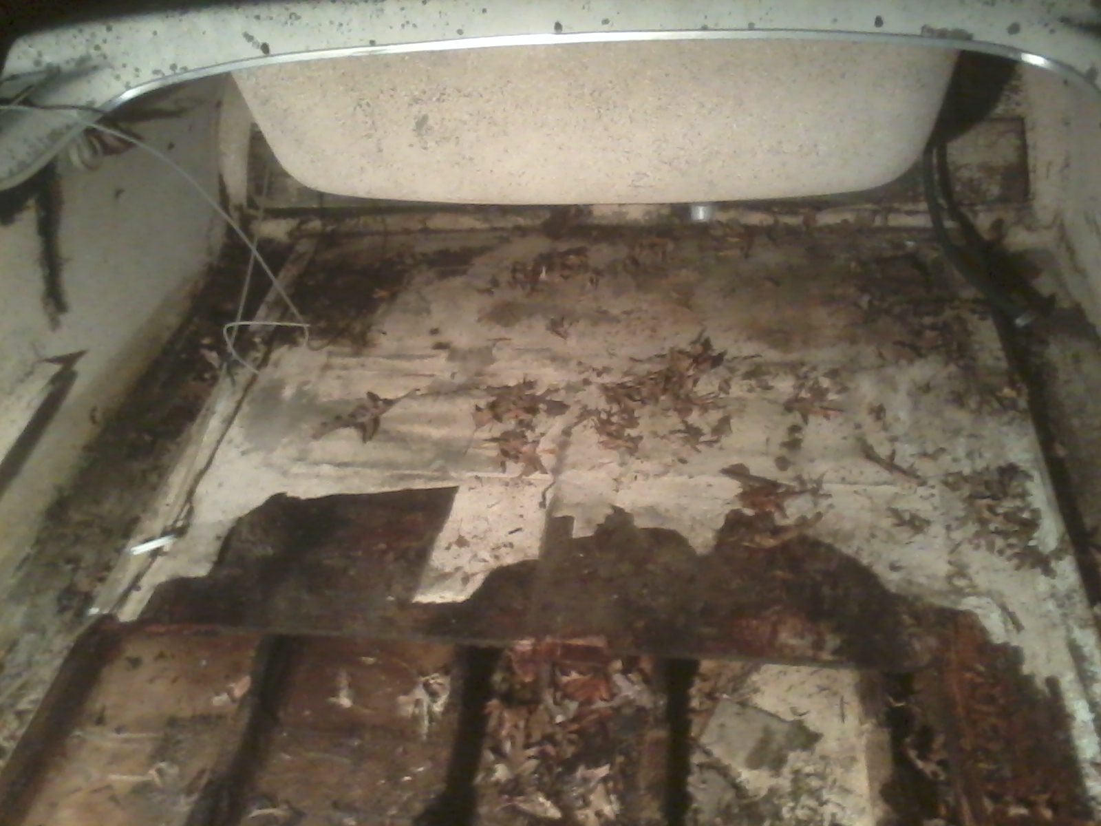

and time to get down into the bilge. Tore up the floor from the cabin back to the transom so far, as you all can see, and as I suspected, the stringers are shot, I doubt if they will even come out whole enough to make patters from them. maybe if they dry out a bit they may come out good enough to make patterns from them.
Re:And so it begins, 1959 Dorsett Catalina 13 years 2 days ago #86105
  • Shake
  • Posts: 983
  • Karma: 29
the battery in my phone died before I was done, but I have her cleared off all the way back to the transom. ;)
Re:And so it begins, 1959 Dorsett Catalina 13 years 2 days ago #86107
Great find, good work so far. Gee that motor looks like the one I just got done restoring.
Re:And so it begins, 1959 Dorsett Catalina 13 years 2 days ago #86109
  • Shake
  • Posts: 983
  • Karma: 29
yes sir, exact same engine. I seen your post, sure looks great waterwings. Have you had her out on the water yet? I'm kinda thinkin I need to shorten the lower to a short shaft. but lookin at your transom, we're about the same there. hows she handle?
