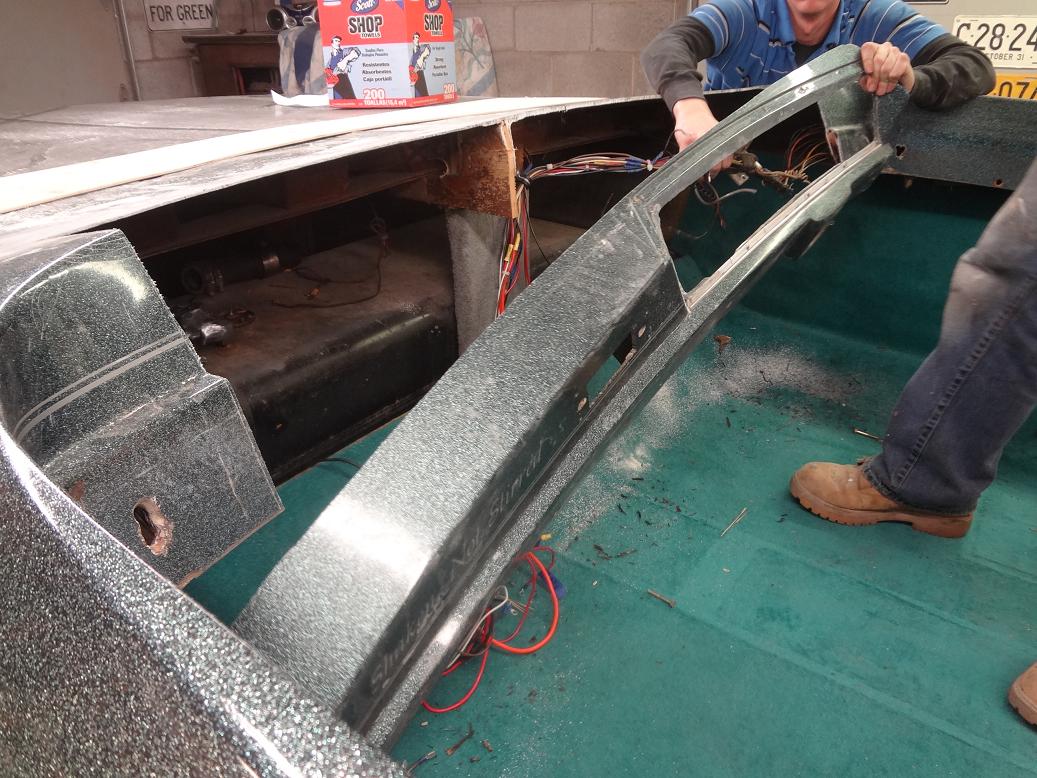

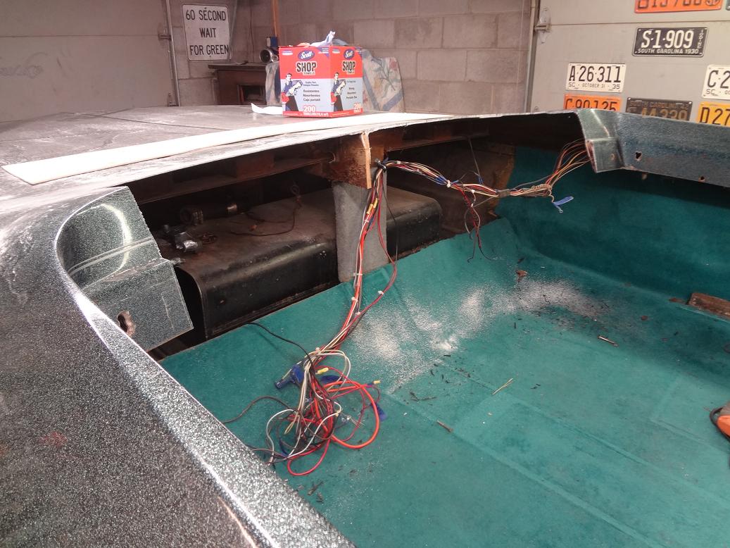

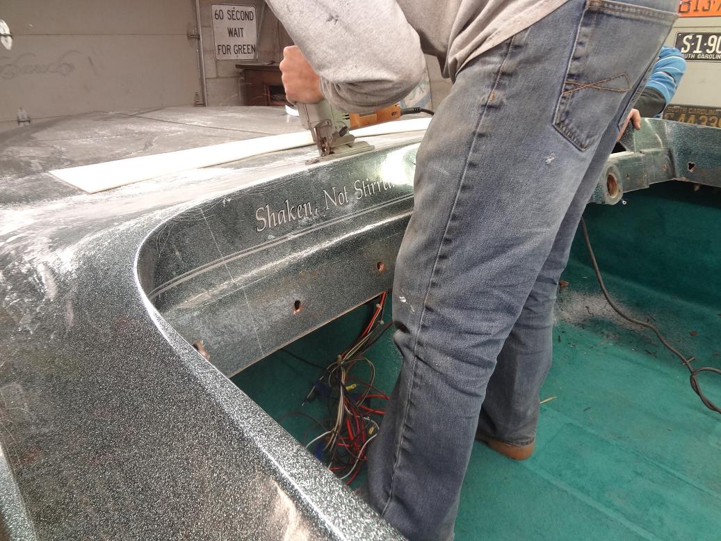

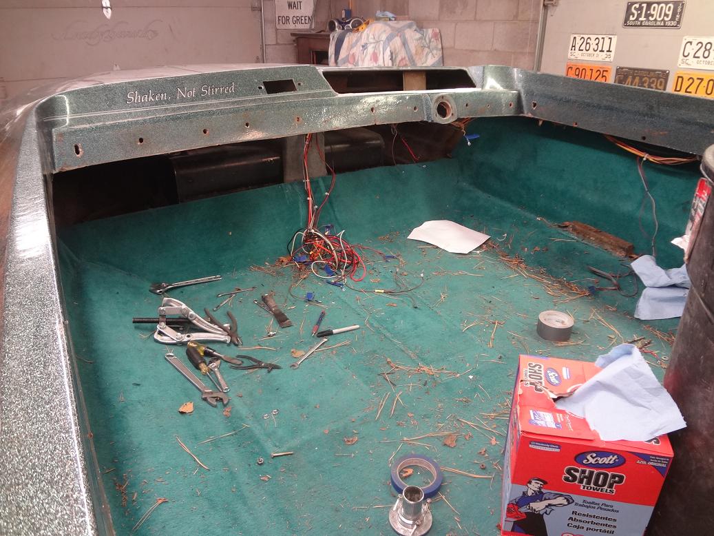

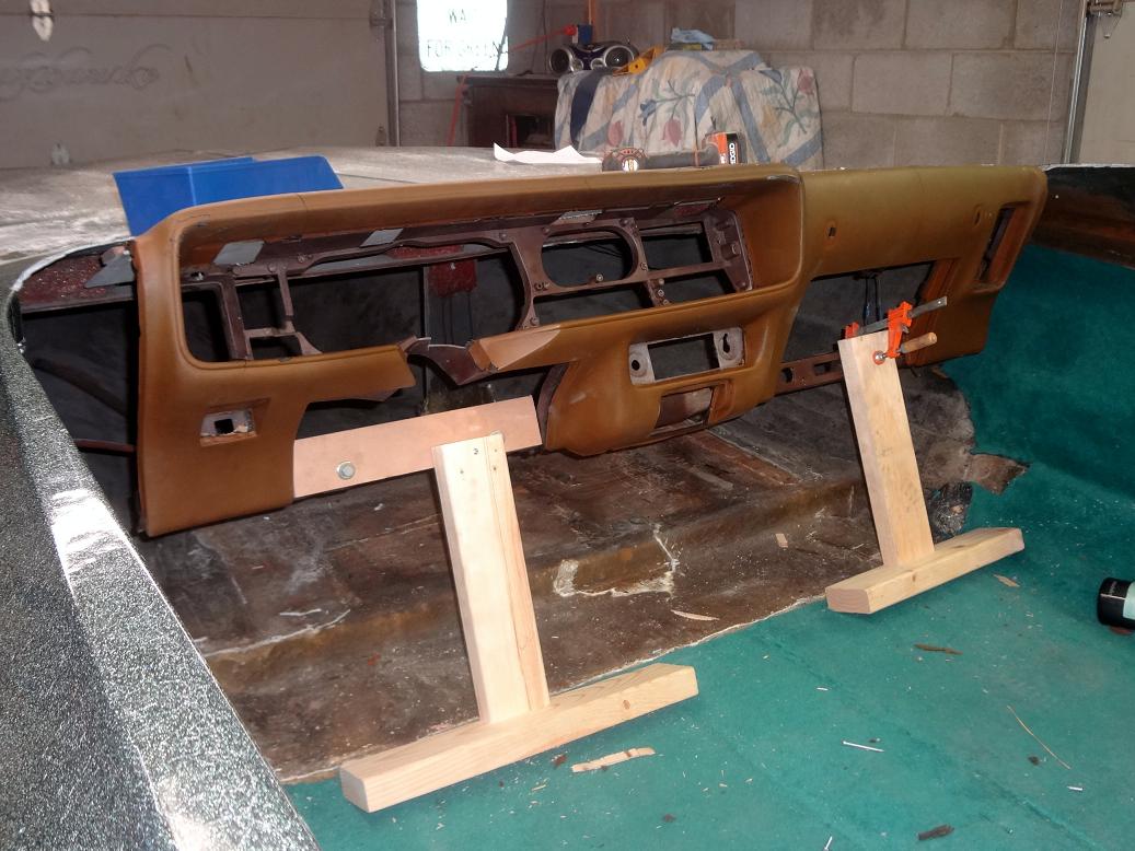

We have begun the transformation. First, we stripped the interior and all the fittings from the exterior. Then we cut away the existing dash area in order to incorporate a Trans Am dashboard. To do this, I bought a "junk" dashboard to use as a pattern for cutting the curves and building the sides to curve into each side to blend into the dash. (The boat is 10" wider than a Trans Am.) After the fiberglass sides have been cast, we'll remove the dash and begin the bodywork in preparation for painting. Anyway, here are a few photos that show the stages thus far.

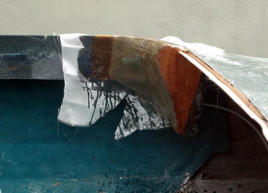

Here is "Step A" in blending the boat bulkheads to the Trans Am dashboard. Step B will look much better...I promise.
