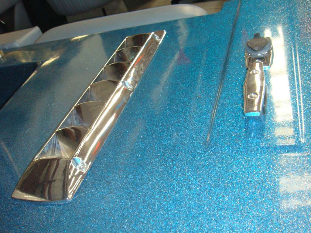

OPPS, IGNORE pic, this my Checkmate..hit wrong image and can't undo..sorry
