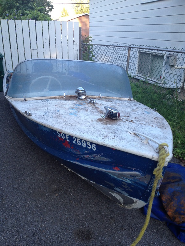

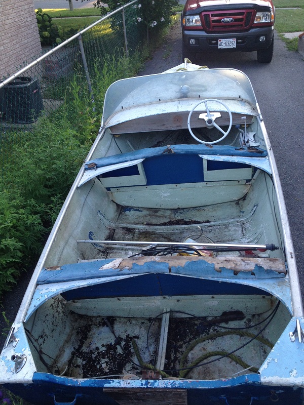

Hi Everyone, I'm new to FiberGlassics and new to boat restoration. Always enjoyed spending time on the lake growing up, and found that water sports helped to keep me in shape. (Well, better shape than had I not be doing water sports.) I am an HVAC mechanic (home heating and air), which means i know how to hold a wrench or a hammer, a little about ignition systems, and know how to do clean wiring jobs. The rest is yet to be determined.
So I am working on bringing this Aluminum runabout back to life with my own vision in mind. It needs hull repair (will have to learn about replacing rivets etc), and the motor isn't firing up yet, and all new interior and repaint everything. Lots to do!

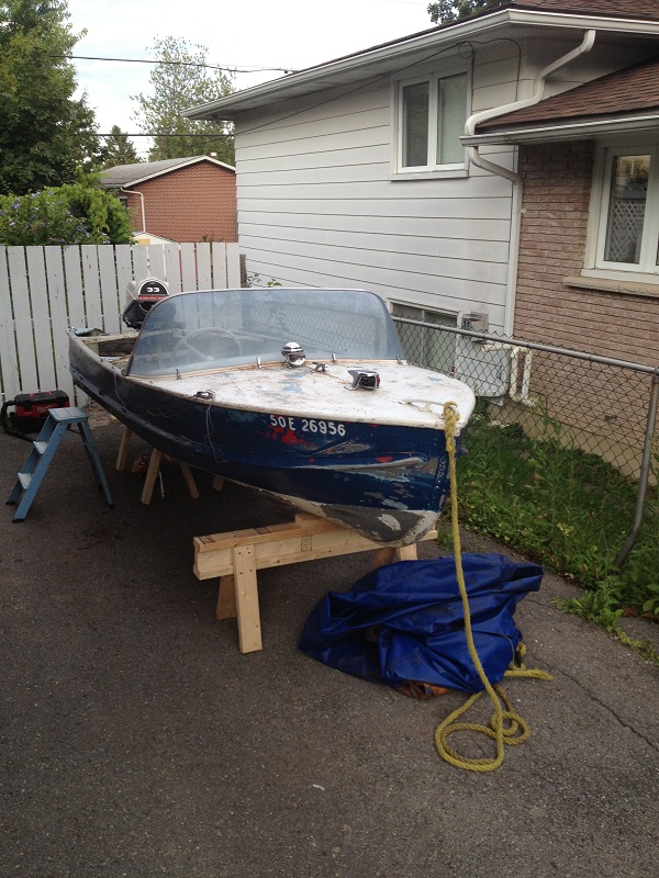

Here it is before I began, Old wooden seats upholstered, completely rotten and host to a colony of carpenter ants. This boat spent 5 years on the ground under a tarp. Mouse nests on the bow and all.

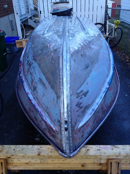

In Ontario, Canada and now mid August I am running out of warm weather and want to see just how bad the hull is for repairs to be completed through the winter. My mission was to get this boat off of the ground, mount the motor and see about getting it running. I picked up the boat and a 1965 or 1968 Evinrude 33HP ski twin both from the same place for a package deal of $160. No trailer included. I think that old Evinrude will look quite swell. Since the hull seems to have a vintage design I would like to keep this antique outboard to help complete the look. I have been toying with the idea of painting the hull to match the (eventually) restored engine.
1. Pressure washed the dickens out of it. Then put the boat up on a few saw horses i built for a quick $20 worth of 2x4's
2. mounted the motor, removed and cleaned the carb (found some sort of nest in it behind the screen). re-installed the carb. that was enough for the time being.
3. removed the old rotten seats and sweep out, vacuum out as much as possible.

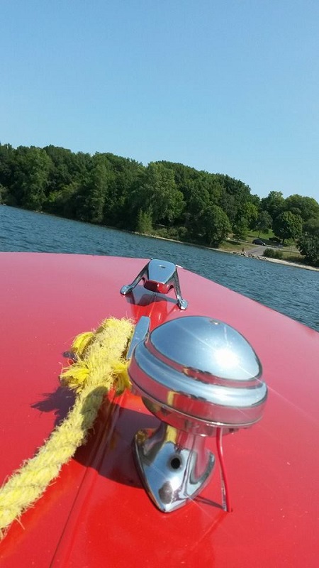

After a very long and cold winter here in Ontario, the project resumes. Over the winter I rebuilt and repaired the original horn, but that's about it. Now that the snow has melted the boat is out of storage and back on the front burner.

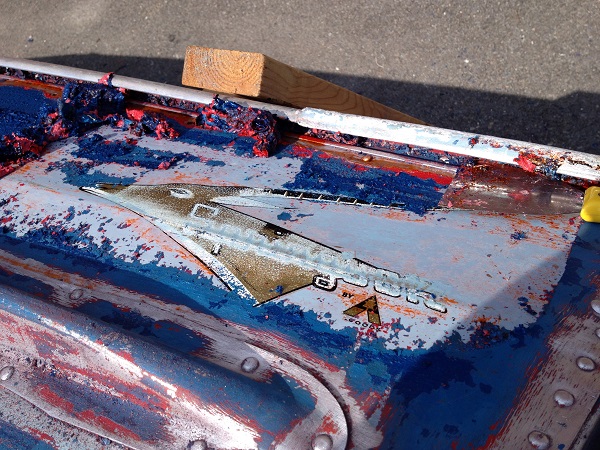

Spent the weekend and about 4Litres of paint stripper getting all of the old paint off the boat. Solved the big mystery behind who's name goes these boats by Aluminum Goods Ltd. It is a Springbok. Work is at a hurried pace these days. Doing what I can outside of my 50hr work week to get this boat finished and on the water.

the hidden Logo

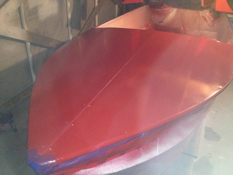

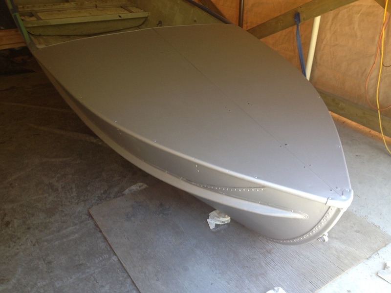

Finally Primer finished on the hull and bow,
I'm having some concerns about paint, Anybody know of a paint that is actually recommended for aluminum hulls? The Marine Outfitters here in town stock Interlux paints but the paint can specifically says not to use on aluminum. the shop owner felt that because I've primed the boat that I should not be concerned but he said that he hasnt done it before. the paint was made for fiberglass and wooden hulls. I'll see if i can get the info and post it here.
I've used the Interlux primer (Xzylene, although im probably spelling it incorrectly.
heres the photo of my progress, it was just a quick snap shot. before priming I used some body filler (marine grade) and did a lot of sanding, cleaning etc.

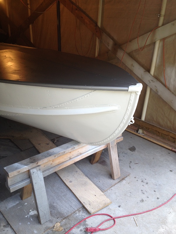

almost finished. One more coat of red.

paint complete

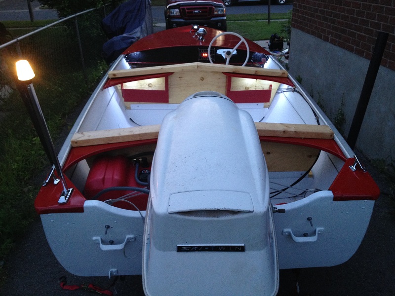

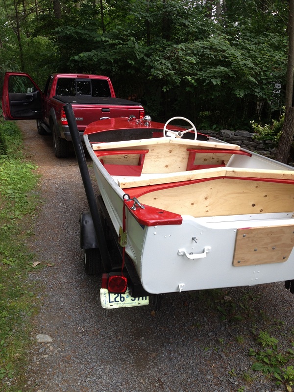

still a few things missing, but time to bring her home from the "paint booth" at the cottage.
Still plenty of work to be done.
Re:1960 "Aluminum Goods ltd" Runabout project 12 years 3 months ago #98512
Looking good! What's w/ the ply panels & 2X caps covering the seat backs?
Re:1960 "Aluminum Goods ltd" Runabout project 12 years 3 months ago #98513
  • Herb
  • Herb's Avatar Topic Author
  • Posts: 49
  • Karma: 2

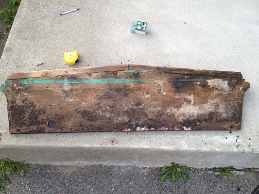

Seats will be upholstered, the ply & 2x caps are the same construction as the original(?) seats.
Here's a pic of one of the old seats.
Think this is original? I'm not sure what else might have been, but I'd like to stay as true to original as I can.
Re:1960 "Aluminum Goods ltd" Runabout project 12 years 3 months ago #98526
I'm not an expert on vintage boats and for sure not on Aluminum Goods boats, but I doubt the original front seat would have spanned the gap between the 2 seat backs.
I'm pretty sure the gap between the seat backs is intended as a step thru.
At some point, I'd guess the front seat either need to be replaced or to carry 1 more person up front (3 instead of 2) a previous owner re-fab'd the front to cover the gap.
If they remade the front, I'd guess they probably remade the back seat too..
Given that the top of the 2X edge on the plywood seat backs (front and back) don't fit down on/even w/ the tin seat back top panels, I don't think the shape is accurate to original even if the gap was spanned.
The 2X top edge may have been the upholstery solution to a 'finished' look or allowed you to rest on the top edge of the seat back.
I've seen pix of a few different makers that used the top of the seat back as a seat and did actually fully upholster them.
I know you've struggled to find pix & info about the boat, but in the end, you will probably just have to make a somewhat educated guess. Then fine tune that guess so that YOU like the way it looks when you're done.
So far, it all looks like really great, careful attention to detail work, so I'd bet the seat shape and upholstery will turn out the same: Great ;)
Personally, to better see over the bow and people in the water close to the boat, I'll 'perch' on the helm seat back until safely able to throttle up. An upholstered seat back top will be more comfortable then one that's not, but I'm usually only perched for a short time while at idle/no wake speeds or starting the motor.

The Step Through for the front definitely makes sense. I think I'll cut out another front seat. I had been tossing the idea around in my head for a while as i have seen it on other boats. This boat is much smaller on the water than it looks in the driveway. The step through front seat would make getting behind the wheel much easier as well
Thanks for the input.

Wired "cabin" lights and running lights. I found some really cool LED lights at the local auto supply (princess auto) mounted them under the seat backs and up above the dash where i could fit them discretely, also wired in a simple switch board i bought from the local marine supply store. still need to tackle the seats and add a second battery. Windshield needs polishing so haven't put it back on.
Going to see what happens on the lake tomorrow. engine runs but need to get the mixtures just right.
still much to do but here's an up to date picture.
