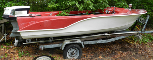

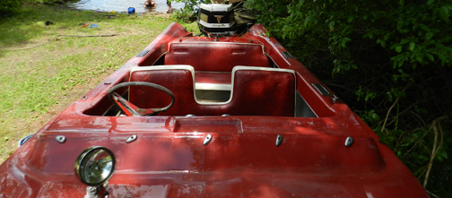

Not exactly sure what the story behind this boat is, soooo shaped like a lake'N sea but branded as a princecraft I give to you my first attempt at a glassic.
I got this boat for a great deal but the transom is toast so the plan is to separate the deck and the hull and replace the transom, the floor and possibly the stringers if need be, paint and gelcoat and whatever else I end up getting myself into.
I believe the trailer is a gator, and not pictured is a wicked cool looking fat fifty motor which i will be restoring also

The hull is definitely a Lake N Sea Biscayne and like I said Princecraft may have simply been buying the hulls from Parsons and re-branding them. The trailer is a Gator for sure and that motor was a winner, you just never find them complete with all the trim. The steering wheel is also a cool unit. I look forward to seeing the progress. I used to have a Biscayne and I ran a 35hp on it which was adequate for 2 people but a 50 would have been better with 4.

Nice steering wheel!

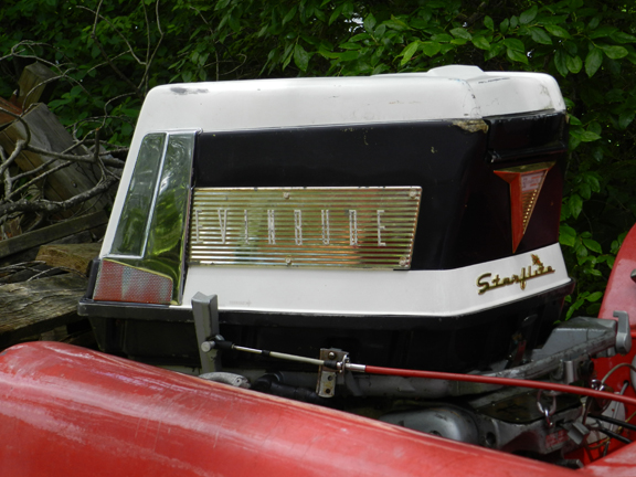

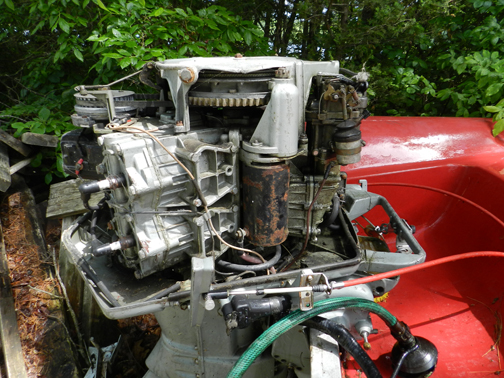

finally got the fat fifty out of storage here she is
couple shots of the hood
and how the boat sits as of today

Nice boat. My family had a pink Lake n Sea when I was growing up. Not a great color for a kid. Nice 50! I have one too, 59 Johnny.

I managed to wrestle the motor on the stand today, with the size of this thing it was no easy task haha but it fit good and its a nice solid base to start working on this thing
