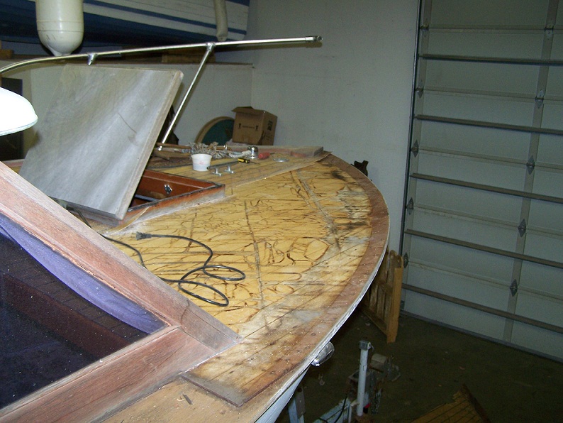

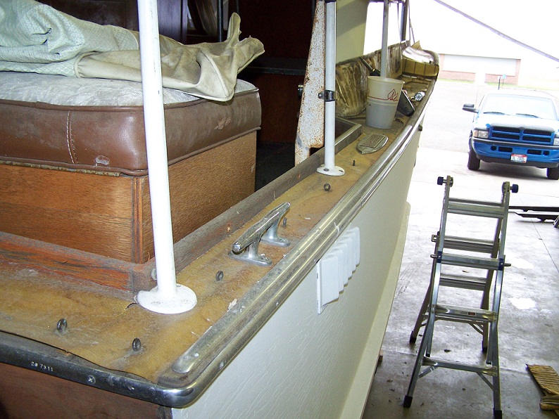

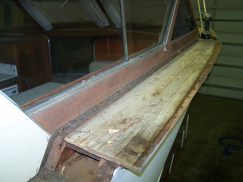

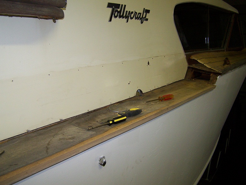

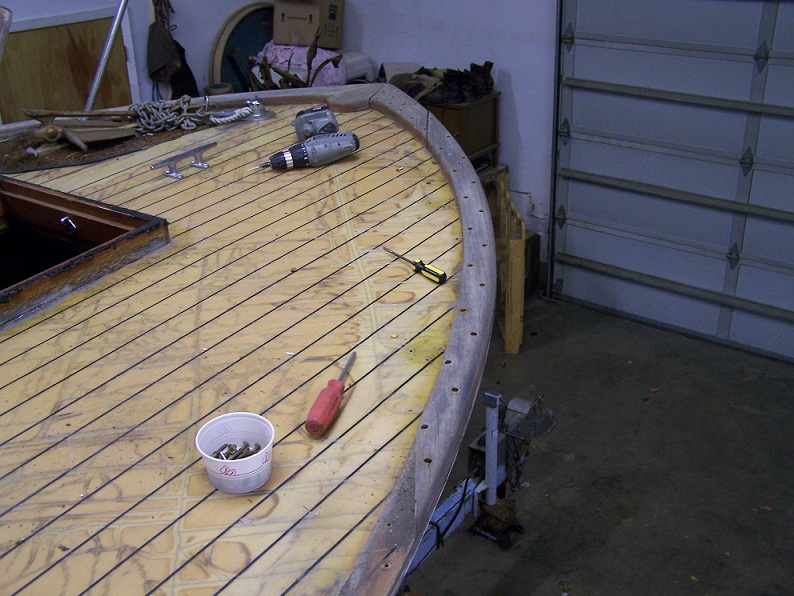

Here we go.
All of the fiberglass overlay is going to come off. Decorative vinyl on cabin also. Going from mid cabin rearward and across stern first.
Looks to be a solid mohagany plank here.

Re:1965 Tollycraft Voyager 26 14 years 3 weeks ago #70654
Looks like your not wasteing any time on this one. It should be interesting to see what the wood under the vynal looks like.

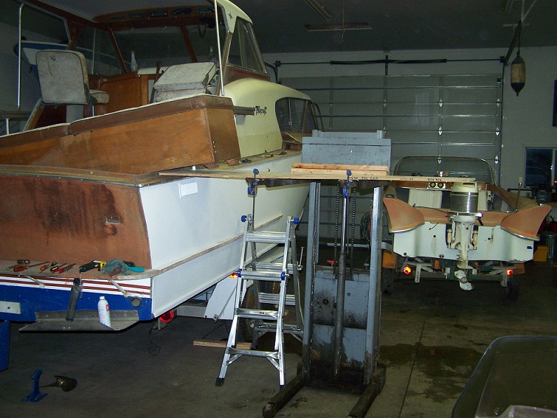

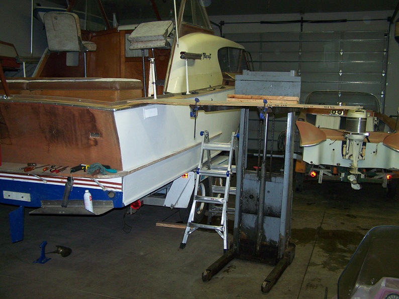

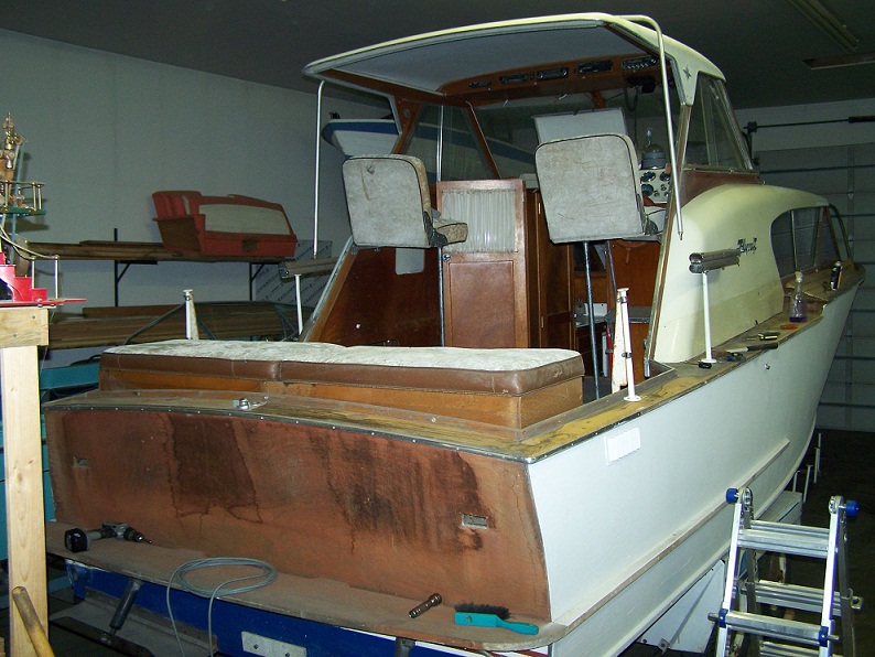

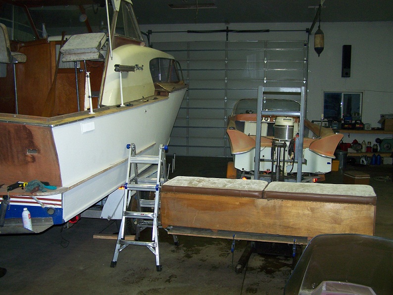

I got some more of the deconstruction done over the weekend.
I first started by unloading the bench/storage from the boat. Working alone and a little taller hull than the rest of the fleet!!
Thank goodness for the little pallet jack/lift truck.
Then continuing forward.

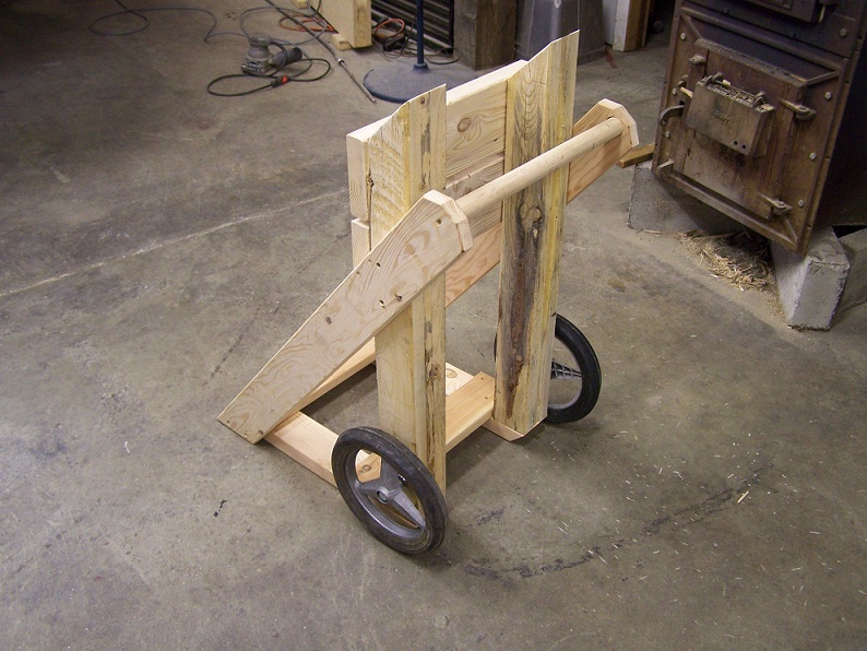

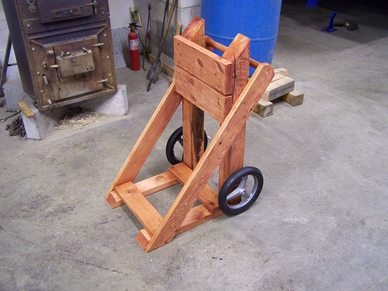

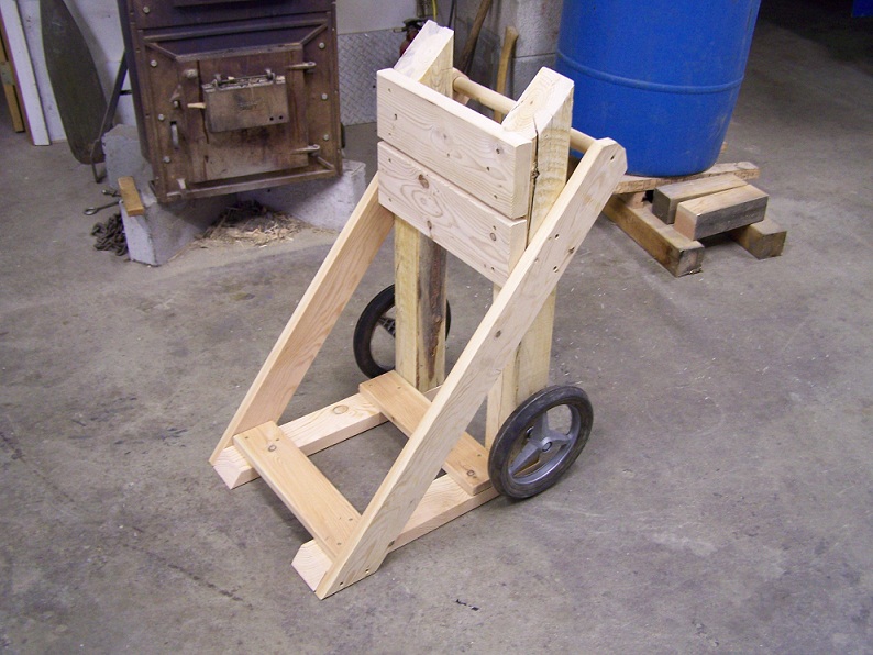

I had a good weekend. The wife was gone so I just got the shop up to 70 degrees, threw a dutch oven full of stew on the wood stove and cranked up the tunes. I also got a 1960 Merc 400 running and hung it on the Wacanda and delivered it to a co-worker.
Then from a couple posts here, I put this together to move some small Mercs around on.
Neil and Mary Ousnamer
Re:1963 Tollycraft Voyager 26 14 years 1 week ago #71153
Looking good up there Neil, nice progress! That IS a big boy, I admire your ambition to even tackle this project my friend.

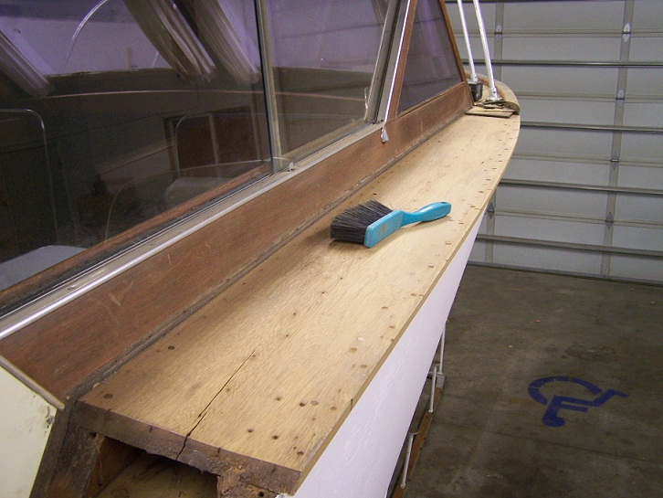

Re:1963 Tollycraft Voyager 26 14 years 1 week ago #71159
Geez Neil, what you gonna hand on that stand, a BB Chevy? Sure looks strong enough. You were right about very little info or pics of your boat being around. I contacted a friend up in toronto who keeps all the records and pics of different clubs up that way to see if he could find you any pics of the boat. He told me it will be a good project for some of the kids who want to get into the history of some of the clubs and there differnt boats.Maybe something might show up there for you. Looks like the wood under the deck covering is in fair shape there. Keep up the good work. Skip. :P
Re:1963 Tollycraft Voyager 26 14 years 1 week ago #71172
Neil, she's coming along nicely. Are you going to replace the cracked planking? Nice motor stand by the way, what a BEAST! Skip's right, I think you could put one of those new V8 outboards on there!!!!!!! I have to admit, I over do most of my projects also, not that that's a bad thing, you know it's not going to have to be redone for many, many, many years!!!!! ;)

Guys that is lumber that was just laying around in the shop. The 4x4's are blocks that our paper wrap comes banded to at work. It is SPF and I just use it for blocks around the shop and firewood.
Skip
That would be great if they could dig up some pictures and learn a little in the process. Great idea.

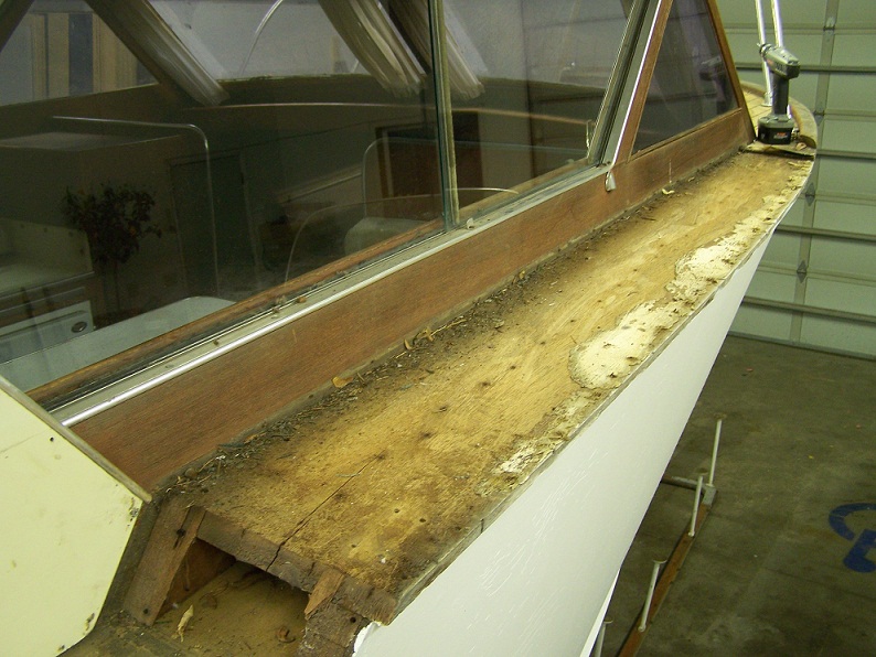

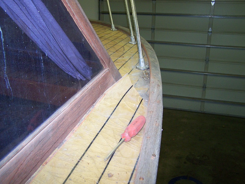

For now I am tearing all of the bad off. Once I get all the way around the deck, I will have a better idea of what I am going to need and replace. So far the planks are solid with only the fastener holes and some checking. The only rot so far is in the plywood under the fiberglass "skin". So far just minor stuff.

Well that's good to hear. Hopefully the rot has stayed away from the inner structure then your good to go.

Re:1963 Tollycraft Voyager 26 14 years 1 week ago #71217
Neil, looking good. That smallcrack is an easy repair. drill a deep hole in the side just about close to the crack, put some epoxy wood glue in the crack and put a brass screw through the drilled hole and then plug the hole with a mohagany plug, clean up the squished out glue and sand it down. voila!
