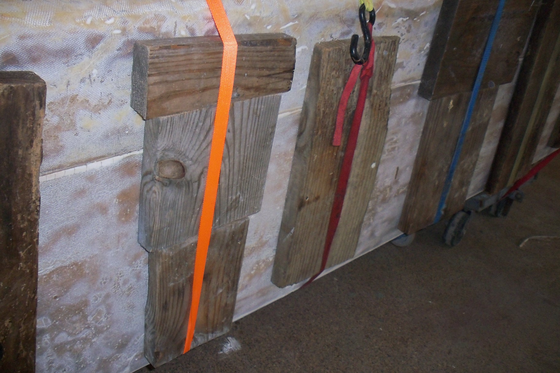

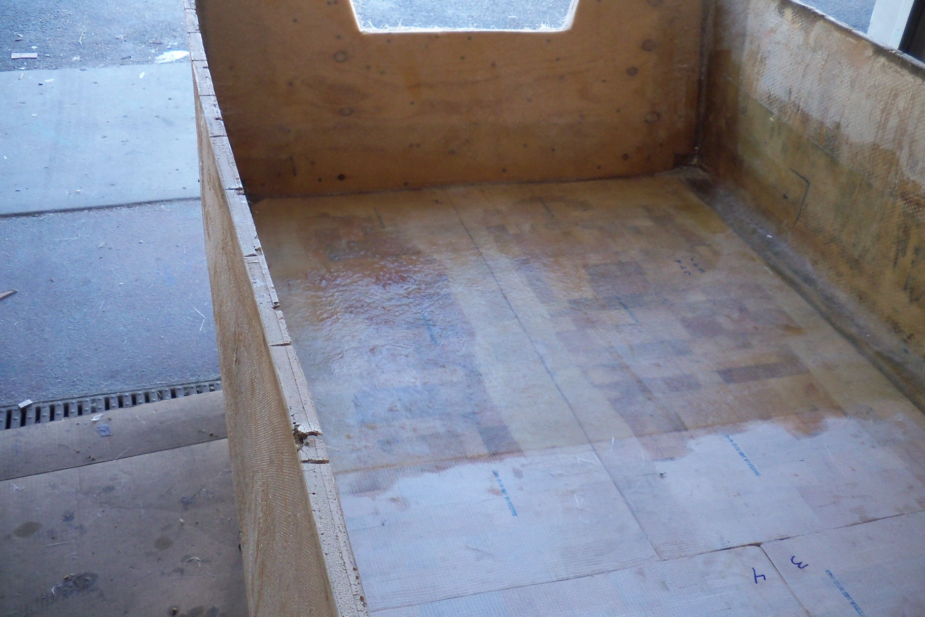

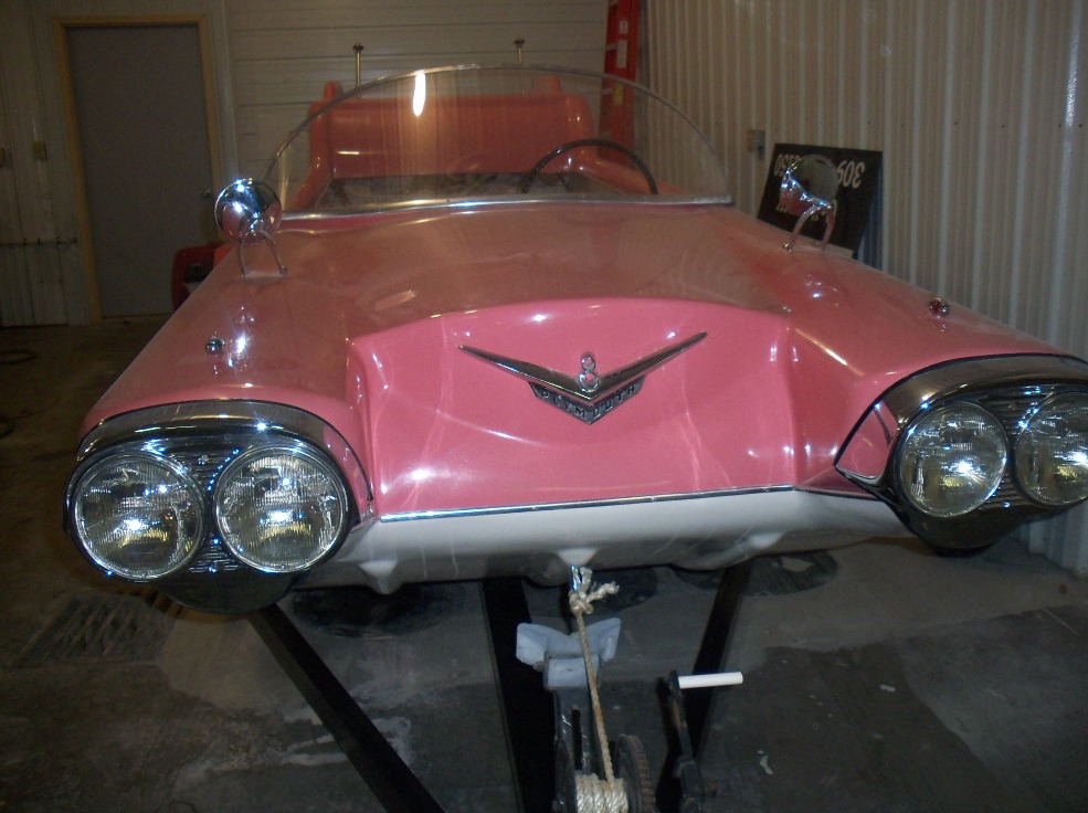

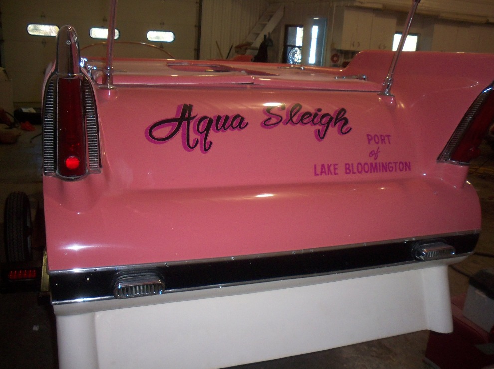

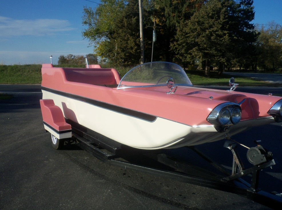

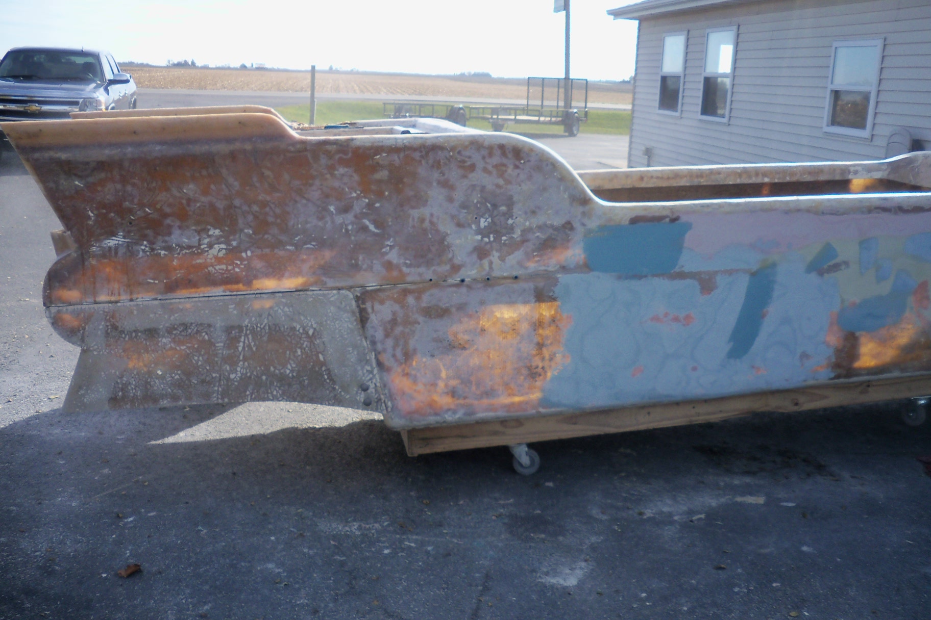

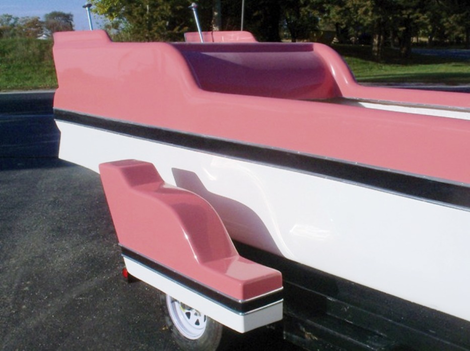

This has been a year project,,we have been on and off,,it was so bad you could shove your thumb to it.It was ground to cloth then it also bulged out 12 in each side then was boarded and ratcheted up to straighten then PVC pipe cut in 1/2 then glassed in to straighten the bulge,It now has a complete new transom, balsa wood floor,heavy mat through out and a balsa wood under deck.all new gel coat,trim, NOS hard ware, custom made trailer,fenders.This is a one of a kind.It is the only one,.Here are some pics,,thanks Bill
Re:Aqua sleigh alias No Name 14 years 3 weeks ago #70525
Very cool and unusual / unique! I'd ask where you find 'em Bill, but I don't want you giving away your secrets. :laugh: Thanks for sharing.
Re:Aqua sleigh alias No Name 14 years 3 weeks ago #70529
Wow Bill, definatly one of a kind. Curious to see the interior and engine compartment.
Re:Aqua sleigh alias No Name 14 years 3 weeks ago #70531
NIce looking boat you ended up with. Sure does look like alot of work went into it. Really cool with the matching trailer. Skip.
Re:Aqua sleigh alias No Name 14 years 3 weeks ago #70559
Those headlights look like an old Plymouth I had! Neat boat Bill... really neat.
