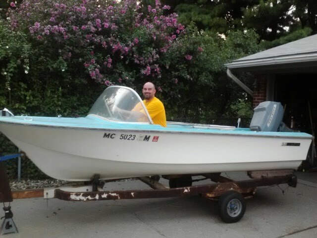

Ok! Now the fun begins!
I must say I'm extremely grateful to the previous owner. He threw in seat frames he made, the patterns for the seats, new wiring for the trailer and a bunch of other goodies. I don't think we did too bad for $200! LOL.
Now, on with the show.

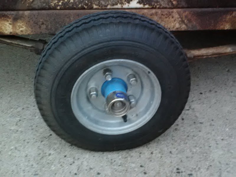

Here is one of the new wheels, and I threw in the picture of the bearing buddies he installed. :)

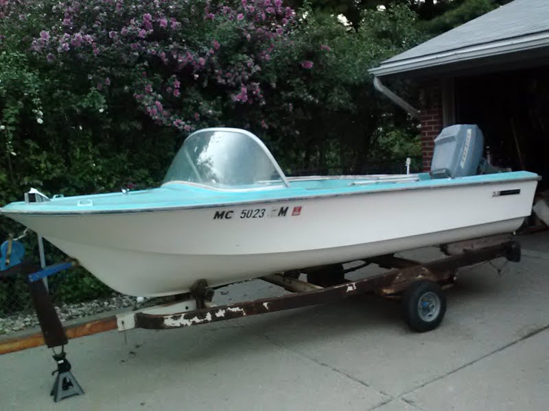

Here is the boat in profile.

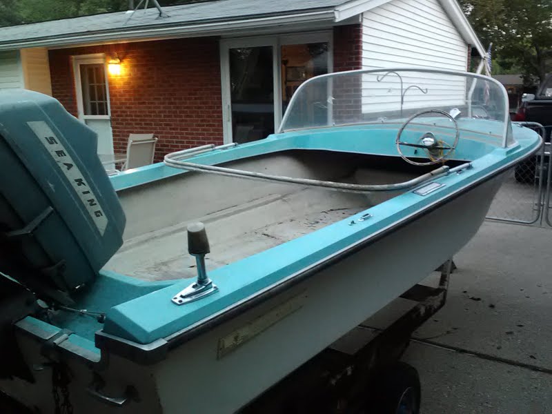

Here is a rear view.

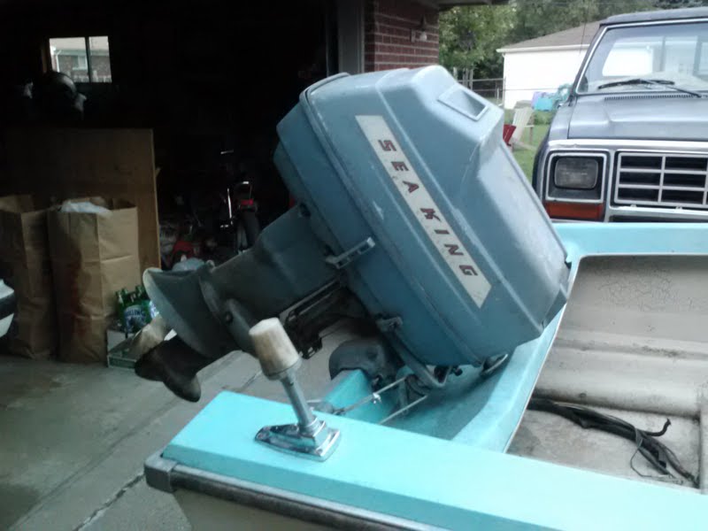

Motor shot.

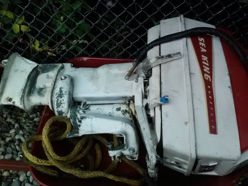

Spare "long shaft" motor. Which I found you you CAN lift by yourself on the side of the road... ;)

Now, for the news I wasn't hoping for. There are a couple of 'soft spots' in the floor, mostly at the area where your feet would be if you were sitting in the rear seats. They aren't through, but they are 'weak'. Can they be stiffened with a fresh coat of matting and 'glass? Or should they be cut out completely and replaced? I know nothing about boats... so any advice will be digested at this point!
Other than those couple of 'soft spots' and what appears to be a thorough cleaning, I don't think it will need too much else. Famous last words, huh?
So, grab a beer and c'mon over. There's plenty of cleaning and waxing to do!
Good night all!
JK

Looks good. Keep that smile for now the work begins.
Soft spots in the floor--not good. The proper thing is to get it all out of there and replace it. Transom also if it is shot. That is about it for structural. The rest is easy stuff.
Congrats and keep going.

Welcome and yep what Neil said! Soft floor almost always means rot and it has to come out or it will just get worse. The transom also needs to be checked to make sure there are no soft spots there also, or hidden rot. That should be a fun project. Good luck We're here when you need help.
Floors rot from the bottom up, usually. Often the bottom of the plywood wasn't glassed or sealed at all- and it rots away. Consider yourself VERY lucky if you don't need new stringers, you wont know that for sure until you get the floor out, though. Check the transom very closely, I've seen many that seem perfectly solid have hidden issues.
The good news is, it's all repairable :)

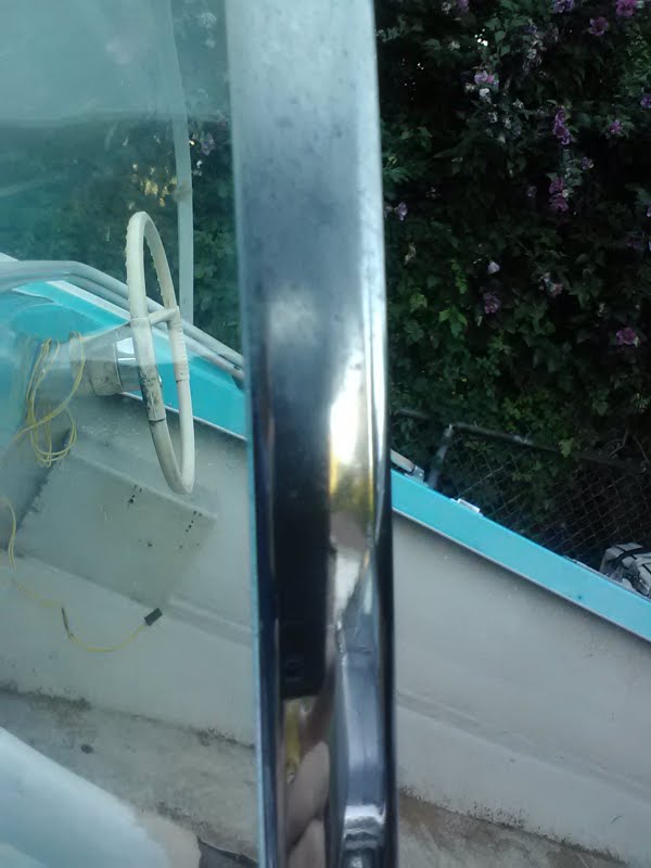

Started to polish the windshield frame. It's amazing what 30+ years of sitting outside will do to aluminum. And with a little Mothers Mag and Aluminum wheel polish...
You can really see a difference. They went to work with some 'magic erasers' and cleaned up the hull.
