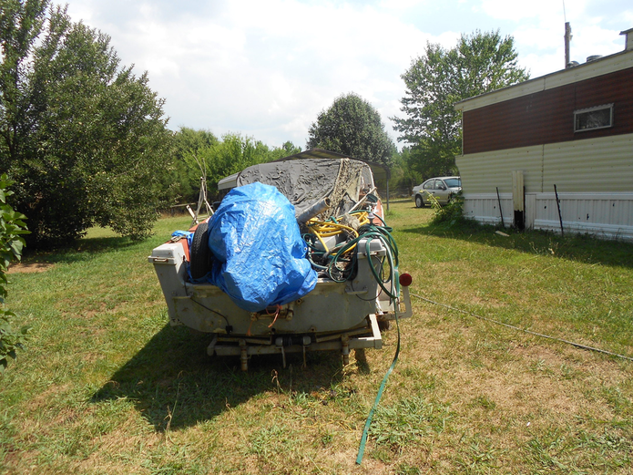

Re:64 sea king 15ft project for newby....help 14 years 3 months ago #64973
here it is

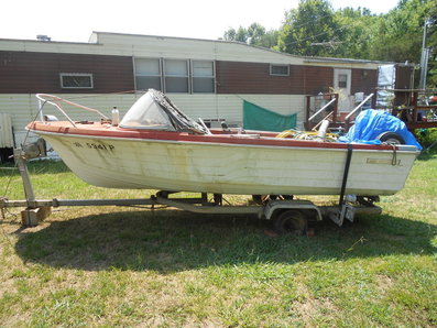

Re:64 sea king 15ft project for newby....help 14 years 3 months ago #64976
last pic,any comments?

it appears, from what i can see, that most all of the hardware is there, even the aluminum brackets that go across the transom and cover the end of the rub rail. BOTH of mine are missing the port side one.
i believe that the railing up on the deck is aftermarket.
there is a little bit of information in the Glassic library here:
www.fiberglassics.com/library/sea_king
sea king was sold by montgomery ward, but they didn't manufacture the boat or any of the parts on it. all of that was farmed out to other manufacturers. i'm not sure who was making what in 1964, but others on here will chime in, no doubt.
if i'm seeing things correctly, it looks as though your trailer has rollers only - no bunks. that is something you will probably want to change. bunks do a much better job of supporting the hull than rollers.
nice boat!
