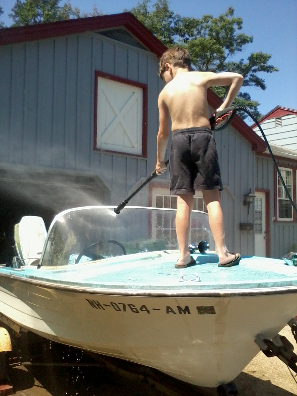

Hi new guy here, I found this place while looking for some info on my boat and saw littlefins post on the same boat. Looked around and liked what I saw so I registered. For fun I work on small engines, and have built/building 2 hardtail choppers from the ground up. I have a 220v welder, torches, drill press all the toys. I used to have a late 80's Stingray 17' boat but got rid of it about 10 years ago. Had a son 7 years ago and wanted to get something to take him fishing. So I bought this boat 3 years ago got it running but discovered the water pump wasn't pumping so I shut it down. It was early November so I put it away at my Grams and would fix it "Next Year" well as I said it's been 3 well my sons been on my case to fix it so here I am. It's a 1964 Starcraft Ranger I believe with a 1964 Evinrude 28hp and a Holsclaw original trailer.
First pressure wash, enlist child labor when possible.
