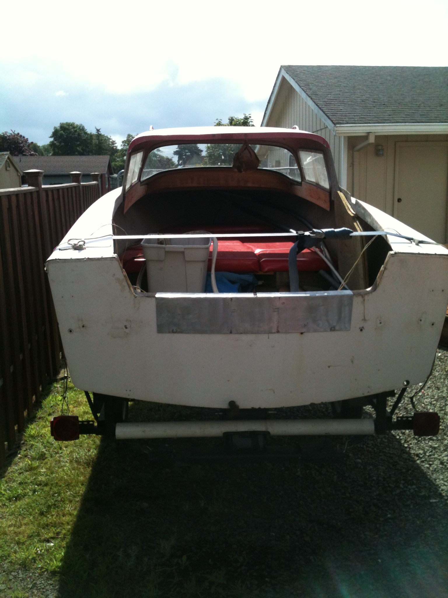

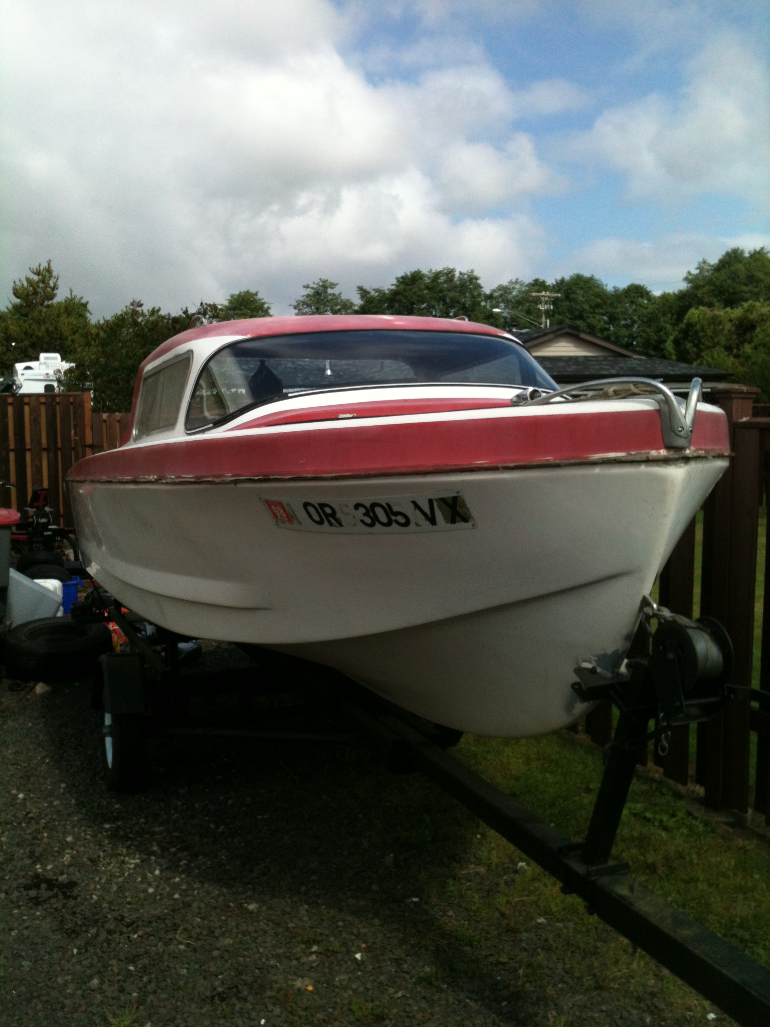

Oh yea, title says 1958; here is one picture.
Re:Glasspar Del Mar 14 years 3 months ago #64647
Back view, note no cabin bulkhead..
Re:Glasspar Del Mar 14 years 3 months ago #64650

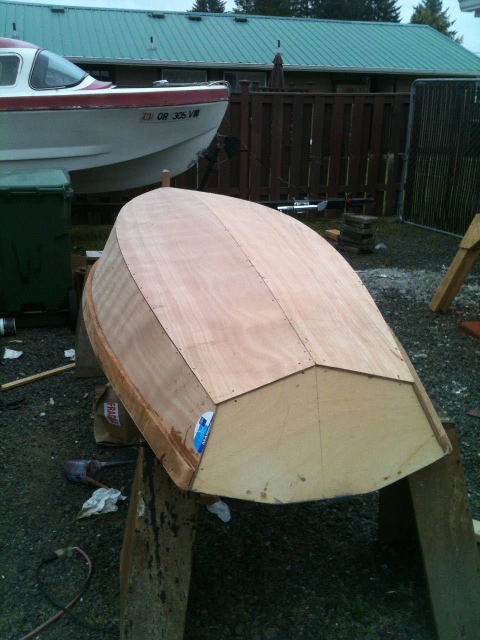

Kind of a side view, I was actually taking a picture of the rowboat I'm trying to finish up so I can start on the Del Mar.. But the mist and sea fog that hangs over the North Oregon Coast makes it challenging; everything stays too damp till mid afternoon..
