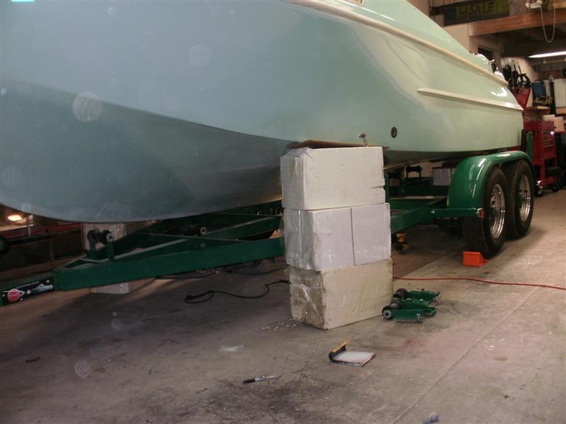

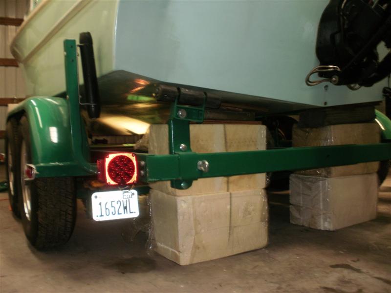

I lifted the front up a bit first and got some styro block under it. Make sure to block the tires so it does not roll when you jack it up.When I had the weight off the front -I went to the back and lifted from the stern. I used a hydraulic floor jack with a 2x6 across the back to even out the pressure. Got the back off the trailer then blocked it well and went back and lifted the front some-more Repeat the process till you get enough room to work. Your boat will weigh alot less than mine so you should have less trouble and risk . That plaster looking stuff is probably "Marine tex" You'll have to grind all that off before you do a fiberglass patch. Check the size of your pictures and use Medium size. You can only load one picture at a time- hit submit then when it post click Edit and add another - repeat process for each picture. I get the styrofoam blocks from Lowes , they get them from the small utility trailers they sell. When they are shipped from the factory they remove the tires and stack trailers on top of each other and they use the blocks for spacers. When they assemble the trailers for sale they throw the blocks away. They will give them to you if you ask. They work good for small steps - blocks Etc.

so ive been bustin butt moving my grandma and havent writin on here but for progress today i took your advise on the foam blocks but when i went to lowes i talked to about everyone in the store and they looked at me like i was nutts ha. so insted i got some wood and built some boat stands i jacked up the whole trailer placed the stands and droped the trailer i got it about a foot and a half higher tomorrow i cant wait to start sanding.sorry still no pics am just going to borrow a camera ha still thanks for you help man i appericate it. :woohoo:
