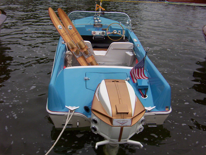

welcome ritchie,i have a 1959 cutter they are very well made boats,about the only wood in them ,is in the transom.
if i were you though ,i would cut out an oval or circle big enough to remove the foam under each seat,mine was soaked,but be prepared to go though alot of jigsaw blades,lol,those seats are made well.
and like i said cut a circle or oval,because a square or 90 degree cut will eventually crack at the corners.
also if your rubrail is savable,hang onto it,i still havent found a good replacement for mine.
your jet de ville will be a beauty,JAG had a beautiful one.
here is a pic of my seat with just some of the foam removed,the bottom half was soaked .
a picture of "JAG's' cutter,its an inspiration for me.

JAGs jet de Ville is BOSS! I wish I had the Jet de Ville. I think I have the Como.
