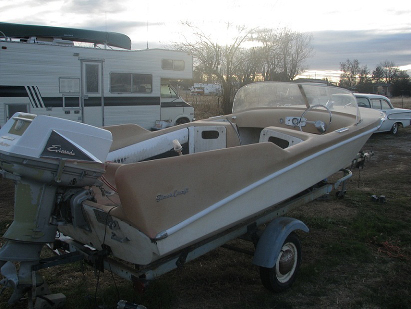

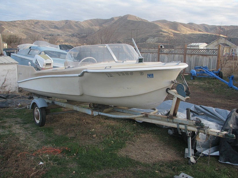

Gracie in Emmett Idaho wanting to come north.

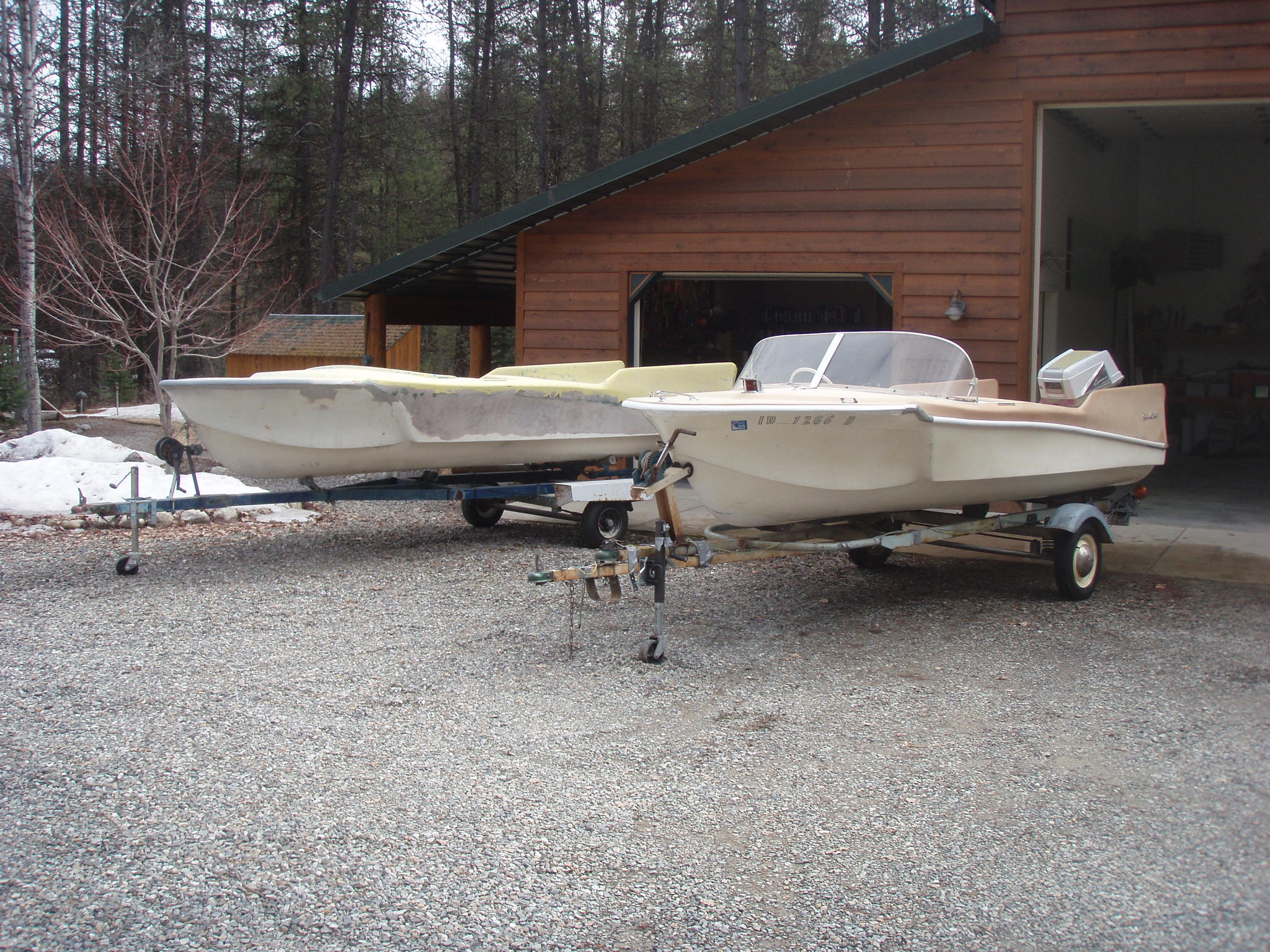

Gracie at new home in Priest River, Idaho with sister GC.

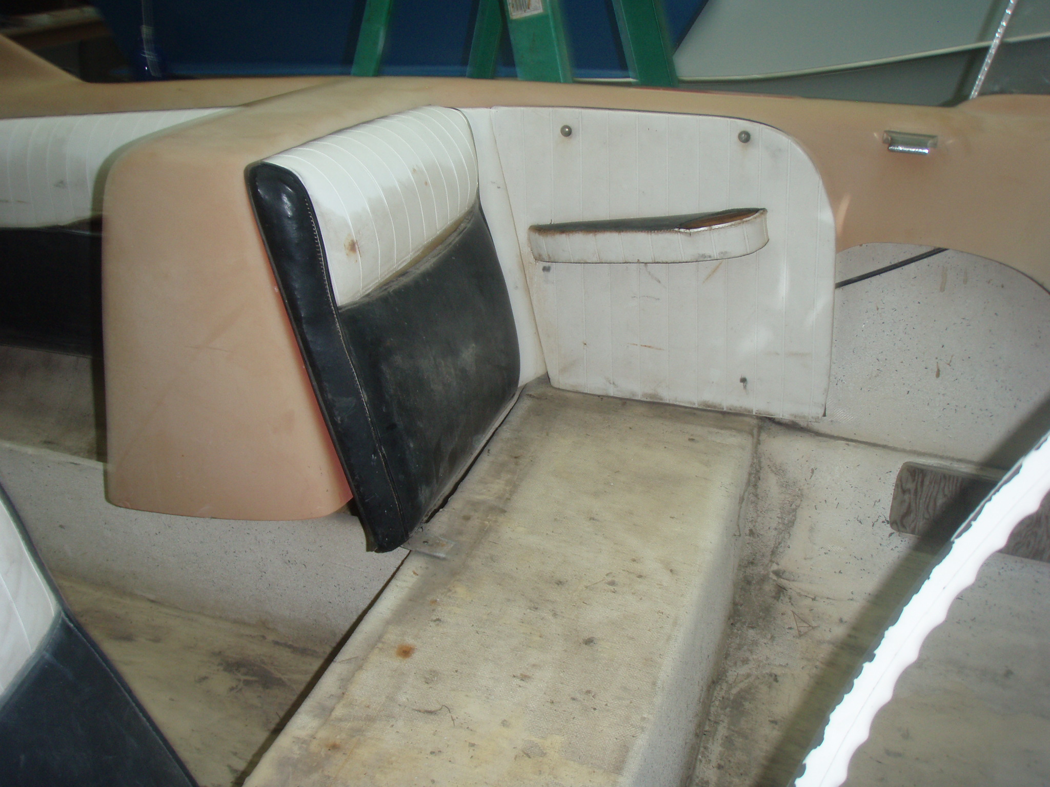

Dash is in great shape with only one hole to fill - There was some sort of modern ammeter in there.
So Gracie is going to be dressed up in '55 Pontiac Bollero Red. As you can see the red has a big tendancy toward orange.
Gotta love the armrests and bottle opener.

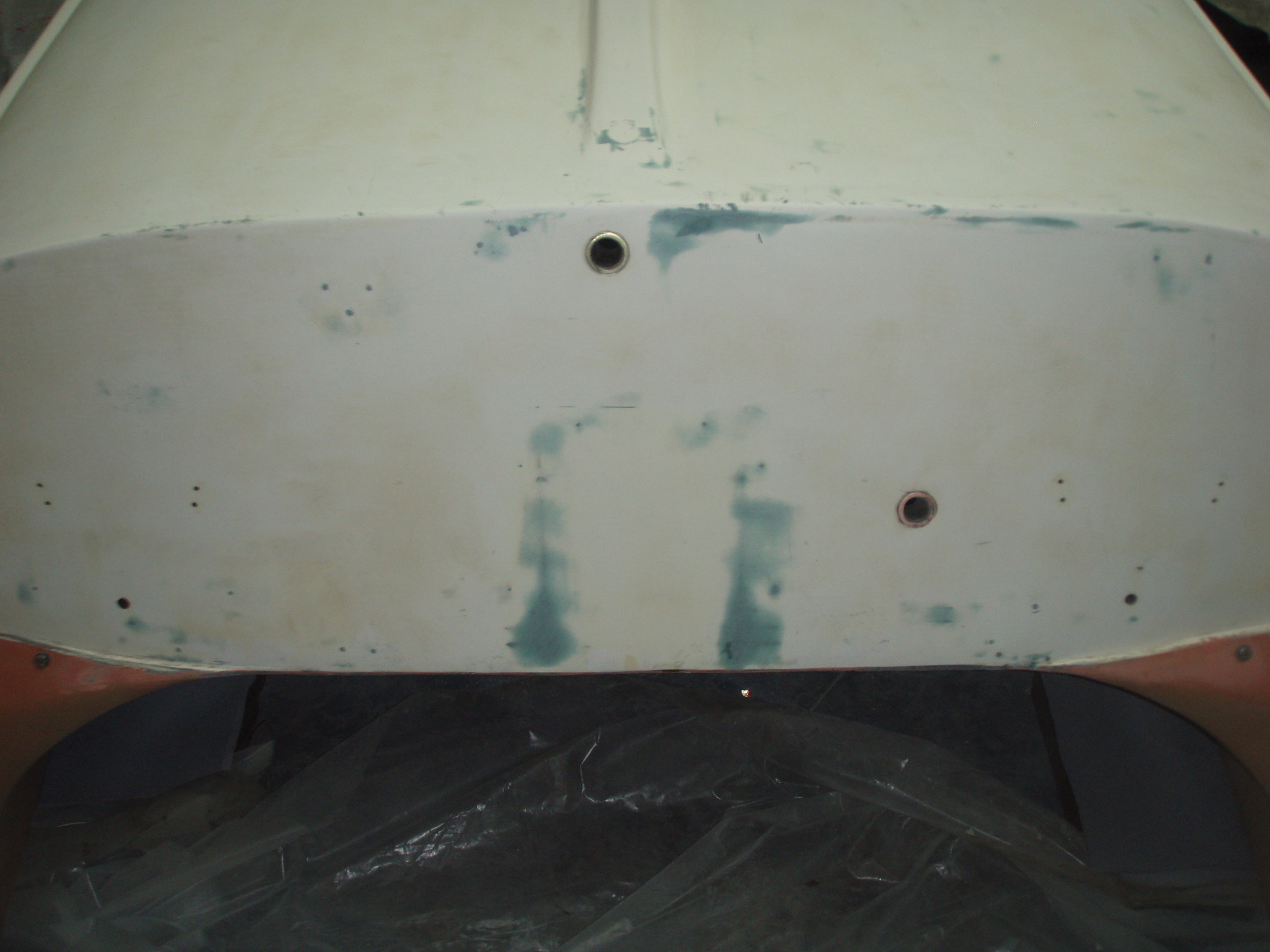

The transom is in excellent shape with only some minor holes to fill.

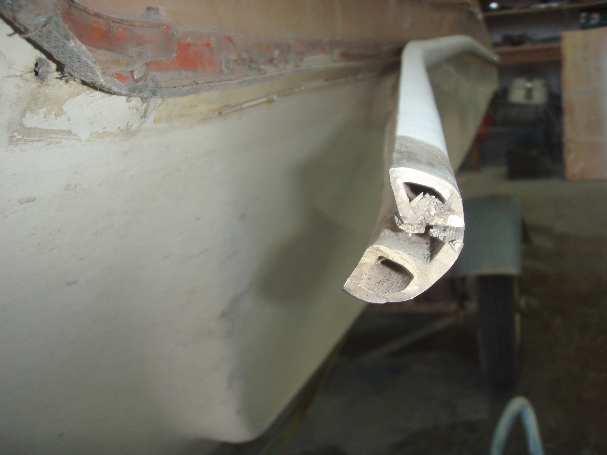

The rubrail is in real good condition for its age. There is some slight cracking over the whole thing, but I have had great success in the past totally cleaning it and then rubbing acetone over it and it tends to meld the cracks together and softens and smooths the whole thing.
Rub Rail End Look

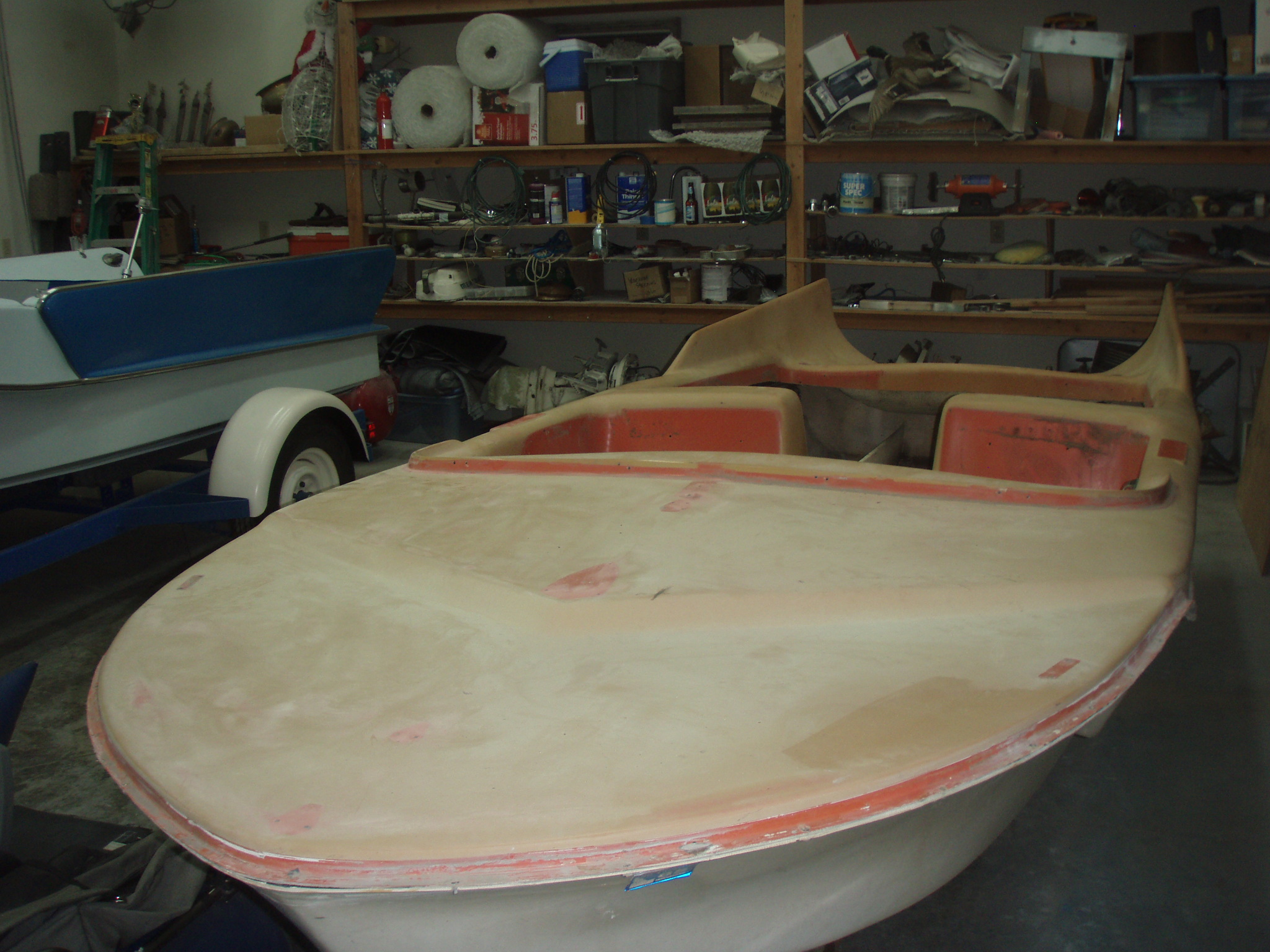

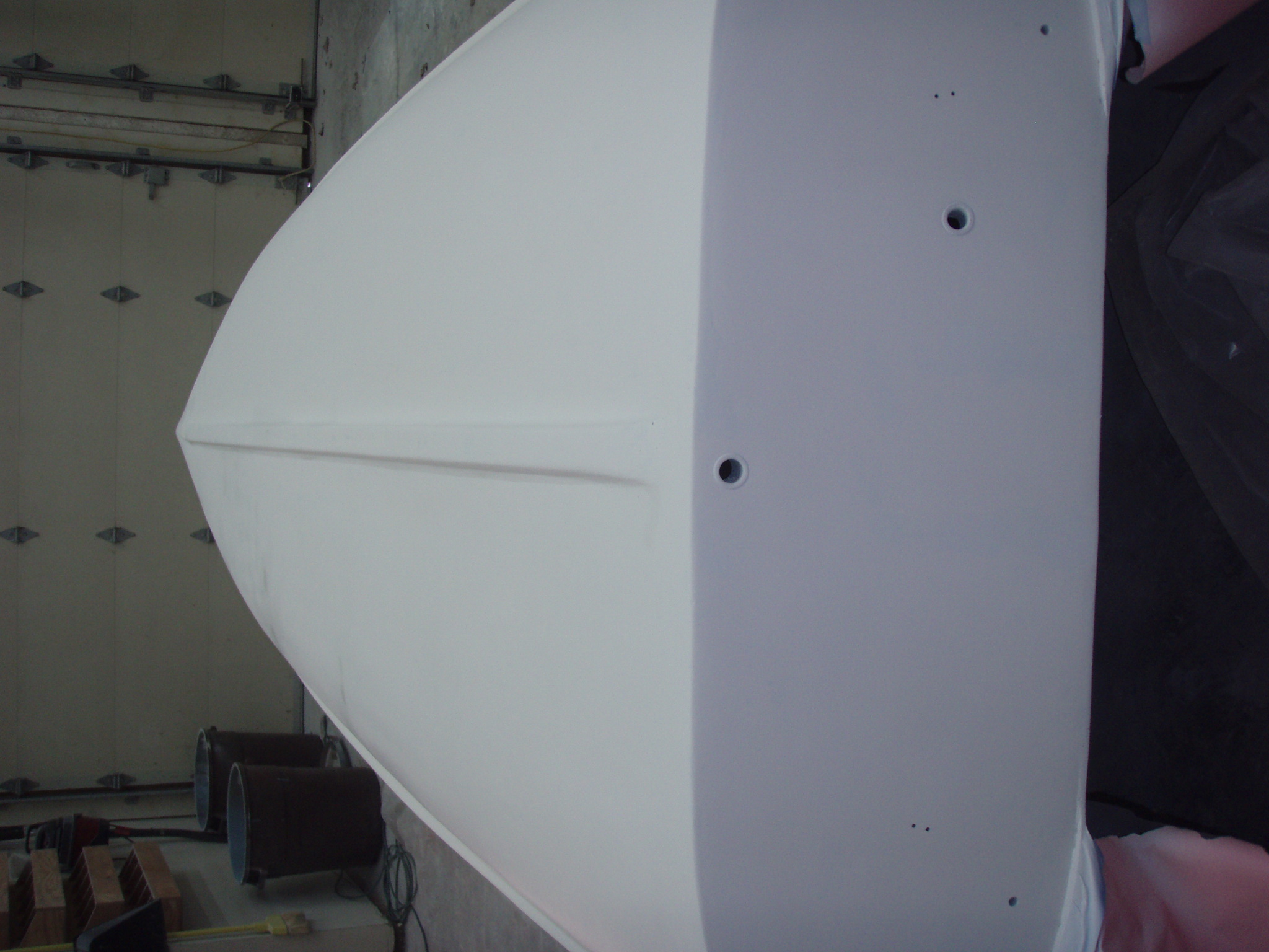

Re:Fiddynine Glass Craft Olympia 14 years 6 months ago #59525

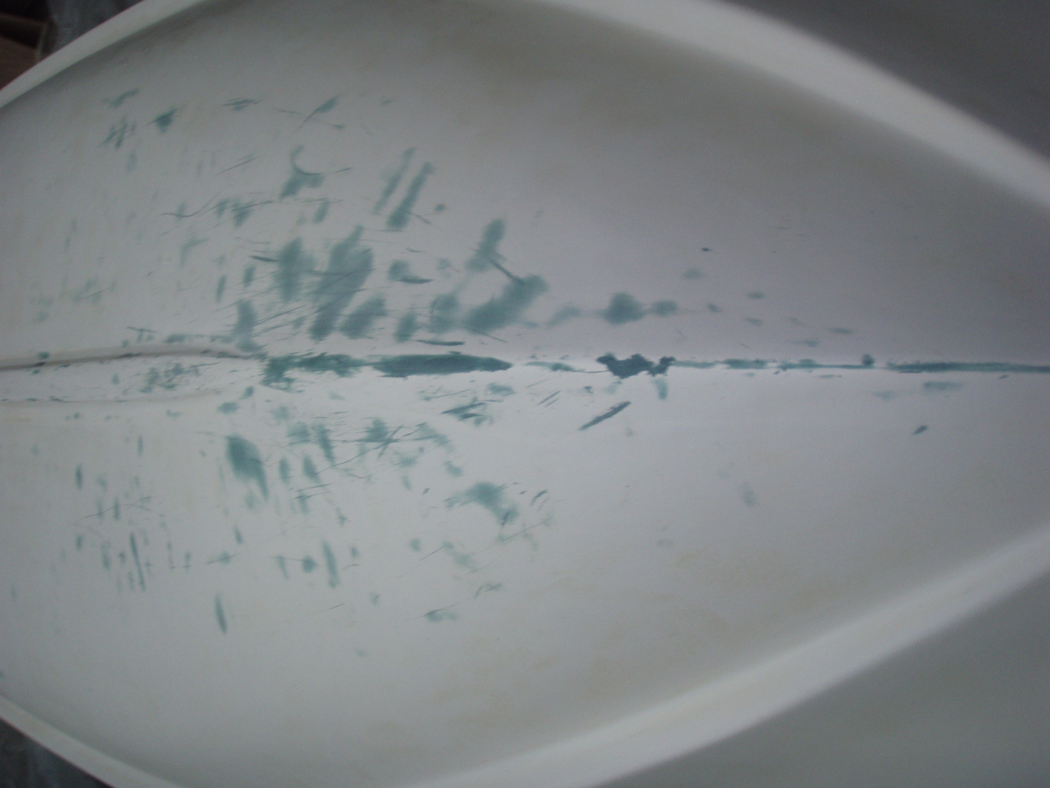

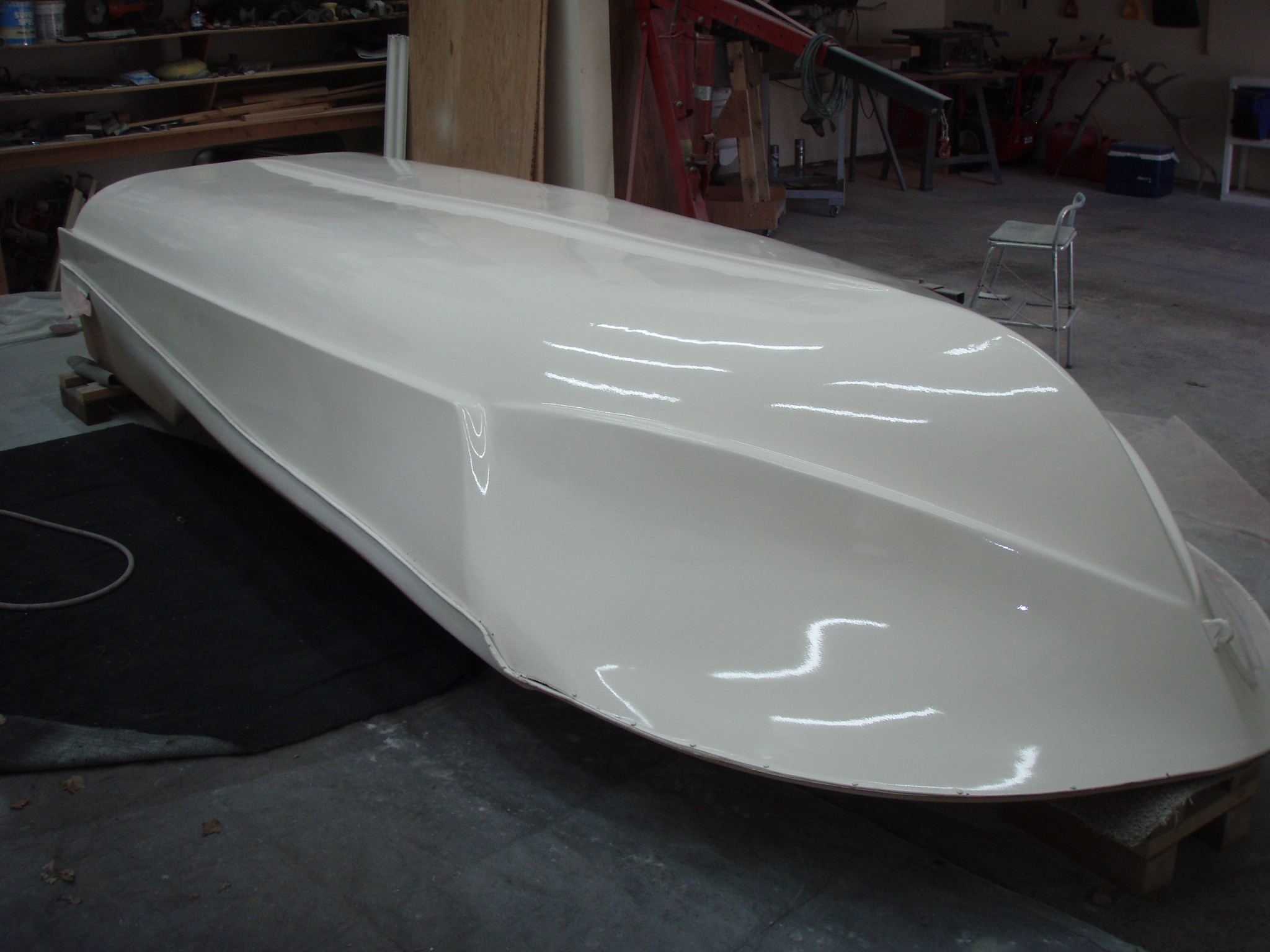

Ok Gracie got flipped Friday. Sanding ...Filling .... Sanding ....Filling .... Sanding... etc etc.
It's now Tuesday and the Primers go on. Duh - what are all these little pin holes about - they just seem to creep up everywhere. They are just like snowflakes - every one is different. Fill sand fill sand fill sand.. Done. More primer. Looking good. My paint should be here tomorrow.
My plan is to get get 4 coats on the hull with wet sanding in between and then a good buffing before turning her over.
Primed....

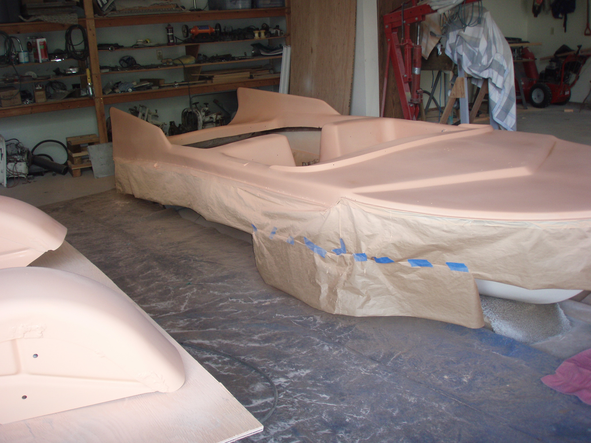

Re:Fiddynine Glass Craft Olympia 14 years 6 months ago #59959
Well - Spray - sand - spray - sand plus two more times...
Hull is done. I'll let her sit for about 5 days before I turn her over and begin the same process with the top (what's the correct terminology for the top?)

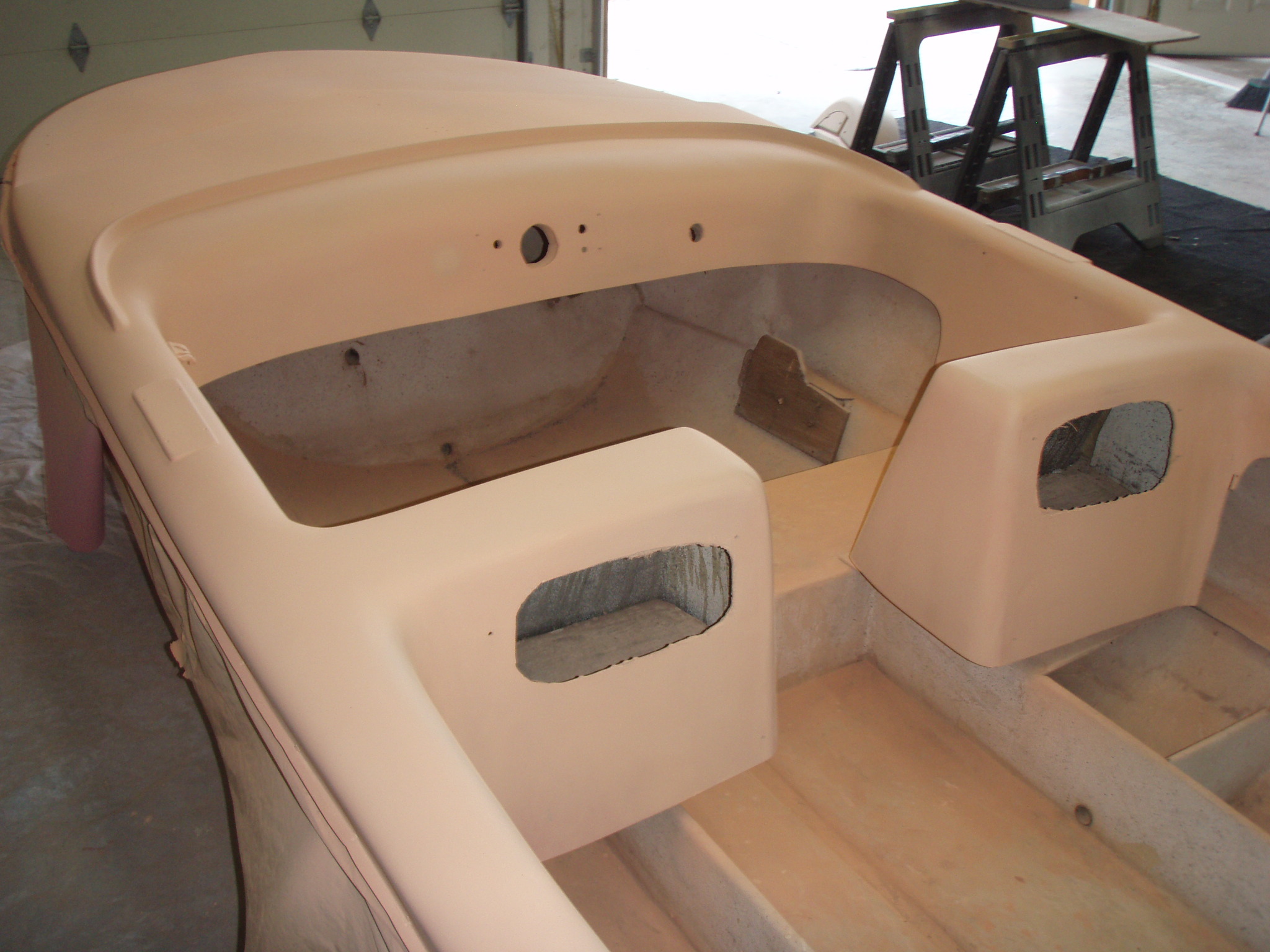

I finished preparing the deck and gave it two coats of primer. Before I gave it the final coat of primer I decided to fit the windshield as I am using the shield from my 59 Citation which is way cooler but had a slightly different curvature on the bottom and different method of mounting. So some grinding of the plexiglass and many on/offs holes drilled etc. - I got it ready so when I go to install I won't be scratching up the beautifully finished deck.
Gave the deck its final primer today.

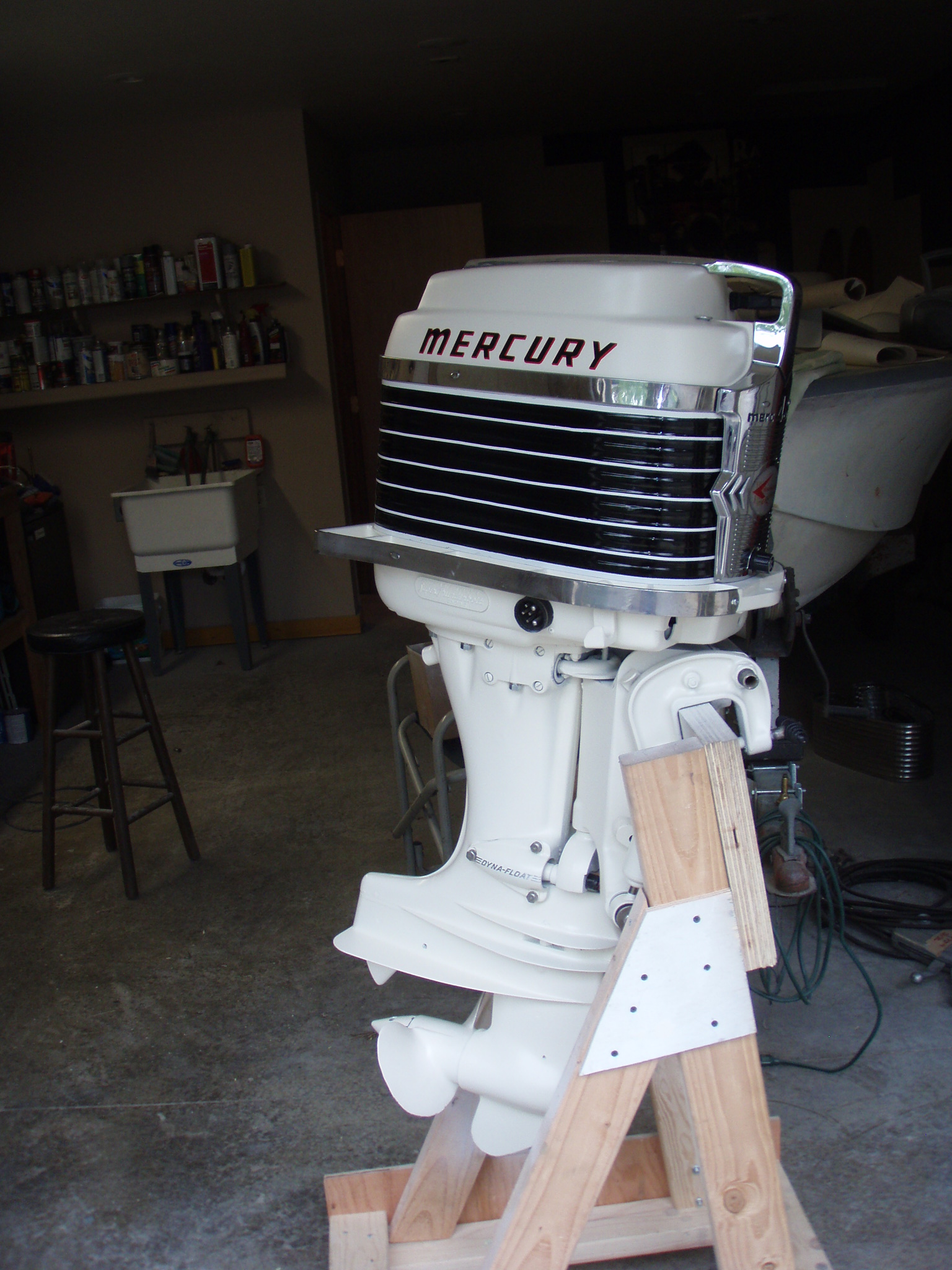

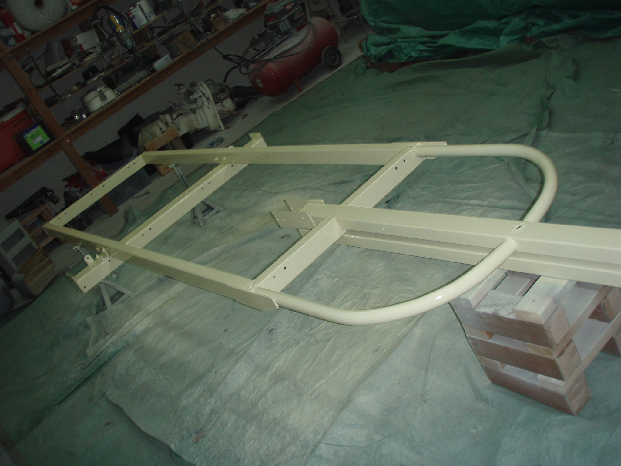

In between sanding and priming I worked on the Sterling Trailer. Disassembled the entire thing. Ground & blasted and primed and painted and reassembled. Hubcaps and fenders still to be painted color of deck.

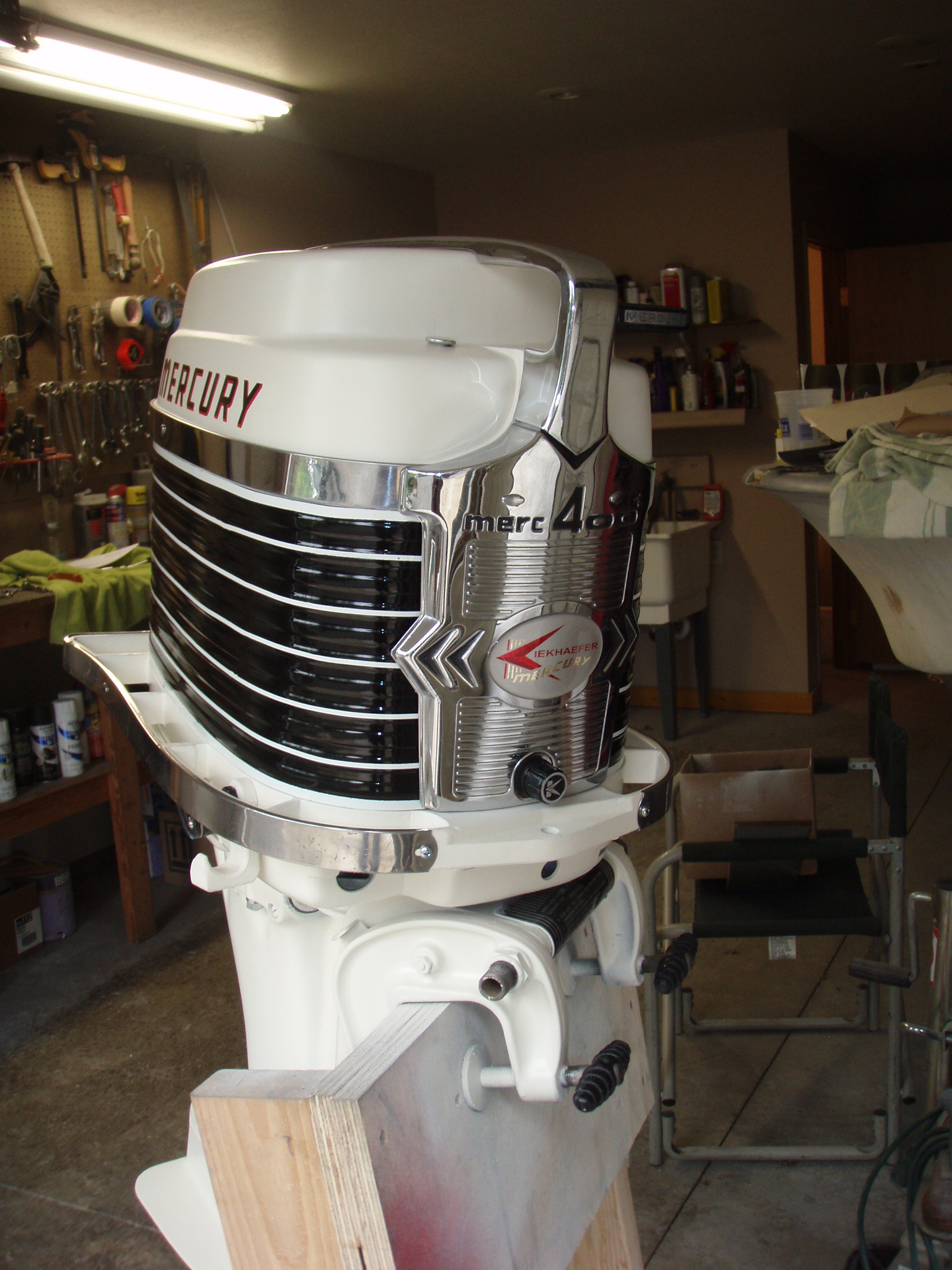

Also got the Merc 400 running beautifully and did the exterior beautification. I think it came out great. Not perfect, but from 10' - Great.

Electrical fenders and hubcaps almost ready to go.

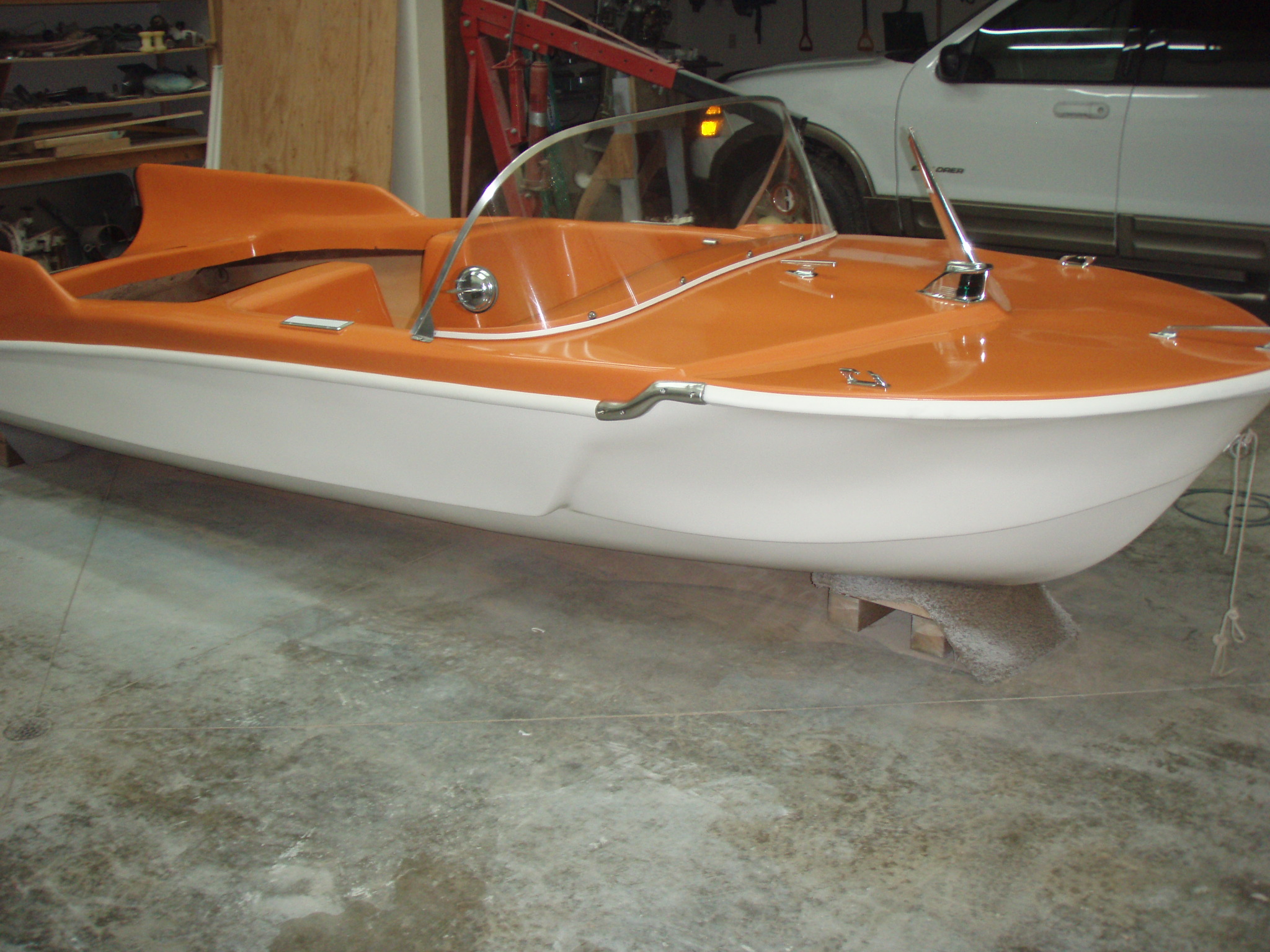

First coat of final color. Woo hoo...

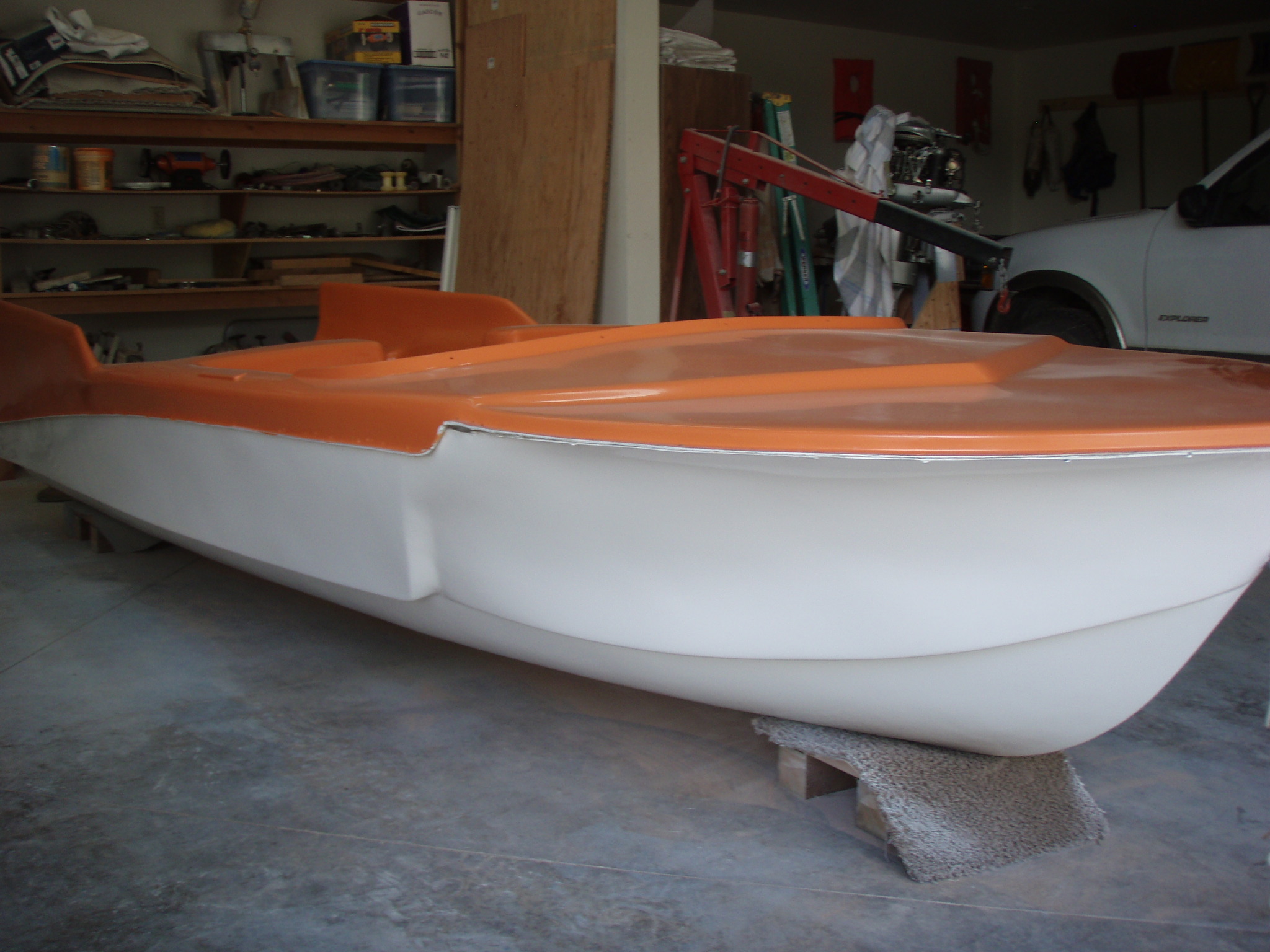

Re:Fiddynine Glass Craft Olympia 14 years 5 months ago #62712
Whew -- Done spraying and now just waiting to buff.
Most all trim pieces are polished and ready to go back on. Windshield is ready and Merc is poised and wanting to be hung. Don't get excited Gracie...

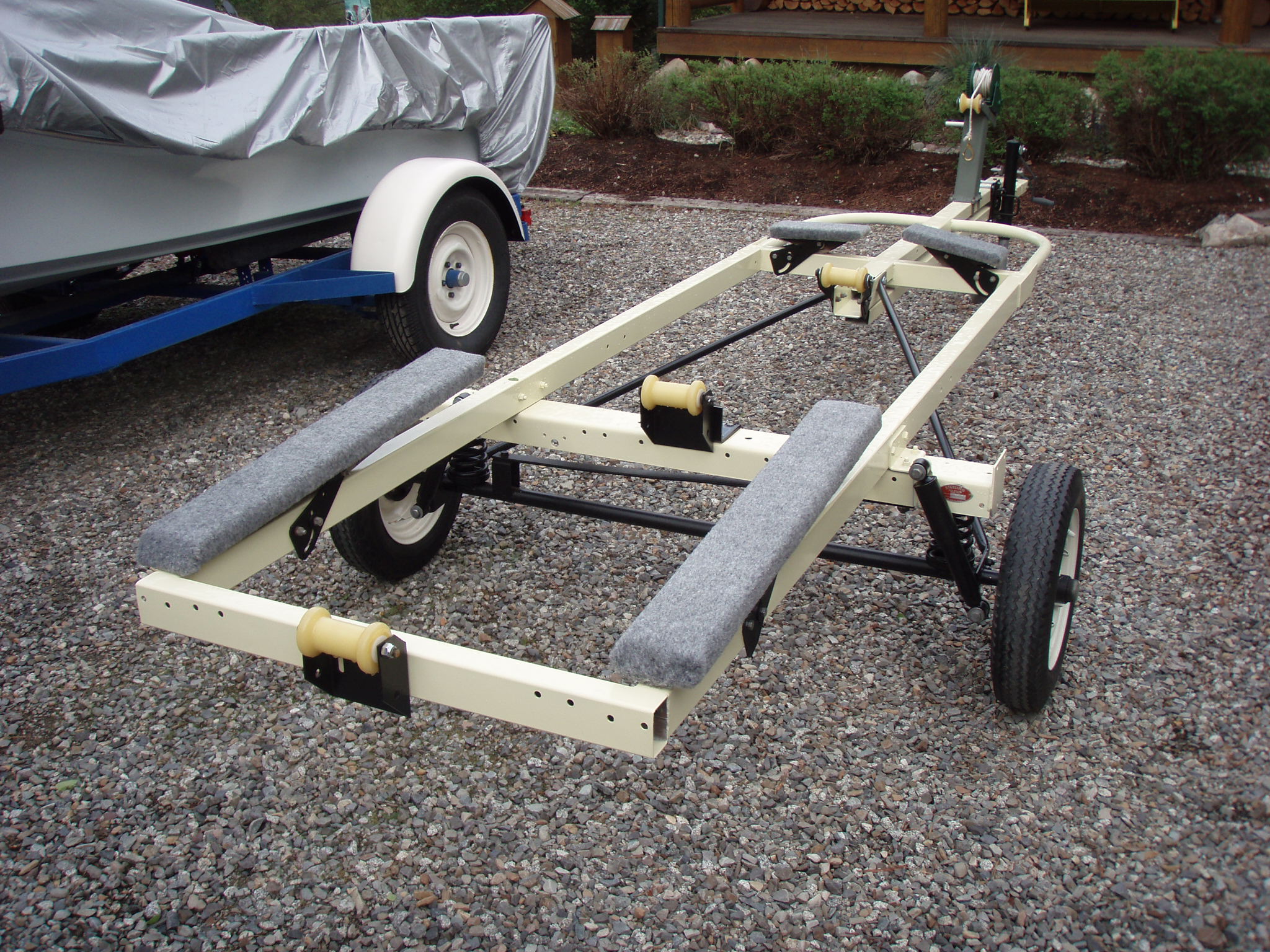

Trailer is ready to go under.
I'm starting some upholstery now. We got snow yesterday and our aluminum boat sunk at the cabin when a big storm came through. Spent the day bringing her up bailing her out and tearing the 25hp Merc apart - drying out and fogging etc. She's fine now.

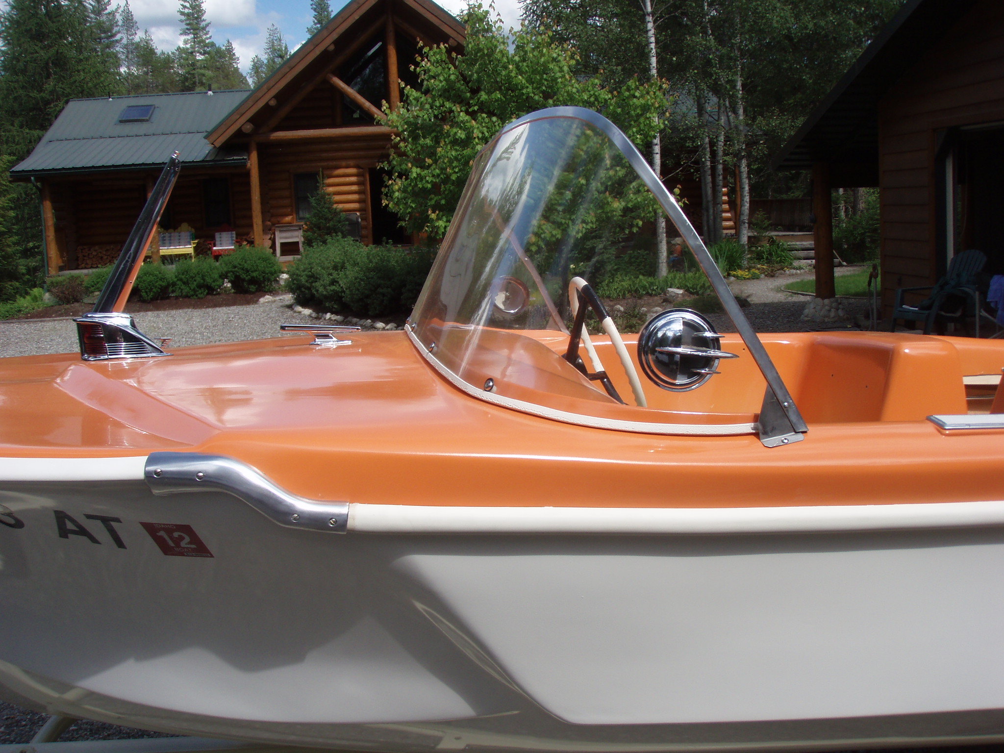

Re:Fiddynine Glass Craft Olympia 14 years 3 months ago #64381

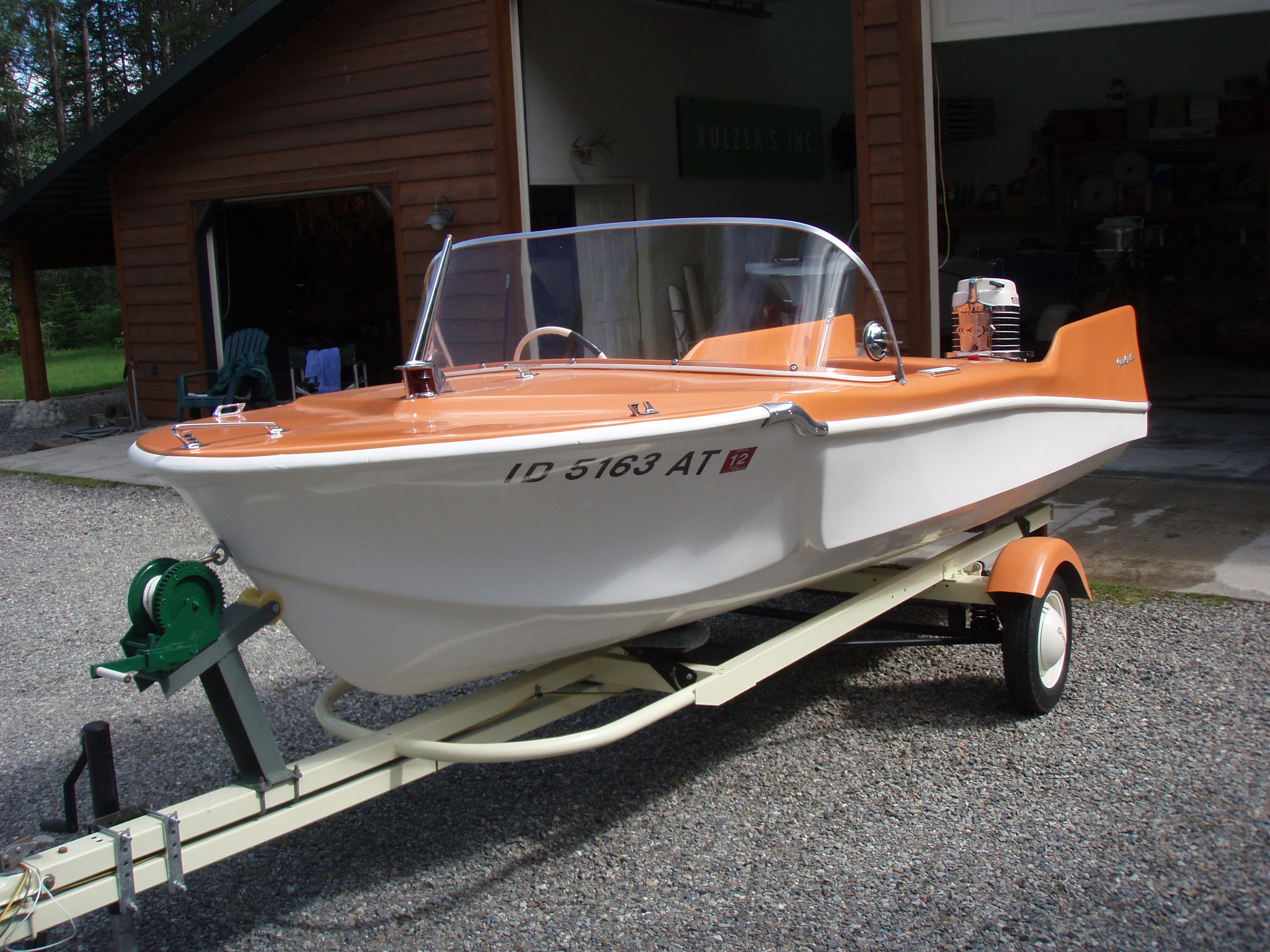

Well we're almost there. Upholstery is measured and on it's way.
I couldn't wait. I had to put Gracie in. She ran like almost like a charm. A little more tweaking on the 400 and she'll be perfect. She handled the water and waves like a trooper. That little watchamacallit on the side threw those waves to the side like nobody's business. \
So the Wacanda and the Glastron SeaFlite Seville Cruiser will also be in the water this week in time for the 2nd Annual Priest Lake Glassic Boat Show.. Lookin for at least 30 boats ... Weather looks like mid 80's and no wind on Sat & Sun -- Thank you God !!!!!!!!!!!! It's gonnabe fun !!!!!
