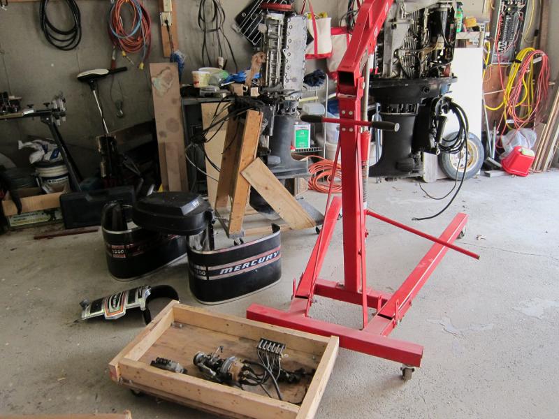

Merc questions are over on the Merc Forum, but I figured I'd post pics as I go at this project right here in the Project forum!
Here's what I started with...

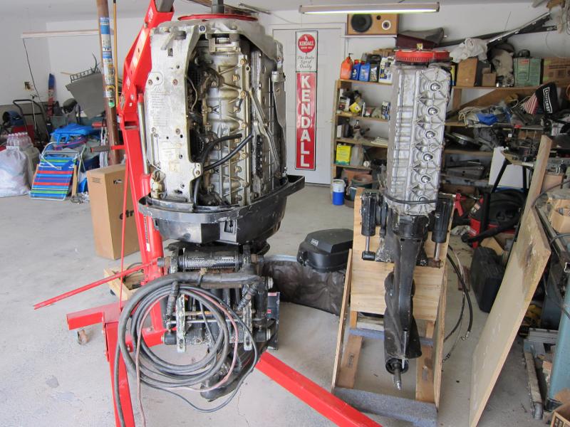

Two motors, both 1350's, one #'s match (parts motor - salty), the one on the engine hoist. The other is an early 1350 powerhead on a later mid & lower unit.
I also got a couple shrouds, a good faceplate and hood; essentially everything I need to make one motor.

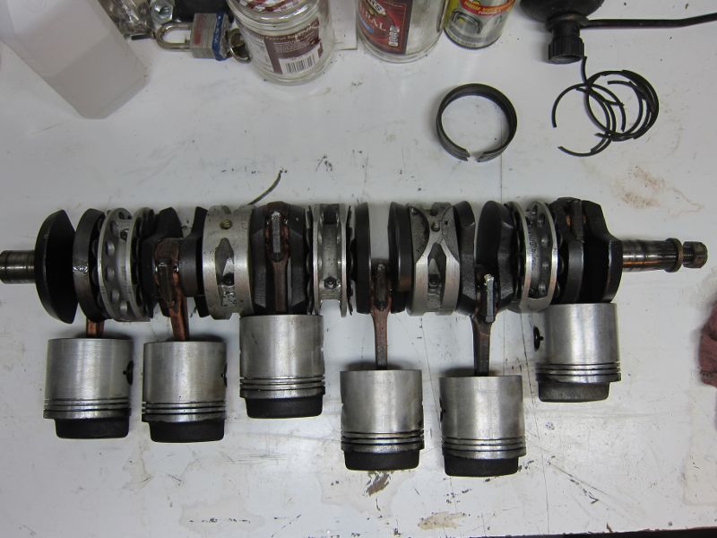

Got the good power head apart a while ago, then this a.m. got the rings off the pistons. No big deal, no special tools or effort required. Saved 12 rings, but have all new anyways. Got the top of one piston de-carboned, will work on the rest as I get a chance. Now I need to do a bit more cleaning, get prepared for power head re-assembly!

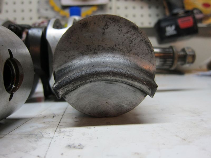

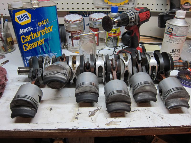

Got home from work a couple hours ago and went at these pistons. They really weren't too bad. Bottom groove on all of them was clean, mid grooves not bad, most of the carbon on the top grooves. Used carb cleaner, parts brush, and aluminum scotchbrite pads on my drill to carefully clean the sides and tops of the pistons. Used a broken ring to clean the grooves. Kept everything moist with carb cleaner while I worked.
