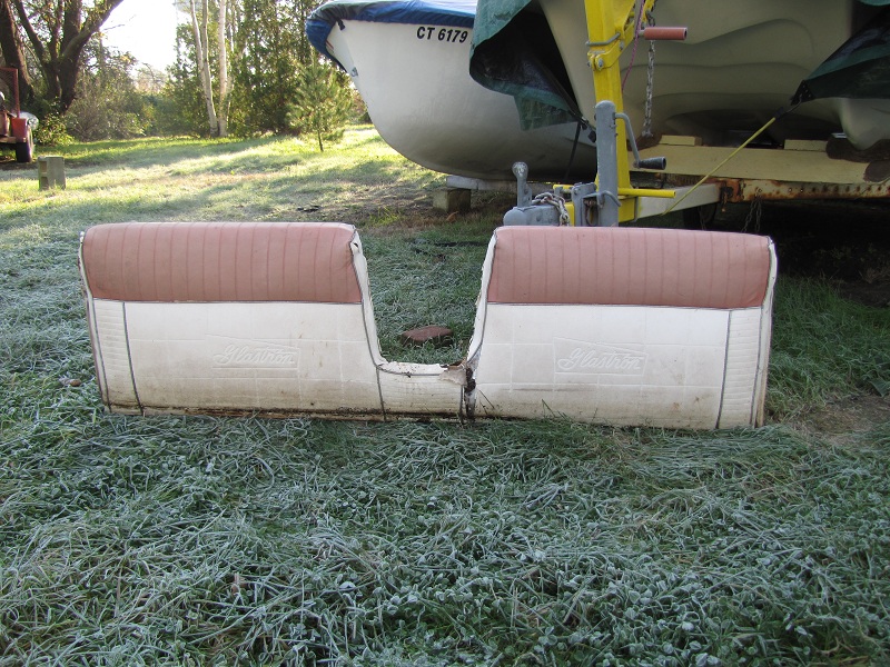

I am finally getting around to starting the thread on this project. Over the next couple of days, I will post pics and bring everyone up to date on the project. Any and all comments, suggestions and "don't do that"s are appreciated
As bought
Interior
Original seat back

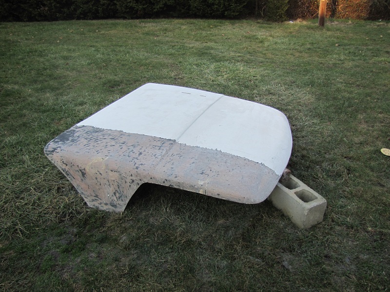

Andrew, the hardtop is what sold me on it. I probably wouldn't have picked it up without it.

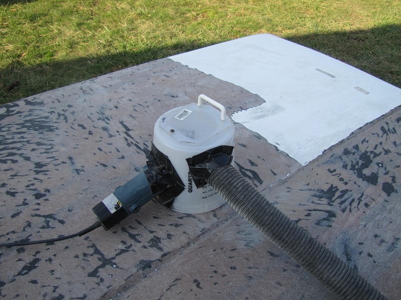

With no heated workshop, not much one can do in the winter in CT. I've had the windshield re-made picked up a lot of the parts I needed. Bought a bunch of NOS stuff to save on re-chroming. I have taken the cover off and am starting on the hardtop. The gelcoat is shot, so I ground that off. There are a couple of holes and one crack that need to be repaired and then the filling and fairing begins. Some of my exploits have been documented in the Main Forum.
After seeing what is going to be involved in filling and fairing, I am going to try nead blasting on the rest of the boat. Hopefully will result in a lot less.
I am using a Vinylester Fairing Compound from LBI Fiberglass for that and their Vinylester Bonding Compound for filling the holes. (LBI is a local company that supplies epoxy and fiberglass materials to the boat building industry. They have pretty much everything. Prices are pretty competative, plus I like to support local businesses)
I've included a few pics.
Grinding partially done
Homemade dust collector
Stripped and sanded
Let the fairing begin.....

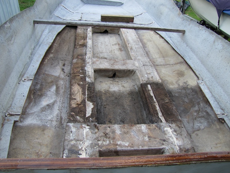

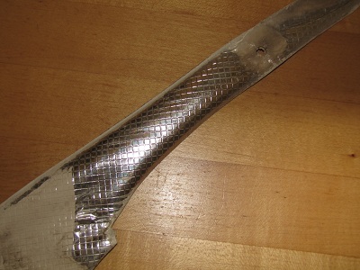

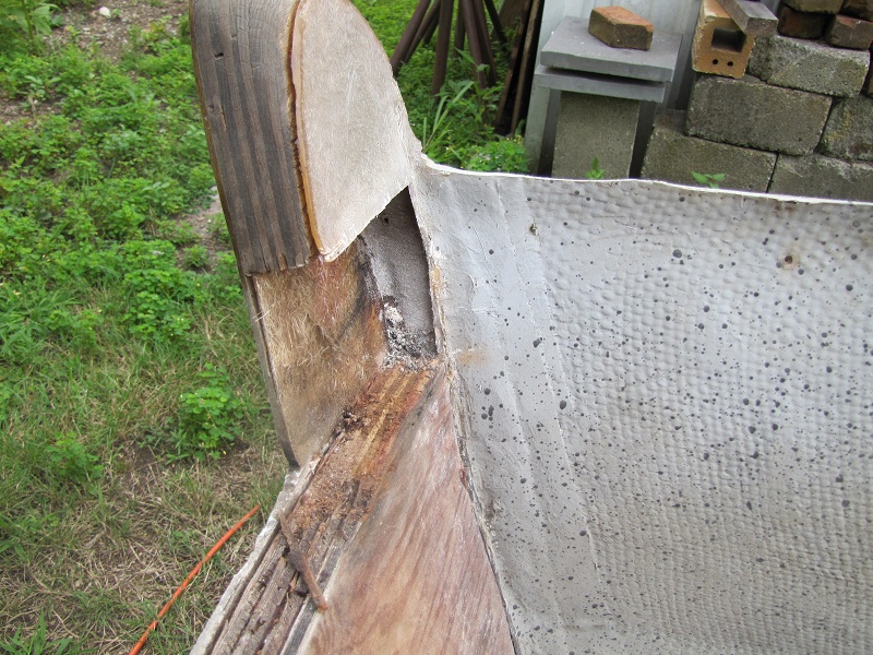

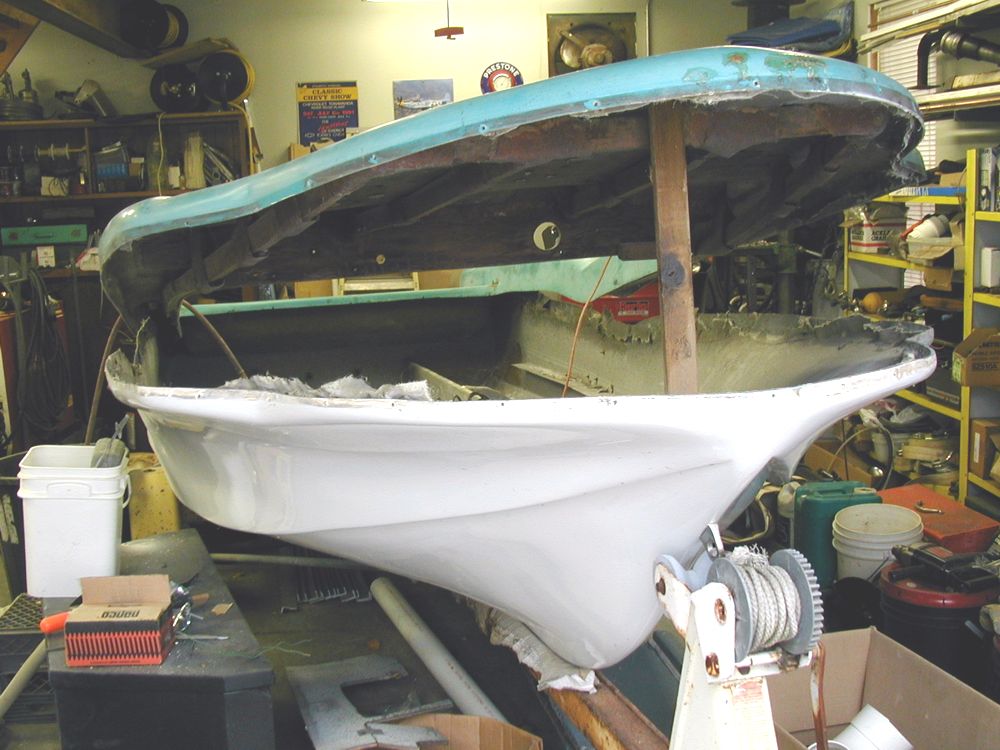

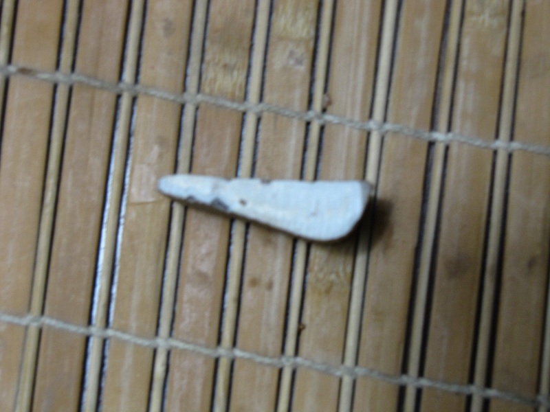

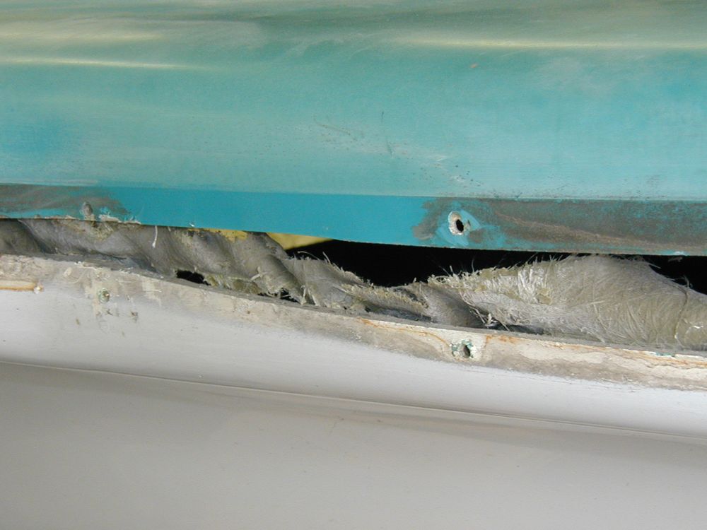

I got the rest of the trim piece off and loosened the deck. It is now ready to lift off when I find 3 other people to help me. A couple of observations:
1. Of all the techniques for removing the screws, cutting them from behind was the best. Drilling the screw heads, although it was quicker, became problematic in centering the drill and getting all of the head. Ended up with bigger holes and more scars on the trim piece.
2. The construction is not exactly top notch. A lot of uneven cuts and the fiberglass shroud was installed very sloppy. Some sections didn't have it and some were poorly placed. Worked to my advantage though. Am I going to need to reinstall something similar?
3. The transom area of the deck was fairly loose, once I removed the drain sleeves. One side had some extra glass, which I cut with the Multimaster.
4. It seems like the transom is a little better that I thought. No severe rot, but a lot of moisture. May have to replace less than I thought. Will know more when deck completely off.
5. There is a fiberglass spacer between the top of the transom and the cap part of the deck. The profile is in the picture. It is solid fiberglass and runs the length of the cap. I will need to reproduce this as the existing is broken in several pieces.
6. It appears that the Mylar sheet that is located in the coves on the sides of the hull was installed before the deck went on. Will install the new stuff that way. The Mylar is a silver sheet embossed with 1/8" squares (which matches the pattern on the aluminum dash trim) that is backed by paper. There is evidence of it being glued around the edges, but not in the cove itself. This may be why there are few if any left with the original Mylar. I will probably glue it to the hull and use wallpaper brushes to smooth it out. BTW, the Mylar with the squares can be bought at hydroponic gardening supply houses.
7. I posted a question on the main Forum about bracing the hull when the deck is off. Any ideas if this is necessary and the best way to go about it?
Transom Spacer Profile
Mylar Pattern

Re:1959 Glastron Seaflite 14 years 7 months ago #58617
Measure from inside of hull to inside of hull before you lift the cap, and use a plastic or grommet washer to protect the hull & screw through an existing rubrail bolt hole into a 2X cut to fit between the 2 sides of the hull. &/or ratchet straps around the hull. There will likely be little deflection of the hull sides when you're putting down the new deck/sole on the stringers. But even just a little would make putting the cap back on. If you need to do stringers too, support from below would probably be better then the strapping/2X. The hull doesn't to be particularly laid up thick w/ the original roving or cloth during construction. But I don't have to replace the stringers, all glass & hollow, not wood wrapped w/ glass.
I found lots of interesting 'lack of quality' in the '60 FireFlite too. Slow progress.... But some lately..
The hardtop is very cool
No big surprise there! I'm AMAZED at what I find in hidden areas on most boats- regardless of age. The older glassics seem to be REALLY bad. Remember there was a lot of competition out there, and they had to crank 'em out fast to make money, so corners WERE cut!
Do yourself a favor- When you've got the boat torn up, just replace the whole thing... Better than having to rip it apart in a few years to repair a spot that rots later. If water/dampness got in there, it should be replaced.
As previously mentioned, take some good measurements and then use straps or something similar to hold the hull in proper shape while you work on it. You may nor may not need to do this- You'll know when you separate the halves how much it 'deflects'. I used some minimal bracing on my Glasspar, just to be on the safe side, and it all fit back together correctly.... Same thing with the g3's I've done. I can't speak for the Lake N Sea, Yet.

Andy, I will probably replace most if not all of the transom. My debate right now is pourable vs wood.
I vote wood all the way... Easier, Cheaper, lighter. People argue that it won't last- BUT your boat made it 50 years, most of which it was severely neglected, with a wood transom. Even if you 'only' get 50 more out of the next, I think you're good. But, odds are it'll last forever- since I have a feeling that this boat will enjoy a MUCH higher standard of living from now on!
-Andrew
Re:1959 Glastron Seaflite 14 years 7 months ago #58703
  • thetudor
  • thetudor's Avatar Topic Author
  • Posts: 1206
  • Karma: 33
Andrew, your point is well taken. I have 2 issues with plywood. The first is that the end grains tend to absorb water rather quickly. I lost a replacement transom in a plywood runabout for exactly that reason. The second is that I have an aversion to cutting perfectly good fiberglass and the layers on both the inside and outside are in good shape. A repair never has the integrity of the original.
COnsidering the boat was last registered in 1969 in LA and somehow made it to Danbury, CT by 2010, I won't take much for it to have a higher standard of living.

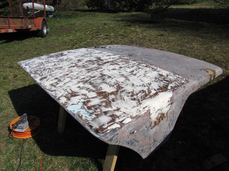

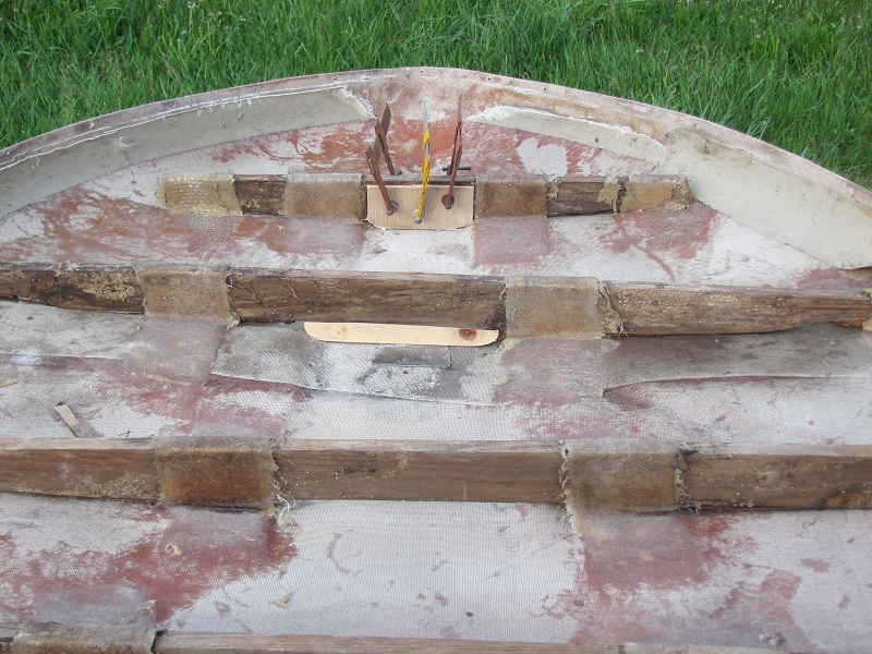

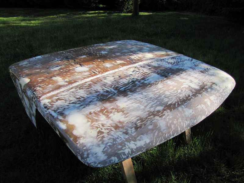

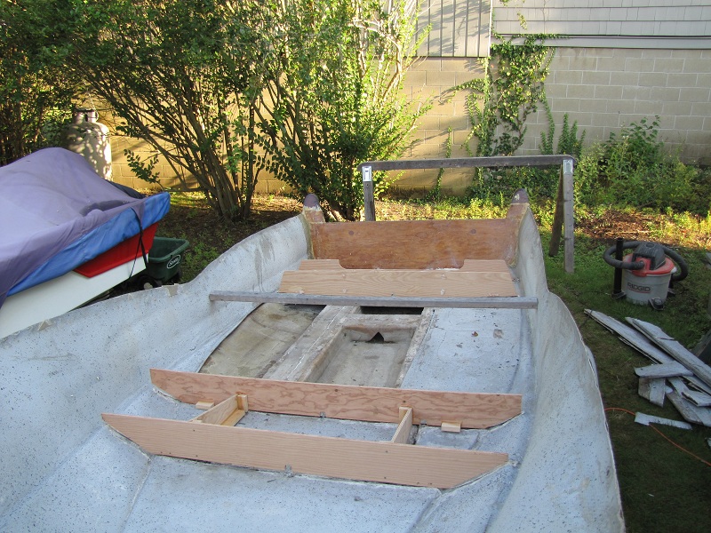

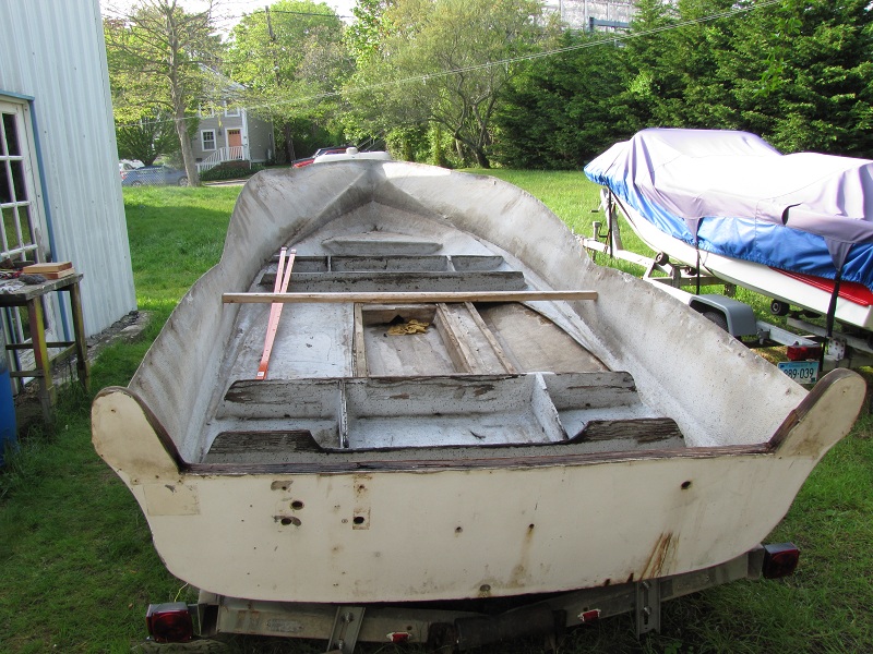

After not being able to get a lot done on this for a while, I am back. The deck is off the hull and upside down on my new cart. I am reinforcing the foredeck stringers, removing the rest of the poorly installed flap for he hull/deck screws and replacing the wood strip strip around the cockpit. After that, it is on to bead blasting to remove the gelcoat.
The hull awaits floor and transom replacement (with plywood - I made my decision)
The fairing on teh hardtop continues

Re:1959 Glastron Seaflite 14 years 5 months ago #61556
hi todd i have a suggestion for you on the hard top,the easist way to get it looking like glass that i have found is using the west marine system,2 part,with the pumps.
mix a good bit,then roll it on with a very smooth foam roller,but be quick,it will probably eat the roller,the thing to do is put it on fast in a cool area,spread it out with the roller.
dont over do it,it will find its own level,just do it a thin coat at a time,you will get runs,especially down the sides,but they will sand off,i hope this helps,john
Re:1959 Glastron Seaflite 14 years 5 months ago #61561
  • thetudor
  • Posts: 1206
  • Karma: 33

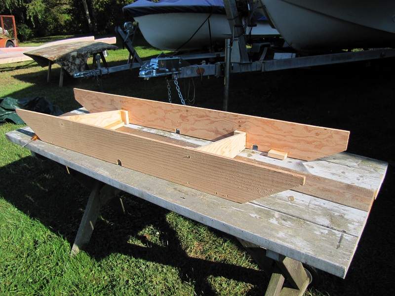

John, I actually did something similar. I put a thin coat of fiberglass resin on the top. This sealed up some minor pits and it has also allowed me to use a lot less fairing compound as compared to the rough glass. With the exception of one side, it is about 85% done.

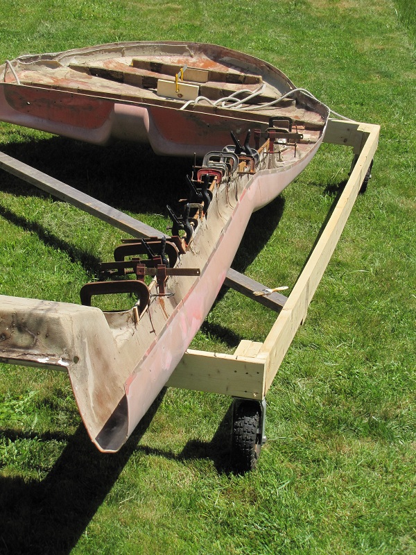

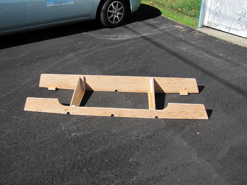

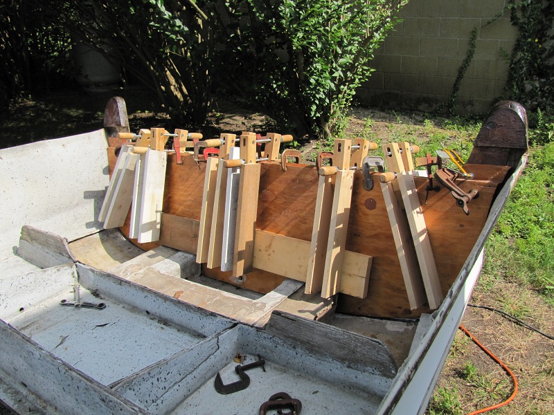

Here is a pic of the new plywood I installed along the cockpit side. This picture contains all 23 clamps that I own.

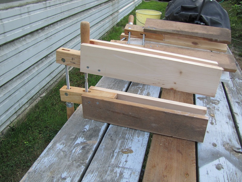

Re:1959 Glastron Seaflite 14 years 5 months ago #61650
Looks like you stole my clamp collection. Either that or we come from like mind beginnings. I might have two that look the same.
Cal

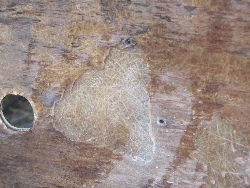

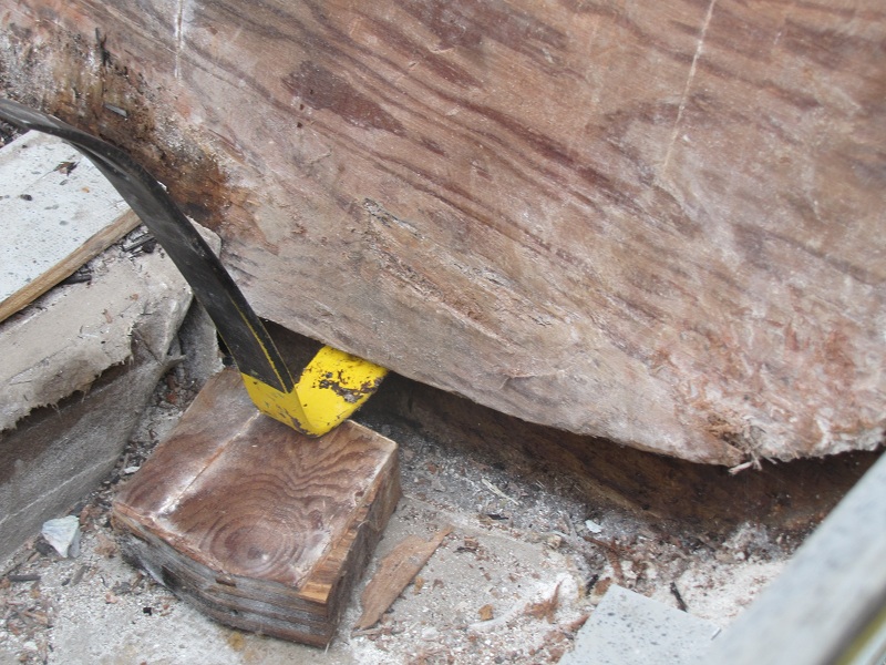

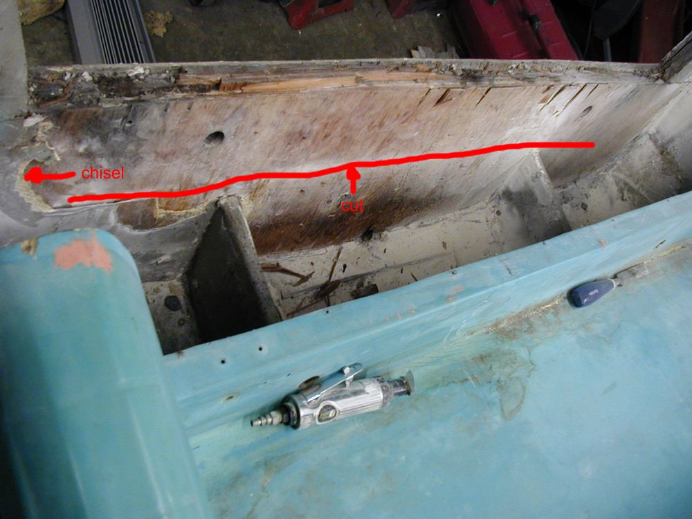

After not working on this for a while (due to too many other distractions), I'm back. Removed the transom today, in almost 1 piece. That was mostly due to the rot on the plywood being around the penetrations and a little on the edges only. I had to cut out the piece that goes up from the main transom half way up the fin on both sides. The plywood at the very top is a separate piece and is in good shape. All the cuts were made with a Multimaster and about the only other tool was a short pry bar. It was actually easier that I thought it would be. The marine plywood for the new transom is in the garage and I will start on that this weekend.
A couple of observations: There was a 3/4" gap between the bottom of the plywood and the hull. Also roughly a 1/2" gap between the sides of the wood and the sides of the hull. There was no filler in these spaces. That will obviously be rectified on the new one.
Also, the plywood was standard exterior grade plywood with at least 1 A side (the piece consisted of two 3/4" pieces of plywood glued together). A lot of gaps. The plywood at the top of the fins is the same, but I will fill and epoxy that for preservation. The new plywood is 3/4" marine grade fir.
There were a lot of air pockets in the fiberglass where is met the plywood (see pic). These will be filled before the new wood goes in.

The new transom is now installed. Two pieces of 3/4" marine plywood epoxied together, shaped and coated with epoxy. Two layers everywhere and 3 on the edge grain on the top. Epoxied to the transom glass and the gaps partially filled. Now to finish the filling and fiberglass to the hull.
And a detail of the clamps I made to do it.

Re:1959 Glastron Seaflite 14 years 2 months ago #68402
Whoo Hoo, another milestone passed. Should be strong enough to hang at least a 400# motor on.
Re:1959 Glastron Seaflite 14 years 2 months ago #68449
Outstanding Todd, better than original!!!!!!!!!!!!!!!!!
Re:1959 Glastron Seaflite 14 years 2 months ago #68453
The agony comes when you have to drill the drain hole in your new transom. :woohoo:
Re:1959 Glastron Seaflite 14 years 2 months ago #68468
  • thetudor
  • Posts: 1206
  • Karma: 33
Thanks guys. It already feels stronger than the the original and I don't have the 3/4" gap below the bottom of the plywood.
I had actually marked the holes for the bottom drain and the two motor well drains previously. Cut holes with 1-1/2" hole saw and filled the with epoxy. I put the transom in place and drilled out the bottom drain the a 1" hole saw right through the epoxy, so that one is done. I put a bolt through that with fender washers and used that to help clamp the transom. I haven't drilled the holes for the splash well drains yet and I probably wont until I put the deck back on. (See the dark circles near the top of the transom.)
When the rain stops, I'll finish the filling and start the fiberglass.

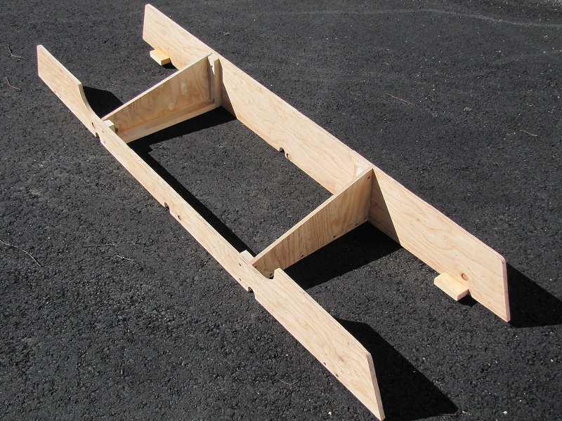

Today I built a new rear seat support. The original system consisted of 4 pieces of 1/2" plywood on edge supported by some fiberglass. The pieces are not connected together. I thought this was not a very good system and decided to build one better.
I used 1/2" ACX plywood and connected with pieces of 1x pine. I also put a piece of 1x at the base of the cross pieces and one piece near each of the corners. This will allow me to mechanically fasten (screw) the frame on to the new floor. I will probably run a piece of fiberglass up the from and back of the frame to give a little more stability and to blend the seat to the floor.
I also cut scuppers in the bottom of the frame for drainage. I opted for scuppers instead of driller holes to prevent water from retaining in the space. I also added two on the outside of the lateral supports to drain those pockets (none on the original)
All of the joints are glued and screwed. All knots and openings will be filled and sanded. The entire assembly will be covered in epoxy with added layers at the edges.
This should be a lot stronger and more stable, but still keep the look of the original.
existing conditions
New seat frame

Re:1959 Glastron Seaflite 14 years 1 month ago #69623
Excellent, better that the original. Great design.
Re:1959 Glastron Seaflite 14 years 1 month ago #69629
If they did that kind of work at the factory you would be paying twice as much when it was new. Shortcut were what made money. Slap some boards together with a little glass mat and hide it under the seats...voila no one will know.
Great improvement and no worries about it coming apart when you hit some rough water.
Great work, keep it coming.
Cal

In spite of the damp weather this weekend (the only sun was late this afternoon), I did manage to get a few things done. I got the new front seat frame built. Once that was done, I marked on the hull where the seats are located and then demoed them in order to be able to start removing the floor. Unfortunately, I broke the round saw blade on my Multimaster early on, so I could only do some rough cutting on the floor, but made good progress with a Sawzall. (no hull damage, fortunately)
The seat supports were built little better than the transom. The 1/2" plywood for the back seat was ended about 1/2" up from the floor and was suspended by the fiberglass. The front seat was a little better, but the rot was such that it was tough to tell what was going on. I had previously said that the supporting boards were not attached together. That was not true, they were nailed together (into the edge of 1/2" plywood) with steel nails. They had rusted down to the size of pencil leads.
The floor was constructed in 3 pieces (transversely); a center piece 2' wide and pieces on either side shaped to the hull. Not sure at this point if the used 8 ft pieces and joined them together of perhaps 12 ft pieces. Will find out when the rest of it is removed.
Laying the reinforcing fiberglass around the stringers looks a little haphazard, but it has remained together for 53 years so it can't be all bad.
Hopefully next week will be dry enough to finished the glass work on the transom, epoxy the floor supports and remove the rest of the floor.
New front seat support
Removed both seat supports and set the new ones on the old floor
Rough floor cut out. The dark areas are wet and show the new cut. The dry areas had been opened by a previous owner.
Close up of the construction of one of the cross stringers. Not exactly consistent.
