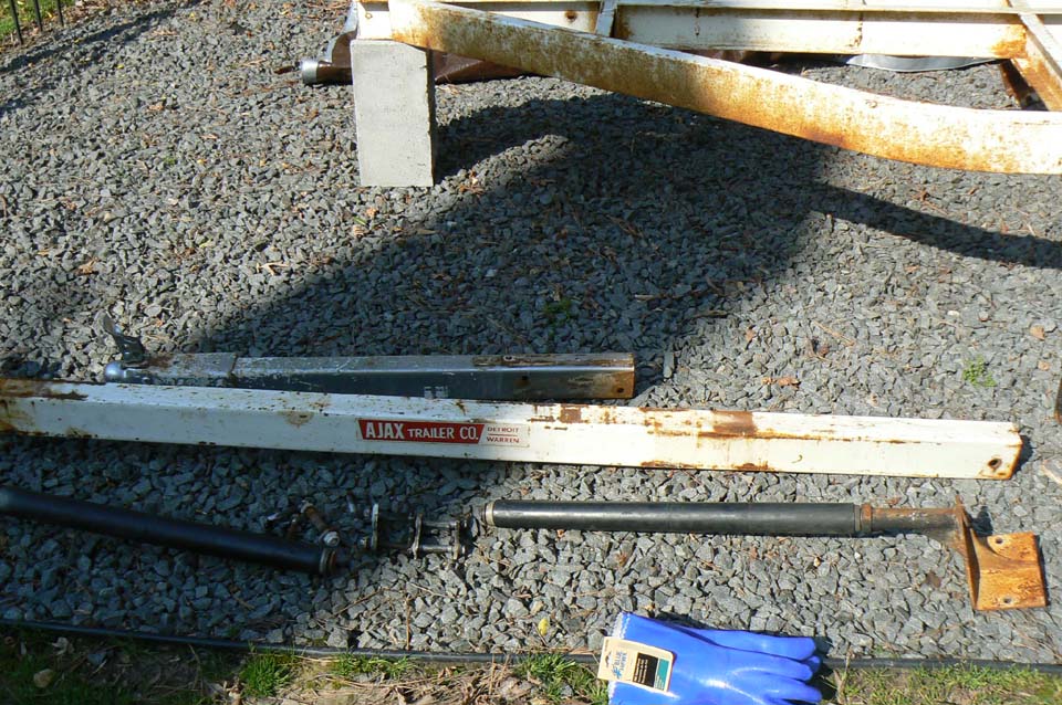

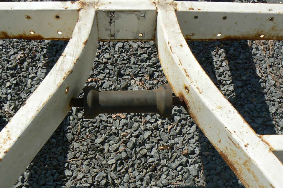

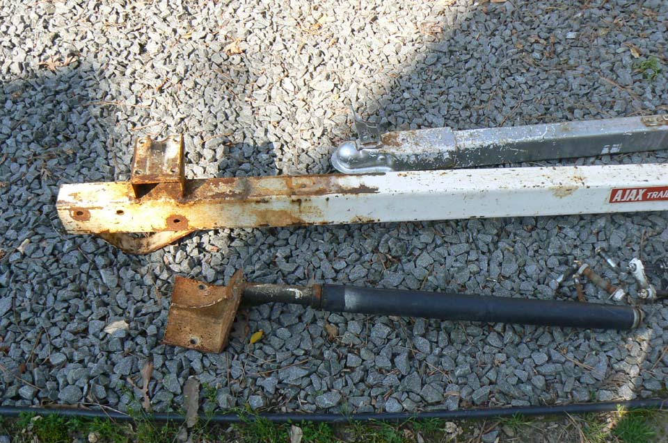

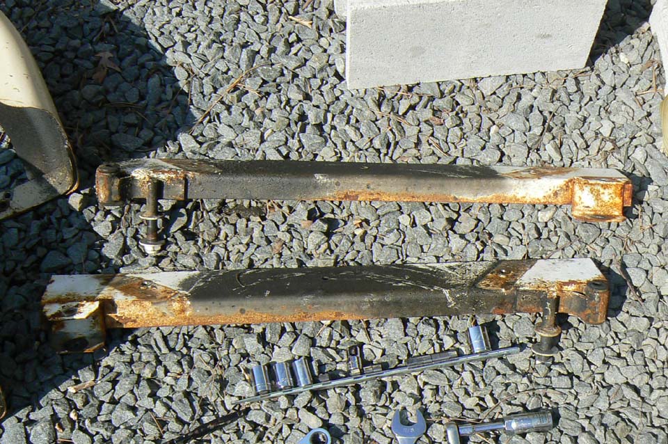

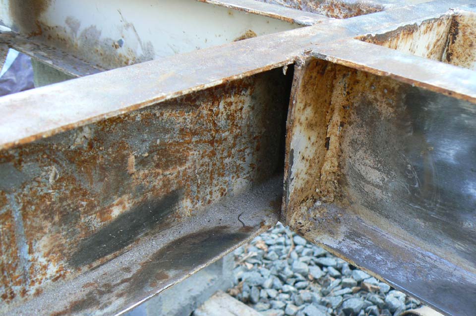

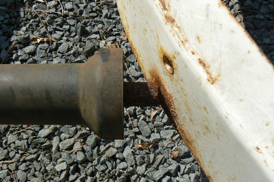

Ok back at it yesterday, here are some update pics.
Here's the rear roller
They all look like this so have to be replaced.
Here's the front tongue, main tube and guides removed.

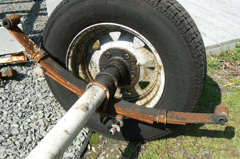

Axle removed with the wheels on. You can see why the bearings and seals have to be replaced.
Here's the axle mounts for the trailer. Kind of interesting they can be moved forward and backward as necessary, depending on how much weight you'd like on the tongue, more or less. Very generic/versatile trailer.
They're actually held on by the fender bolts. I may mount them with seperate bolts as I plan on moving the fenders back a little to be over the wheels more. Also another view of why the wheel bearings and seals need to be replaced. Nice paint job with the grease hugh?

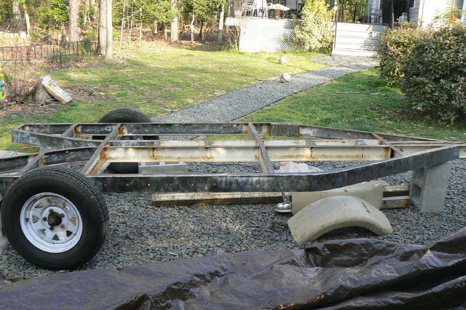

Ok here it is stripped, flipped and ready for blasting.
On a side note, got that 50lb portable media bucket from Harbor Freight real cheap. One of the write ups said he used play sand in it and it worked great, so I got one. Not to self, make sure the play sand is real damn dry before trying to use it!!!!!!!! It does work if the sand is dry but the sand I got, even though inside a barn, was still too damp, so I was trying to spread it on a tarp yesterday in the sun to dry it out. YEeah I know, NOW THAT'S CHEAP! WEll at $3.50 a 50lb bag why not try it right? :woohoo:
Well back to sand drying, bug spraying, lawnmowing etc. I may use some of that stripper I have left over from doing the inside of the boat. Need to use it up anyway and I can just blast where the rust is, we'll see

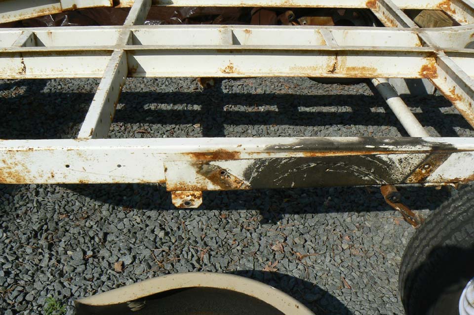

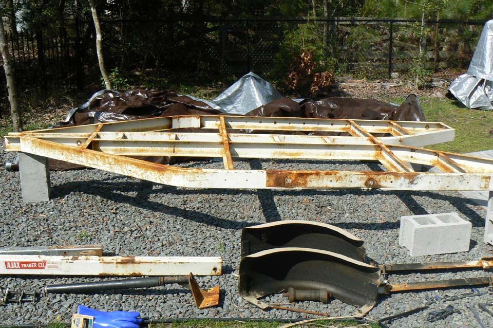

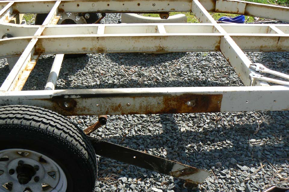

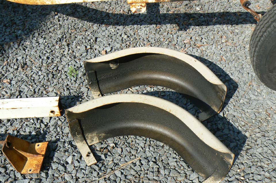

Here are pics of what got done today. Left work early and started at about 1:30pm. Stopped at 5:30pm
Tha axle isn't attached I'm just storing it under the trailer till I get to it. Keeps it all in ome place under the tarp that way.

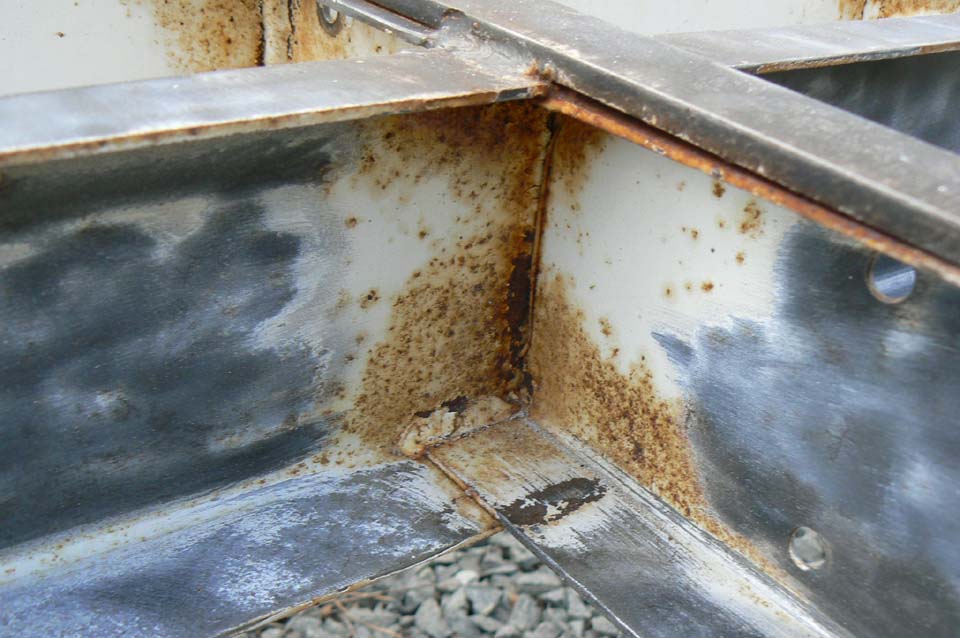

Here are the problem areas where I'm probably going to have to blast. Shouldn't be too bad since it's small areas.
With it being a C frame it's hard to get at all the corners with the wheel. WEll I have tomorrow off, the wife does too so I think we're going to Annapolis so probably no trailer work. :( It's suppose to be crappy now all weekend, figures! Oh well maybe I can swing by HArbor Freight on the way up or back and get a couple more wheels for cheaper. ;)

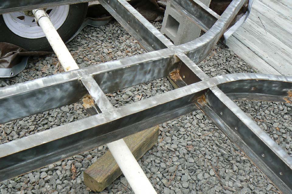

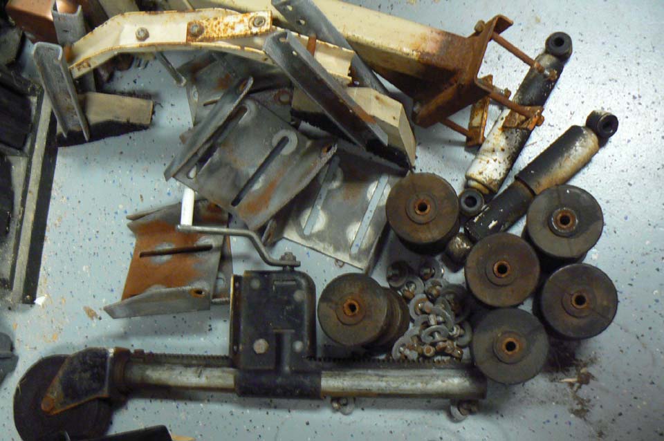

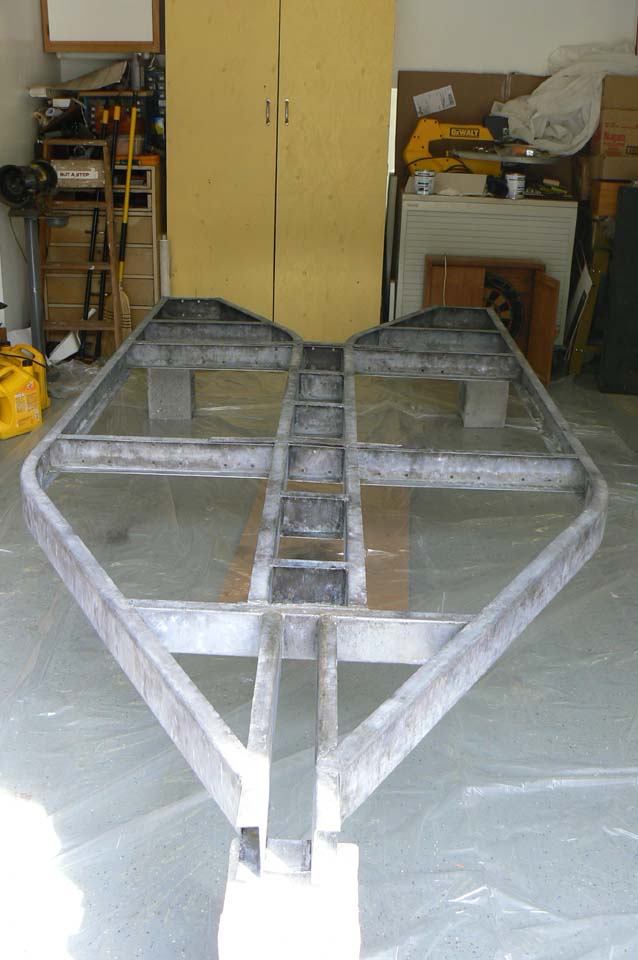

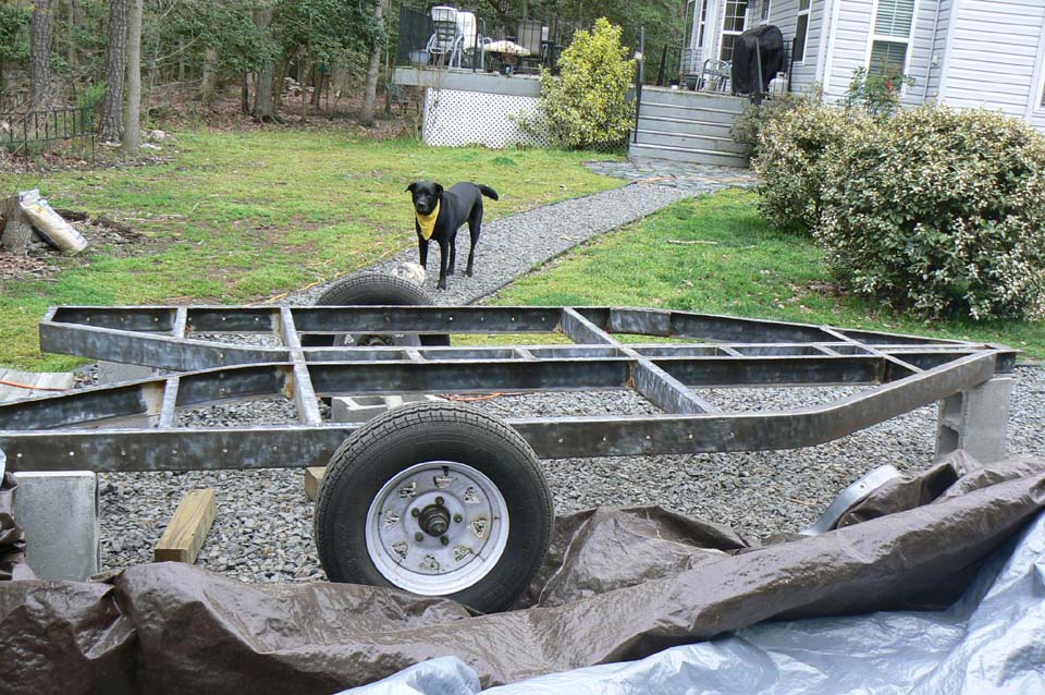

Well I was able to work around the rain this weekend and get quite a but more done.
Here's the main section completely wire wheeled.
Rightside
Leftside with helper.
All I have to do is the spot blasting and the main will be ready for POR 15.
Here's what I got stripped while it was raining. Used the wire wheel on my grinder.
Also managed to get the rollers off their brackets so I can sand/wire wheel the brackets.
I know that last pic looks like organized chaos but I'm running out of room in the garage. I have to re-work the woodworking side and build cabinets to get stuff up higerh so I can rearrange and make it more usable.
I also have to start looking for the new rollers. They seem a little out of the ordinary from what I've been seeing on the web. Have to look a little harder I guess.

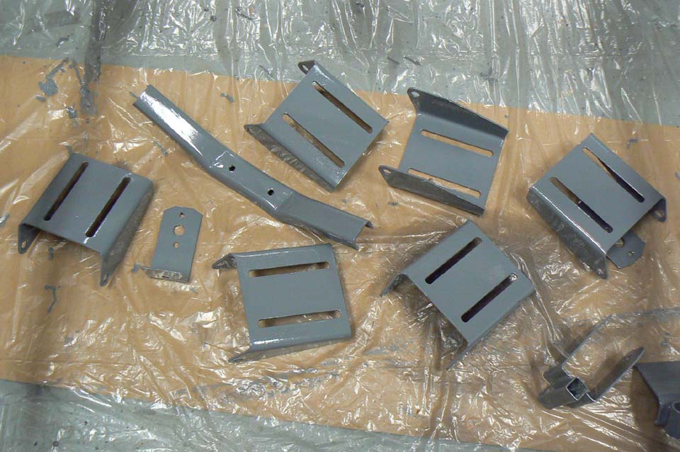

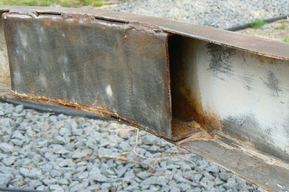

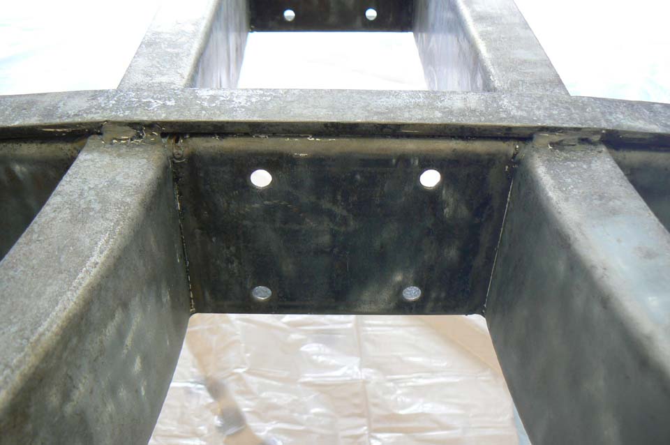

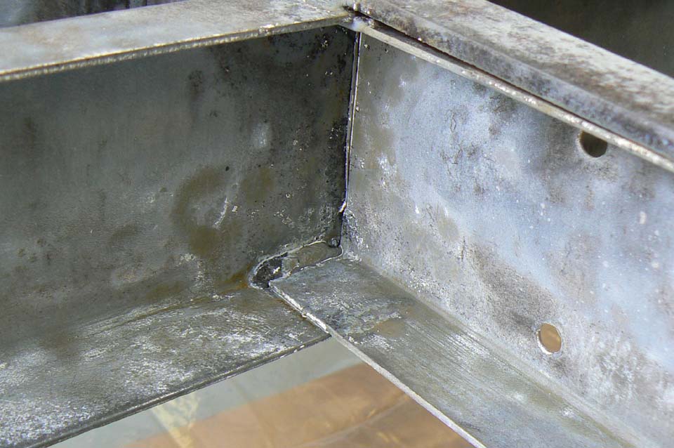

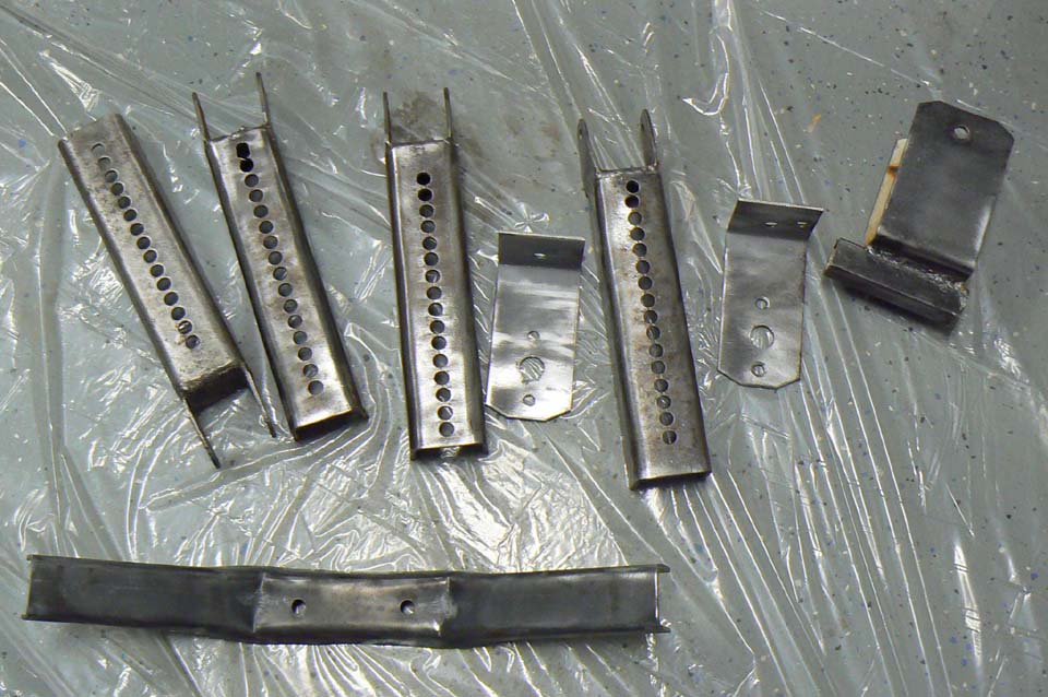

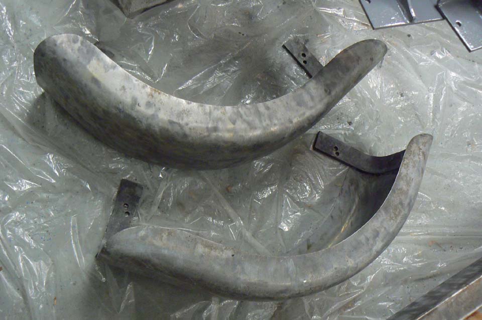

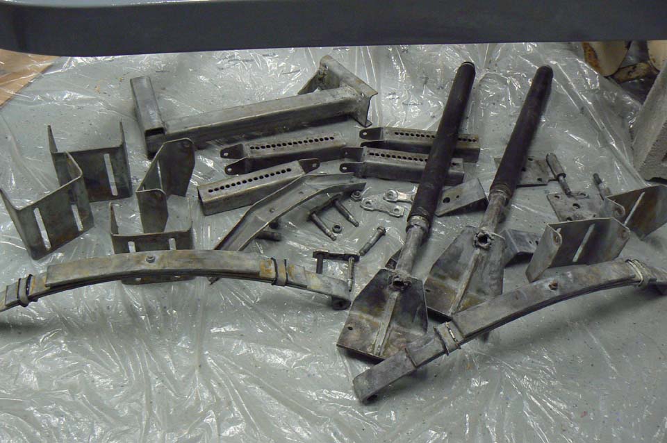

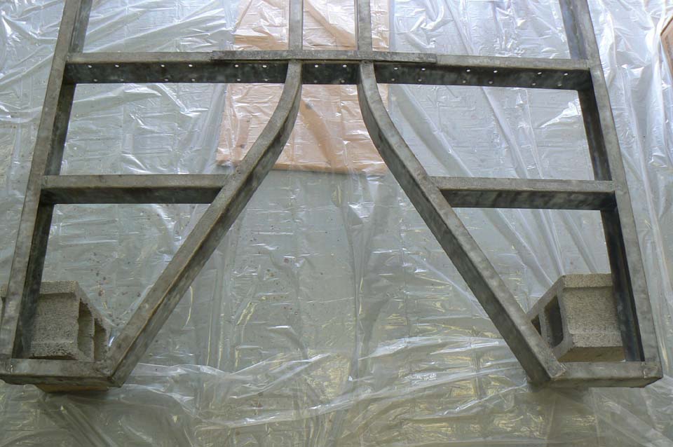

Yeah I know, blapshemy!!!!! Ok this should help some. I know it doesn't look like much but that spot blasting was taking forever.
Here it is blasted and metal preped. Should be able to start first coat of POR 15 tomorrow morning.
Sorry this one is a little washed out from the sun behind me.
If you look close you can see some of the zinc left behind by the metal prep. Cool stuff, just squirt it on, keep wet for 10-15 minutes and rinse off, dry and done. Have to make sure ti's "BONE DRY" before you paint it though, per manufacturer.

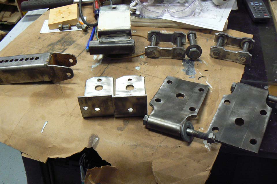

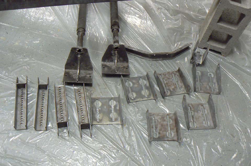

Here's the brackets pretty much done, with blasting included.
Ok, I lied the inside of the tilt bar bracket needs to be stripped yet.
I did get most of the main bar wired wheeled also but have to blast around the bracket for the jack. That was in the shed and didn't get a pic of it. Probably tomorrow.

Well got hit with the "Honey Do" bomb again today. Yesterday started with washing her crossover my truck and change the oil in her cross over! Lucky I got done what I did yesterday. Today started with in house stuff, then get the lawn watered,(hasn't rained in over a month so far), do a commissary run (grocery store on base), then my stuff. The plan was to put a coat of POR 15 on, do commissary run, then put on secodn coat, first should be dry enough. Welllllllll, after getting the quart out of the first box that was shipped, I opened the can and what do I see, well nothing! It suppose to be Gray but it's CLEAR!!!! ARRRGGGHH. Opened the other can that came with the metal prep and it was right but since I haven't worked with this stuff before I dodn't know how far it goes so I didn't want to get the first coat on only to find I ned the second quart for other coat. I have to call a certain "Global" place and find out why the shipping slip says Gray and the can is Clear. Needless to say I did all the honey do crap then commensed blasting again.
Here's what I've gotten done.
The only thing left is finish baslting the main bar that can't be wheeled, the winch stand and the axle. The axle and winch stand should be fine with the wire wheel. Oh well, always somthing!!!

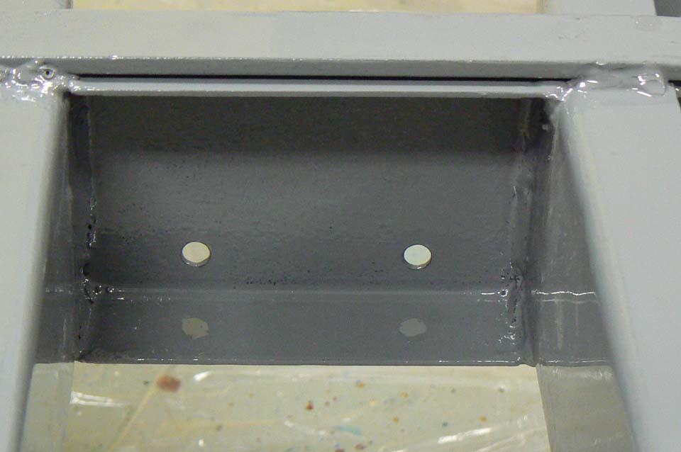

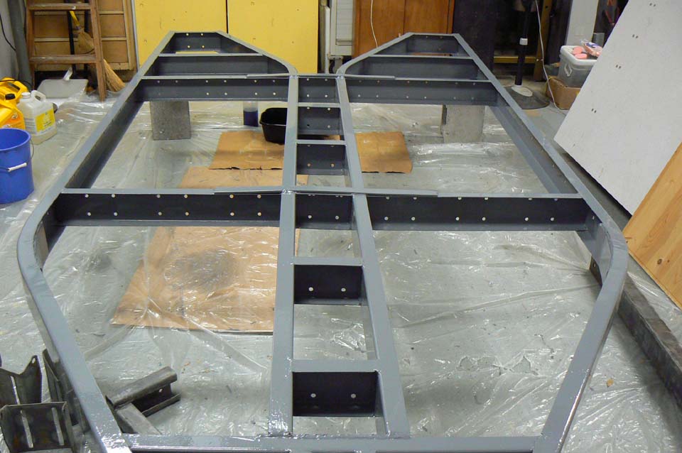

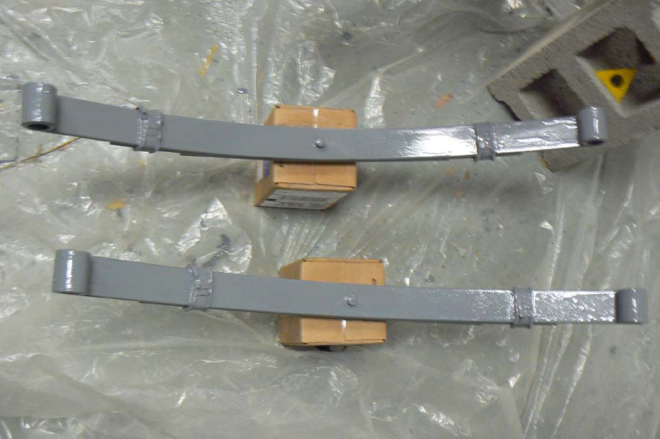

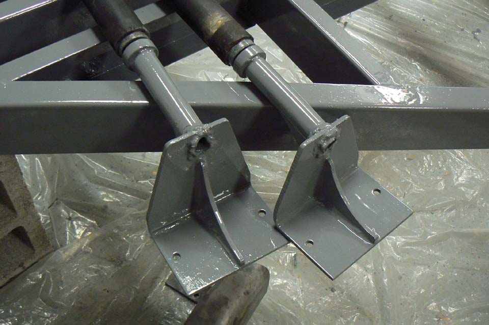

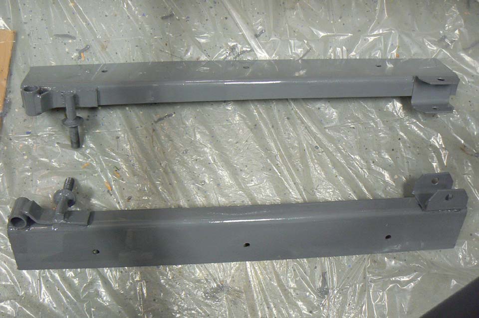

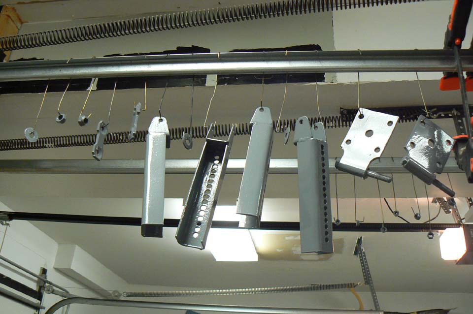

Well I liked to sya I'm alot further along than I am but lost of stuff going on during the week and the weekend wasn't any better. The only good day was Saturday, it rained that evening and all day Sunday. I did get two coats of POR 15 on the main part of the trailer though.
Here's a close up of some corners of the bottom and the support bar. Spreads pretty good I think.
Just a note to anyone wanting to use this stuff. It's great, very hard but not as thick as you'd think. It does gone on thin and will run so make sure ru run a brush along any edges or you'll get drips. Learned the hard way. After turning it over had a bunch that I had to take an exacto knife too. Also learned I should have done it in stages. Tried doing the whole thing at once. What a nightmare! Only do that if you have a rotissere to put it on. Decided on the second coat to let it dry and just do the sanding before the second coat. You can recoat before it dries but there was just too much to do so, leaning from the first coat, I flipped it coated all I could ofr the second and finished on Sunday for the parts I couldn't get on Saturday.
I did manage to get these all prepped for their POR 15 coats.
I know they probably don't look much different than the last pics of them but actually, they're done with blasting and have had their Metal Prep coating put on and ready to be painted. Not sure when I can get to those, another screwy week this week, working nights tonight and possibly tomorrow. I may not paint until Saturday so I can two coat all the pieces while the first coat is still tacky so to speak. Second coat sticks better that way.
Also going salvage the rollers, looking at new ones and they really don't look any different the the ones I have. They just need cleaning and the center metal buchings replaced. I've knocked the buchings out and I'm going to replace them with PVC. I have a lathe that I can trim down the outside of some schedule 40 and they'll fit snug as a bug and I won't have to worry about them rusting out again. Looks like dad replaced the rollers at some point because they still have a lot of bounce to them and aren't dry rotted or cracked. Well that's all for now.
I hope this is some help to folks. I'll try and take pics of the PVC trimming in action when I get to it.

Well got quite a bit more done this weekend and this evening. Got most everything POR 15'd now.
Those broken laundry hangers with the cardboard on them make great parts hangers!
Also got the fenders stripped and metal prepped along with the axle but forgot to take a picture of the axle.
Now to get the fenders and axles POR 15'd, then primer then white and Tan paint. Also have to scrub the rollers yet. MAy do that tomorrow after work since it's suppose to rain so can't paint the axle, it's under a tarp outside.
It's getting closer but still taking a lot longer than I thought.
