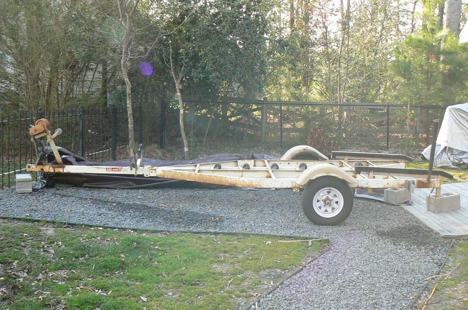

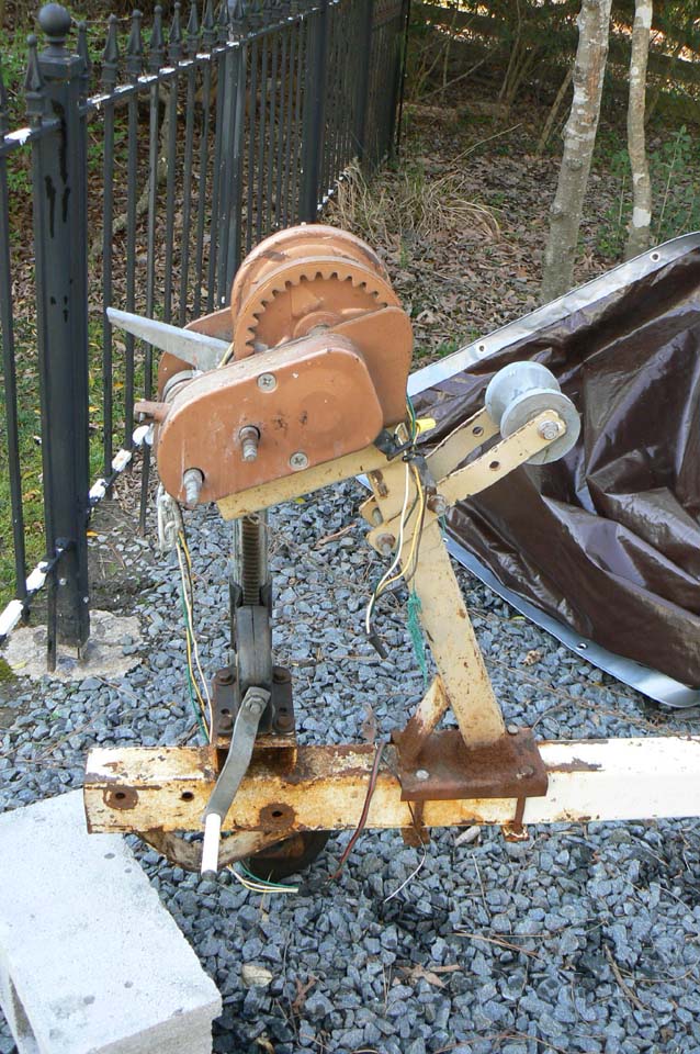

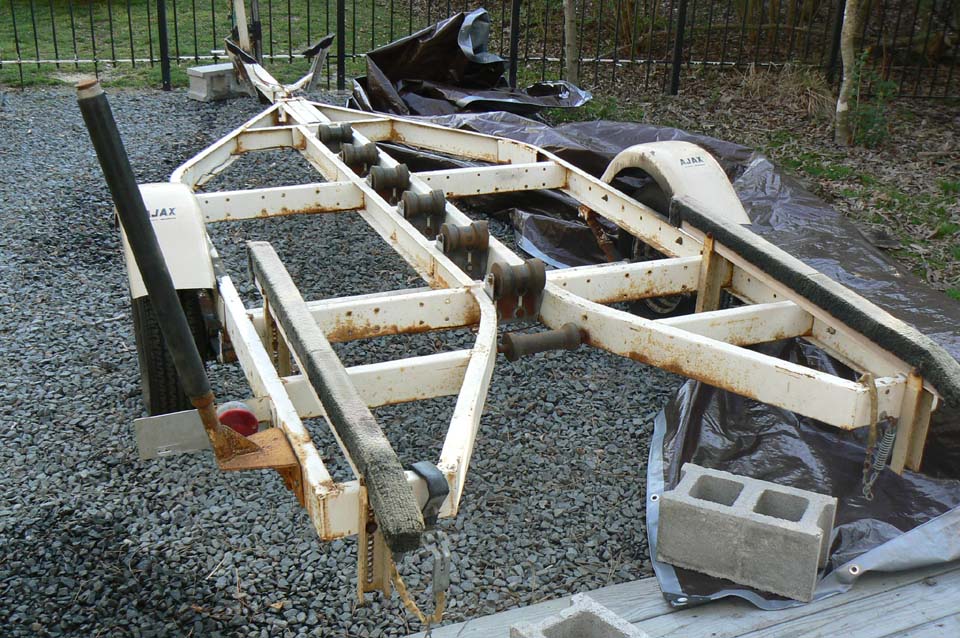

Ok, so I figured this should probably go here since it is a restoration. Finally got warm enough to do the trailer. Don't have enough roomin the garage to do it so it's getting doen outsdie under a tarp, while the clipper resides on blocks in her shed.
Here are a few pics of her starting status. I will take more pics tomorrow of everything off of it and ready to be blasted. I plan on using POR 15. They say I can just blast, blow off the dust and paint, without having to do anything else. This way I dont' have to buy all the other prep stuff and I know there won't be any old paint chipping off from under the new stuff.
I went with the Gray since I will be topcoating in while to original color. Along with repainted Tan fenders and probably tan winch, even though it's closer to a bronze color now.
I also think I'll be replacing all of the rubber keel wheels. They still seem to roll fine but are very hard and the steel sleeves are very rusted.
I only have one guide on her for the pic. I already had them off when I realized I hadn't taken any before pics.
That's all for now. More pics tomorrow.

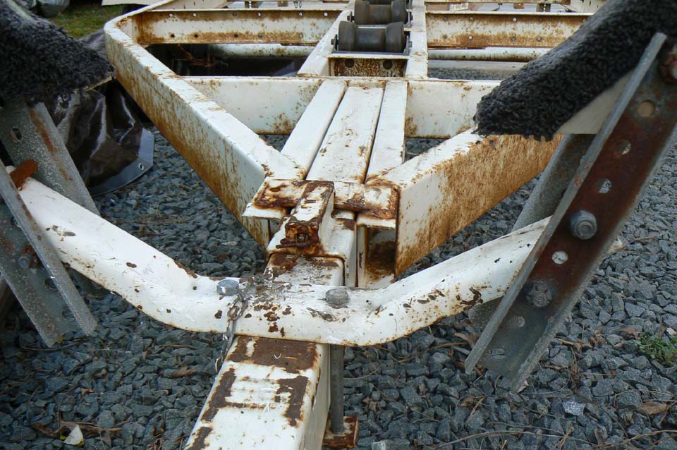

Ok back at it yesterday, here are some update pics.
Here's the rear roller
They all look like this so have to be replaced.
Here's the front tongue, main tube and guides removed.
Axle removed with the wheels on. You can see why the bearings and seals have to be replaced.
Here's the axle mounts for the trailer. Kind of interesting they can be moved forward and backward as necessary, depending on how much weight you'd like on the tongue, more or less. Very generic/versatile trailer.
They're actually held on by the fender bolts. I may mount them with seperate bolts as I plan on moving the fenders back a little to be over the wheels more. Also another view of why the wheel bearings and seals need to be replaced. Nice paint job with the grease hugh?
Ok here it is stripped, flipped and ready for blasting.
On a side note, got that 50lb portable media bucket from Harbor Freight real cheap. One of the write ups said he used play sand in it and it worked great, so I got one. Not to self, make sure the play sand is real damn dry before trying to use it!!!!!!!! It does work if the sand is dry but the sand I got, even though inside a barn, was still too damp, so I was trying to spread it on a tarp yesterday in the sun to dry it out. YEeah I know, NOW THAT'S CHEAP! WEll at $3.50 a 50lb bag why not try it right? :woohoo:
Well back to sand drying, bug spraying, lawnmowing etc. I may use some of that stripper I have left over from doing the inside of the boat. Need to use it up anyway and I can just blast where the rust is, we'll see
