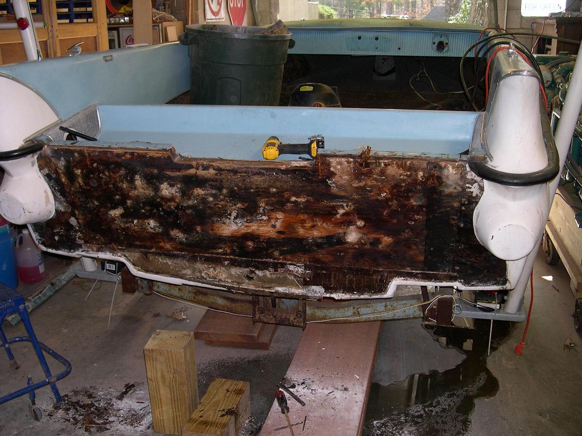

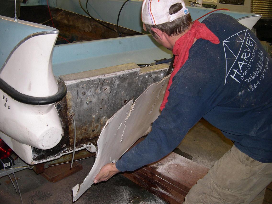

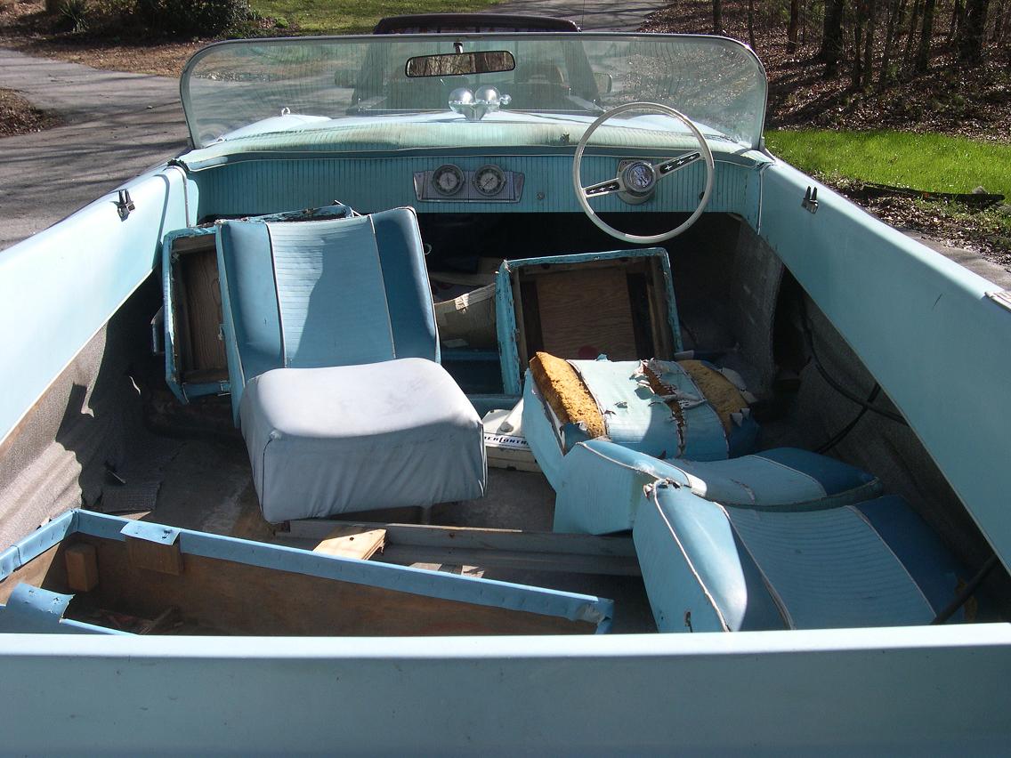

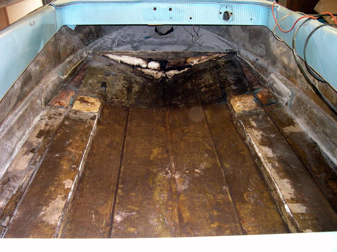

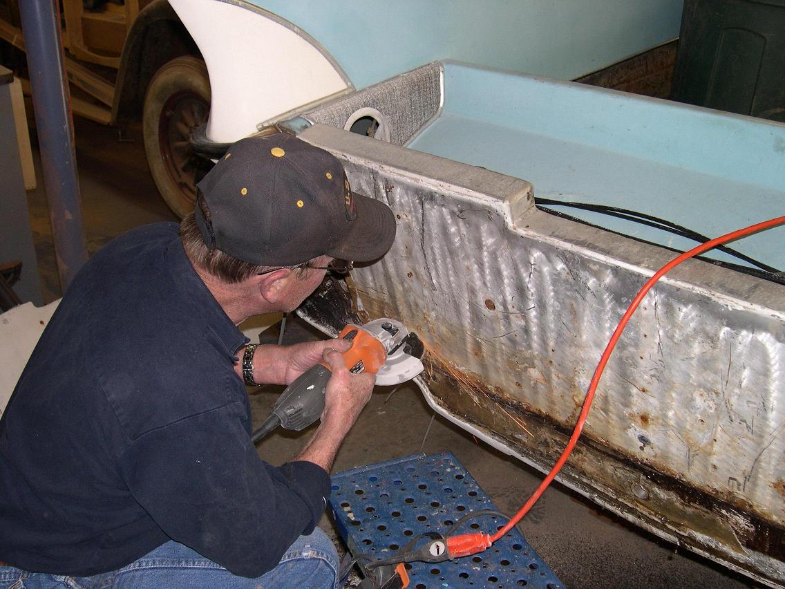

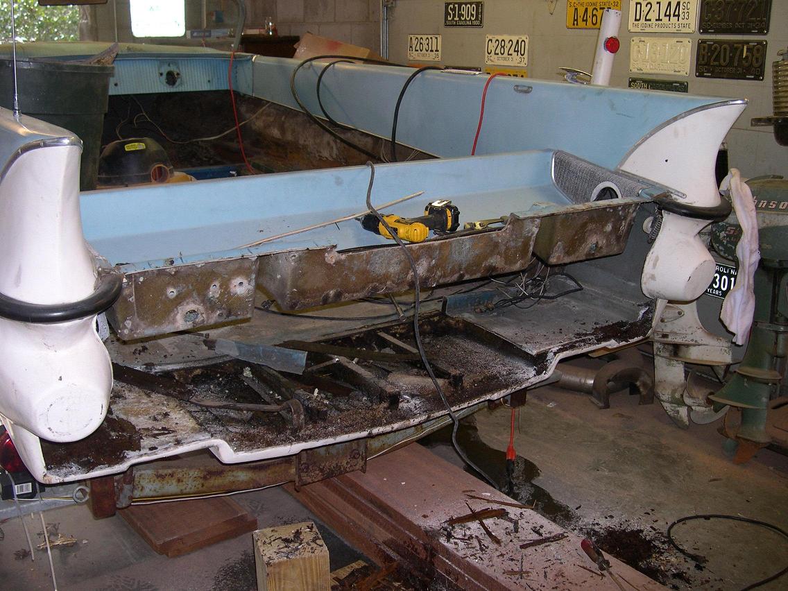

Nautilus Marine Restorations has just begun the restoration of a 1962 Custom Craft. At some point, large 1/4" thick aluminum panels were installed on both sides of the (rotted) transom and were then fiberglassed-over. In the process of doing this, a lot of cutting and drilling was done that will require some creative remodeling. As might be expected, the floor, stringers and all plywood against the hull were rotted and the floatation could be wrung-out like a sponge. The hull interior is in the process of being stripped bare in order to replace all the structural elements.
The boat will be restored using modern seating and appointments but keeping most of the original style elements. I'll post progress photos as they become available.

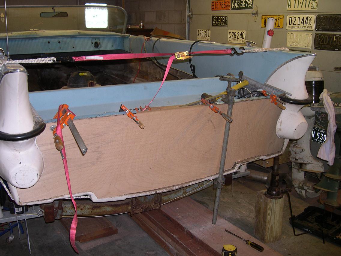

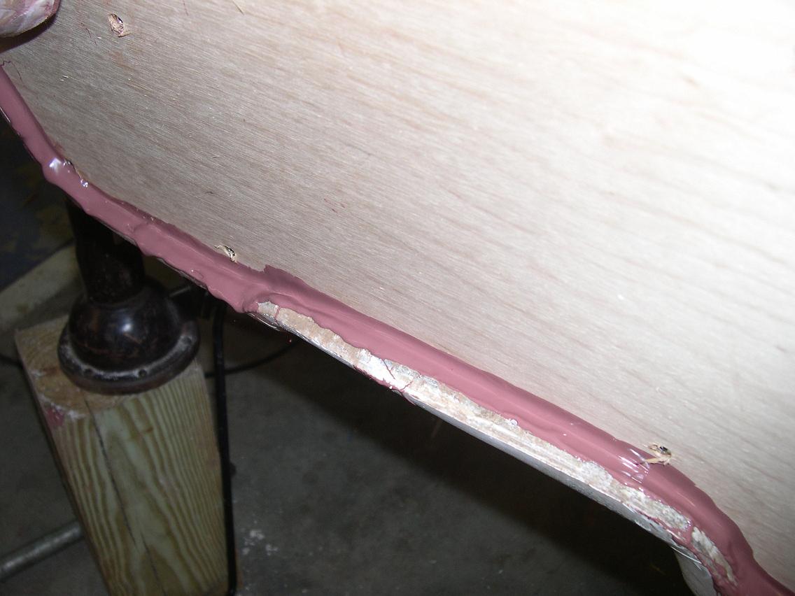

Installed two layers of 18mm meranti marine plywood. Panels were sandwiched together with 3M 5200 and installed with stainless screws and copius 5200 on all edges. An additional layer of 9mm sapele will be applied to the exterior prior to replacing the fiberglass on the transom.

5200?? You will have a great transom in 7 days. Great project hope to follow it along.

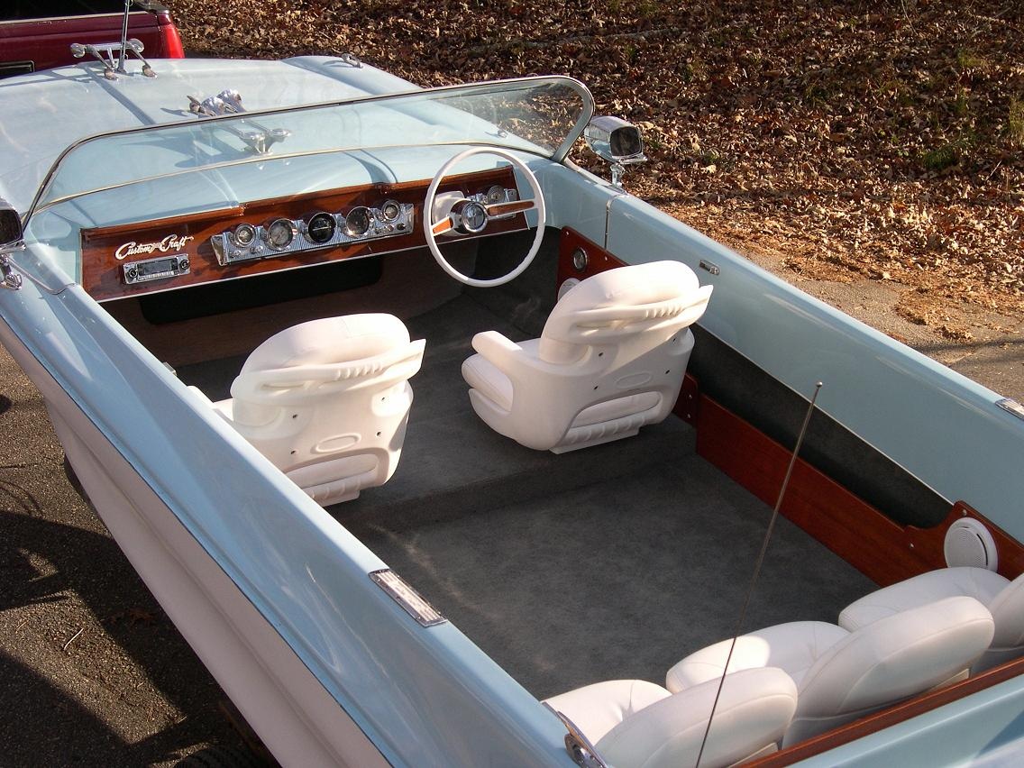

Re:Custom Craft Restoration 13 years 11 months ago #71931
  • Nautilus
  • Posts: 1580
  • Karma: 87
  • Thank you received: 58

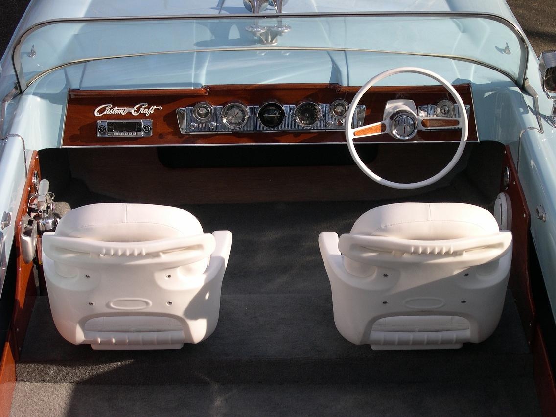

Finished transom
Mentor to the unenlightened!
"Success makes...
Re:Custom Craft Restoration 13 years 11 months ago #71934
Looks great Nautilus, very nice work! ;)
Re:Custom Craft Restoration 13 years 11 months ago #71935
Beautiful!!!!!!!!!!!!!!!!

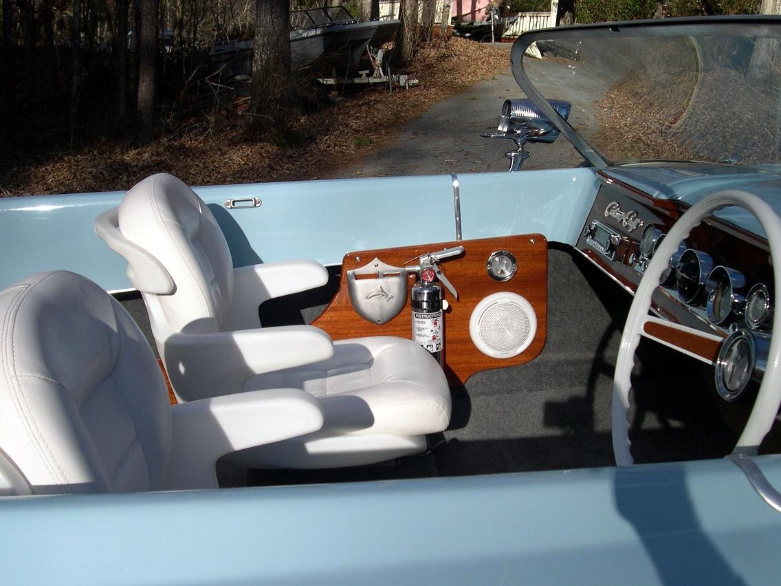

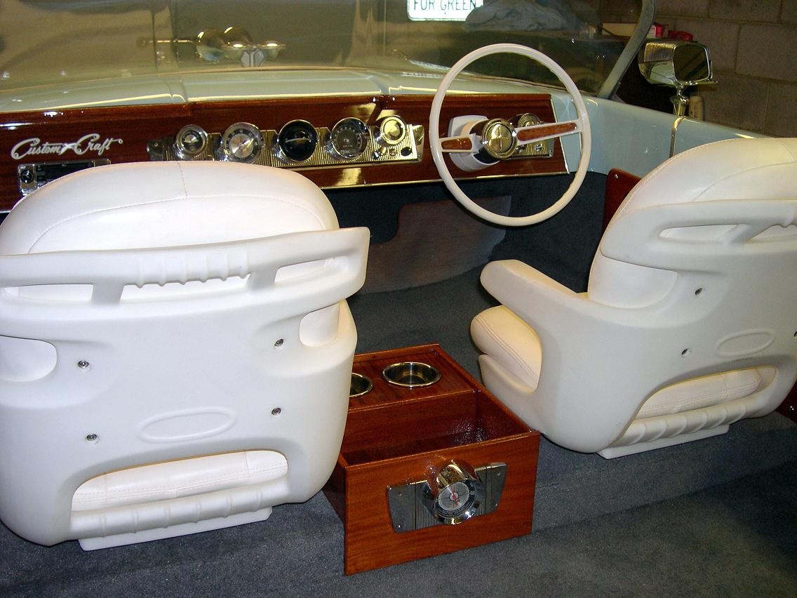

Re:Custom Craft Restoration 13 years 10 months ago #72757
More of his good work
Re:Custom Craft Restoration 13 years 10 months ago #72768
Sweet looking boat. Very well layed out and finished. Great job, something to be proud of. Skip.

Re:Custom Craft Restoration 13 years 10 months ago #72771
  • Neil
  • Neil's Avatar
  • Posts: 1997
  • Karma: 65
Nicely laid out.
Not too busy or crowded.
Not overdone.
Nice, very nice.
Well done.

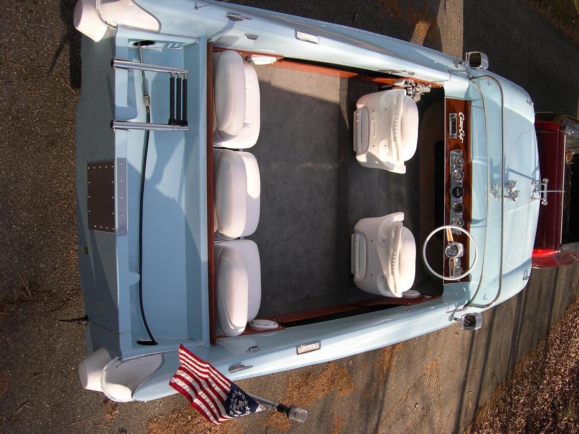

Re:Custom Craft Restoration 13 years 10 months ago #72772
  • Nautilus
  • Posts: 1580
  • Karma: 87
Thanks for the compliments. I was going for "retro understated elegance." We're still missing the wrap-around molding and the docking lights still need to be installed but she's ready for some vintage power. I'm waiting for Jim to send me a white Merc!

Re:Custom Craft Restoration 13 years 10 months ago #72777
a 700 or 850 would be nice. ron

Re:Custom Craft Restoration 13 years 10 months ago #72792
Ron - this is the one u found in nj
Re:Custom Craft Restoration 13 years 10 months ago #72857
I'd say you hit the mark beautifully, Jan. She's a gorgeous boat Jim, you'll have a nice on there!
Re:Custom Craft Restoration 13 years 10 months ago #72859
if your talkin about my boat a fiberglassic member found it for me in south western pennsylvania.
