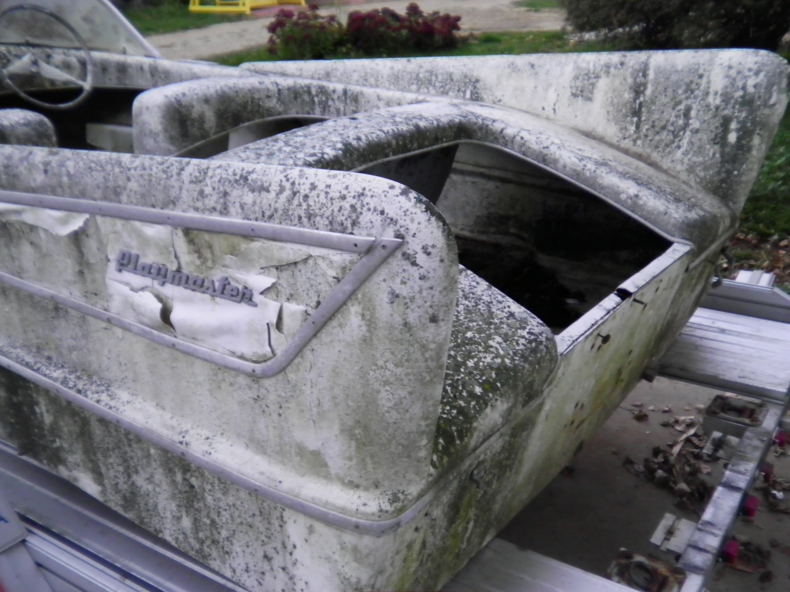

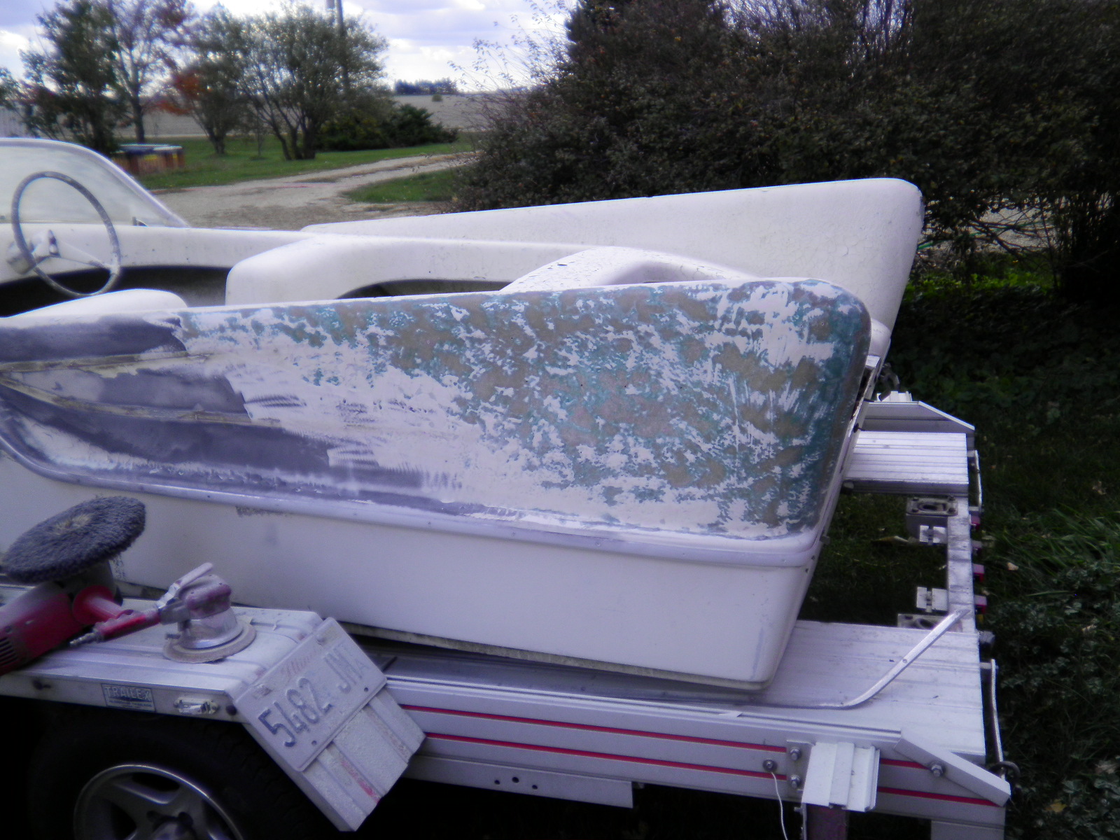

I than started buffing the trim on the boat. One piece came out great. The next not so good. They used a little stainless and a lot of anodized aluminum. So I will need to do the "drano" trick to remove anodization.
I than started grinding off the white gell coat. As far as I know this fiberglass looks great with all issues residing with the thick cracked color coat.

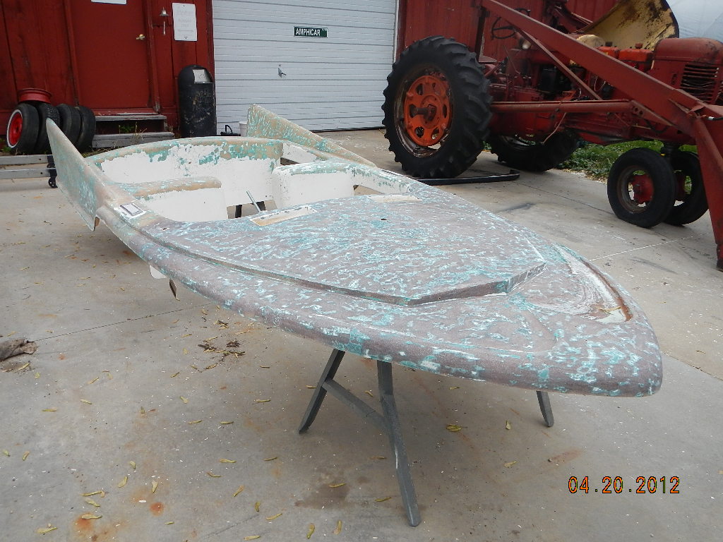

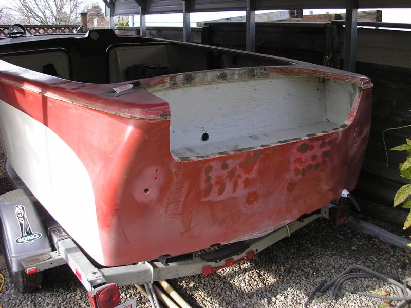

Re:1958 Glass Magic Playmaster restoration/repair 15 years 2 weeks ago #48654
grinding off cracked gell coat. I wanted to get a soda blaster but economic realities dictated paid for grinder.

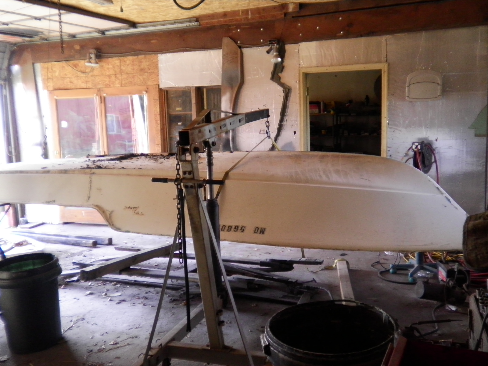

I had to finish this first. Now the Playmaster is inside and upside down. I will now learn about keels.
Re:1958 Glass Magic Playmaster restoration/repair 14 years 11 months ago #51221
Family came out for Thanks Giving. I had them pick up and flip the Playmaster.

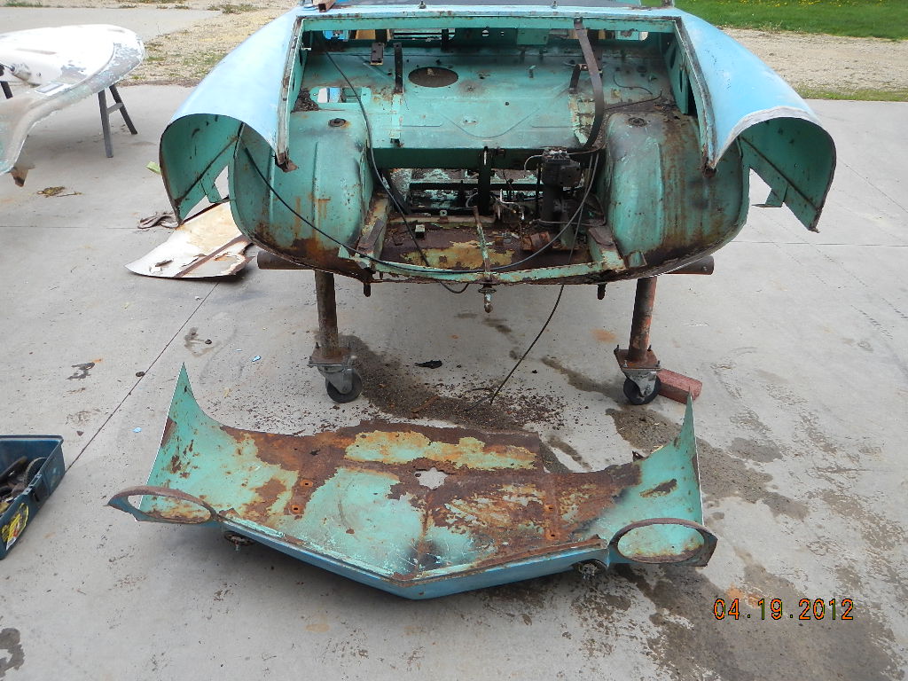

Your airplane wings are awful little and you forgot the tail. It will never fly. Well it looks nice. What is it? I'm sure the boat will be fabuglass when your done. You can find some real funky stuff working on boats. My Tee Nee Trailer had at least a 5 gallon bucket of nuts inside it. I picked the nose up and washed-floated them out.
Re:1958 Glass Magic Playmaster restoration/repair 14 years 11 months ago #51233
Okay, I'll bite: velomobile or powered; kit, manufactured, or one-off custom?
Re:1958 Glass Magic Playmaster restoration/repair 14 years 11 months ago #51239
A youtube link to see it in action. Pulse 110 of 350 produced. A Jim Bede design. Fiberglass body over steel frame. Great fun.

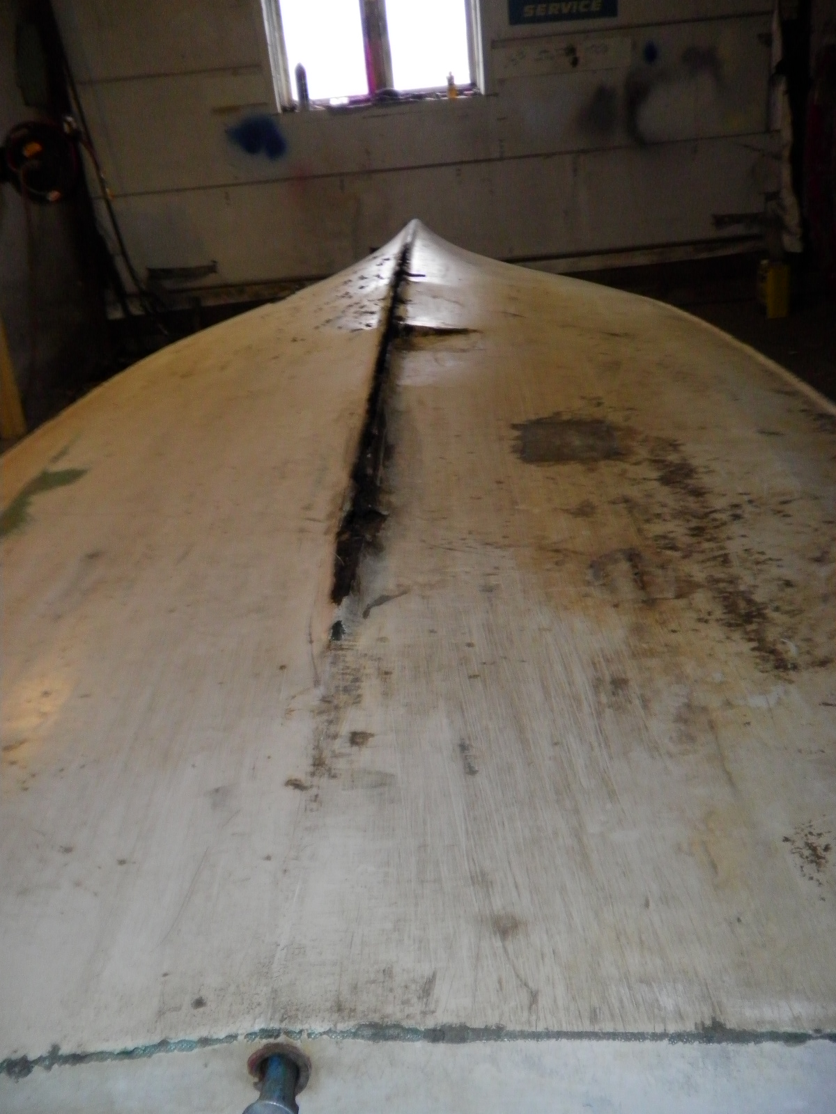

Re:1958 Glass Magic Playmaster restoration/repair 14 years 11 months ago #51435
Not half assed but all assed backwards !!!

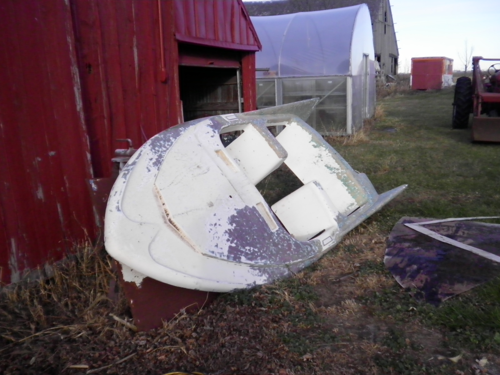

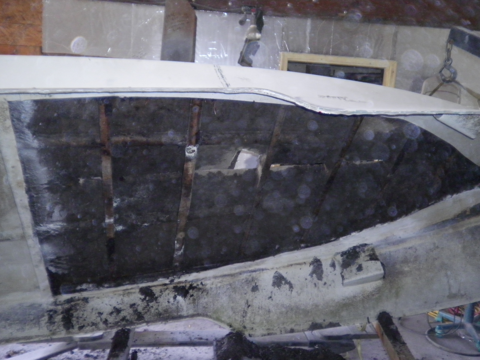

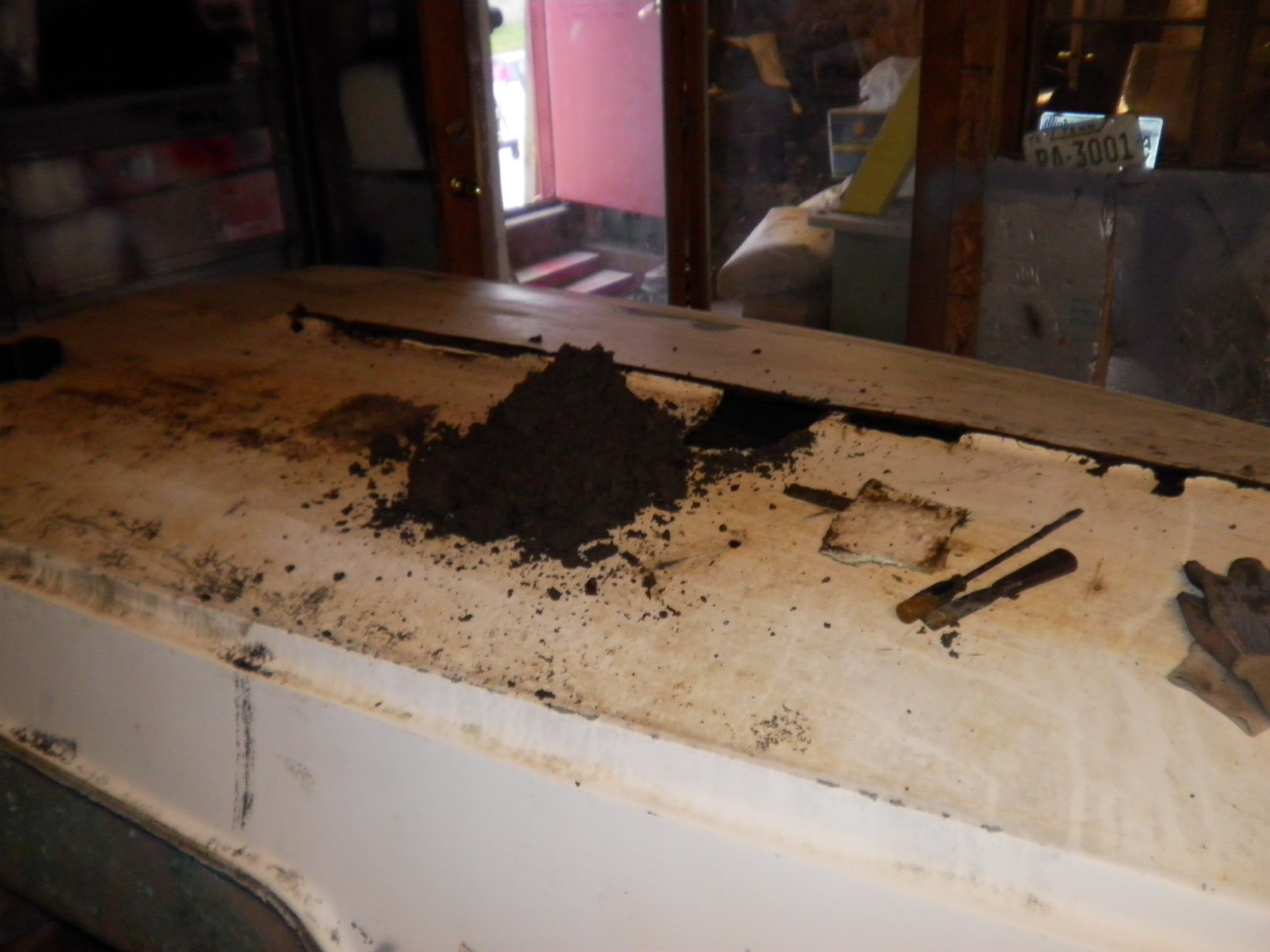

When this all started most everything seemed good. I really thought I was to remove gell coat fix transom and paint. HA HA HA HA HA HA HA
Once inside and upside down the bitter truth was dug out. As usual I am alone in shop. So I cut it apart and raised. If I had planned for this it would have started right side up.
I am just glad I do not know what I am doing!! If I did .....

Re:1958 Glass Magic Playmaster restoration/repair 14 years 11 months ago #51440
two hundred pounds lighter

What have I done??!!
Re:1958 Glass Magic Playmaster restoration/repair 14 years 11 months ago #51445
It's gonna be alright Dave, you have to crack a few eggs to make an omelet! ;) That overwhelming panic feeling will subside, just take it one step at a time. :)

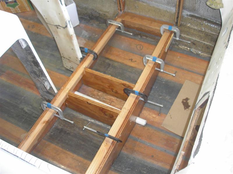

your doing fine dave,we have been there too,but one suggestion,lay the deck across some 2x4s,4x4s would be better,the way its leaning against the building it could lose some of its shape and be harder to put together,john
Re:1958 Glass Magic Playmaster restoration/repair 14 years 11 months ago #51502
That spot was only temporary. I will take your advice on storing it.
I am thinking about closed cell foam between stringers.

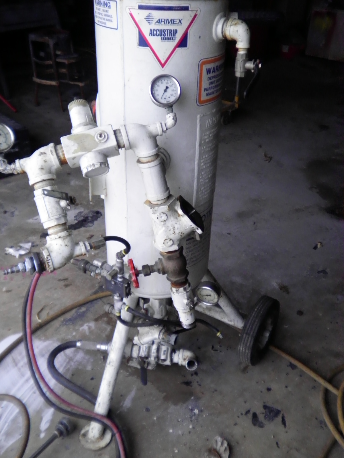

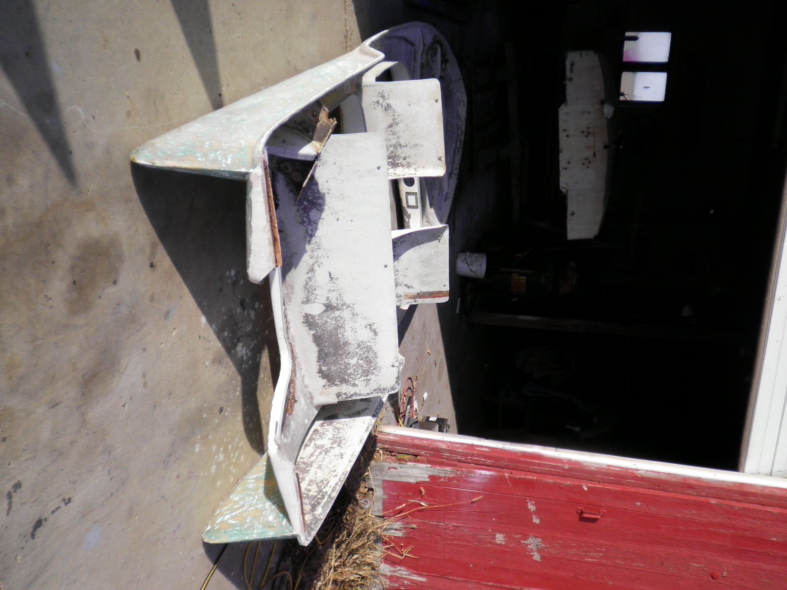

The hull had to get stored out of main shop. So I have been collecting parts and pieces. I did not like grinding and purchased a large media blaster. After repairing valves I hope to be able to use to remove gell coat.
Re:1958 Glass Magic Playmaster restoration/repair 14 years 10 months ago #53138
Dave,
Now you are talkin.... But wow! That thing has more pipe fittings than a boiler room. I have a pressure pot as well, got it 2nd hand from a neighbor for 20 bucks. Need to do some fixing on it too. I have no 1st hand experience blasting glass yet, but I will be starting up on it soon. I have talked with Larry McKay from Vintage Boatworks about his experimentation with blasting glass/gelcoat. So far, the only thing that has worked is sand, or anything harder. Soda does nothing, neither do nut hulls or corn. The fiberglass is too resillient. You need sharp & hard media to cut into it. The blasting cabinet in my shop uses Aluminum Oxide, and while it is an excellent abrasive, it is expensive. Sand is the least expensive of all - so I'm going to use sand. PLEASE be warned - if you don't know; Sand is full of silica. Silica in your lungs will kill you, if there is enough of it. Do the work outdoors, and if there is a breeze blowing even better. You must wear a quality resperiator - one that filters out the timy silica particles. The little white paper masks won't come close to doing the job. The best way is to wear a full blasting hood that has a fresh air supply that is sent to it from a low pressure line. This is very serious - your health is No. 1. Blasting will go fast if you have a big enough compresser, and the results will be great.
PS - you are right - grinding glass stinks.

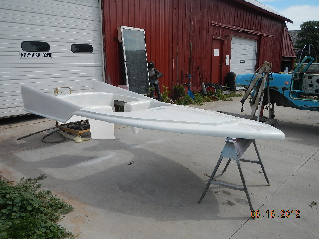

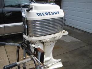

Finally warm out. Between projects I have been adding my "special" filler. My left over plastic body filler cut with fiberglass resin. It almost self levels. Than with long board all will be flat and smooth.
My 1959 Mark engine appears to be excellent. Minor points cleaning, a shot of carb cleaner, 6 pulls and it fired.
Now in process of ordering impellers and such to get to really hear it run. Taking Jims advice, I will be resealing entire engine before active duty.

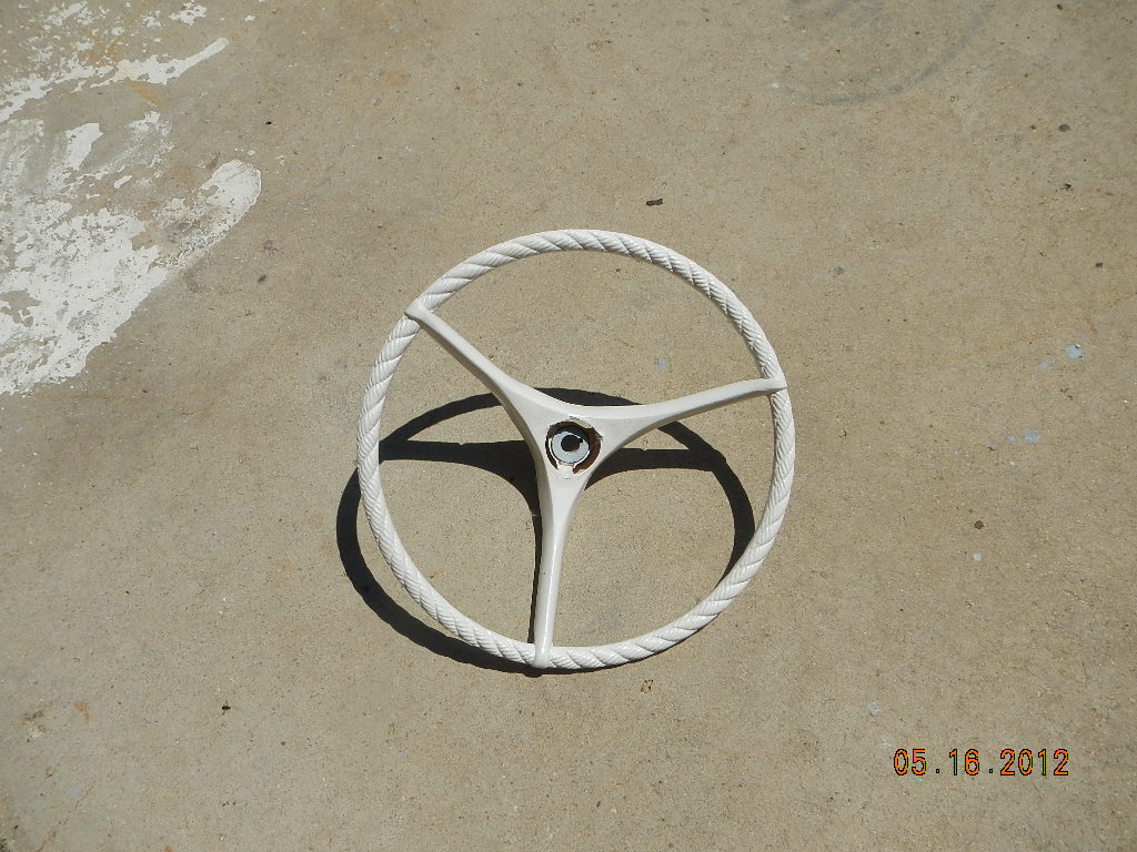

Some time ago someone asked about a rope steering wheel. I had one. Since I had dug it out, I media blasted it. Than a coat of white. Looks a lot better.

Dave, great progress, gotta love those fins! Is that a Mark 58AE? Same motor That is on my rebuild. Good luck changing the impeller, sometimes that pump cap can be a &%$#&.

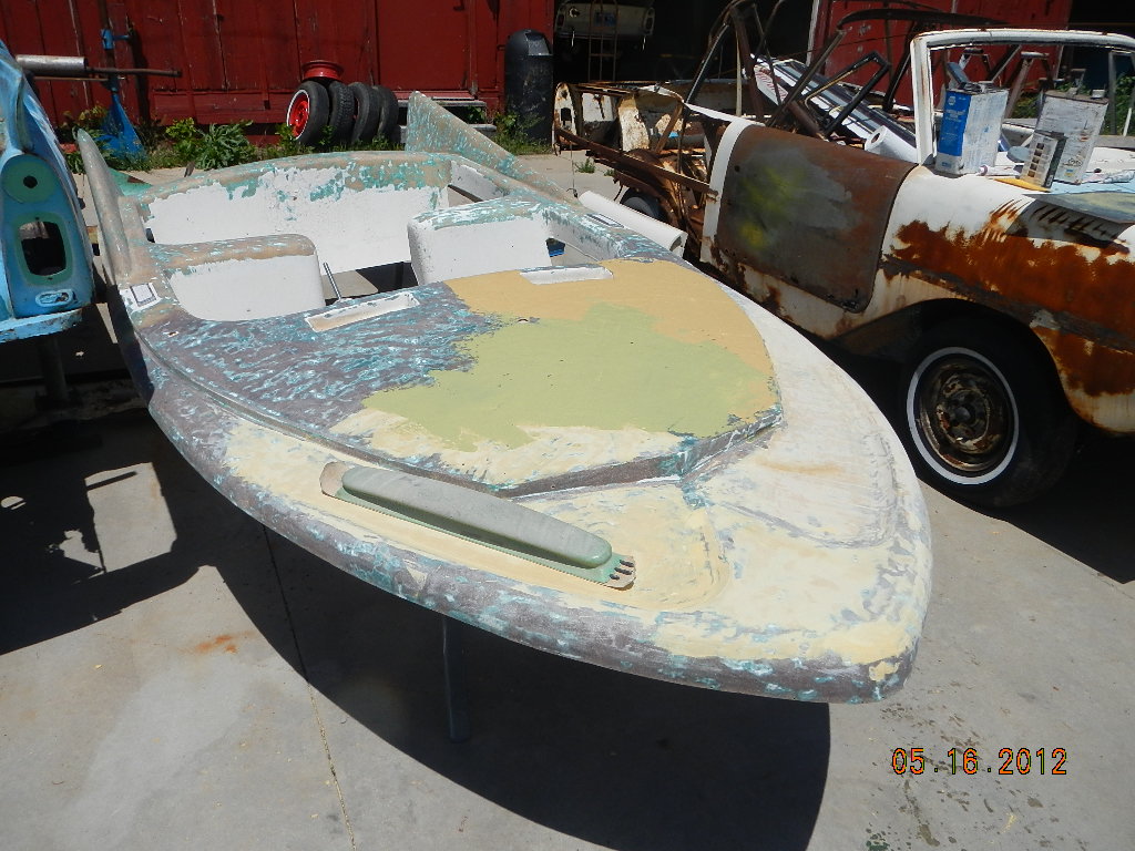

Gallons of filler, mounds of dust. I have to say, I really do not think I will do another boat as rough as this. I put a sealer coat of epoxy on. This allows me to really see all the bad areas. Plus it can sit in other garage for a few weeks. I need to take a break from it.
