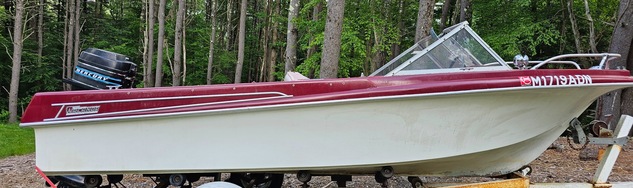

Here is a picture of the boat

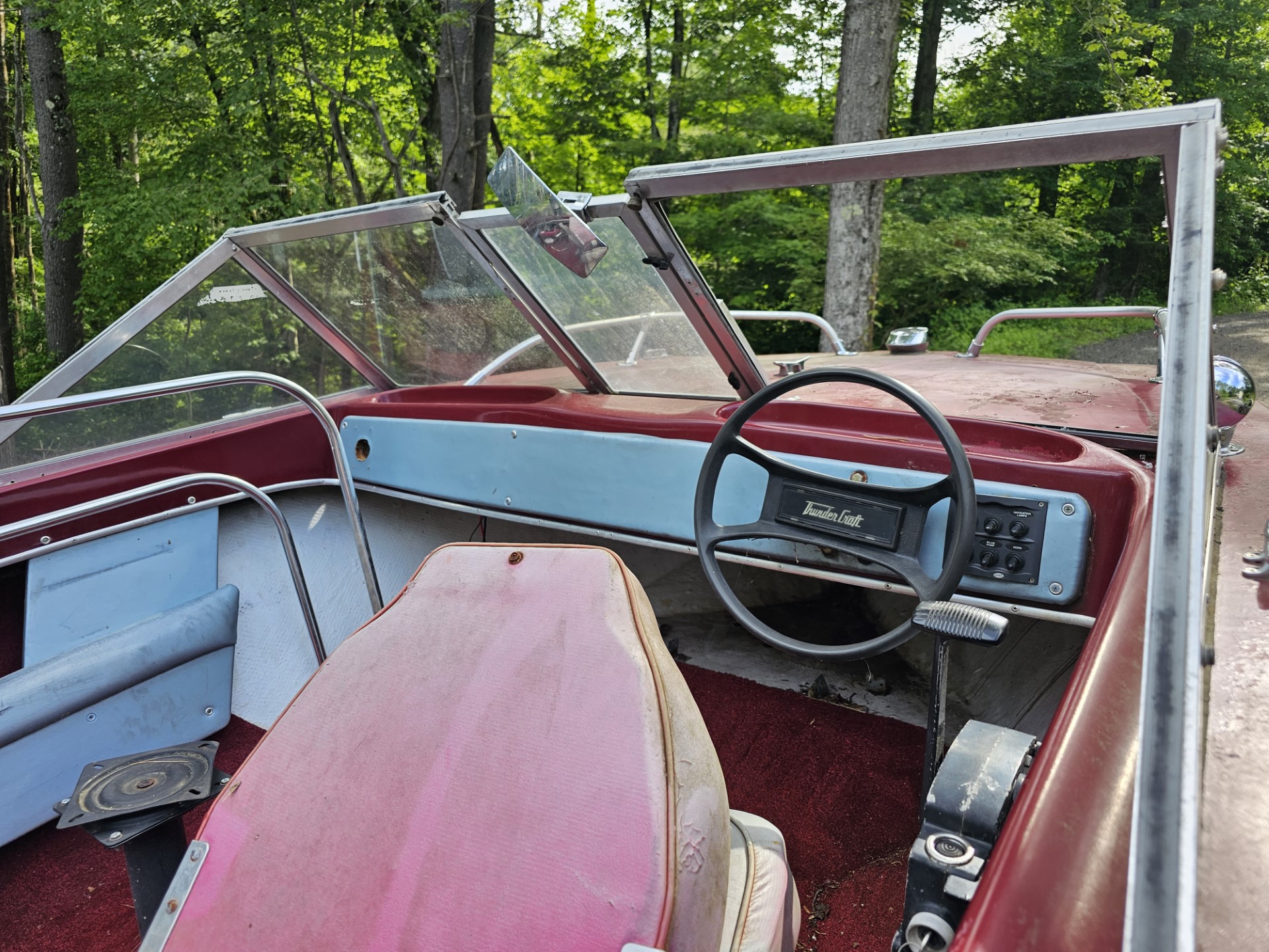

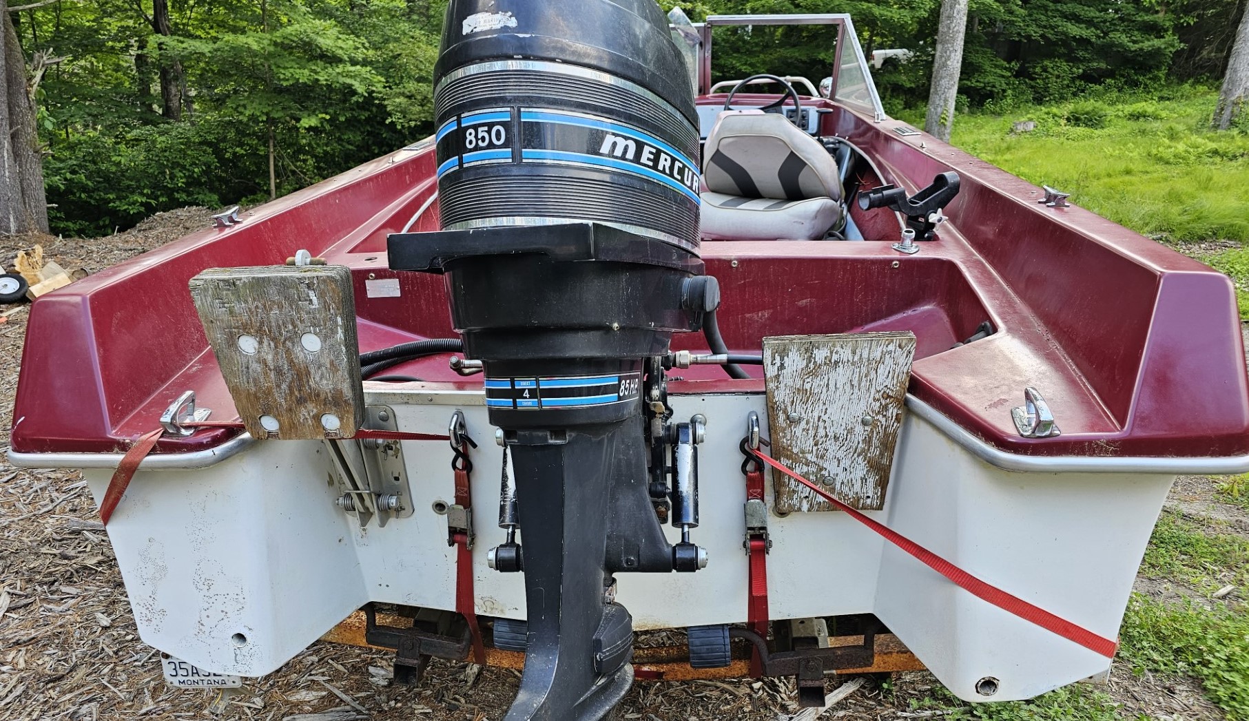

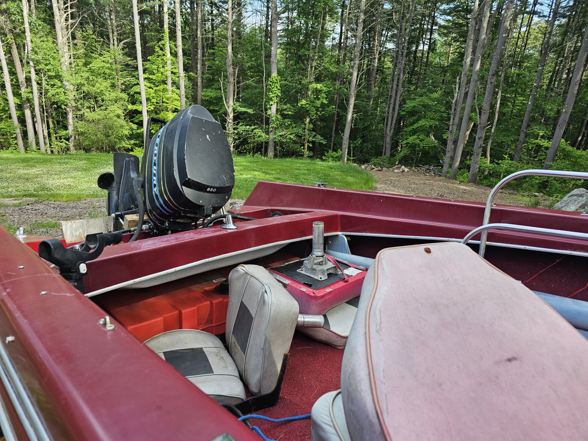

I got some more pictures finally. I will be going to take a look at the transom tonight alittle closer and try to find out what is going to need to be cut out to replace. I believe it is just the center section which wont be to bad if it is as that is the only section of it with an aluminum cap on it. The transom feels solid and does not flex at all so i am not even sure if it needs to be replaced. However all the bolts and clamps are pushing on the fiberglass and bulging. Which from my research is a sign of a rotten transom. There is also a small crack on the bottom of the boat by the center drain hole that i will be needing to address at some point. My hopes are that it isnt major and i can just grind it back alitlle epoxy and reglass it.
Wacanda project 3 years 5 months ago #148073
Nice! Anither trick is to take a small diameter drill, maybe 1/8" and drill a hole in the transom from the inside, toward the bottom and not through . Maybe a 1/4" and see what the saw dust looks like, if it's even sawdust. If it comes out black it's toast, it's rotted. If not you may be ok, you can always mix a little epoxy and fill the whole if needed.

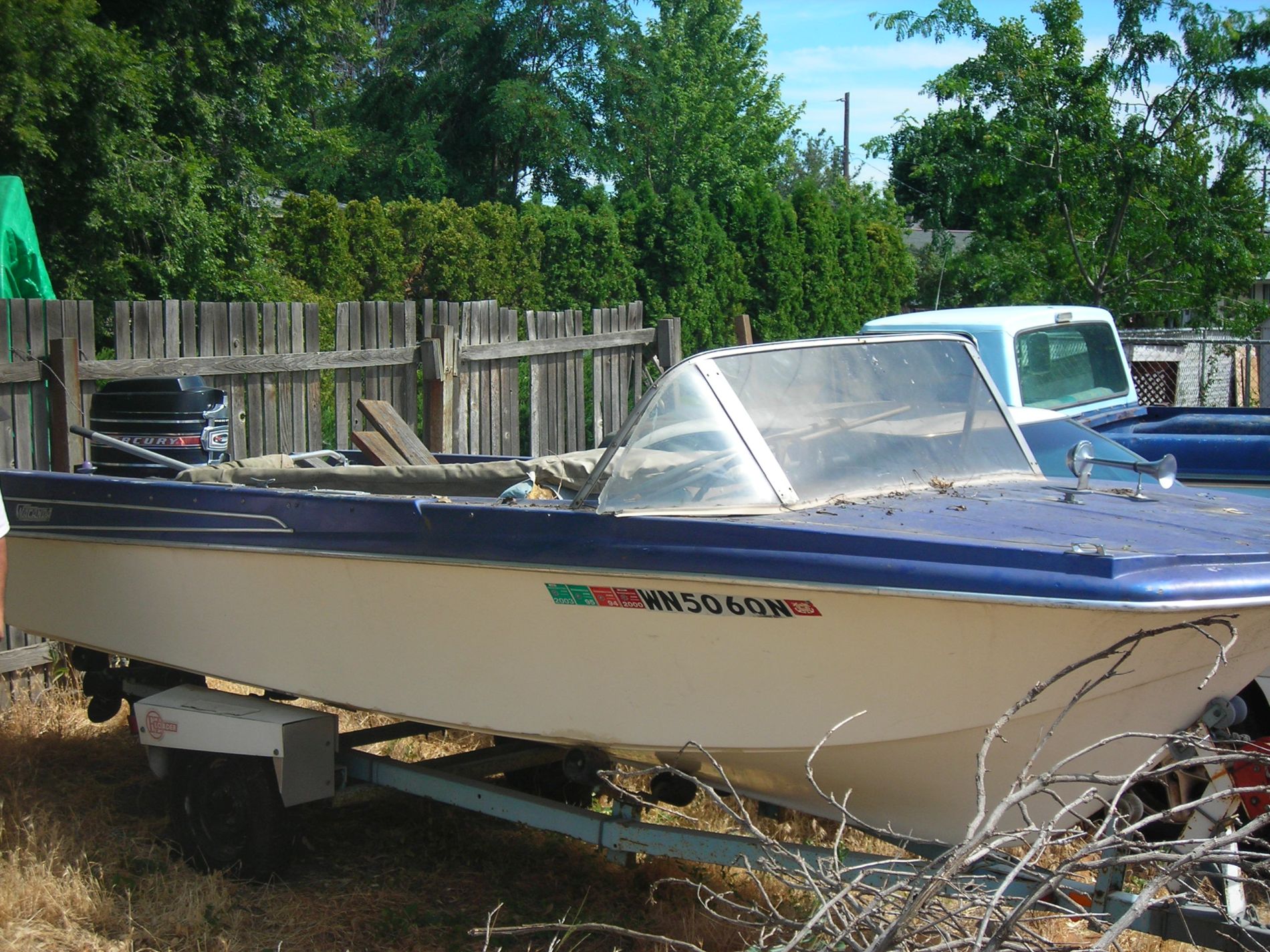

I found this related post.
I don't believe your model used the Ford windshield, as this one looks to be original.
doc
Wacanda project 3 years 5 months ago #148082
Even if it didnt use the ford windshield my guess is it would fit on here. If i am ever able to come across one which i highly doubt the boat alone is hard to come by enough i will for sure buy it and try my best to make it work.
