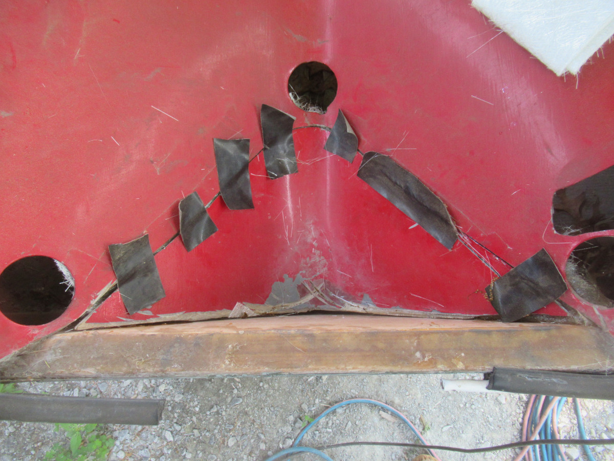

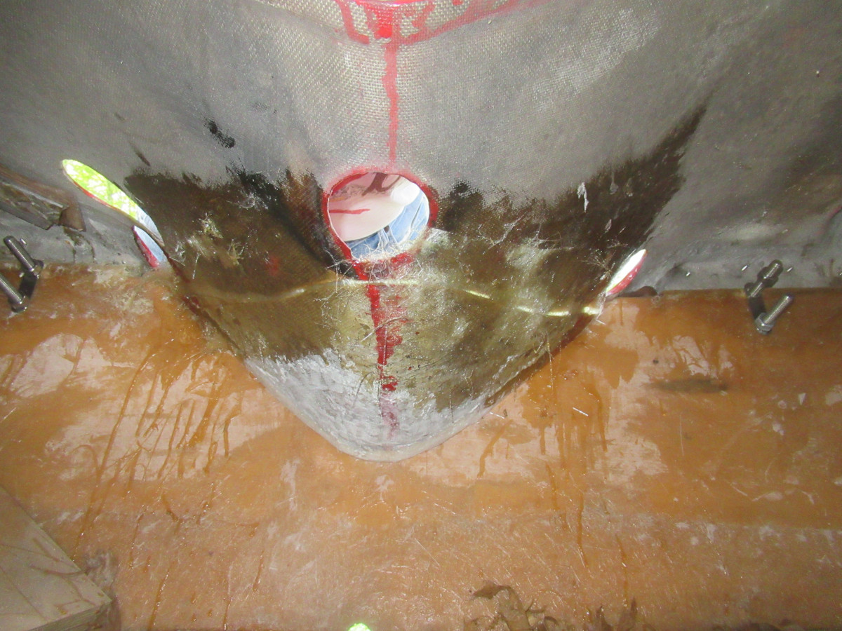

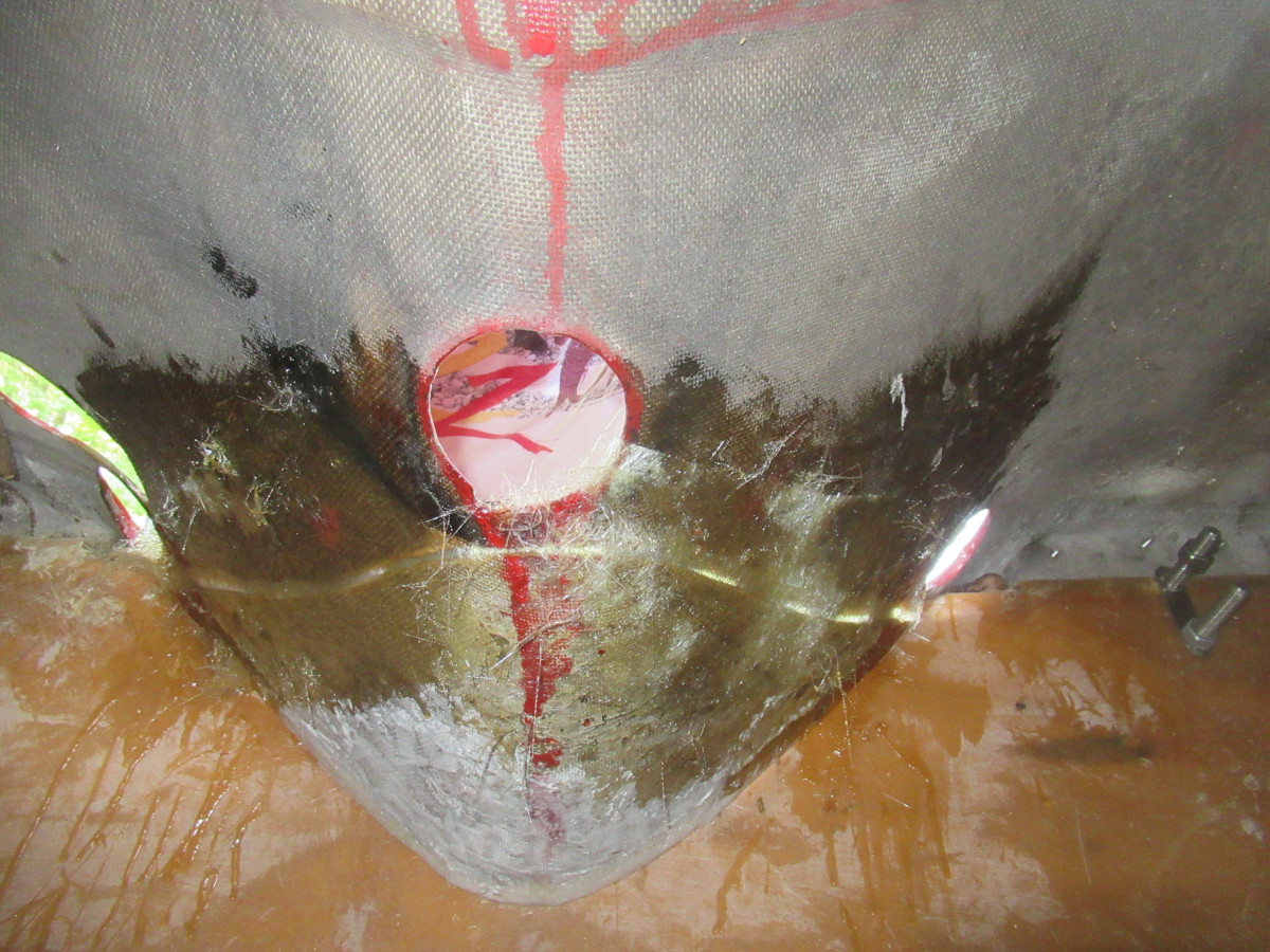

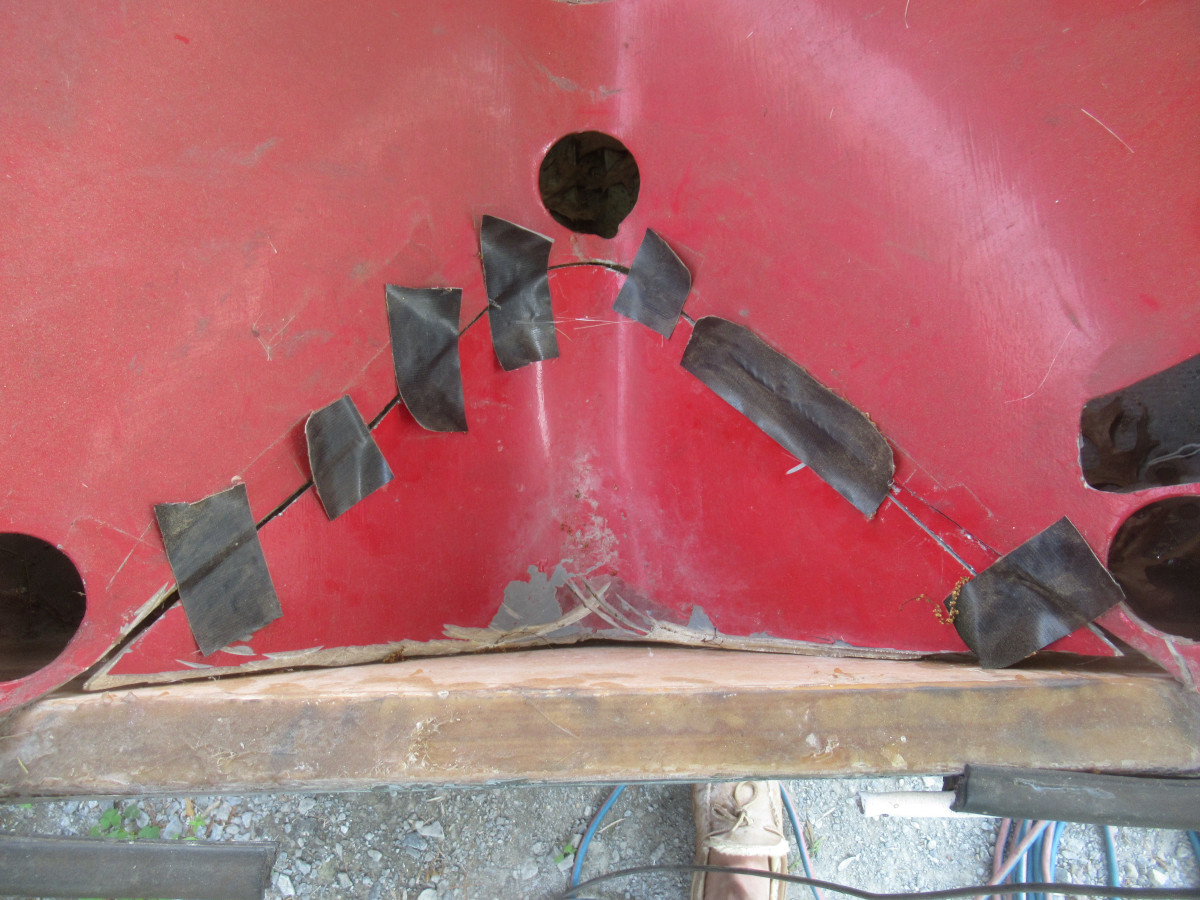

Getting my old 1959 splash pan back in was a doozy, but got it done this nice warm afternoon. Ground everything down from the last (failed) attempt, and got new glass both sides. Back isn't great, and to be honest, had to re-do one side, but everything stuck good and will let it dry overnight and put one final wider layer of glass on tomorrow, then fill what crack be seen on top with duraglass or some such.
We're packing up to move soon, so it was a challenge finding everything I needed.

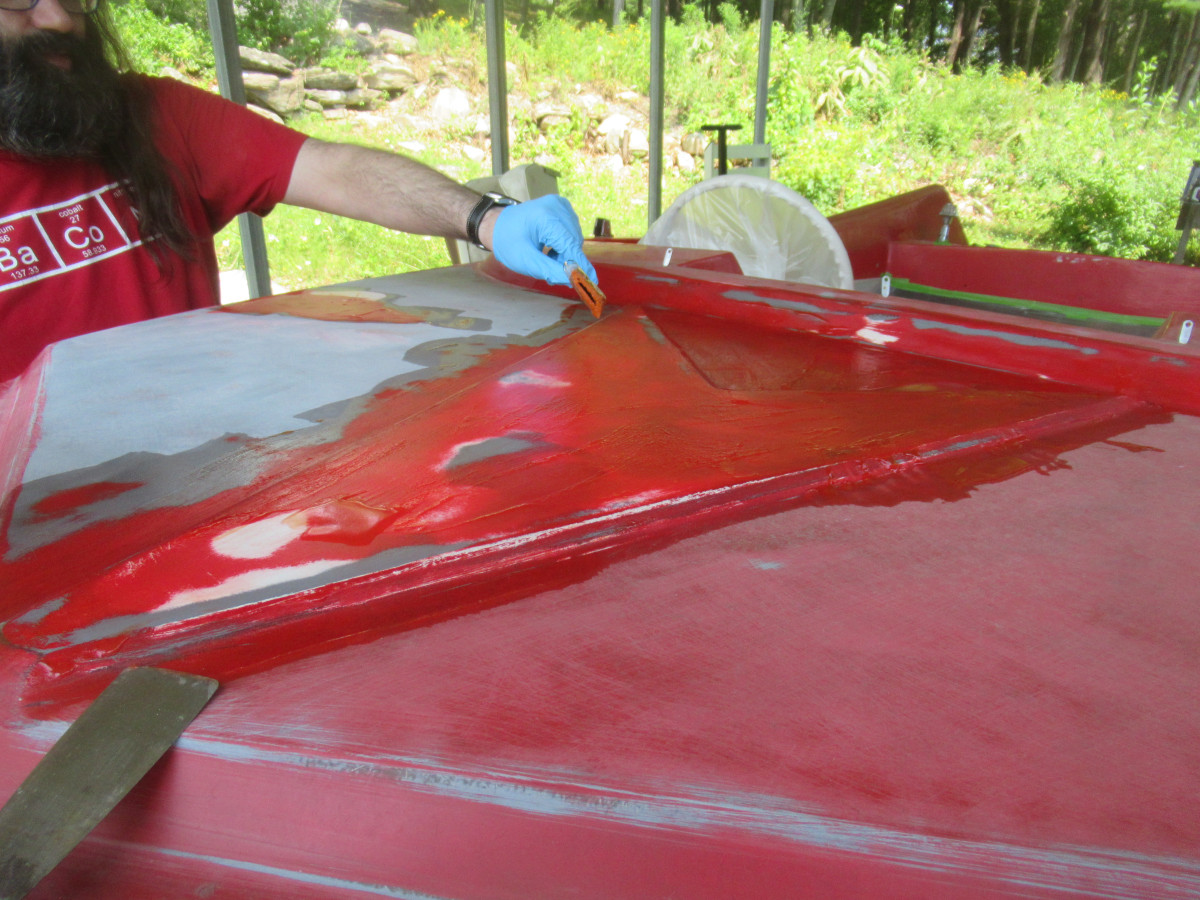

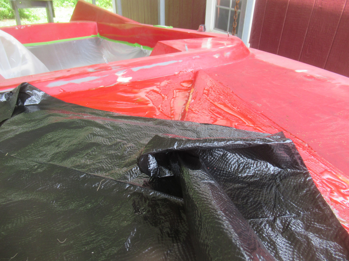

Starting to strip the single stage paint for two stage paint. 2 hours doesn't do it. Will check in the a.m.
Finally 5 years 3 months ago #144997
You may have to cover the stripper, once applied, with a plastic garbage bag to keep it from drying out?
I've been using the orange safe stripper, and it only works while moist. If it dries out ? it stops working.
But maybe your stripper is different ?
The following user(s) said Thank You: JetDeville700
Finally 5 years 3 months ago #145003
Looks like I'm going to junk this boat. Covered the stripper, and when I just went back to see how it did, it did too good. I have bare fiberglass now sticking up. I'm going to have to decide whether to keep this boat or take it to the dump. I do not have the skills to fix this sort of damage. Bah.
