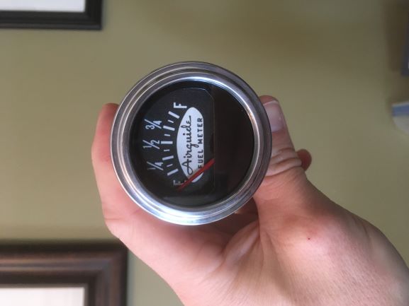

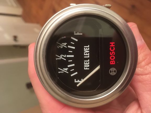

So, I had a little fun with photoshop. I bought a Bosch gauge and sending unit for the fuel tank and decided to make my own Airguide fuel gauge. I just need to buff out the bezel to bring up some more shine out of the aluminum.
I also managed to score an original Wilcox Crittenden head that came out of another Seafair. I pulled it all apart today to begin polishing out the bronze, and I did manage to find a NOS repair kit. I may end up bypassing the pump, though and having it hook up behind to an electric pump/macerator. We shall see.

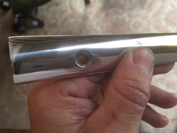

My favorite thing I did today was to see how aluminum trim parts can polish up. I took the cabin roof rails and went through 4 different sanding grits, then two polishes on the bench polisher. What an amazing before and after!

love the custom gauge!
any chance that you would share a high res file of the airguide letter logo? I have been thinking of making a sign for the barn with logo and then "marine instruments" where you have fuel meter.
thx

Eric,
Yes, i do have a pretty good file of an Airguide speedometer face. I'm happy to send it to you! I'd attach it here but I can't reduce the size of the file enough, so if you can give me an email, I'll send the large one. Caveat: I've had zero luck getting PM's to work on this site.
Eric

Eric,
is it a PNG that can be blown up without distortion?
did you print a decal for the fuel gauge?
I have the "sea speed" style speedo, tach and compass in the lake n sea and will be installing the 651 black n white style tach and speedo in the custom craft.
Thank you!

email sent, Eric. Yeah, the face is printed on a waterslide decal paper. I found the adhesive isn't strong enough so I cleaned the adhesive off and used a proper spray adhesive but the only issue I have is that it isn't glass smooth...you can see some texture in the light. Oh, to have silk screen capabilities. But it looks good enough for me, even better now that I polished the bezel today. It looks like chrome now.

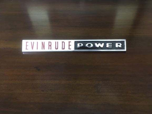

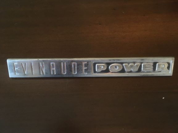

One more very small task done, but a welcome change. Evinrude POWER badge restored. More difficult than I thought.
Jeremy Clarkson would be proud.

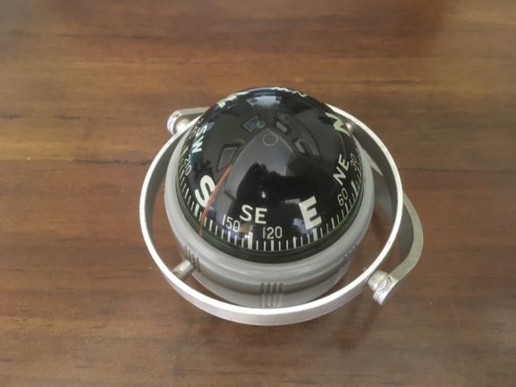

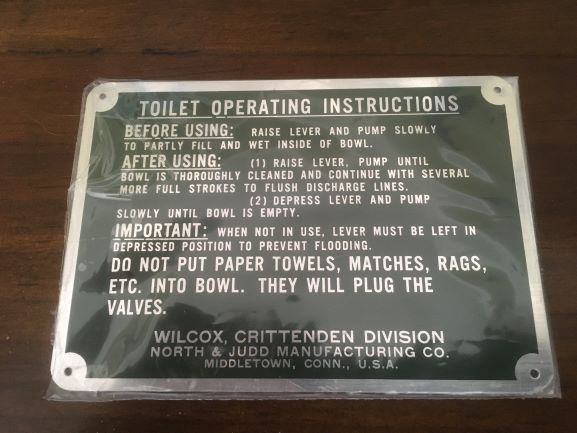

Acquired a couple more needed items for the Seafair. The original Airguide model 87 gimbal compass that came on the boat was totally cracked and weathered and empty of liquid from 62 years of sun and elements. I managed to find a minty clean one still filled to the top:
I also lucked out in finding an original instructional plaque for using the Wilcox Crittenden head. Super happy to find one.
Now if only I could find that darn rear corner piece for the transom! That's probably going to take years.

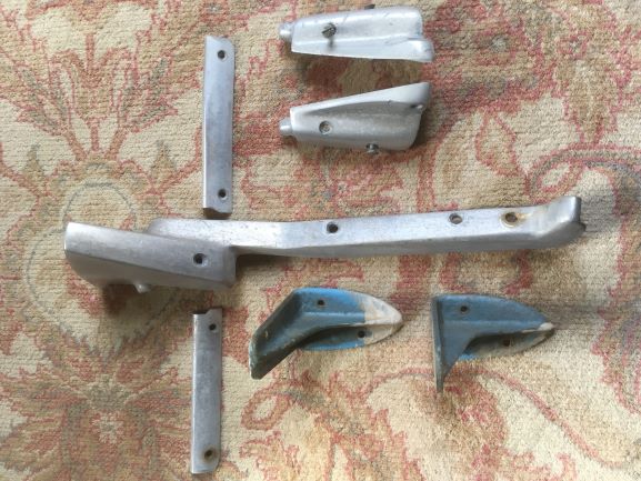

FINALLY! I found the last of my missing parts! Gentleman who was parting out a 1960 had all the remaining pieces of trim I need to complete my list of necessary items. I got the 1959-1960 only port side transom bracket, the two missing transom-to-deck joint pieces, two original footrest brackets to replace the modern shelf brackets on my one side, and for good measure the two pieces near the upper windshield that have the receiver for the bimini top frame (someone royally screwed mine up with drilling in eye bolts for something). I'm happy as a clam. Here's to the power of daily searching across multiple platforms!

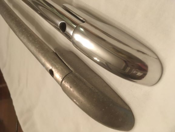

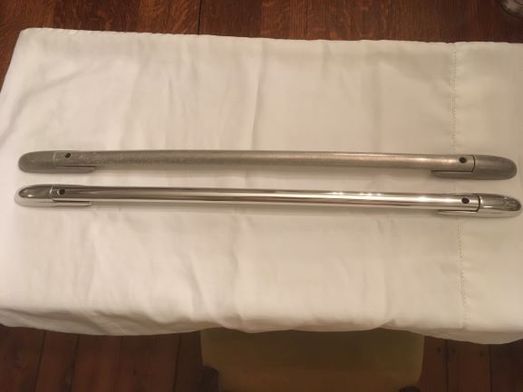

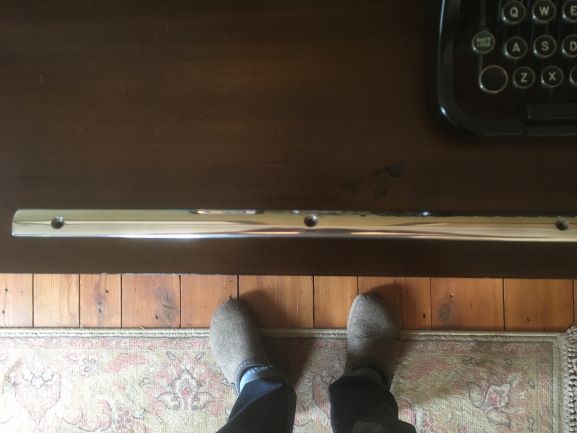

In my recent haul of salvaged Seafair parts not shown above was this: The trim piece that covers the cabin door threshold. It had gone missing on ours. I love seeing how a piece of aluminum most would consider junk off a boat destined for the scrap heap can be returned to glory. It's small, but today, the boat got just a teeny bit better.

1959 Glasspar Seafair Sedan (long term restoration 5 years 4 weeks ago #144296
  • Dr.Go!
  • Dr.Go!'s Avatar
  • Posts: 1719
  • Karma: 19
  • Thank you received: 125
Looks great! Did you get that result from a buffing wheel and some sort of compound?
Dr.Go!
1959 Glasspar Seafair Sedan (long term restoration 5 years 4 weeks ago #144303
  • eperot
  • eperot's Avatar Topic Author
  • Senior Boarder
  • Senior Boarder
  • Posts: 186
  • Thank you received: 19
This piece was heavily scratched up and very oxidized. I began with a belt sander to level and remove most of the heavy gouges, then moved on to a random orbital sander with 100 grit. Then just hand sanded with progressive grits from 180,320,400, 800, and then wet sanded with 1500 and 2500. Then used brown polish on the buffing wheel and finally white polish on the fine buffing wheel. It honestly looks like chrome now.
Thanks for the compliments!
The following user(s) said Thank You: Dr.Go!

It certainly does look like chrome... it looks amazing. Thanks for the steps... shows me sometimes there is just no shortcut to great work and great results!

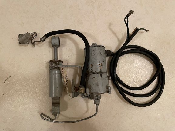

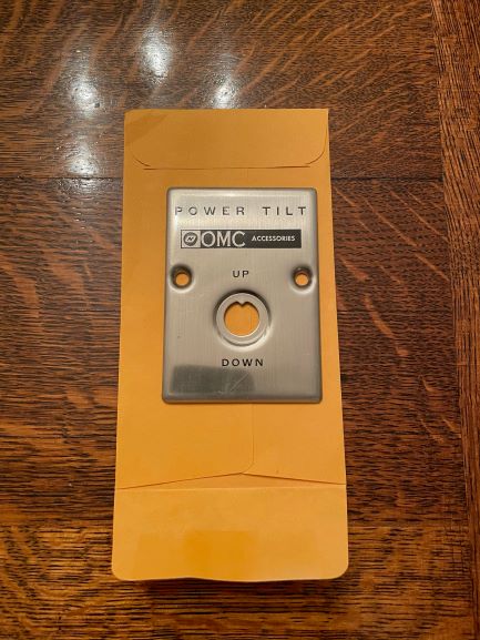

So this week I scored a vintage OMC Prestolite power tilt unit for the Evinrude, and also a NOS switch plate for it for up at the helm. It'll be a great period correct addition!

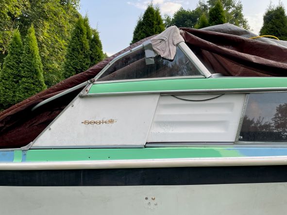

So I've long wanted the Seafair to be a period appropriate seafoamy minty green color. I like the original blue but the green makes me weak in the knees. Recently I've been playing around with samples and finally found one I thing may fit the bill. It's a Sherwin Willliams color called "vegan". What do you guys think?

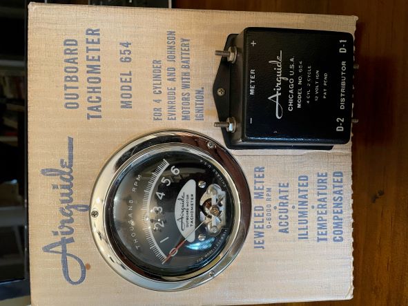

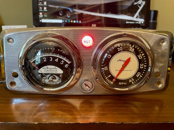

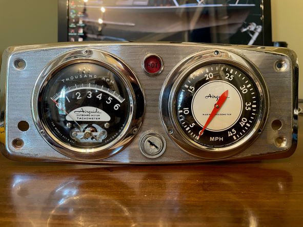

So I got a few more items to show...First, NOS Airguide tach. This has the 654 battery ignition sender but I have located a magneto sender for my 1960 Evinrude.

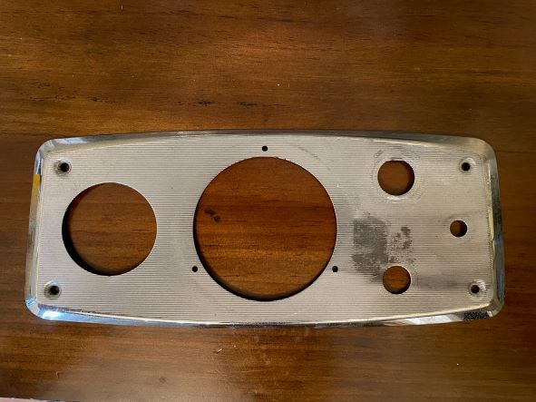

This is the original Airguide gauge plate that came with the Seafair, but with both a tach and speedo I needed to find the twin large gauge plate. After much searching Ebay turned one up. So this one for a speedo and either ammeter or fuel gauge is likely up for sale.
Here's the Ebay sourced plate with my gauges fitted. I also temporarily fit the ignition....
And, the HOT light! It fit almost perfect. just had to notch the plate a bit for the hot light locator pin.
In order for this to work I needed to source a 1961+ V4 head with the well for the temp sensor, and the corresponding water jacket cover. Ebay also turned up this NOS unit. In addition, I got an original OMC warning buzzer that will be mounted under the helm to alert me to any overheating condition should I miss the HOT light.
Thanks Ed MC for all your assistance!

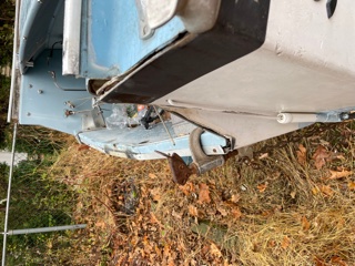

Finally got the Evinrude off the Seafair...will you take a look at the severity of that bow in the transom? Yikes. At least the weight is off now and the Fiberglass should be okay and straighten out once a new core is in place.
The engine is now on the stand I built in my basement where it can stay protected and get worked on as time allows.

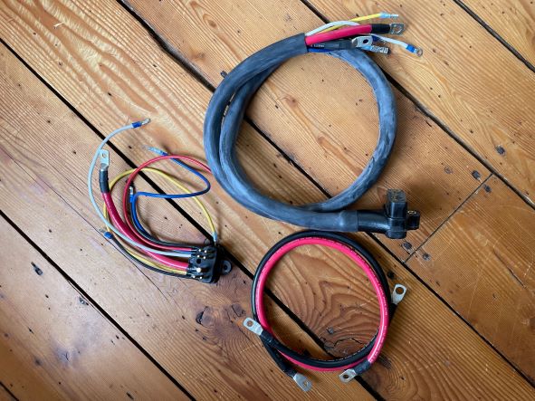

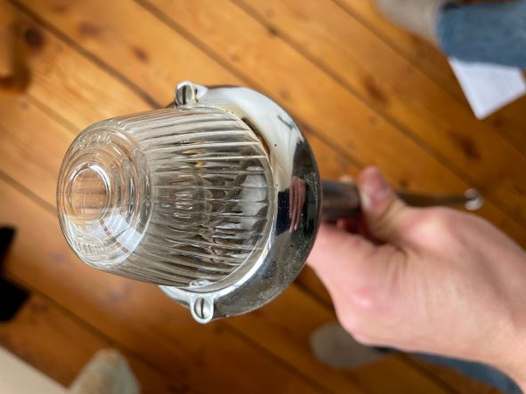

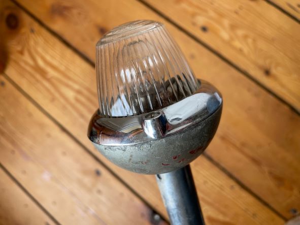

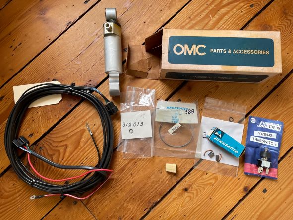

Well, some more goodies came in the mail. First, I needed a new bulb housing for my stern light which had a broken bulb holder / lens, and was looking for an upgrade....found this for 5 bucks on Ebay, made by Hella, no less. Strange, never knew they made marine products. It will need re-chroming along with the original base and pole but the best part is the lens is glass. Cool.
I also managed to score just about every replaceable part for the Prestolite power tilt! Marineengine.com even had several of the original wiring harnesses in stock for cheap!
And speaking of wires, I dug into the pockets a bit and got full new internal/external engine wiring harnesses for the Evinrude from nymarine.ca. They are very well made and frankly I'm amazed that even one human on this planet still goes through the trouble of making them. Thanks, Peter! I'll feel much better knowing the engine wiring is 100% new.
I love collecting the parts I'll need!

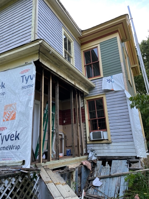

The Summer Swelter finds me working solely on the house, residing my 1874 Victorian with new wood and painting, restoring windows and whatnot. So, as stated previously, the boat sits in waiting.

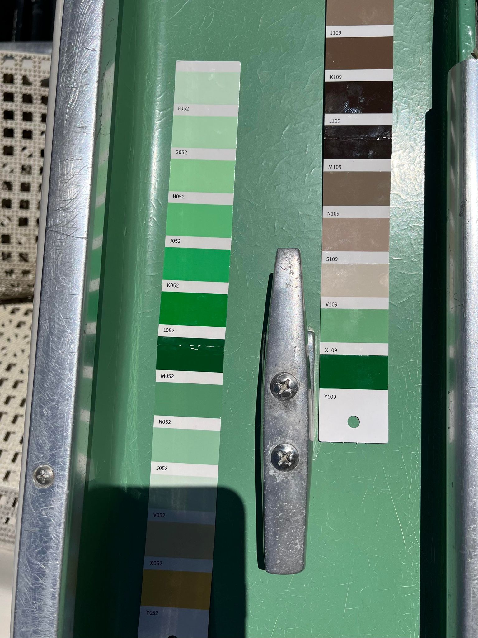

First is the ongoing search for the correct gel coat color to turn this first year Seafair into the "Glasspar Green" I want it to be. I have a massive color deck from INEOS composites, and with the help of my wife and her Facebook, She managed to track down a gentleman with a real beauty of a 1960 in original green gel coat.
He agreed to try to match the color deck to his boat, in specific an area of color that had been covered by trim so it wasn't faded. And thus we found a color as close to original as we're ever likely to get.
This is under the rub rail end cap, where the OG color is most true. N052 is clearly a winner.
Note how you almost totally miss the color N052, it looks like there are three color cards but in reality n052 blends so well it kind of disappears into the deck making it look like there are two cards on the left of the cleat.
So it would appear that I have the correct color pinned down. Nice!

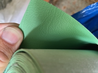

Next step I went nuts looking for some marine vinyl that would be a good match for the cabin bunk cushions and some accent panels on otherwise solid white helm chairs. It took a long time, but I did find a really good match and bought five yards which is more than enough.

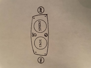

My plan for the helm is a very simple, clean and minimalist setup yet with a full accompaniment of gauges...the tach and speedo in their gauge plate dead center in the helm, with the fuel and amp gauges on either side in the fiberglass for balance.

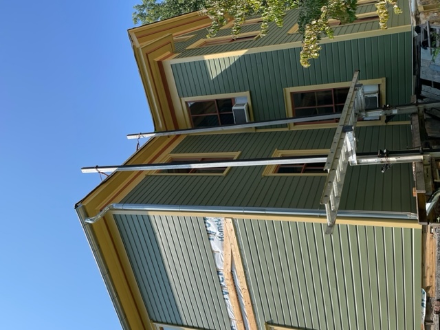

You're house project is looking great. It will be quite a showpiece when you are finished.
