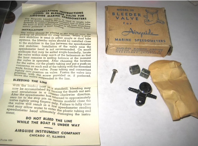

Weird...I posted recently here but my post is no longer up. So I'll try again! Just an update really. I'm still hard at work on the old Victorian, but did score a couple more parts...I found both of the pre-bent hydraulic lines for my power tilt NOS which is really cool. And perhaps my favorite find was an Airguide model 20 Bleeder Valve for my speedometer, also NOS in original box! Got it cheap too, as I don't think anyone knew what it was ever used for. Now my entire speedometer setup will be fully functional and all original Airguide equipment. Other than that I just replaced the tarp thet's keeping the Seafair dry while it waits for a garage. I do so look forward to restoring this boat!

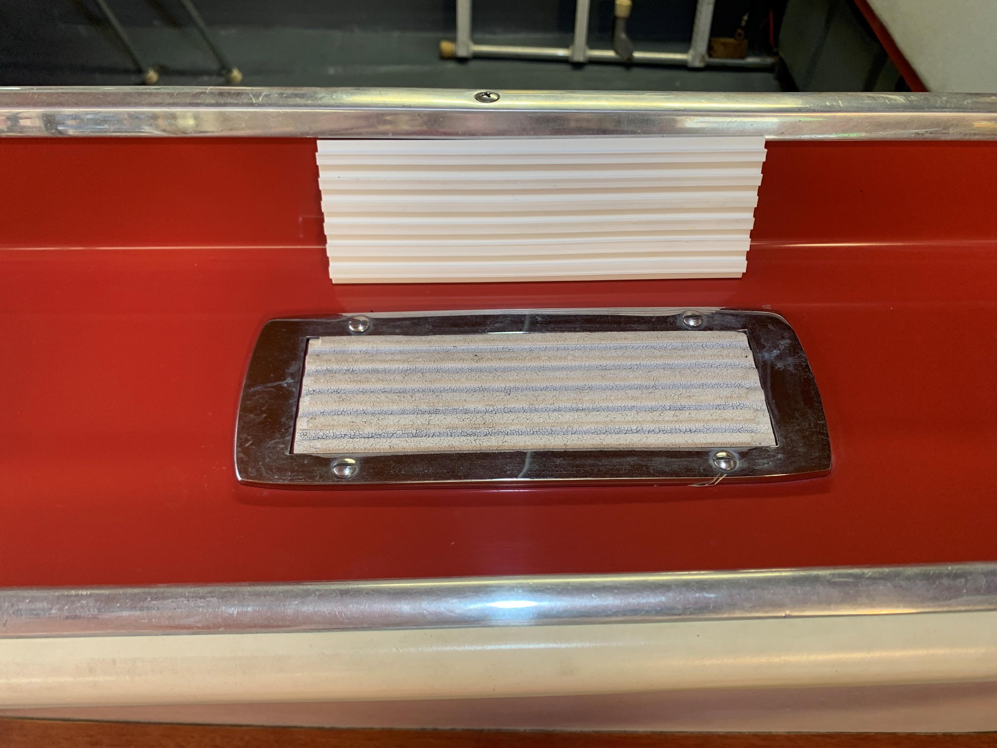

Have the NOS Atwood rubber step pads replaced and they look great.
Thanks for the generous gift.
That Airguide valve you found was installed originally in 59 on Mama Mia!
Think it was used as a damper for gauge pulsations.
