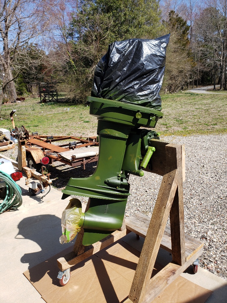

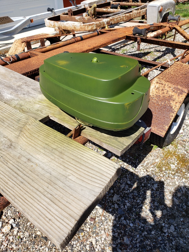

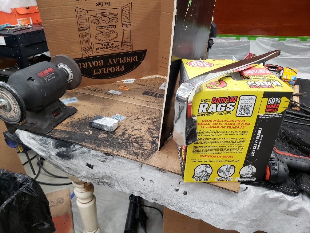

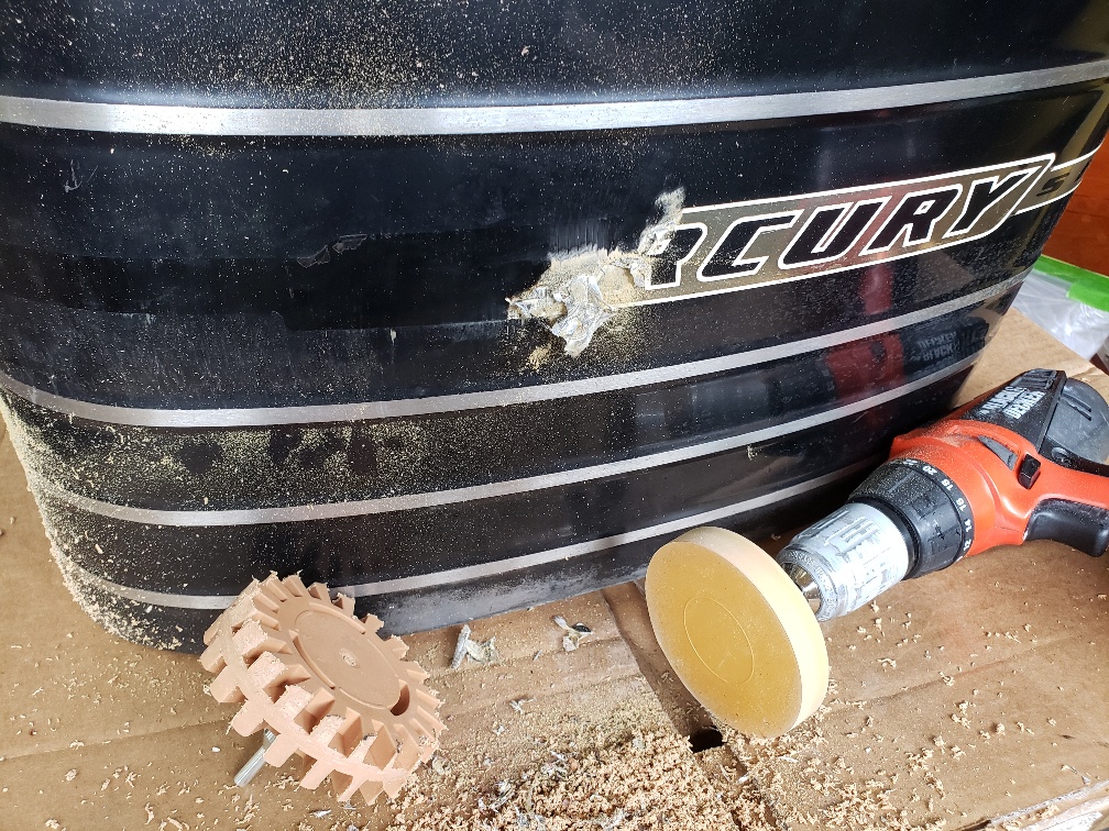

Last week I posted under the merc forum asking opinions if I should clear over the phantom black paint. The opinions were no, just the black.
Pictures of engine in a zinc suite below.
While ordering the paint, I came across a decal remover / eraser wheel and thought it would be worth a try for the wrap around cowling. I was skeptical, but if it worked, it would be better than sanding, solvent or heat. Amazon had a 2 pack with two different types; waffled and smooth. The waffled took a lot of effort and started to throw eraser crumbles quickly. I switched to the smooth and 10 minutes later the rear medallion and 1 side was done. A quick spray of the hose & wipe down revealed smooth metal ! No solvents, no scratches from sandpaper !
It's great when something actually works as advertised! I had never seen these before but would recommend the smooth one for easy decal removal. I got in a rhythm starting at the top edge and working in approx. 2-3" increments pressure on the decal while pulling the eraser wheel back and forth. It gets hot! The decal was pulled downward along with the eraser crumbles. Nice little gadget!
The following user(s) said Thank You: Dr.Go!

That is a pretty slick gadget. Glad it is working nicely for you. Fortunately my 71 Merc decals peeled off with slow steady pressure just using a blow dryer to warm them up. I am sure not all do that and I felt lucky since I didn’t know of that removal disc you showed. Likely age and sun exposure can affect if a decal will even peel off... I was thinking mine would not. I will be trying removing more decals this summer , so thanks for sharing in case I need this as a back up plan.

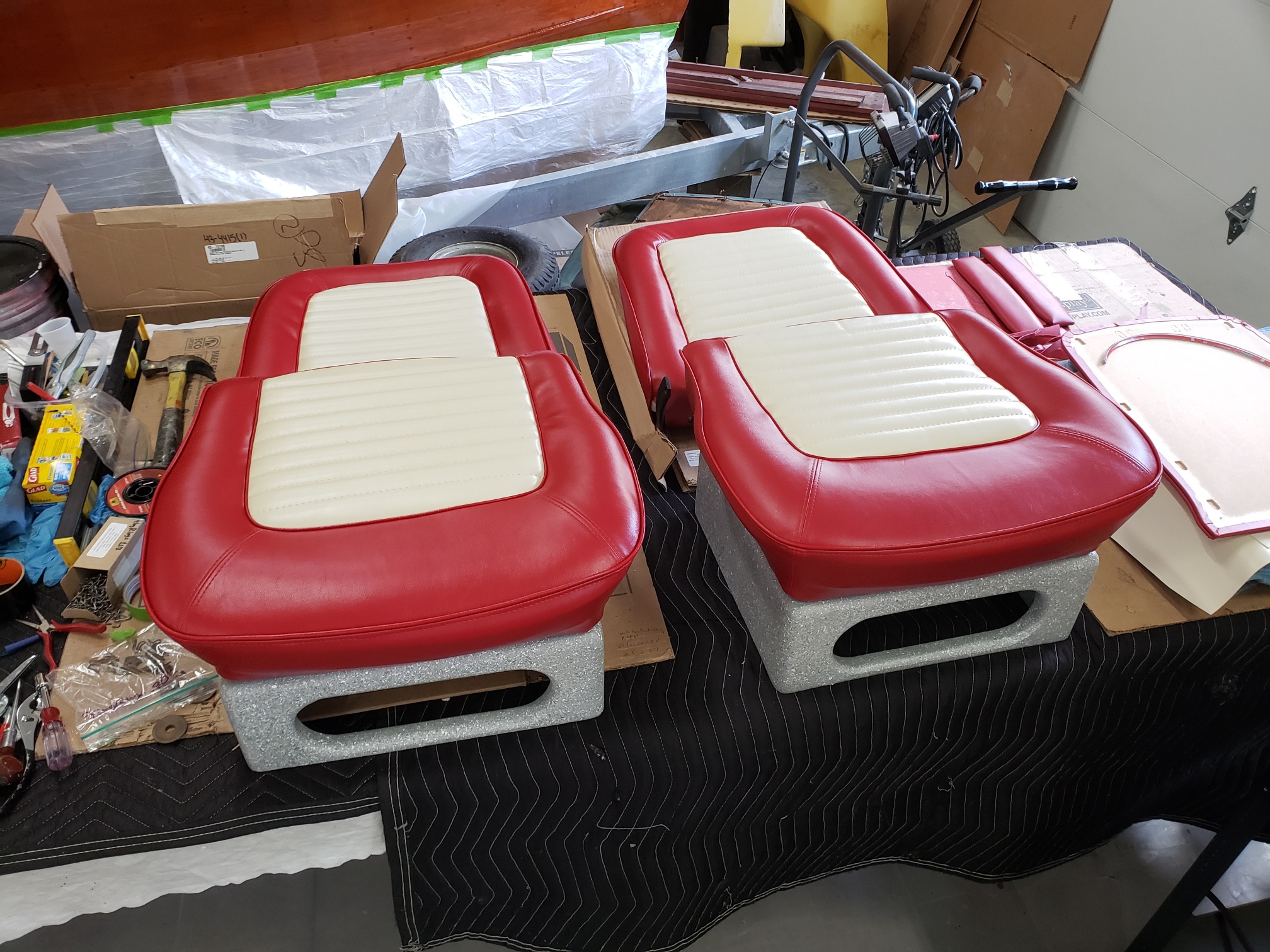

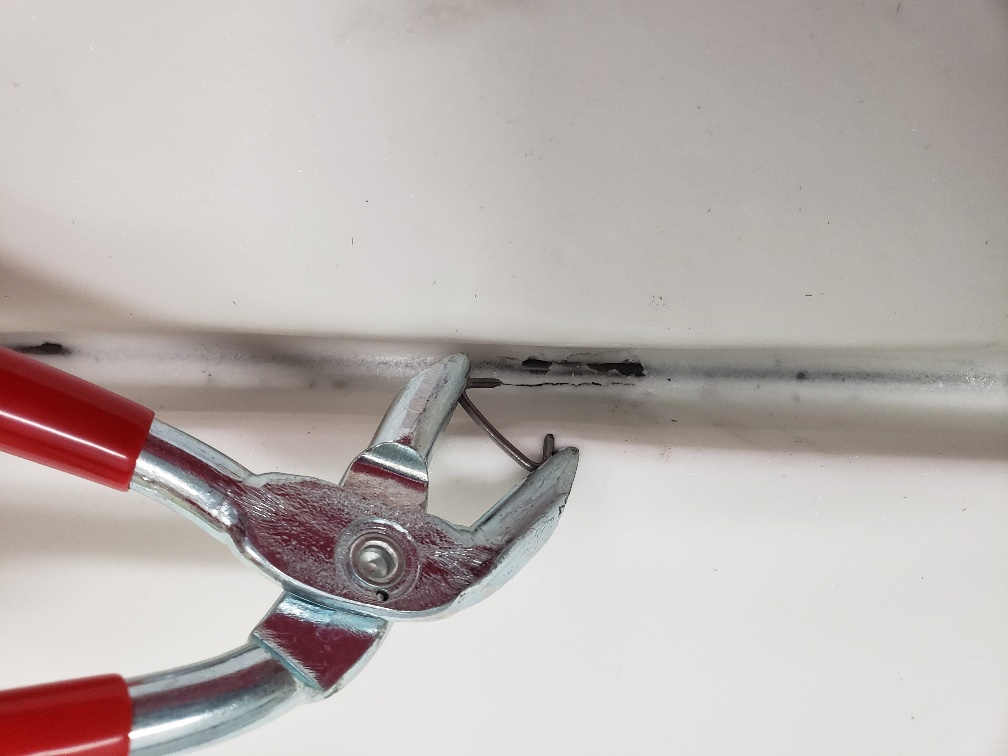

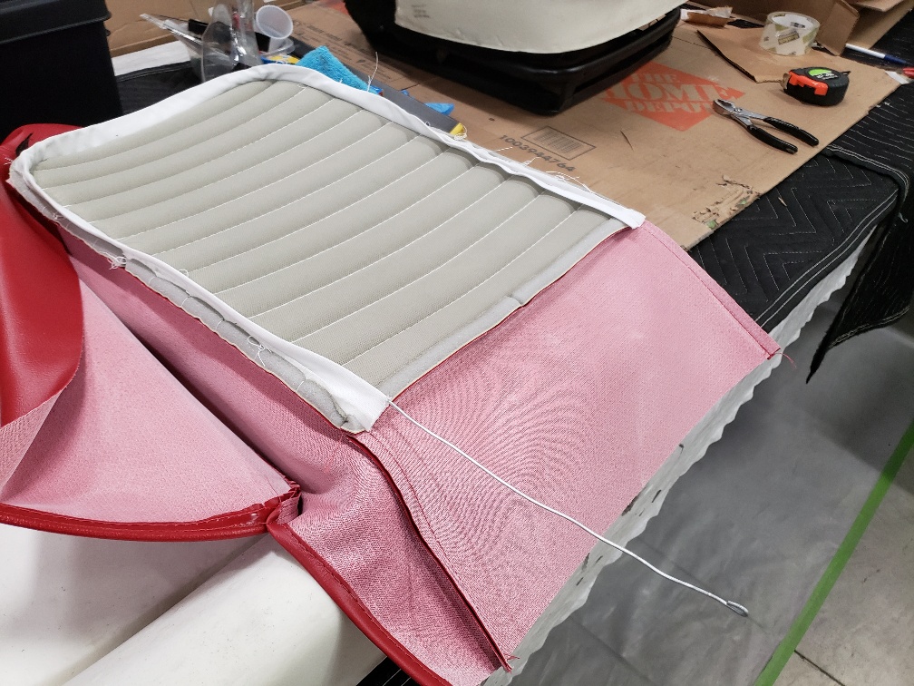

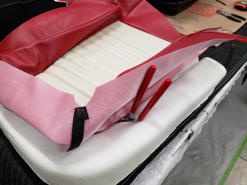

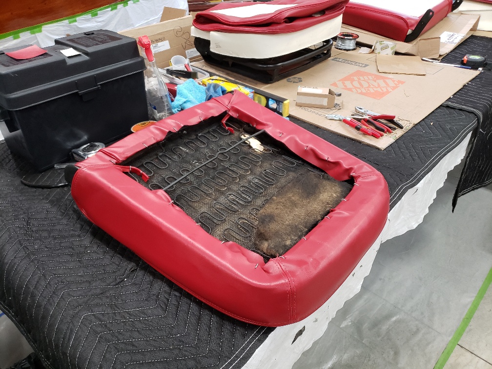

Front Seat Upholstery !
pic 329 seat frames, a friend touched up a coupe of welds and the painted
pic 333 new foam is hog ringed in
pic 334 listing wires inserted
pic 335 and hog ringed in to the seat frame as well
pic 336 pulled tight and hog ringed to the rear of the frame
pic 337 composite seat bases bolted to seat frames
pic 338 rear seat panels snapped in place
pic 340 front view
all vinyl wiped down with a UV inhibitor protectant

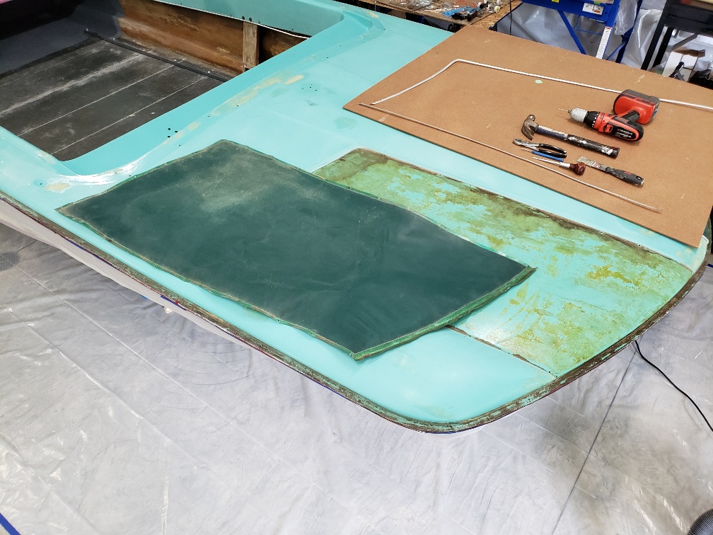

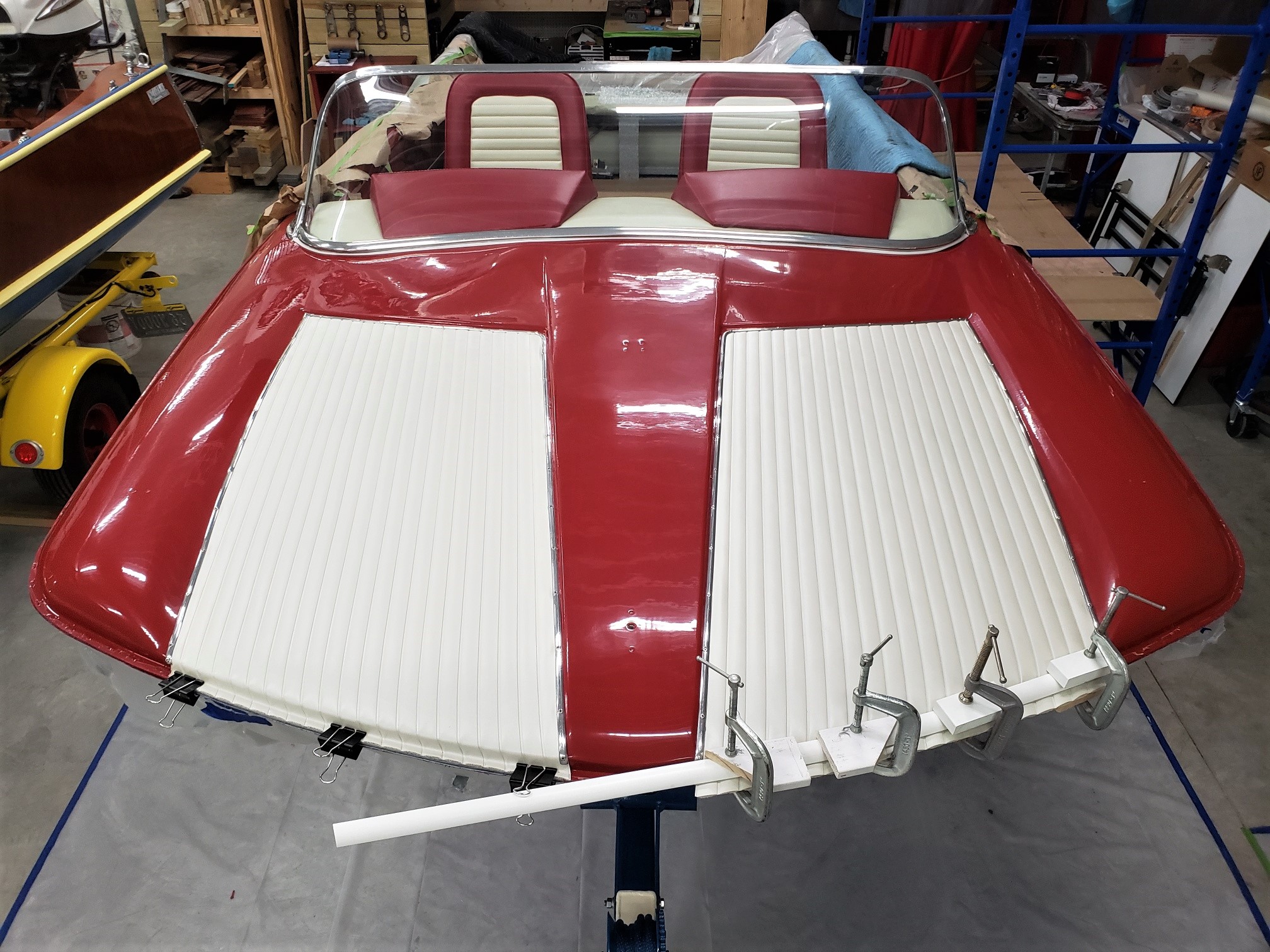

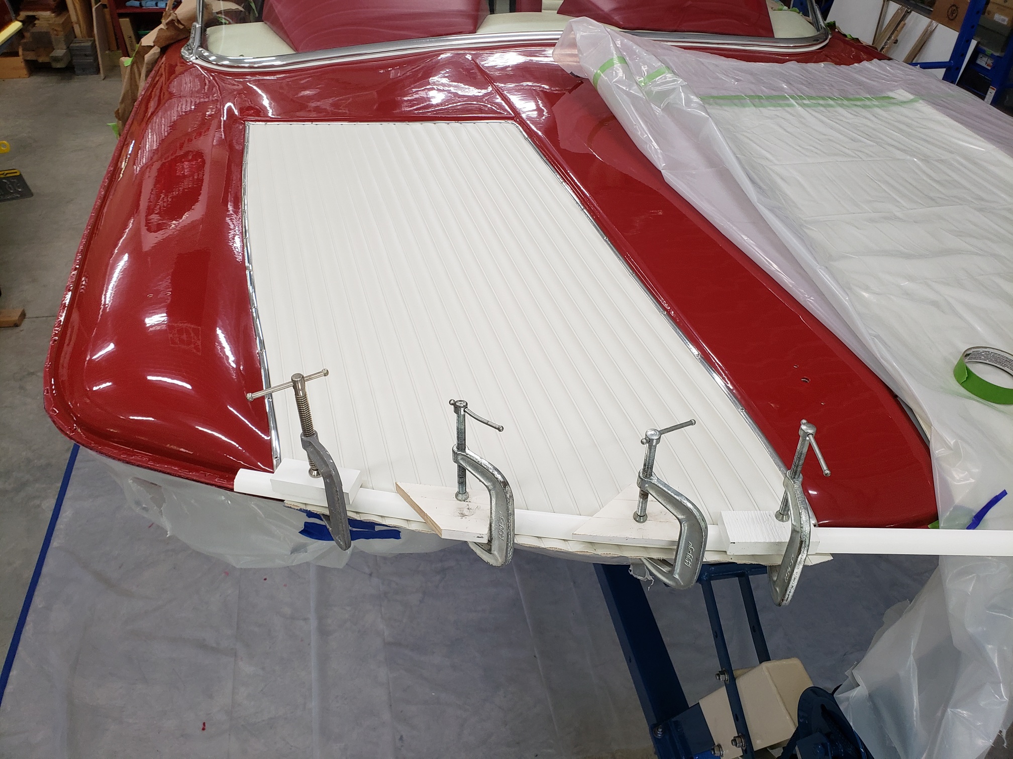

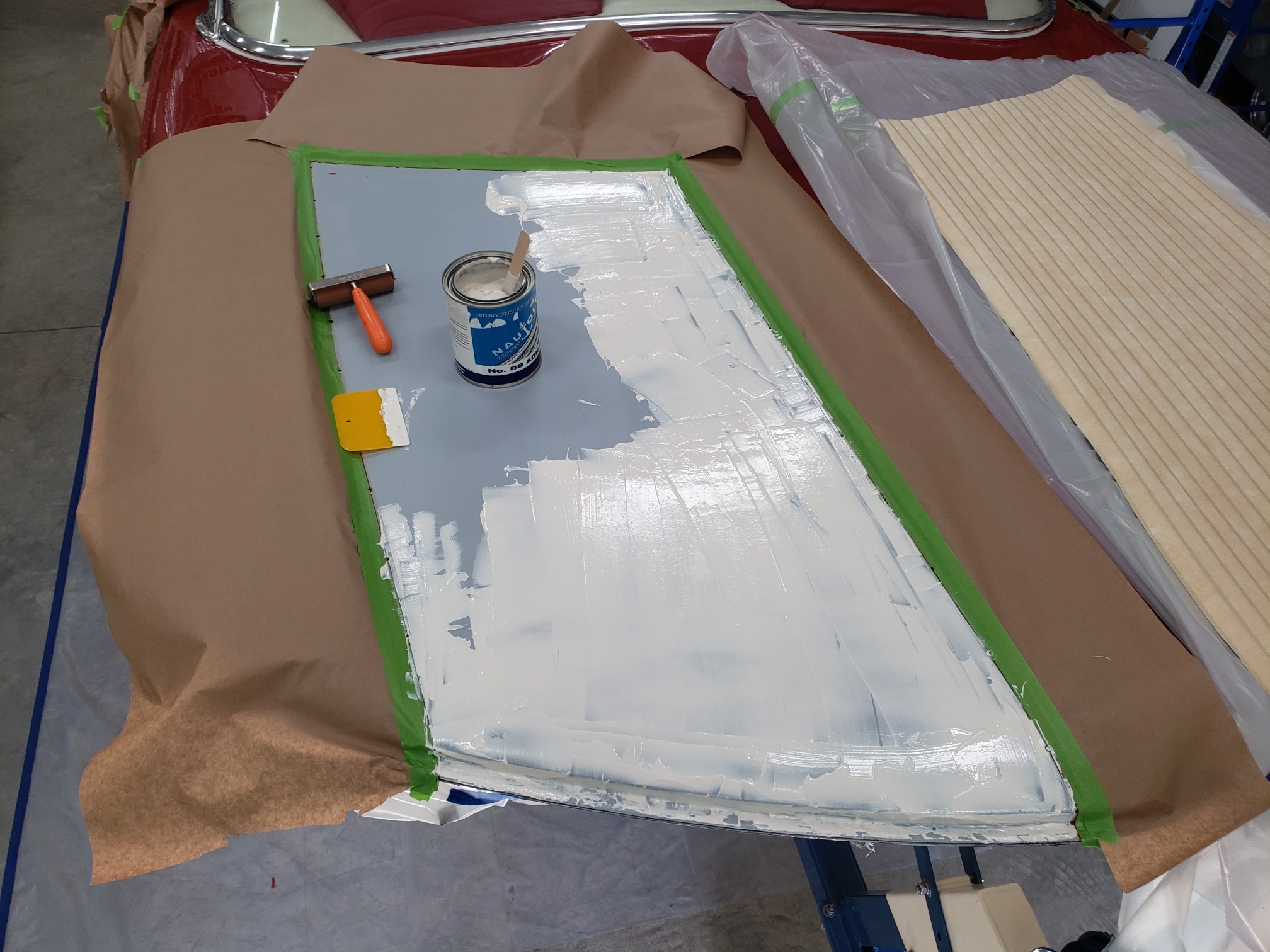

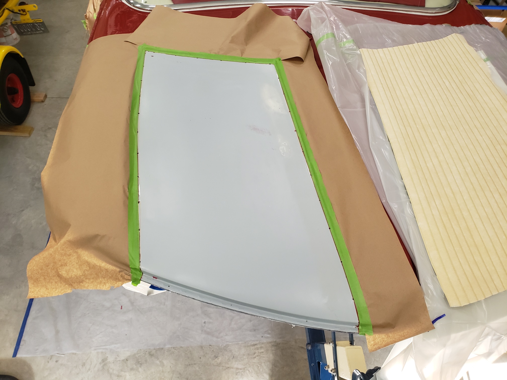

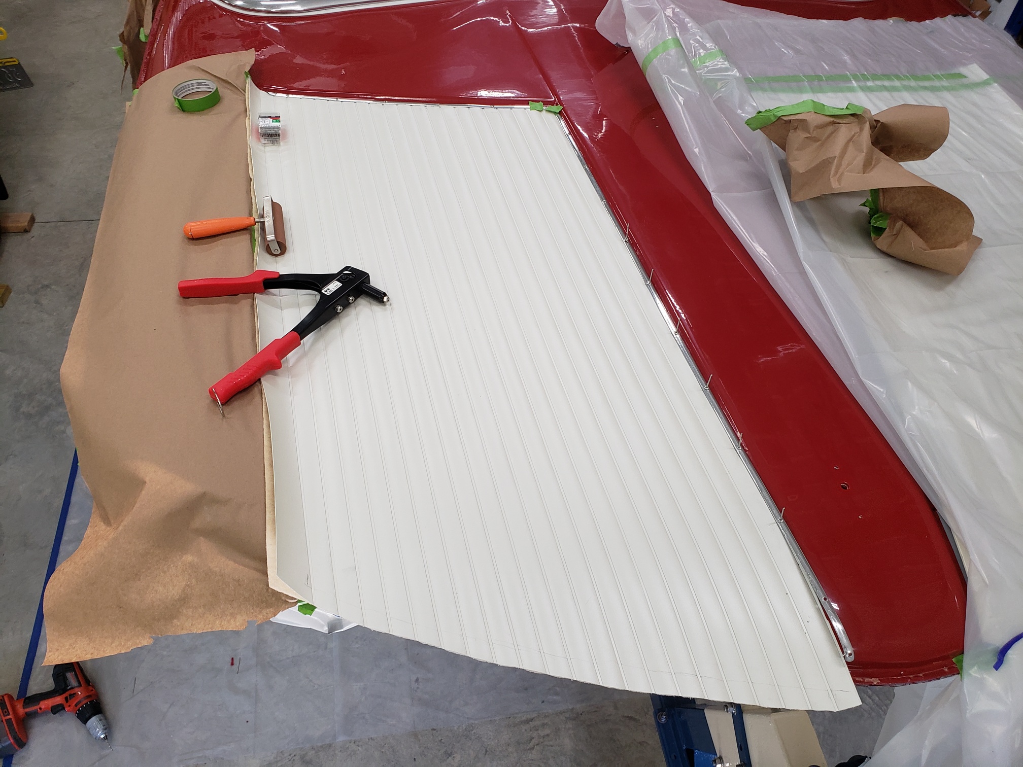

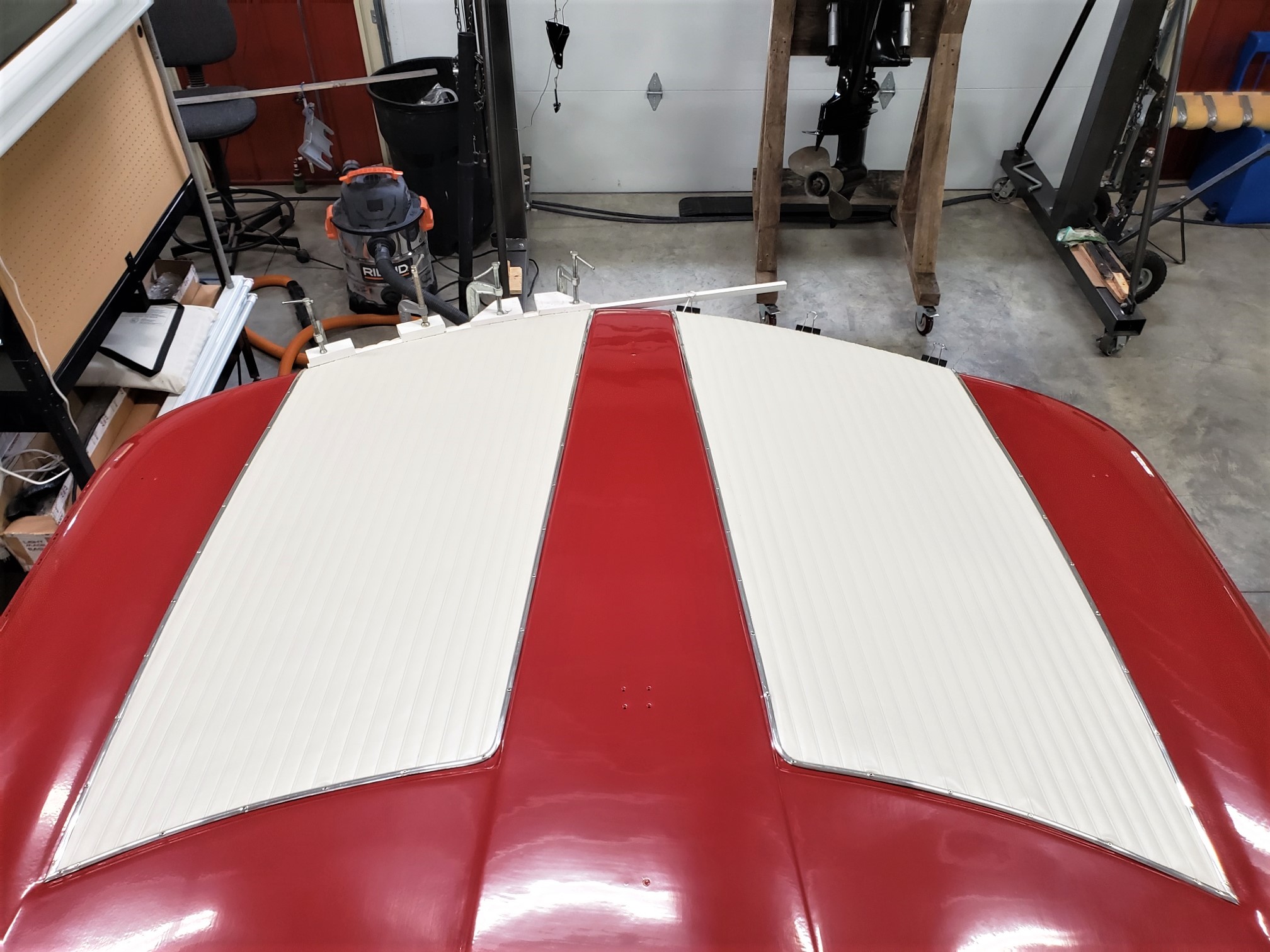

The embossed vinyl, color to match the seat inserts, finally arrived.
Pic 341 the old vinyl I removed which was probably the a replacement as well. It started as a metal flake zodiac product
Pic 342 brochure shot
Pic 343 another model custom craft example
Pic 344 prepping the area
Pic 345 nautolex adhesive
Pic 346 new vinyl applied, rolled and trim getting stainless rivots
Pic 347 trim finished and front edge clamped to rub rail lip. let cure for a few days
Pic 348 other side done
Pic 349 from the windshield
its on there now, no going back, but comment away...You're gonna love the retro look or hate it !
rub rail goes on next-

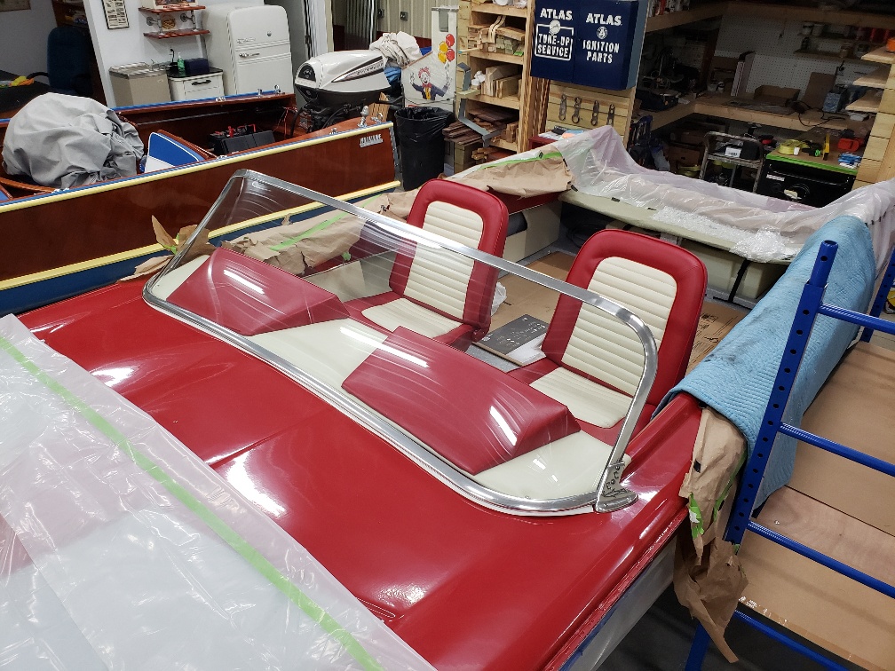

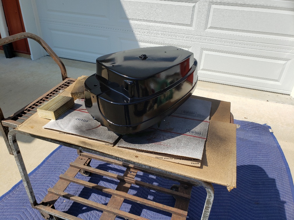

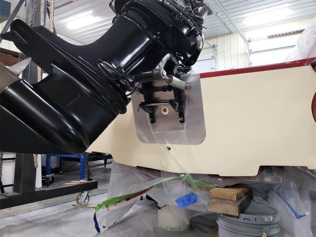

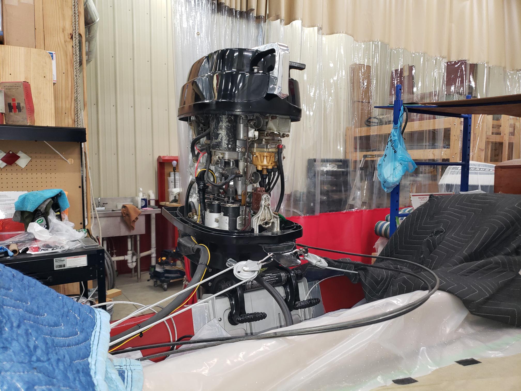

Raining in the mid Atlantic today, some shop time this morning to get the Merc 1000 hoisted onto the transom.
Some pics of the primer, paint and polish of trim. Still need to get the decals and trim on the wrap & top cowl.
Still waiting on my chrome...

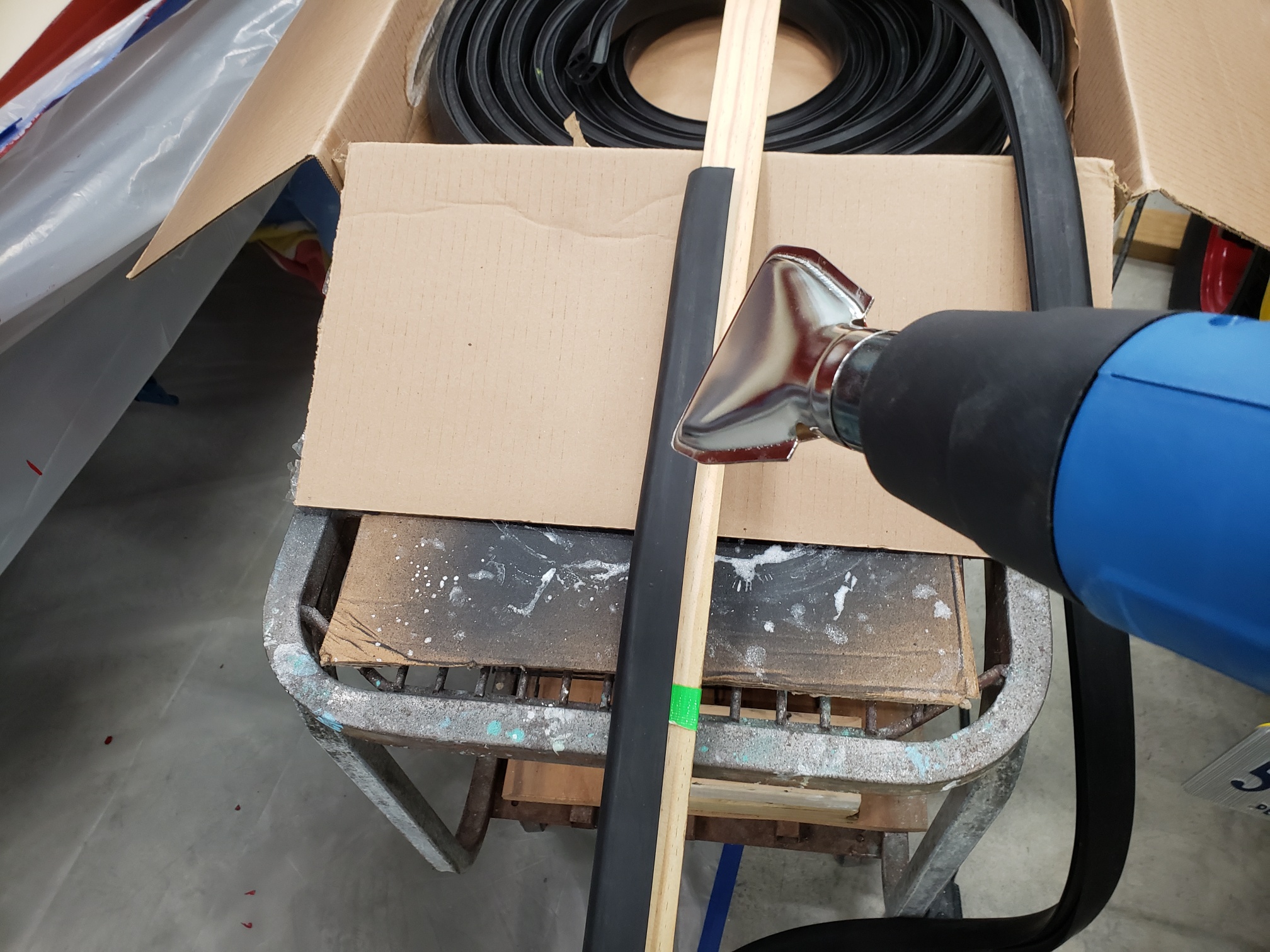

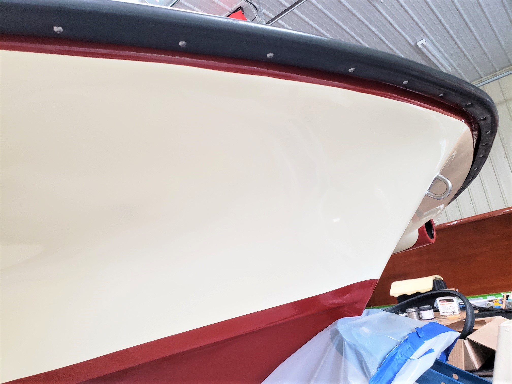

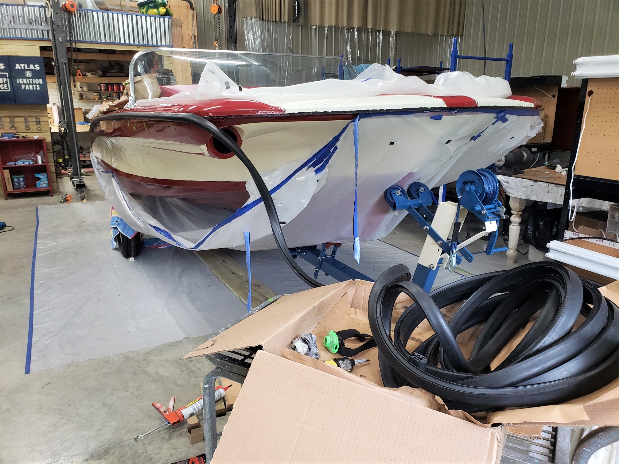

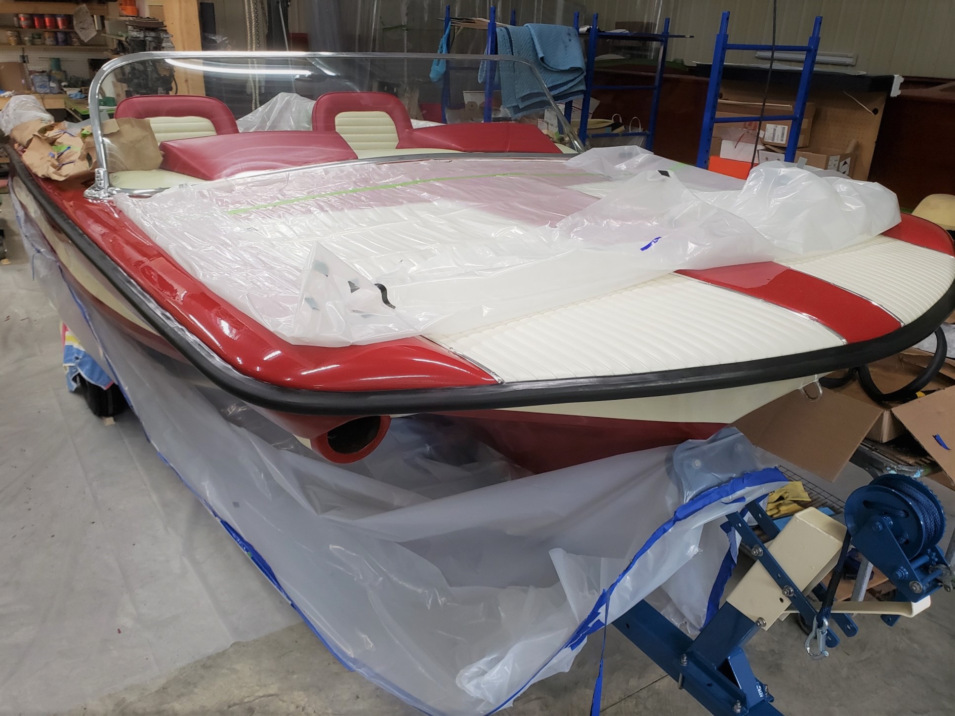

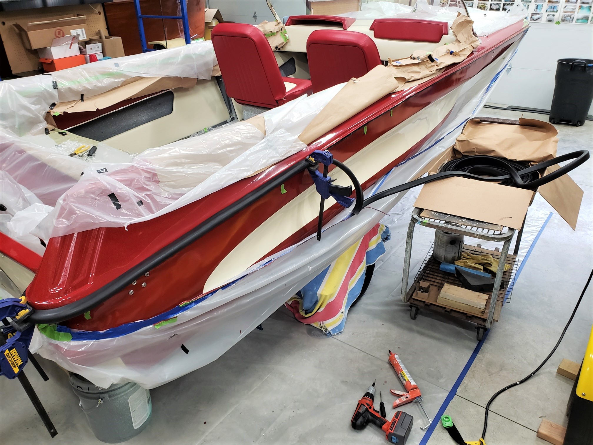

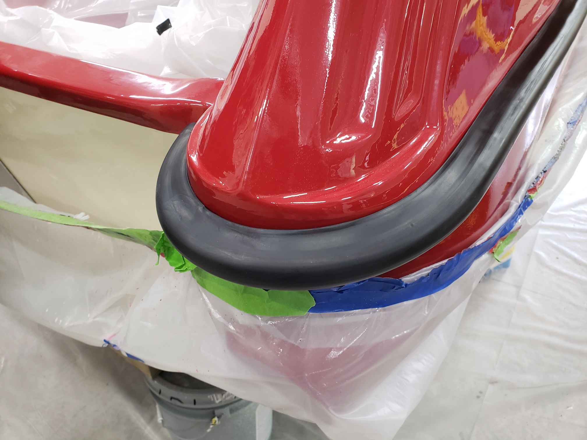

Got into the Wefco rub rail this weekend.
Pic 350 Warmed roll under tarp with heater but the tight radius around the tail fins needed some extra heat.
Pic 351 around the tight curve
Pic 352-3 headed up the starboard side, tried to place new screws between hull flange staples and previous holes
Pic 354 around the bow
Pic 355 view of the new screws at bow
The Wefco 1/2 G-2 profile fit great!

Excellent work… looks like care and patience are key to getting nice results like you show. That boat is really looking nice!

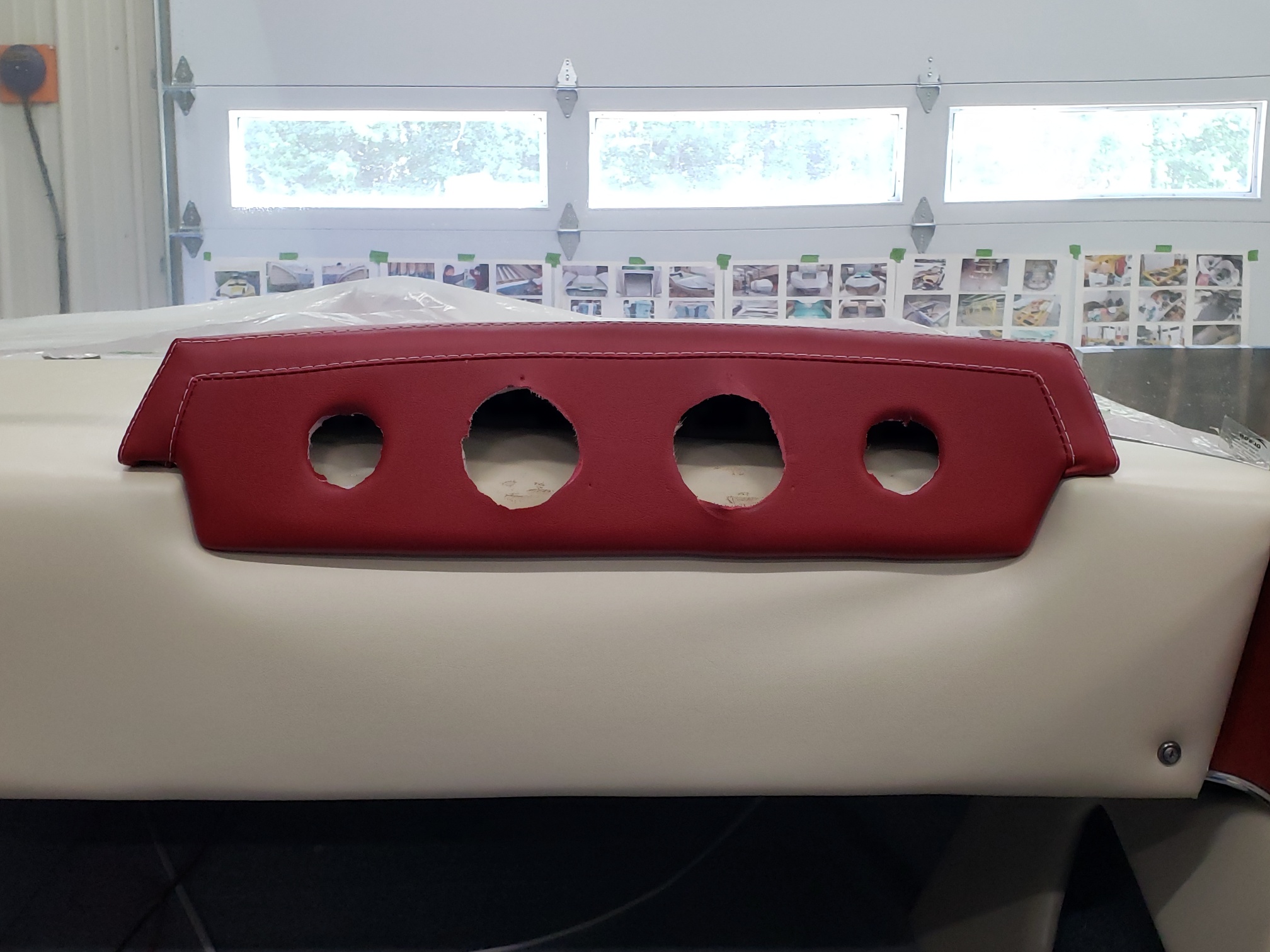

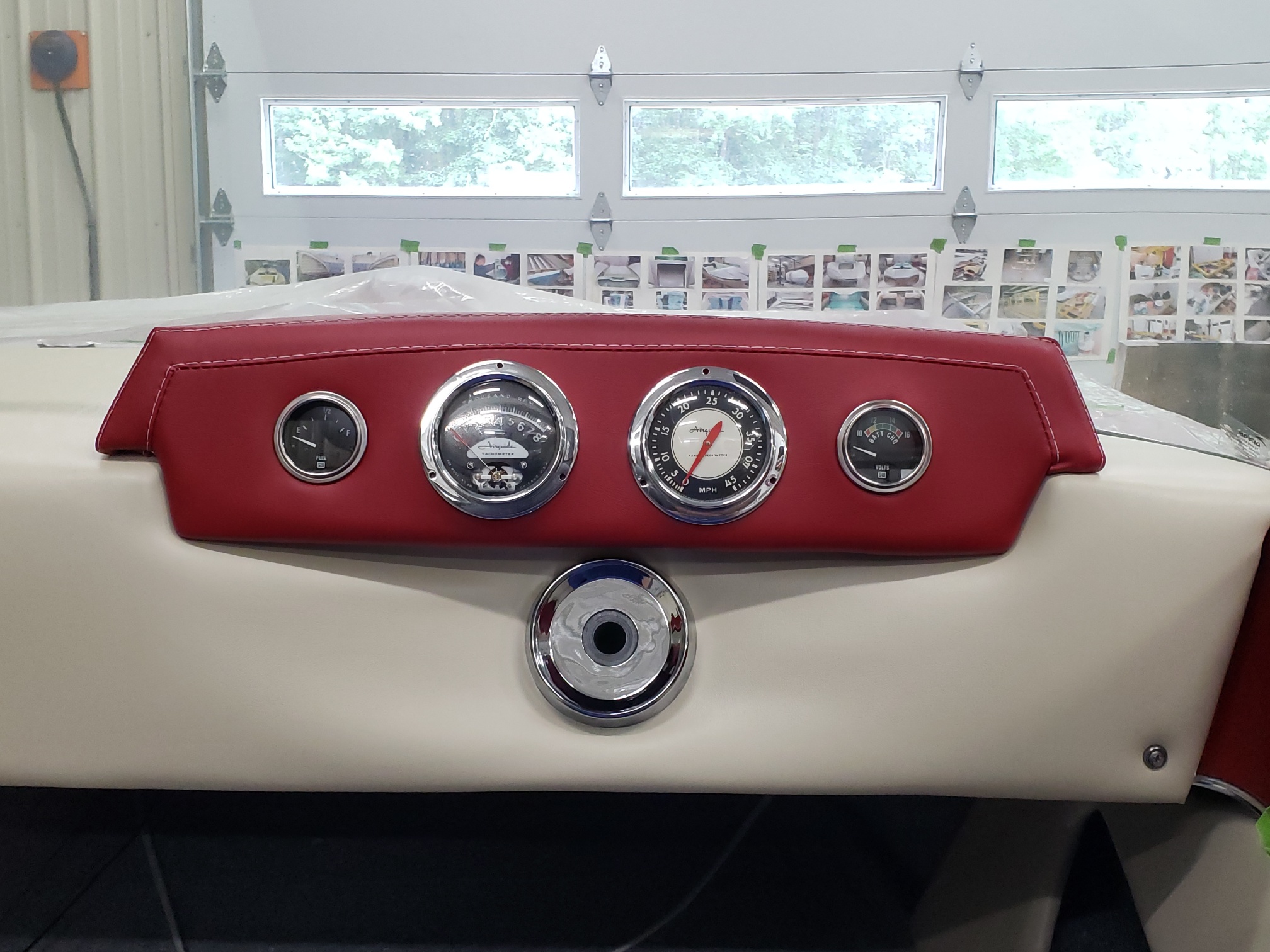

Gauges dry fit this morning...left to right: fuel, tach, speedo, battery...sound like the right placement?
thx
'64 Custom Craft Sunray - cont from Coosa transoms 5 years 2 months ago #145344
  • Dr.Go!
  • Dr.Go!'s Avatar
  • Posts: 1719
  • Karma: 19
  • Thank you received: 125
Very clean and nice installation! As far as placement, the first person to please is yourself. JMO, but if you like it, that is all that really matters. Pretty classy looking.
The following user(s) said Thank You: Eric Z

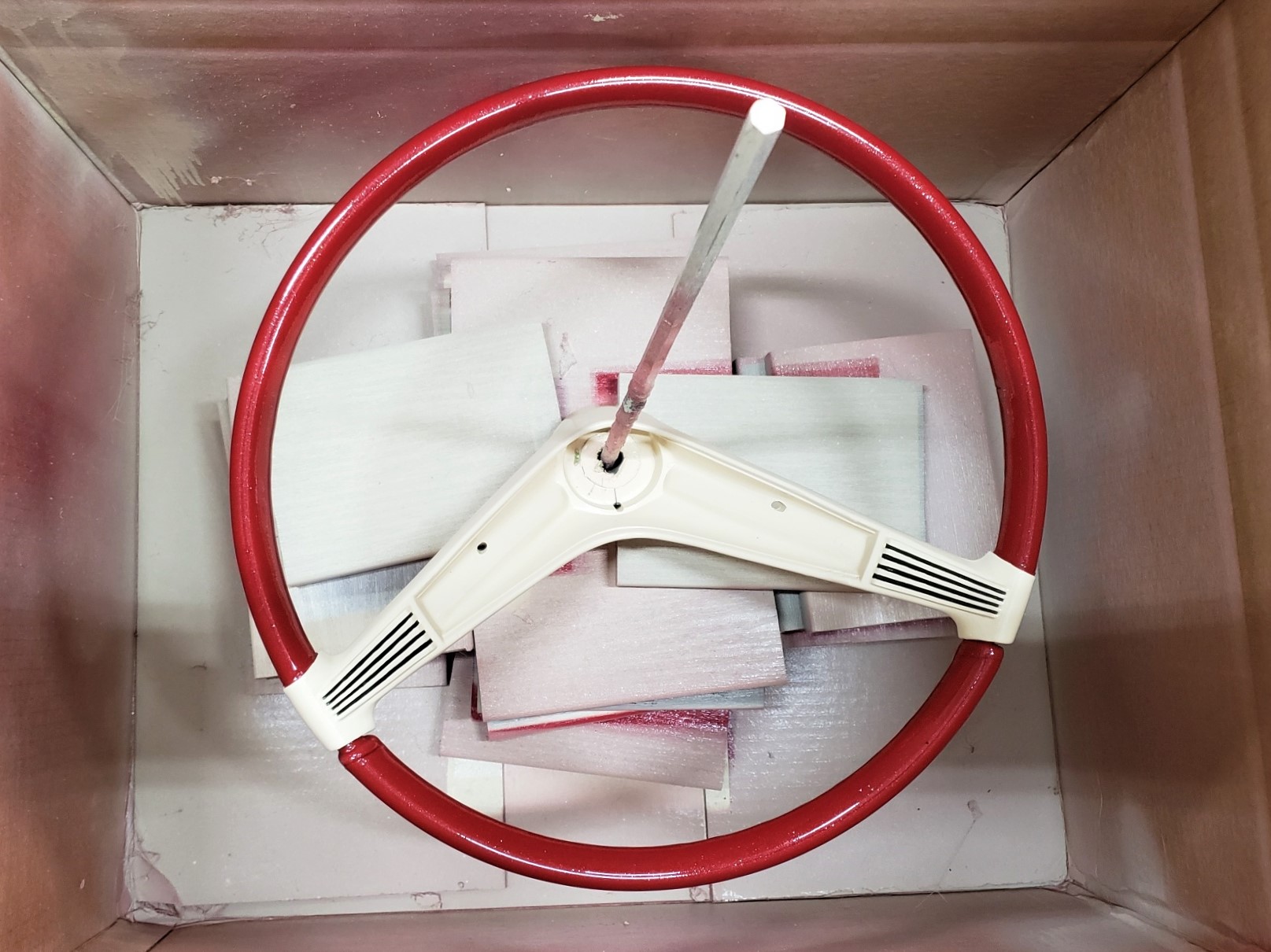

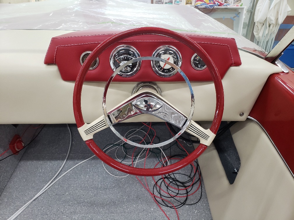

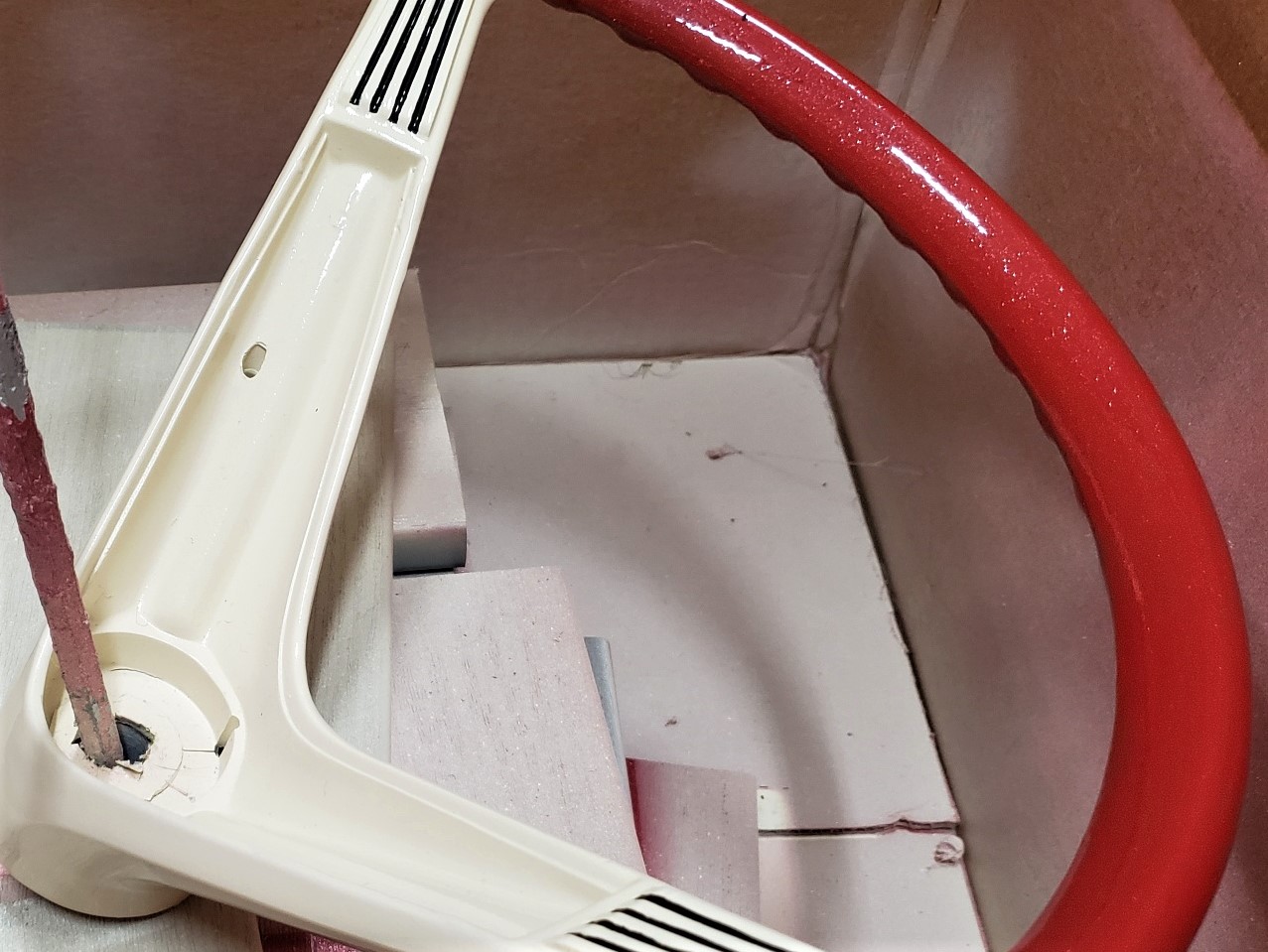

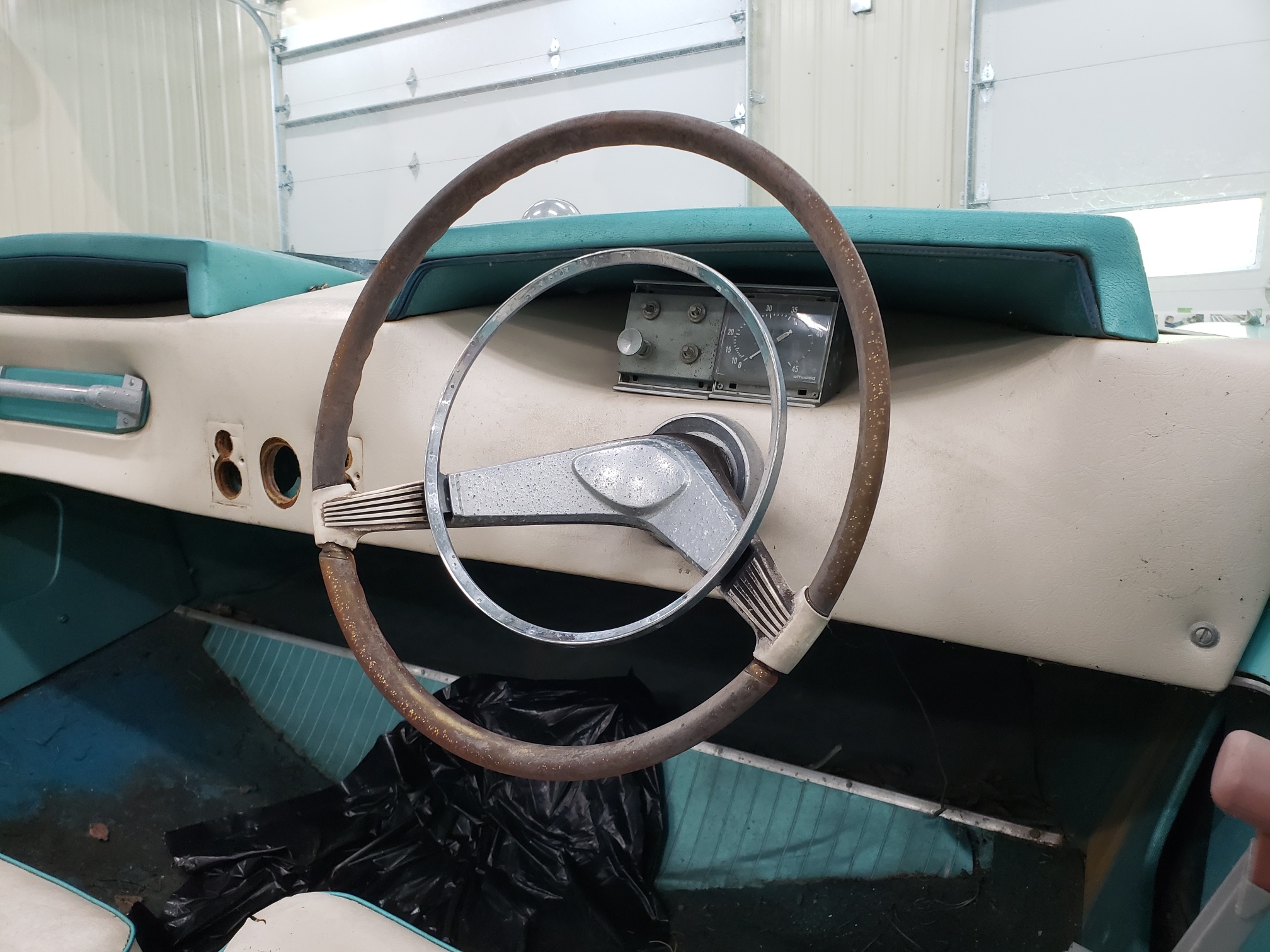

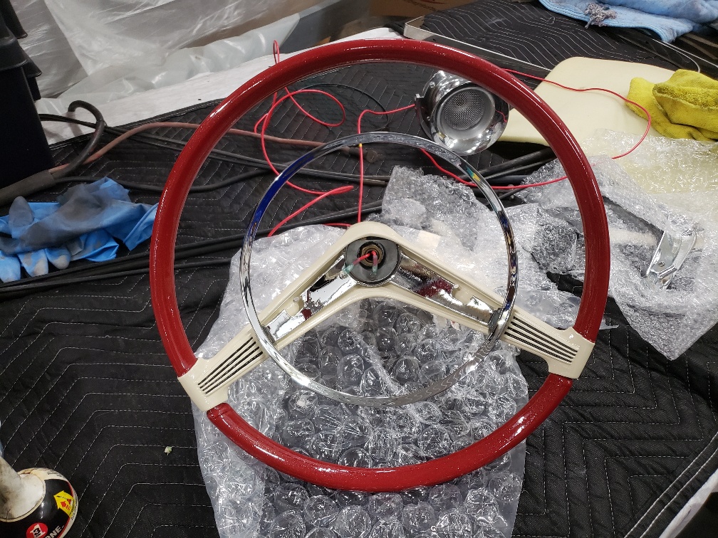

Got the horn ring and boomerang insert back from chrome shop for the steering wheel !
Cracks were filled, sanded, primed.
Colors applied.
Red got some microflakes layered in with the clear to resemble the original wheel molded with flakes.
I love the result!

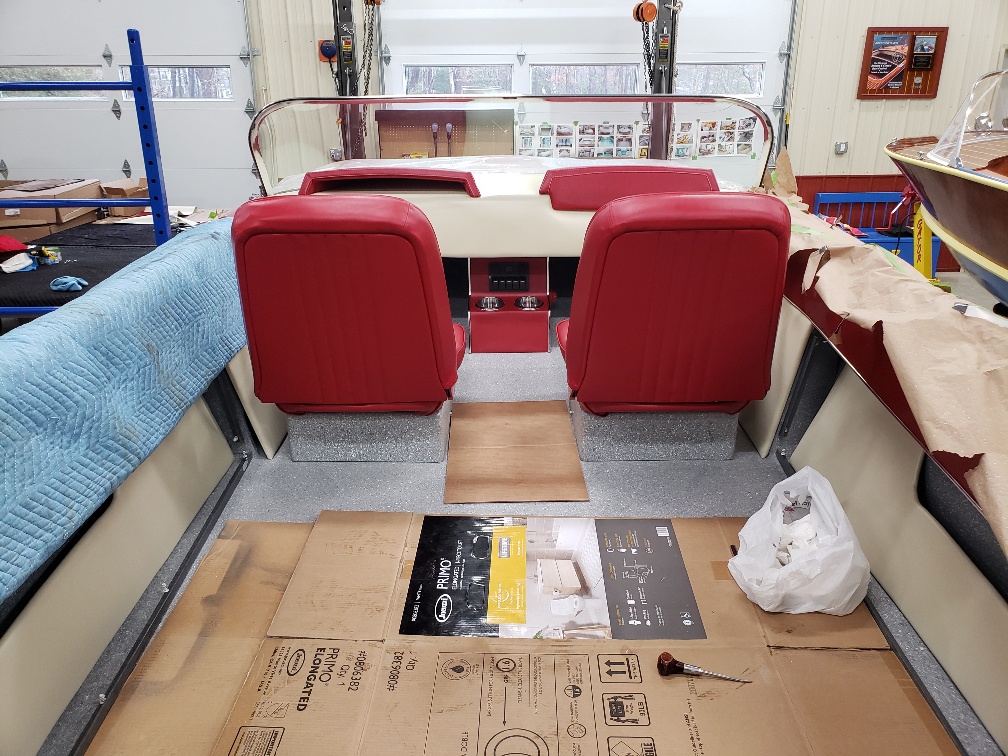

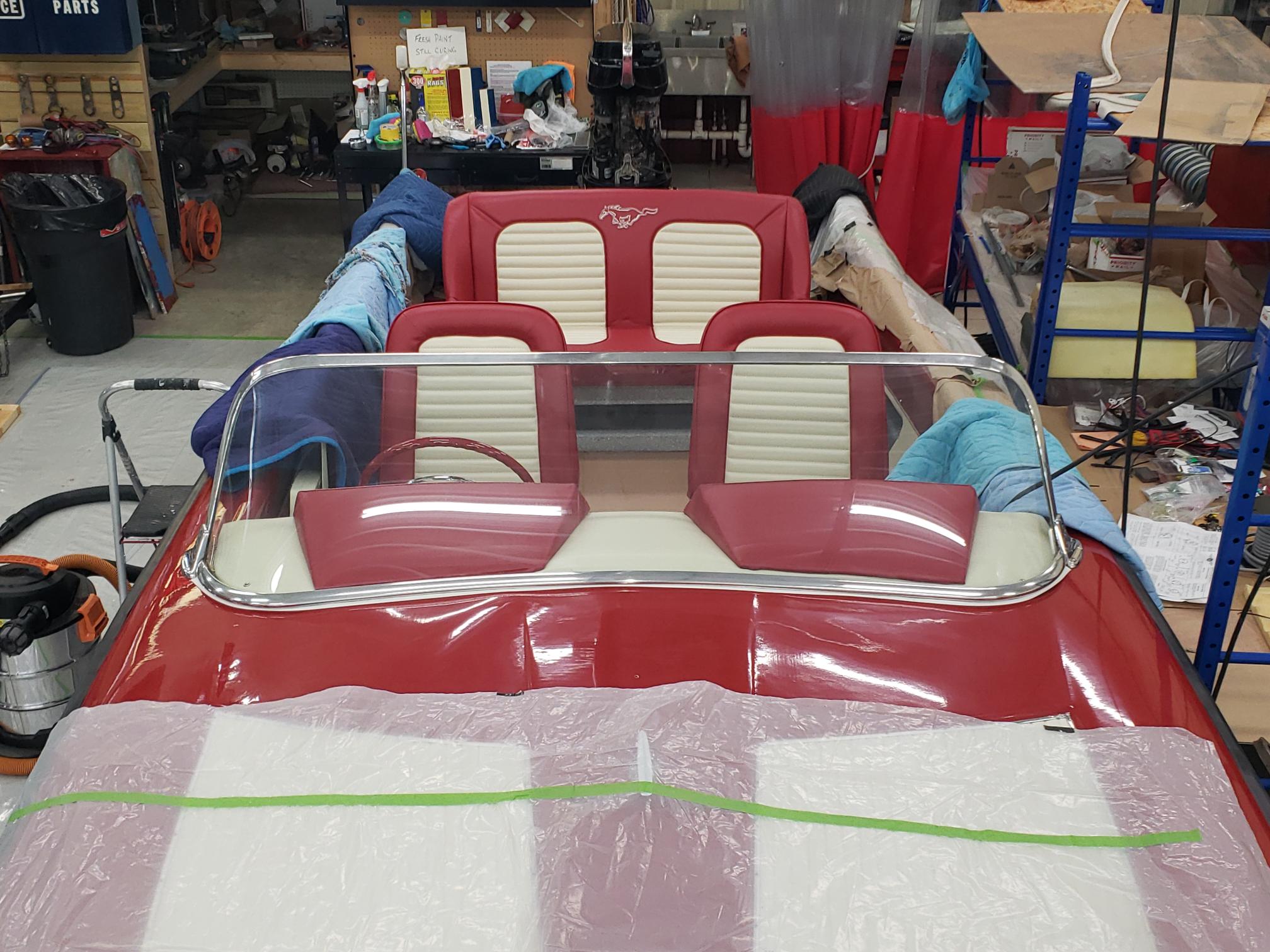

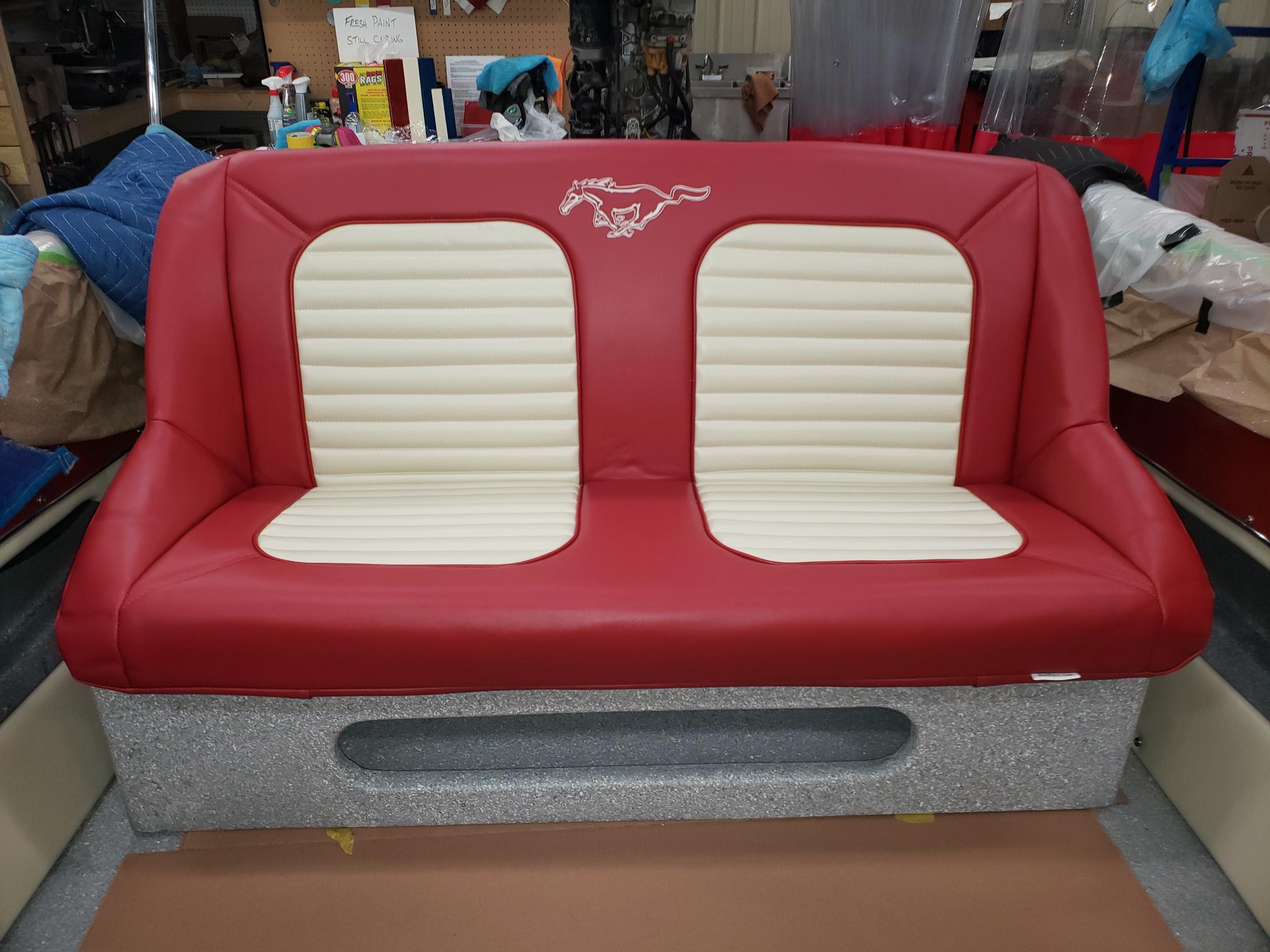

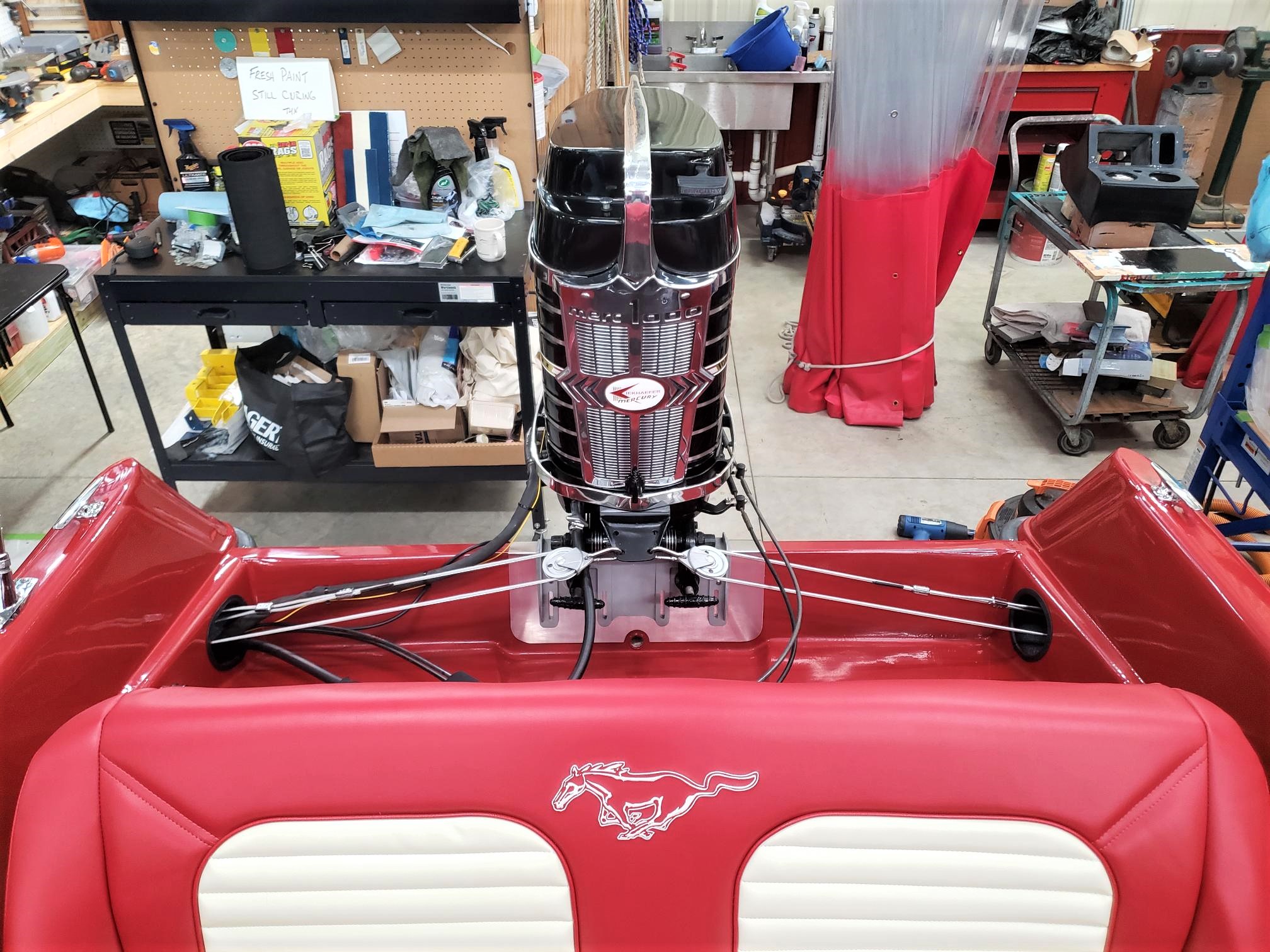

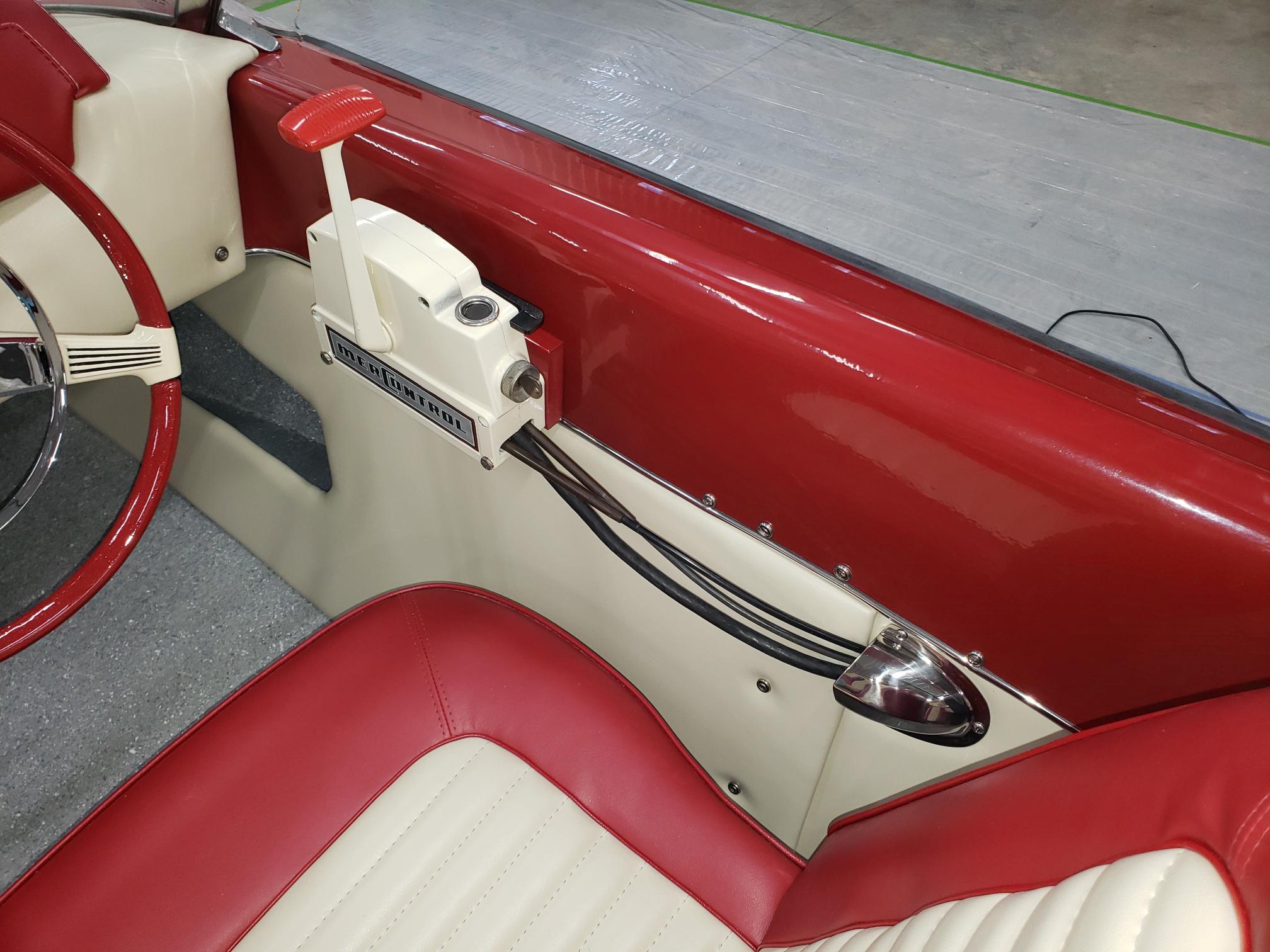

Been a long, long time... got into classic cars and other things came up in 2022. Finally back on the Sunray and will have it in the water this summer.
440 control box mounted
441 top cowl installed and cables run
444 rear seat lifted in and new upholstery cover installed, need to heat-steam out some wrinkles
445 nice match to the front seat upholstery
running wire and testing some electrical circuits next

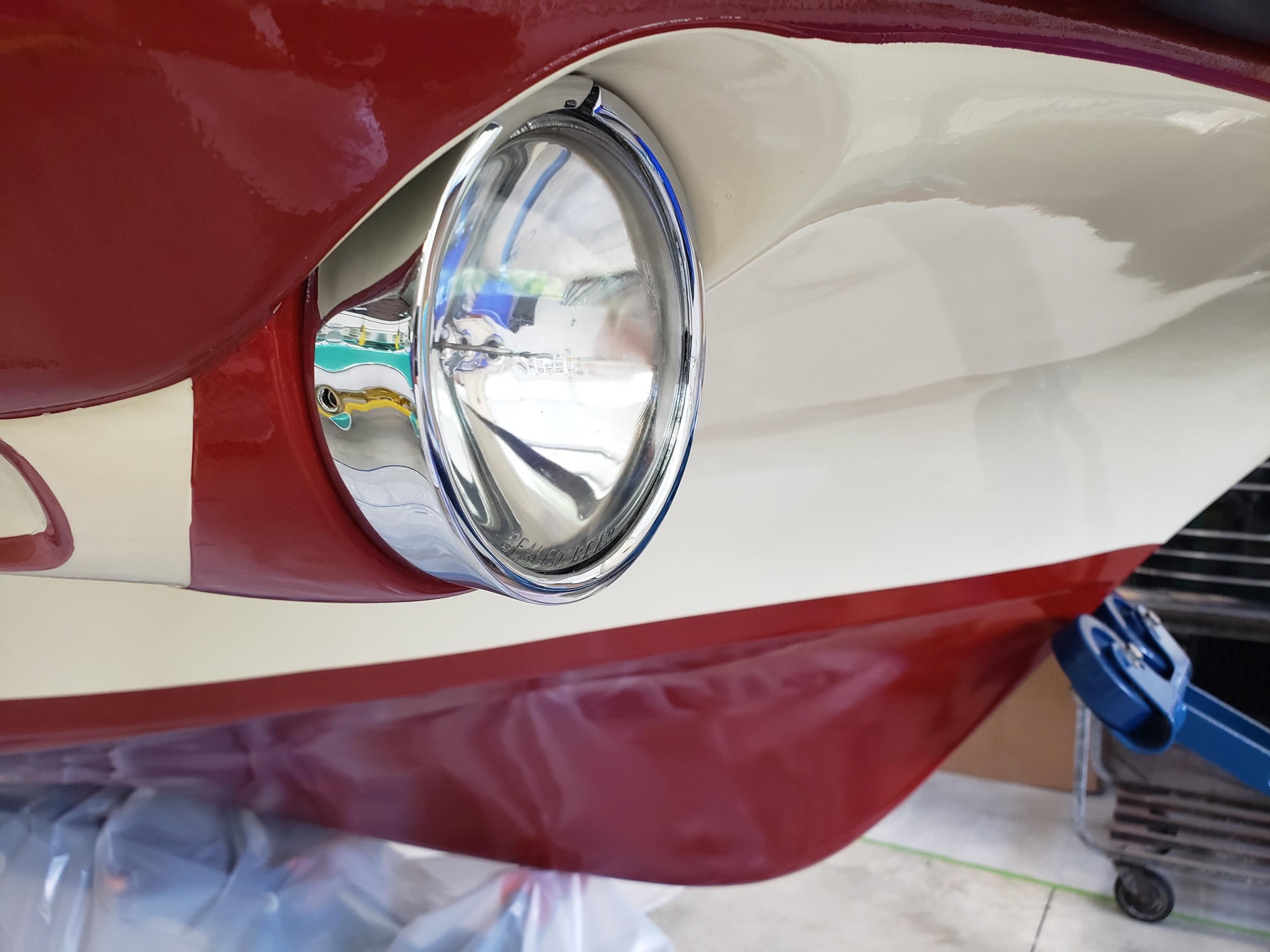

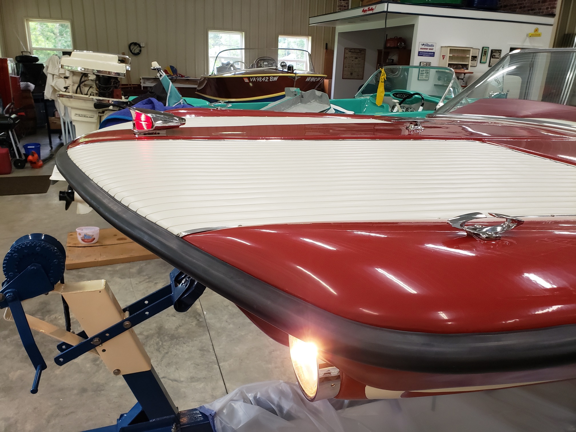

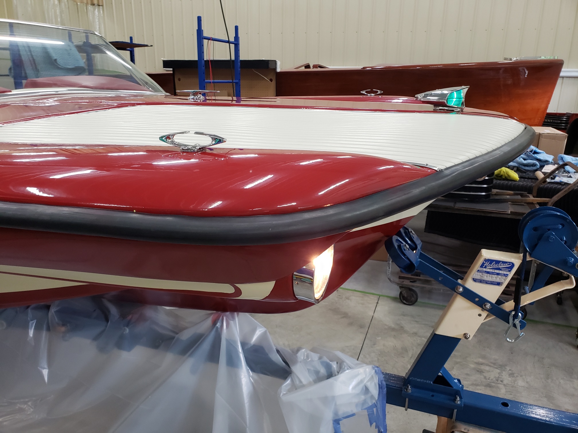

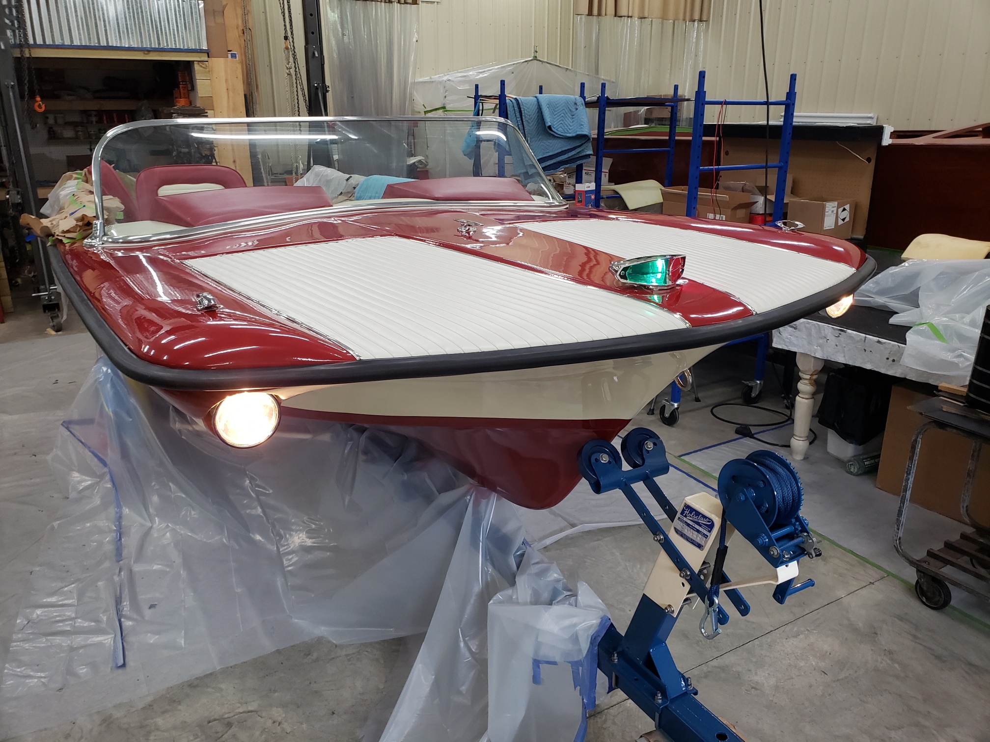

Almost done.... 3 more weeks till we debut the Custom Craft in St Michaels at the boat festival, link below, need to get her done!
chesapeakebayacbs.org/
'64 Custom Craft Sunray - cont from Coosa transoms 3 years 5 months ago #148007
  • Eric Z
  • Eric Z's Avatar Topic Author
  • Posts: 237
  • Karma: 2
  • Thank you received: 19
some details and ready to roll out ...
'64 Custom Craft Sunray - cont from Coosa transoms 3 years 5 months ago #148008
The picture showing the bow lights is awesome! Definitely a very unique boat! Good luck at the show!
