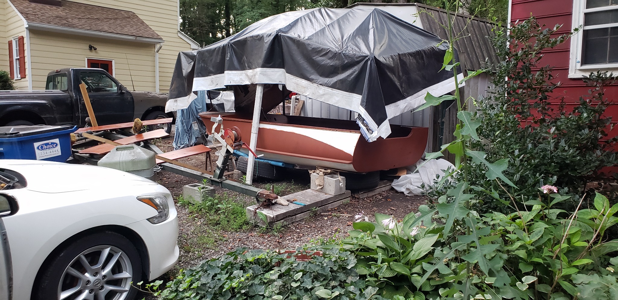

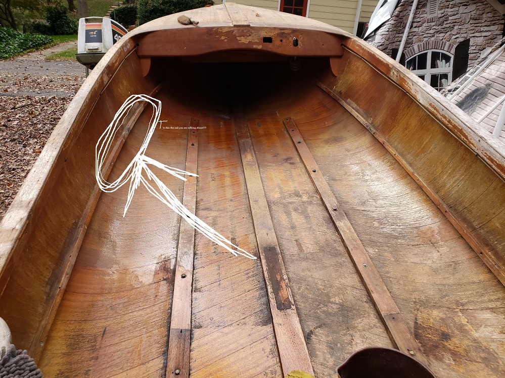

Whirlwind 1961 restoration started 7 years 1 week ago #141275
trying to get it going before bad weather sets in. wood seems pretty solid

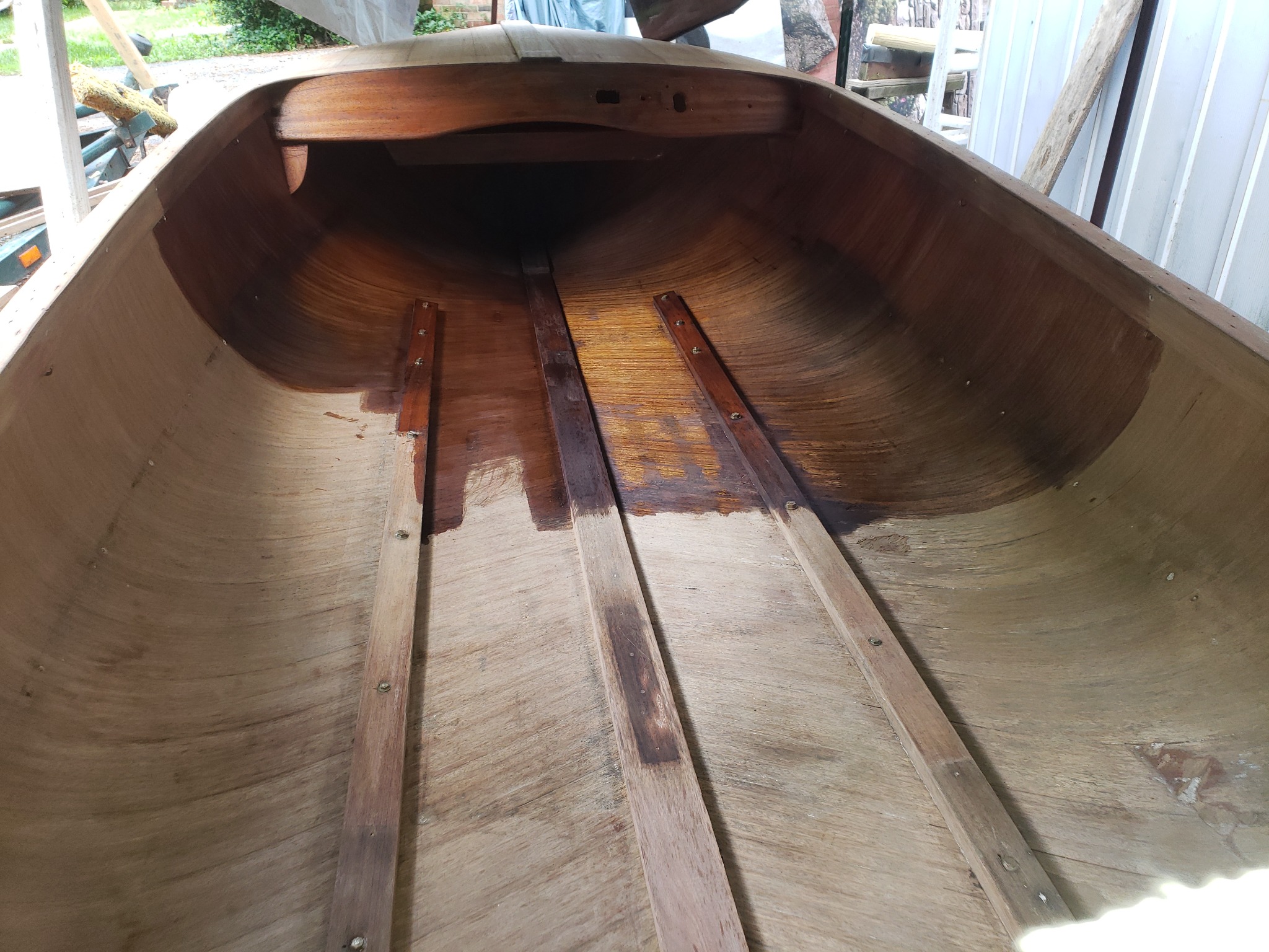

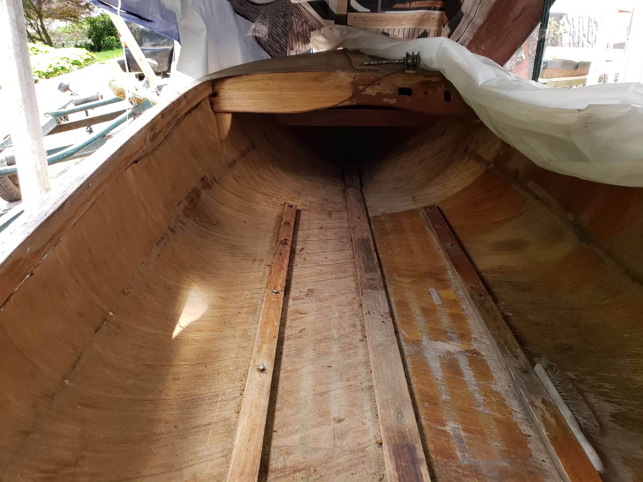

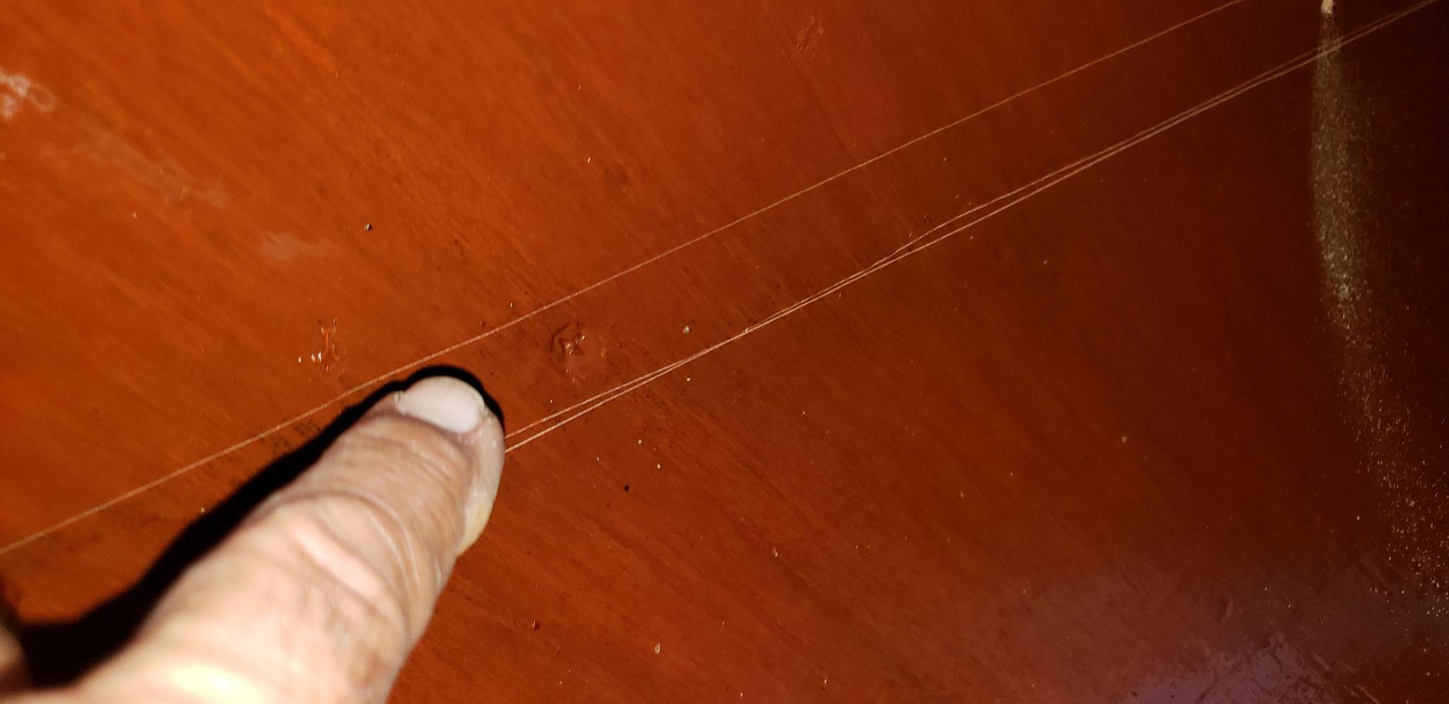

Whirlwind 1961 restoration started 6 years 5 months ago #142311

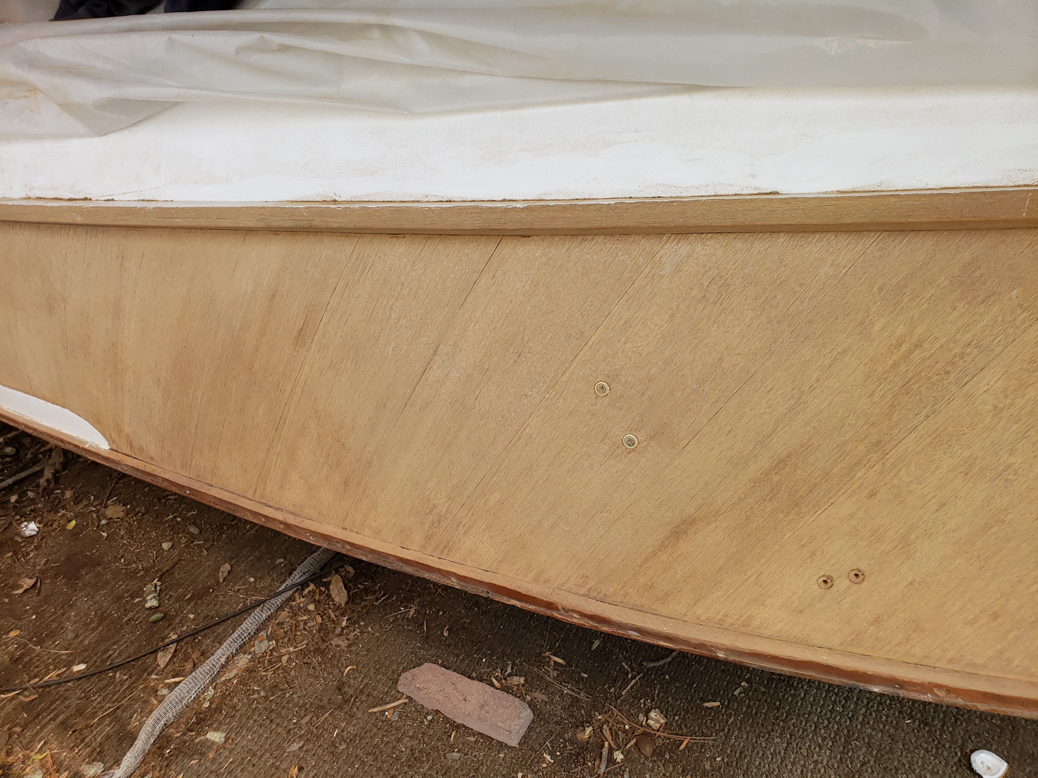

OK, i think i'm done with the stripping and 80 grit sanding after. Just a few somewhat bad spots of a layer of rot I do not plan to bleach, CPES for next step, not cheap bit the bullet and ordered the 2 gallon package .
you can't see this in the picture but far under the bow where the shelf starts , i did not strip just too hard to get to and it was in good shape. I don't think it will ever be noticed anyway.
Whirlwind 1961 restoration started 6 years 5 months ago #142336

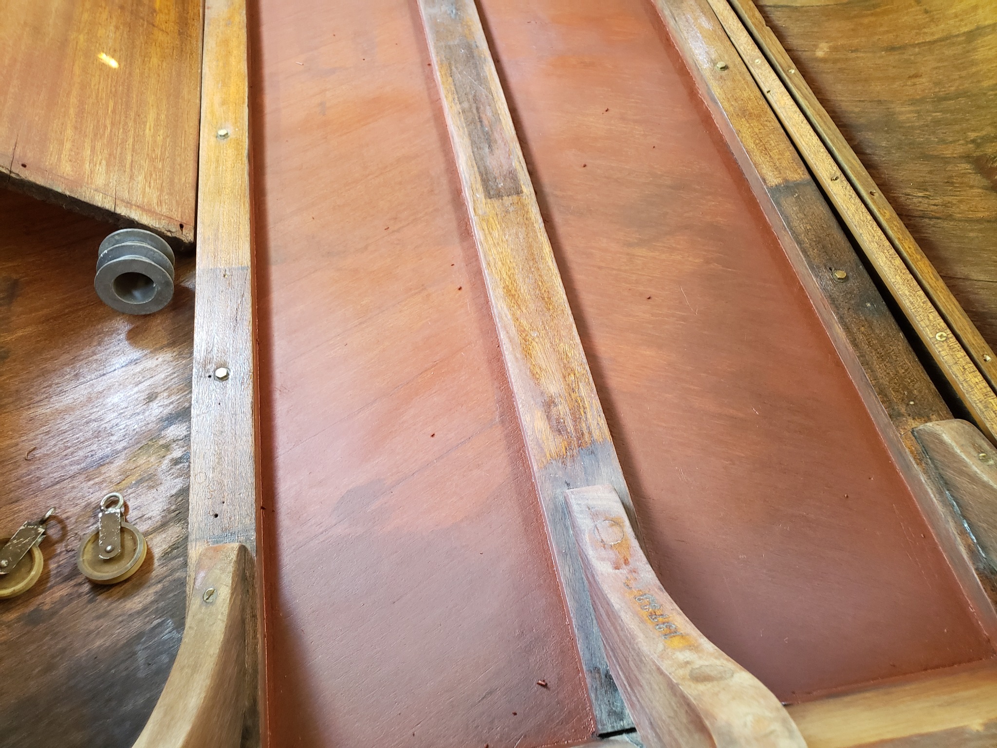

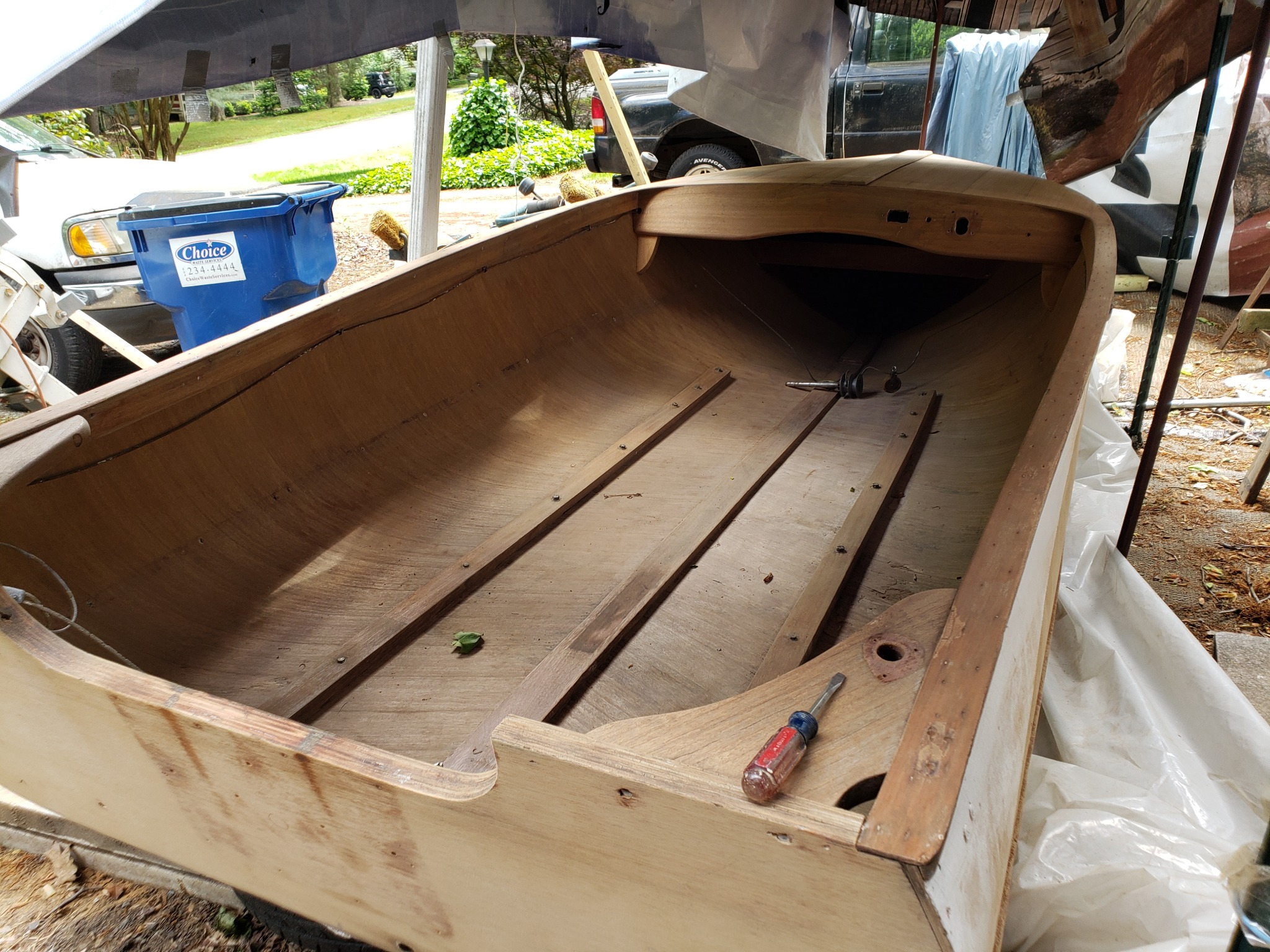

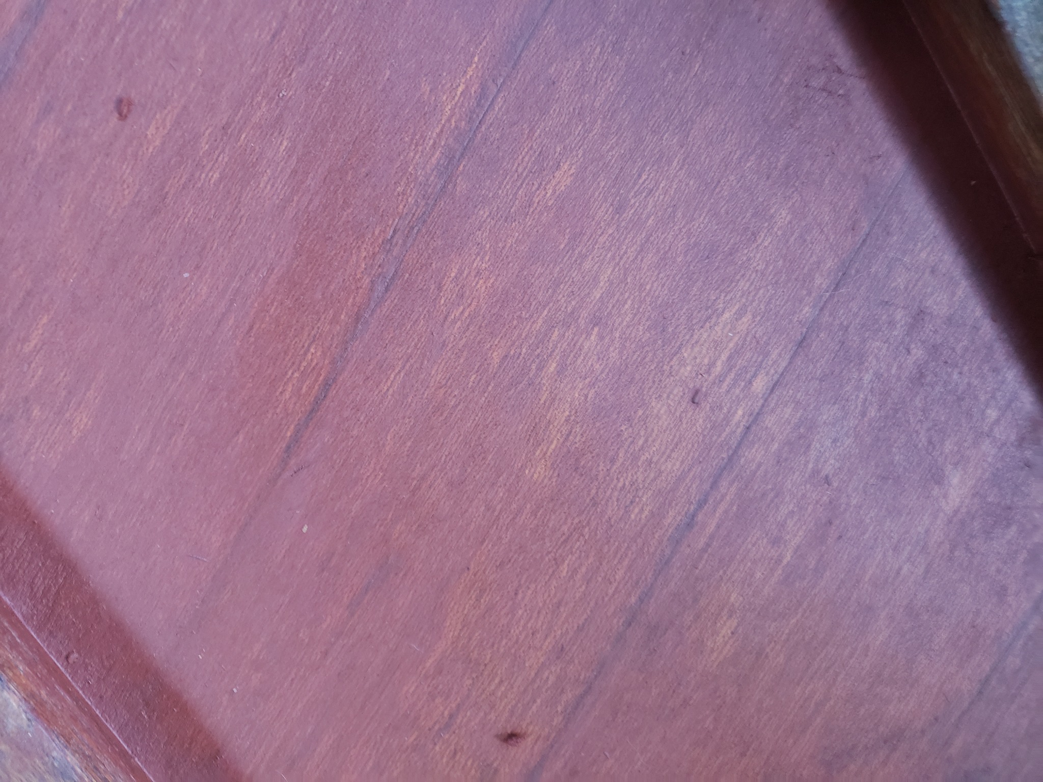

Whirlwind 1961 restoration started 6 years 5 months ago #142415
any one want to comment on staining color the picture shows the start of putting on the ceps . it has darkened it up back to how it looked when i bought it. ( darker than I was interested in, but I know it needed that treatment of the ceps. i am thinking of using
Chris Craft Red Mahogany with Interlux Interstain Wood Filler Stain.
i do not want it to get any darker for sure
Whirlwind 1961 restoration started 6 years 5 months ago #142424
Personally, I would leave it with just the CPES. I think it will get darker if you stain it.
The following user(s) said Thank You: joecffv@aol.com
Whirlwind 1961 restoration started 6 years 5 months ago #142425
So I'm with Doug. Just use CEPS, but I would definitely do 2 coats then maybe a couple of coats of varnish. The Chris Craft Red is just going to make it look like the outside hull of a Chris Craft, unless of course that what your looking for. If I remember correctly they weren't really stained on the interior, just varnished.

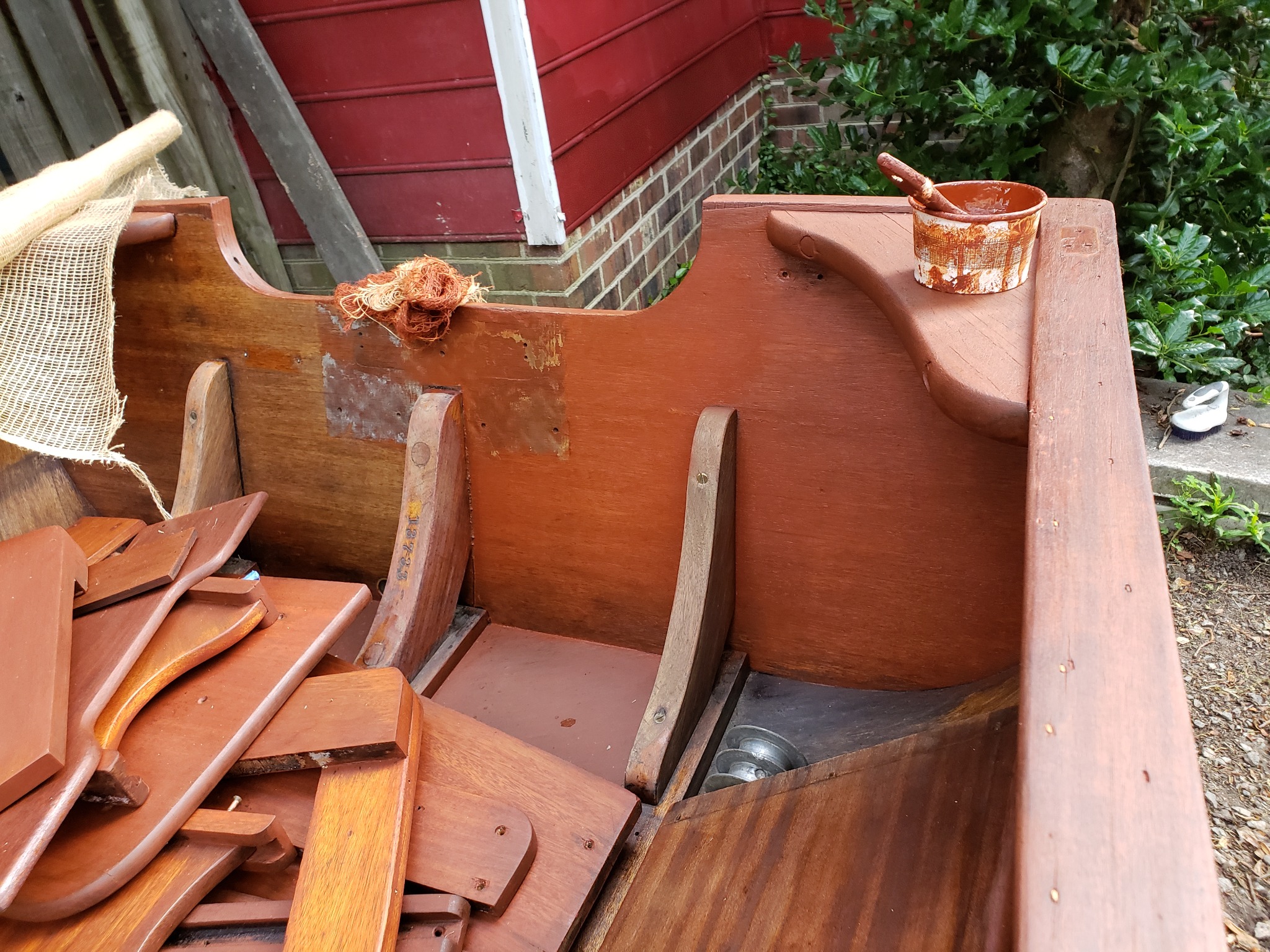

Whirlwind 1961 restoration started 6 years 5 months ago #142462
Can anyone answer a question about stain? I bought interlux filler stain and some 333 stuff to thin it.
two questions 1. any comments on the ratio to use of stain to 333 thinner?
2. if i mix a large batch and don't use it all can i seal it up and use it later over the next few days or so?
i know when using the 2 part stuff it will only last a few hours or less
thanks much

Whirlwind 1961 restoration started 6 years 5 months ago #142467
Joe I posted on your wood boat forum also. So I have to admit I don't remember the exact ratio I did for my Wagemaker but I put some stain in a small plastic bowl and just poured a little 333 in at a time, mixed it up until I got it thinner than peanut butter. If you use a good sealable container you should be ok to save for a day or so. it will completely harden up after a couple days. I started first thing in the morning and progressed until I got everything done. If it's a big job I would guestimate about how much I needed then go for it. That thinner makes it spread easy but wicks off fairly quickly.
Whirlwind 1961 restoration started 6 years 5 months ago #142471
thanks, im going to start with some testing of the mixture % , inside on the bottom of the hull because it will be covered by some removable flooring strips that came with the boat originally
Whirlwind 1961 restoration started 6 years 5 months ago #142478
testing the stain it is interlux chris craft red mahogany thinned . not quite till it can drip off the brush,cut the brush bristles half off so they are more like a tooth brush feel . painted it on just let is stay on for a min or so then rubbed off with burlap. circular motion the with the grain to finish. Not exactly the methods i have been seeing on youtube vids. but I want to see the grain and have some color. up close
Whirlwind 1961 restoration started 6 years 5 months ago #142479
Yeah that works, looks good. It's really up to you, if your happy with it that's all that counts.

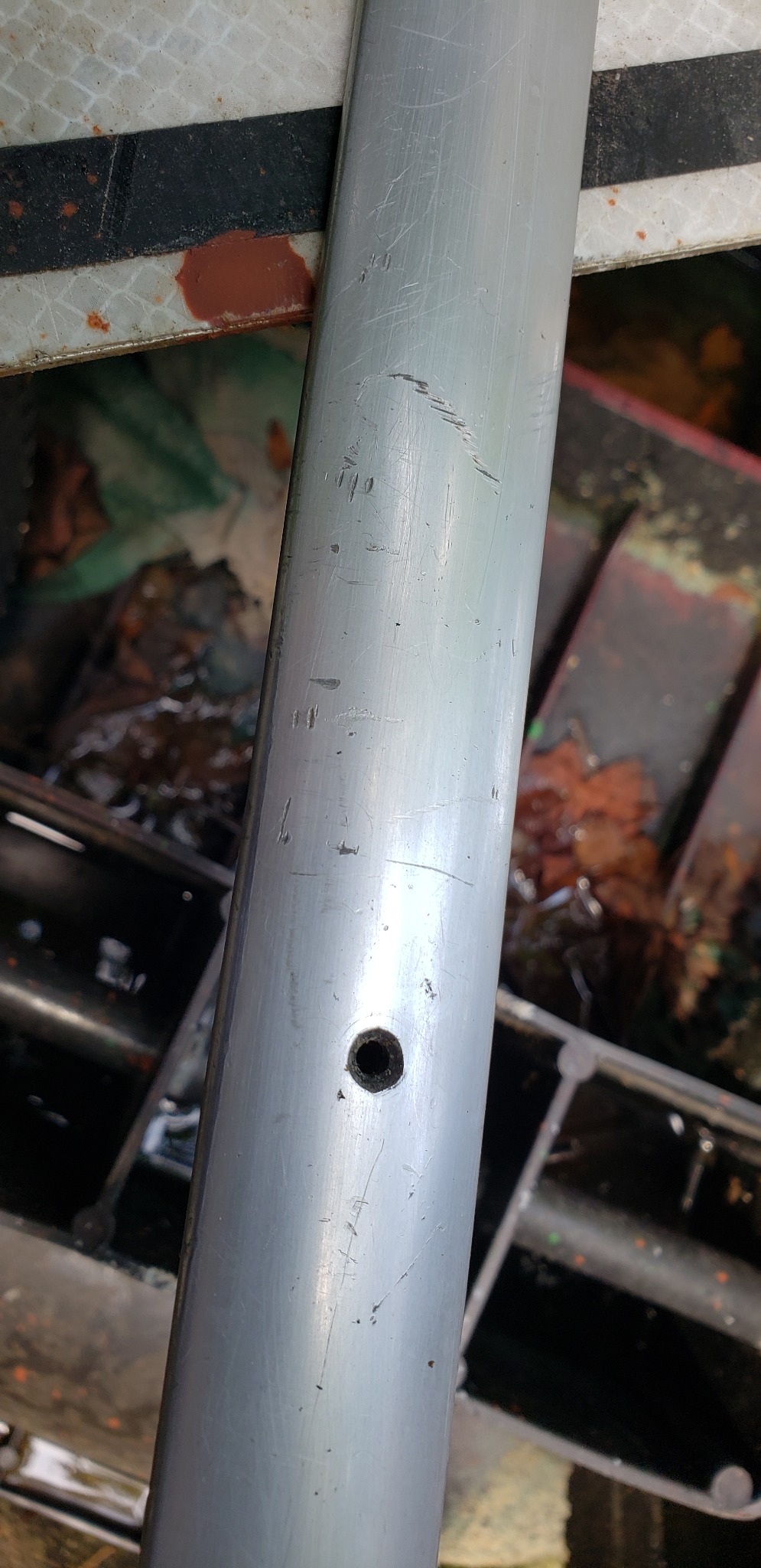

Whirlwind 1961 restoration started 6 years 4 months ago #142666
Anyone have some good ideas on buffing up the chrome trim

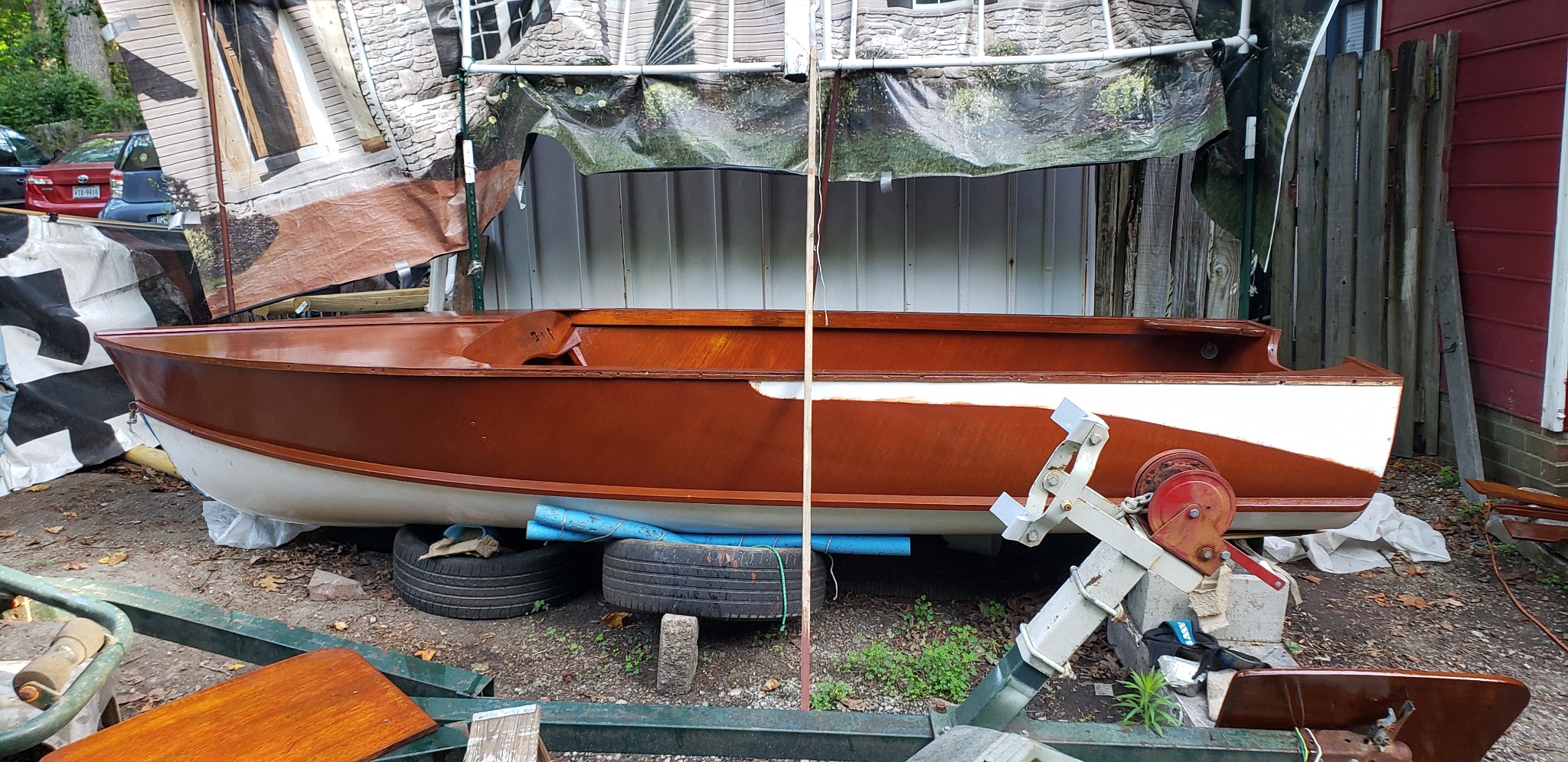

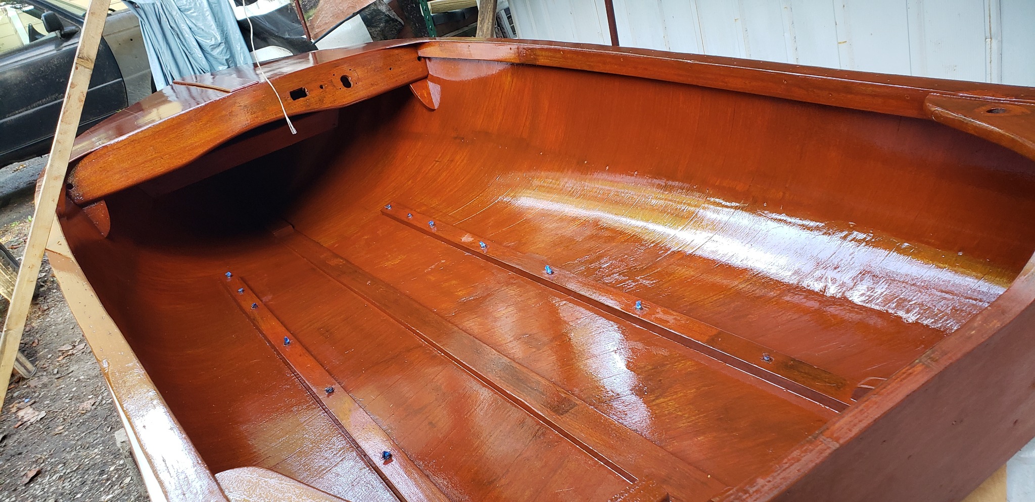

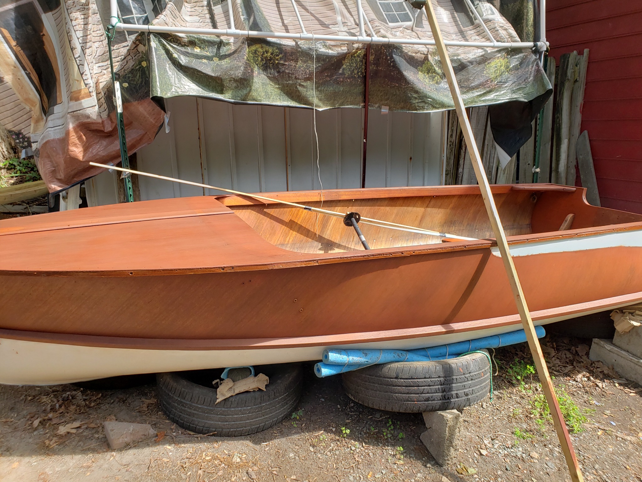

just some follow up progress. stained and now varnishing with total boat gleam i like it ! but I already finished off a gallon and was only on the 4th coat :( costly stuff . however I do like how it is looking (shinny lol ) and the color is more to my liking than when it just had the flat looking stain Got caught in a rain out burst and the boat got wet but at least it had a few coats of varnish on it lol I am also picturing my working conditions not easy. it is very hard to tell where you are once you start putting on the 2ed and addition coats of varnish.
Whirlwind 1961 restoration started 6 years 4 months ago #142731
work shed, so to speak
Whirlwind 1961 restoration started 6 years 4 months ago #142732

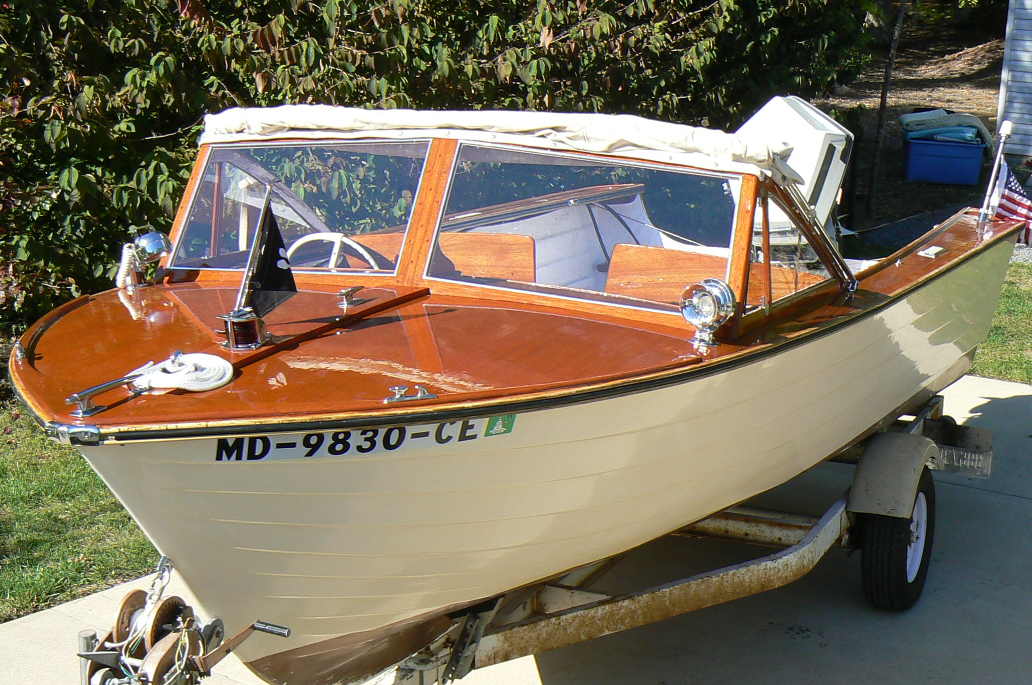

Looks fantastic from here. Once the basics are done the fun starts putting it together. Ingenious cover for your work area. Love it.
Just a suggestion. For the lettering that I pictured, it's not expensive. I found a local gal that does it at home as a side business, That set of words plus a set of registration numbers was $17.00 total. Craigslist actually. Just about all the signage and lettering, pictures etc that you see on business vehicles are all computer cut-outs, not much old school painting anymore. Most of the boats in the marinas are all the stick-on.
Whirlwind 1961 restoration started 6 years 4 months ago #142735
lol I liked the name on your boat i will look at what people are advertising locally. I told my wife we need to think about a name, of the top of my head i told her how about topless ( a requirement to get a ride, LOL) . she was not impressed lol lol

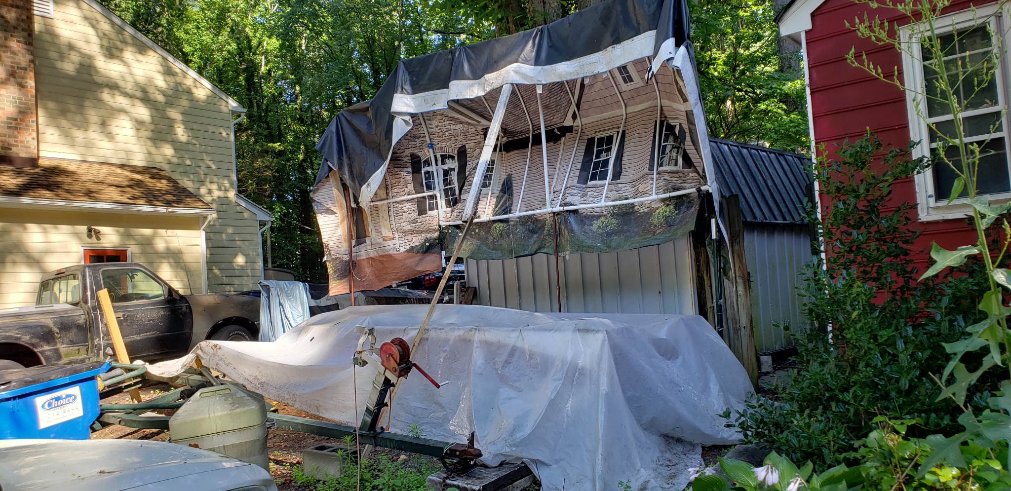

It has been a challenge trying to keep that boat dry over the winter and while i was stripping and staining it. Now with a few coats of varnish maybe i can relax a bit if it gets wet a little lol lol.. that tarp is repurposed used billboard signs. It is not totally water proof but helps and helps with shade etc.
Whirlwind 1961 restoration started 6 years 4 months ago #142781
any one want to comment on the type of brush to use for the varnish coats.
I was sent those foam things, and for the first few coats i have been using the cheap brushes you get a lowes
thanks
Whirlwind 1961 restoration started 6 years 4 months ago #142784
No foam brushes for varnish.
Best I have found are not the most expensive or the cheapest. A good middle of the price range will do very well. The ones I have used have what they call split ends. If you look at brushes they will say if they are good for varnish. A good 2 1/2 or 3 inch brush with soft split ends will work just fine. Recommended not to use the brush right out of the wrapper but clean it first in mineral spirits or thinner and dry it well. Manufacturing leaves lots of junk in there plus you want to knock out any loose bristles. Finish with lite smooth strokes in one direction, do not put it on thick, it will sag. Several lite thin coats are better. Lowes or Home Depot will have the brush you need, just ask an attendant.
I like the ones that are cut at an angle, easier to get in the tight areas.

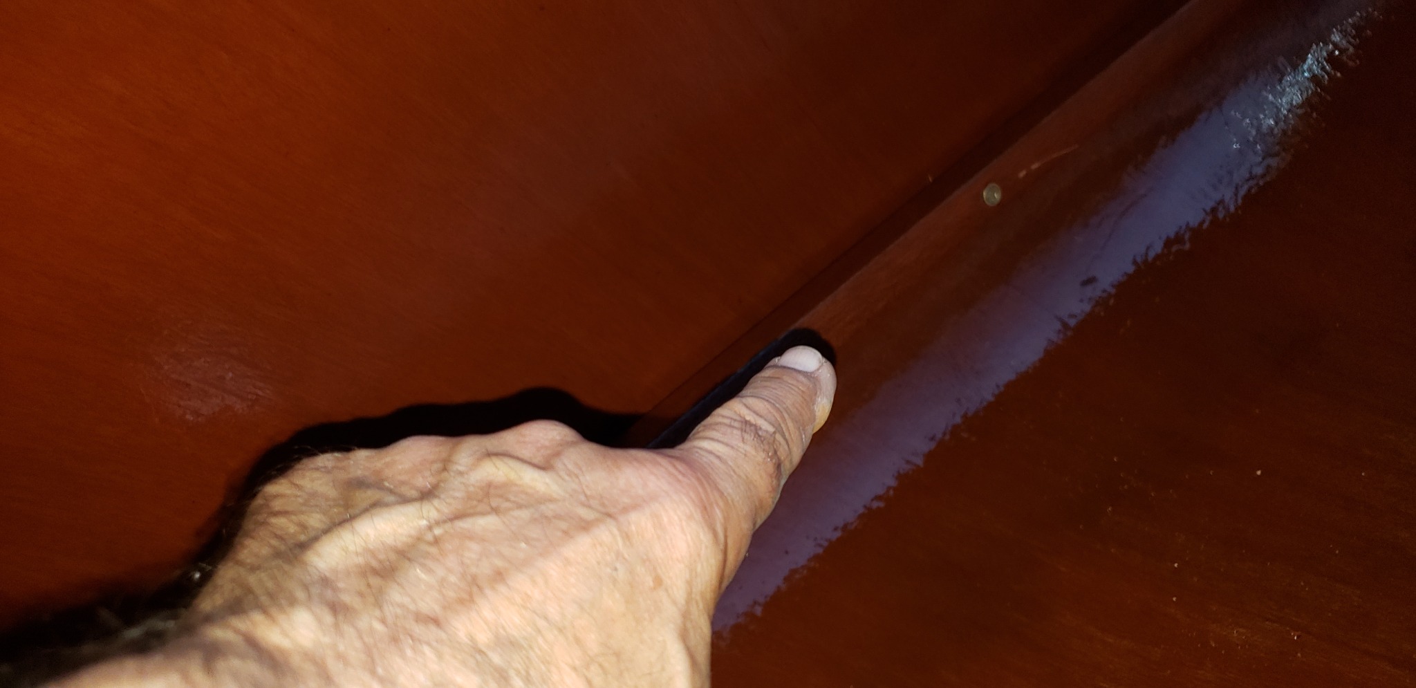

Whirlwind 1961 restoration started 6 years 3 months ago #142936
anyones thoughts about he following
the rail the supports the wood bench seats needs to be reattached after i'm finished varnishing. BUT now i'm realizing maybe i should have taped over the line where it screws into the sides ( hull ) because I wanted to use 3m 520 adhesive also, for additional strength, as it looked like they did use some kind of black glue when i took it off.
i'm thinking with those coats of varnish the 520 adhesive will not hold and i should sand down to the original wood along the strip where the bar will attach two pics below
Also , the screws for it, i think I should get new ones, should i get brass or stainless steel ??? the originals look like they are brass
Whirlwind 1961 restoration started 6 years 3 months ago #142939
I would sand down to bare wood. Tape a wide swath on both sides of your lines and get the varnish off. More than likely those were brass screws. Most hardware or big box store will have them. As for the glue, if you want a real permanent fix use 3m 5200. Water proof and the wood will break before the glue gives way.
Anxious to see your finished project.
