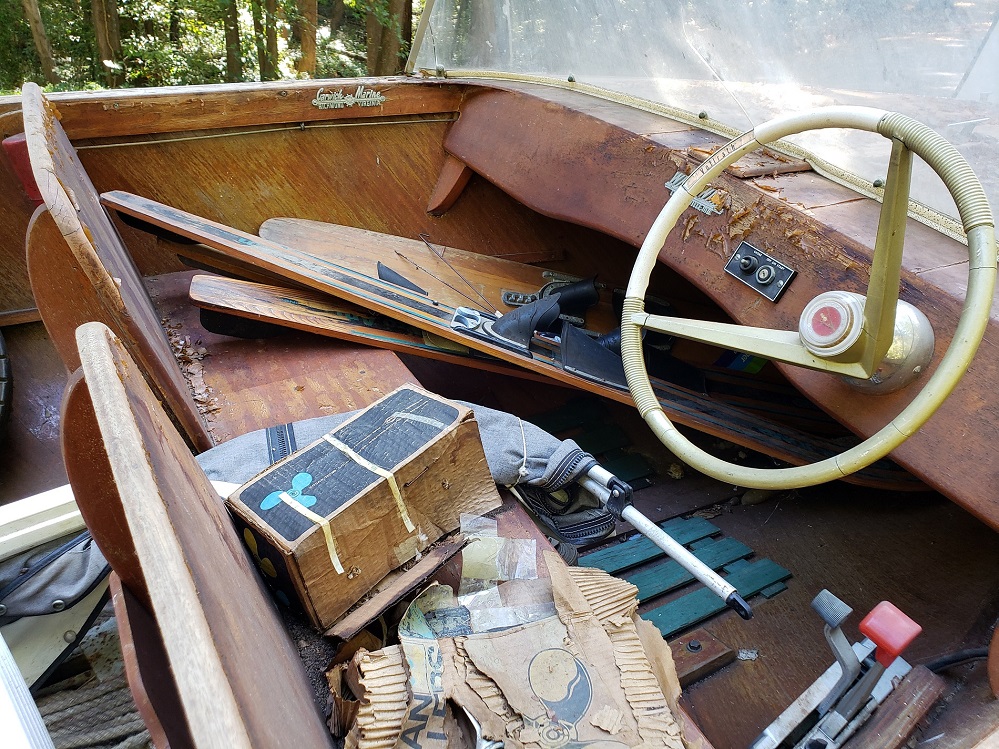

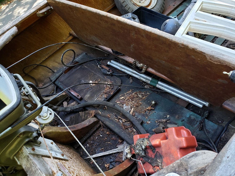

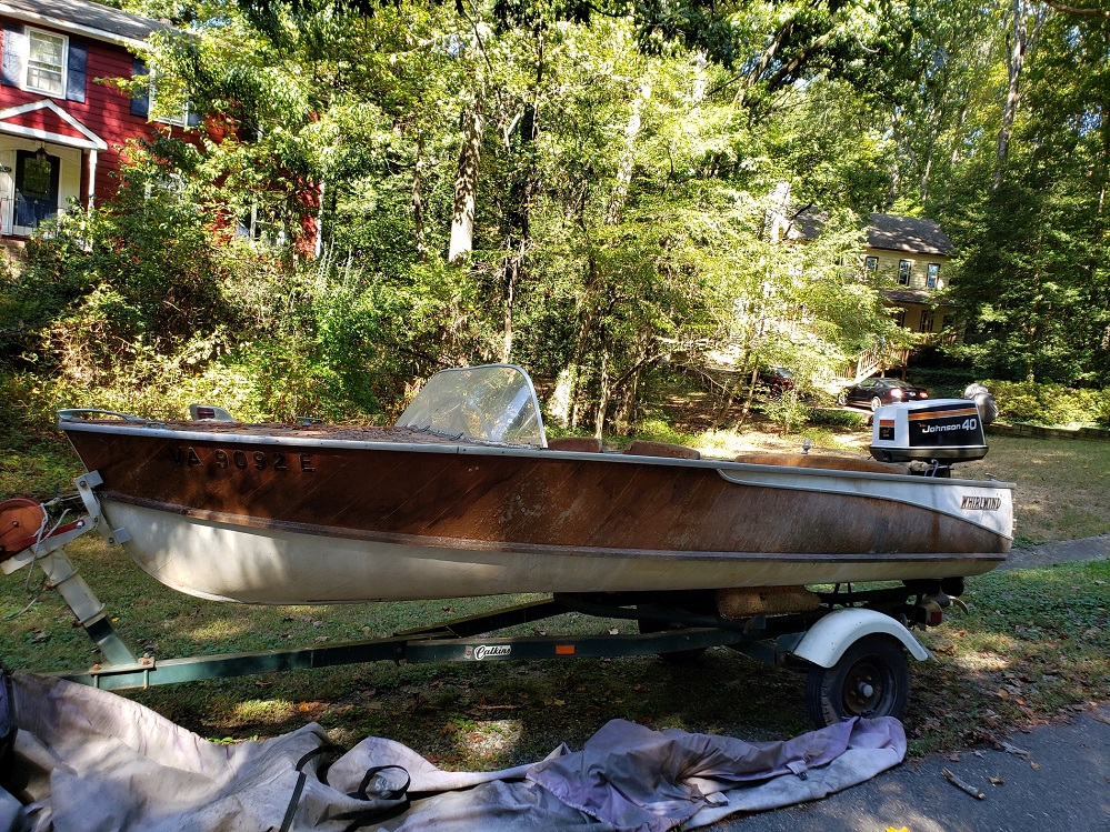

hello,
I just bought this boat and I am looking forward to fixing it up. So to help me keep track of things I will post here from time to time.
Your tips, comments etc. will be welcome. I have refinished some furniture in my past so this will be fun. These old classic wood boats look so so cool. I just finished a 1959 Lake n sea, which I posted. I hope i can get this done faster than that boat lol.
I got it from the widow of the guy, whos' parents bought it new, and mostly barn kept except for the last 3- 4 years, when he brought it to his house. Looks like it is all very original.
