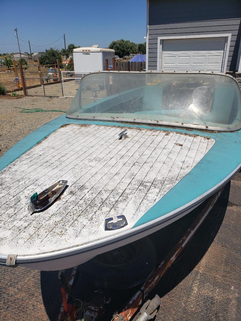

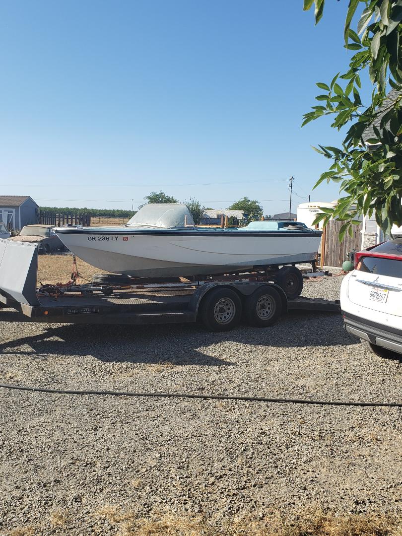

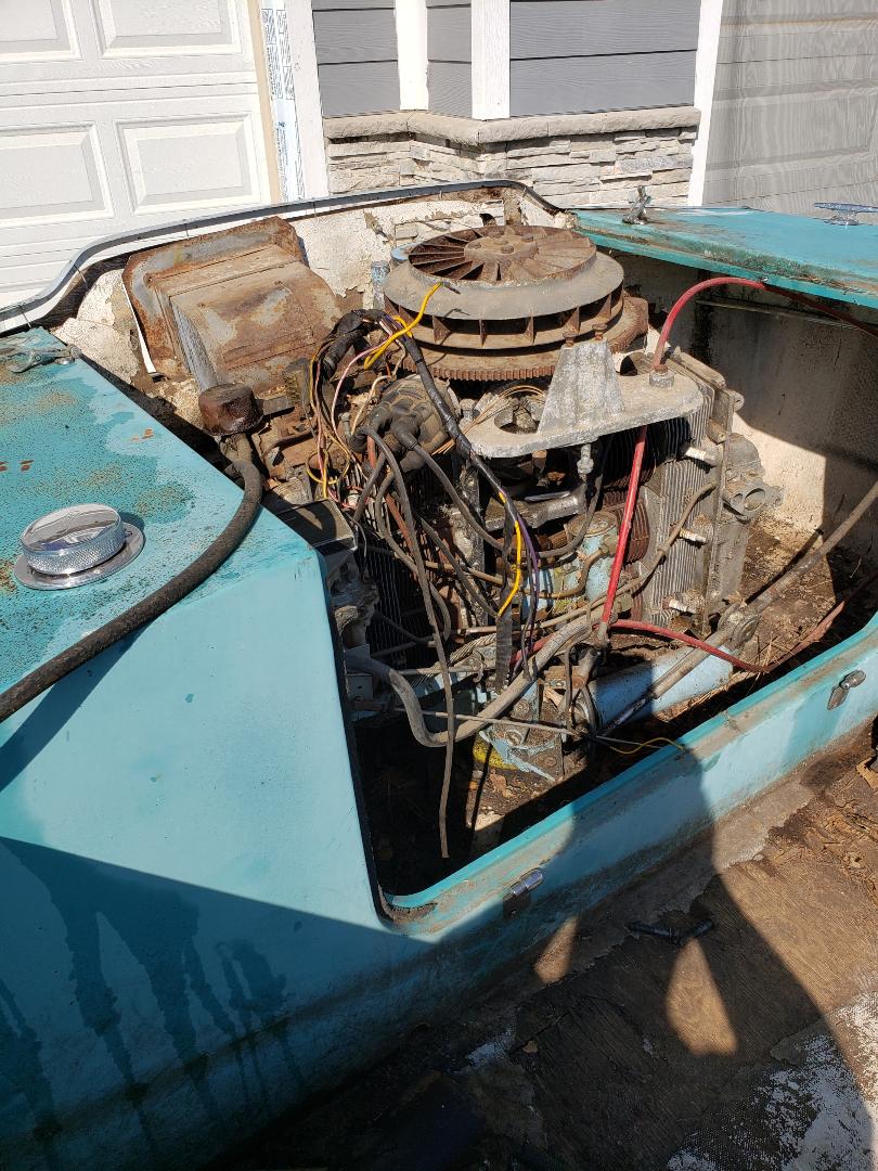

Here we go! Its a 1965 Wayne 100...whats that?....A 1965 Glasspar Avalon powered by a 95 HP Corvair, designed and patented by Wayne Horning, designer of the 12 port Chevy and GMC head for drag racing. He built around 96 of these units for Glasspar and Tahiti hulls. I believe mine is an early version as the head and block numbers designate an 80 HP engine.
When I brought it home..trailer on a trailer
And the engine
This may take awhile to do but hopefully will be on the water next summer,,,and possibly towed to some car shows by either an 8 door Greenbrier or by my 140 Corsa.

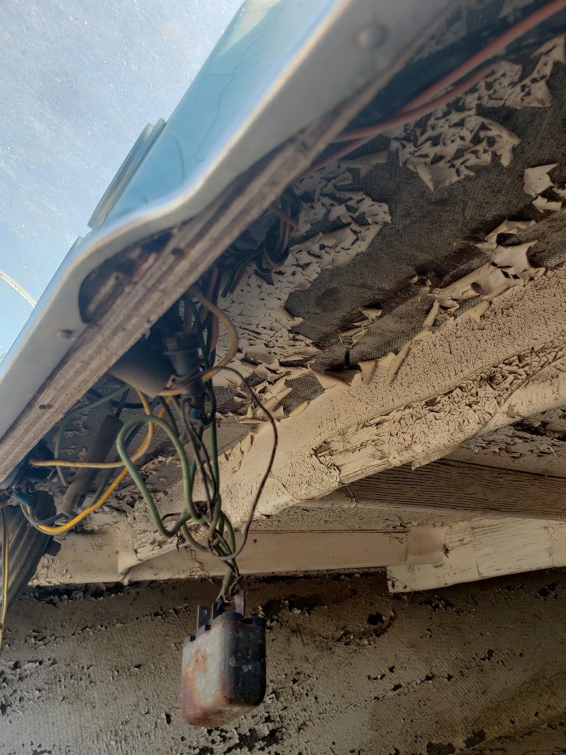

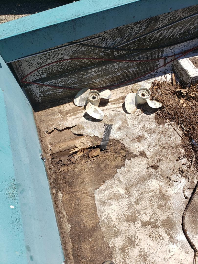

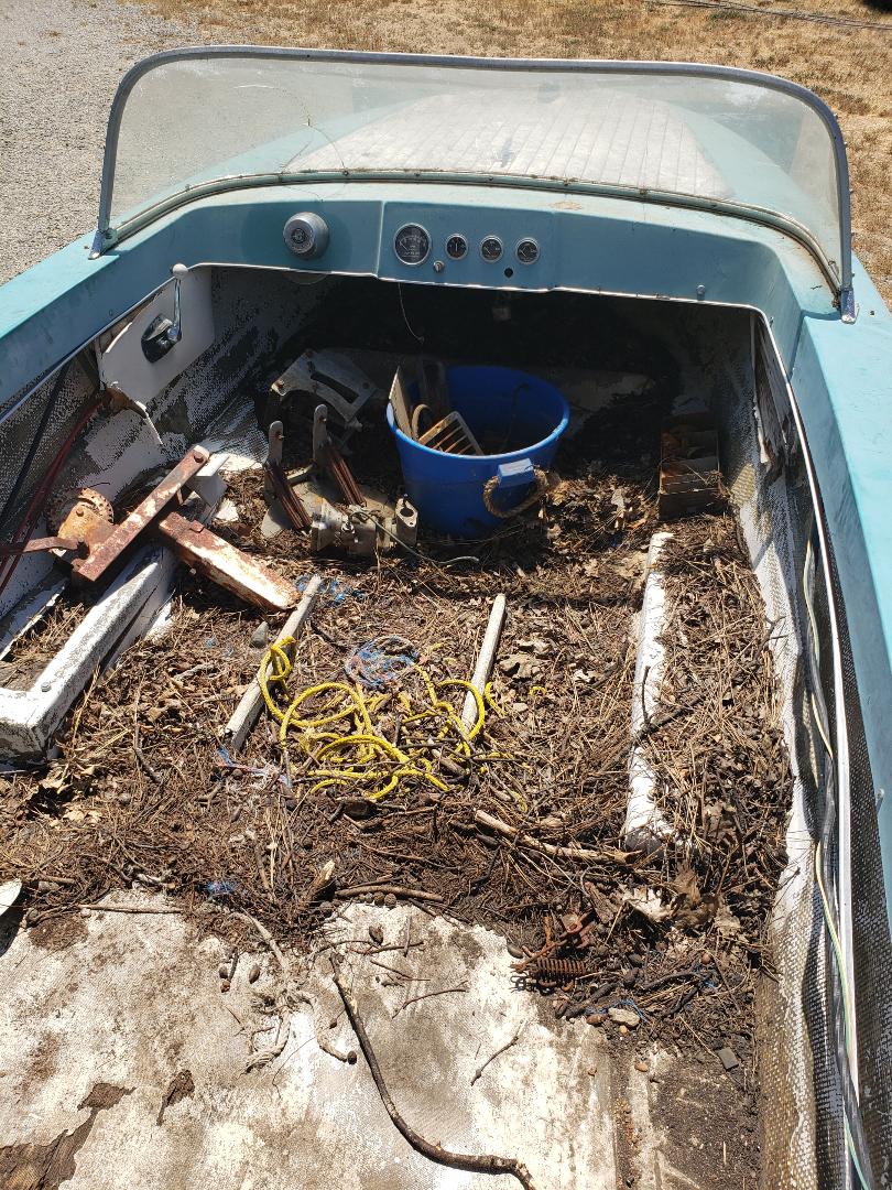

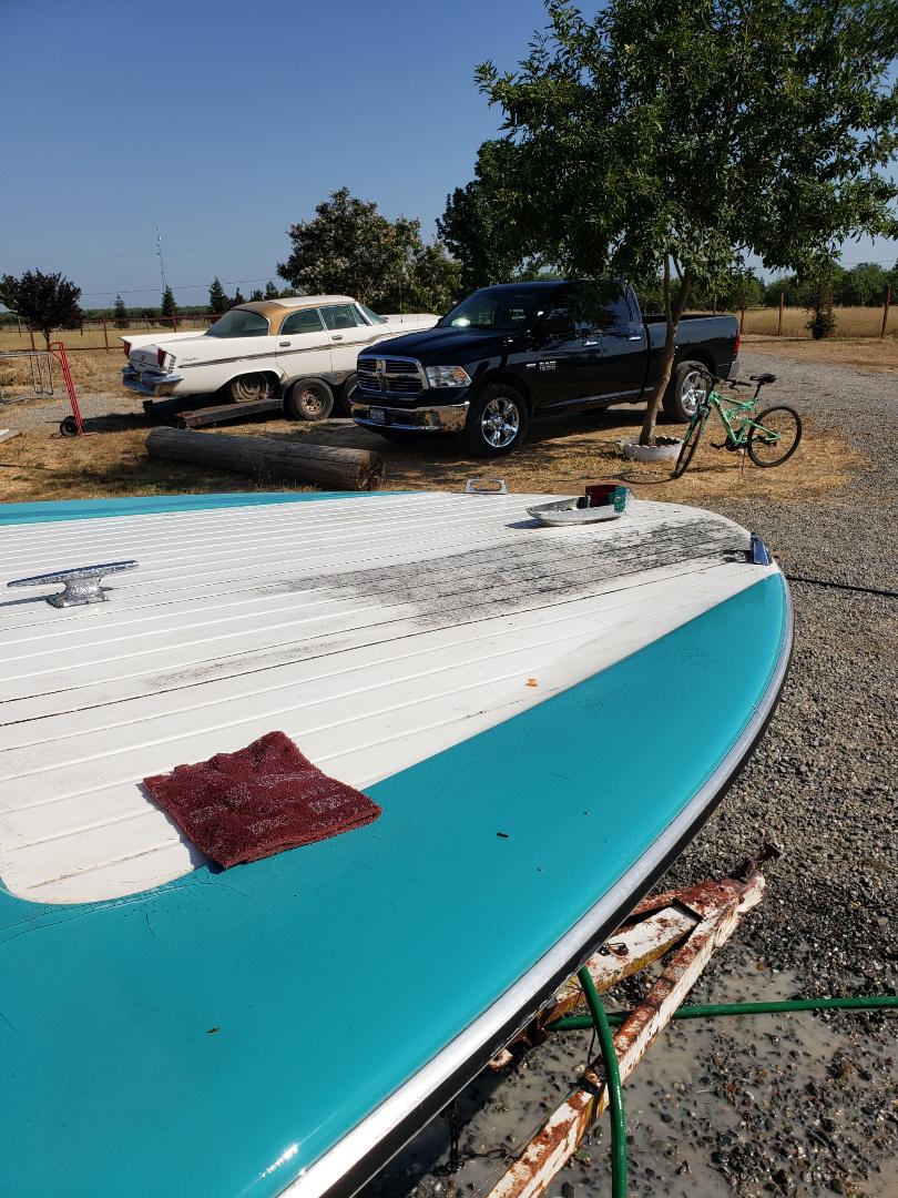

A little bit of forest
Some grime
After a scotch brite scrub
And a few holes in the floor

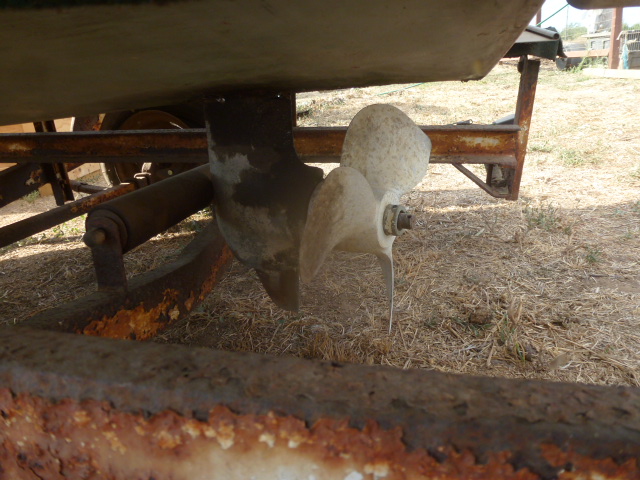

Great project...cool boat and unique powerplant. Nice add to the Corvair collection. Good luck!
What drive does it use?
1965 Wayne 100 restoration 7 years 2 months ago #140824
  • O2_Kool
  • O2_Kool's Avatar Topic Author
  • Posts: 24

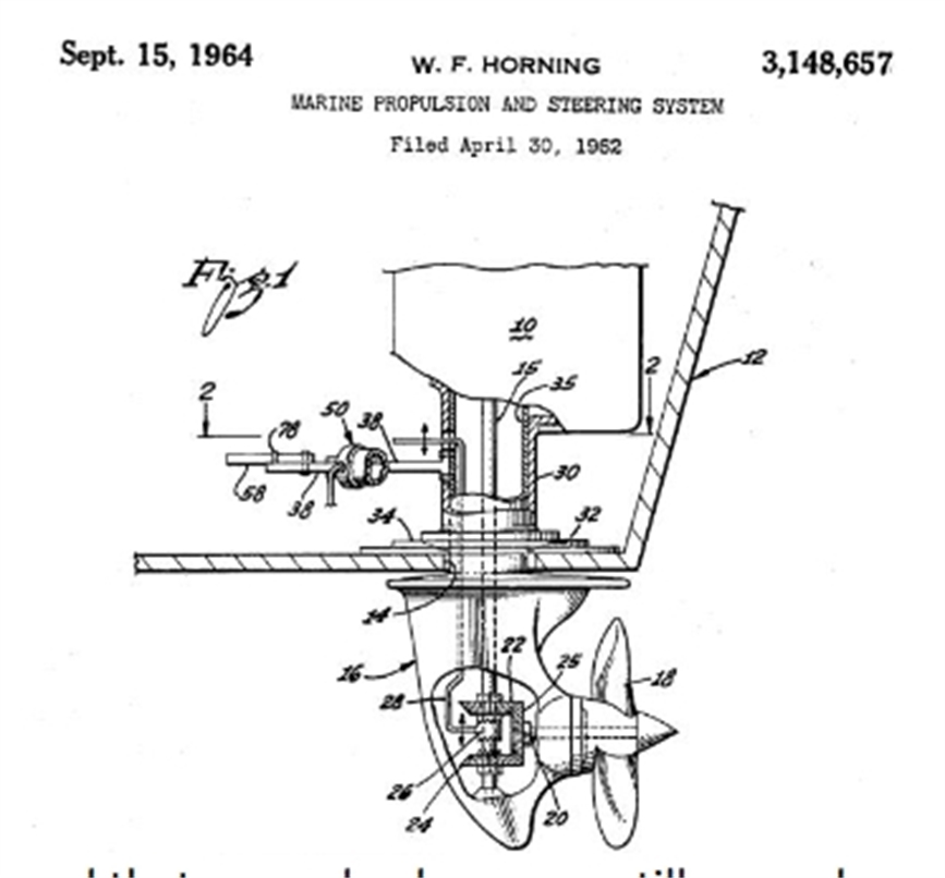

This is all I could find on the patents for the drive. Fairly simple. It uses the ring gear and spyder gears from a Corvair differential.

The patent

I mean pinion gear...I will post a lot of pictures when I get the engine out

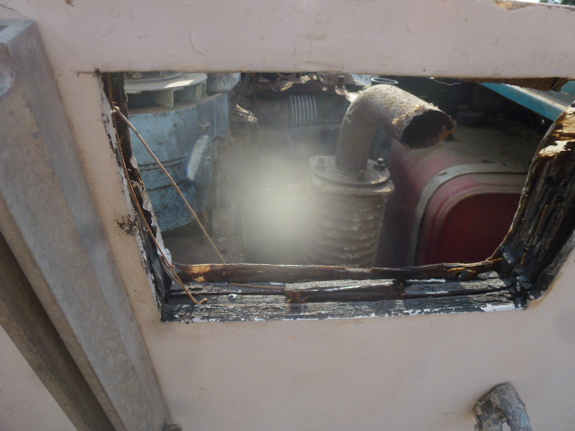

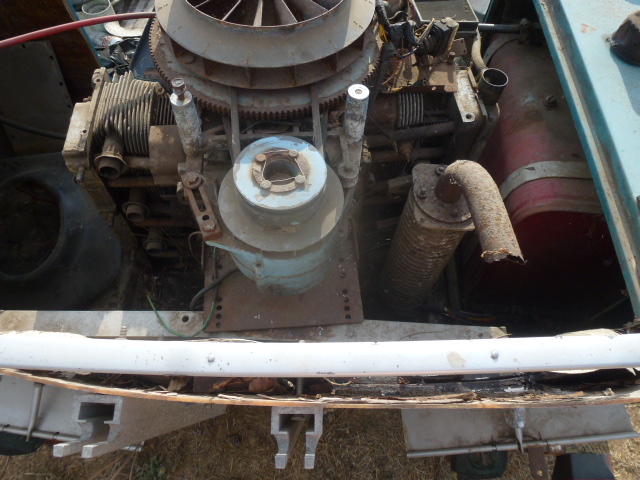

Some more engine dis assembly. Removing exhaust and engine baffles and bead blasting parts
