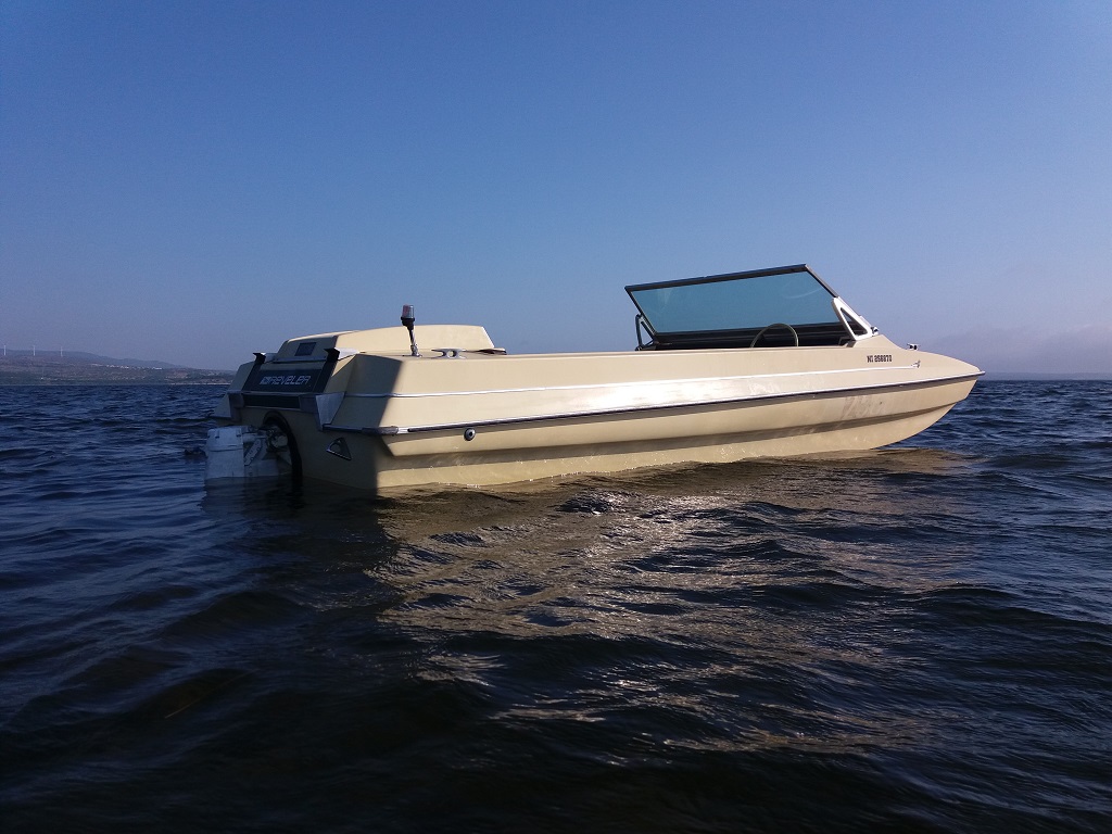

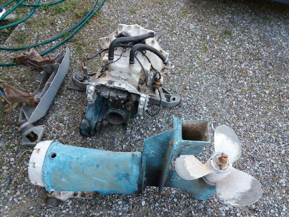

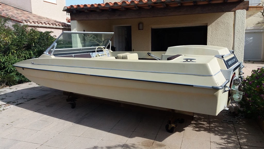

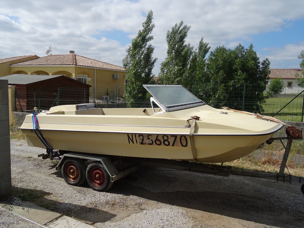

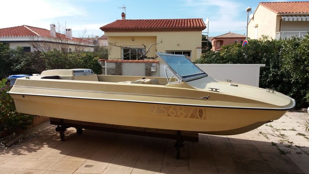

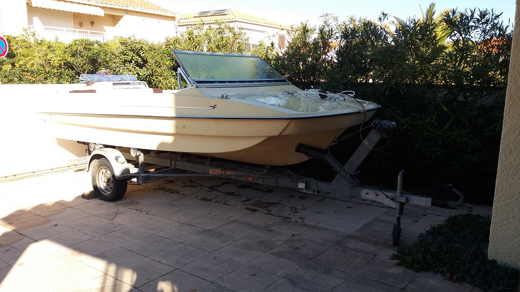

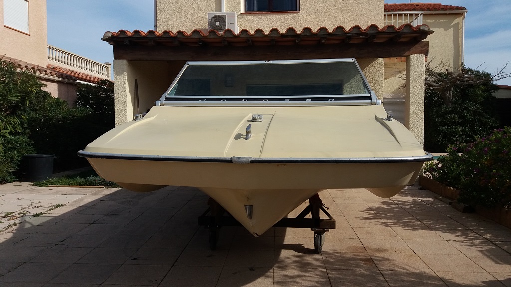

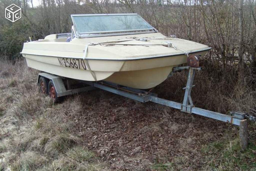

This is the boat when I picked it up. Single hull, no interior, no seats.

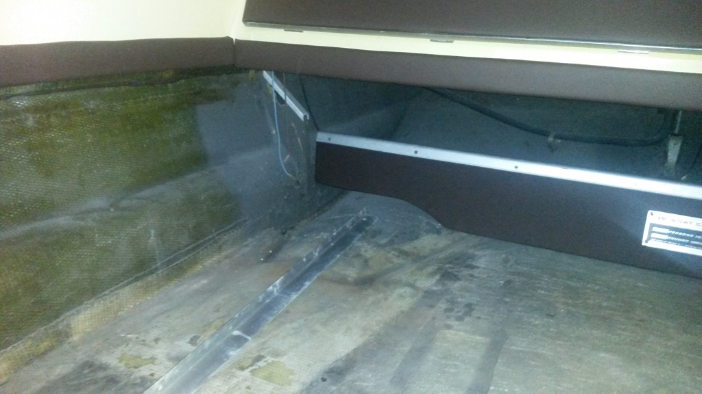

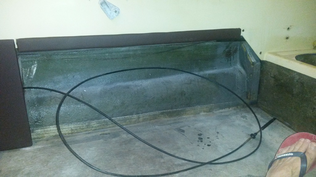

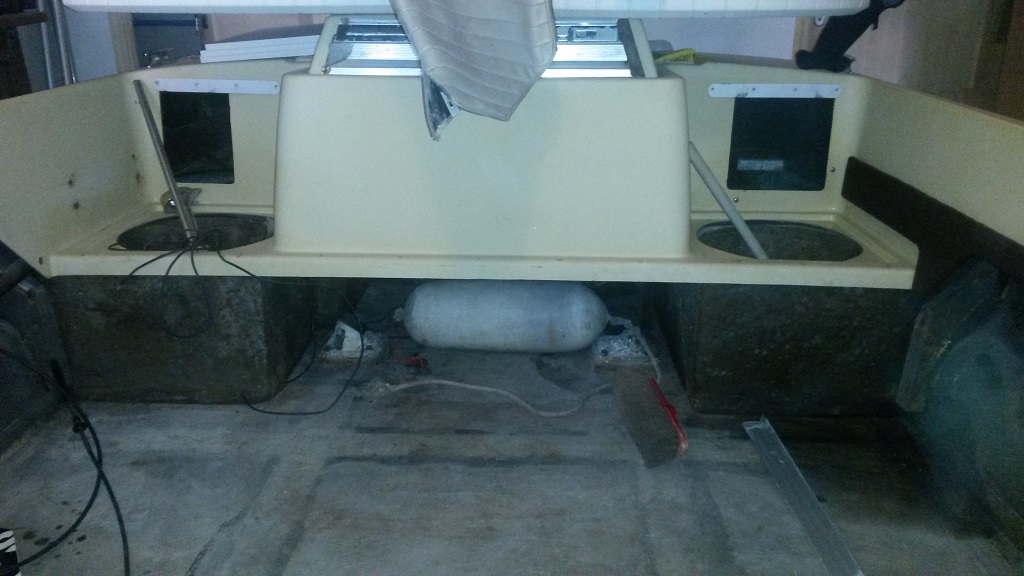

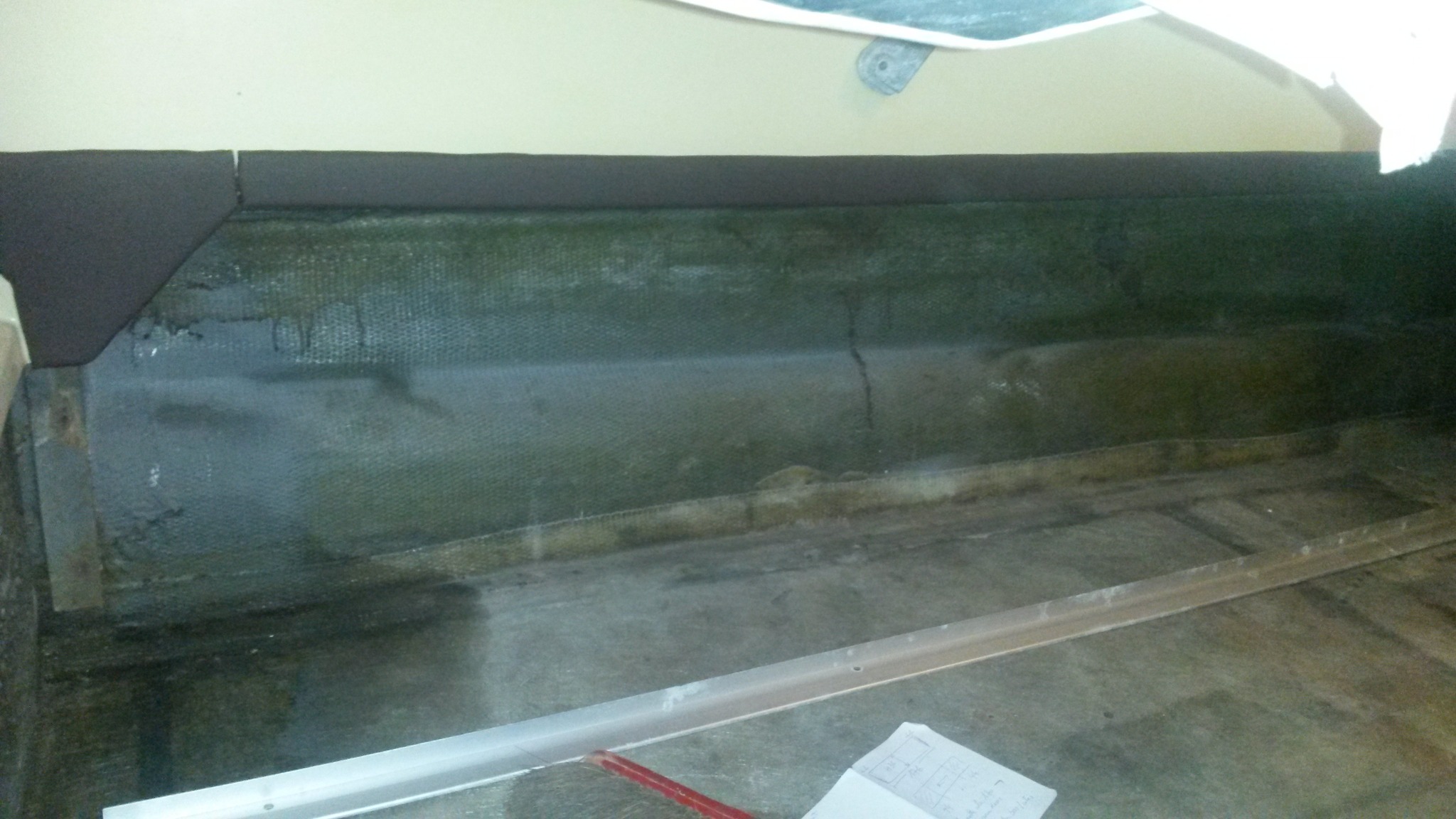

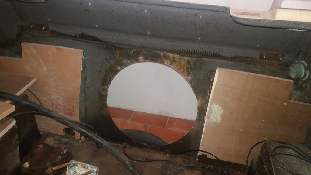

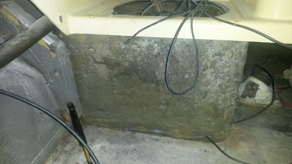

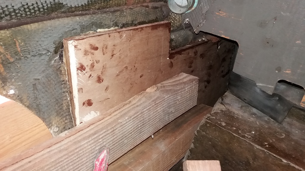

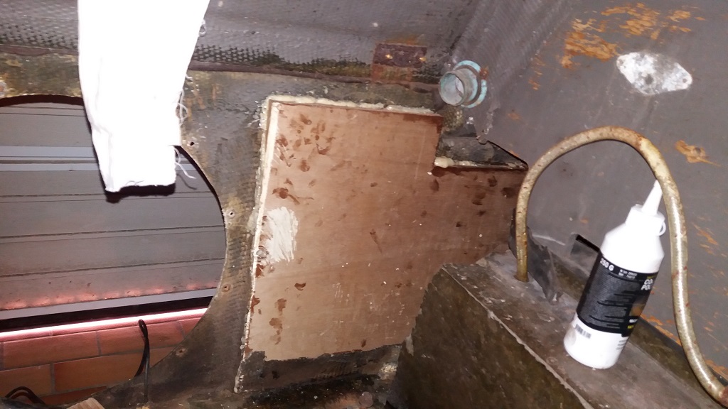

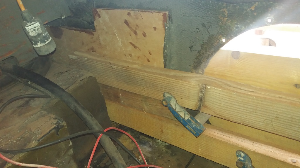

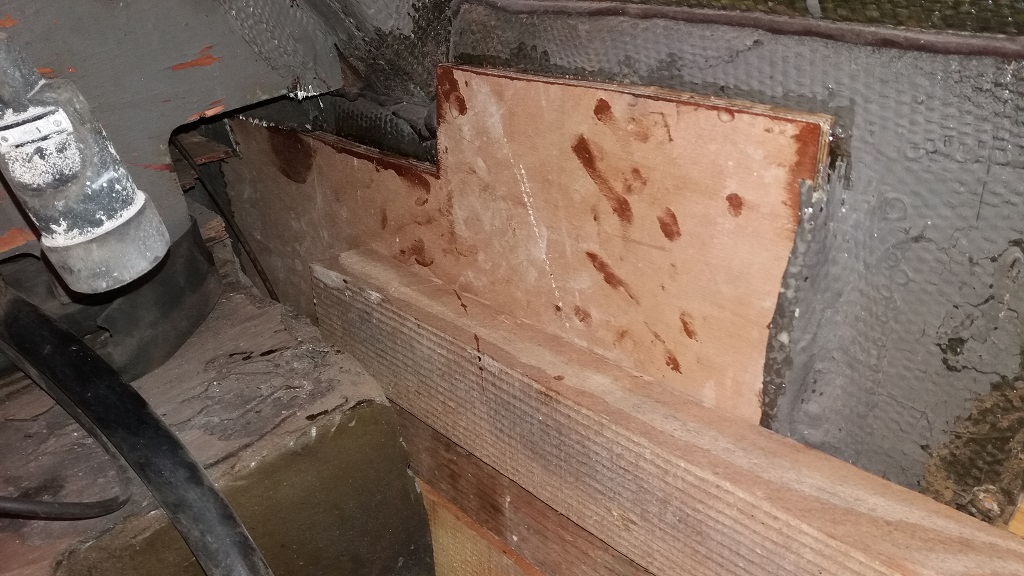

The first work done after cleaning was the repair of the back panel. Replacement of plywood. Gluing with marine polyurethane glue.

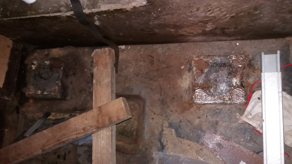

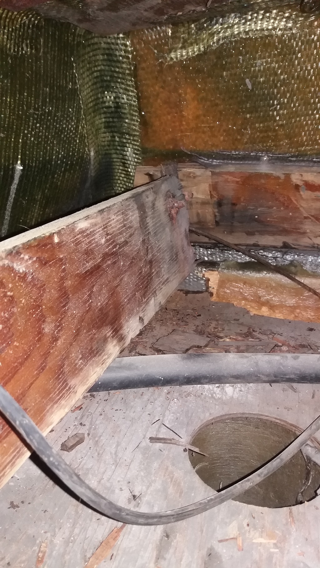

Repair of engine mounting pedestals.

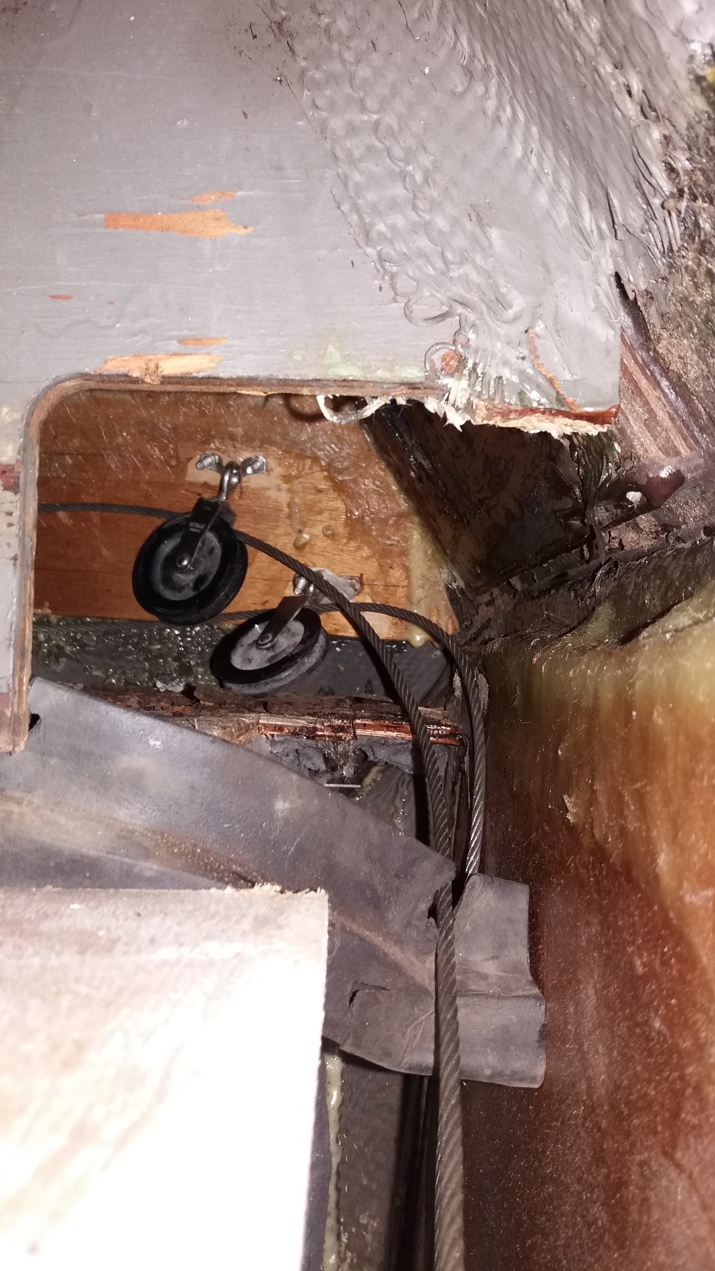

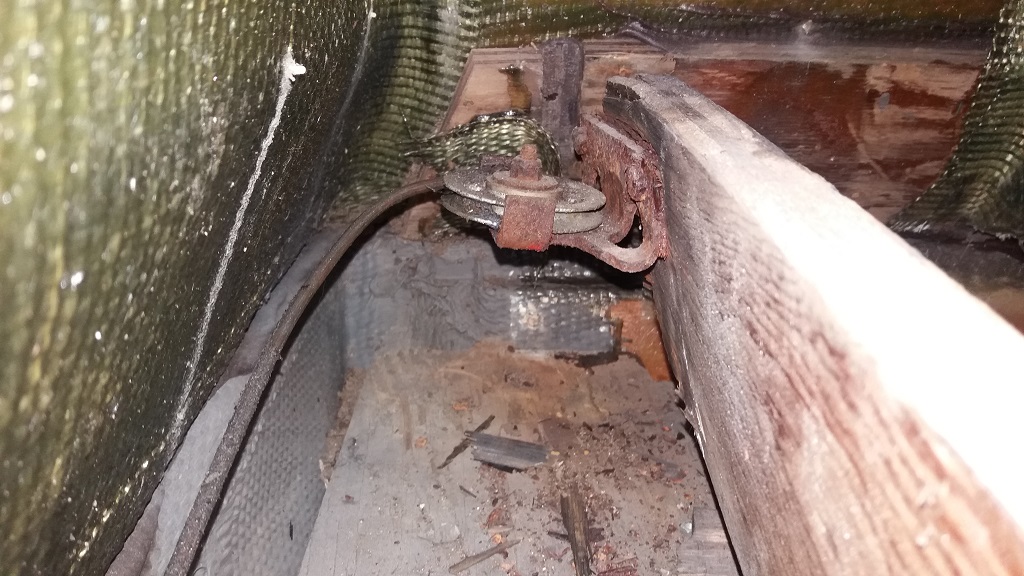

Repair of steering pulleys at the stern of the boat.

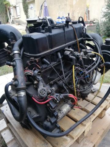

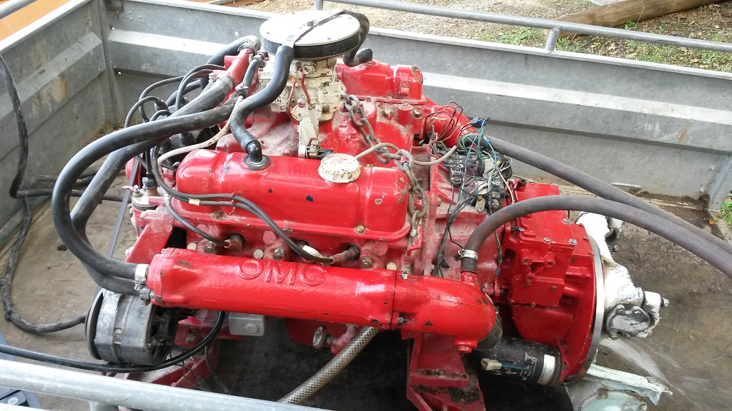

The original engine an omc buick v6 155hp will be replaced by a Mercruiser 3.0l 140 hp.

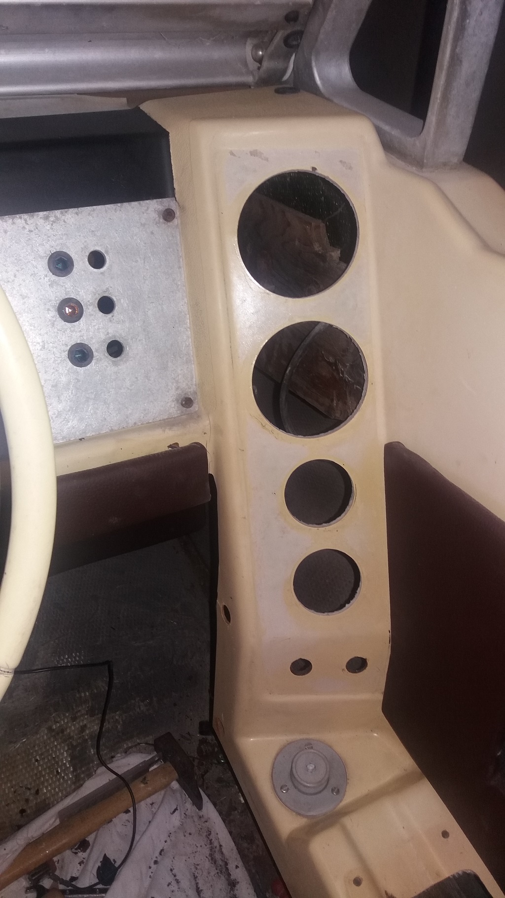

New member, My project : johnson reveler 1967 7 years 5 months ago #139605
  • evb11
  • evb11's Avatar Topic Author
  • Junior Boarder
  • Junior Boarder
  • Posts: 94
  • Thank you received: 7

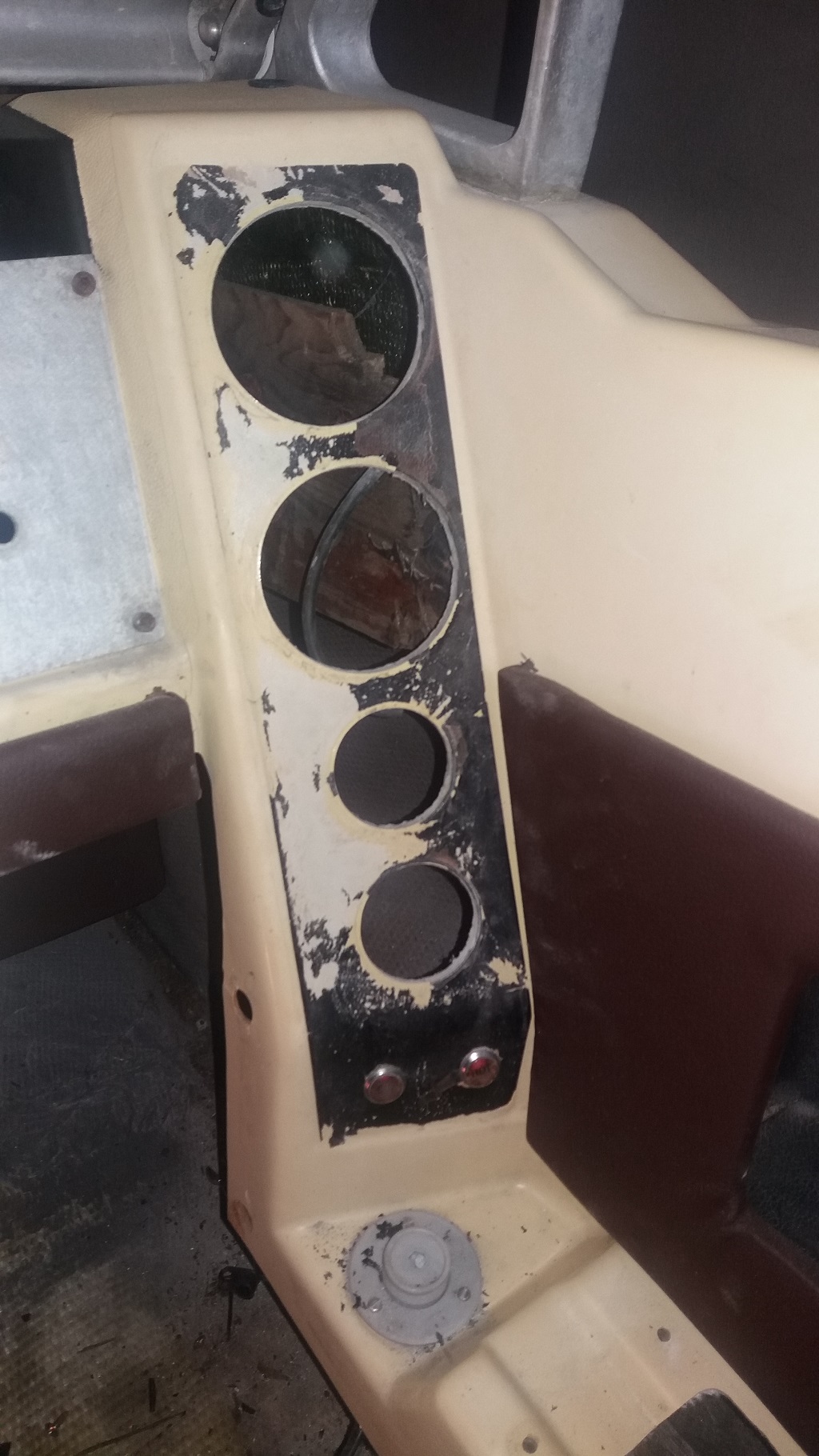

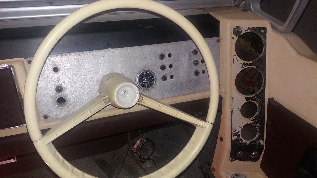

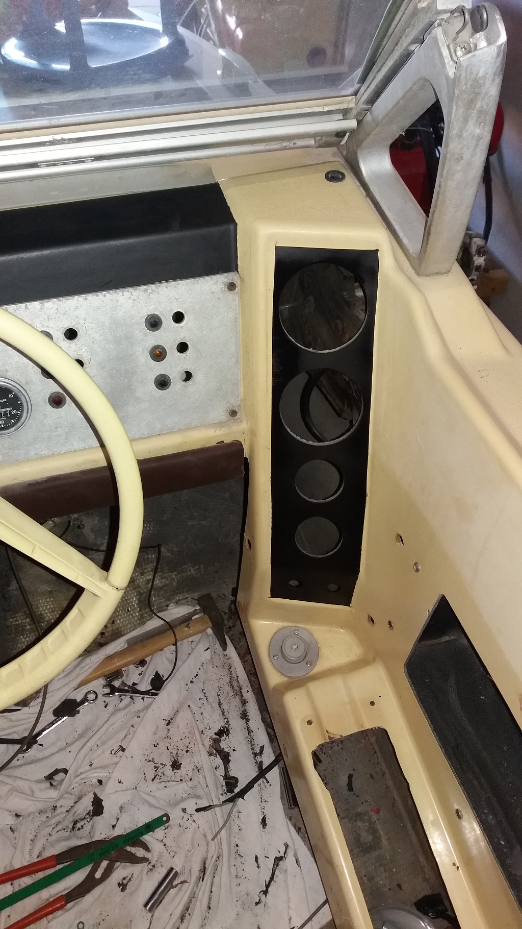

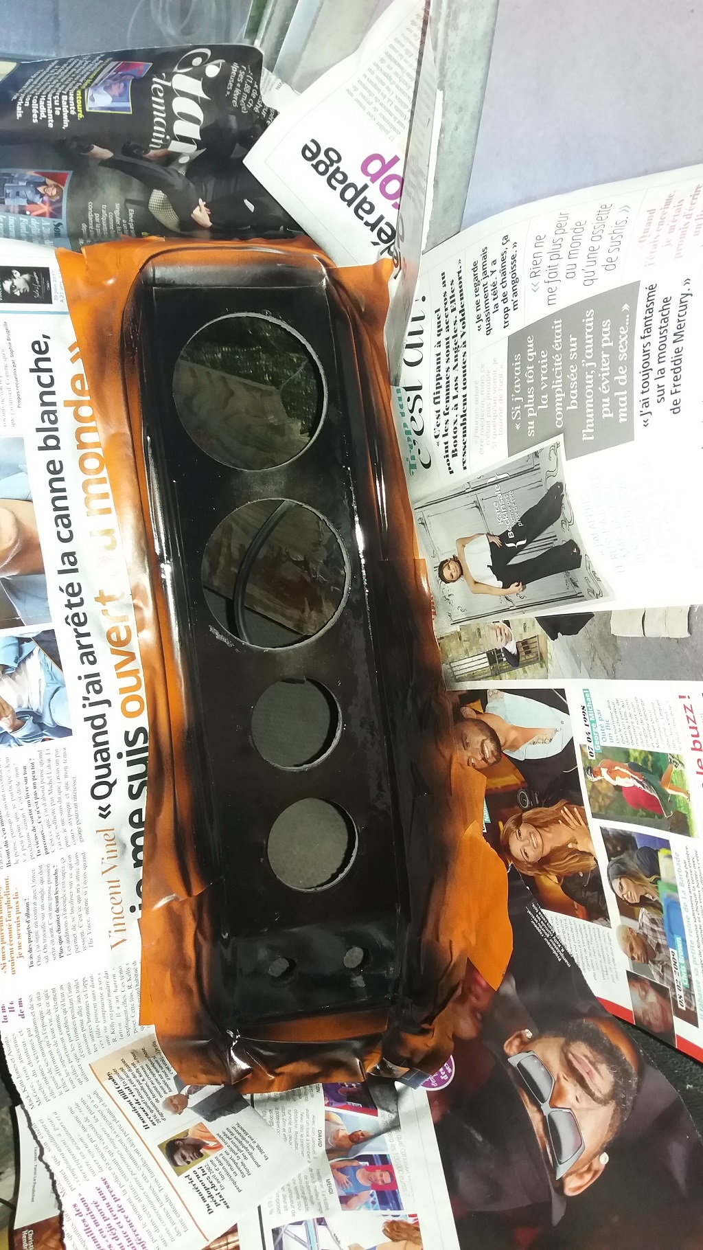

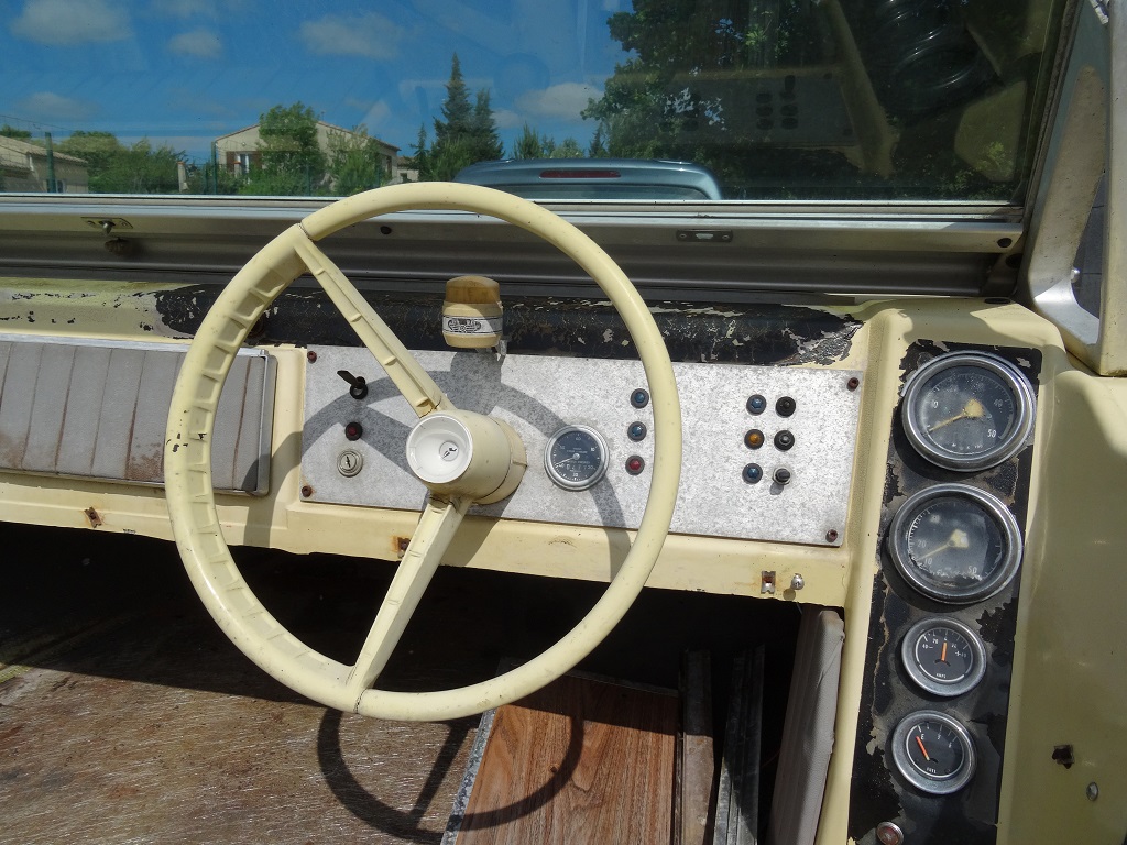

Painting of the dashboard [attachment
=51850]20170820_221510.jpg[/attachment]

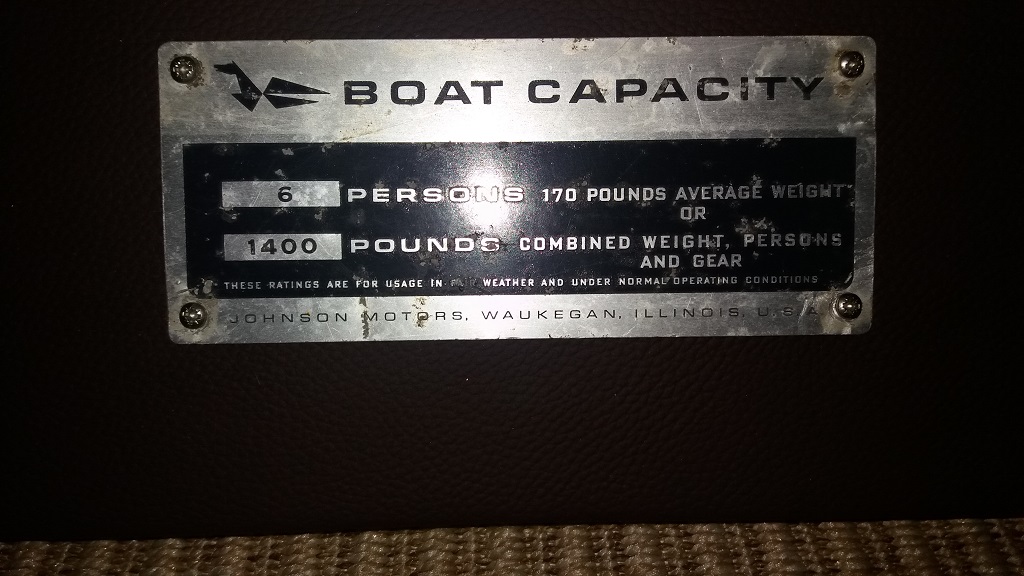

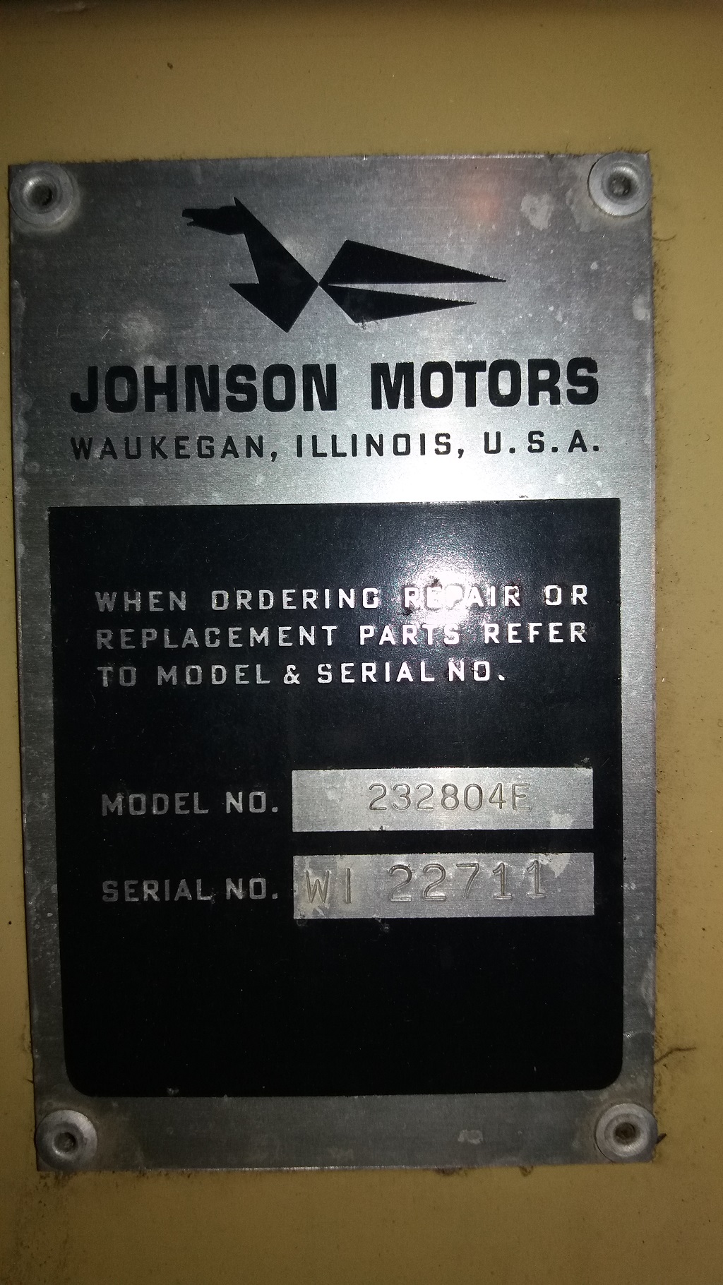

Model number and the Serial number

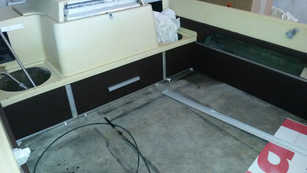

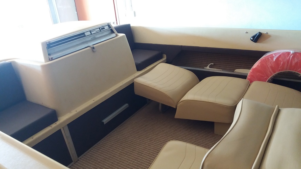

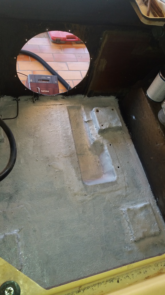

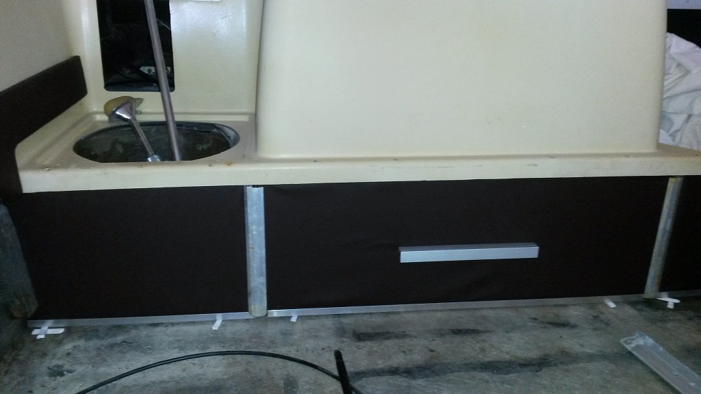

Manufacturing of the internal panels

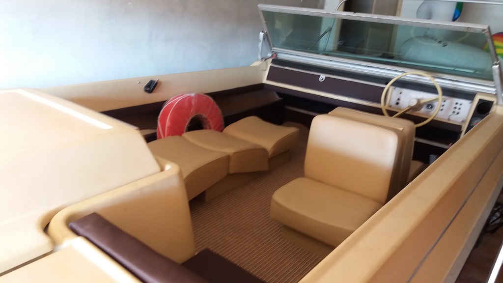

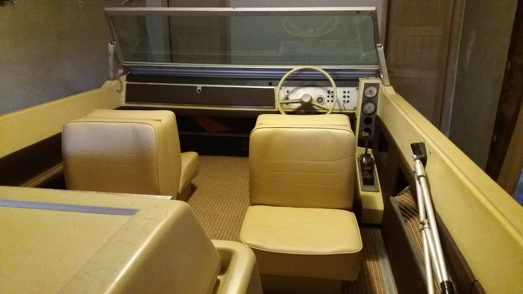

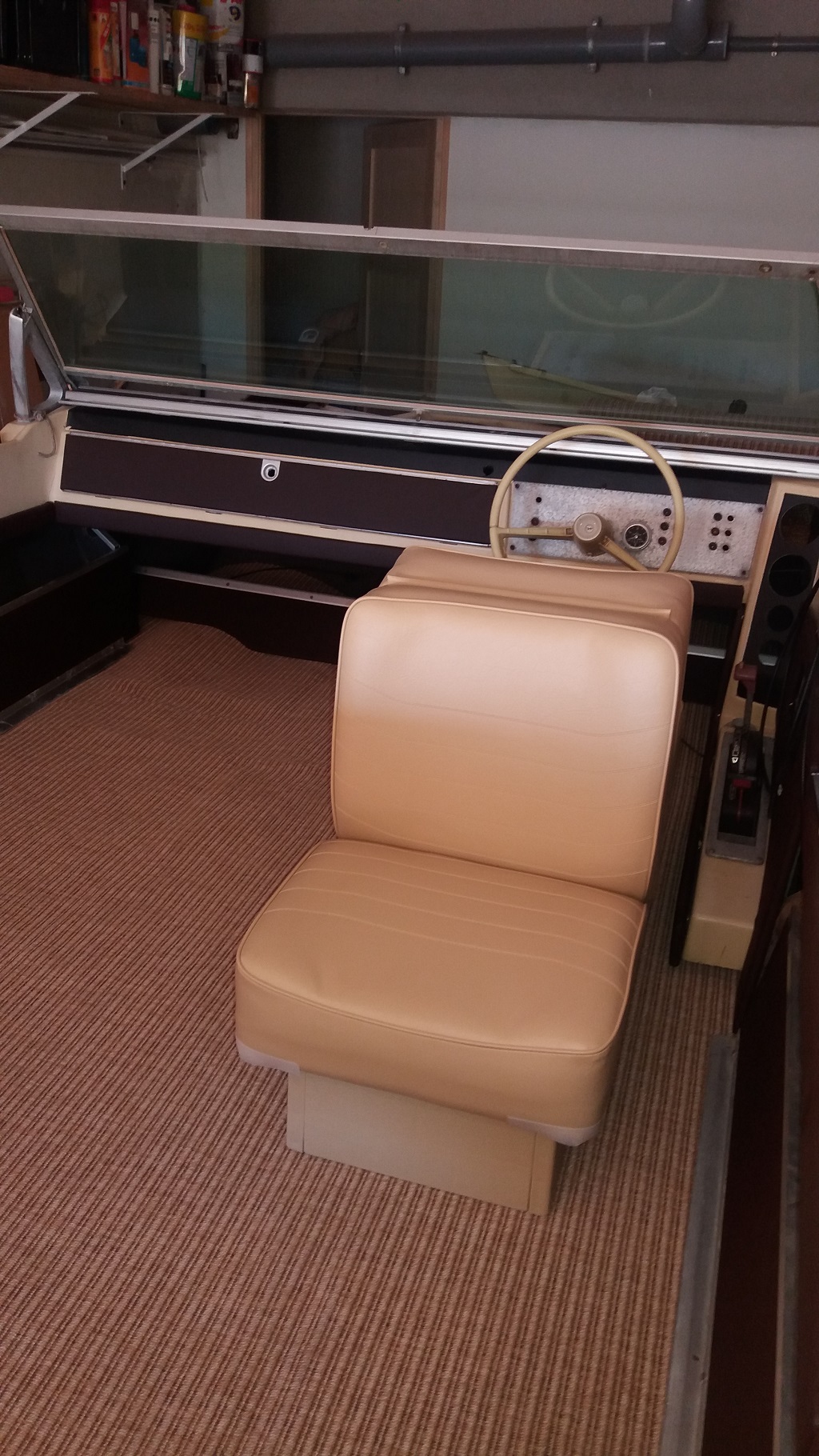

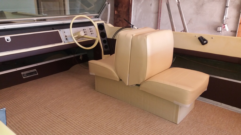

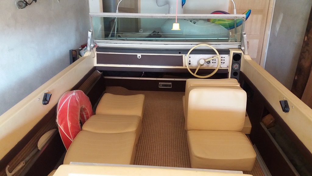

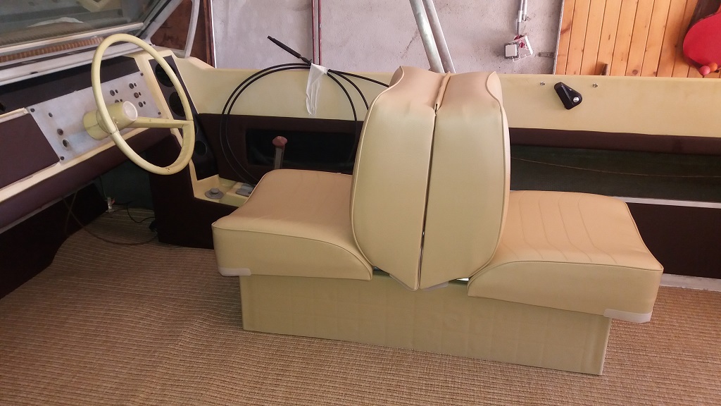

Carpet installation and seat positioning
New member, My project : johnson reveler 1967 7 years 5 months ago #139609
  • evb11
  • Junior Boarder
  • Junior Boarder
  • Posts: 94

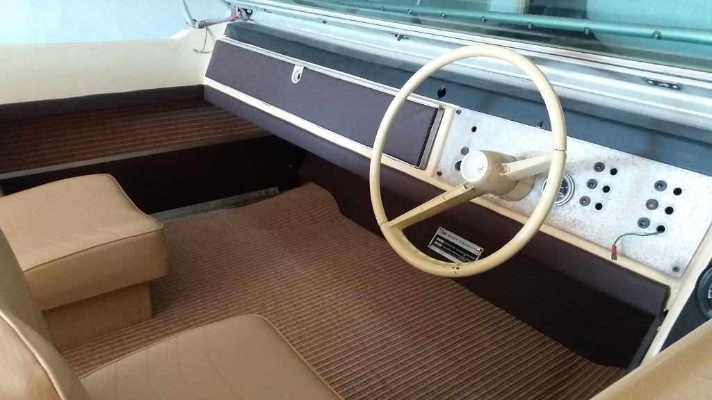

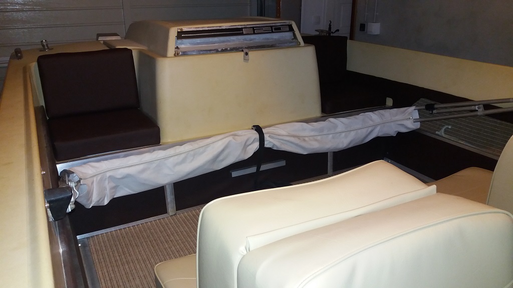

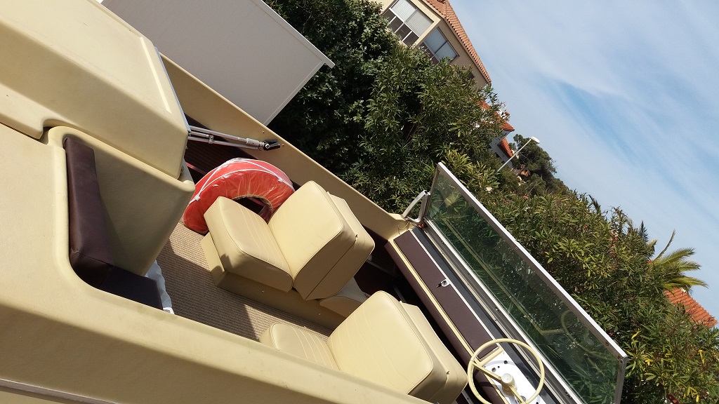

The ended inside

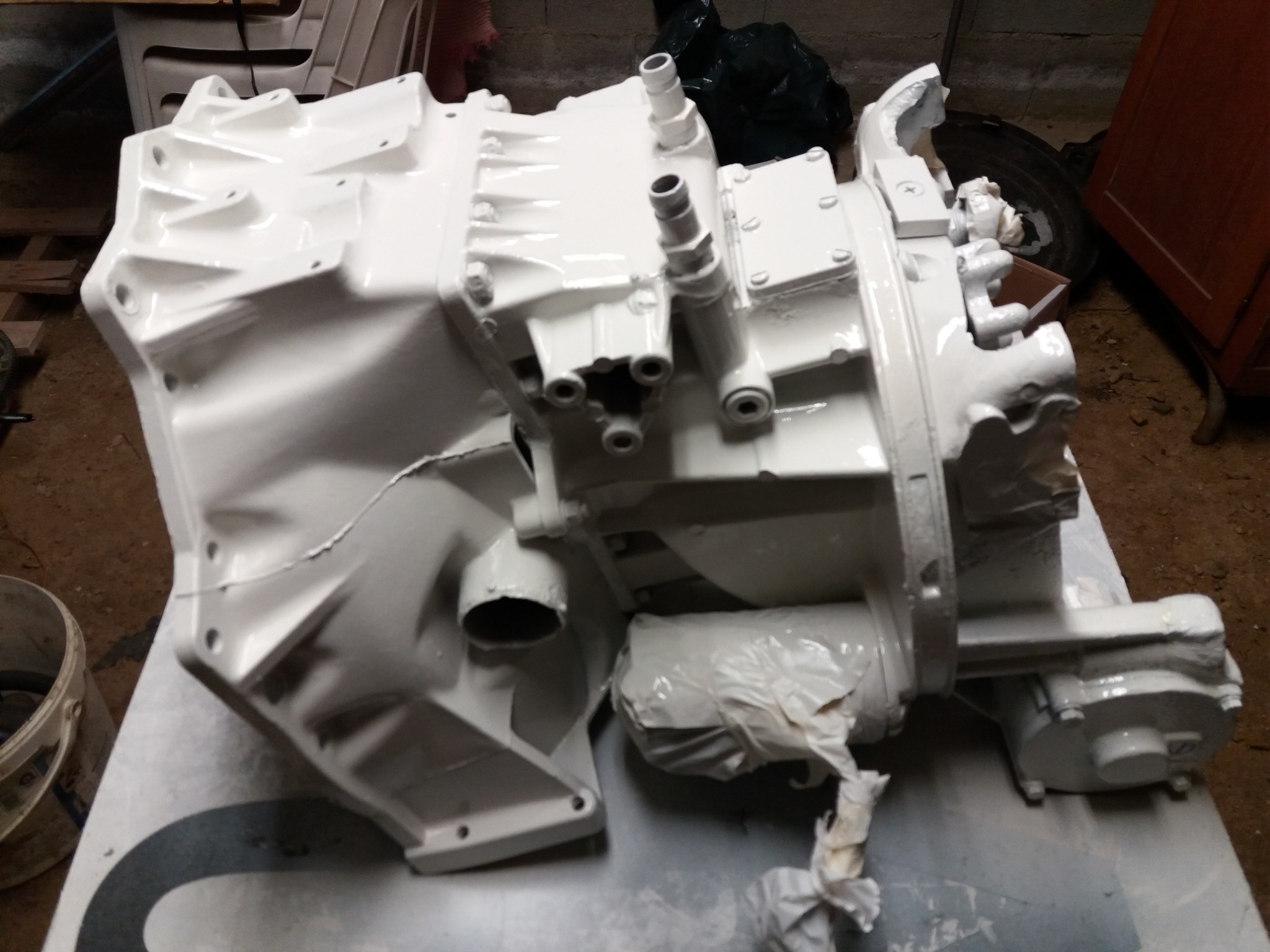

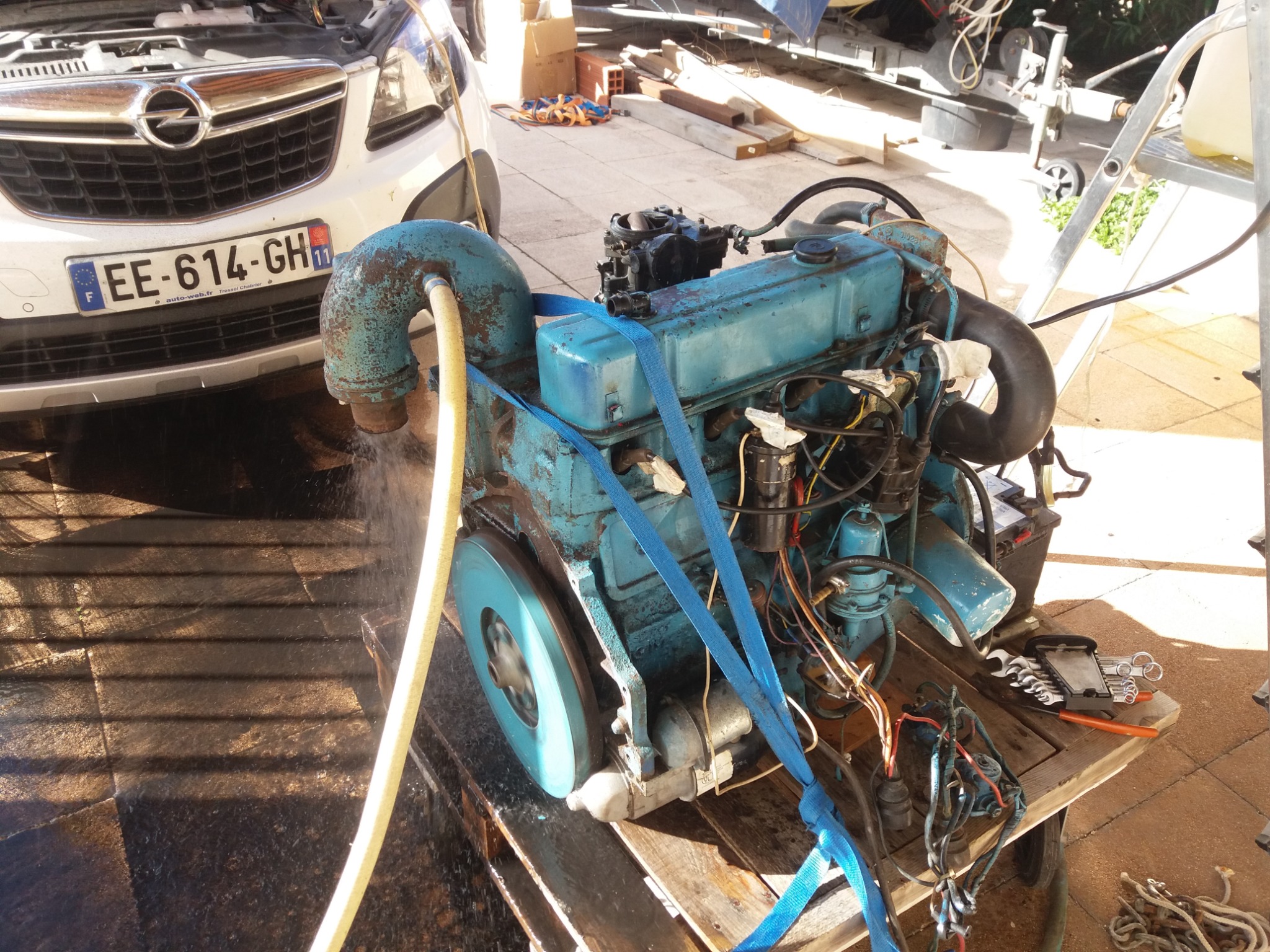

I’m having a compatibility problem fixing the omc Coupling on my Mercruiser. I can’t fix the Coupling on the flywheel. Coupling fixation is not the same on the new Mercruiser model than the old one. The CRANKSHAFT is différent. Does anyone have a solution?
Thanks

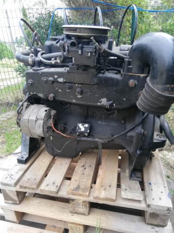

I’m actually thinking of putting back the original engine, an omc 120hp. I was wrong looking at the serial numbers of the boat. It is a reveler 120 and not a 155 as I originally thought. I have put on sale my Mercruiser 140
Changing the outdrive requires completely redoing the back panel. I don’t want to do this work. I want to keep the boat as it was originally.

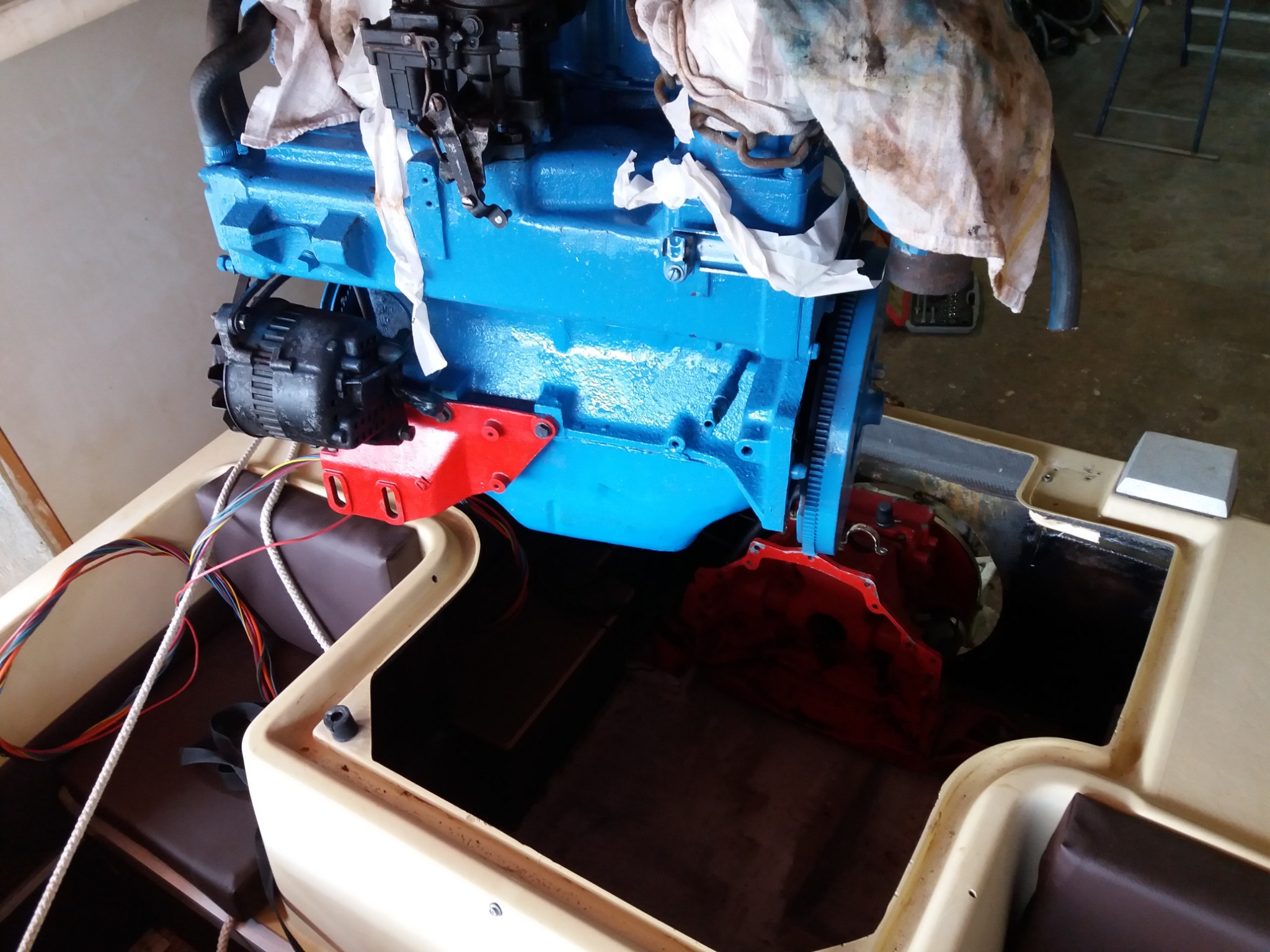

New member, My project : johnson reveler 1967 6 years 8 months ago #141809
  • evb11
  • Junior Boarder
  • Junior Boarder
  • Posts: 94

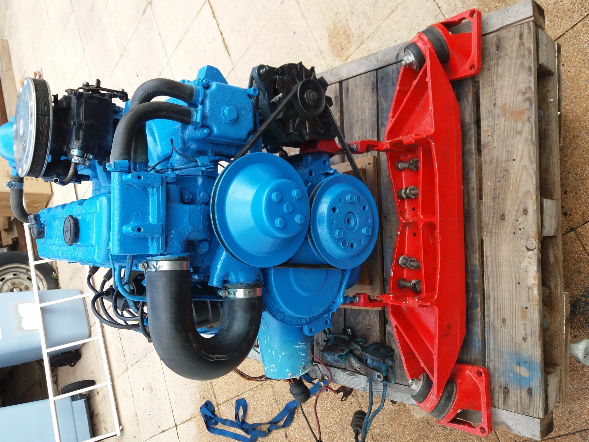

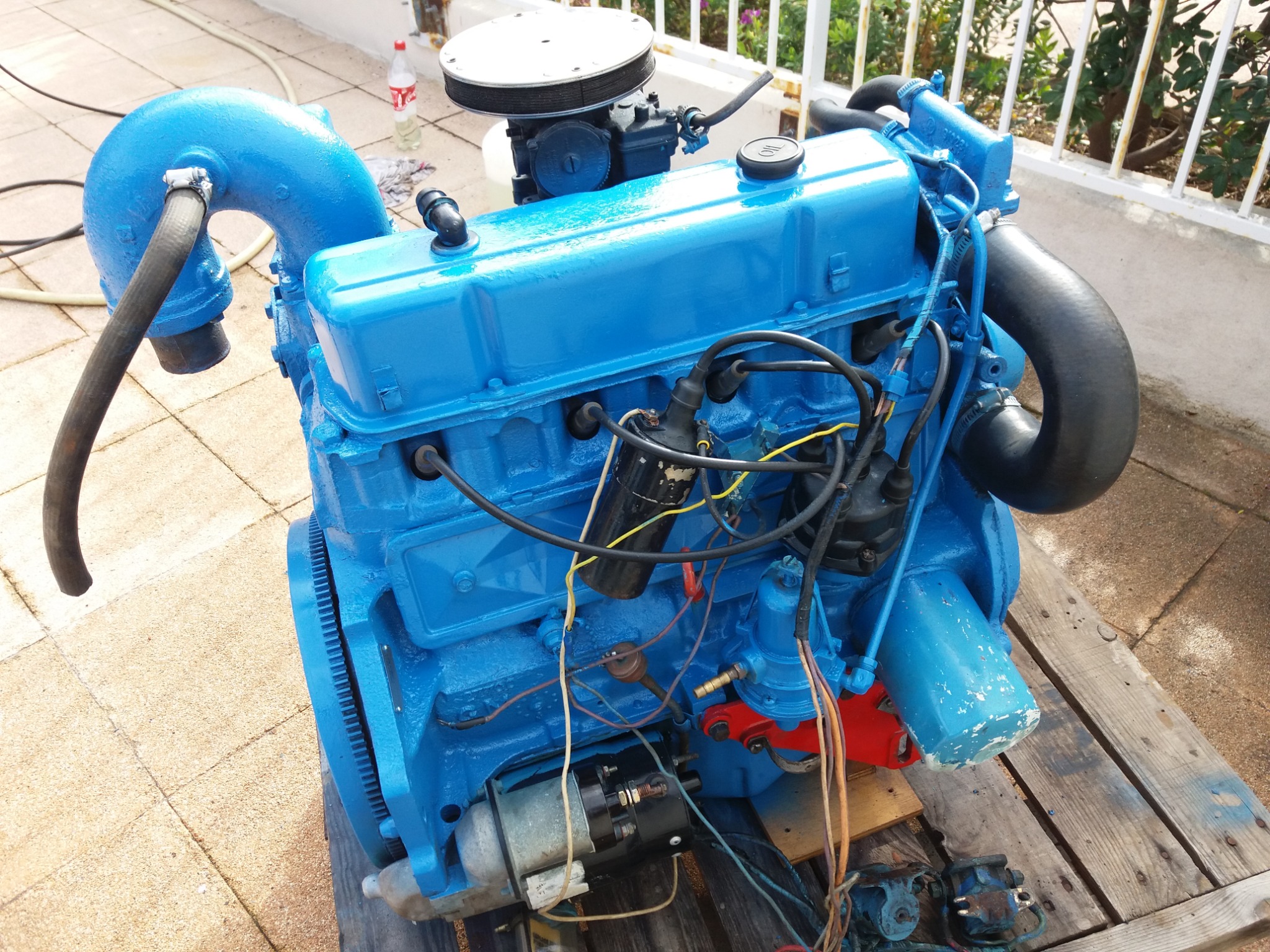

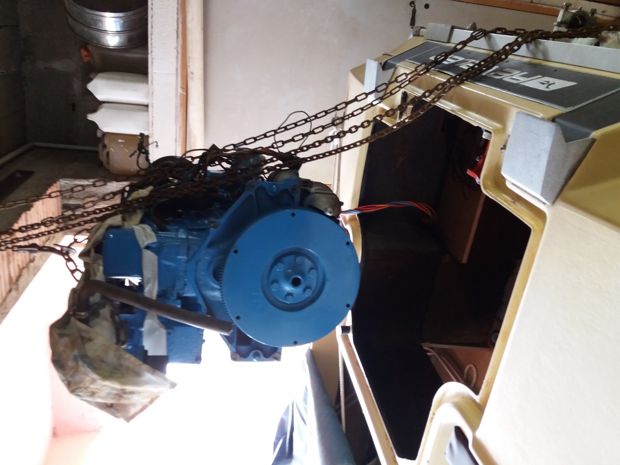

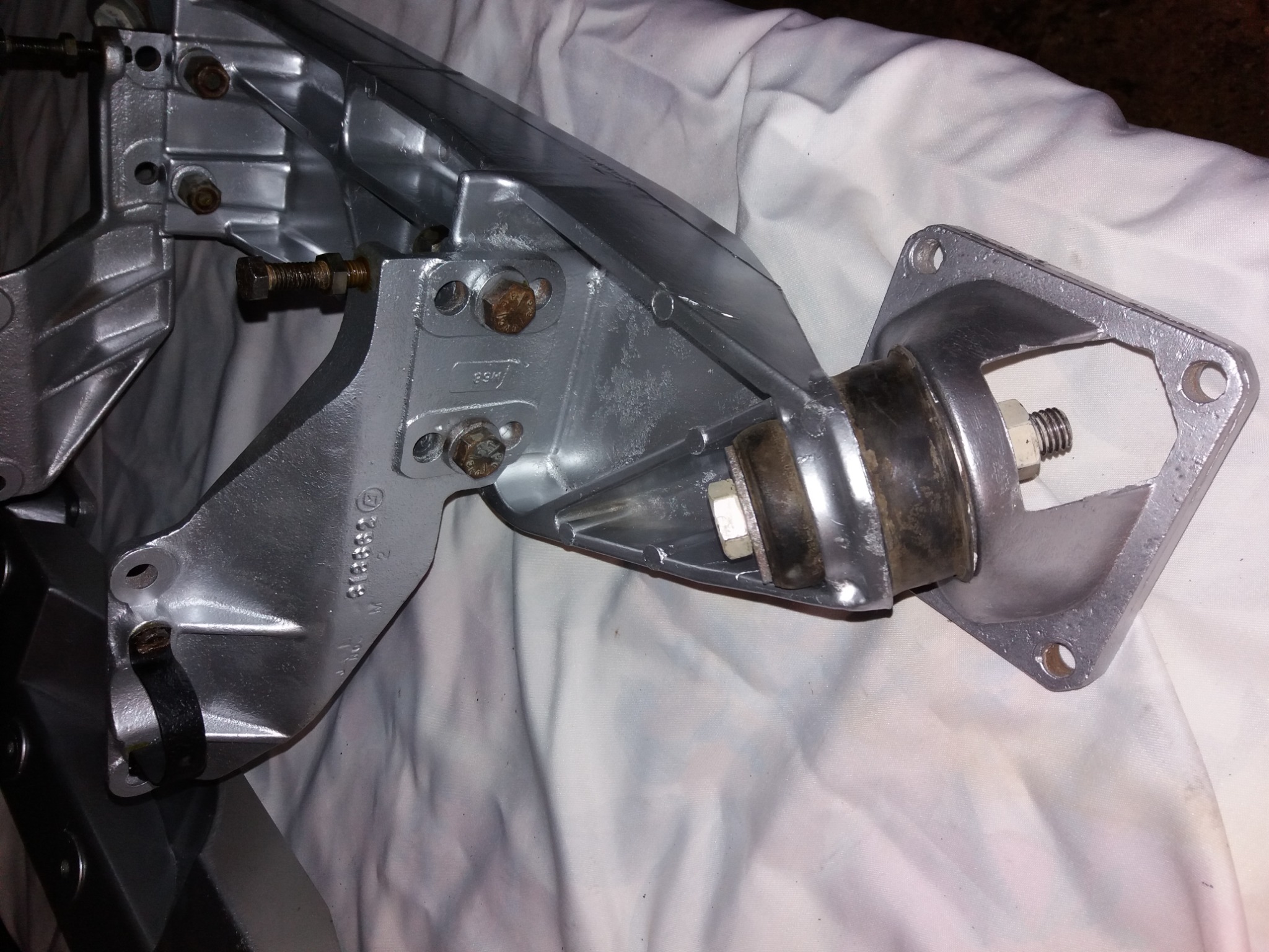

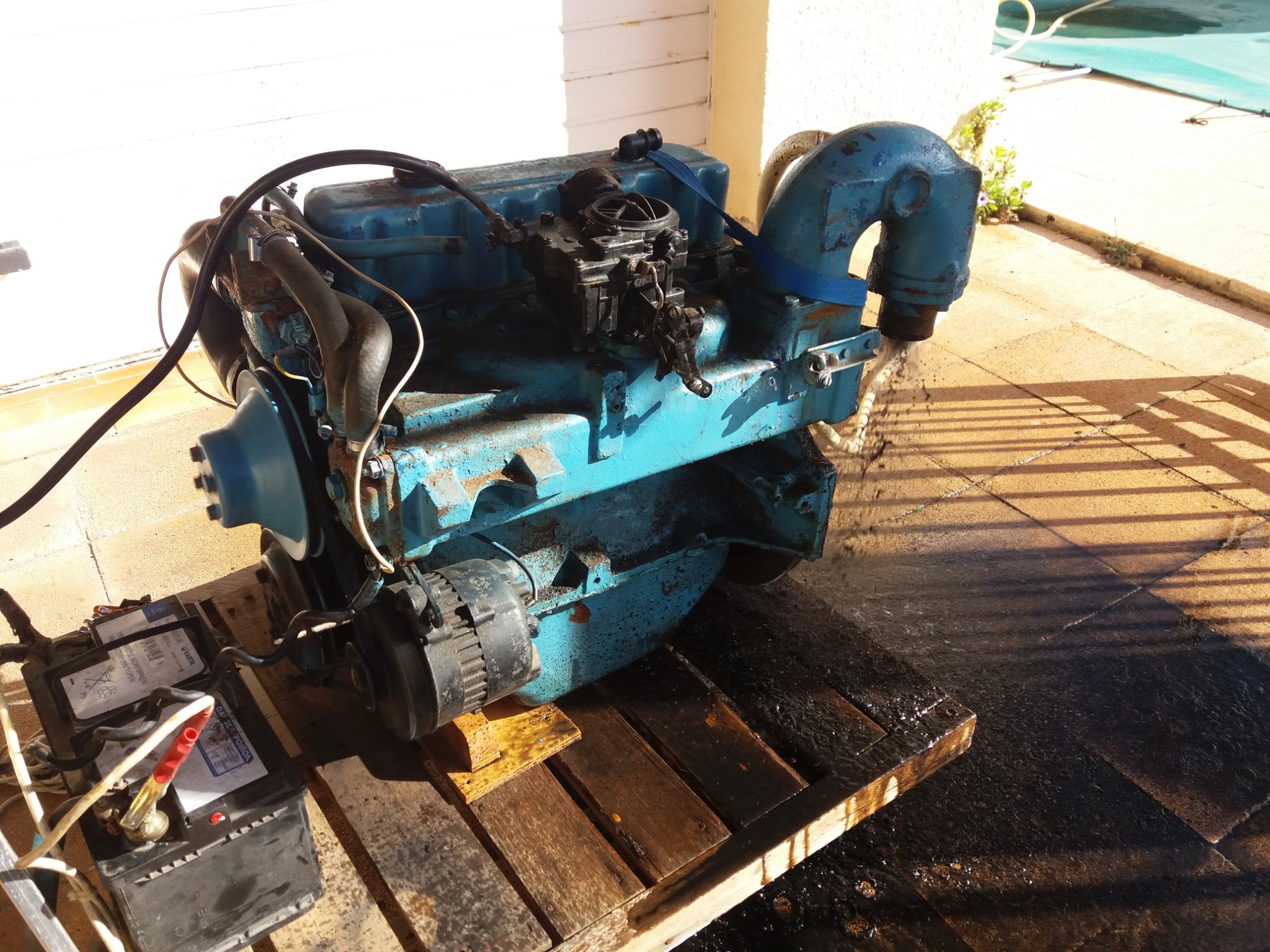

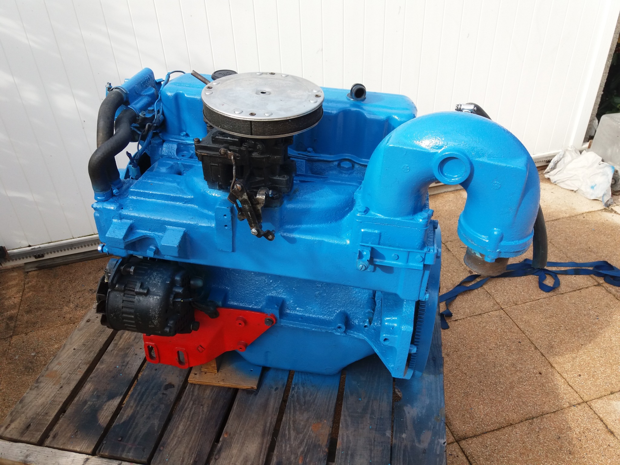

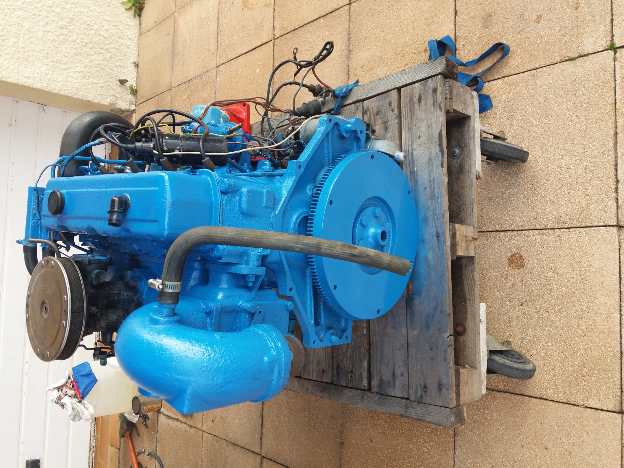

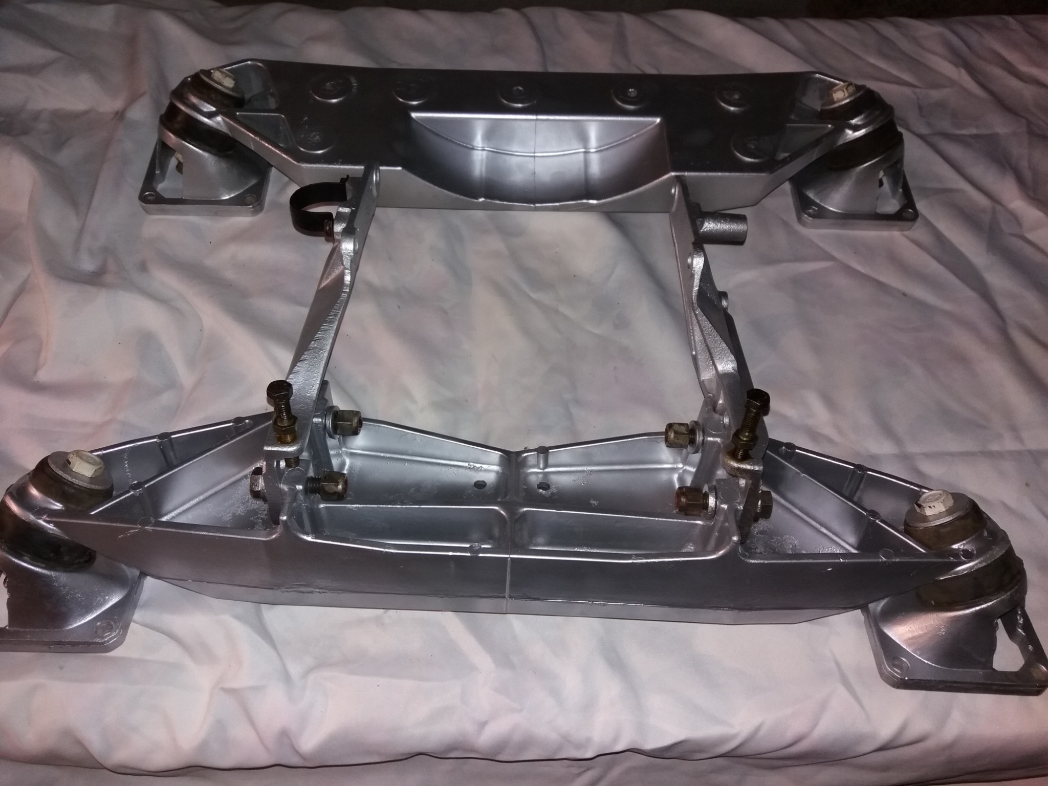

]My new engine. Omc 120 hp. Small restoration. degreasing, painting. it is cleaner

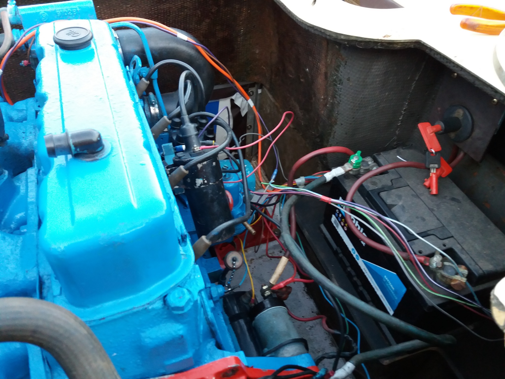

New member, My project : johnson reveler 1967 6 years 8 months ago #141811
  • evb11
  • Junior Boarder
  • Junior Boarder
  • Posts: 94

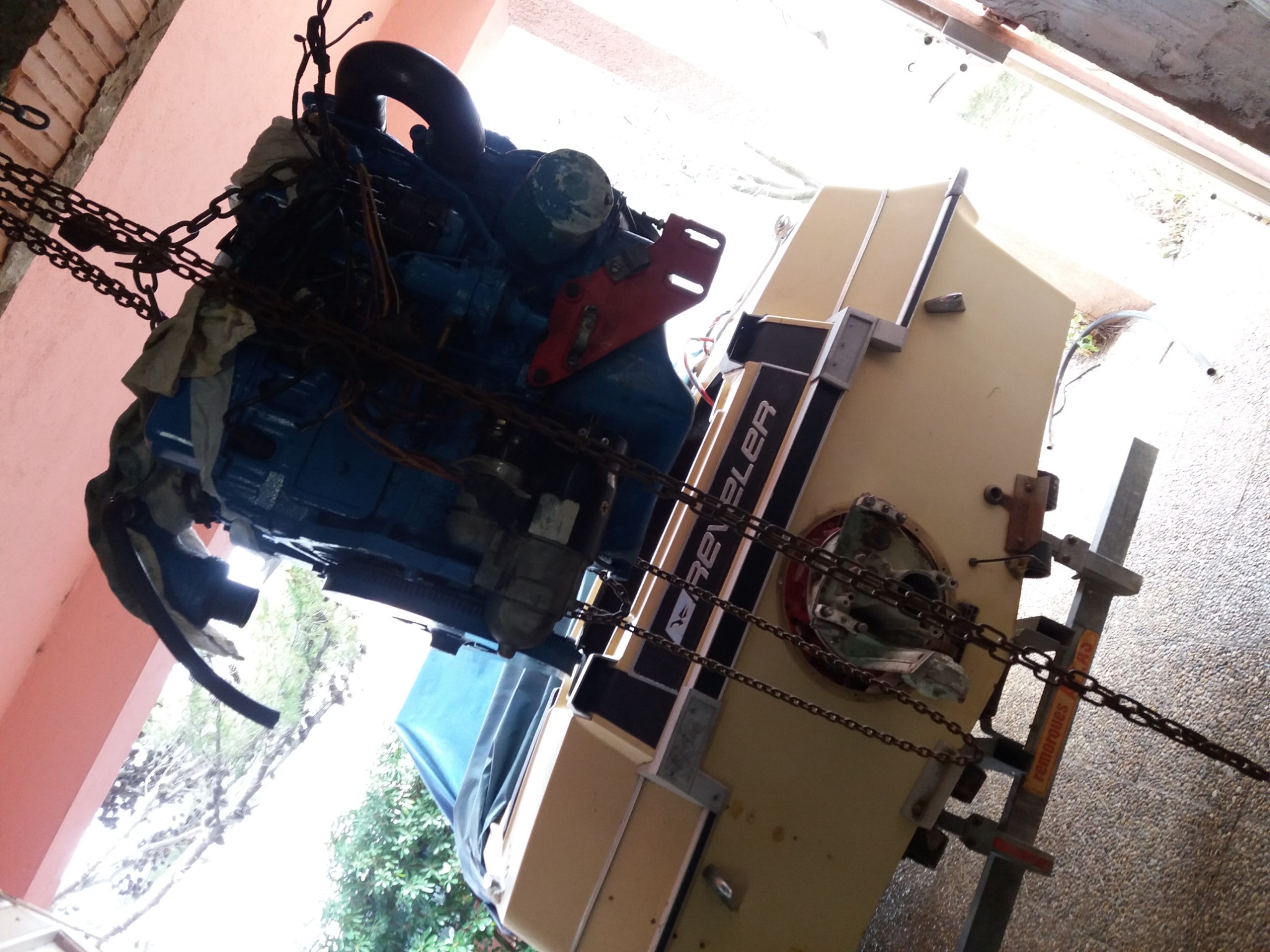

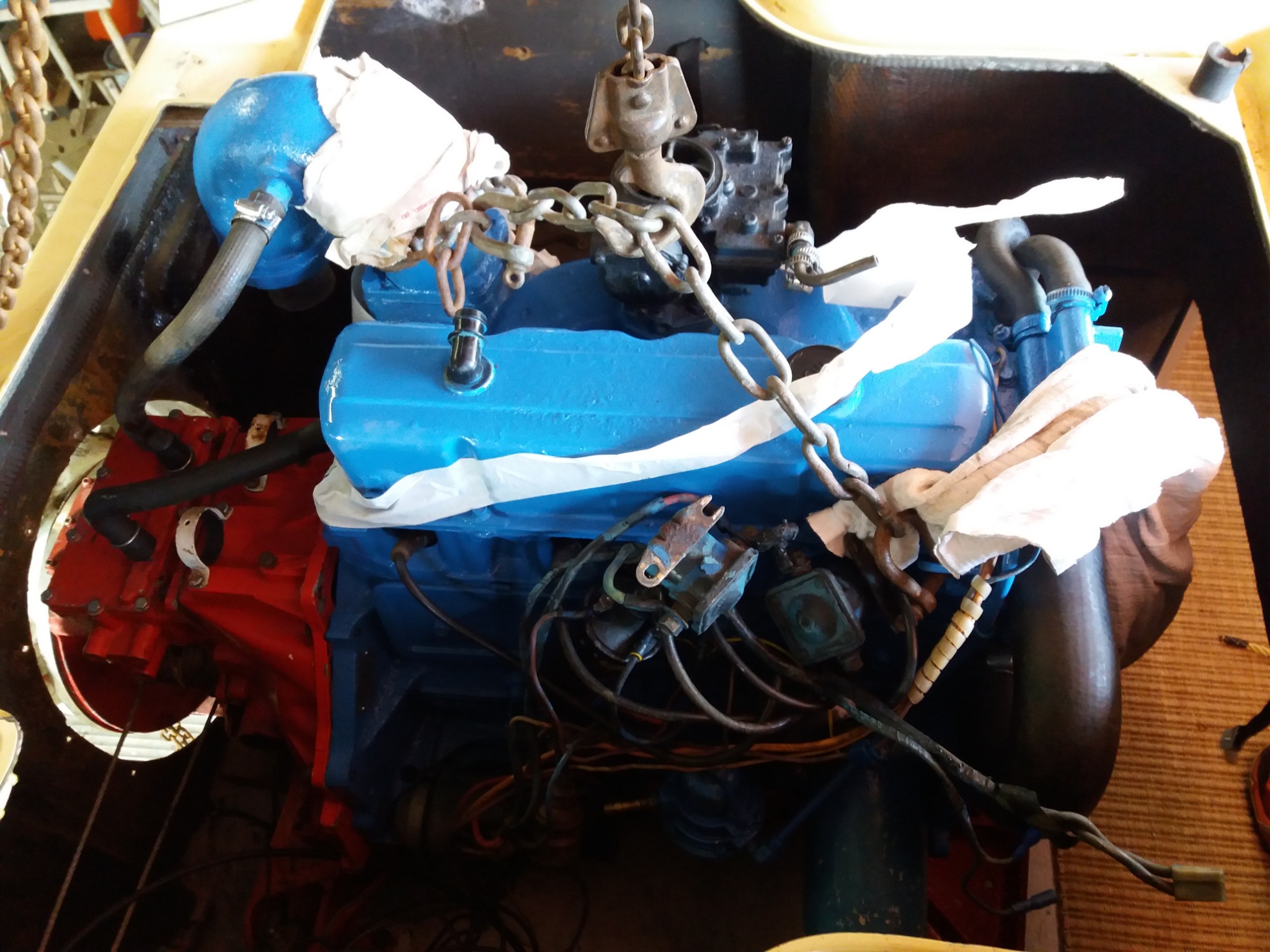

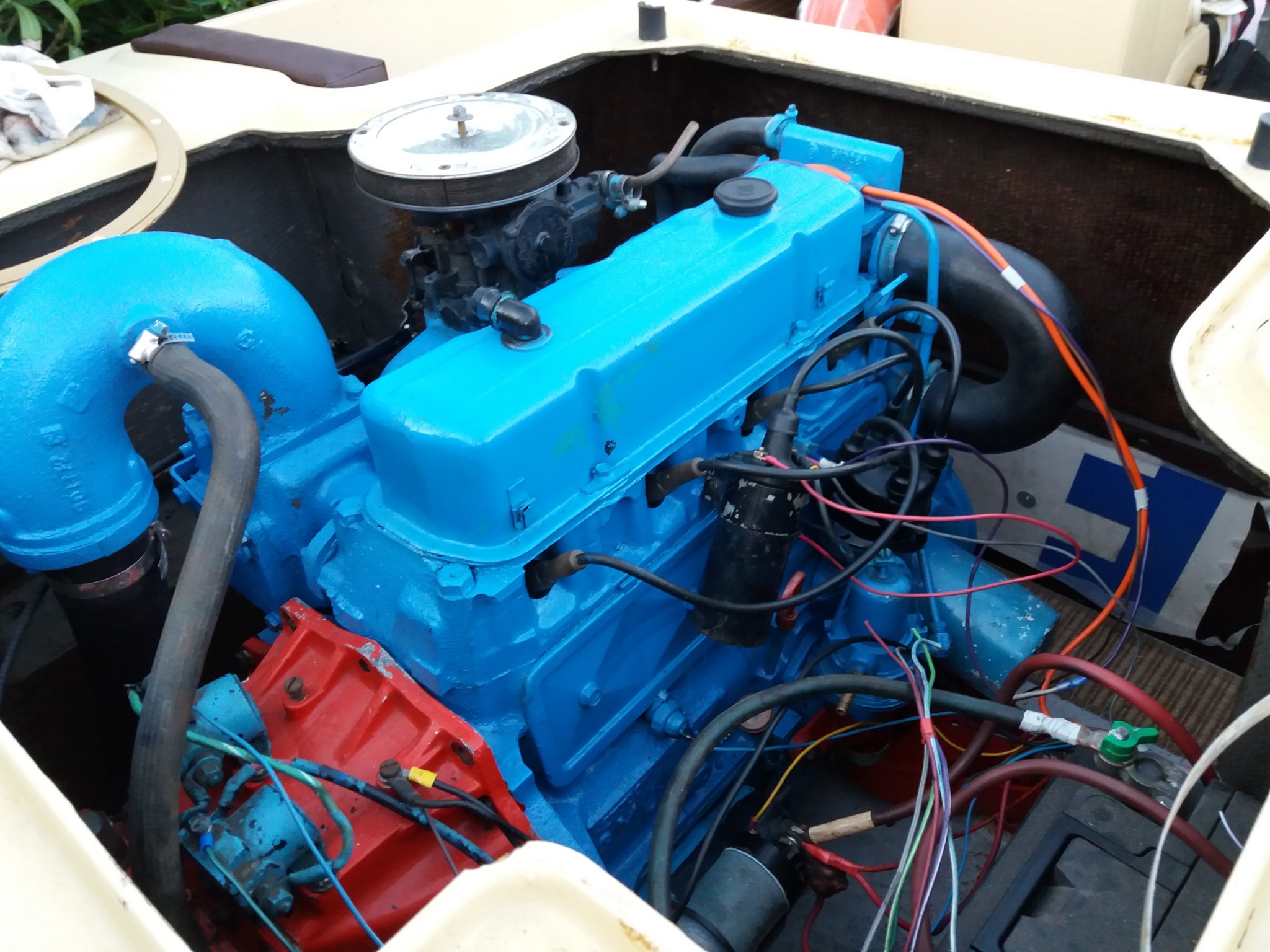

Engine inside, next step the electrical connections...

Nice. Making major progress. I used to have a plastic toy boat that look very much like this model except in green. Yours has a very clean look about it.

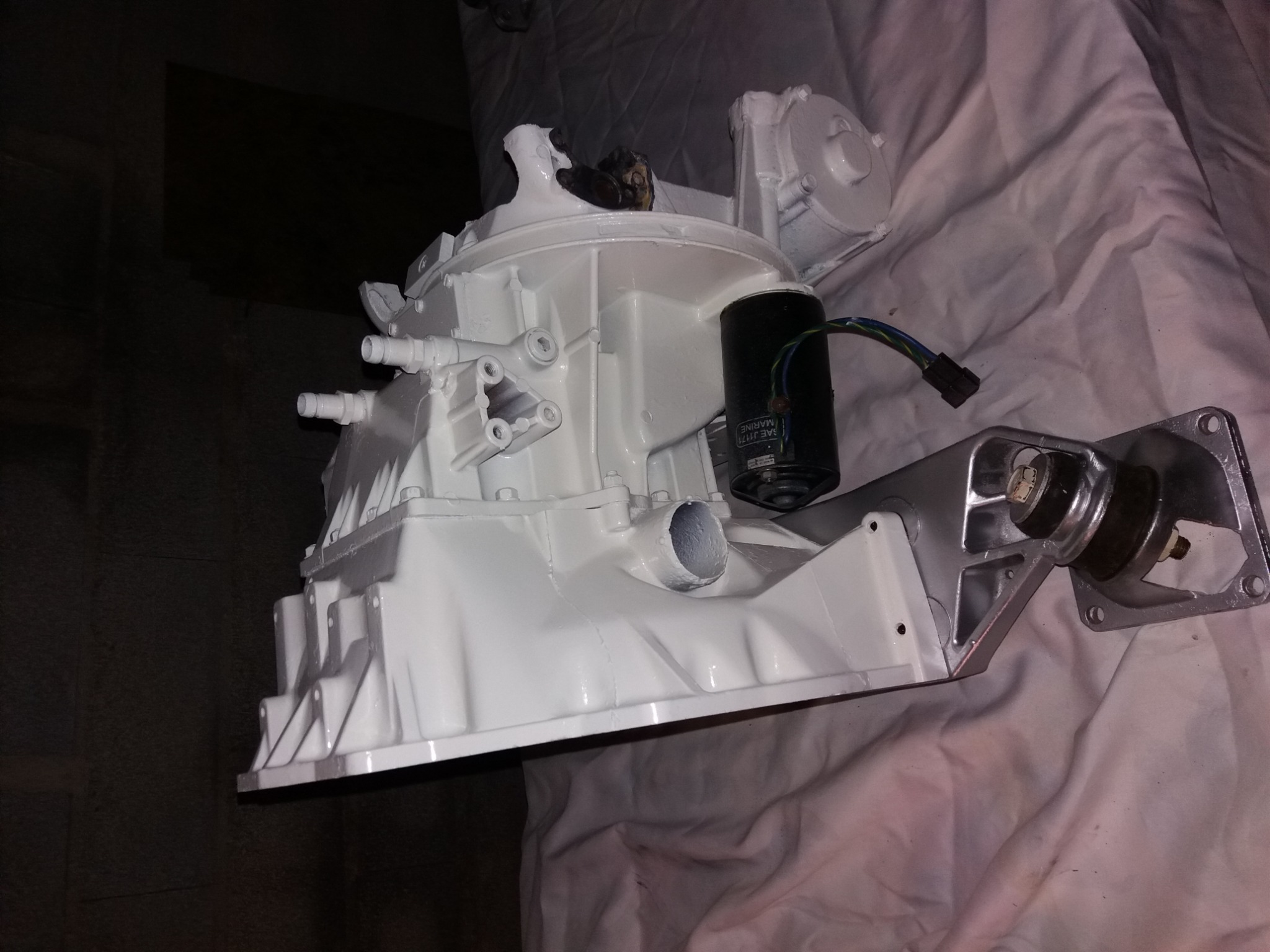

It is a job that I would like very much! My professional activity leaves me time, so I can reconcile work and leisure ;)
New member, My project : johnson reveler 1967 6 years 7 months ago #141973

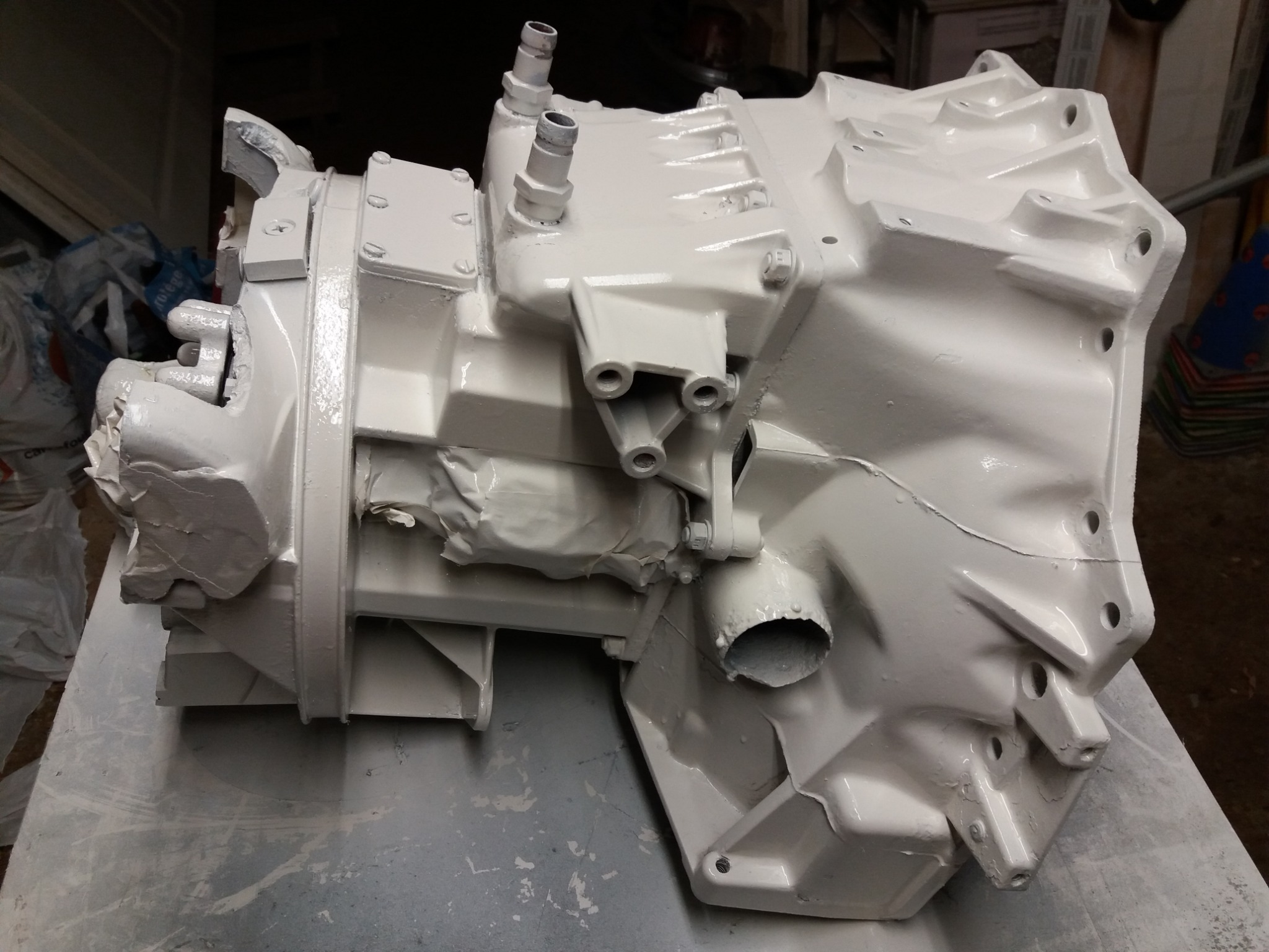

The ball gear looks like it's in really good condition. Most are worn down from people running with the trim foo far up. Jan will provide free housing, meals, and transportation plus unlimited health care for you and family. Just bring your talent and beer.

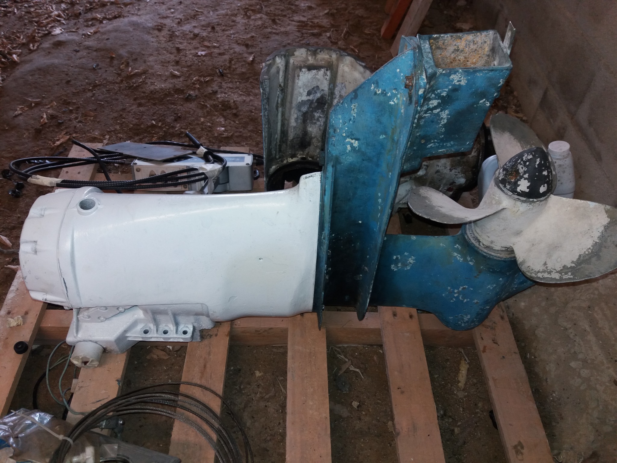

Indeed it is in good condition. I have to take care gearcase group now but I have more paint !

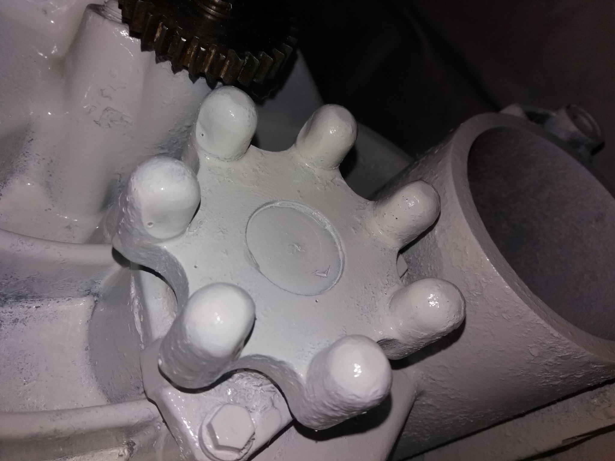

New member, My project : johnson reveler 1967 6 years 7 months ago #141978
Does the power trim still work? If I can recall it just takes regular oil but should be nice and clean. I do have some spec material for that. I'll have to look for it. Your welcome to have it if you want. I think it's for the 155hp V6.

63 Sabre wrote: Does the power trim still work? If I can recall it just takes regular oil but should be nice and clean. I do have some spec material for that. I'll have to look for it. Your welcome to have it if you want. I think it's for the 155hp V6.
I cleaned it, but I didn’t test it. I don’t have what it takes here. Actually the parts come from a omc 155 but the engine I install is the original 120 hp engine. These pieces are replacement pieces in case of breakage. In france parts become rare and expensive !
For specific equipment it would be cool but I live in france!!

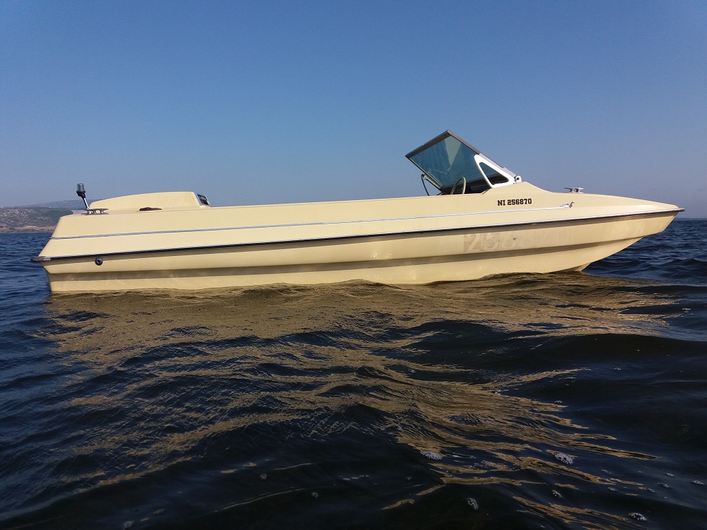

First run., a few more points to review cooling and fuel supply.......
