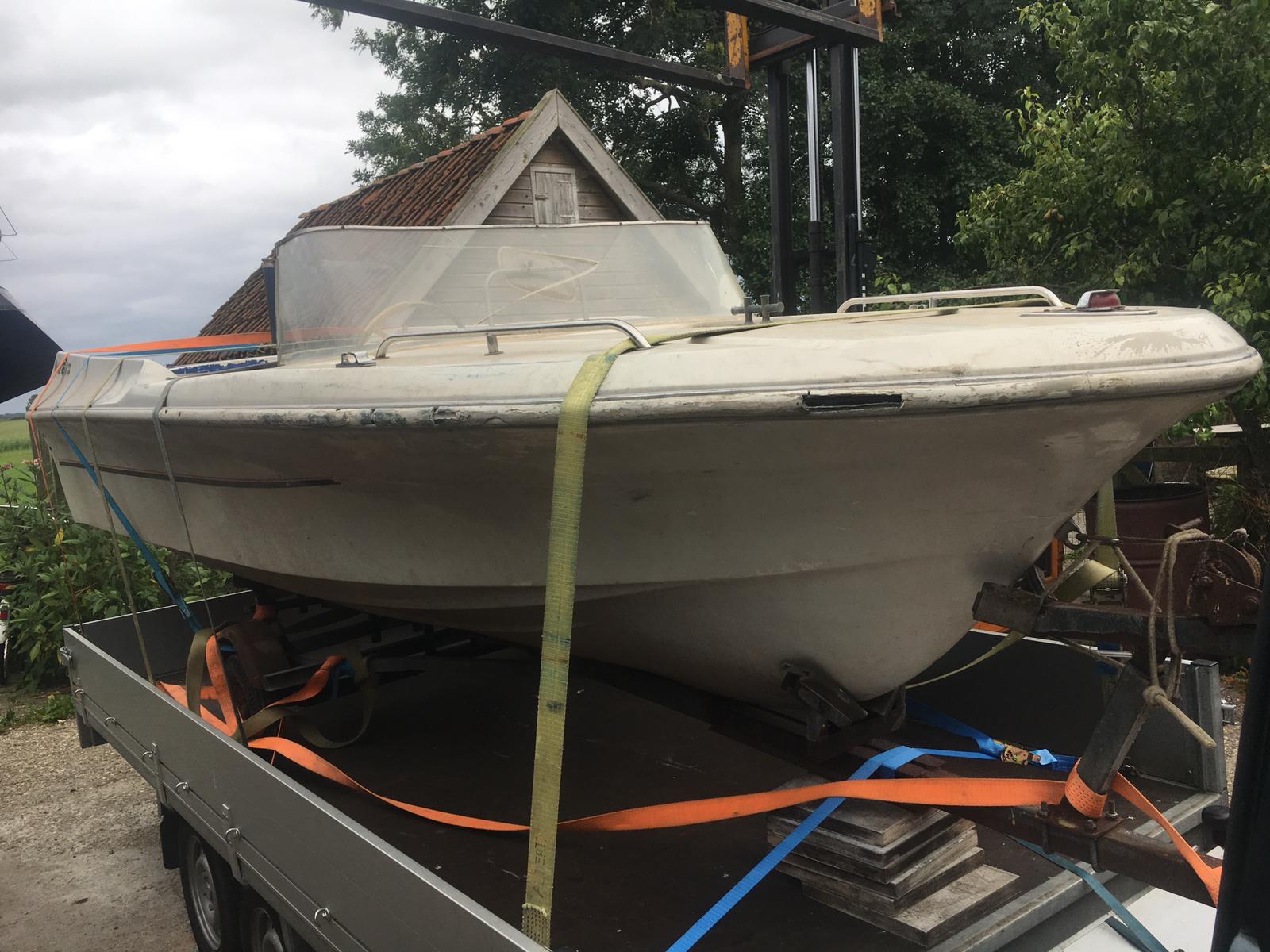

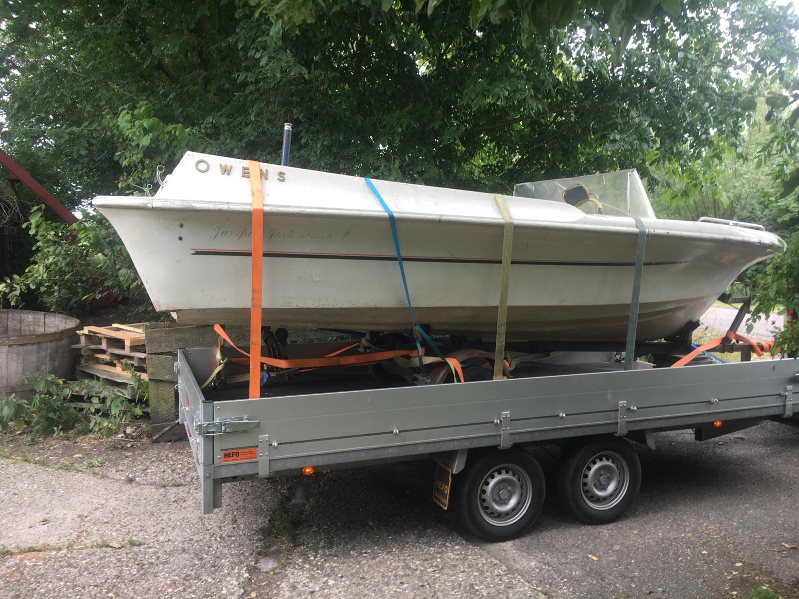

Hello and thanks for the invite. New as a member but not new to the website and library. I've been working on a 1960s Owens runabout. Ive done some work on it but I'm nowhere near completion. It wont be a classic restoration but more of a personal renovation. I have a lot of pictures of the work I did so far.
If anyone has any info besides whats on the forums I'd love to hear it.
