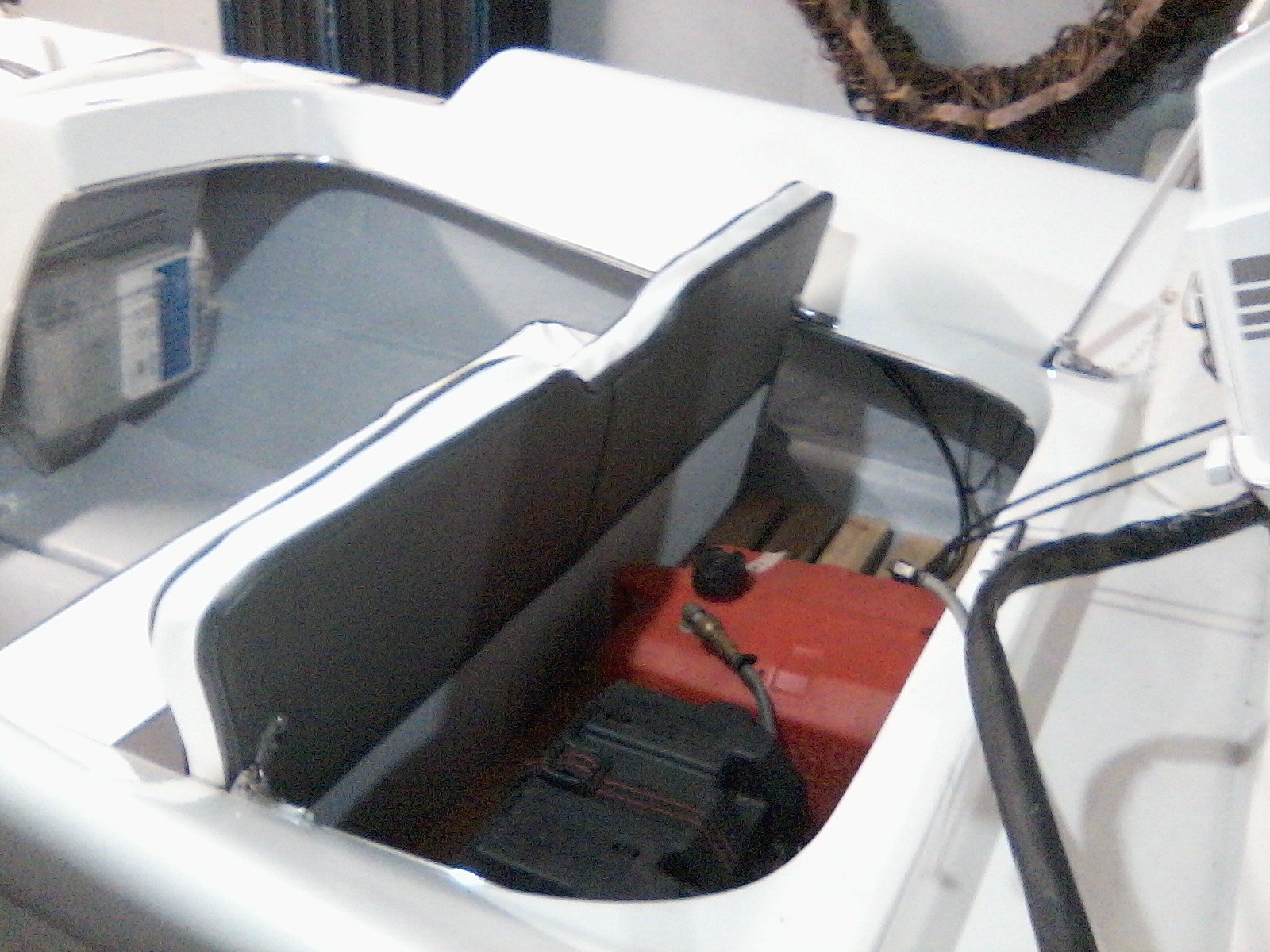

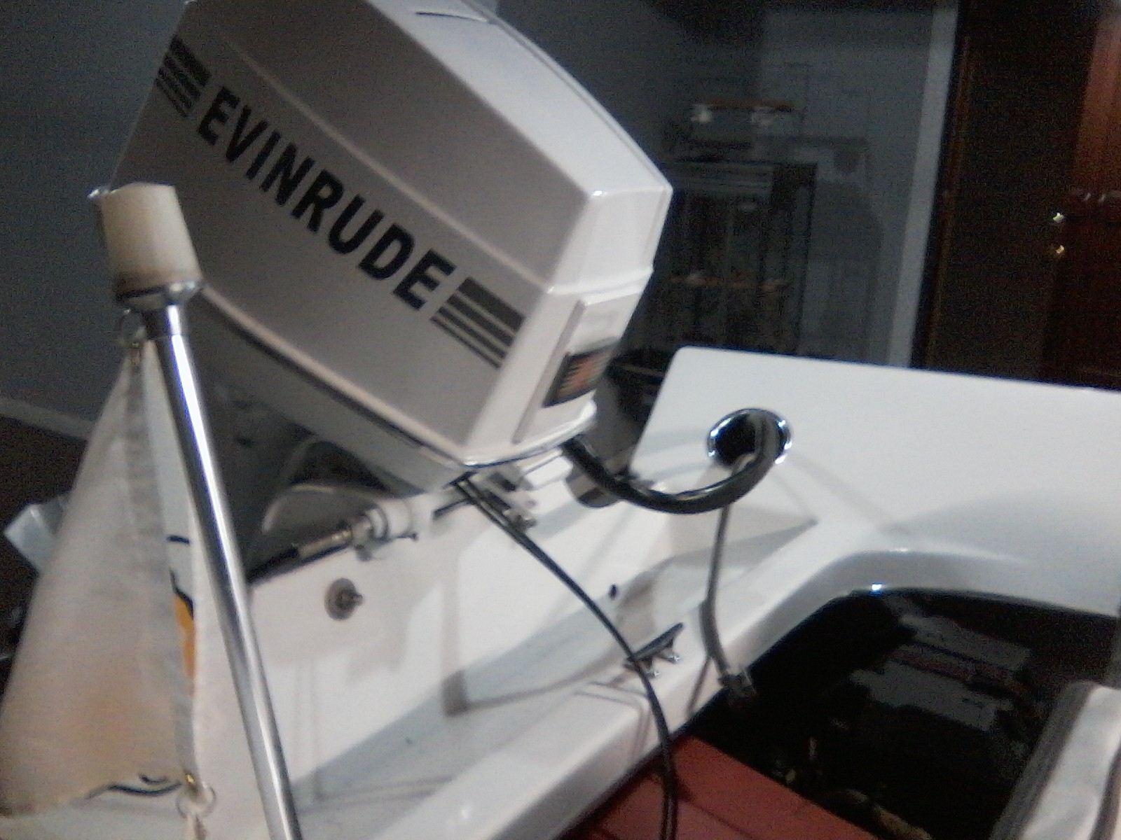

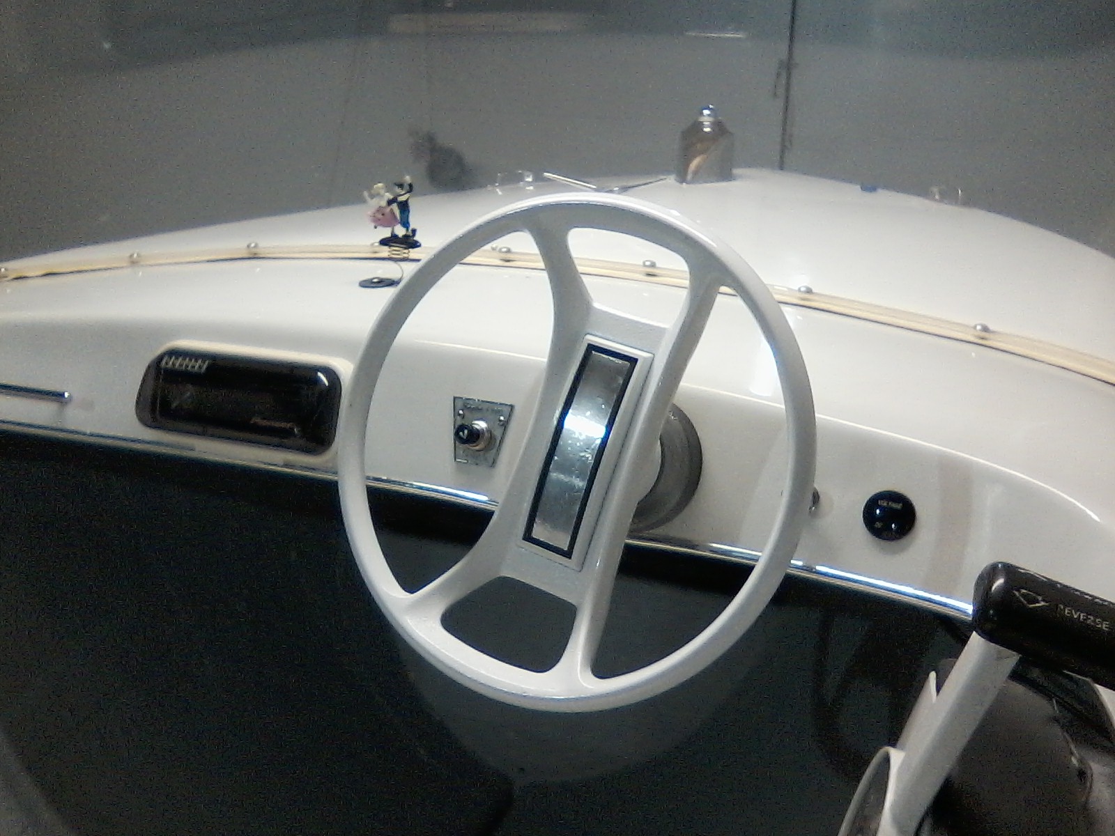

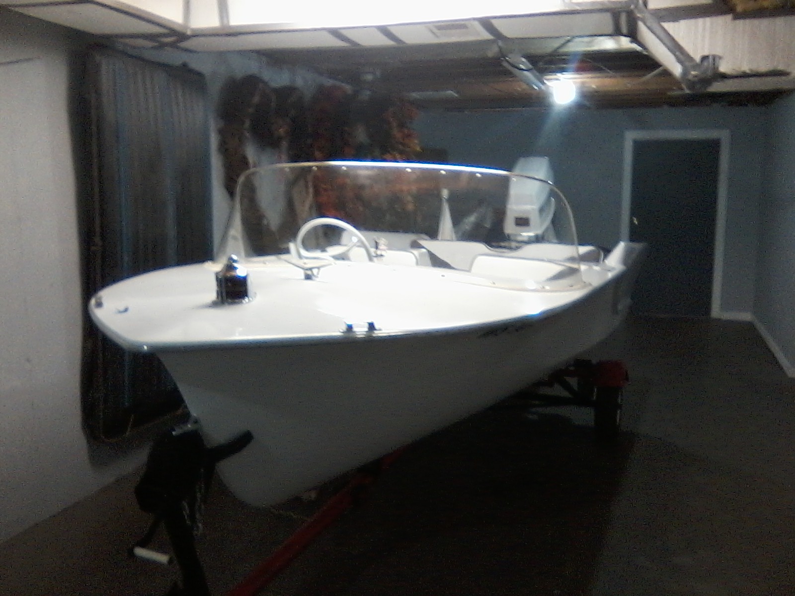

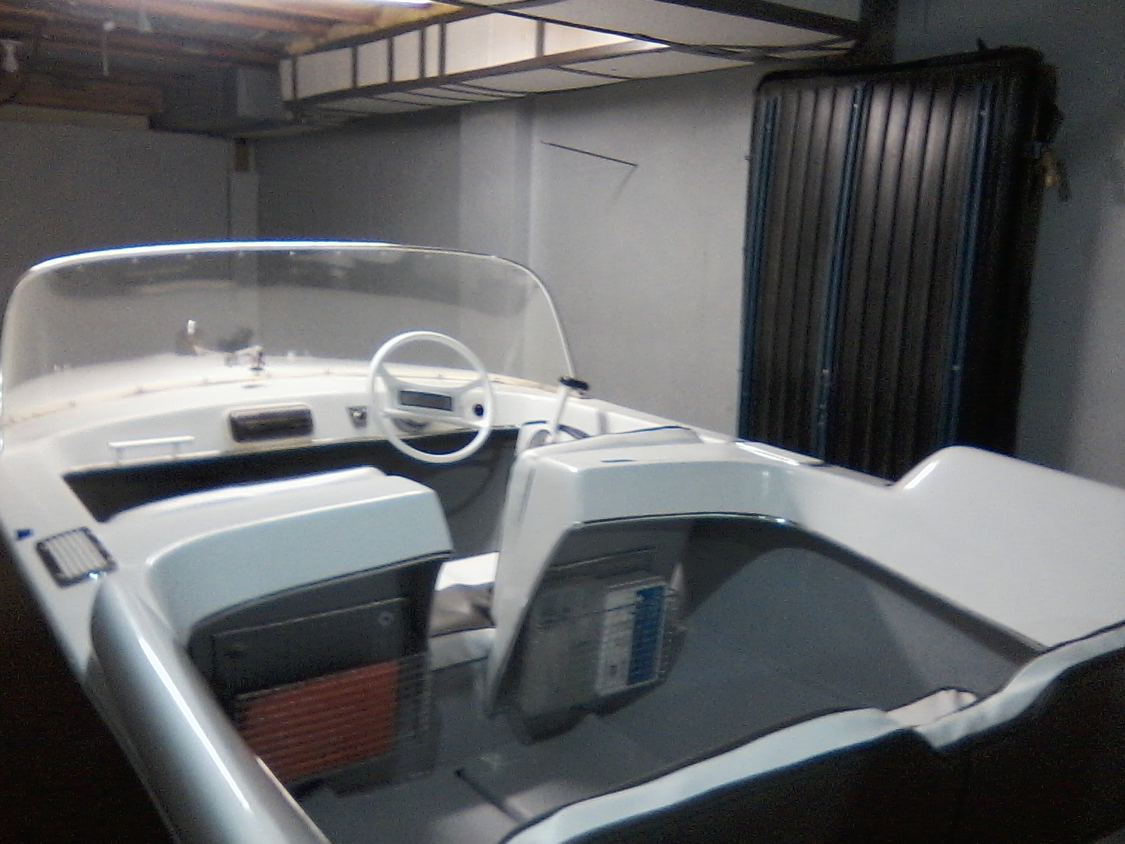

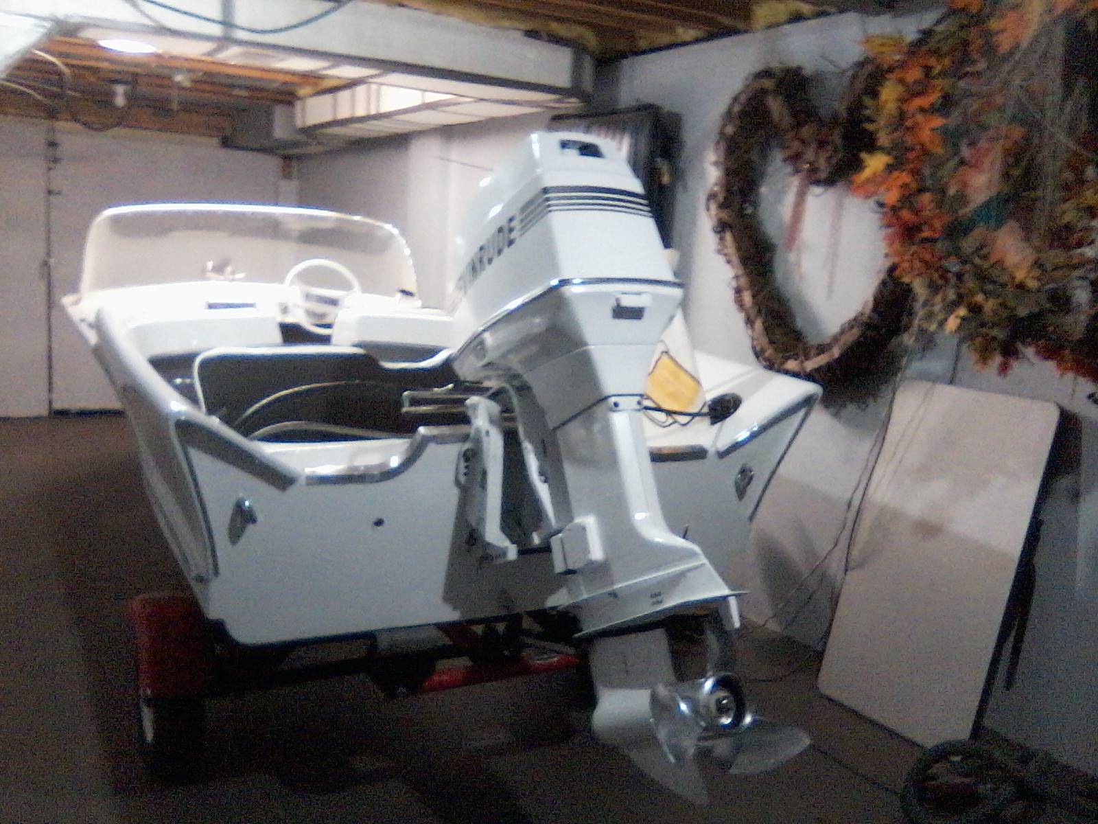

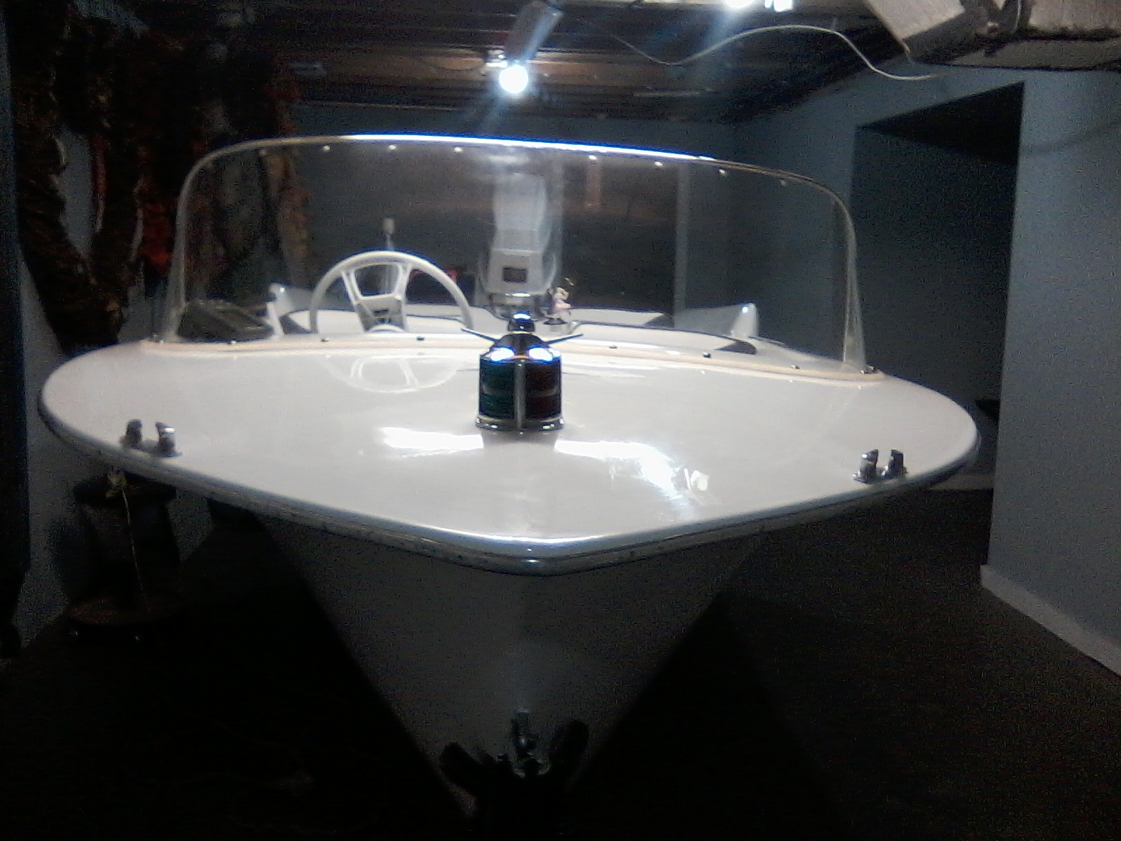

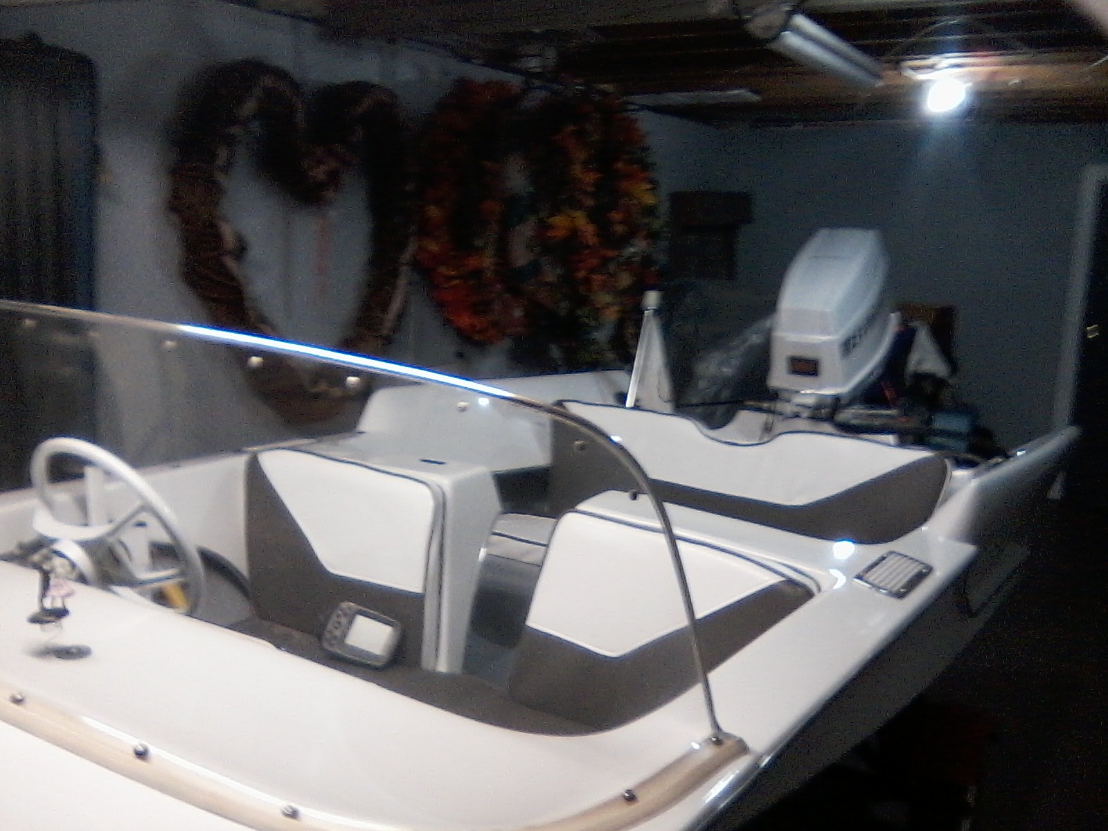

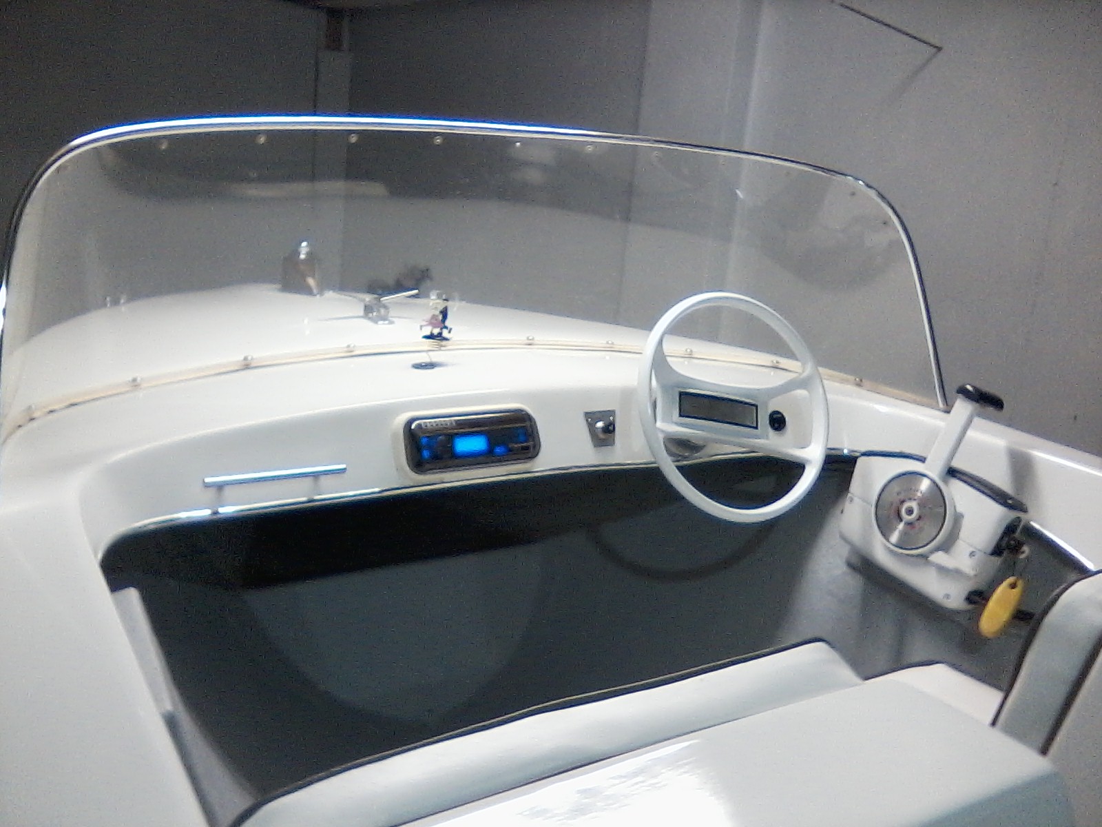

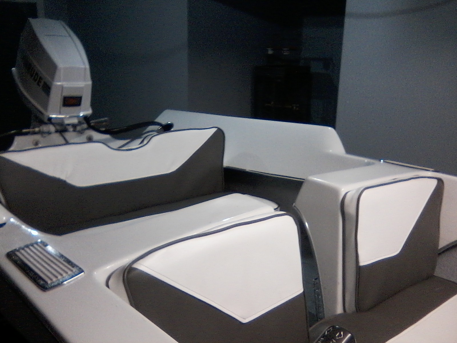

Last August I started a project, '60 14' Tomahawk ski mate on a Balko trailer. Like most of my fun time toys I couldn't decide what colors to use. Already did the red, blue, yellow, green etc. so decided to try white on white. After sanding the ski mate down I found that the original was actually white on white...imagine that. Just about got her finished up with some detailing to do. Now I can drag my feet during the winter. This is what I started with. Note the 5" rise added to the transom :woohoo:
Fun little runabout, easy to launch and pull. Shouldn't be too shabby with the '78 70hp Rude.

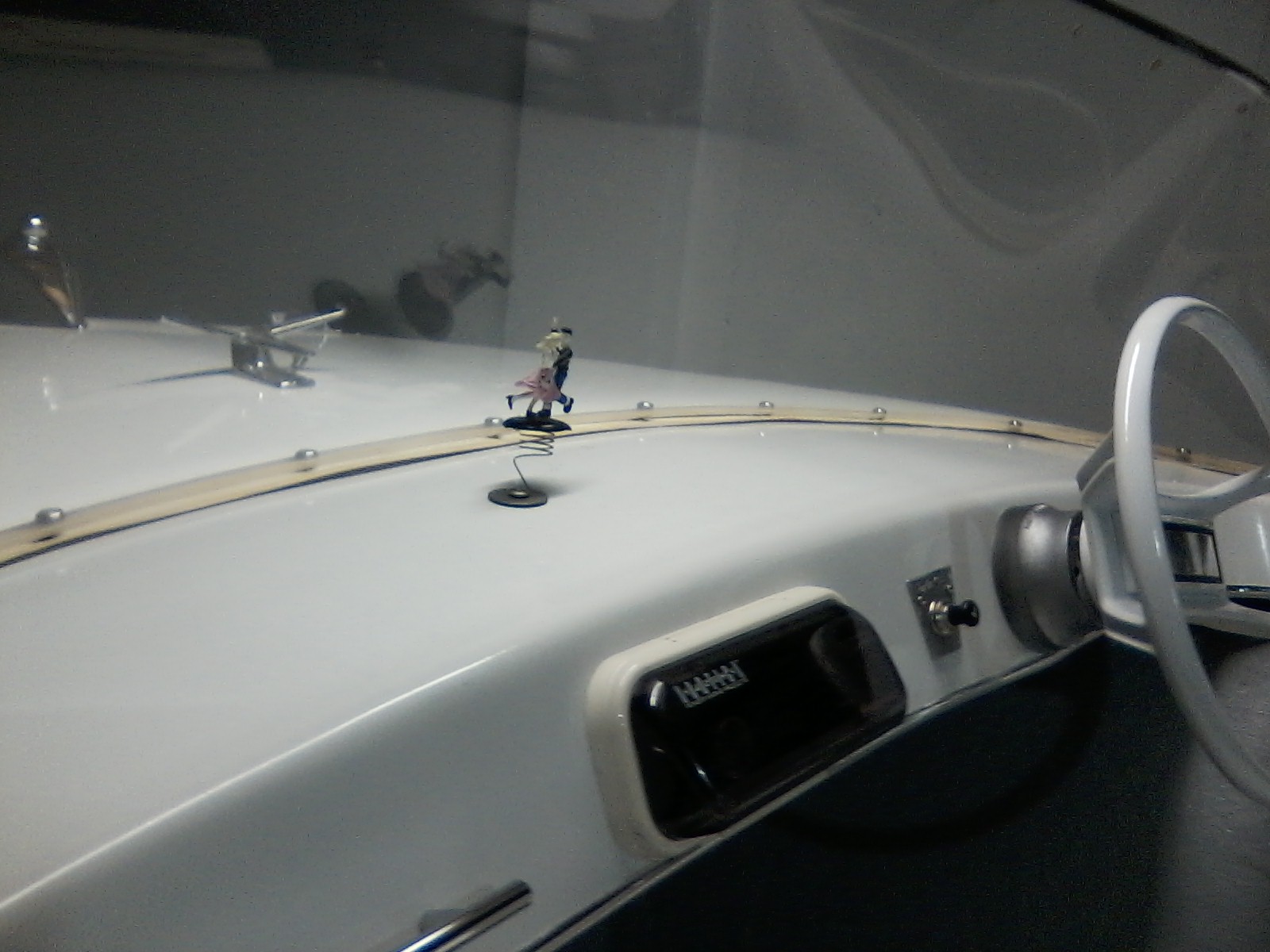

Nice. I even see a stereo in there, so does that make this a keeper. Very nice work. That rig really looks nice.
Dr.Go!
White on white 7 years 3 months ago #138570
Another outstanding job as usual Cal!!!!

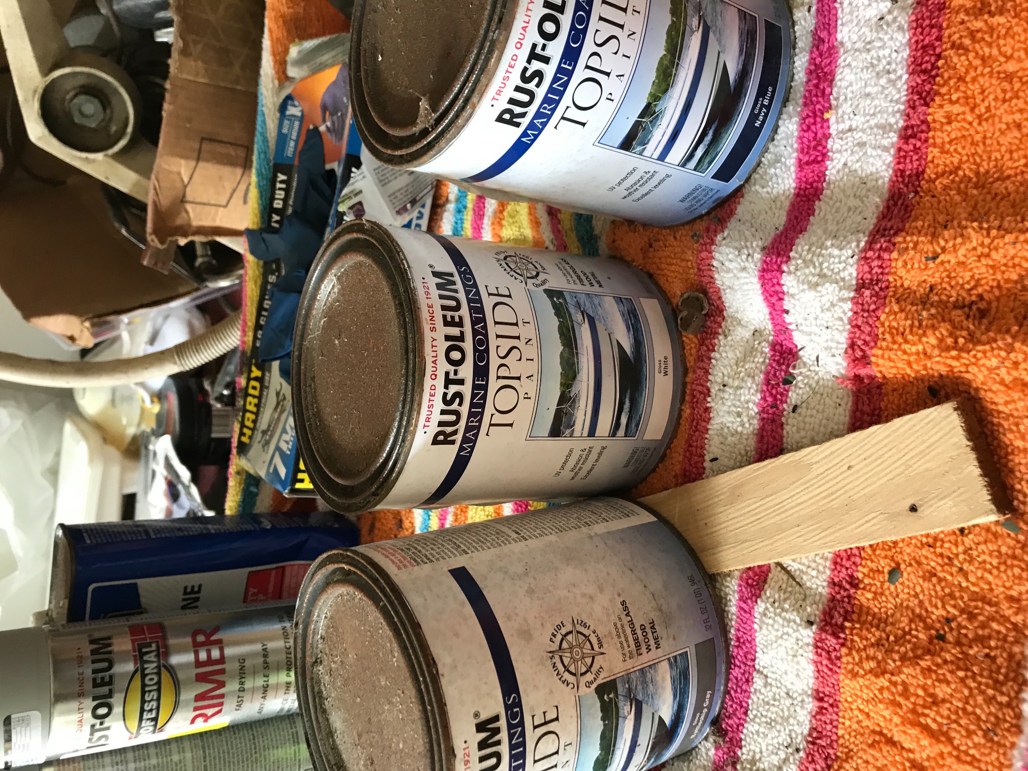

What brand of paint do you use? Ive been considering using rustoleum marine brand paint based on discussions with previous posters on this forum. The boat wont get a lot of use but i do want something that will hold up. Id be interested in knowing what products you use for filling pinholes, fairing, priming and paint? I love this little boat but the two of us are getting older by the minute!

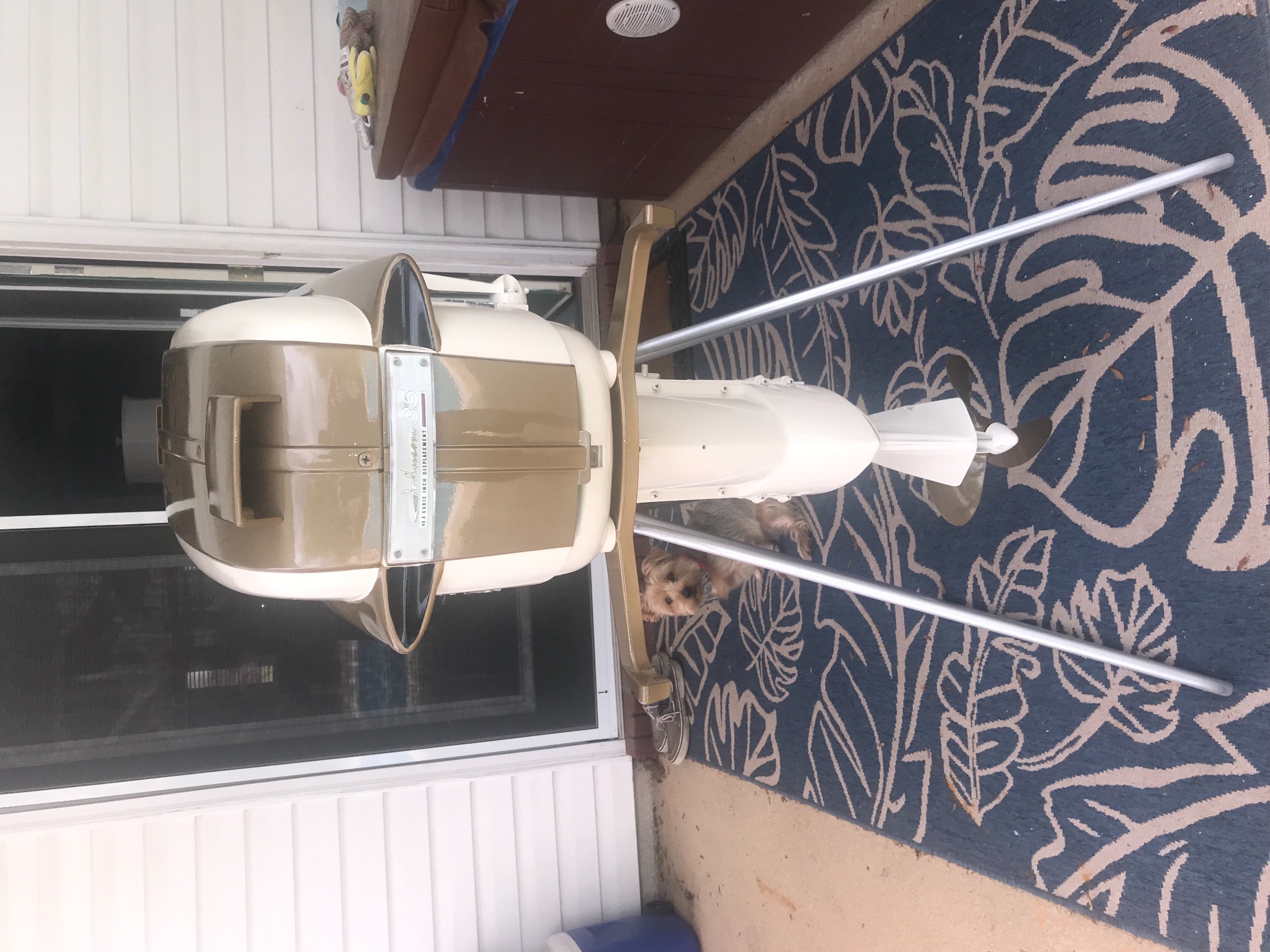

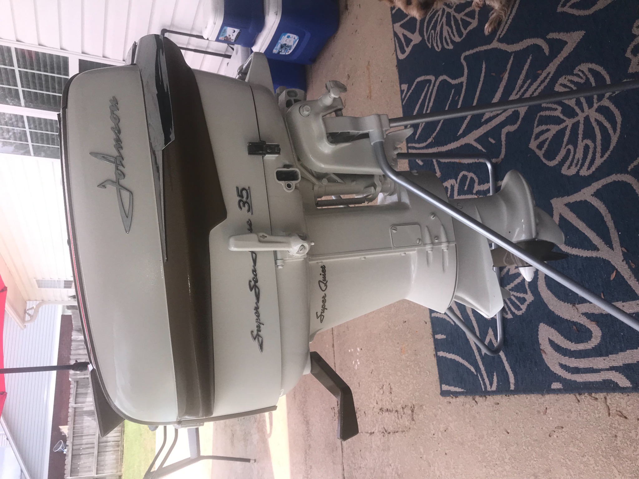

It came with a Johnson super seahorse 35 hp motor which im in yhe process of repainting. Hoping the motor runs after all this work!

For your basic questions I,ve used some pricey automotive paint, some pricey marine paint but found out that they were actually no better for my purpose than the Rustoleum. Maybe some teckie chemist can tell the difference but I've found that Rustoleum marine and regular are all the same. Assuming you still have the boat flipped and easy to work on you're past the hardest part. Wash the whole thing down with soap/water and a stiff brush. Let it dry completely and maybe blow all the water out of those pin holes. I use several products of different brand names but they are mostly the same. A thick strand body filler that some call 'peanut butter', a thin body filler that's pretty juicy called 'jelly'. or on the topside you can use a fairing compound. If you want we can get into detail along the way. When all the holes, scratches etc are filled and faired I use a high build primer then either spray or roll and tip with the Rusto with a hardner. I'll "splain" eventually. Rustoleum is easy to work with and can be mixed to get any color you can imagine. I did a light blue on a Shell Lake rocket that turned out perfect by mixing a base of white, a touch of blue and a smidgeon of green.

That motor is a bullit proof workhorse if tuned up and running, all the parts are still available and reasonable. Easy to work on with a screwdriver, and 8" adjustable wrench.

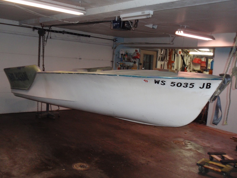

White on white 7 years 2 months ago #138649

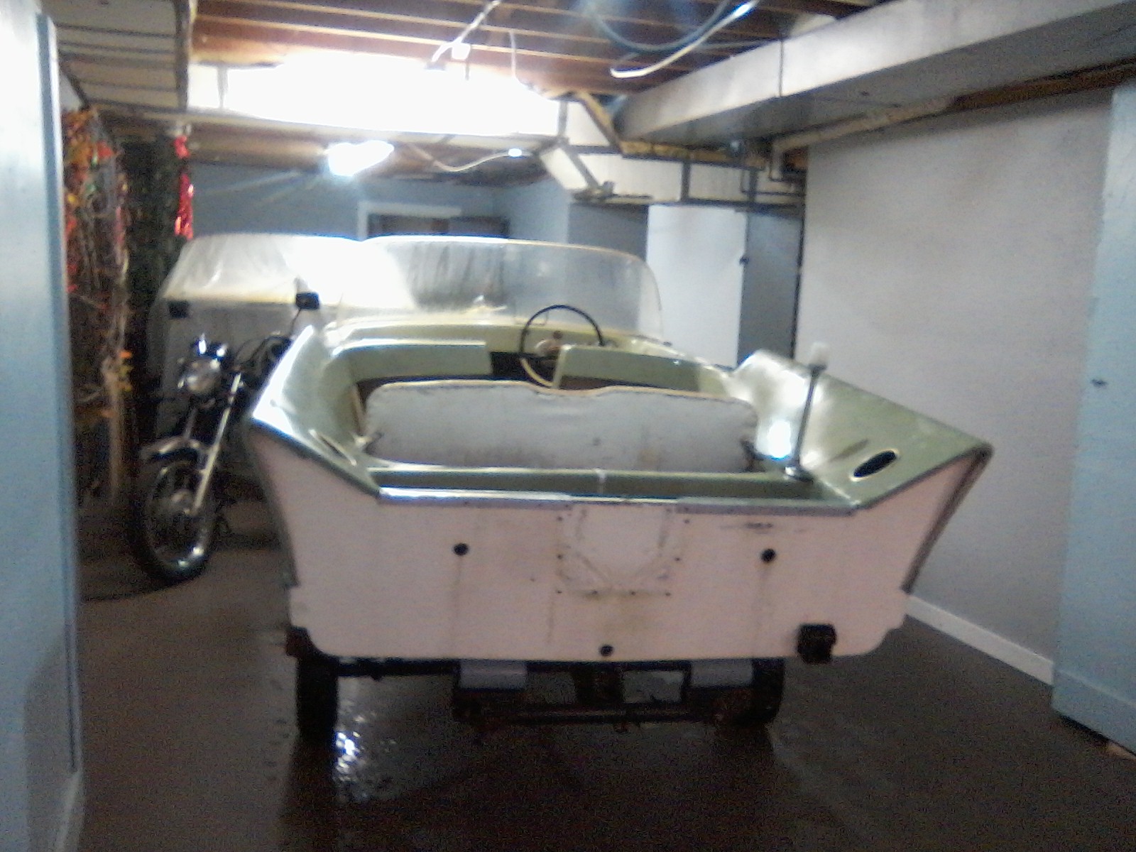

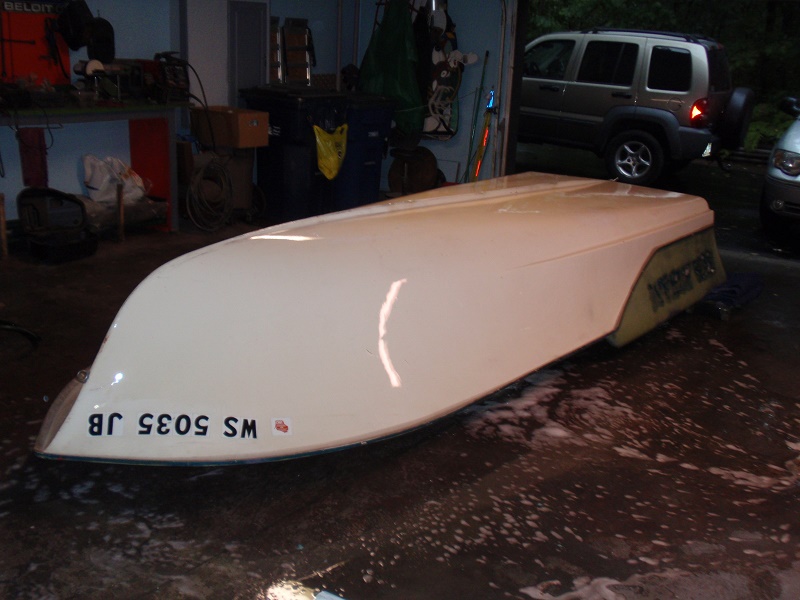

Wohh! More than you'll need. I go by the old K.I.S.S. method. (keep it simple …..) One step at a time. If you stop and think about things they will never get done. I'm a pragmatist. Just do it, if you screw up, big deal, fix it and move on.
Step one …. It's not that shiny, just wet from the initial washing, see the soap suds on my garage floor :)

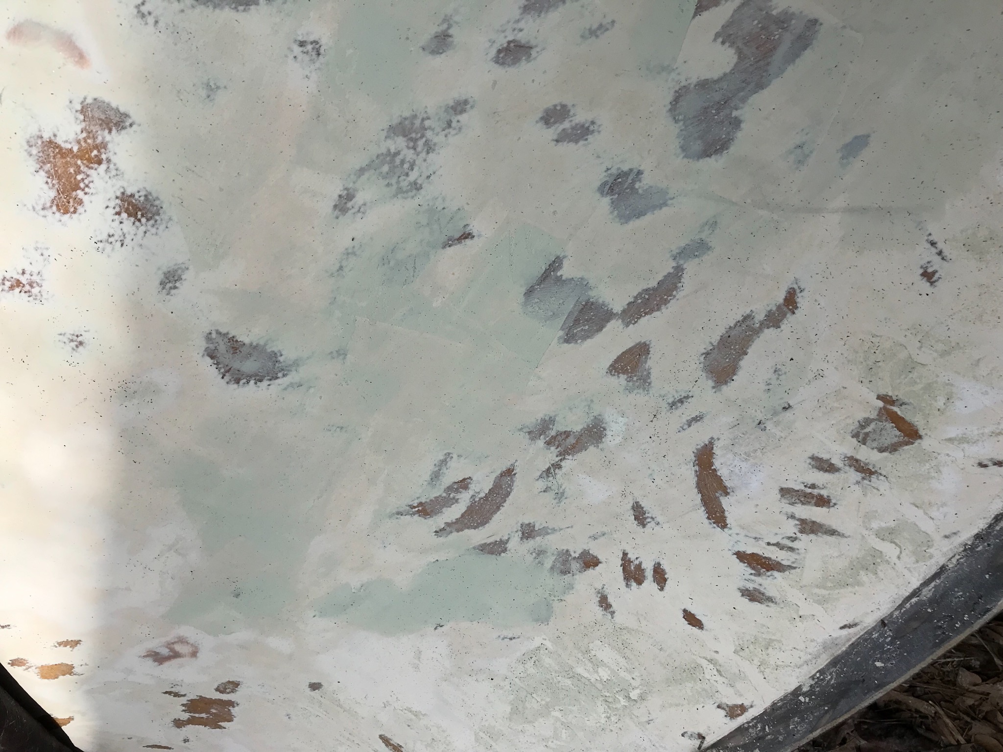

As you can see in the pictures, i still have the boat on its back and i think my first step is to get those pinholes filled, folloed by fairing, priming and painting.
Next would be to flip it upright and begin on the top and interior. The boat has no interior peices so ill be scratch building seats and benches when the time comes. Your advice is sound...one step at a time and just keep moving forward! I appreciate that!!
So after sharing all of that, what are your thoughts on proceeding from here? Ive got to get those pinholes filled and planned to use the evercoat glazing putty.... im way open to suggestions and learning from your experience....more than willing to talk to you on the phone if your time allows? Whatever guidance you can give i would truly appreciate!

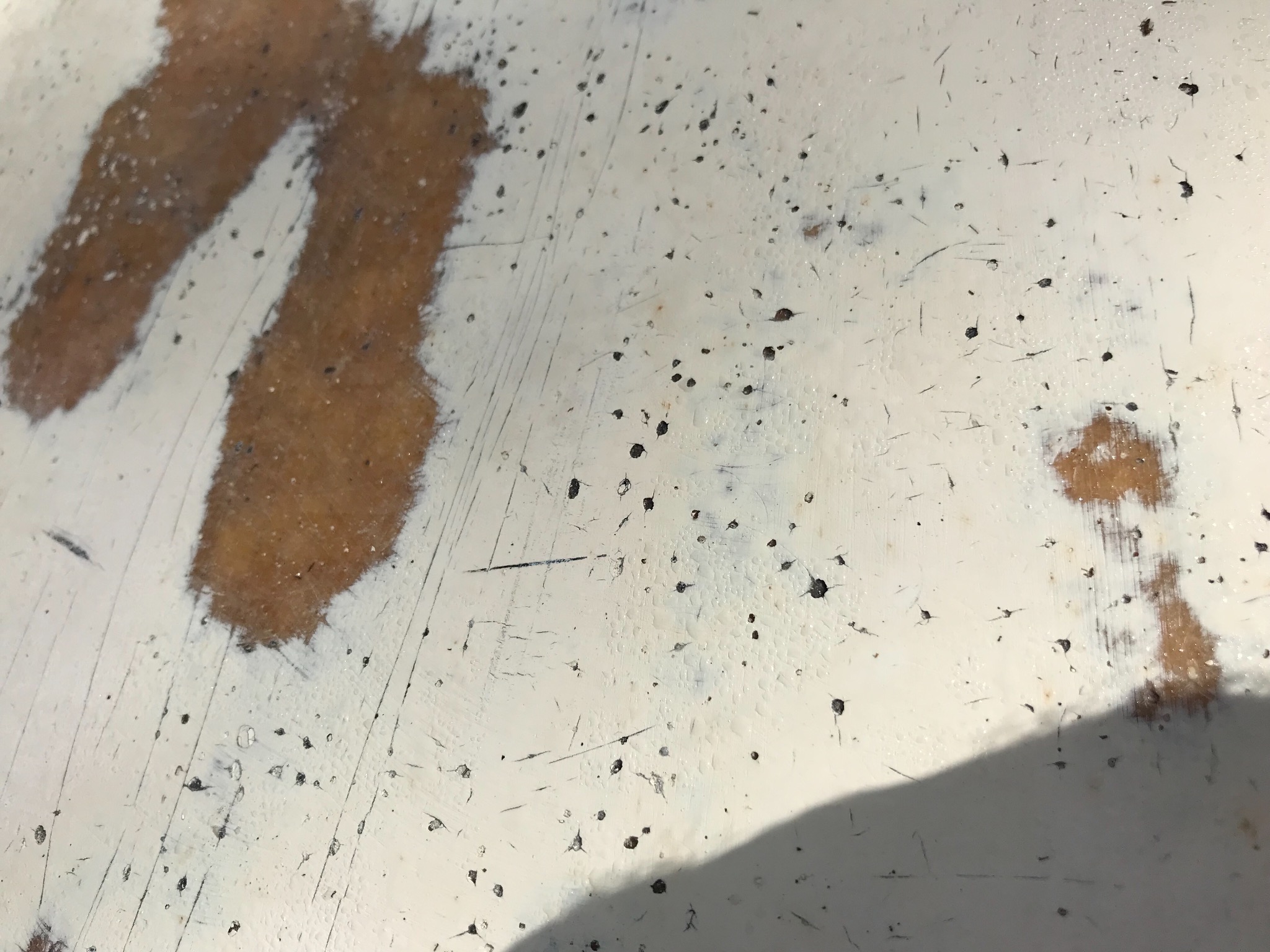

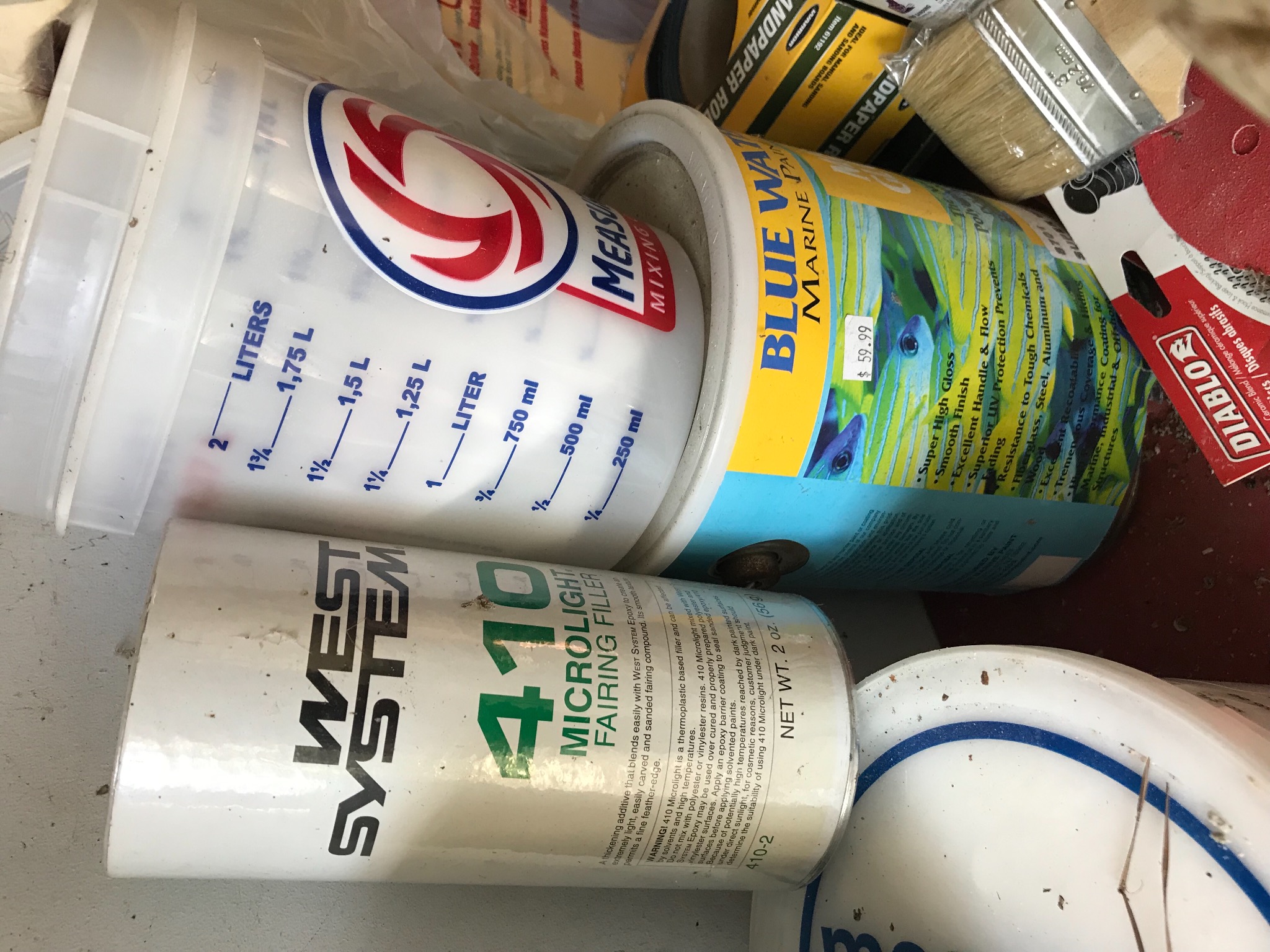

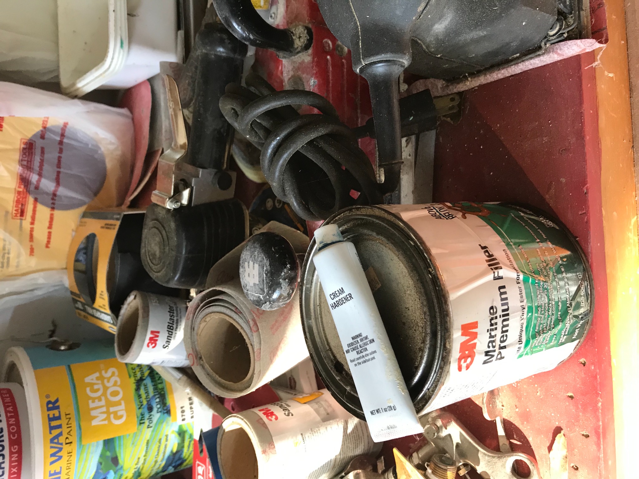

OK, I'll tell you what I did but not what you should do.

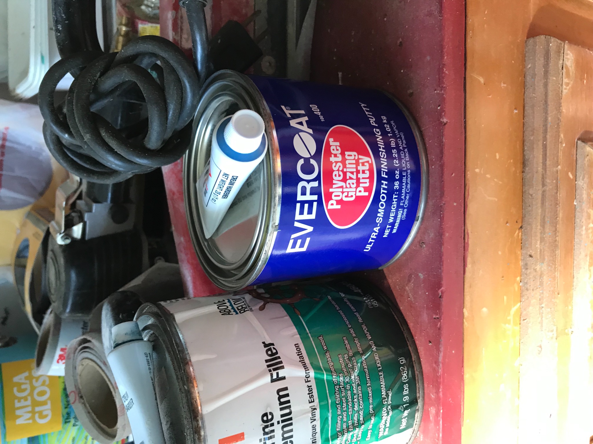

Looks like you have the hull pretty sell sanded down. I used a 220 grit paper on a palm sander to get an even finish overall.
If you have any deep scrapes, some that are gouges from running rocks or trailer loading they can be filled with the resin jelly and sanded smooth. The pit holes that are from the original manufacturing process I fill with the glazing putty. A little dab on your finger and just work it into the hole. After a few hours you can just take the sand paper on a block and finish it off. Once you are satified with your work I take a rattle can of gray primer/surfacer and just touch those spots. Any goof ups will stand out and you can re-do.
Amazing how the rattle can primer shows up those holes. After that is done you can either roll and tip your white Rusto or spray. If you roll and tip you have to add the hardner but only mix enough for what you can do in about 20 minutes. The stuff turns rubbery as the chemicals work. It will be dry to the touch in an hour and sandable the next day. I usually mix just enough in a small cake pan and use a 4" foam throw away roller and a soft varnish brush that you can clean out. You'll need to put at least three coats to get good coverage.
Keep in mind that it is your boat and you do it your way. Dosn't need to be perfect unless you're going for a show trophy.

Yes i got a little carried away with the sanding, partly because the old paint had alot of what looked like fisheys and i wasn’t comfortable with filling and painting over it...the result is obvious where i wound up at the original fiberglass in alot of places. I do not intend to be this aggressive with the top surface after i flip the boat upright. Im planning to give it a good sanding to remove anything loose and then proceed with filling fairing priming and painting.
I have used the red glazing putty on some small radio control models and love the way it sands. I considered using it to fill those small pinholes but worried it may not hold up on the hull. As a result, i purchased the “Evercoat” two part glazing putty for this purpose. I have not tried it yet but hoping it is just as easy to work with and sand as the red tube stuff.
In regards to the fiberglass gel, are you saying i should use that like a fairing compound? I was afraid of using epoxy in this manner because i thought it would be really difficult to sand back level.

I did bring the motor home with me and waiting for the weather to warm up just a bit more before i paint it...since the cowlings are off and i have free access to the power head, would you recommend just rebuilding or replacing the carb, fuel pump, points, magnetos, etc? Or should i wait until im at a point where i can attempt to start it and the trouble shoot from there? Just trying to throw smart money at it as opposed to blindly replacing components which may not need to be.
It has probably been well over ten years since the engine ran. The previous owner said he never ran it but that the guy he bought it from had done so....the previous owner i bouth the boat from had it about seven years before selling it to me so i really dont have a clue when it was last run.
I know mechanical things dont like to sit for too long...seals drying out etc....
White on white 7 years 2 months ago #138660
I would start and run the motor first before replacing anything other than the water impeller.

The jelly is a bit harder to sand down, I never used fairing compound so don't know how it would react under water especially underway. Maybe someone else has experience with it.
White on white 7 years 2 months ago #138666
Im pretty sure it’s suitable for below the waterline from what i recall. Its a vinylester product which isnt supposed to absorb water. It works and smells a bit like bondo, not too difficult to sand when compared to epoxy. Im really itching to get going again! We have another cold front coming through this weekend so it appears painting the motor will have to wait again too.

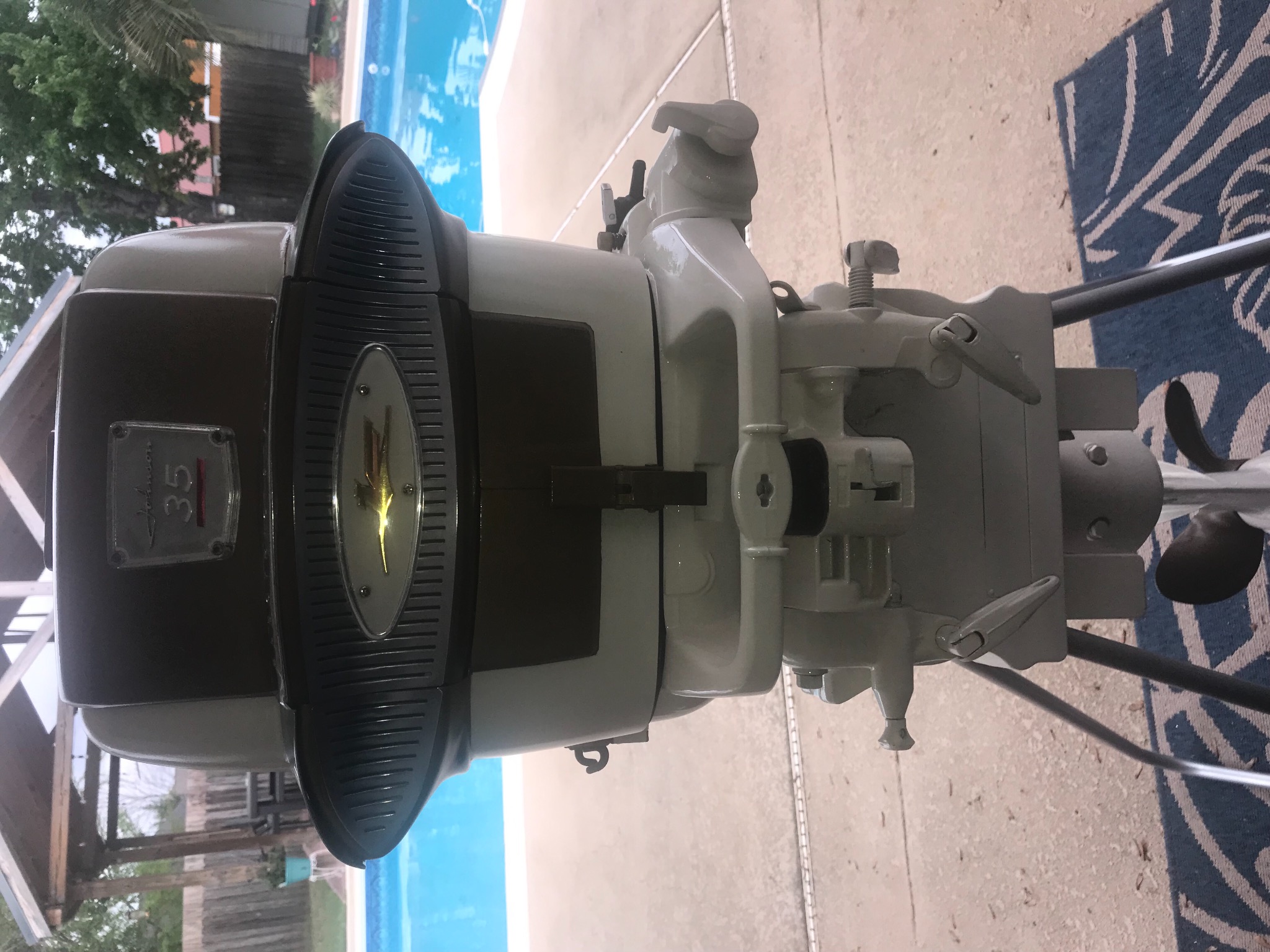

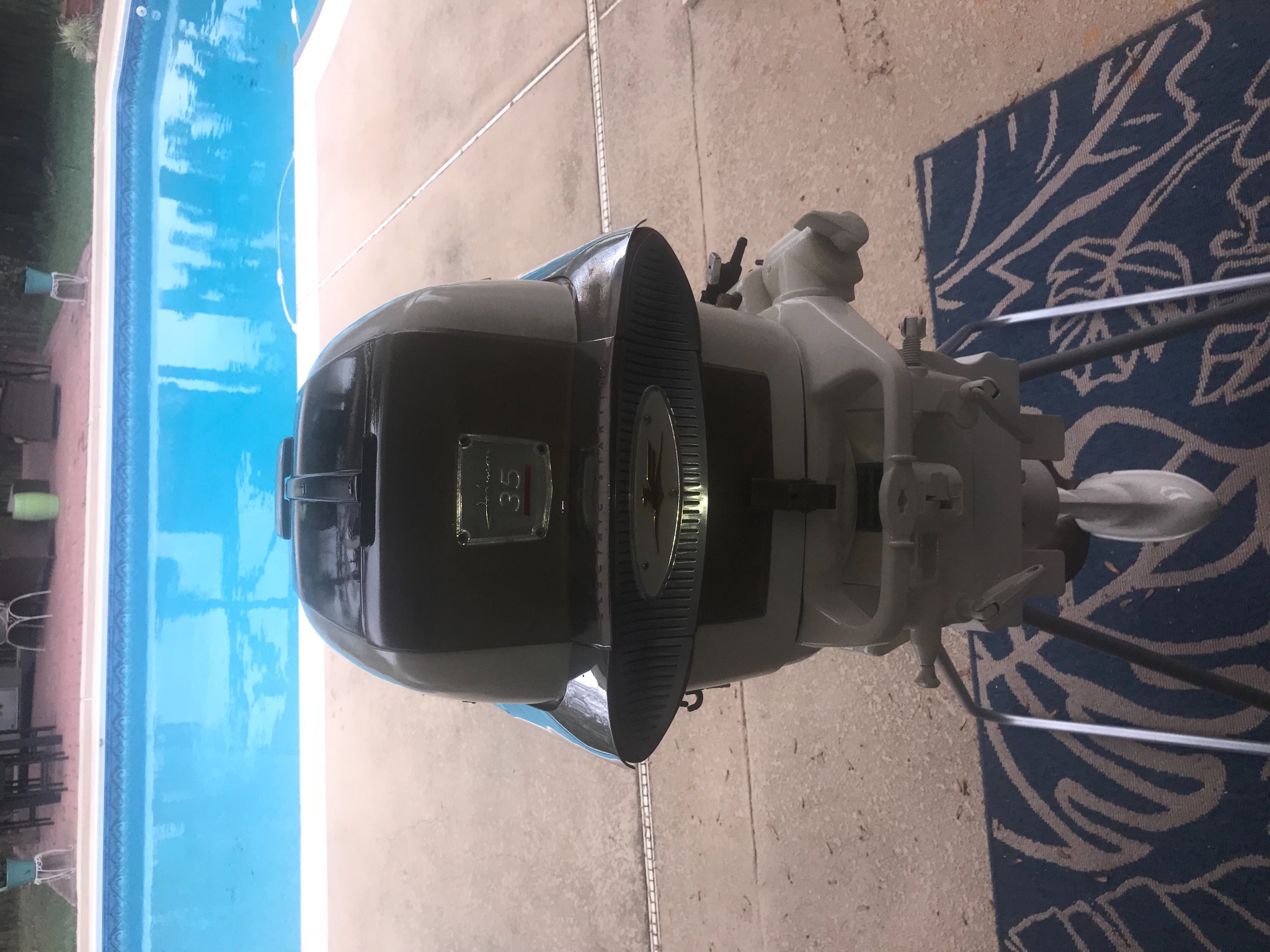

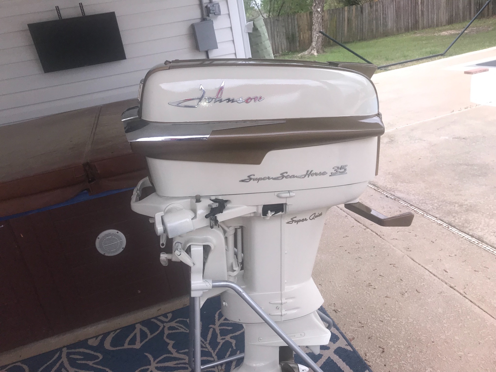

Hey Bob! Still too cold to paint but ive cleaned up/polished some of the engine components (carb, fuel pump, cut out switch, etc). I ordered a product called “all fair” from Johnstown Distributors...looks like it should do what i want on the boat bottom in terms of filling pinholes, fairing, etc....
It looks like they have a pretty good line of products for the diy’r...im not changing course away from the rustolem marine paint i already own, but i kinda wish i had found these guys sooner.

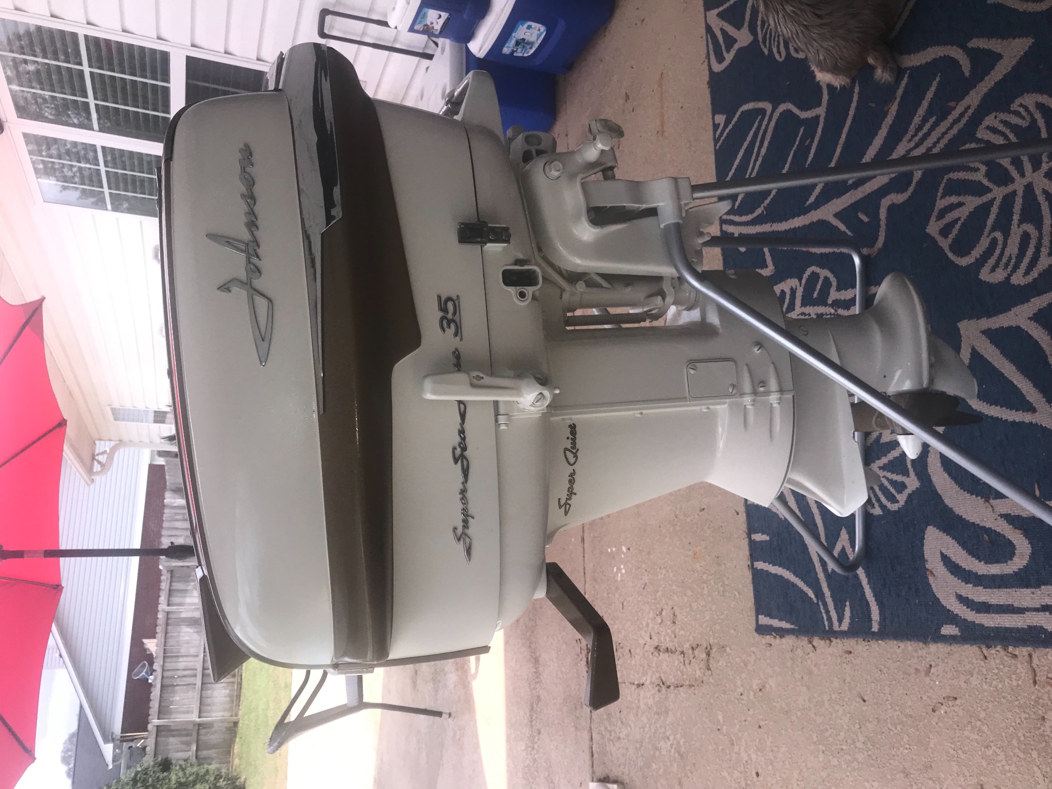

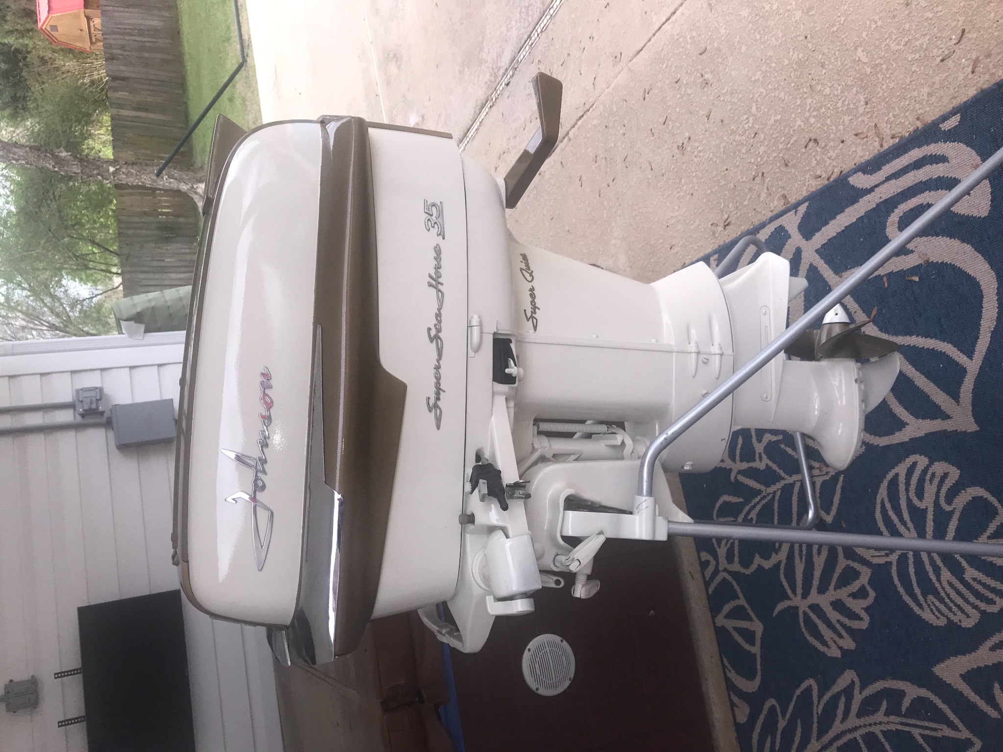

Hey Bob! Finally finished the motor! Still have no idea if it runs but it has good compression so the rest is just tweaking/adjusting....

White on white 7 years 4 weeks ago #139031
Sweet! Looks outstanding. I do have parts that would fit if you need some. Ranone of those war horses last year on a '60 Shell Lake.
I ran a 26:1 gas/oil mix like it was originally designed for. Some guys say you can run 50:1 but I didn't want to chance it.
