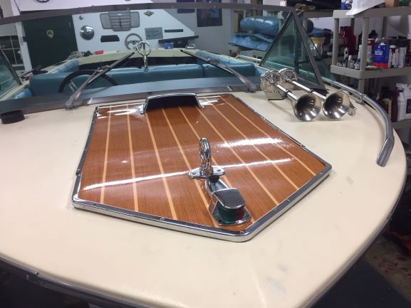

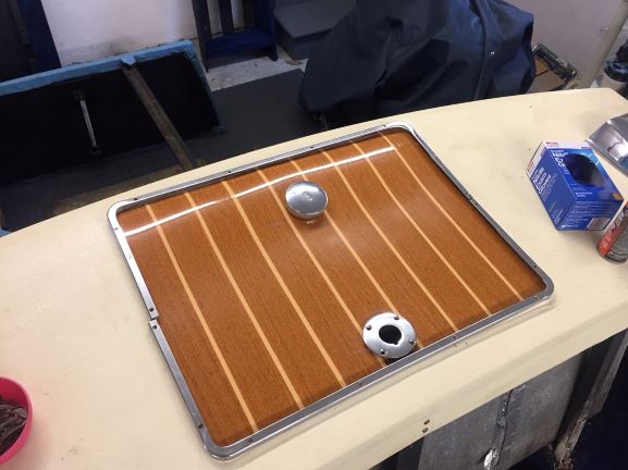

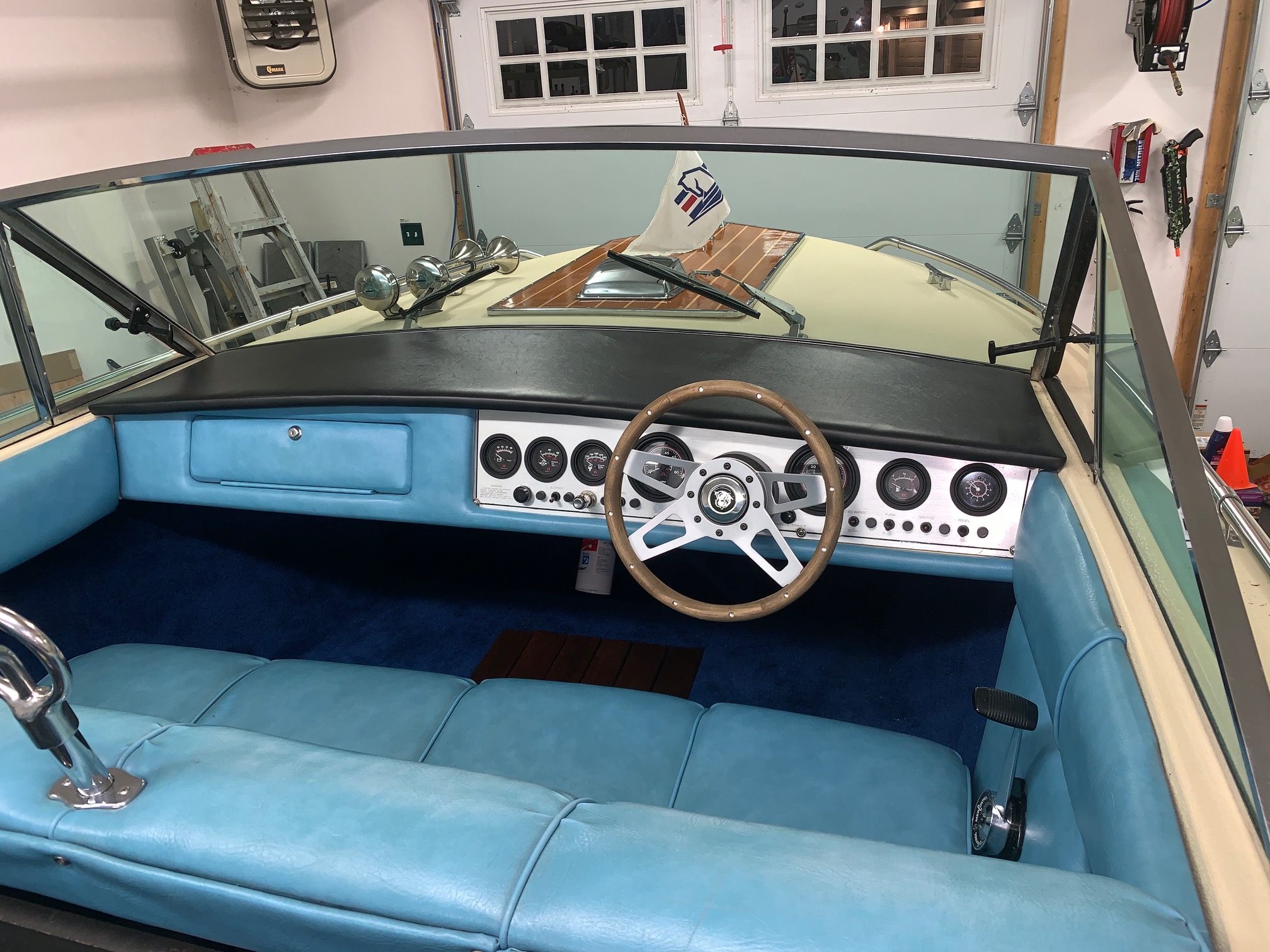

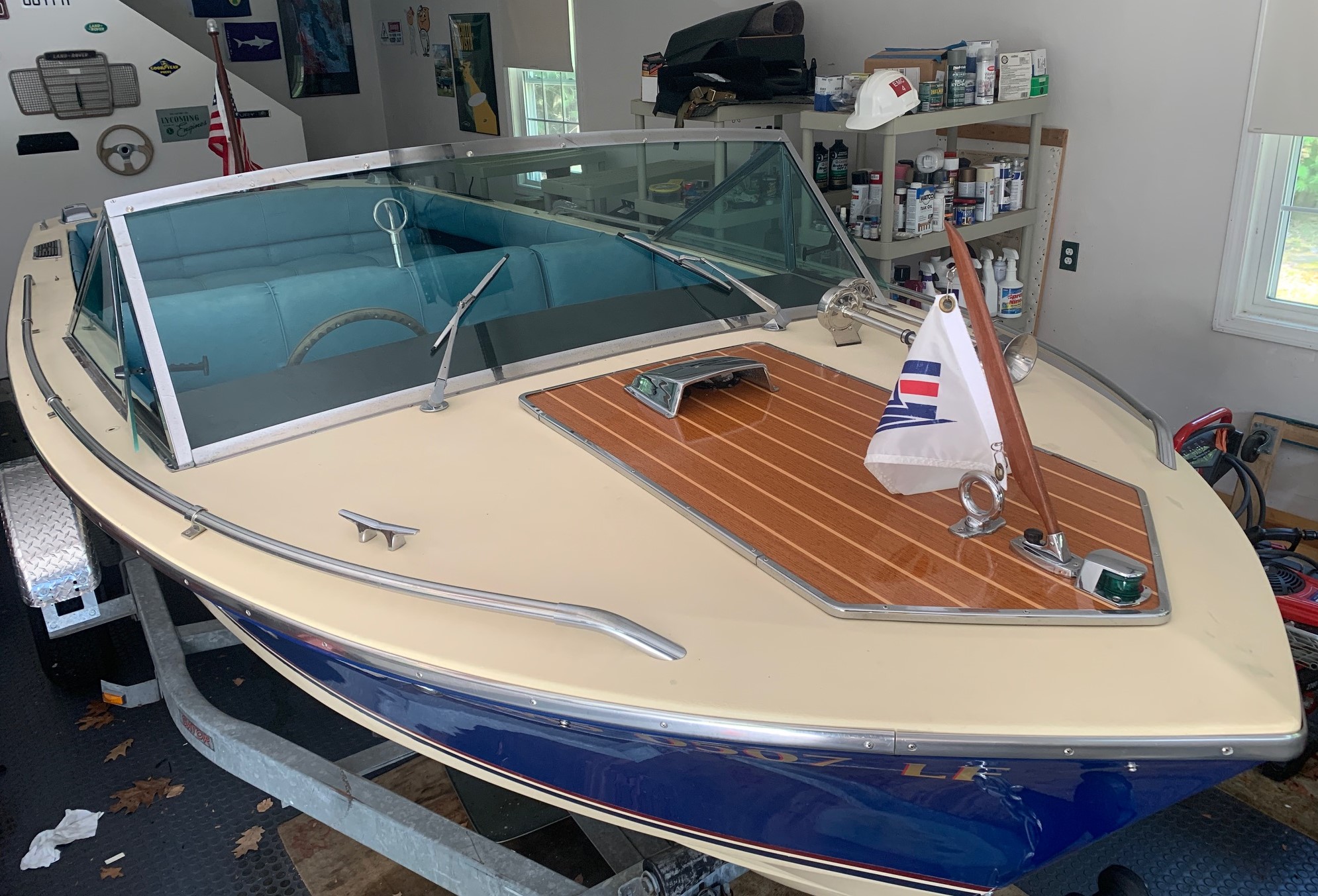

Some progress. I have all of the gauges working, new horns, led bow light (identical in appearance to the original) and replaced the only really soft wood on the boat; the vinyl covered plywood panels on the fore and aft decks. I went for a teak laminate, but kept all of the original panels.
These are pics of the test fits, so not perfect when I took the pics.

Hmmm.... I posted then ran out to dinner, just rechecked.
These were final test fits, so trim isn't perfect and boat is dirty. better now.
Also, the original wiper motors aren't available, and the ones currently available move down a fair amount from park before they reverse their sweep and they must be mounted so they park as I have them. Luckily, they don't really obstruct vision anywhere near as much as you would expect....not that I have much choice.
Try again on the pics:
Intro-Century Resorter 18 light project 7 years 8 months ago #138917
Ah much better!!!!!!!!!!!!! She's coming along nicely!

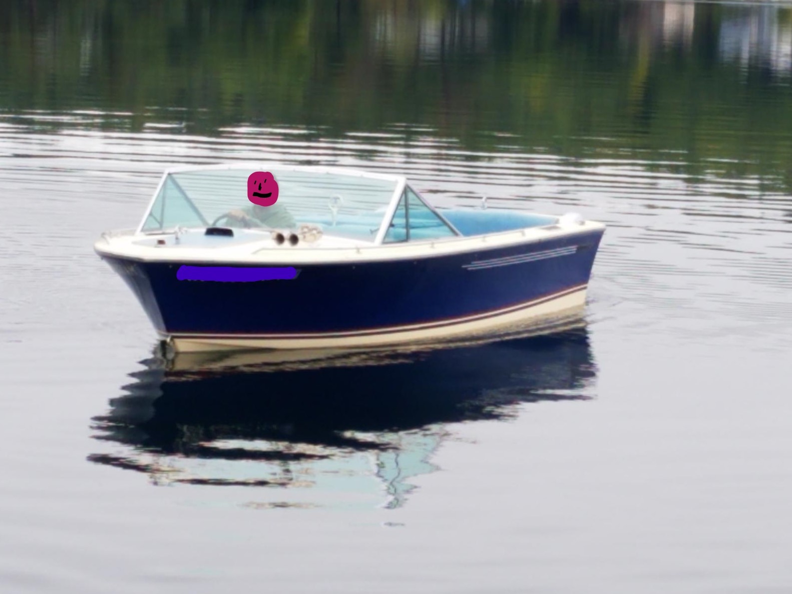

So a month or so since launch and I really enjoy this boat, she runs like she looks. Importantly, the Wife likes it. While the Chaparral is the appliance boat, and loads of fun, I find myself, when I can, soloing the Resorter at the end of the day for a quick loop before the evening. Only a few glitches arose, not unexpected, and none too critical.
My question. I noticed she takes water through the seam behind the rub rail, between the deck and hull. There doesn't seem to be any structural issues the deck is rock solid, as is the hull there. What would you seal this with?
We had an end of the season party and I got a bug. I still managed to haul the kiddos tubing, but I had enough by the evening. Good friend took our families for a sunset cruise in the Resorter and I got this pic as they left our little inlet. Not the best pic, but she is a pretty boat.
