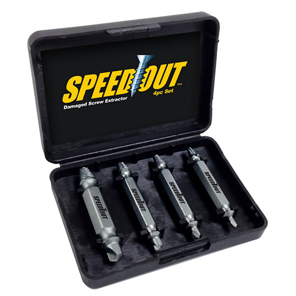

Sorry I'm late for the party here. Are they screws or bolts with nuts underneath? If they are wood screws there are special screw removal kits that work great and are cheap, sold at most hardware stores. The kit is just a small drill to put a short hole in the center of the stripped screw and then a reversed drill bit that fits in the small hole to back the screw out. If they are through bolt and nuts then you can just take your dremmel and grind off the nut from below. Stainless screws and nuts are also available at hardware stores.
Those kits are also available on line, Amazon etc.
