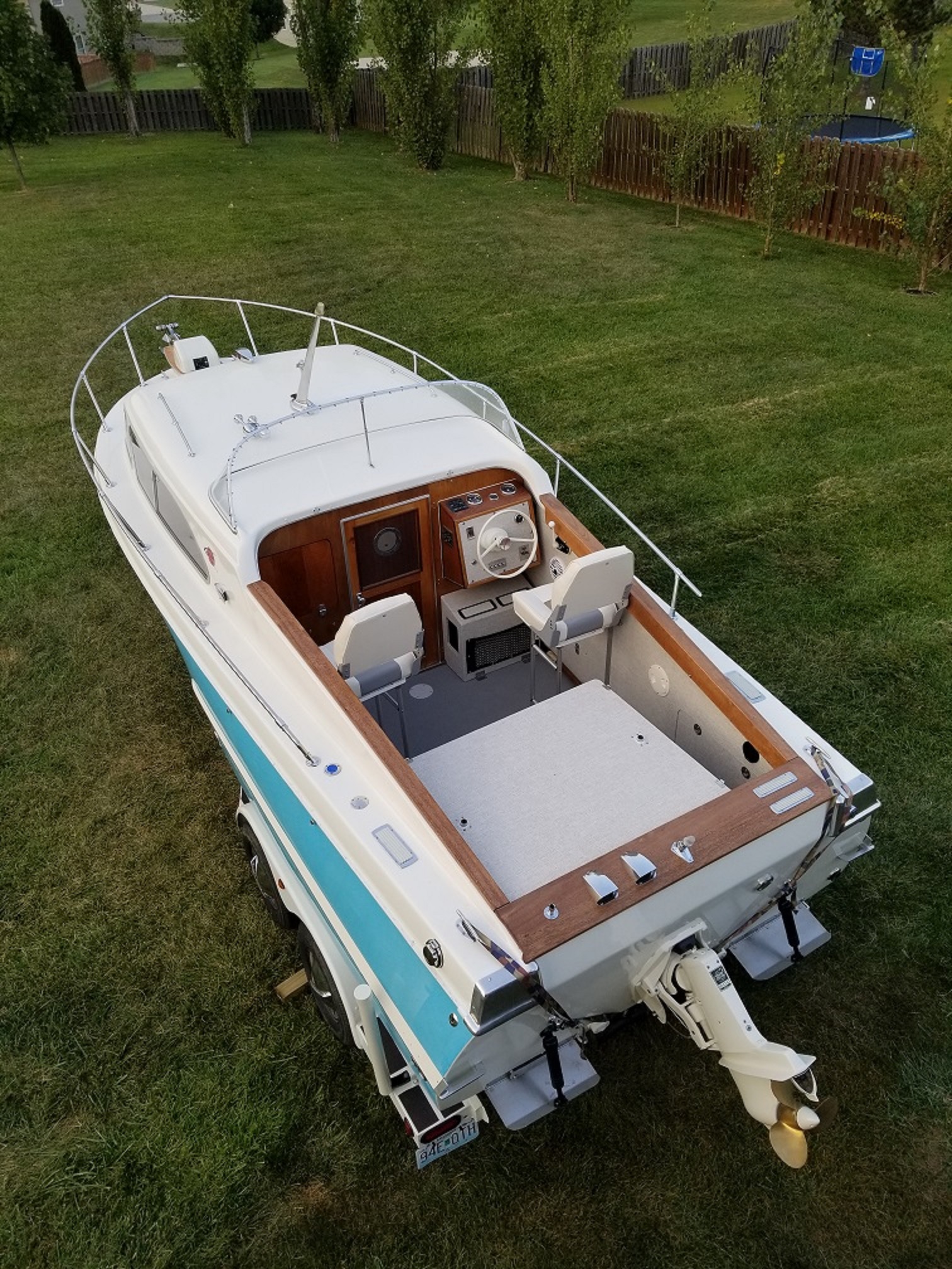

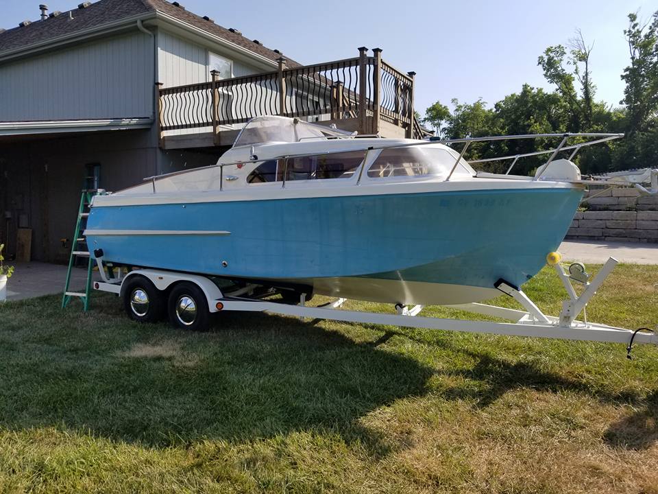

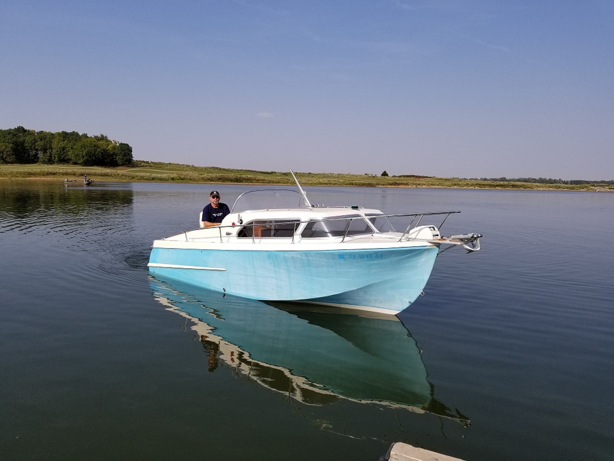

1960 Dorsett Farallon restore 8 years 11 months ago #134901
5 years in the making so far, this was test day #2, pics from the beginning to follow just wanted to get this out there.

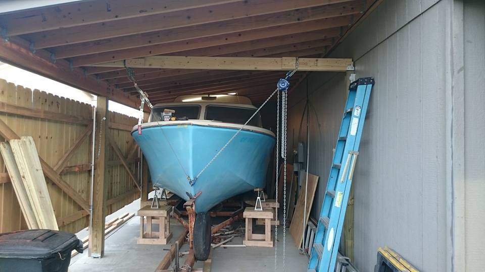

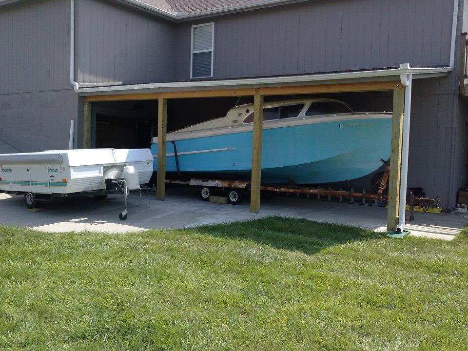

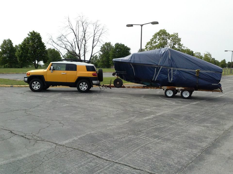

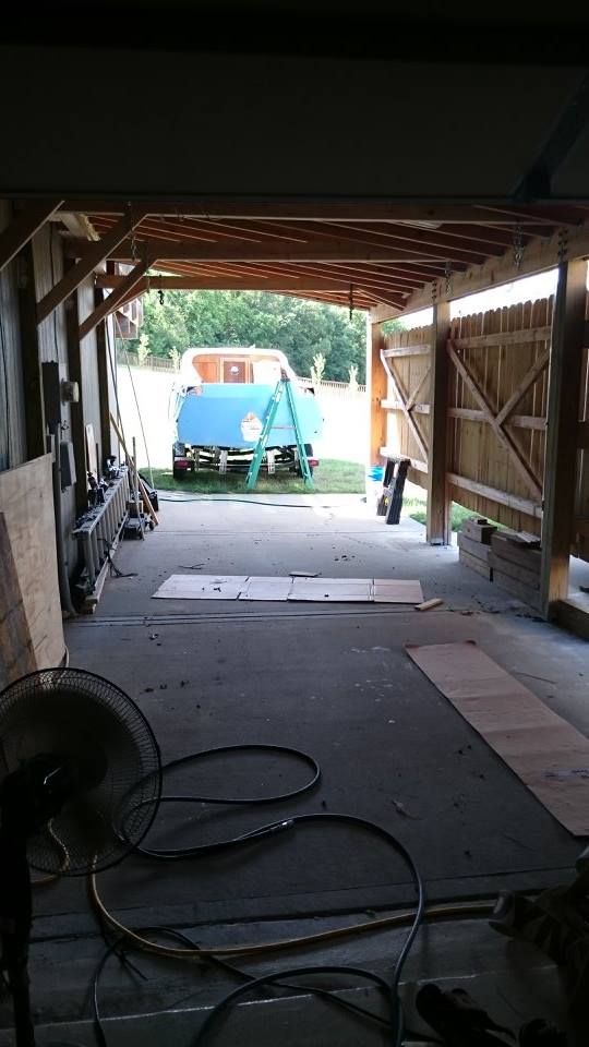

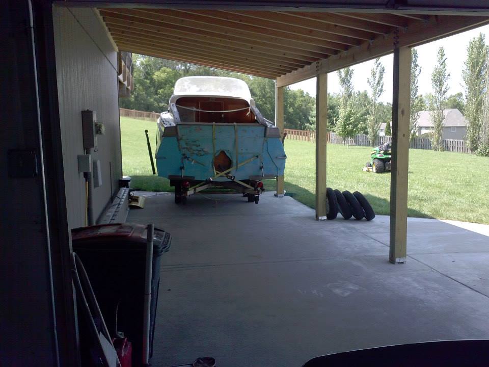

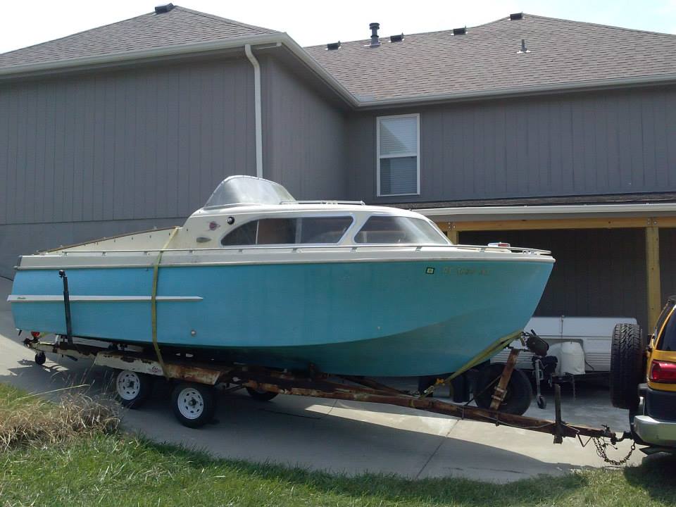

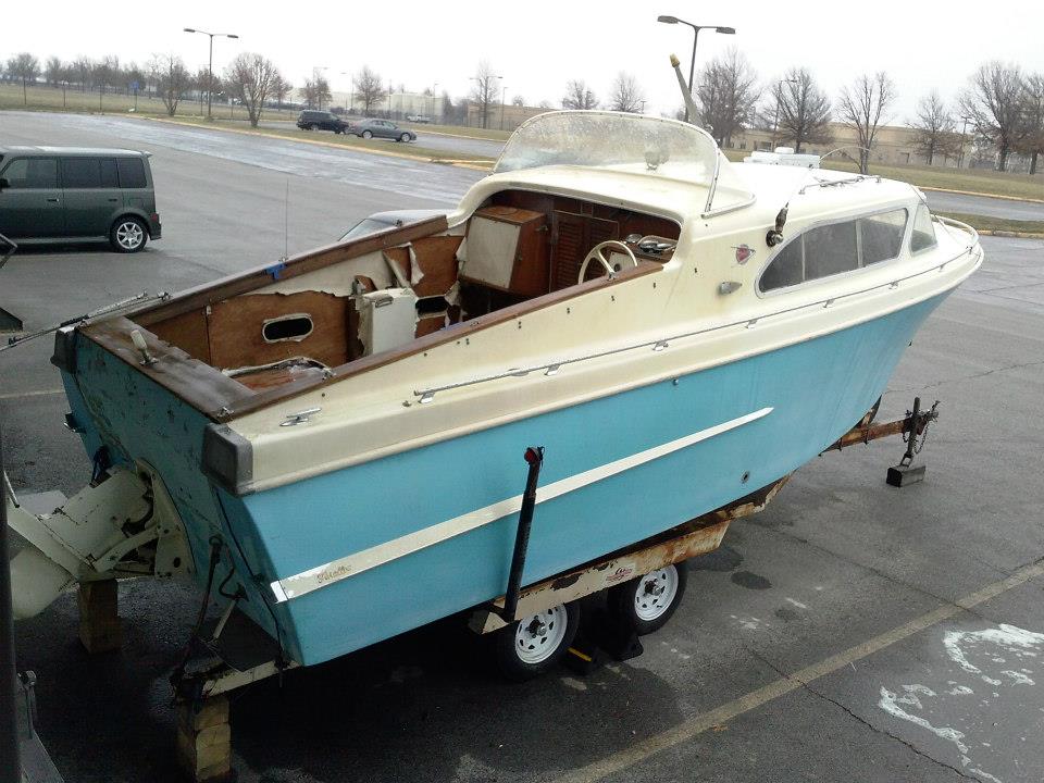

1960 Dorsett Farallon restore 8 years 11 months ago #134903

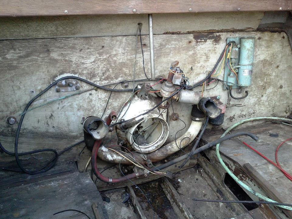

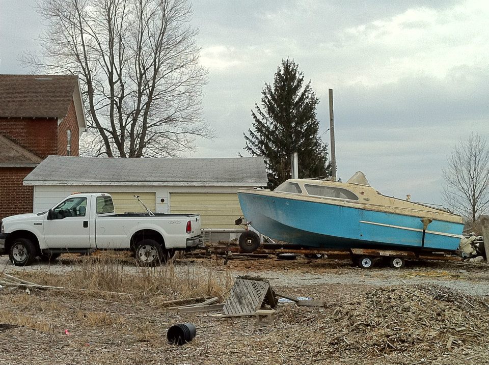

Bringing her home and getting starterd

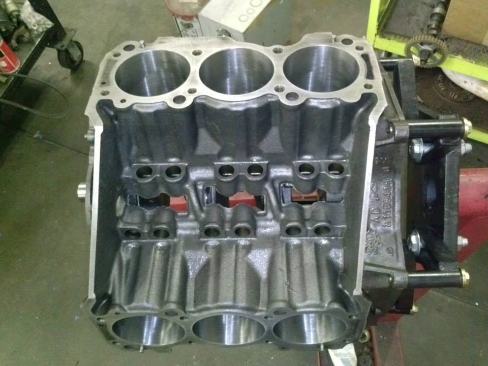

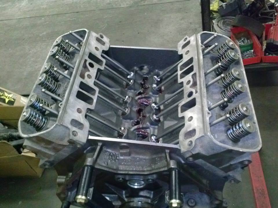

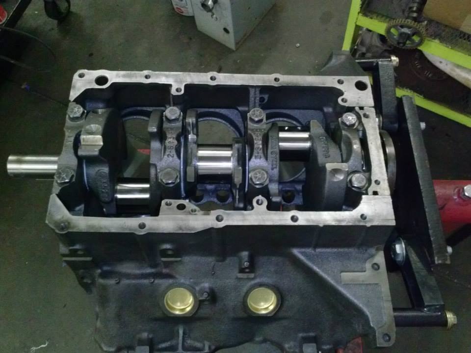

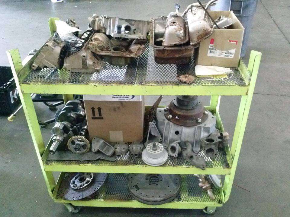

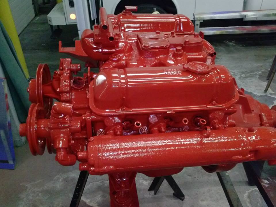

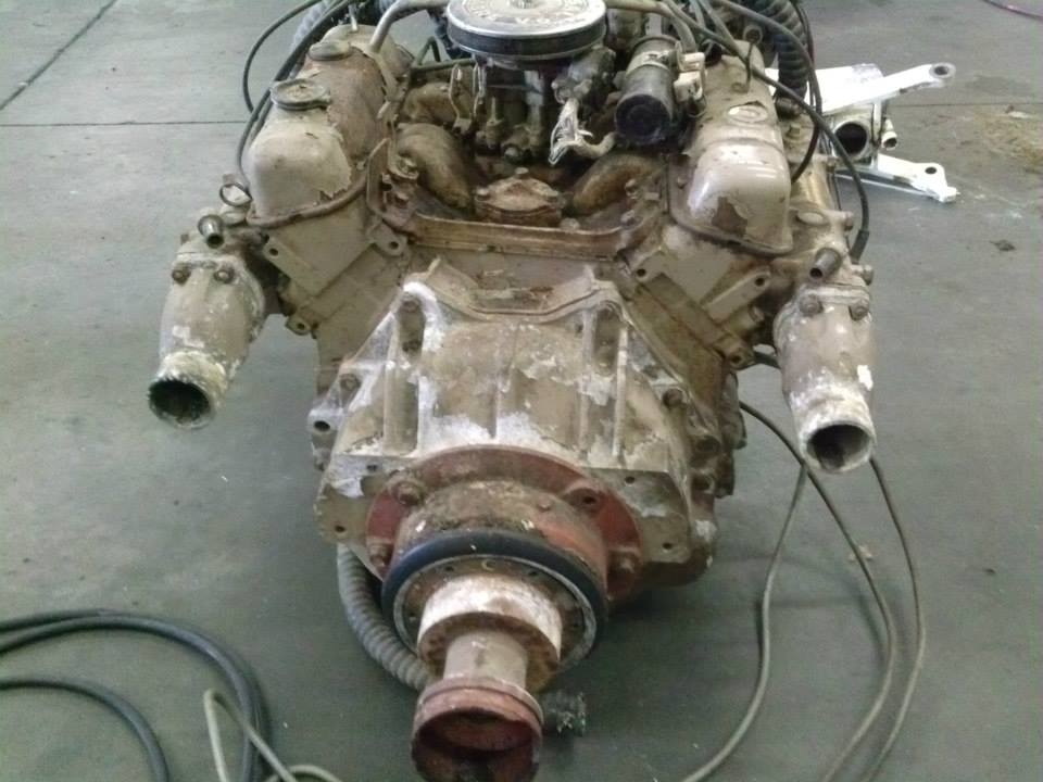

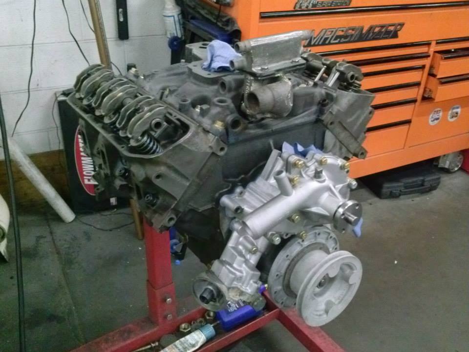

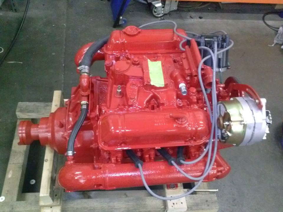

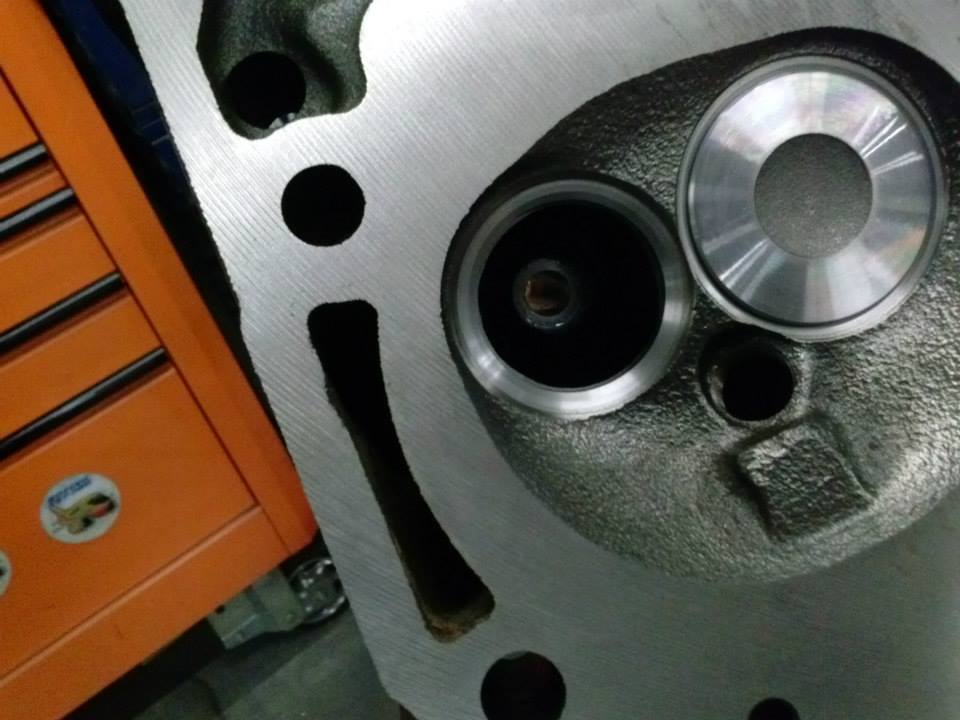

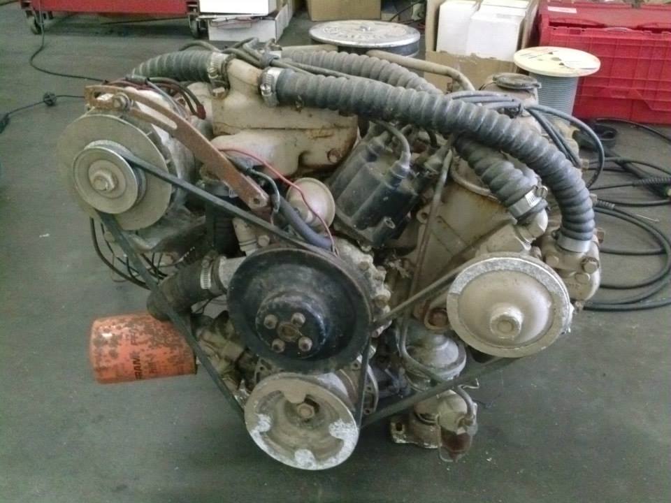

1960 Dorsett Farallon restore 8 years 11 months ago #134904

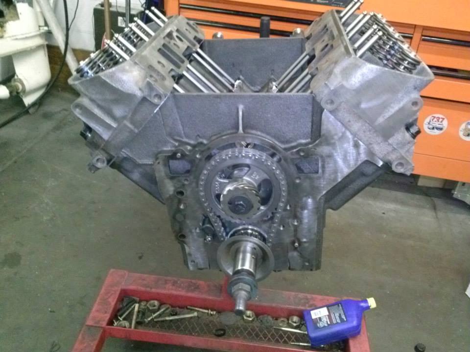

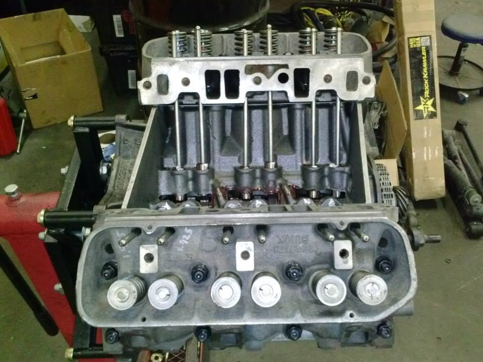

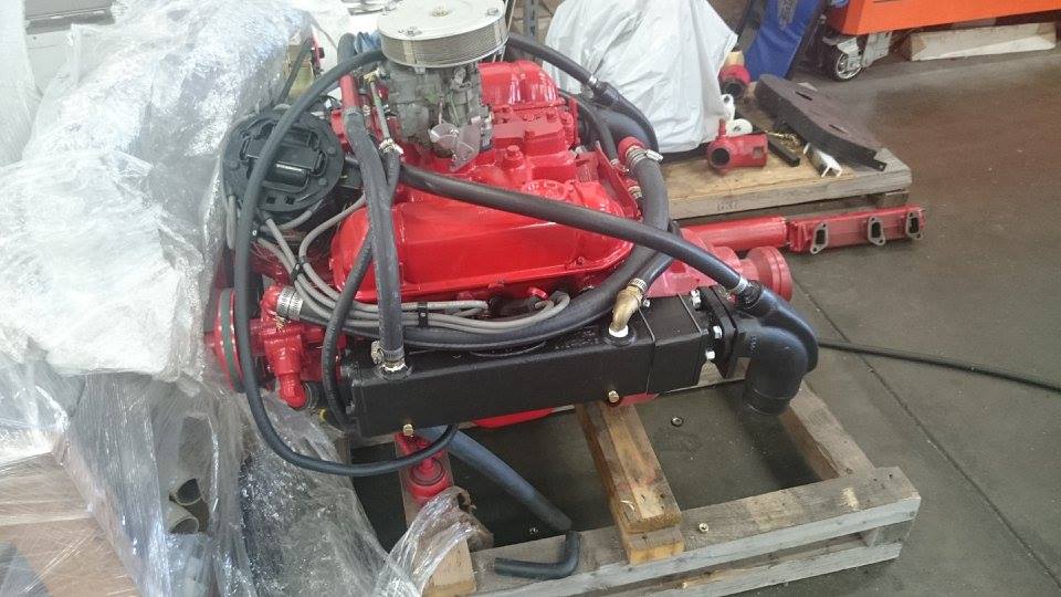

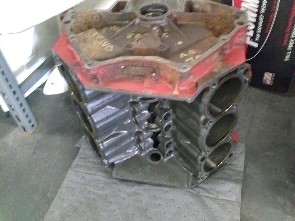

Engine

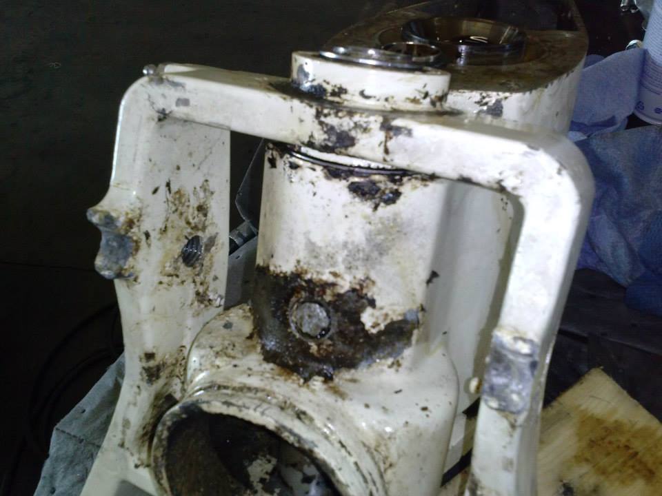

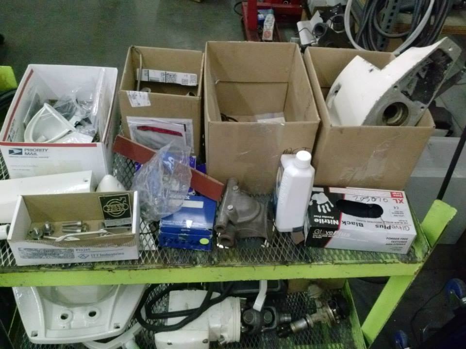

1960 Dorsett Farallon restore 8 years 11 months ago #134905

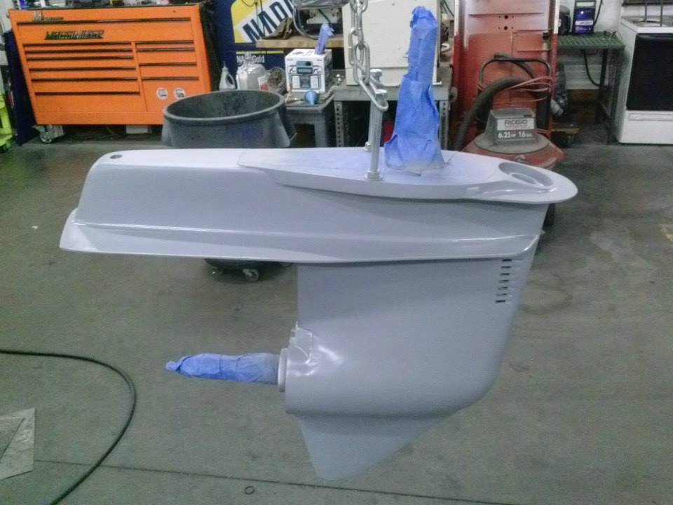

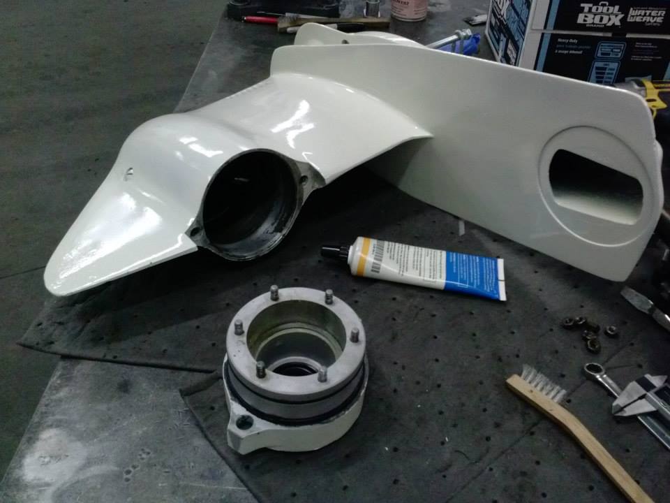

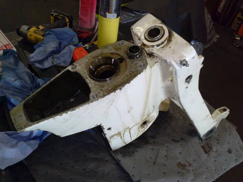

Outdrive

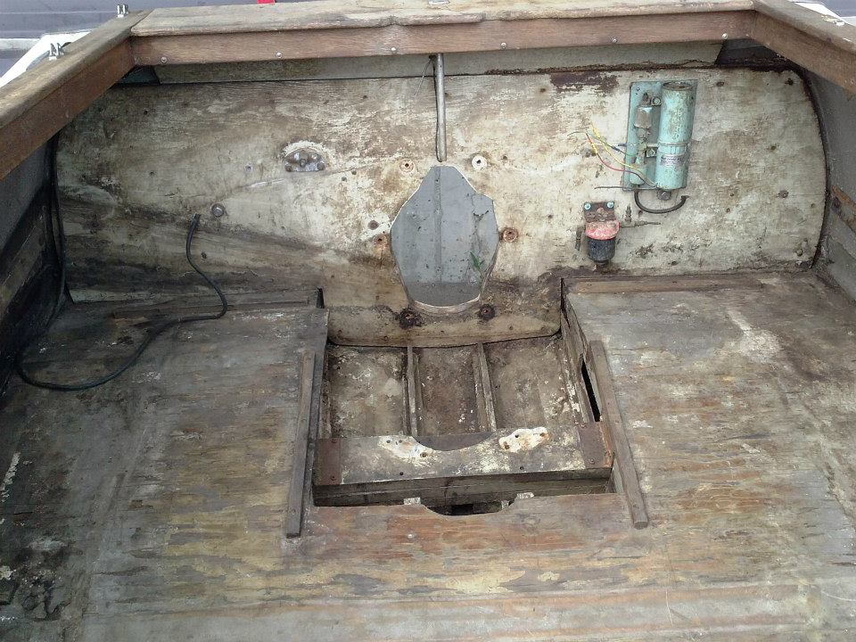

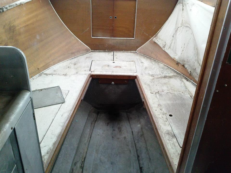

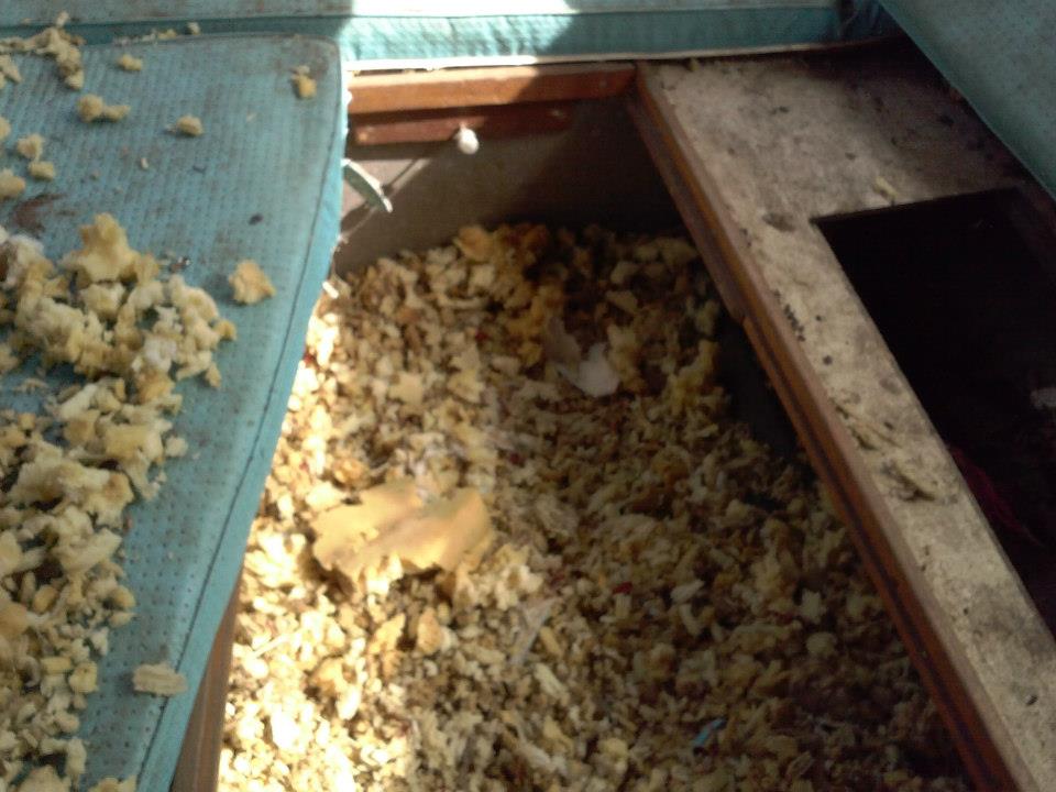

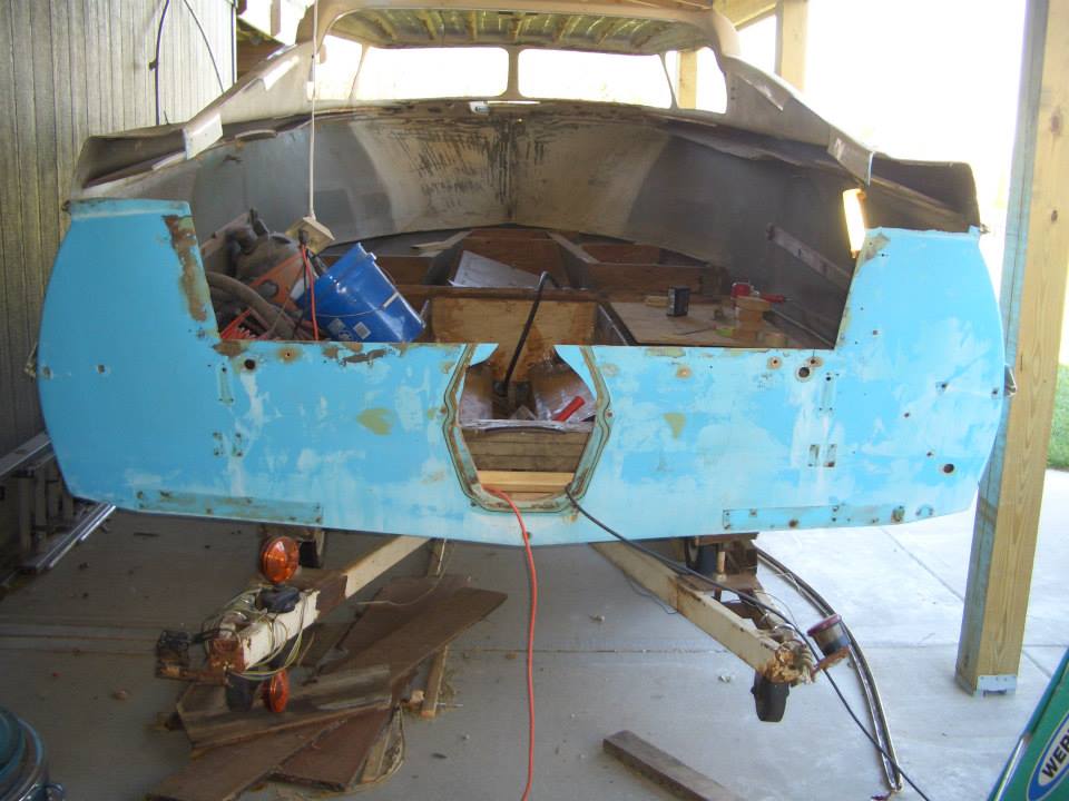

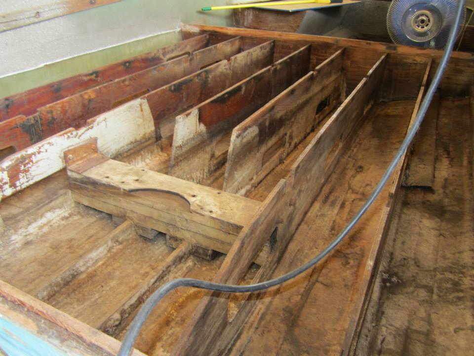

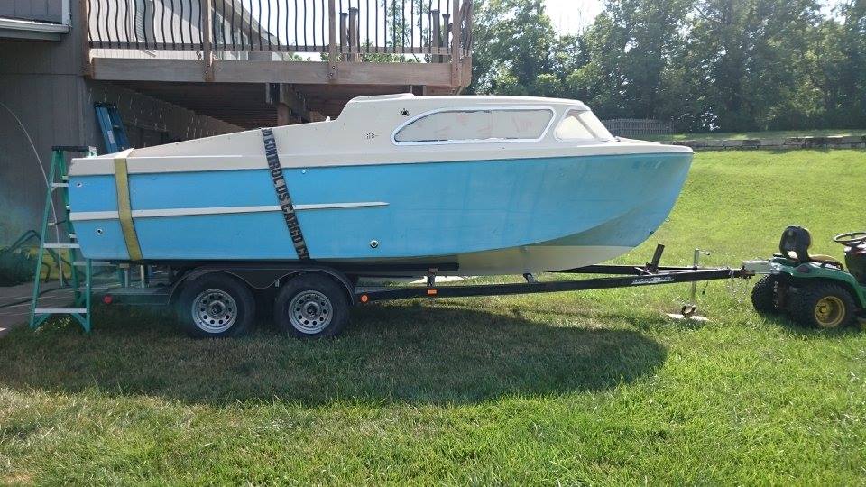

1960 Dorsett Farallon restore 8 years 11 months ago #134906

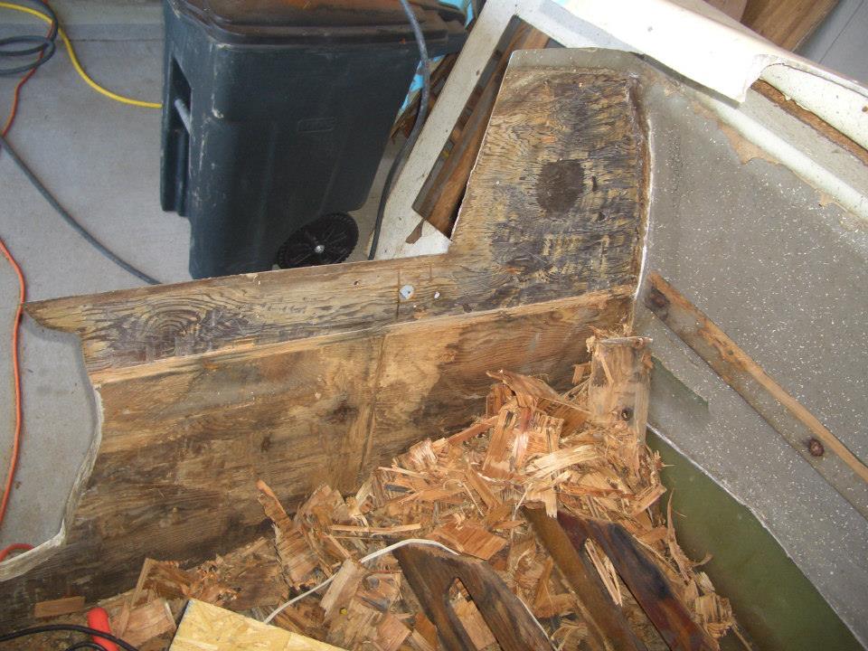

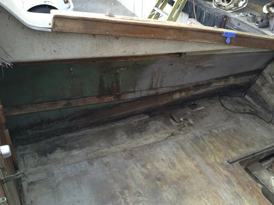

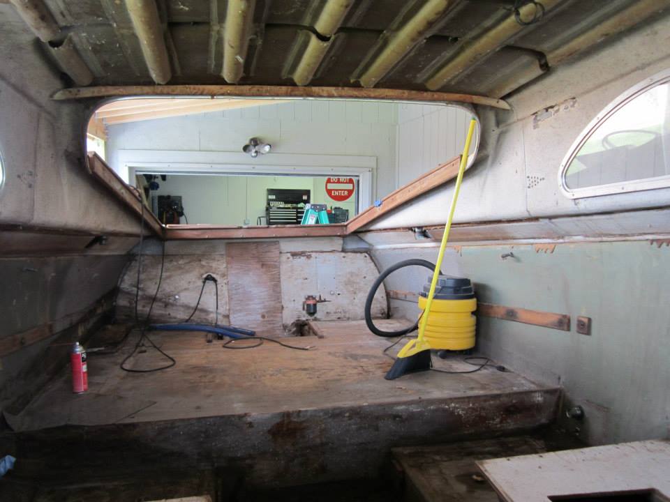

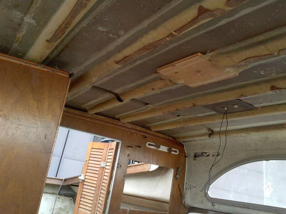

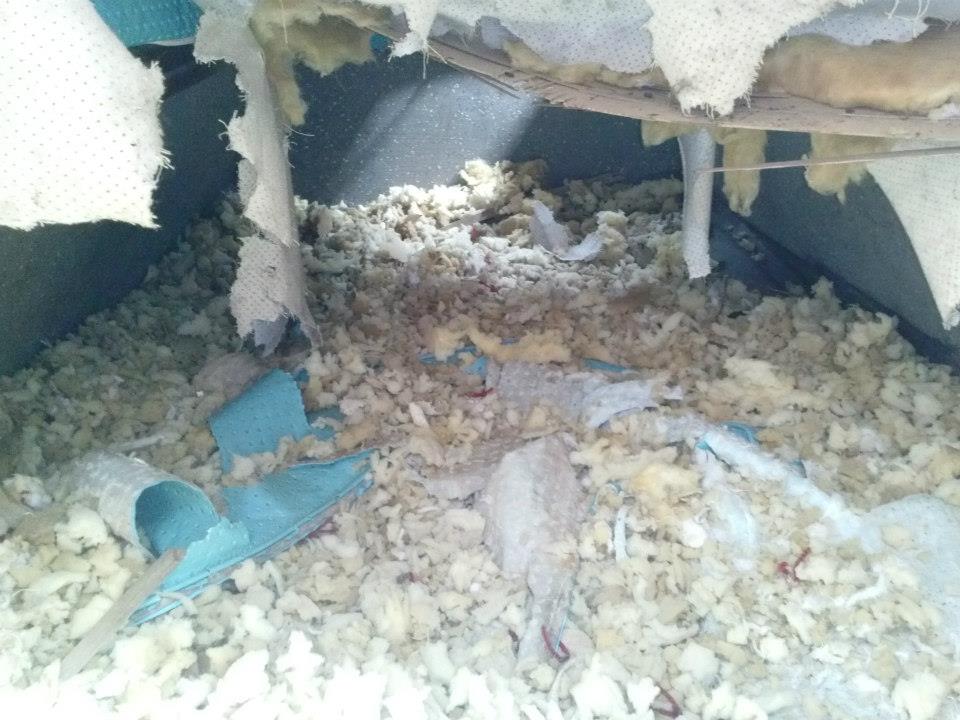

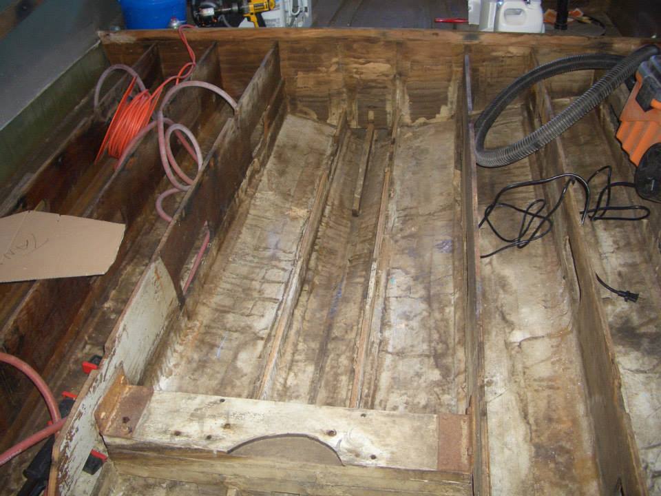

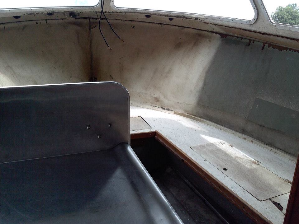

Bring her home and tear down started

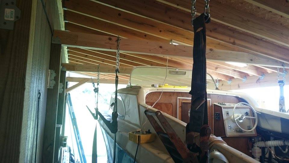

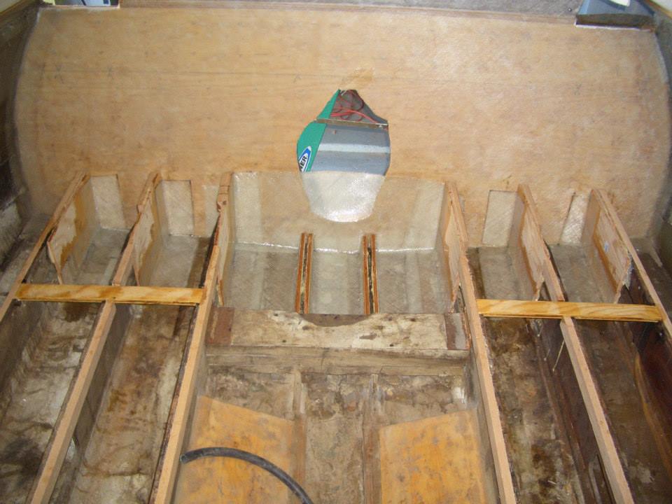

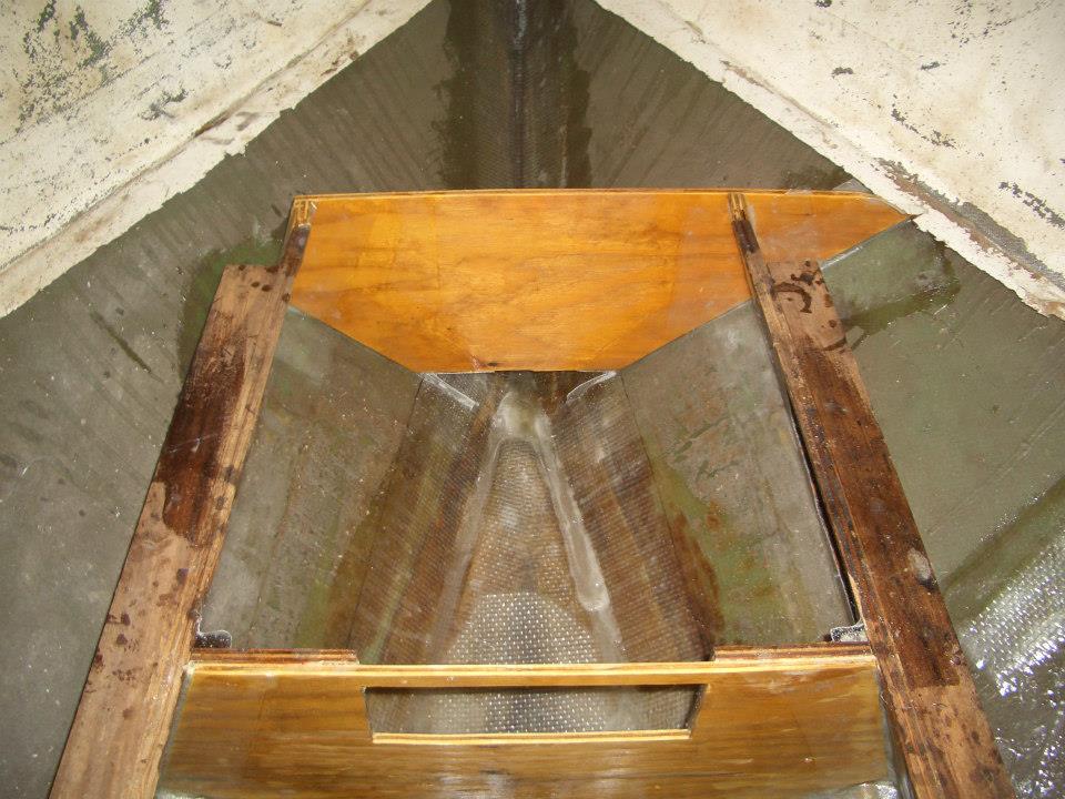

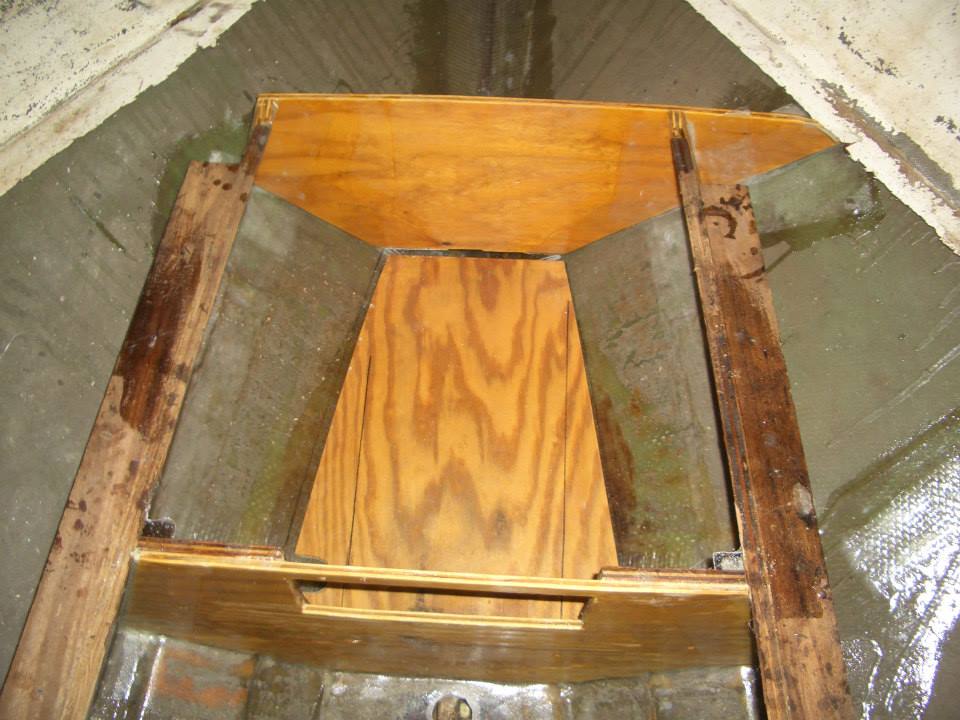

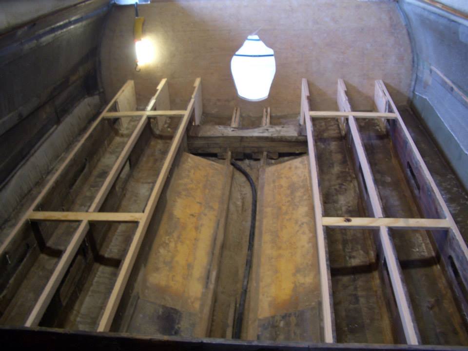

1960 Dorsett Farallon restore 8 years 11 months ago #134907

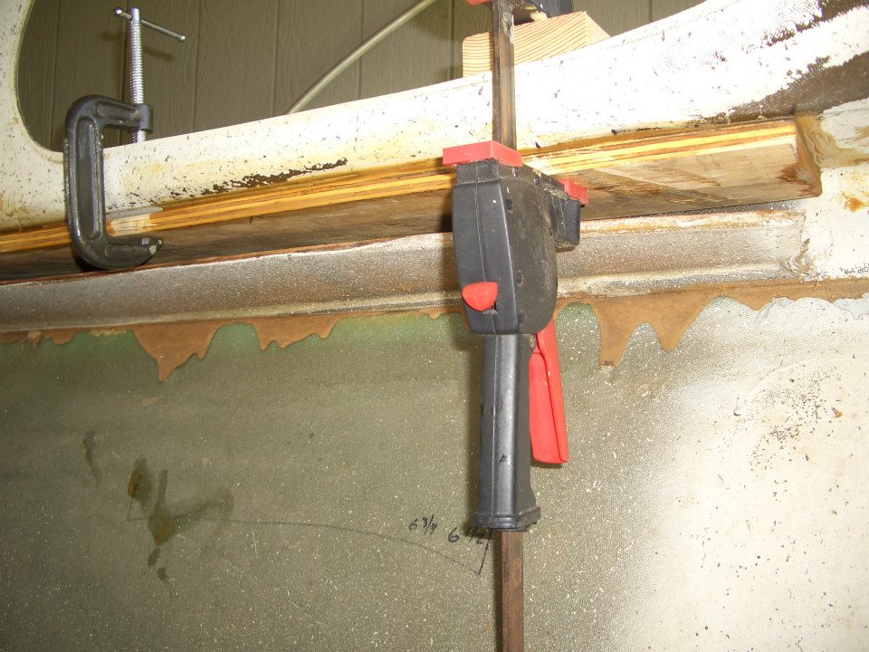

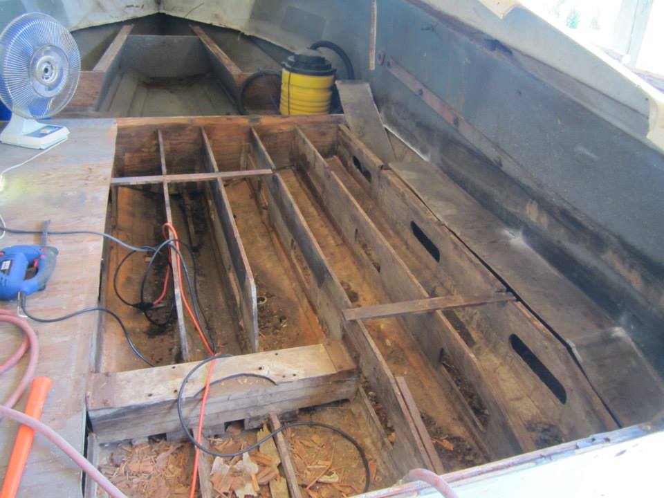

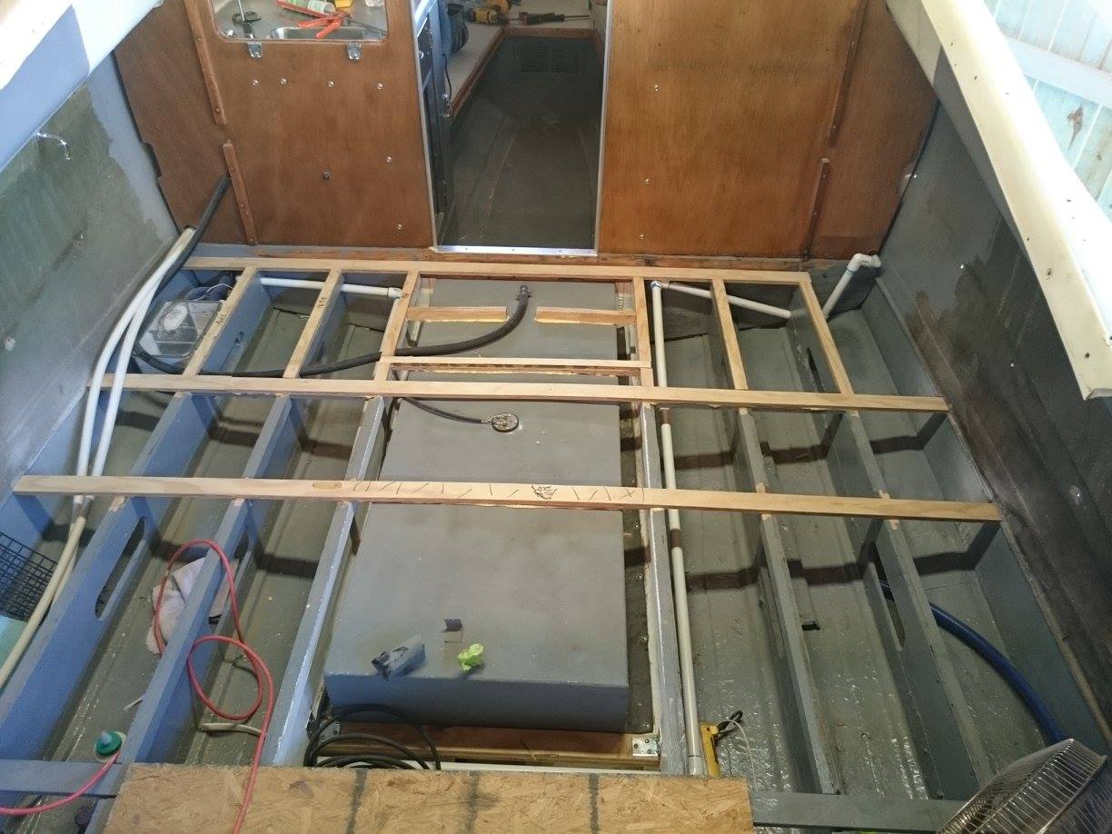

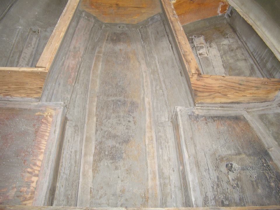

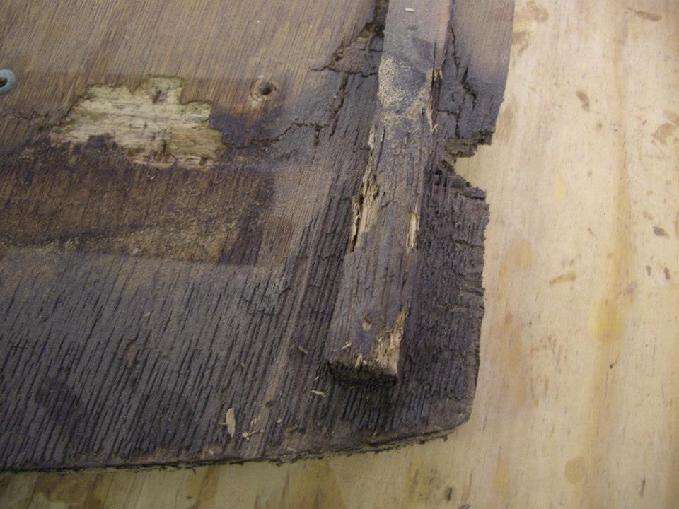

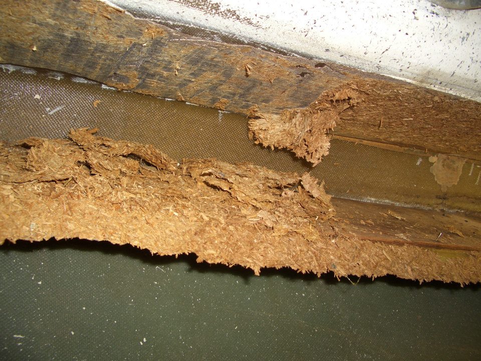

Floor spars and transom all redone, Marine Air install, gunwale replace. New fiberglass everywhere.

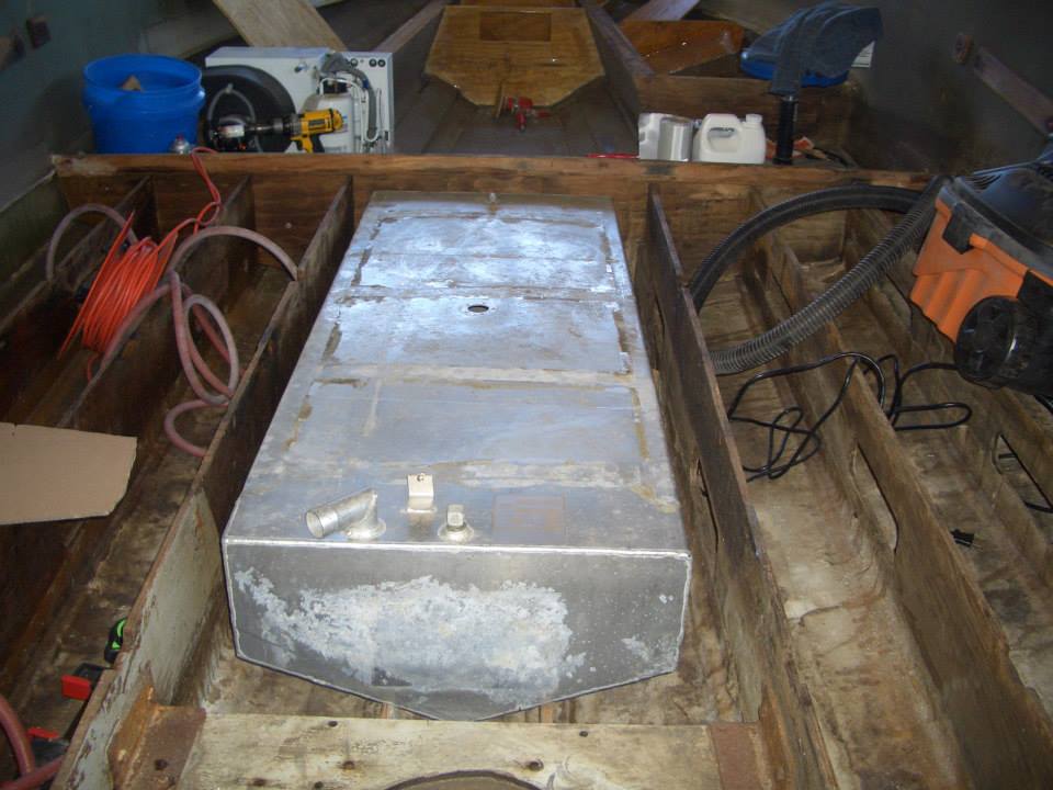

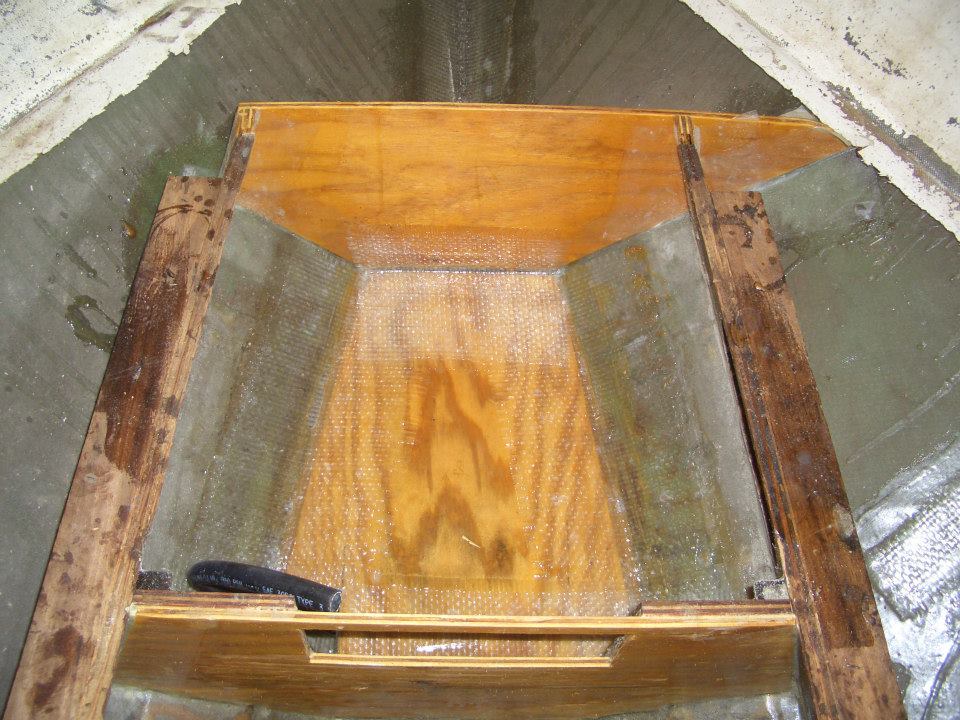

1960 Dorsett Farallon restore 8 years 11 months ago #134908

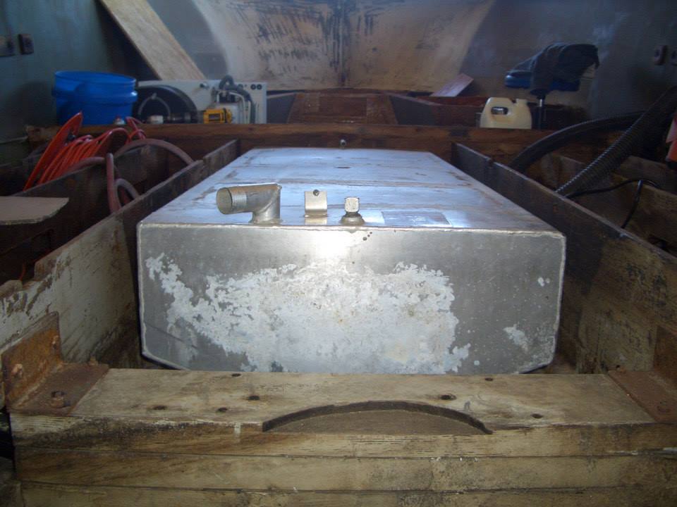

Transom and below deck fuel tank

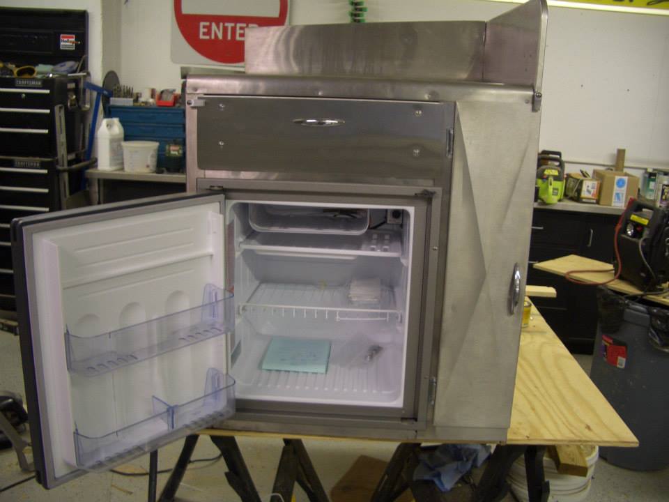

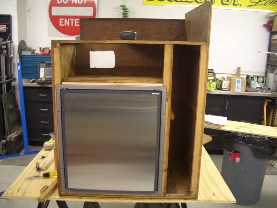

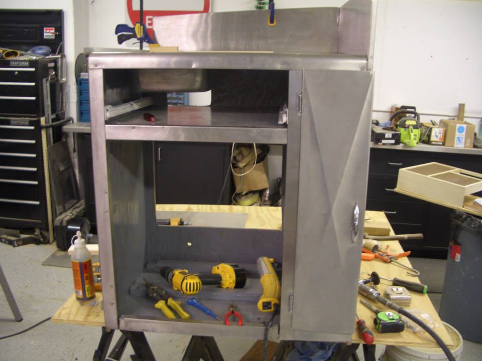

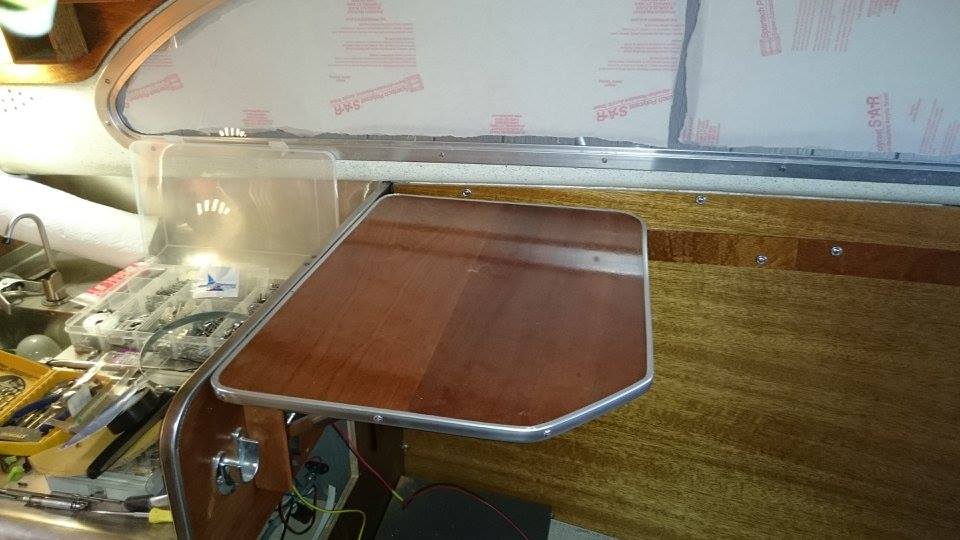

1960 Dorsett Farallon restore 8 years 11 months ago #134909

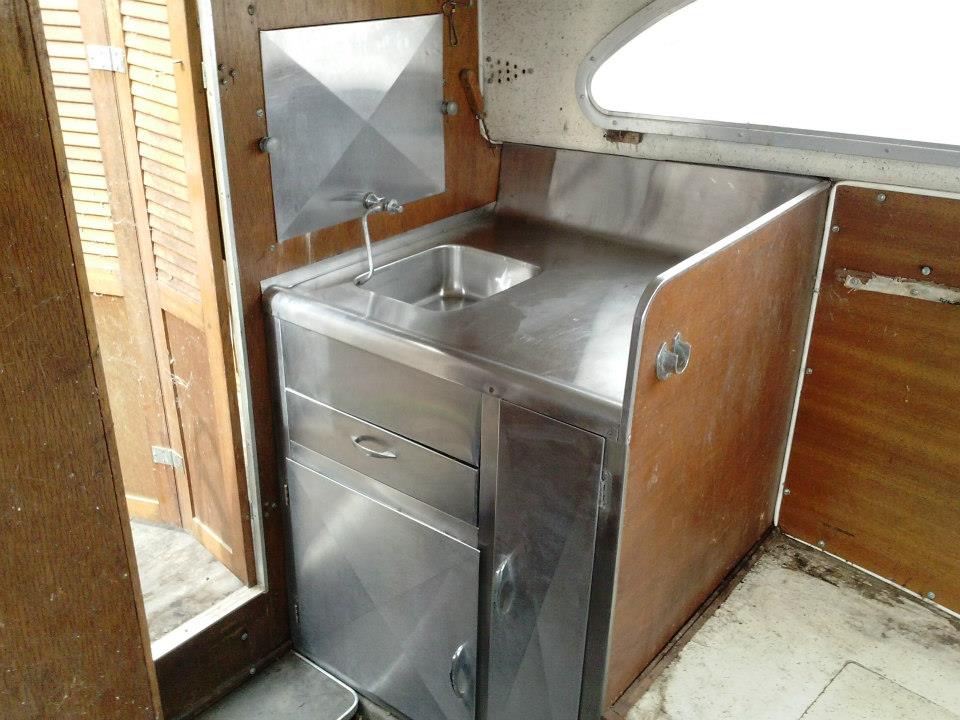

Galley rework

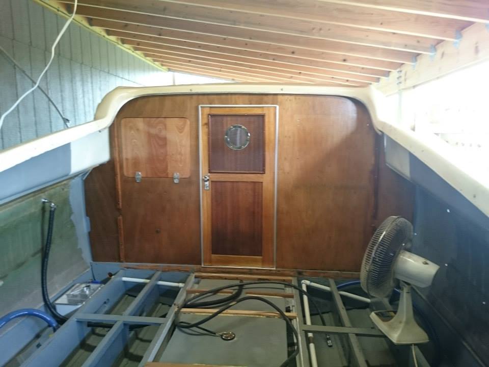

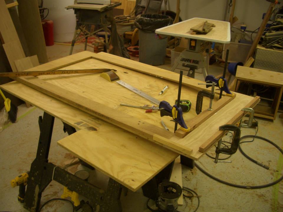

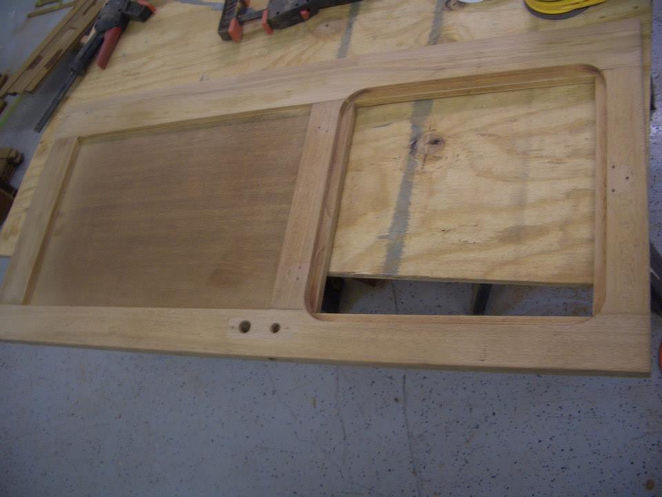

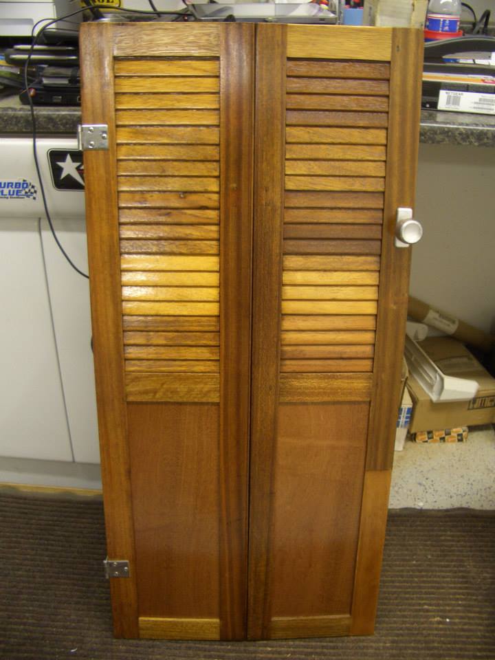

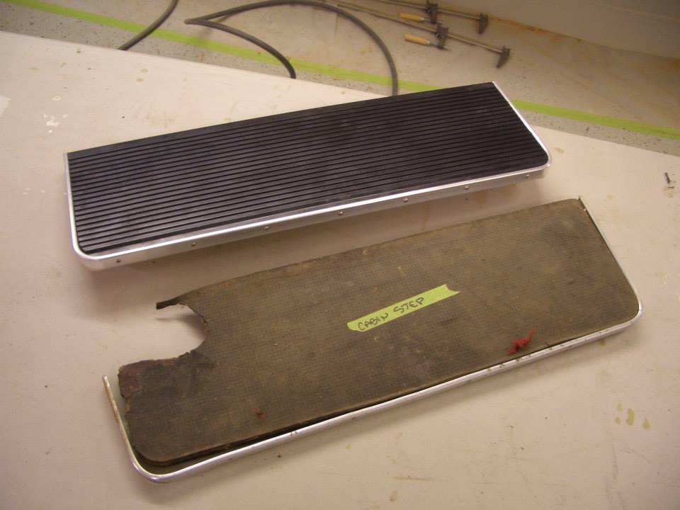

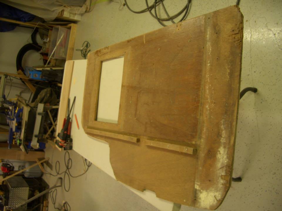

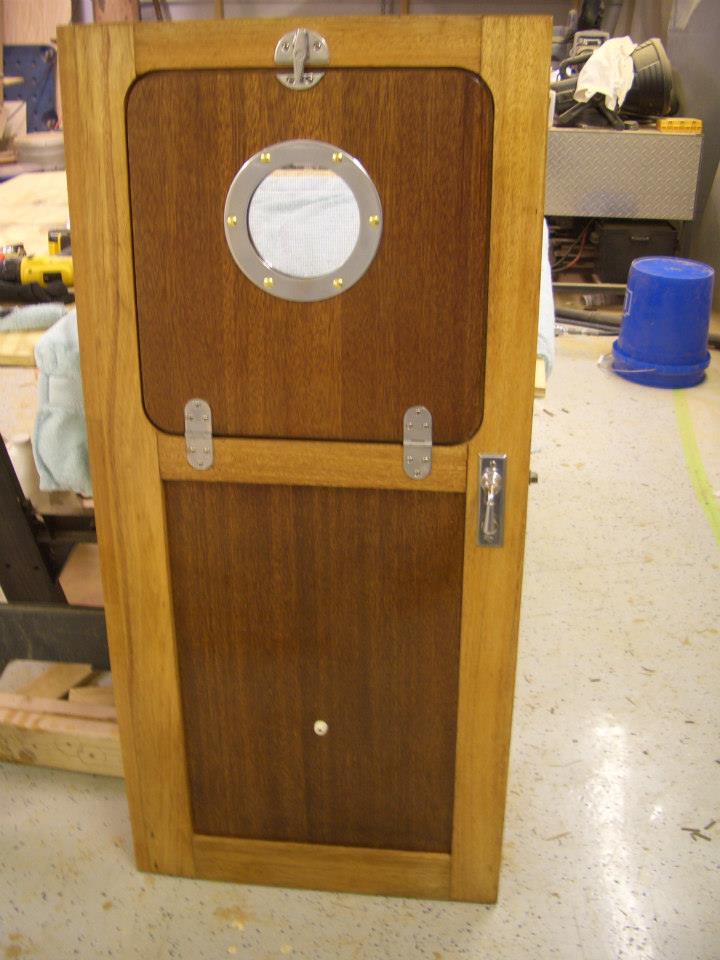

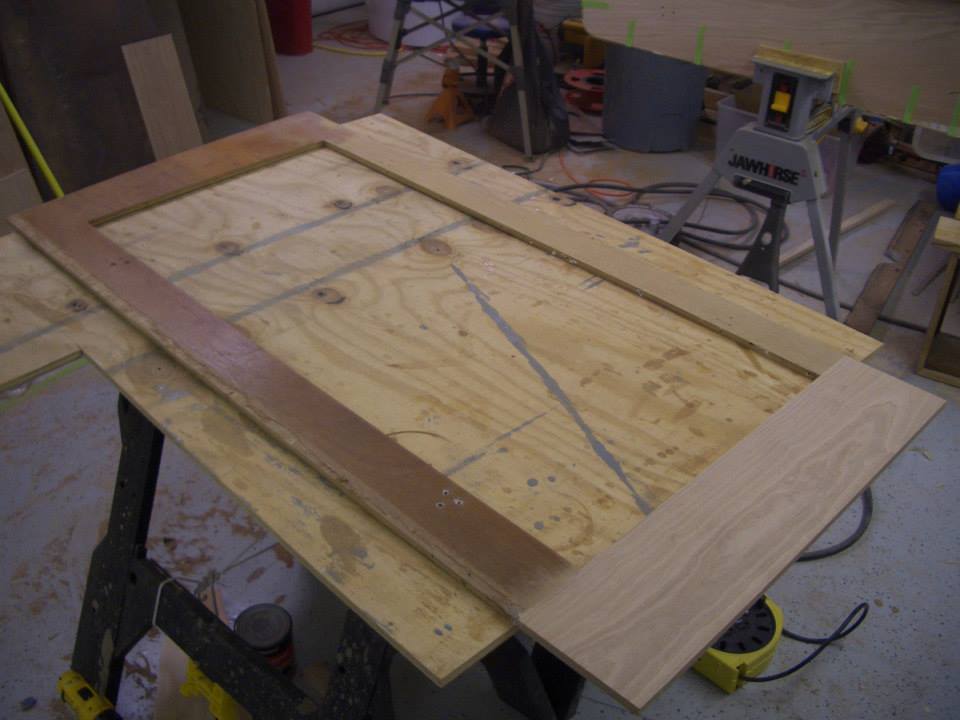

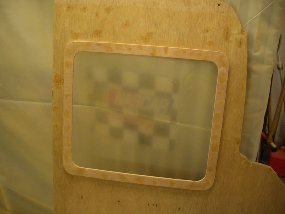

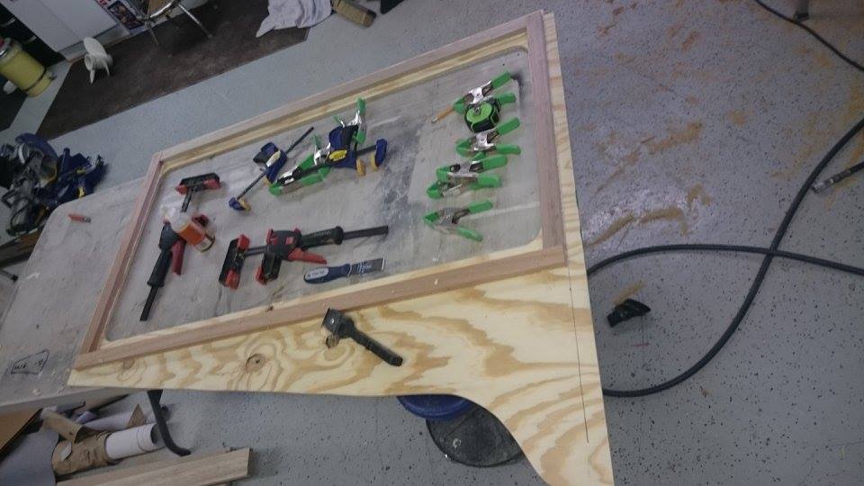

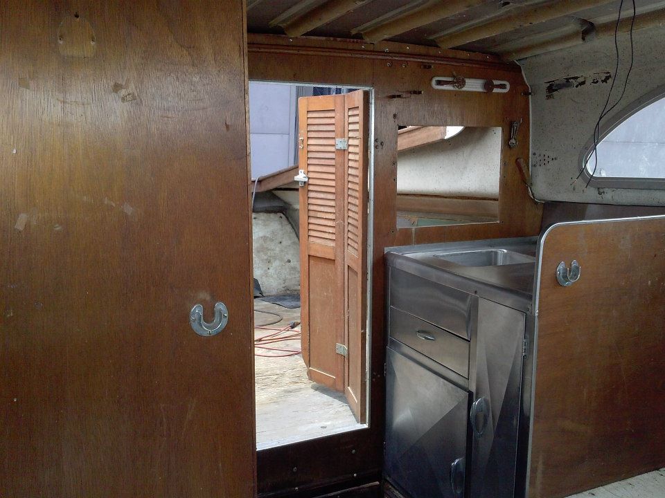

1960 Dorsett Farallon restore 8 years 11 months ago #134910

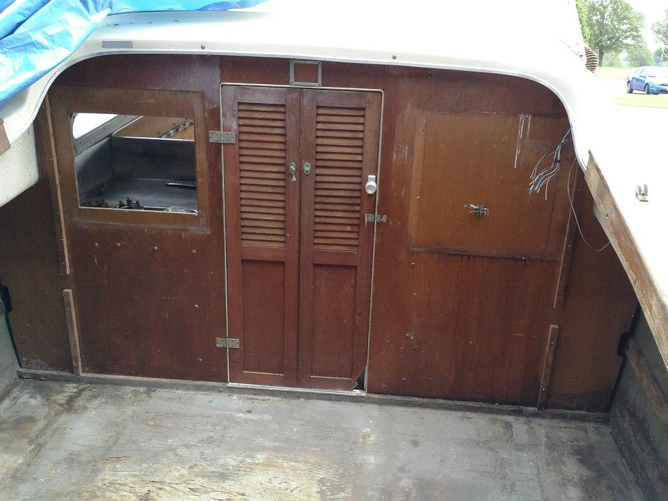

New cabin entry door modified from a Chris Craft door and added the porthole

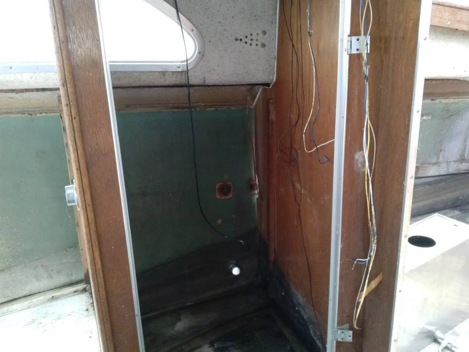

1960 Dorsett Farallon restore 8 years 11 months ago #134911
Old cabin entry door turned into the head door

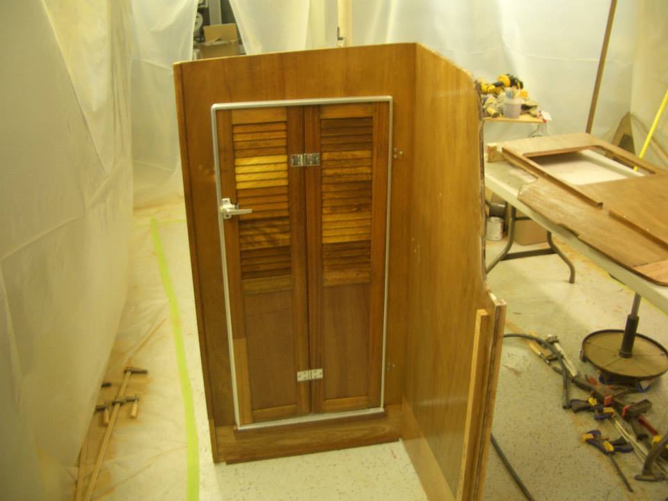

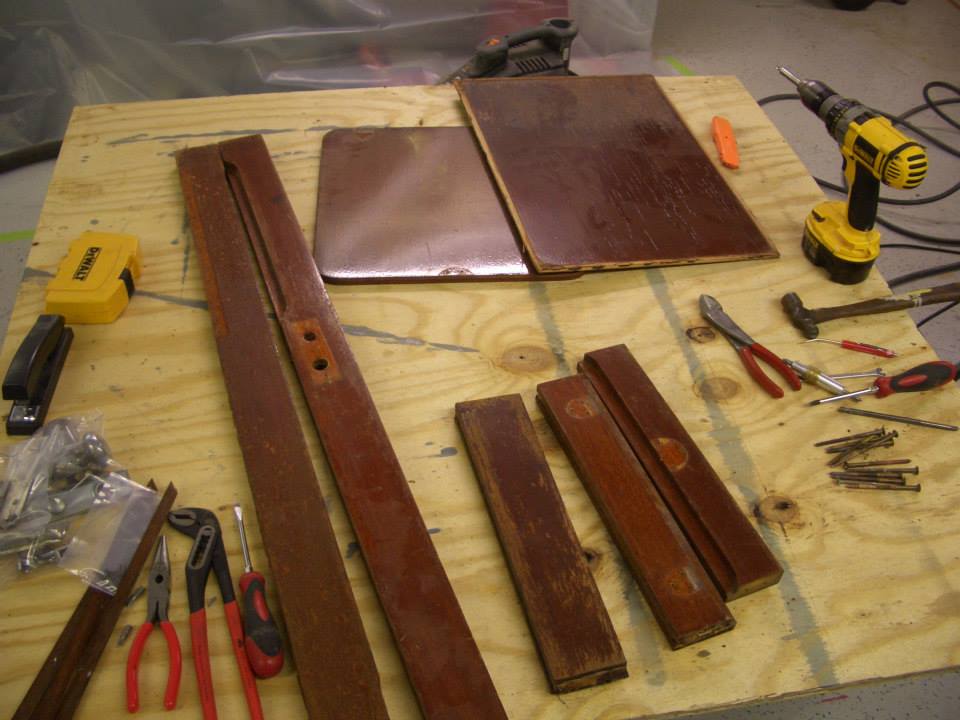

1960 Dorsett Farallon restore 8 years 11 months ago #134912
Interior redo

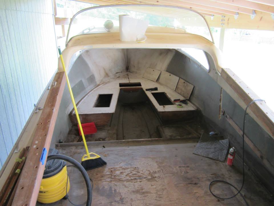

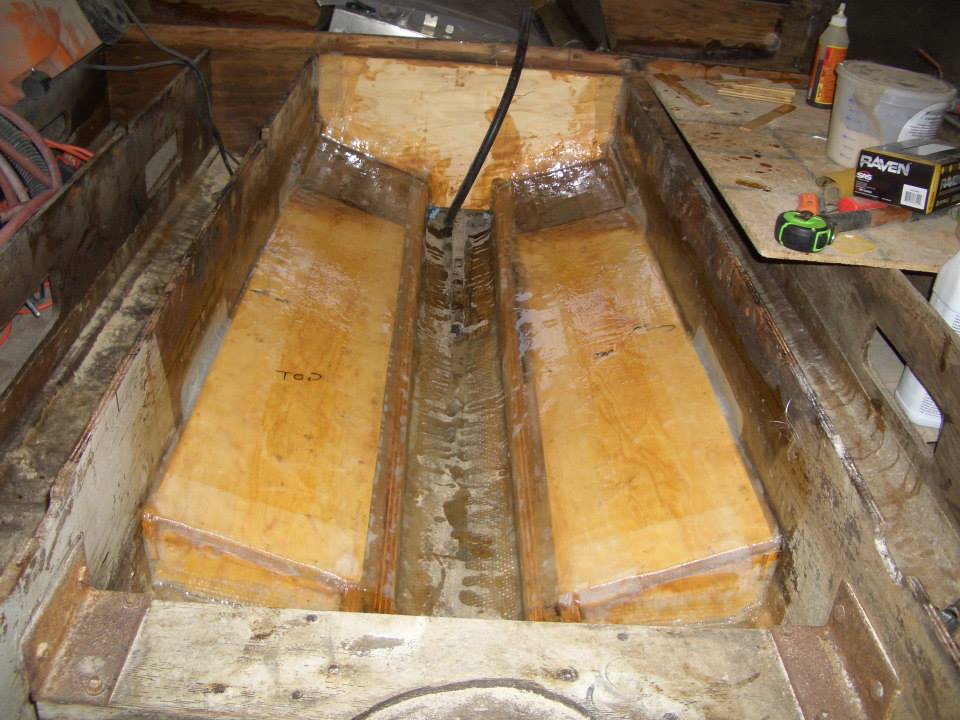

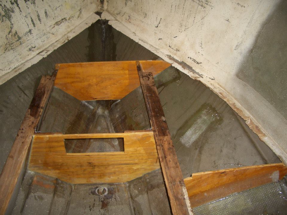

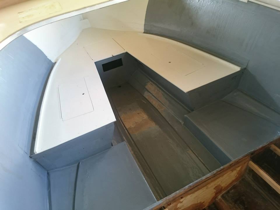

1960 Dorsett Farallon restore 8 years 11 months ago #134916

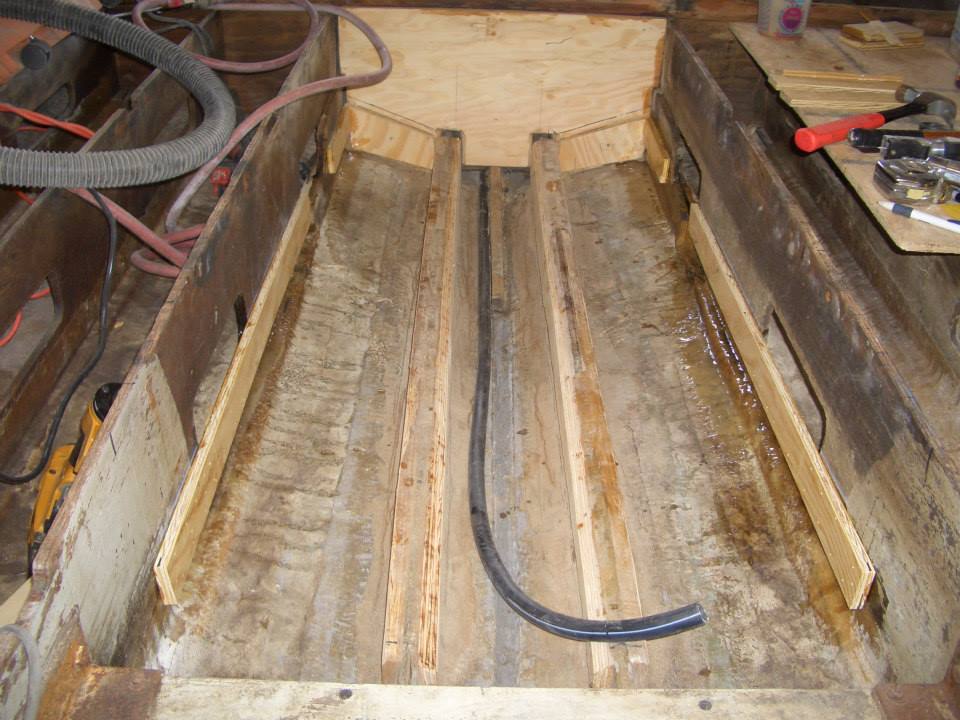

Spars glassed in, V berth done, new fuel tank area done .

In goes the cabin

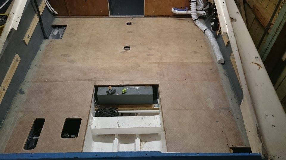

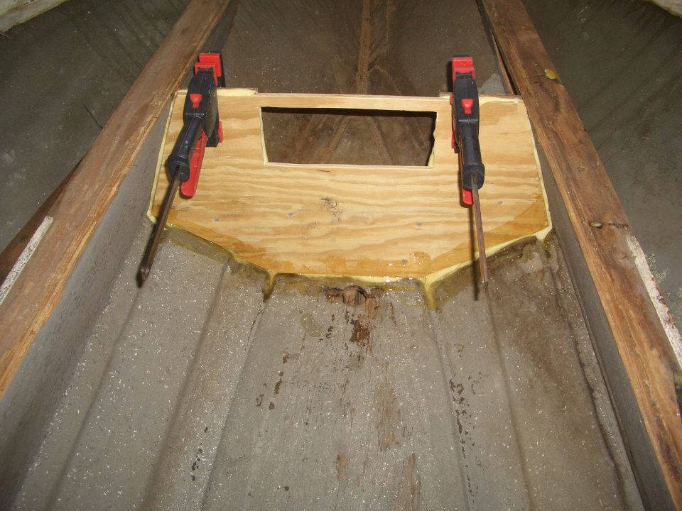

1960 Dorsett Farallon restore 8 years 11 months ago #134918

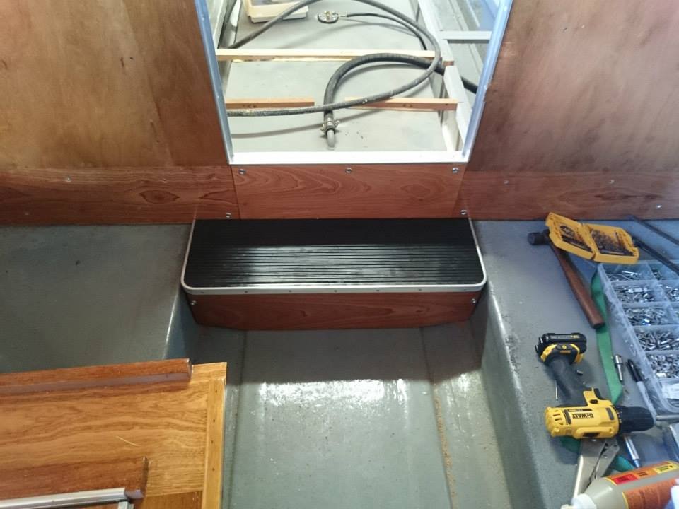

floor time and head build

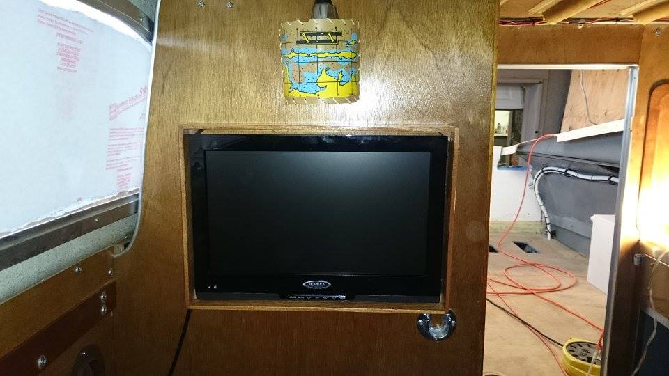

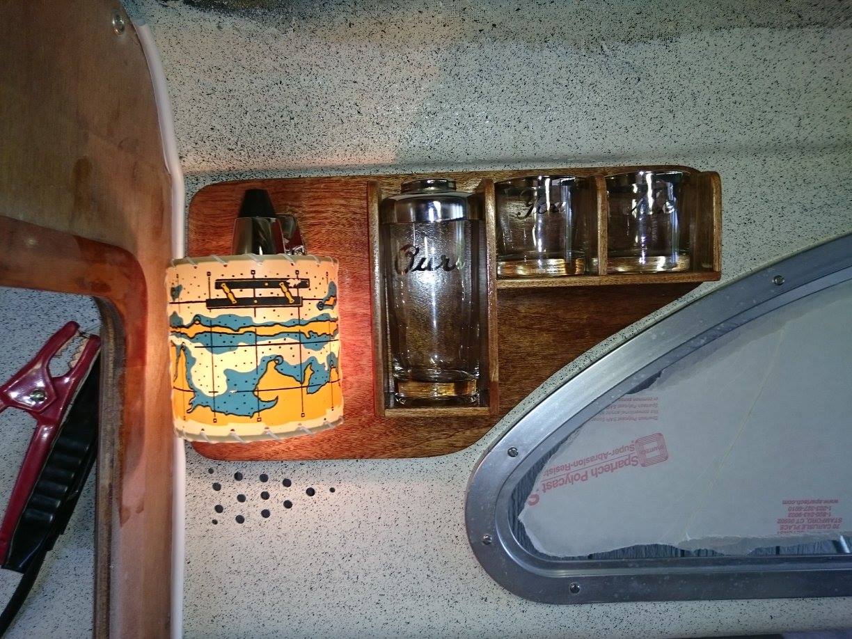

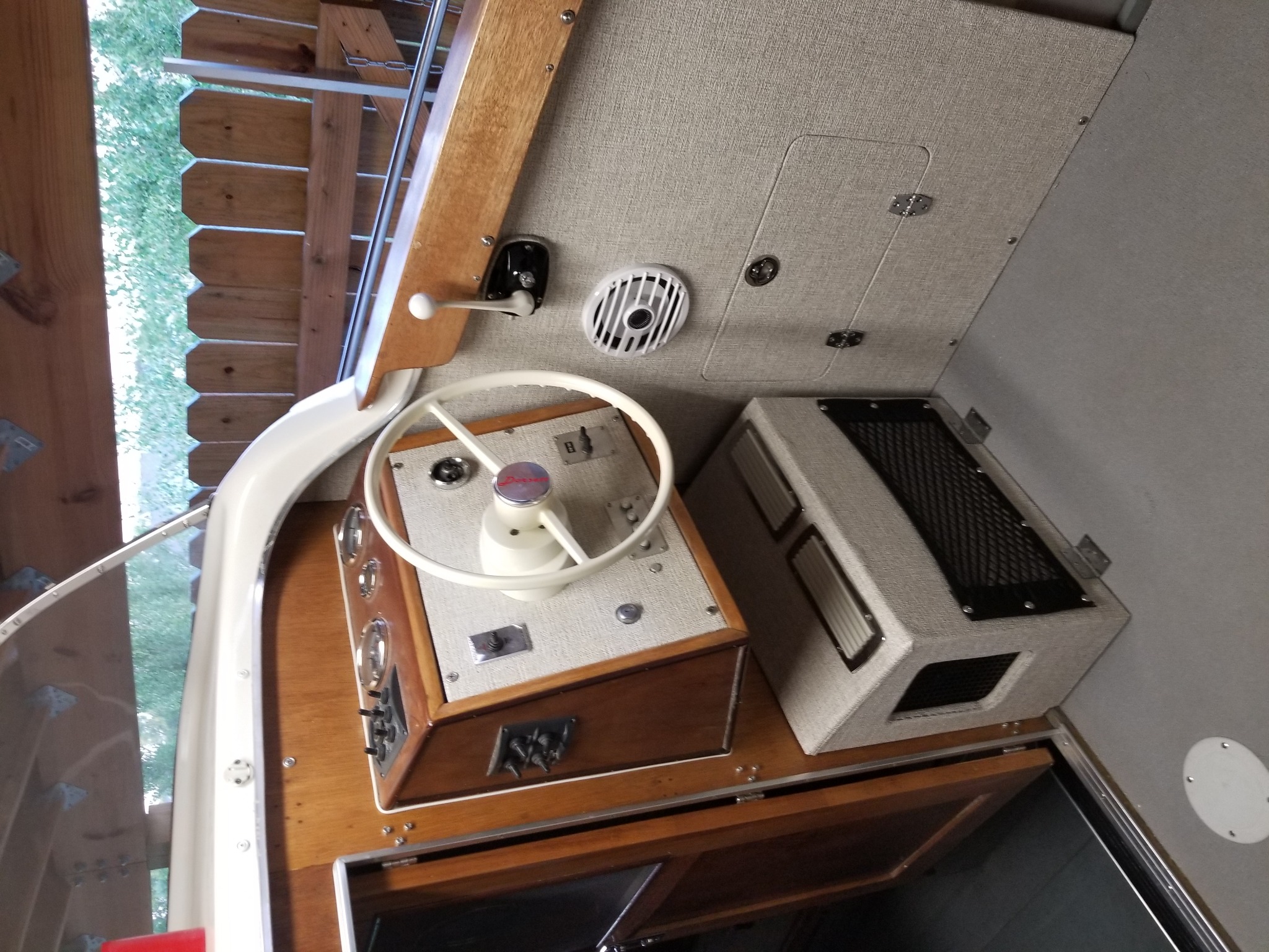

1960 Dorsett Farallon restore 8 years 11 months ago #134919

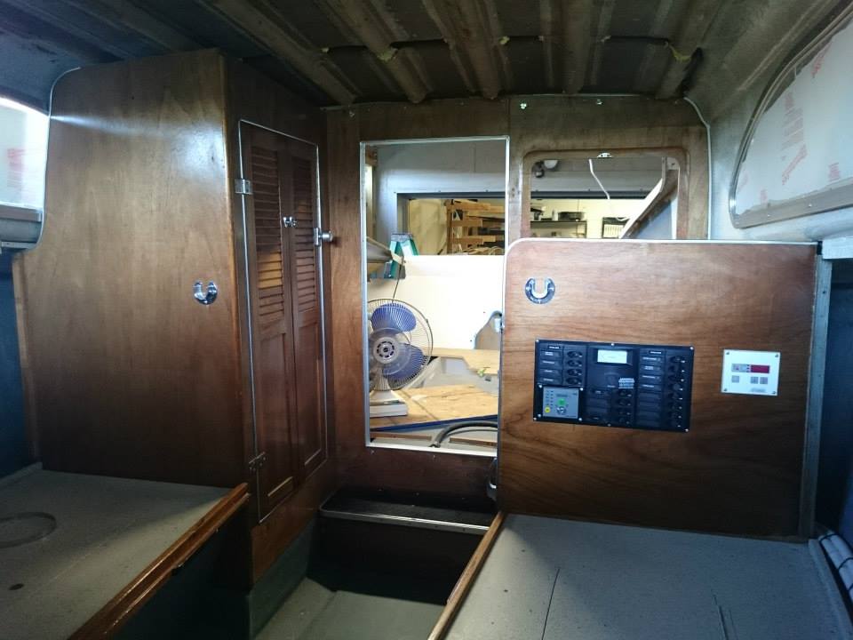

here's some interior pics and of course gotta have DVD with TV for those times at anchor. Also have AC and Heat to make the wife happy.

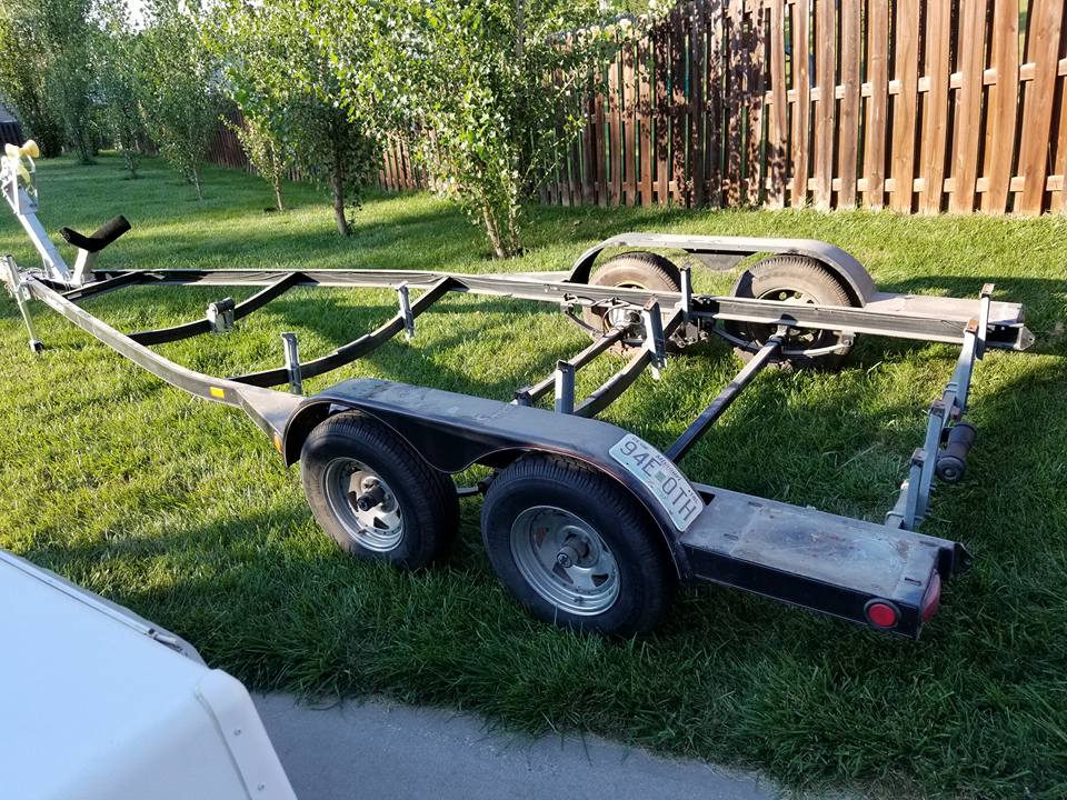

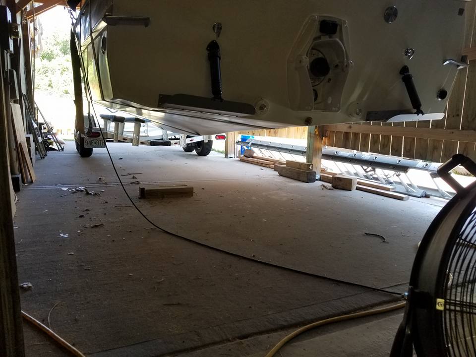

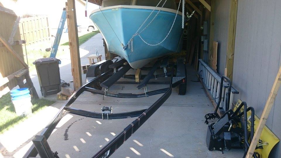

1960 Dorsett Farallon restore 8 years 11 months ago #134920

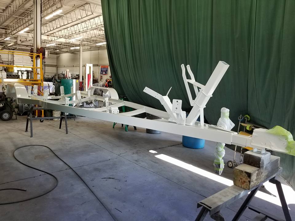

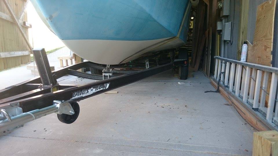

Had to pick her up off the old trailer and fit her with a new one

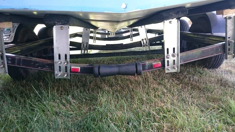

1960 Dorsett Farallon restore 8 years 11 months ago #134921
New trailer redo

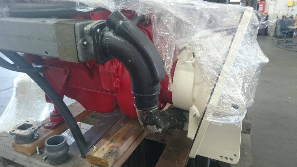

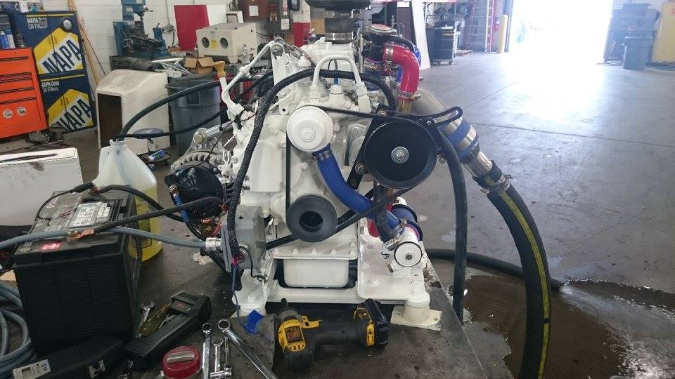

1960 Dorsett Farallon restore 8 years 11 months ago #134922
Had to build custom exhaust to match up with the early Penta AQ 200

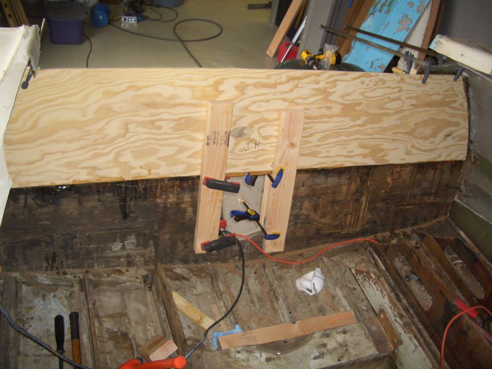

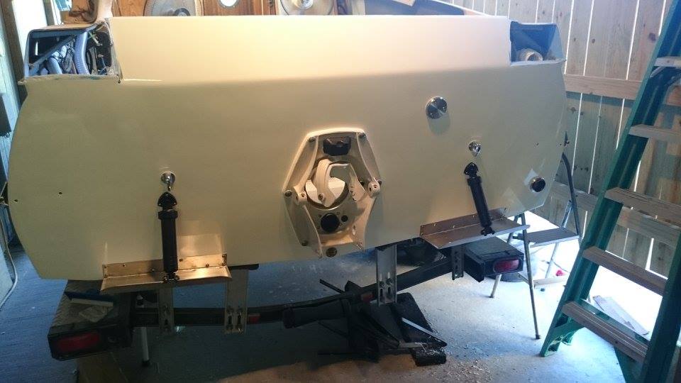

1960 Dorsett Farallon restore 8 years 11 months ago #134924
Transom done

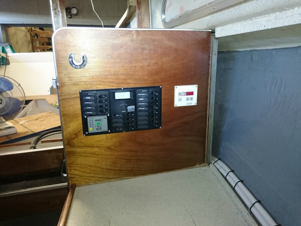

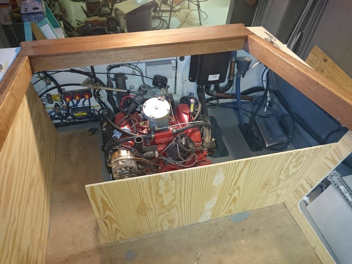

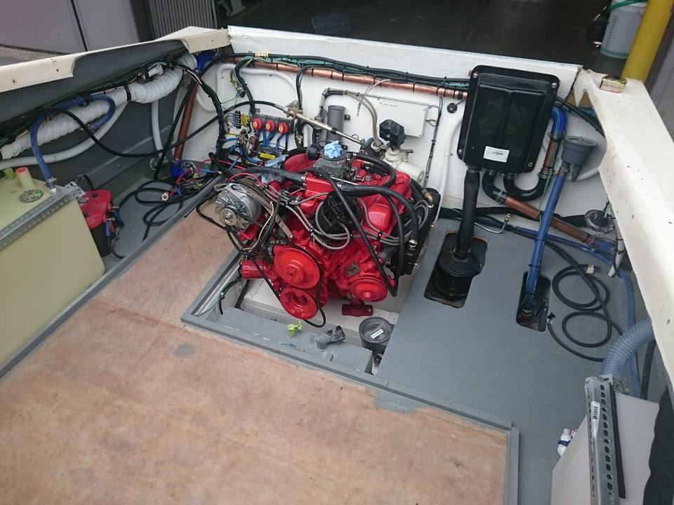

1960 Dorsett Farallon restore 8 years 11 months ago #134925
In goes some wiring and plumbing then dropped in the motor

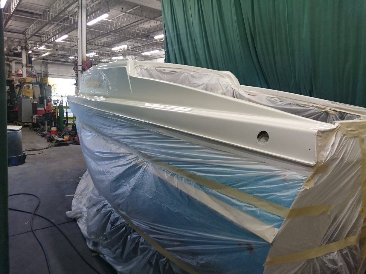

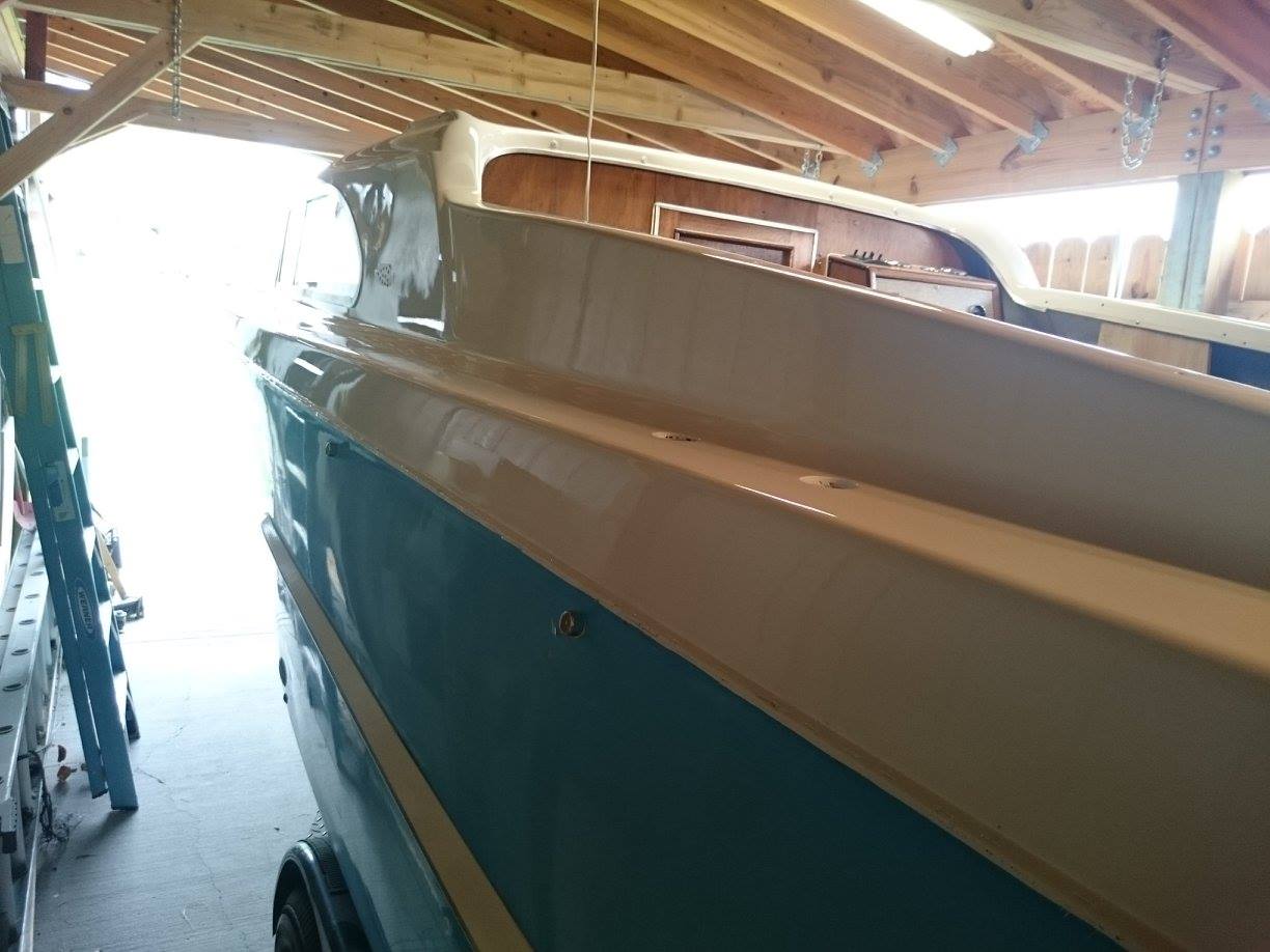

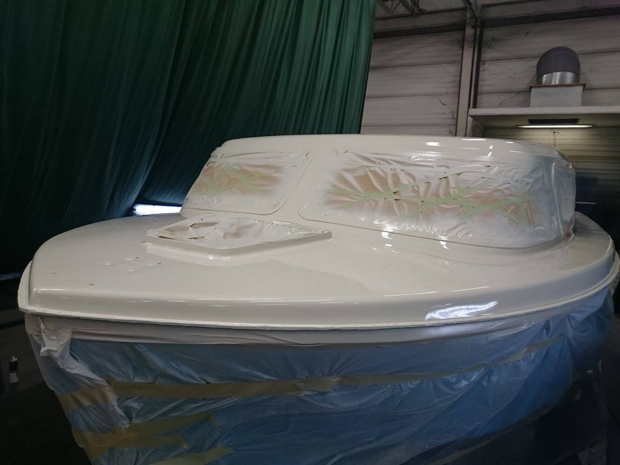

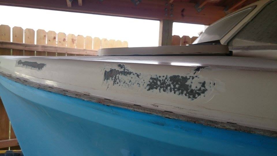

1960 Dorsett Farallon restore 8 years 11 months ago #134926

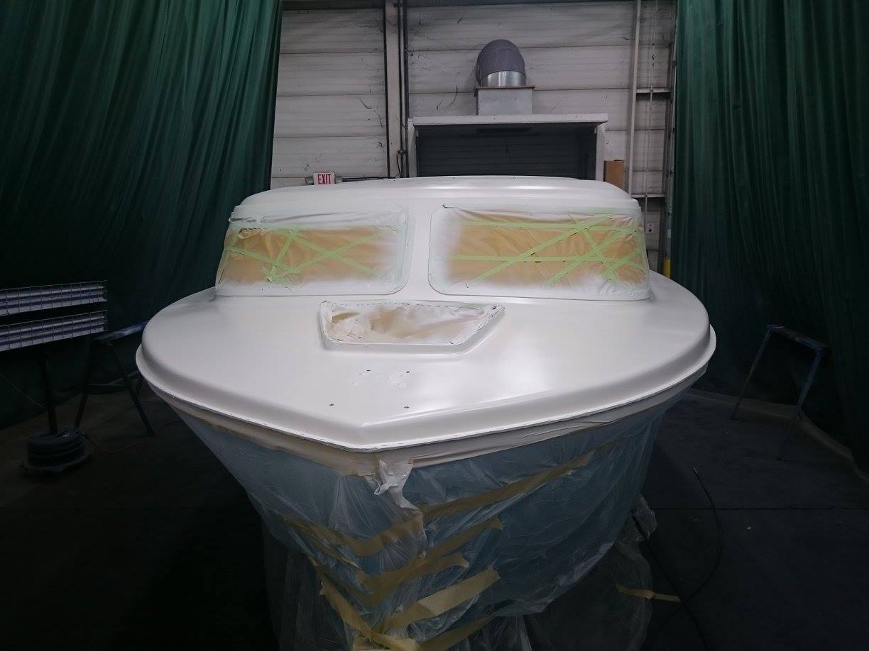

The top gelcoat was in bad shape so I had to do a repaint on top

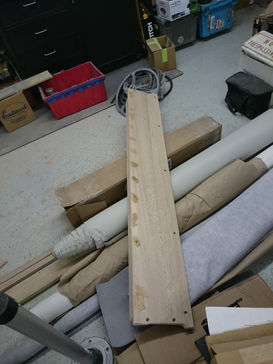

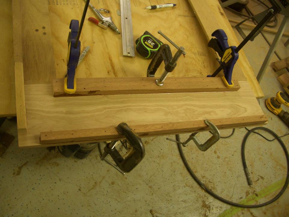

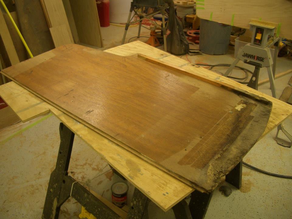

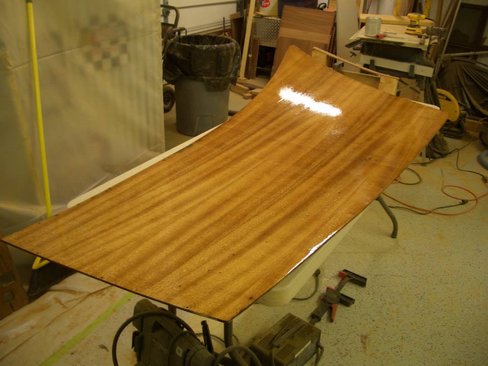

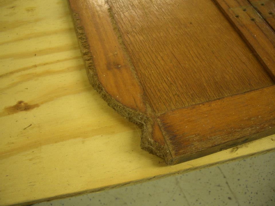

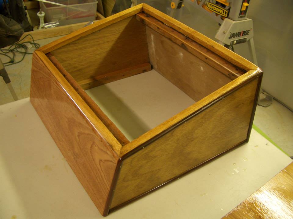

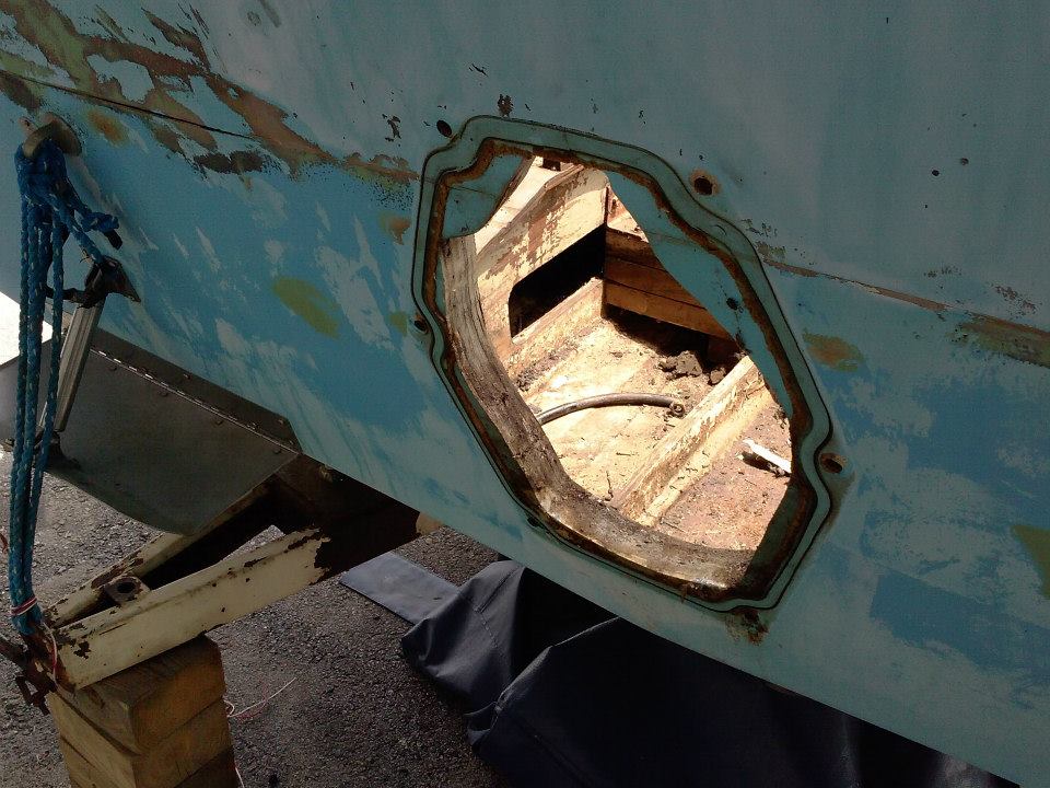

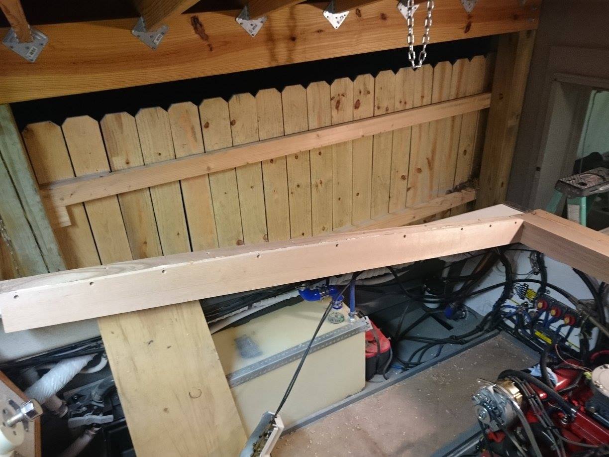

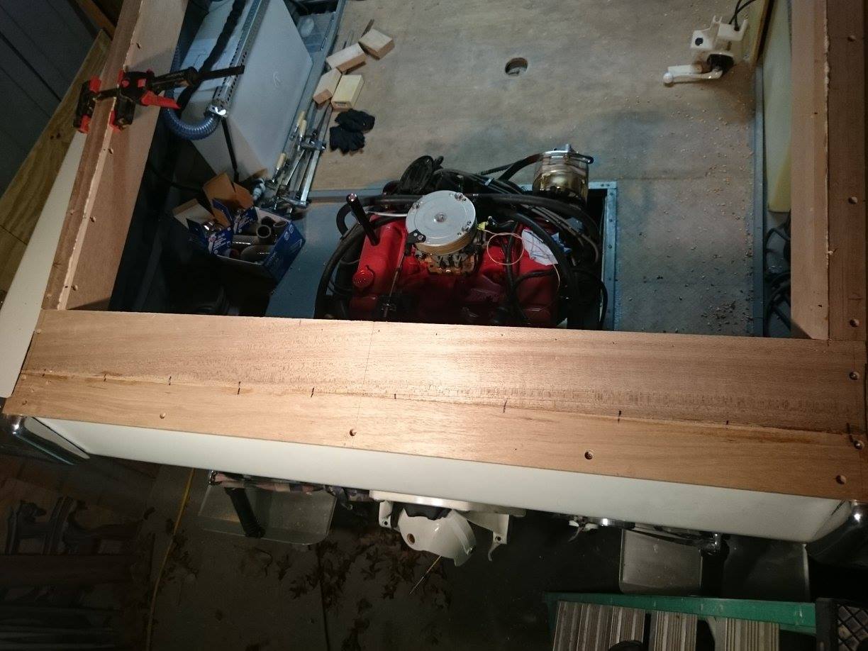

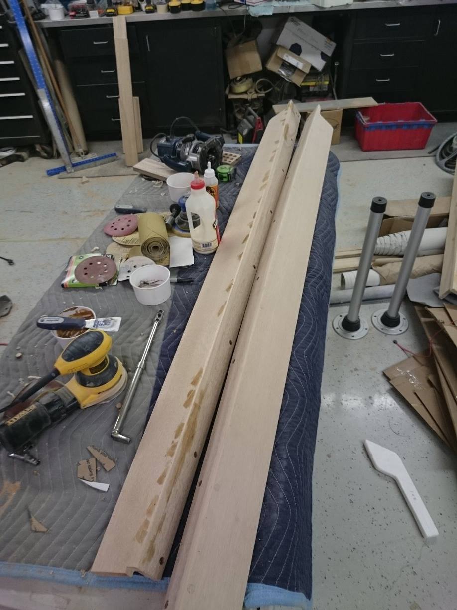

1960 Dorsett Farallon restore 8 years 11 months ago #134930

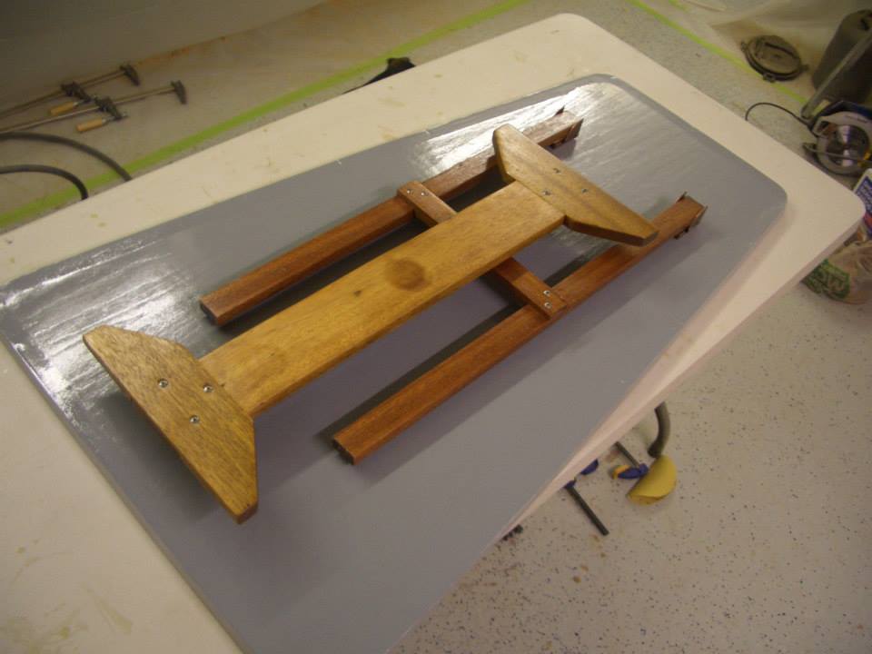

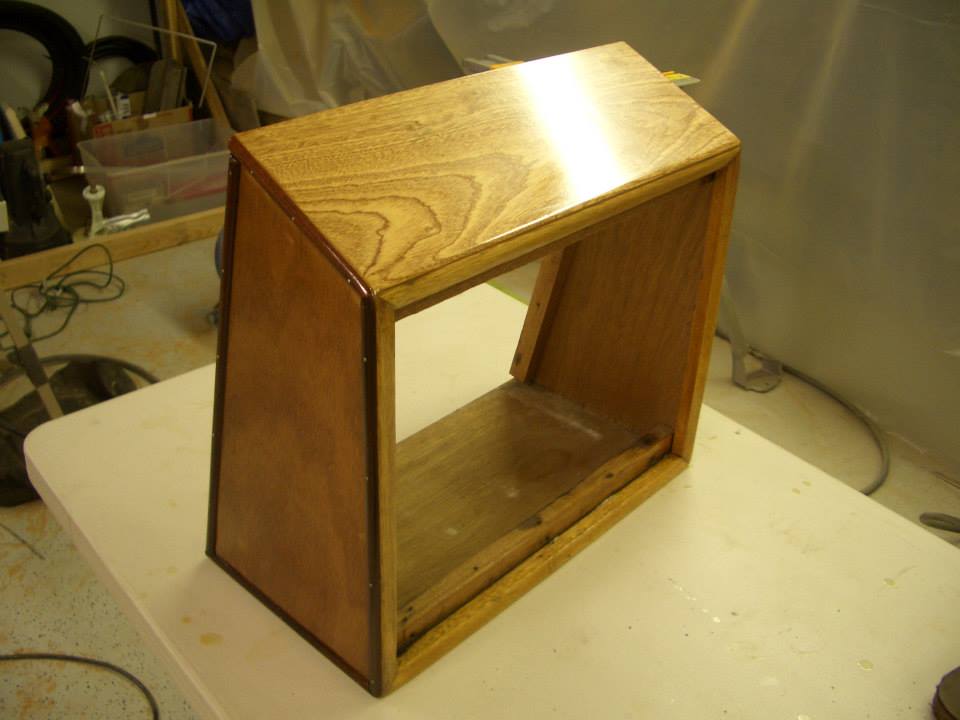

This boat was converted to a I/O back in 1964 (based on the engine date code) and because the splash well was cut out there needed to some kind of structure added back in so they wrapped the surround in mahogany. The old surround was junk so a new one was built from mahogany as well.

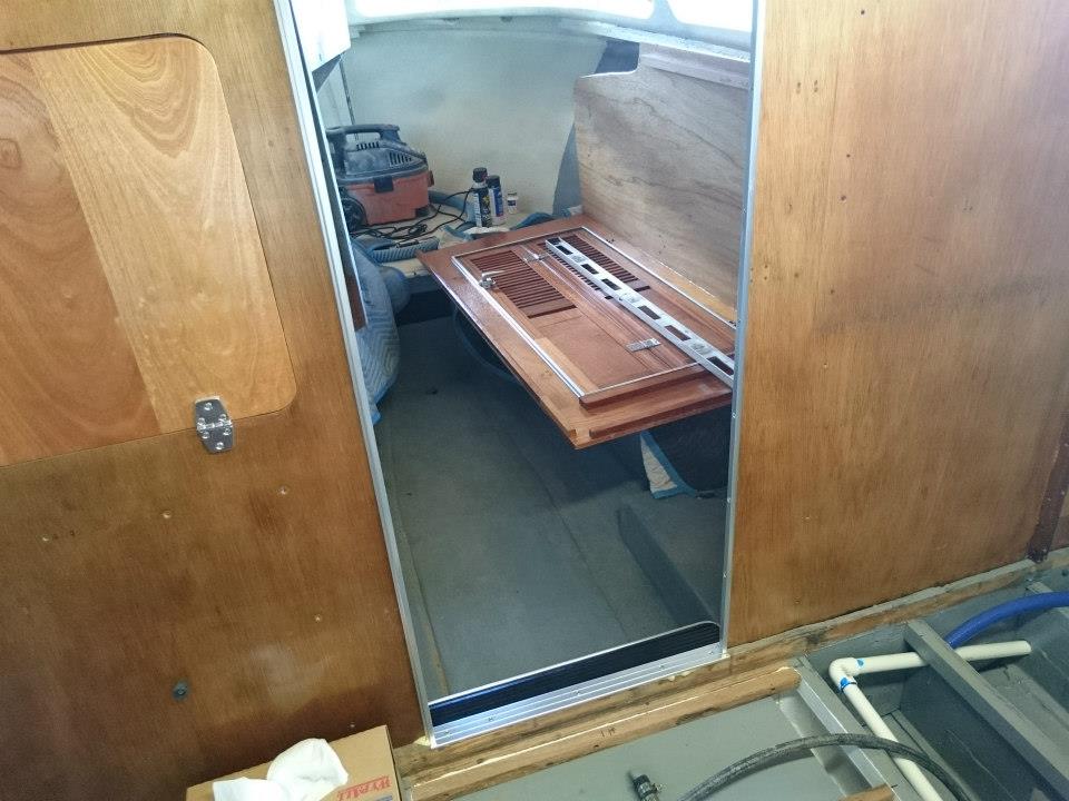

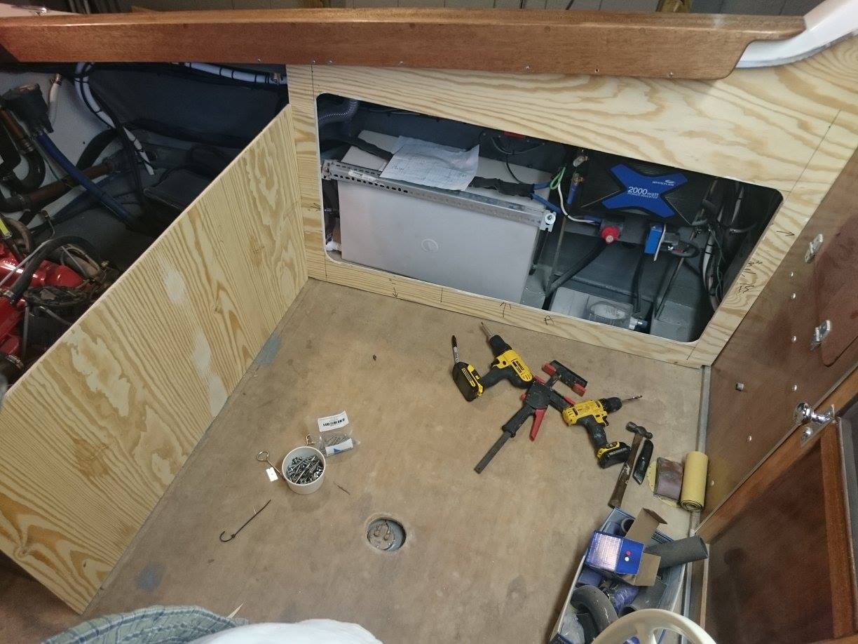

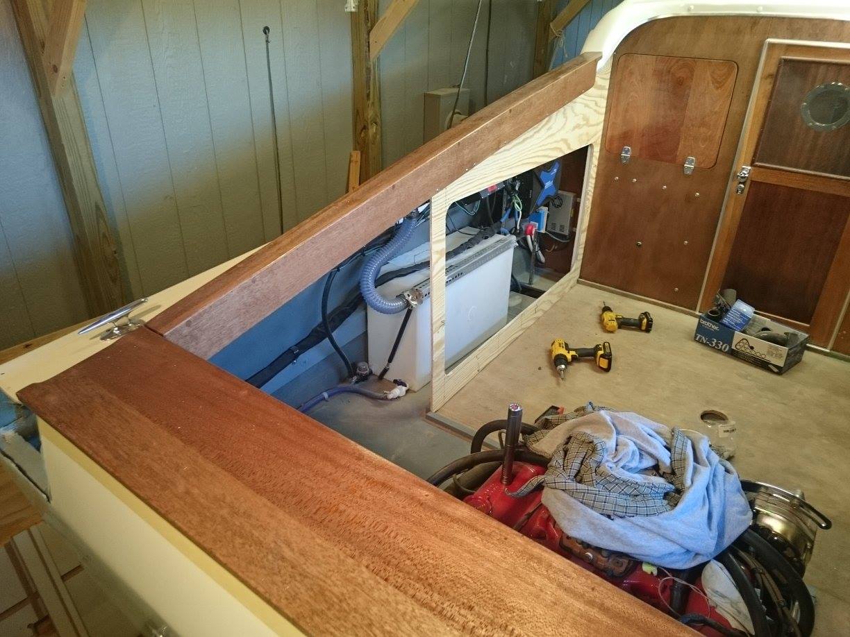

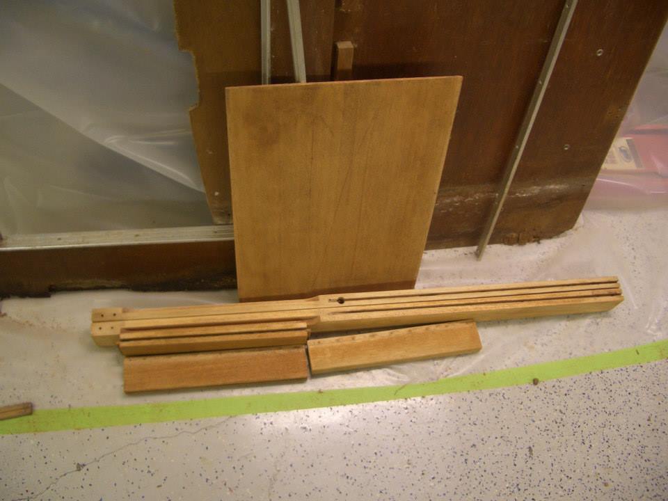

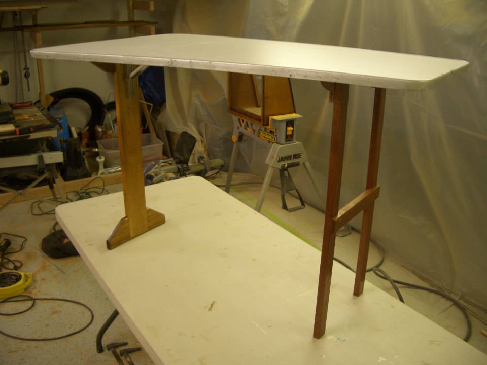

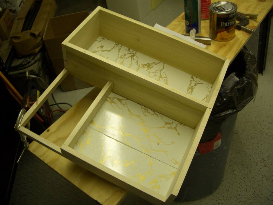

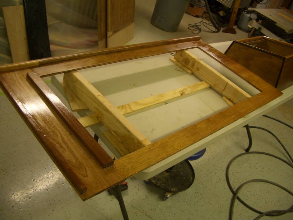

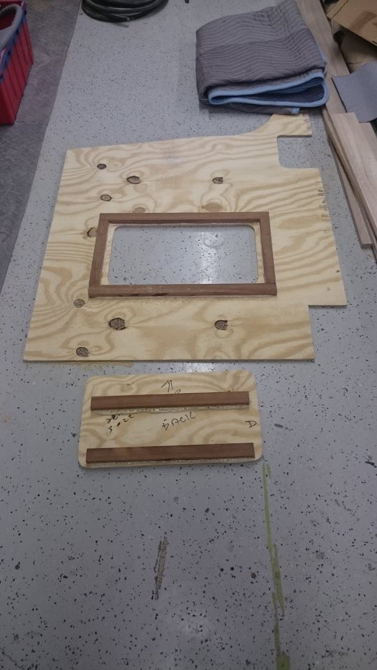

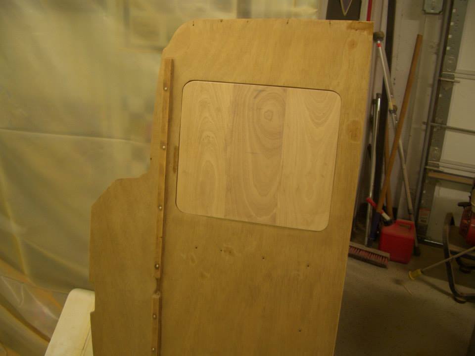

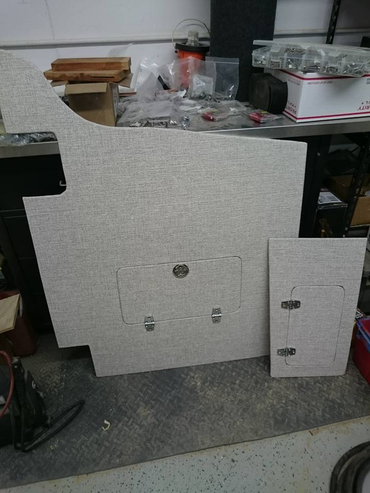

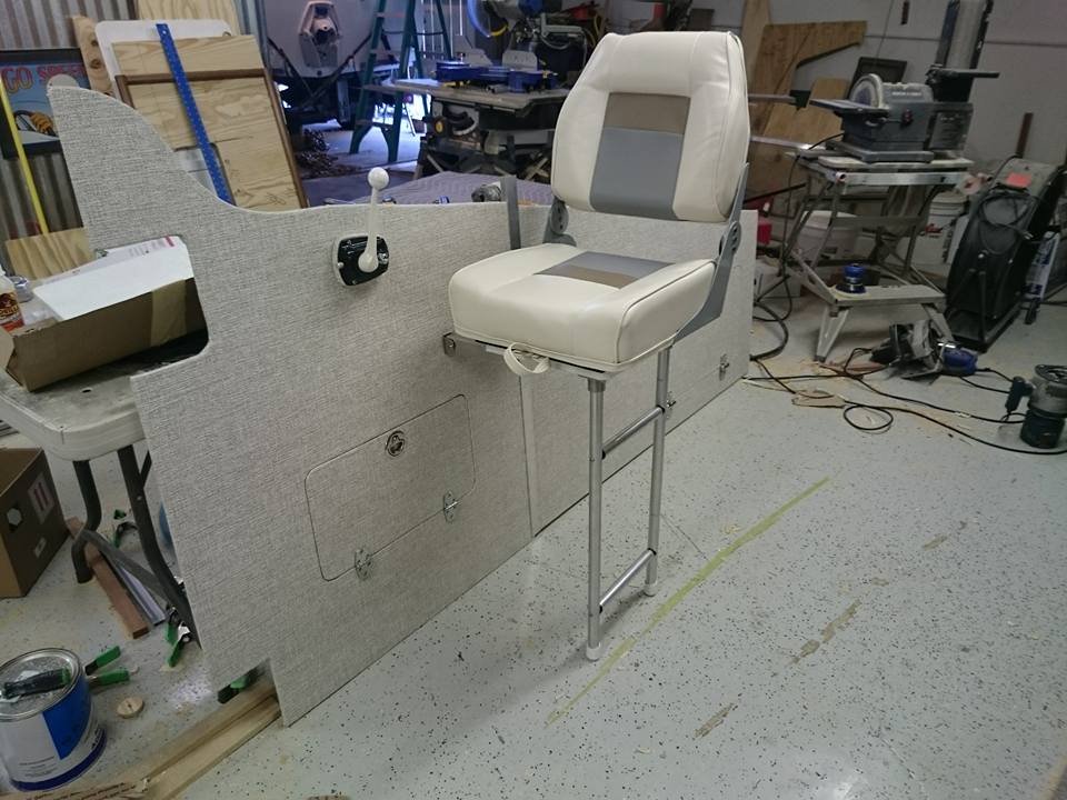

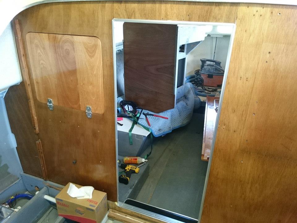

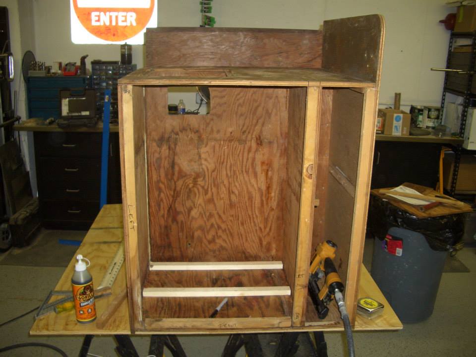

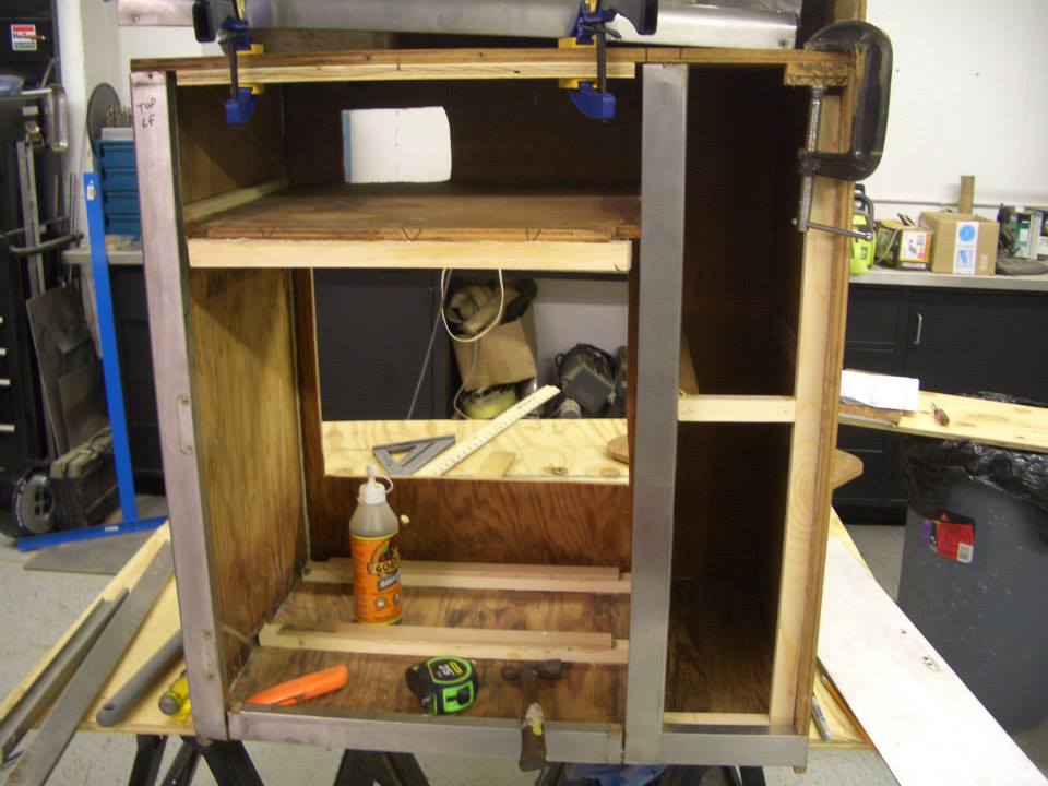

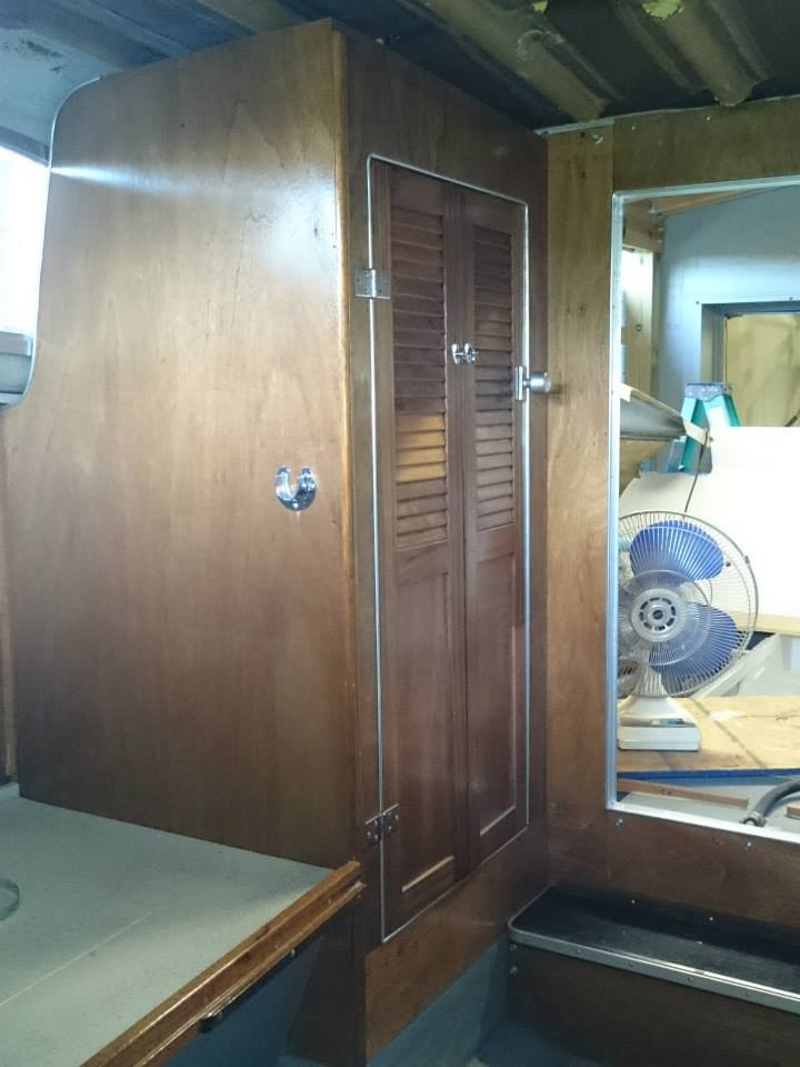

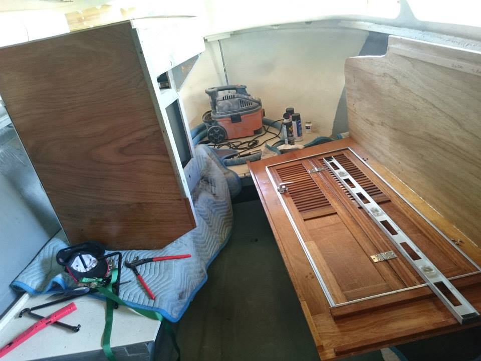

1960 Dorsett Farallon restore 8 years 11 months ago #134931

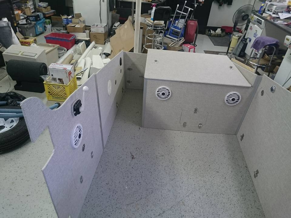

Now on to the interior panels with doors and access points where needed. The large door on the port side allows for the galley table to be stored inside it when not needed.

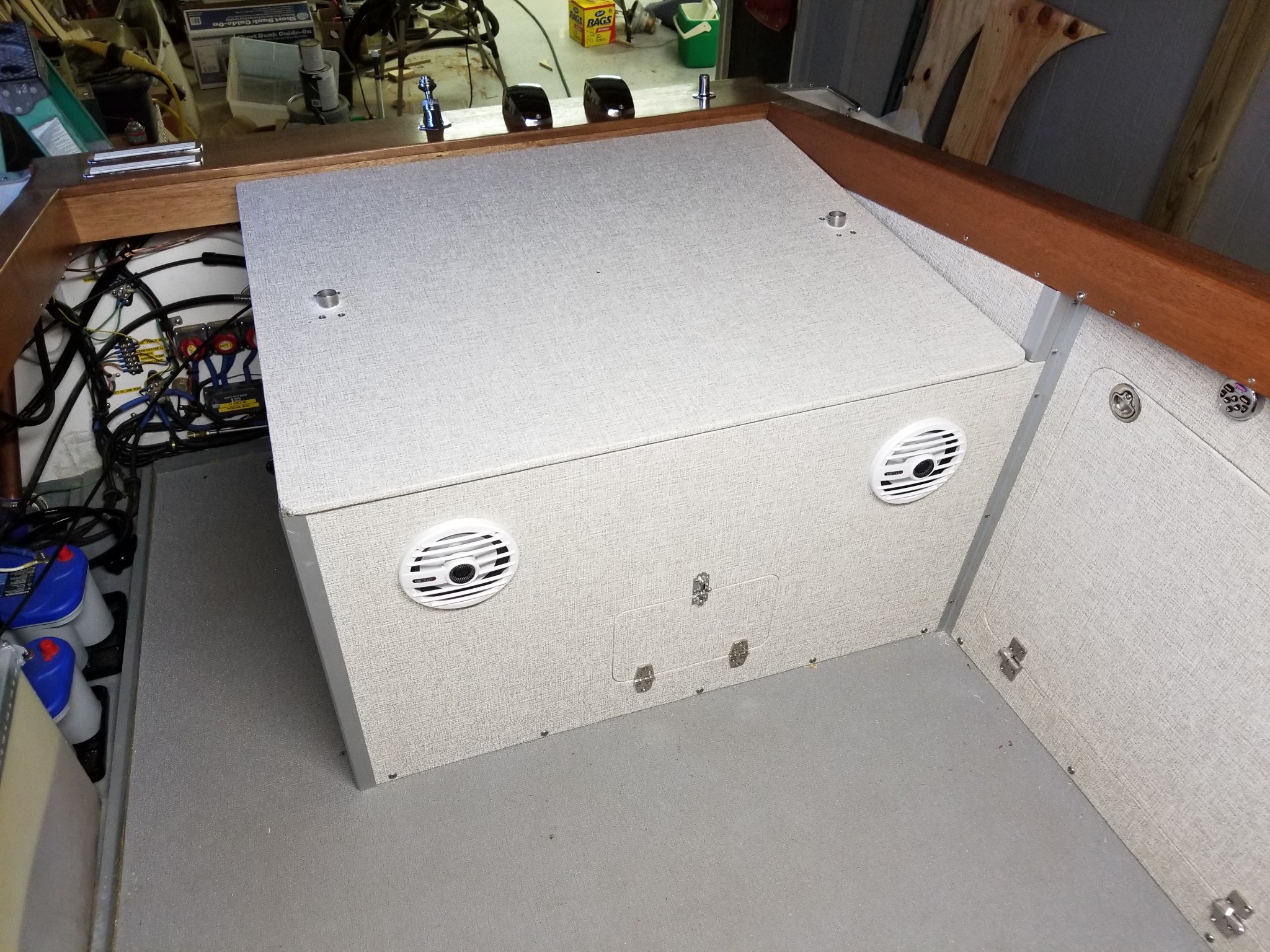

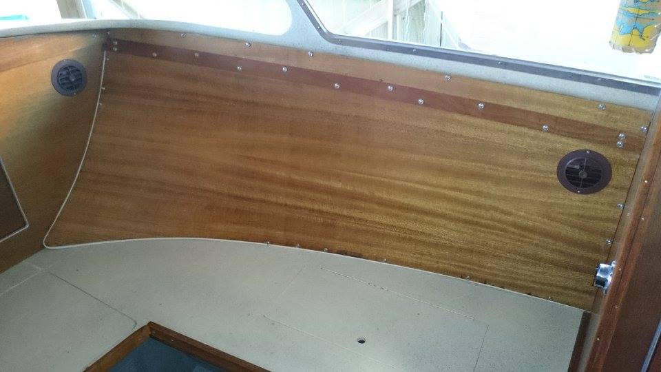

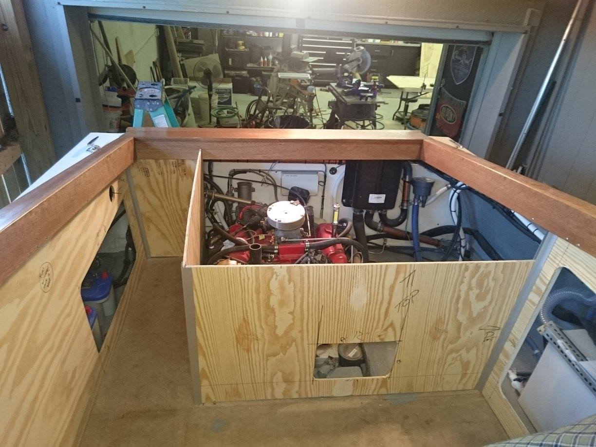

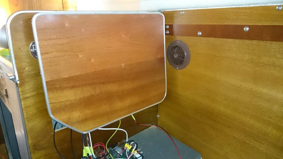

1960 Dorsett Farallon restore 8 years 11 months ago #134932
Interior panels covered in Nautolex, the engine cover has a removable backrest and snap down cushions (still in the works)

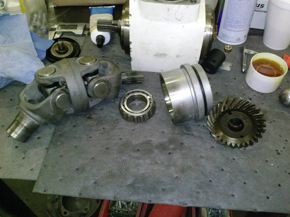

1960 Dorsett Farallon restore 8 years 11 months ago #134933
Fully restored Volvo Penta AQ 200 outdrive hung on the boat.
