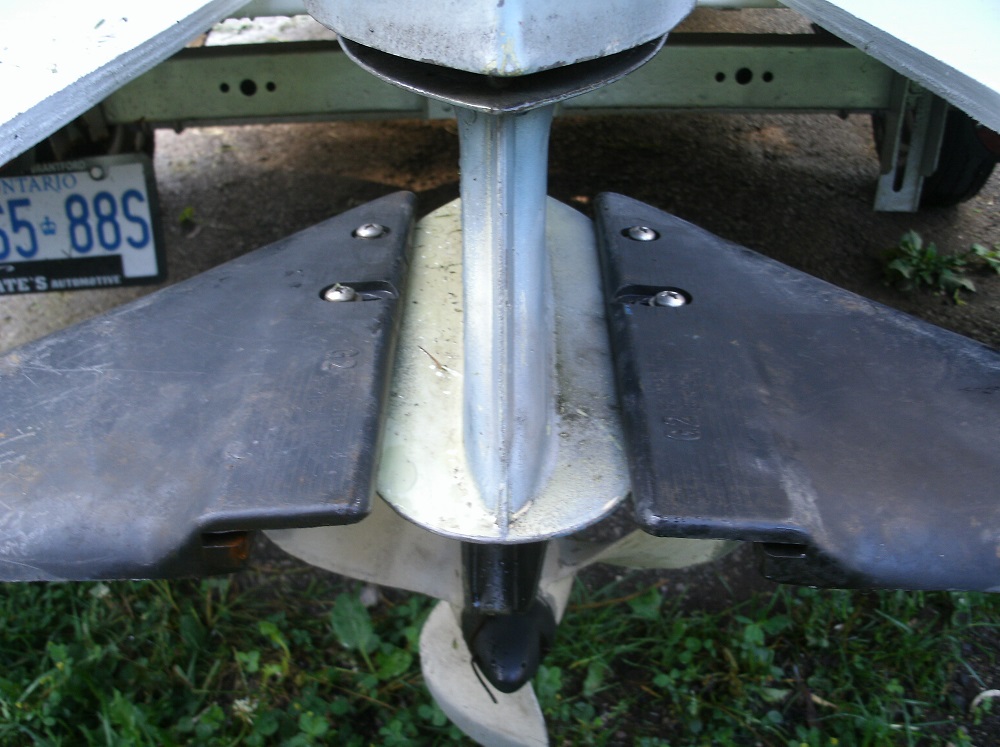

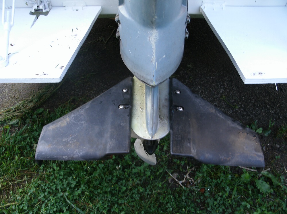

As you can see, I rebuilt the homemade trim tabs the original owner had installed himself on my 1960 Humber Regal and they seem to help planing and handling a bit, but she's fairly flat bottomed so I think it should come up on plane faster than it does and because it's wide and flat it drifts quite a bit while turning (maybe the tabs?) and I can put the gunwales under water with ease at WOT. My Merc buddy Steve gave me these planers(?/wings?what do you call them ?) so I'm going to put them on today and try them tomorrow after some engine work. What is the best position for them ? I haven't a clue. I've seen them back as far as they can go and I've seen them forward. Opinions please. I only want to drill two holes in each side once.

Well I can speak from personal experience now and they suck ! The boat took twice as long to get on plane and lost about 5 or 6 mph on the top at WOT. I put them on last night, drove to Belwood Lake this morning, launched just after sunrise, and by daybreak I had beached the boat on a really nice little island so I could REMOVE them. This is firsthand and it might be different on someone elses boat but wow what a downgrade they were on my little Humber ! Never again. As for turning with them on it wallowed thru the turns and I could stand it on it's side without really altering course in any measurable way. I'm going to play with the existing trim tabs next weekend and see what happens. Whaletails receive 2 thumbs down from me. Thanks for the reply and have a great day !
