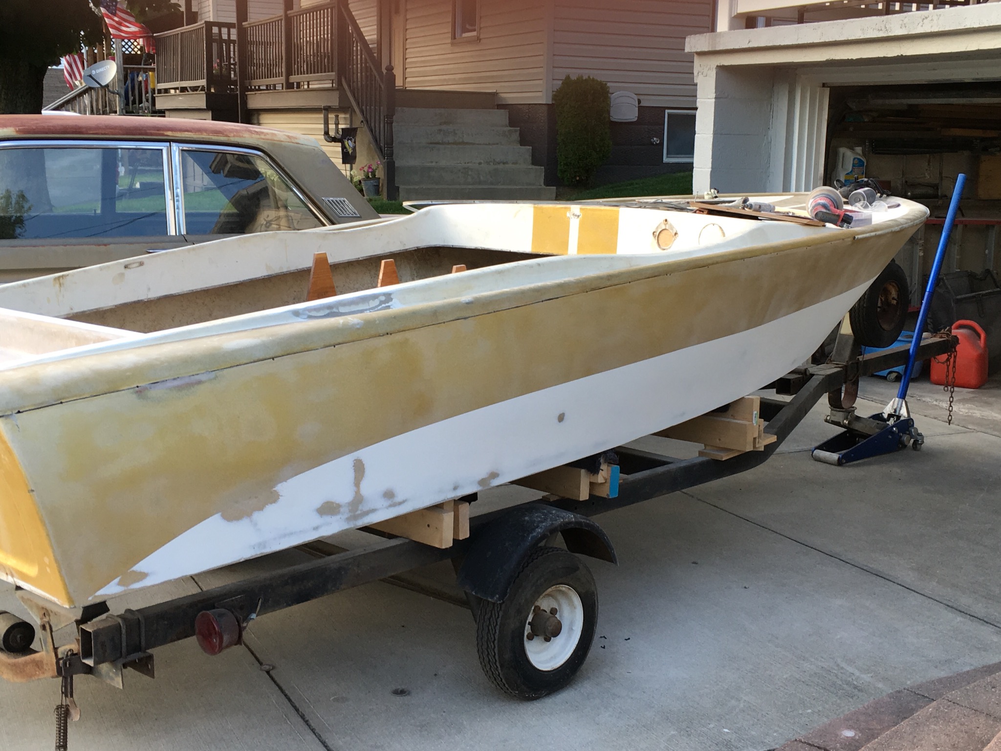

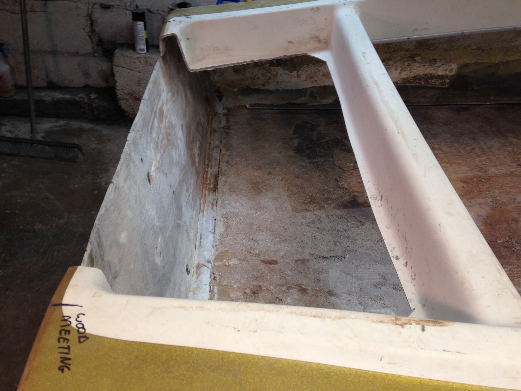

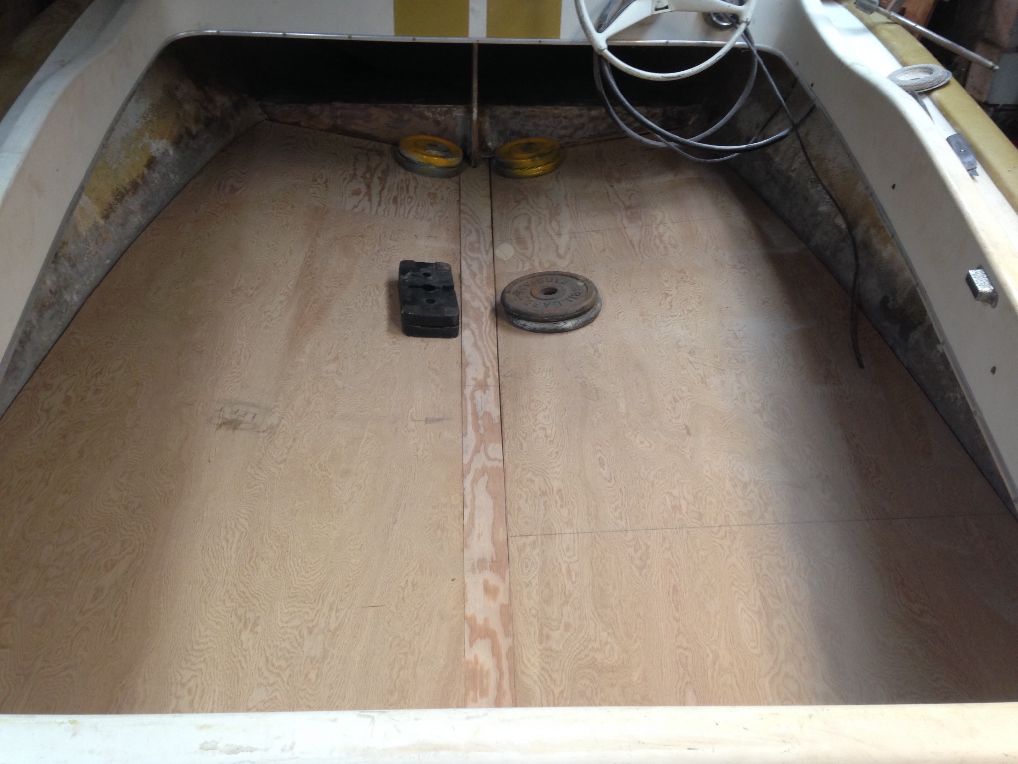

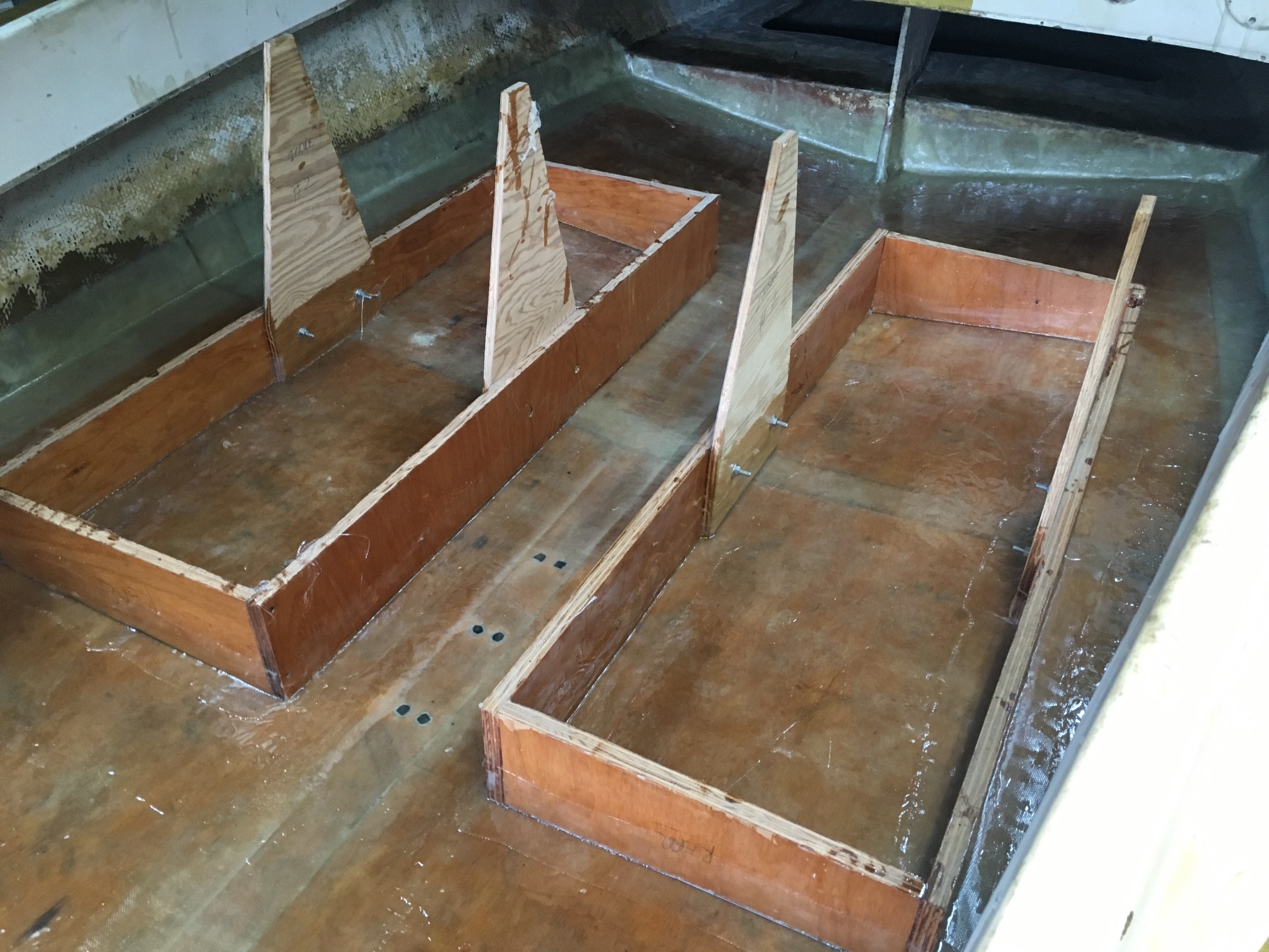

Some progress of the Eliminator by International I've been working on last couple years. All new wood through the boat , transom , floor ,seat mounts and inner bracing . Boat will be powered by a 100hp 6cyl Mercury. Boat will be painted with gold flake and white accents as original

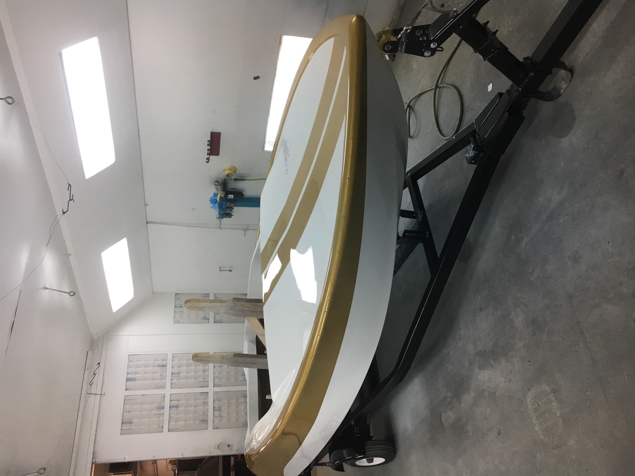

First pic from body shop .. with snow on the roads it will be till next week till I can pick it up
1964 Eliminator project 8 years 10 months ago #135324
Not sure why it stretched the photo ..try it again

Very nice! What was used for the finish? Marine paint, automotive paint, gelcoat?

The original gelcoat finish was knocked down with a DA with 120 grit then sprayed with epoxy primer, it was then wet sanded with 220 and sprayed with shopline JP2 finish primer wet sanded again with 220 reshot with another coat of JP2 and wet sanded with 400 then topped with PPG automotive paint and flake then topped with several coats of clear to even paint and flake heights .
From everything we researched there was only a small chance of automotive clear “fogging” if docked in the water for an extended period of time (days to weeks) but would eventually regain its clear .This boat will not be docked for any long periods so we should be OK
