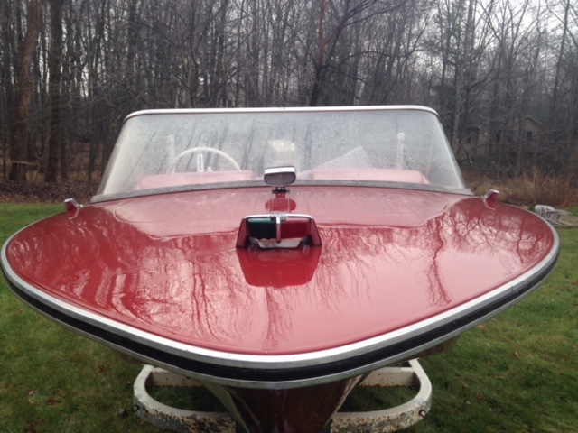

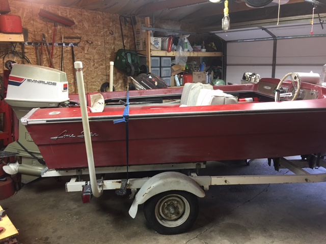

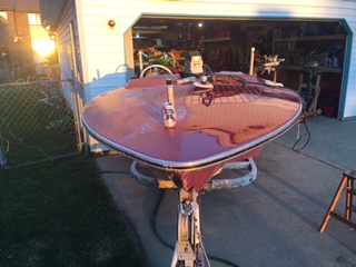

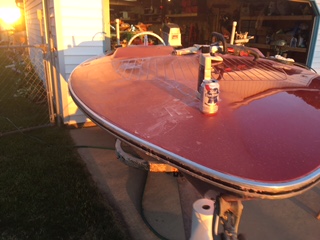

Been a while since I have posted anything on the site. Been very busy with life!!

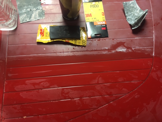

Spent some time last night on the first cut for buffing out the 1968 Lone Star Mustang. We have been working on wet-sanding the oxidized gel coat for quite some time now. We are working to get it ready to show for the Door County Maritime Museum classic boat show on 8/11-13. So far, so good. Going to sit with Cal for the weekend and drink all of his beer!!
Got some pictures of its original condition and work in progress. Last 3 are from last night when I put the buffer to it for the first time after extensive wet sanding to remove the oxidation. Preliminary results look good, just need to keep working at it. Once it is buffed out I need to reattach all the hull furniture and the windshield. I have a feeling the weeks are going to fly by!!

looking good! I'm going to be doing this same thing over the winter I hope. I saw the 800 grit wet/dry....what grits have you used? I was figuring doing 800 then 1200 before switching to the liquid compounds.

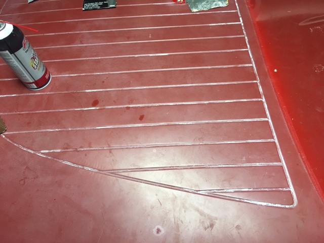

It was recommended that I use mostly 1000 and finish with 2000, with a sheet or 2 of 800 for the tough spots. I ended up using the 800 right away and was making some progress, but switched to 600 and powered through. I had very heavy oxidation on the topside, and while 800 was working I didn't think it was time effective.
The cut I did the other night was a test cut using Maquires Heavy Cut just over the areas sanded with the 600. I wanted to see how close I could get it. I think that I need to use the 1000 first to get a better mirror finish. I will try that on the other side and see what happens.
The boat looked awesome in natural light, but when I pulled it back into the garage under the flourescent lights i could see the fine scratches from wet sanding. Thats why I think I need to run another course of wet sanding before making the multiple runs with the buffer. Right now I am planning on 3 runs - heavy cut, rubbing compound, and then polishing compound. Then a good wax.

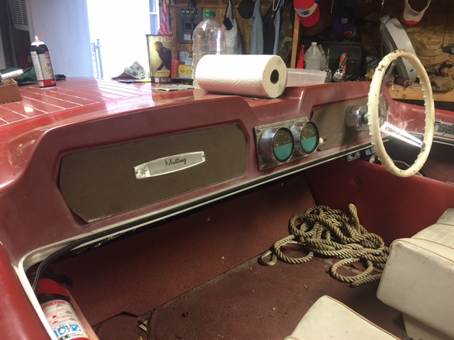

Here are some update pictures from the last few weeks with me and the crew working on the boat. Getting it ready for the boat show this weekend. Still need to show pictures of the current "finished" product. I left a few areas in their original state so that people could see the difference. Still has a way to go....
Made good progress last night and put back on the hull furniture and windshield. Just need to reinstall the seats tonight and do some hull polishing and it is as good as it is going to get for the show.

That should do it. I ended up using mainly 600 and 800 because of the heavy oxidation. There were only a few spots that I needed to sand with 1000 before compounding with the Mequires heavy cut. I then used Meguires polishing compound to brighten everything up even more. I just need to put on some wax to protect everything from the sun so it doesn't start all over again.

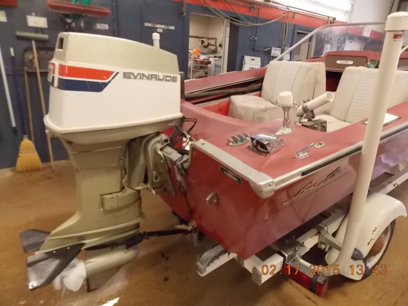

VERY NICE ! A quick question if you don't mind ? A friend gave me a set of those planing fins for my motor and I'm wondering about placement. Yours are as far back as they can go so is that what I should be aiming for ? My Humber is a little slow to plane even with the homemade trim tabs the original owner built and I recreated so I'm going to use them. Maybe when I get back from the lake. We had so much fun yesterday we are heading for Long Point today. Thanks in advance and have a great day.

Are you talking about the whale tale on the motor? It was there when I acquired the boat, and I did not make any changes or adjustments. Sorry that I can't be of assistance. I am sure that someone else on the site will give you some suggestions.

That's okay, if it works for you for you it's darn sure good enough for me. They are going on tonight ! We got another morning out in the Humber today but Lake Erie was flexing it's muscles. The swells were 5 feet coming into the river and they were breaking out on the lake so we stayed inshore and played in the marsh. My little 14 footer only draws about 14 inches so it's a great little skipping stone. We love it and we are happy as all get out to be back in the life. We've both got a pretty good sunburn today tho. That'll learn us. Thanks for replying anyway and have a great day !

Here's hoping that your guy new his stuff because I copied him as best I could. Now I have trim tabs and planing tabs ! SeaMaster Series II G2 tabs give you WIIIINGS ! We'll find out tomorrow. Have a great night. P.S. those aren't finished pictures, my camera died so I'll get some tomorrow.
Damn the torpedoes, full steam ahead !
Shining up the '68 Mustang 9 years 2 months ago #133421
If you've never had them off, oh my God you need to try the boat without them !! I went about 5 miles this morning on my first run with them before I beached the boat and took them off ! They took away speed, handling, and wave running comfort and I am much happier without them on. Please try it without them and let me know if it's just my boat or if they suck for everyone. I was not impressed at all and regained 5 or 6 mph at WOT without them. Might be worth a try. Have a great day.

I think I have about three different styles sitting on a shelf, removed every one of them and filled the holes.
Shining up the '68 Mustang 9 years 2 months ago #133433
How did you fill the holes in ? I'm not even sure what kind of metal it is. There is NO way those things are ever going back on. Do you want a fourth set for your display ? You are welcome to them. They aren't heavy enough to be an anchor so I can't come up with a single reason to keep them.

I will need to try popping them off and see what happens. Haven't done much with the motor with the exception of tuning it up. If you had such good results I will pull them off and see what the difference in performance is.
Shining up the '68 Mustang 9 years 2 months ago #133443
Firstglassproject wrote: How did you fill the holes in ? I'm not even sure what kind of metal it is. There is NO way those things are ever going back on. Do you want a fourth set for your display ? You are welcome to them. They aren't heavy enough to be an anchor so I can't come up with a single reason to keep them.
You can just bondo the holes and sand them down flush. There's no stress there. Just cosmetic.
