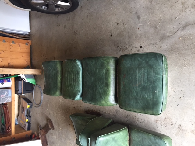

The base of the seats rotted out so I rebuilt them out of cedar, all interior wood that rotted is going to be replaced with cedar...I have stockpile of it and so far this project has only cost me about a hundred bucks so far...

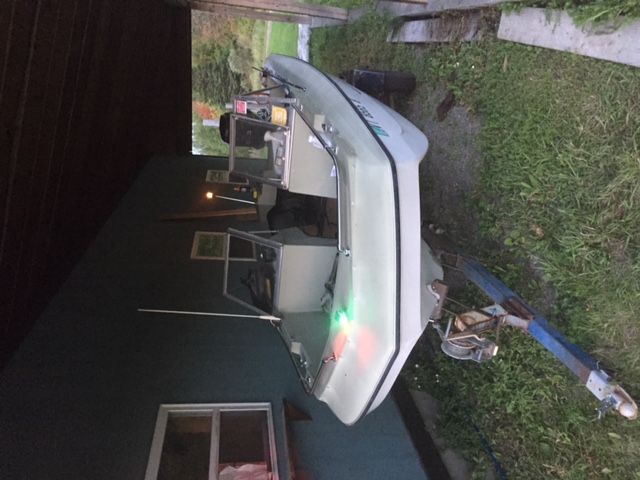

Re:17 Ft MFG Gypsy 10 years 2 months ago #127184
Rebuilt lights up an running...

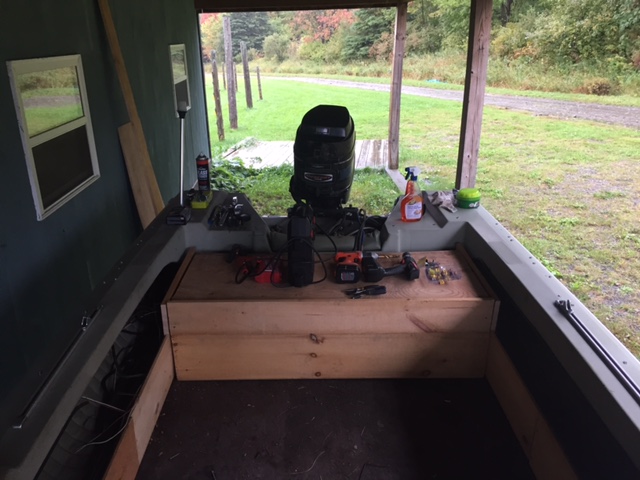

Re:17 Ft MFG Gypsy 10 years 2 months ago #127185
Start the redo of the interior with the box added to the back....

I have laid a 1/4 lightweight water proof sub-floor on top of the existing floor that is in good shape...I wanted a clean smooth surface to lay the carpet in few weeks on...in side the box is going to be thick rubber mat on top of the existing sub floor....as I said I am putting the battery gas tank and hydraulic lift and tilt pump and bilge pump....I am planing on building a live well tank into the top of the box...images of th inside coming together follow....

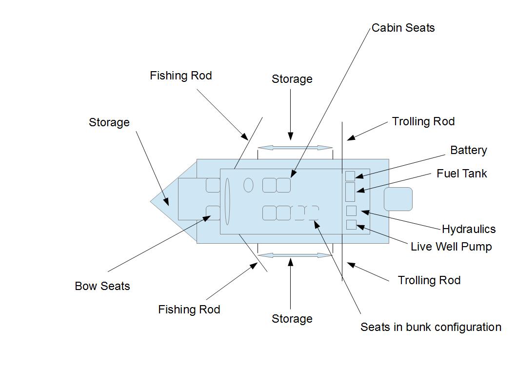

The following diagram (not to scale) is the design I am working to with this project....it's a fishing boat design for northern New England's lakes...

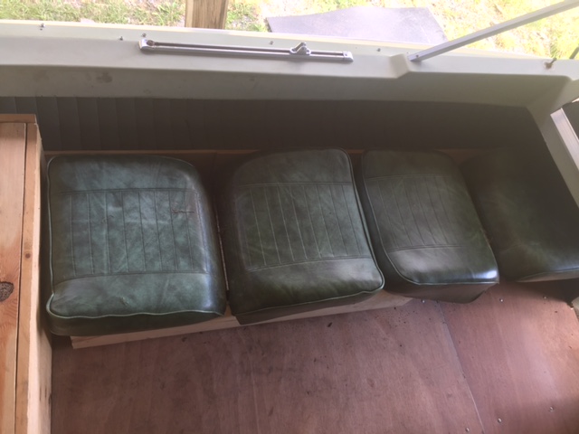

Re:17 Ft MFG Gypsy 10 years 1 month ago #127266

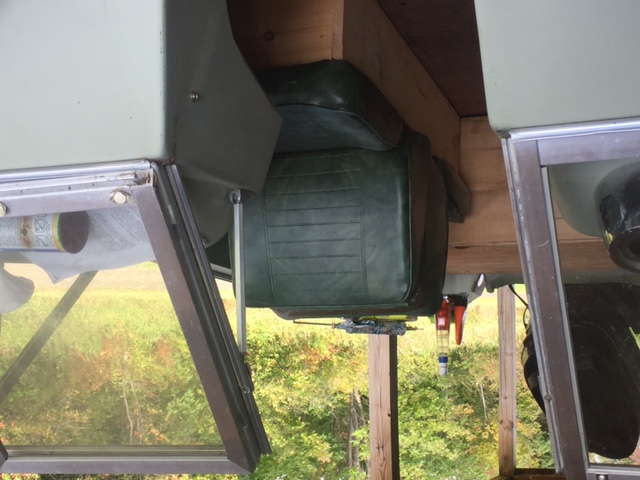

Restored seats in bunk configuration.....

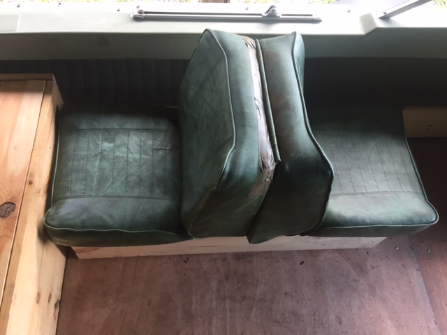

Re:17 Ft MFG Gypsy 10 years 1 month ago #127385
upright seat configuration.....
Re:17 Ft MFG Gypsy 10 years 1 month ago #127386
one more picture of the seating in upright configuration.....

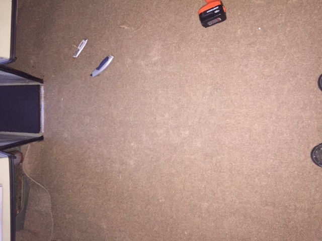

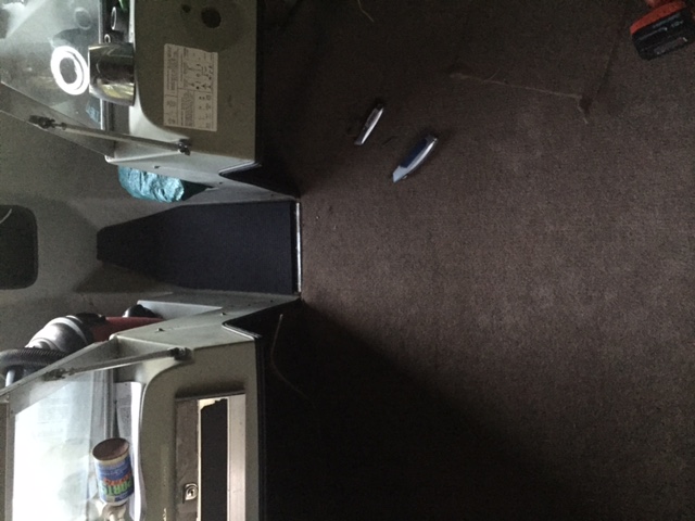

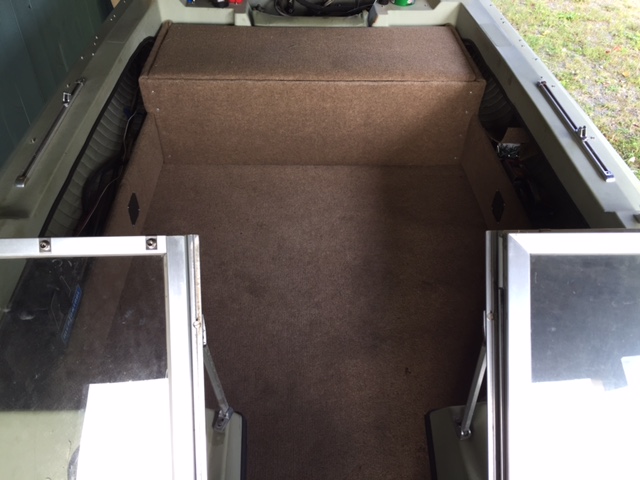

The carpet showed up....I started laying it in the main cabin of the boat before it got dark...a few pictures follow of the installation....
Re:17 Ft MFG Gypsy 10 years 1 month ago #127487
Close up of the carpet..final pictures to follow on Friday.....

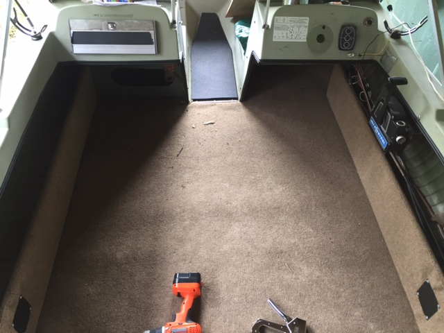

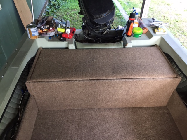

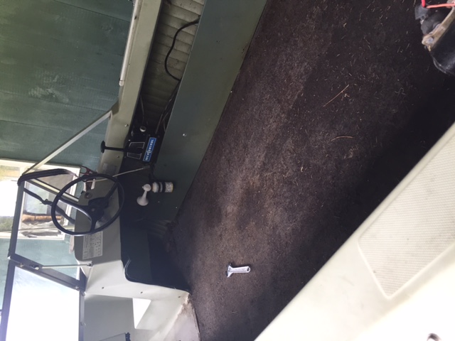

Re:17 Ft MFG Gypsy 10 years 1 month ago #127517
I just finished installing the carpet a few pictures follow...
Re:17 Ft MFG Gypsy 10 years 1 month ago #127518
Another Picture...
Re:17 Ft MFG Gypsy 10 years 1 month ago #127519
Final picture....

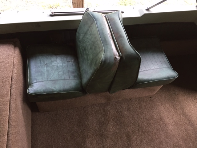

Re:17 Ft MFG Gypsy 10 years 1 month ago #127520
Carpeted the base of one seat set and placed it to see how it looks...the seats are in good shape and I will recover them down the road...
Re:17 Ft MFG Gypsy 10 years 1 month ago #127521
more seat pictures....
