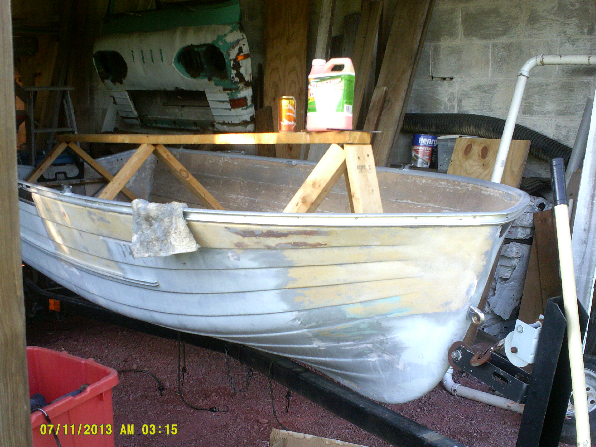

This is going to take a while... I am multi-tasking, because ?
Citri-Strip, from recommendations here on fiberglassics is great for stripping paint off of fiberglass without harming the resin, BUT it works as fast as grass grows ! So, I apply, go do honey-do sh-tuff, then 30 to 45 min. later, scrape some paint ! then re apply... repeat...

If you can use Citrus Strip in the sun and the heat it will work a lot faster and still not harm the FB.

So, does that stripper remove gel coat as well?

Here is the original post about Citri-strip. Apparently is does not affect gel-coat ? Looks like my boat was sanded and painted a few times.

Chuck, that link is not working for me. On the Citrus-strip website, it says it removes epoxy, so I would think it would gel coat too. My '59 needs the gel coat stripped. It's completely wasted!
