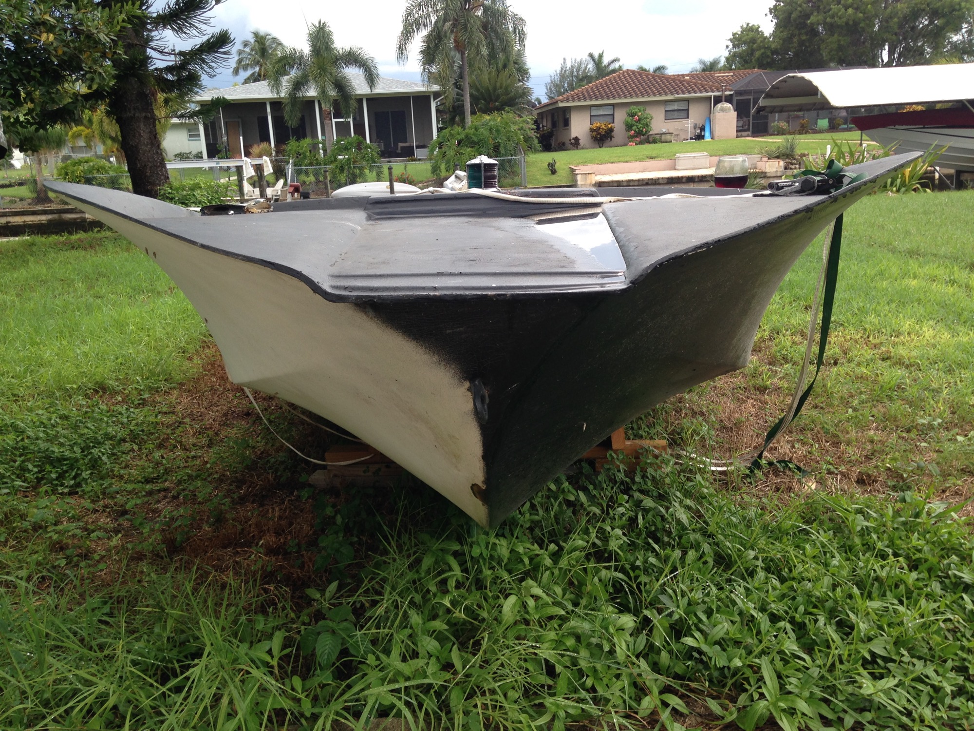

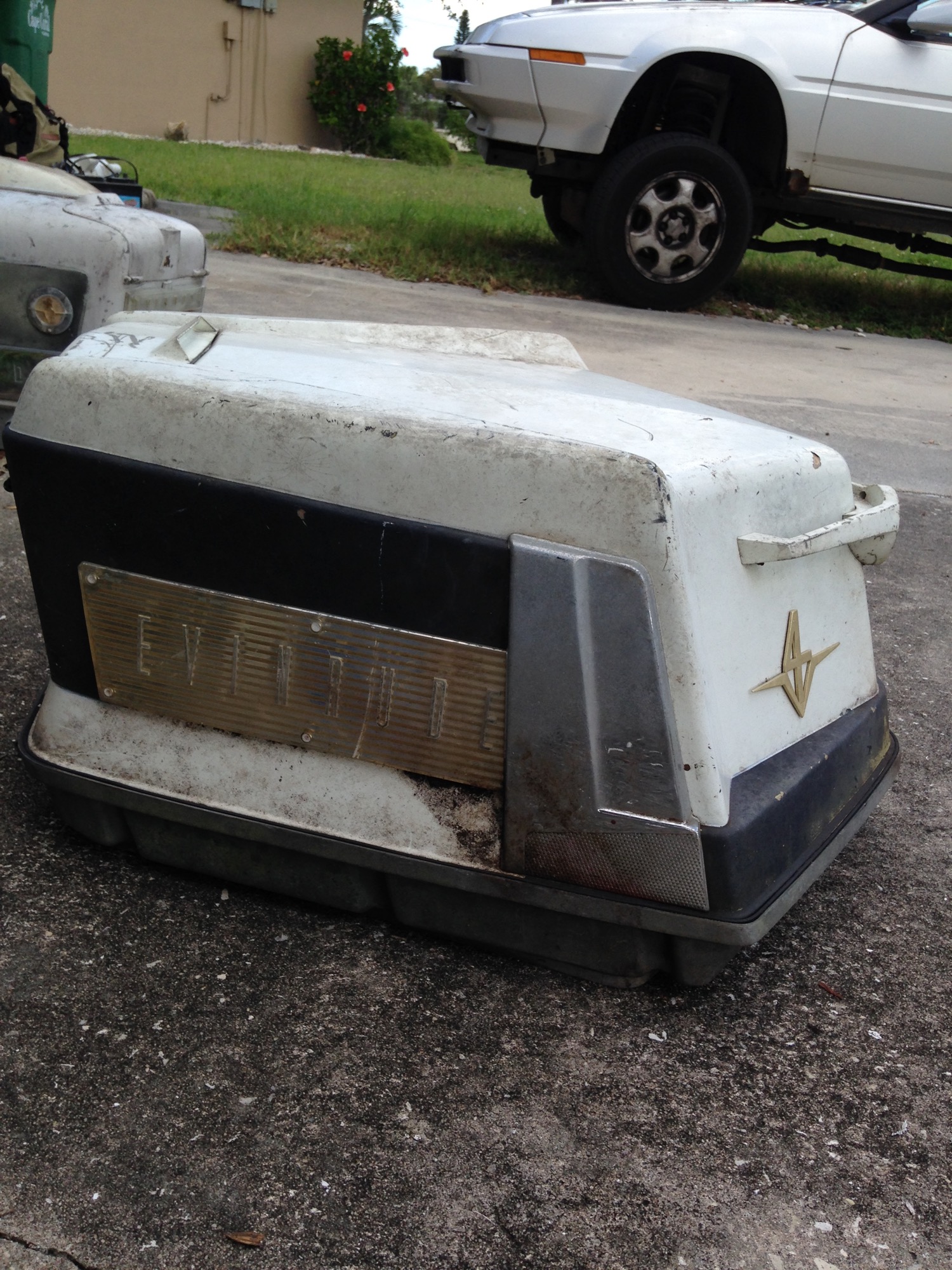

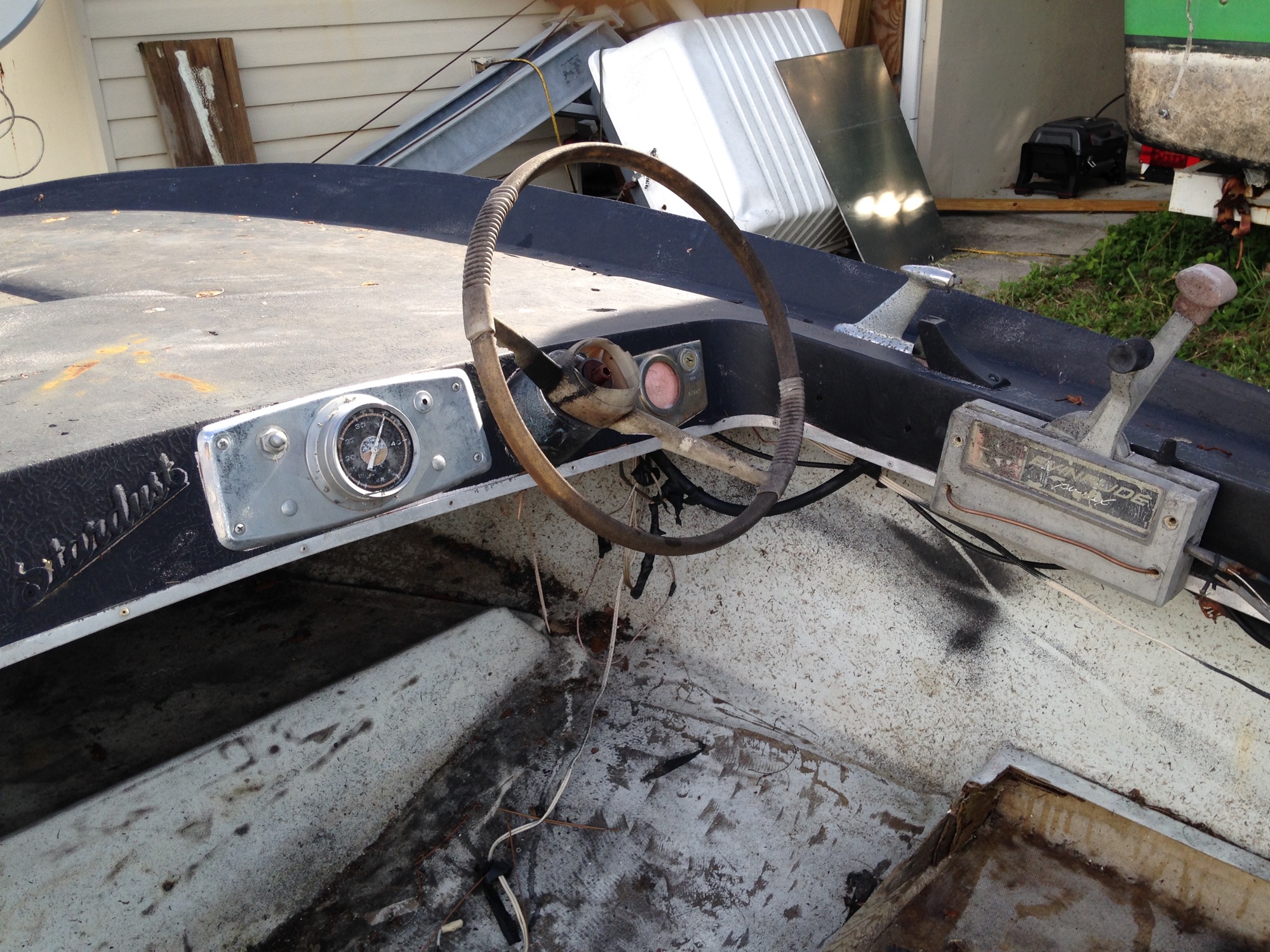

So, I thought I'd graduate from lurker status, now that I've figured out how to post pics, and start a project thread. This is my latest one, saw on craigslist for 250 and got for 200. Basically just the bare fiberglass missing most of the trim, but did come with the original controls. Looks like some kids got ahold of it and tried to remove the pink gelcoat with a grinder. After gouging the deck up thoroughly, they gave up and just painted her flat black... So needless to say, I have my work cut out for me! Just going for a decent restomod though. The crazy thing is, just two weeks prior, I had gone out to buy a retro looking outboard hood for my other old boat from a guy who had a trailer full. He said he was giving it 4 weeks and then the ones he didn't sell were going to the landfill :angry: So I bought a 60 Scott 75 (I think) hood, and a 58 Evinrude 45, and 59 Evinrude 50. Not knowing the boat I was about to buy was originally equipped with one, I just couldn't stand the thought of them being thrown away! Paid 20 apiece for them and just recently sold the 58 for 200... should have bought more but the girlfriend was with me and, y'know :silly: Getting ready to do the floor first and then the transom, even though that actually feels solid. Stay tuned B)

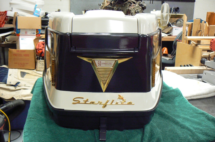

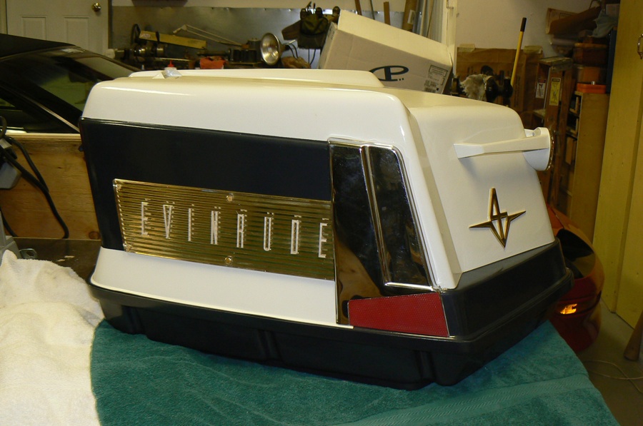

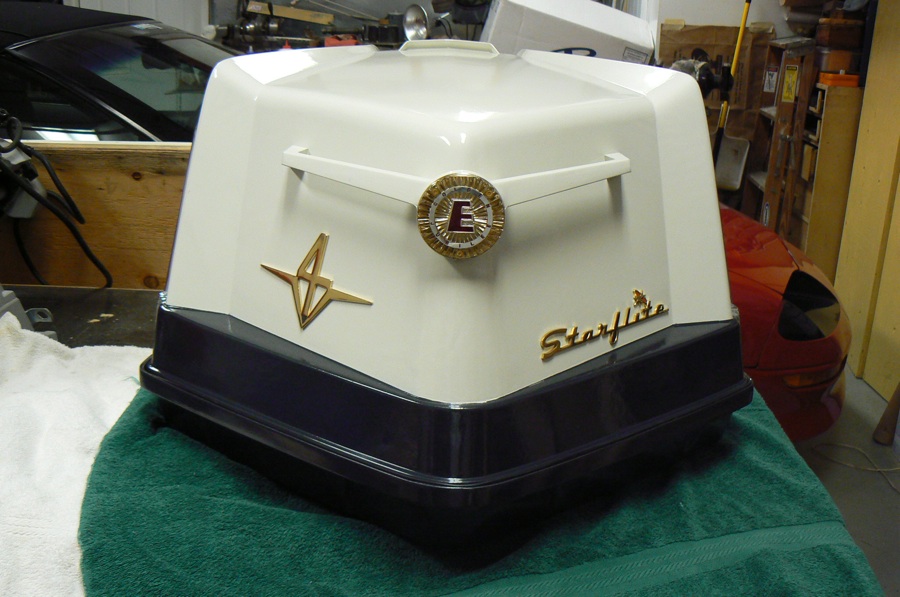

Excellent find!!!!!!!!!! Love that '59 Golden Jubile Fat Fifty cover of course I'm partial.
Re:'59 American Marc Stardust 10 years 2 months ago #126185

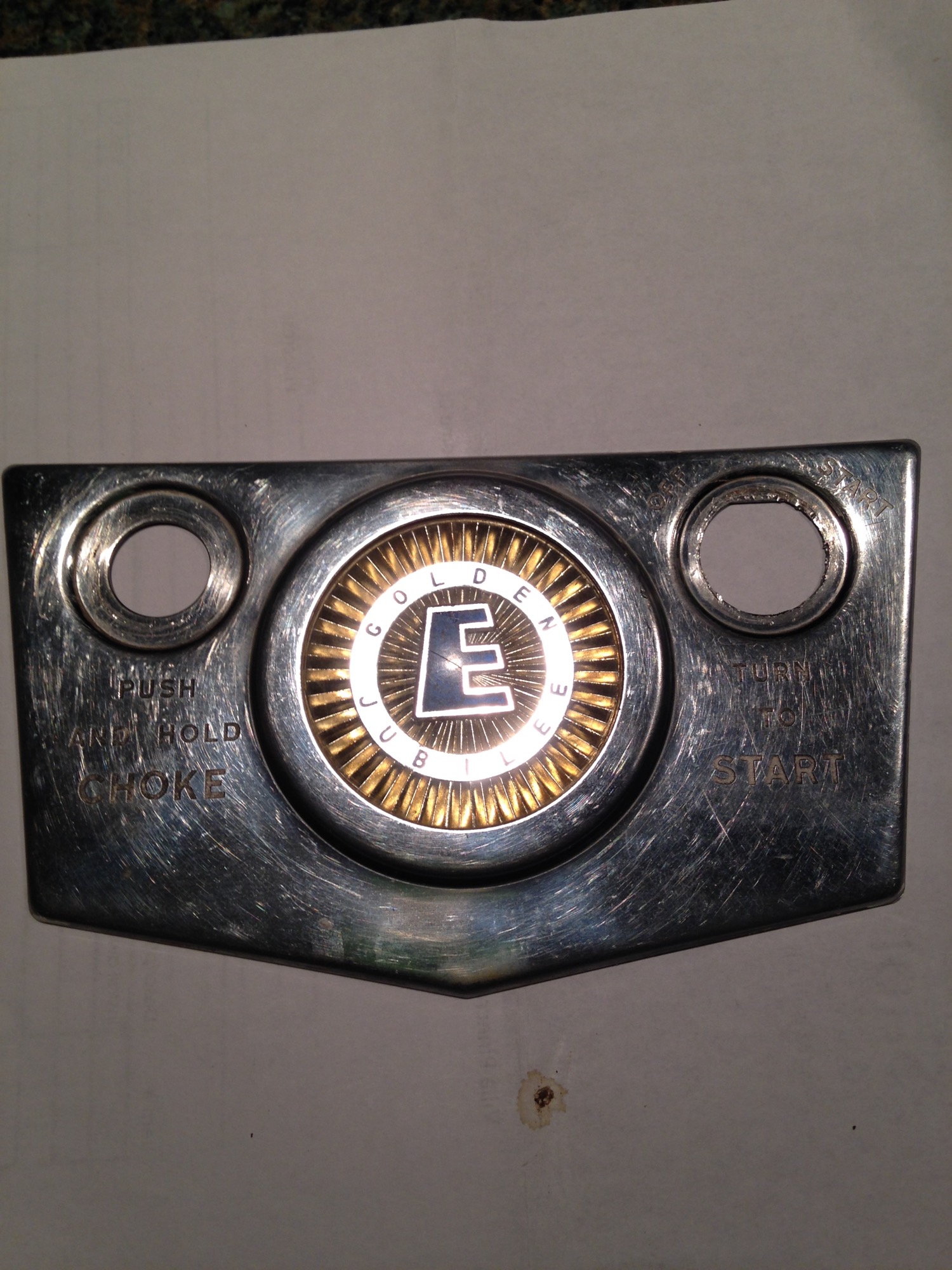

Wow, Waterings yours looks much better than mine! I was able to source a Golden Jubilee medallion off a 40 hood on eBay for half of his asking price for the whole hood... Also picked up a sweet dash panel with a pristine medallion. The original dash panel was ok, but there was just a piece of the medallion left. When I started to initially clean out the boat, I found another fairly big chunk. When I was done, I looked at the trash can for days, knowing the other pieces could be inside somewhere. Then, I finally dumped it out on the driveway and sifted through all the filth. I found 4 more slivers, enough to glue up and have it somewhat complete. 4 weeks later I found the new one...

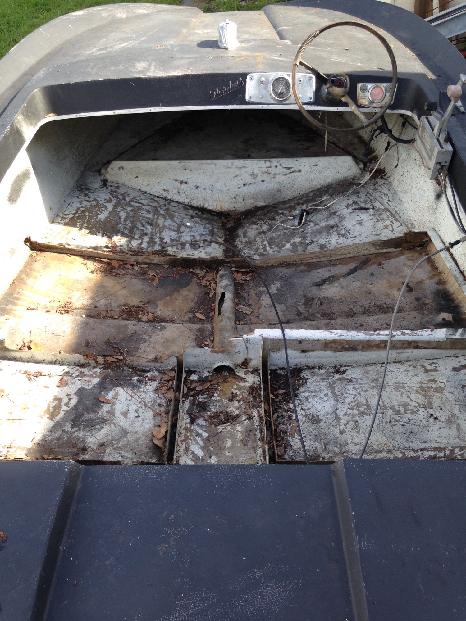

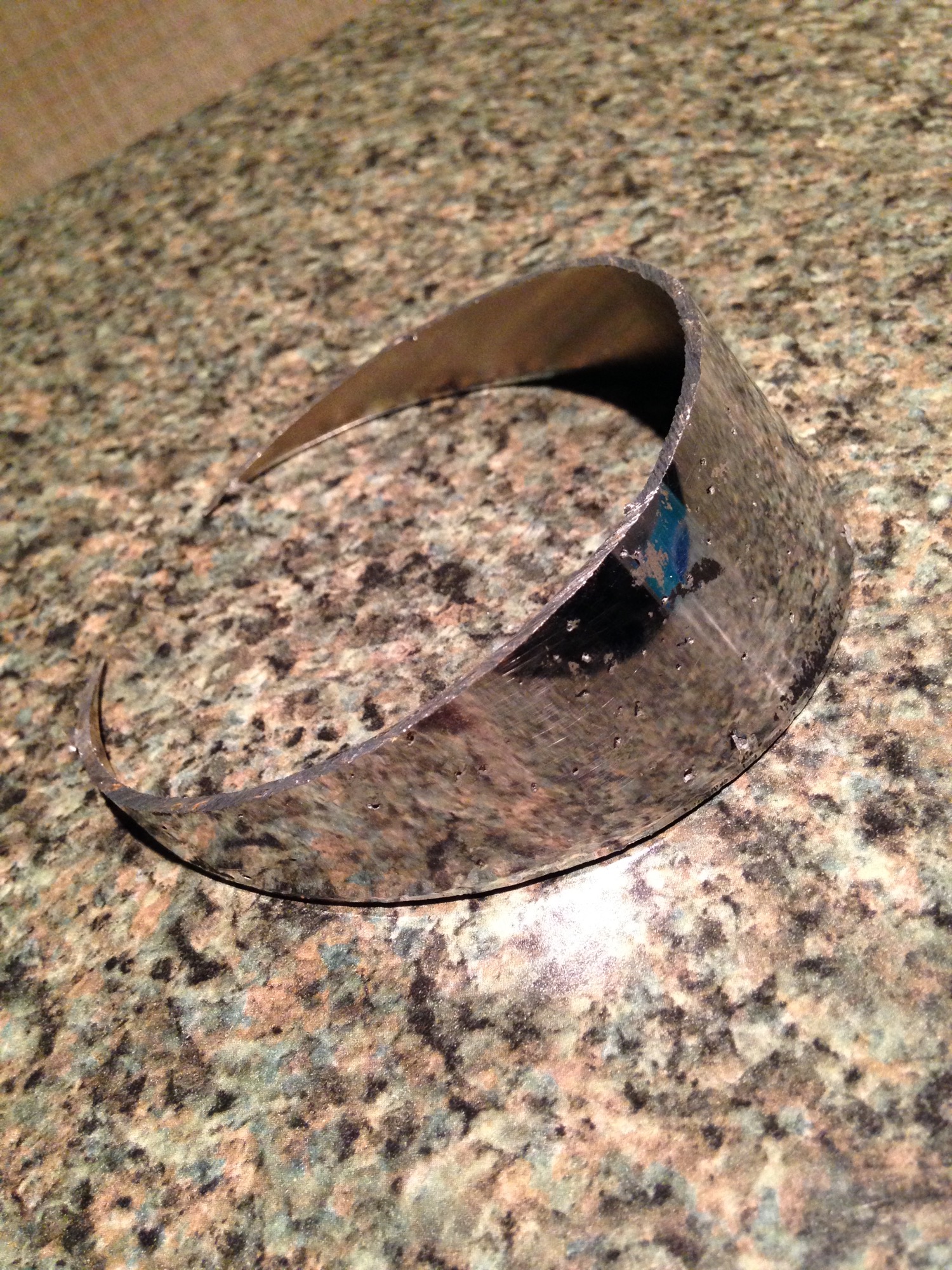

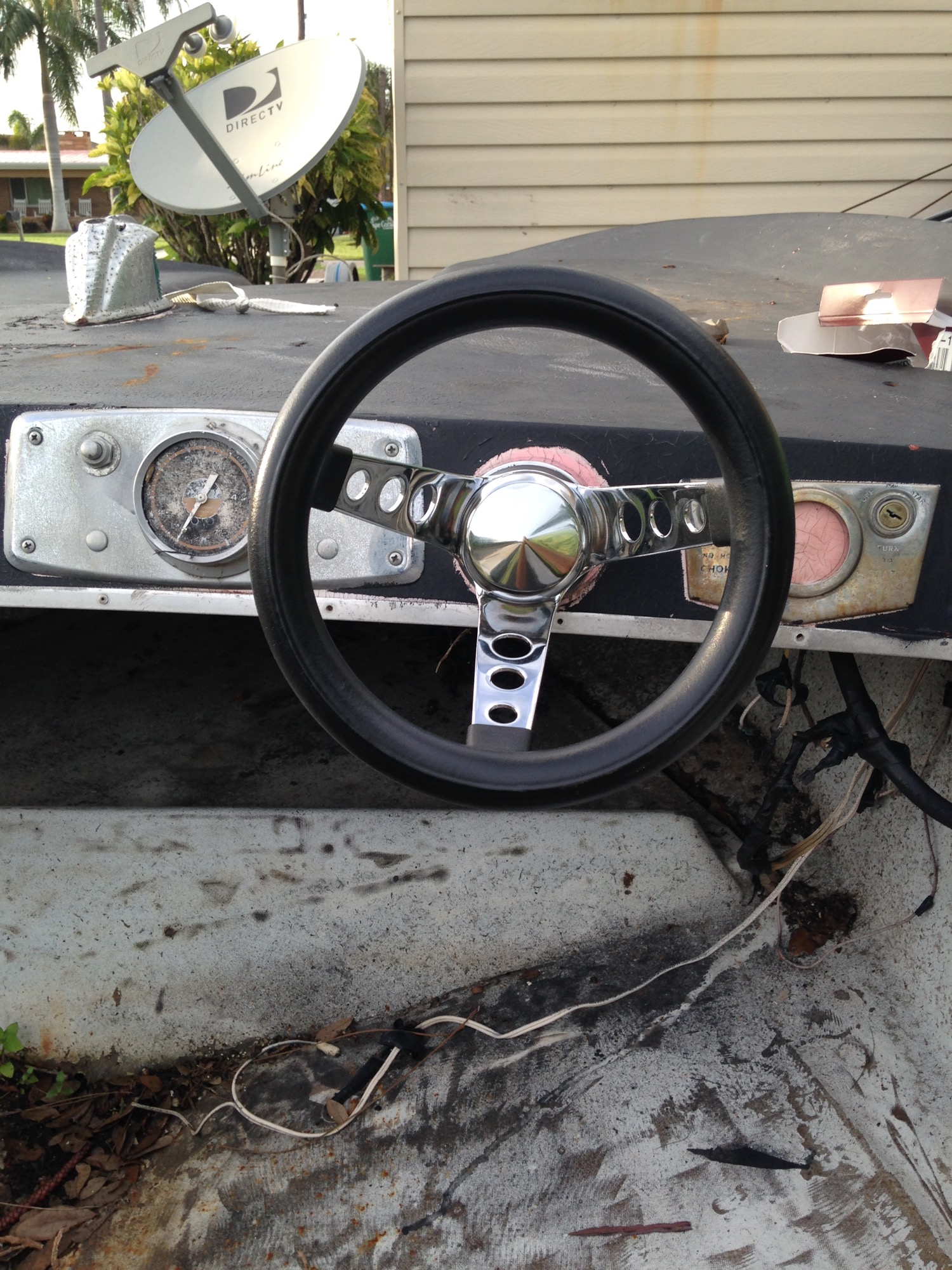

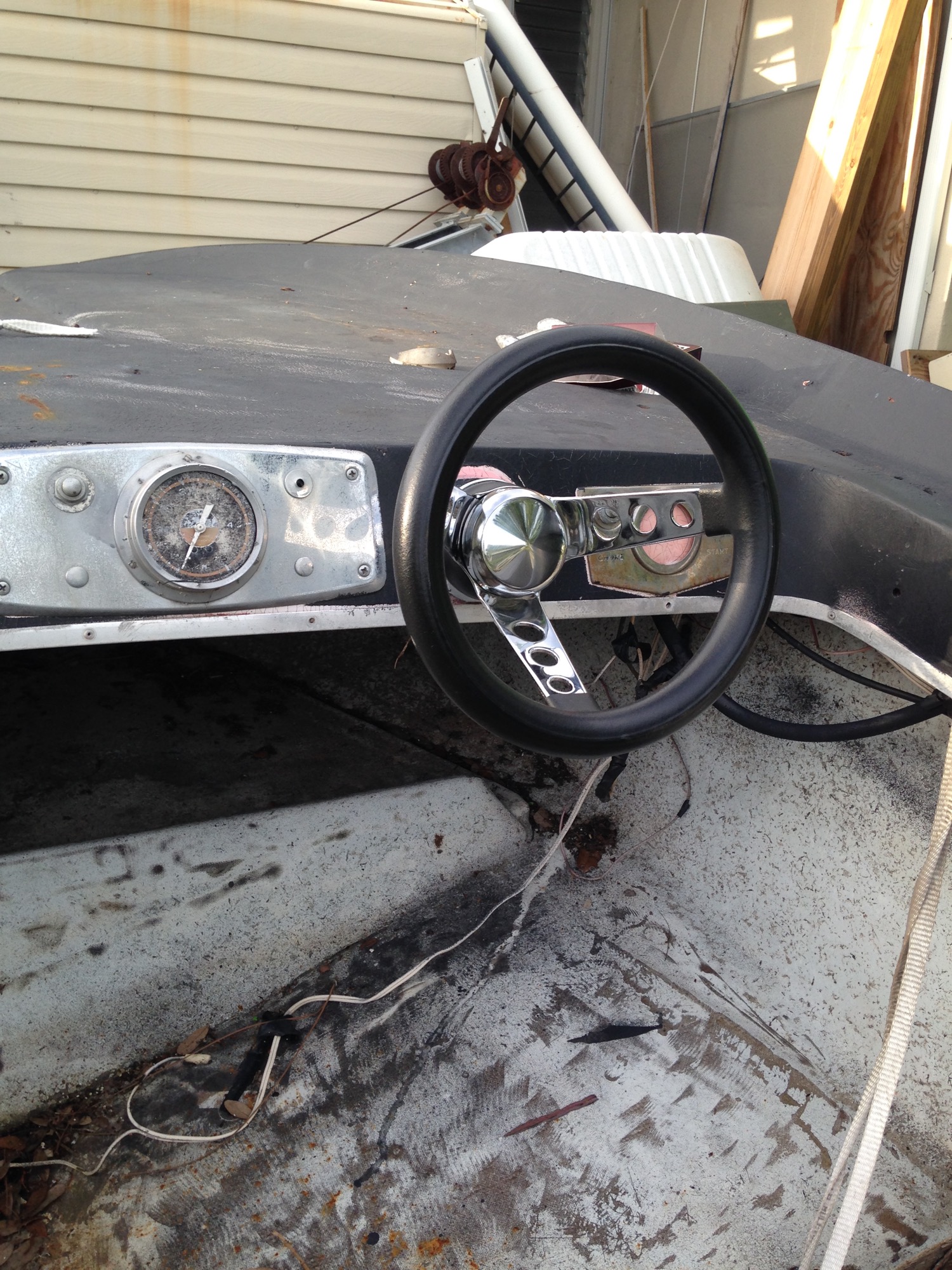

OK, so, first things first. The old wheel has got to go! Ever since I was a kid, I always wanted one of those deep dish, tri-spoke, classic grant wheels. You know the ones everyone said thieves like because you can keep both hands on the wheel while wearing handcuffs? So I ordered one :) I decided to keep the old cable and sheave system because the helm was in good shape and I just feel like staying retro (and cheap) on this. But the helm hub had this angle to it that just made the wheel like, school bus style. So I sliced a chunk out to get it coming straight out of the dash. Much nicer! Check out the original gel coat color... :pinch:

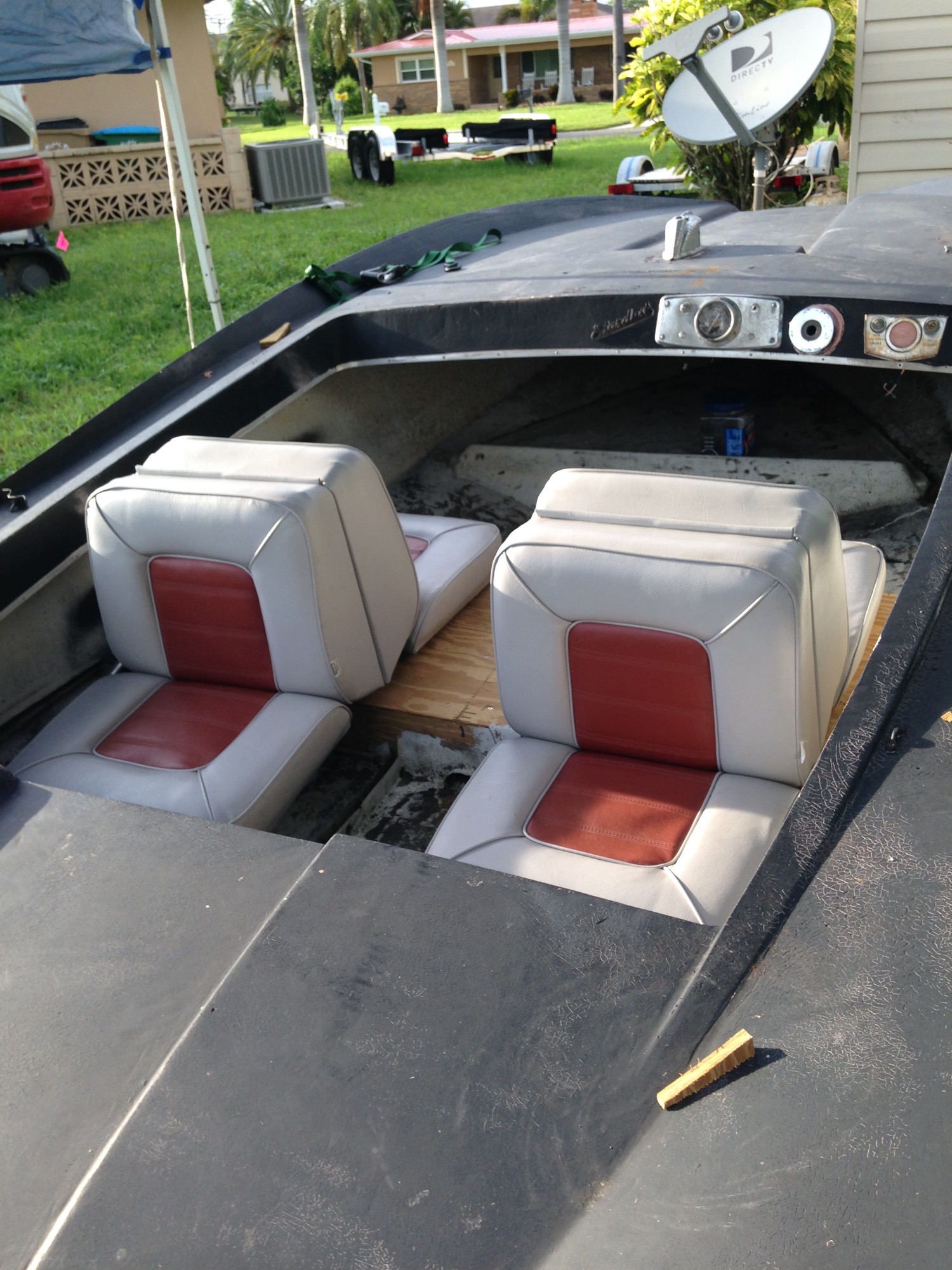

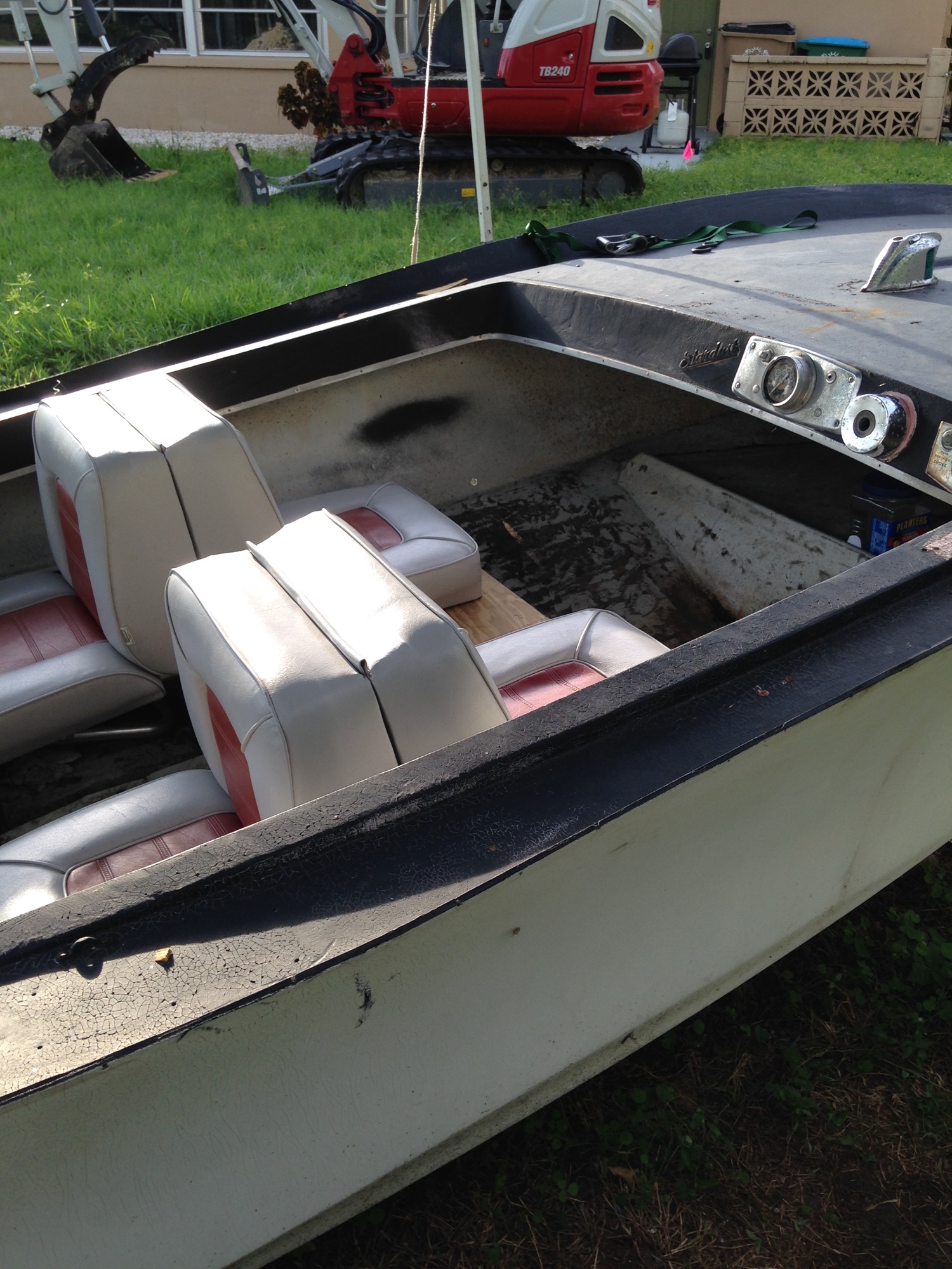

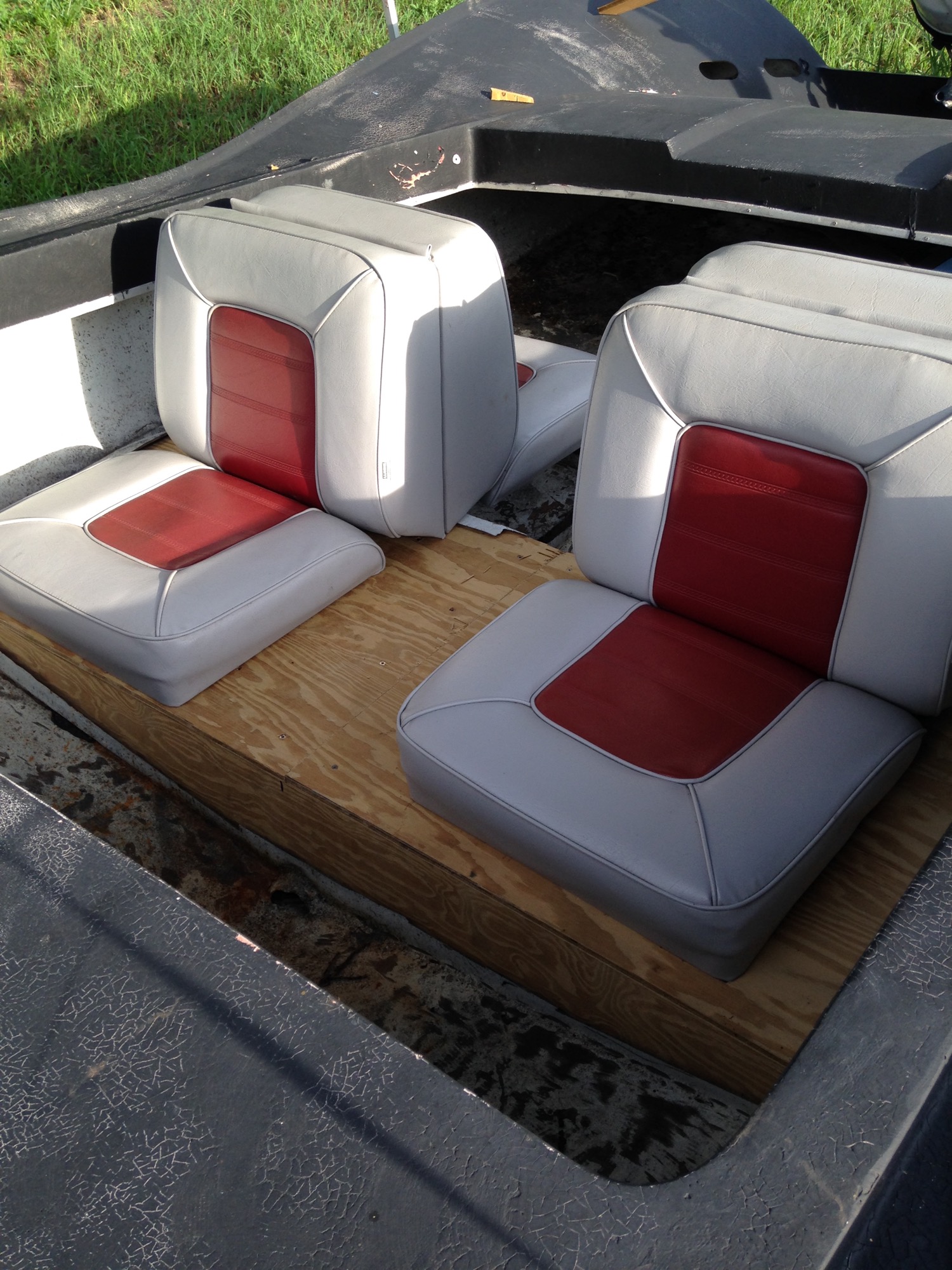

Now on to the floor. Most all of the seat platforms had been cut out already by whoever took the grinder to the deck. So I just needed to clean out a little remaining compost and cut some new plywood to glass back in. Assembled for a test fit and set the seats in to try it out.
Aaaand they sit too high... but that was the style in '59, just like the steering wheel, upright and proper. But I prefer to have it laid back and low. So I'm taking a couple inches off the platform. Floatation foam goes under the platform, so I'll have to make that up somewhere else.

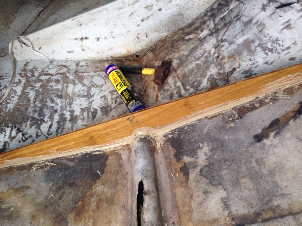

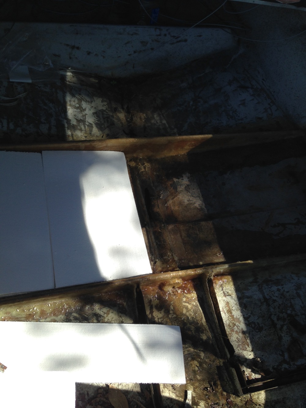

So here are my most essential tools, shorty sledge for taking it apart, and PL for putting it back together!

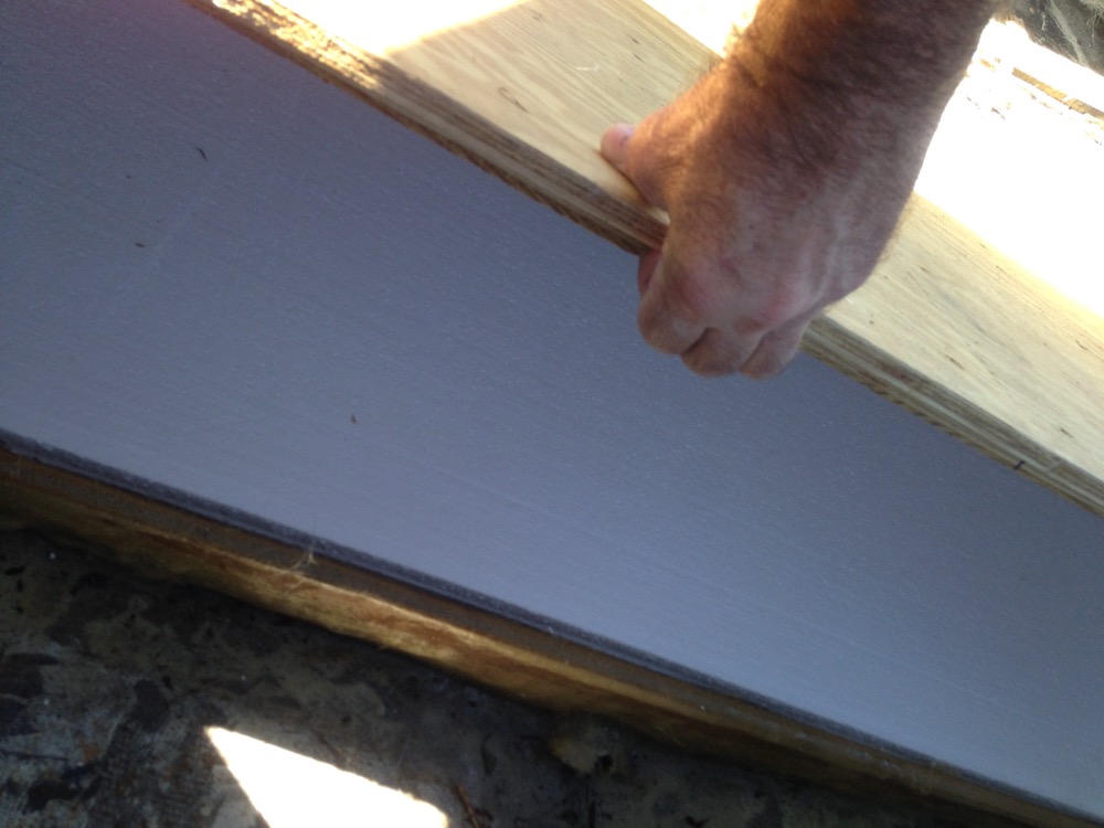

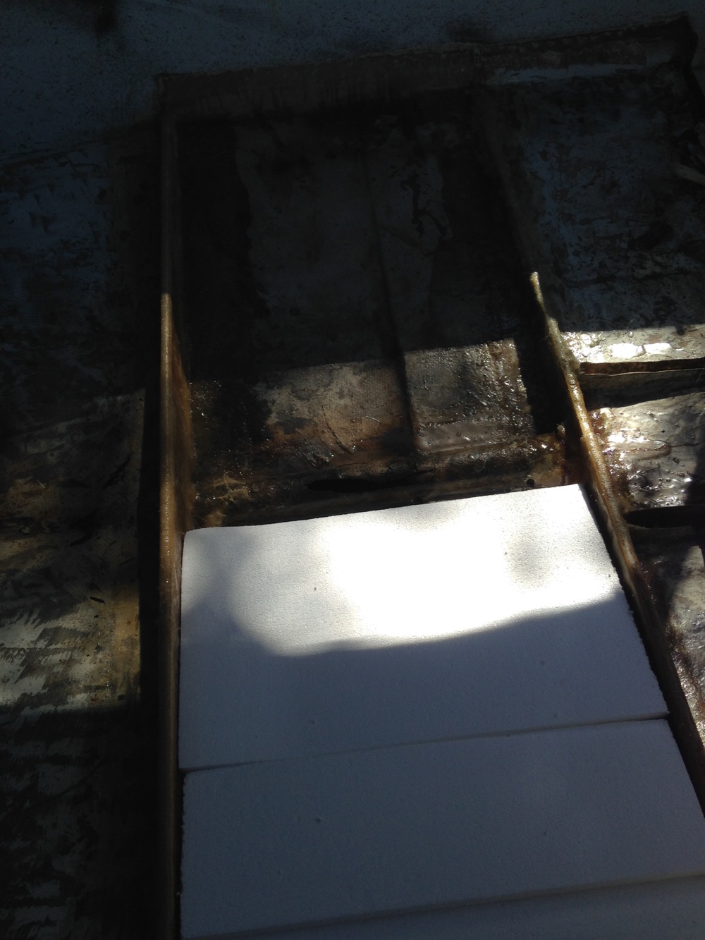

Laying in foam sheets under the seat platform.

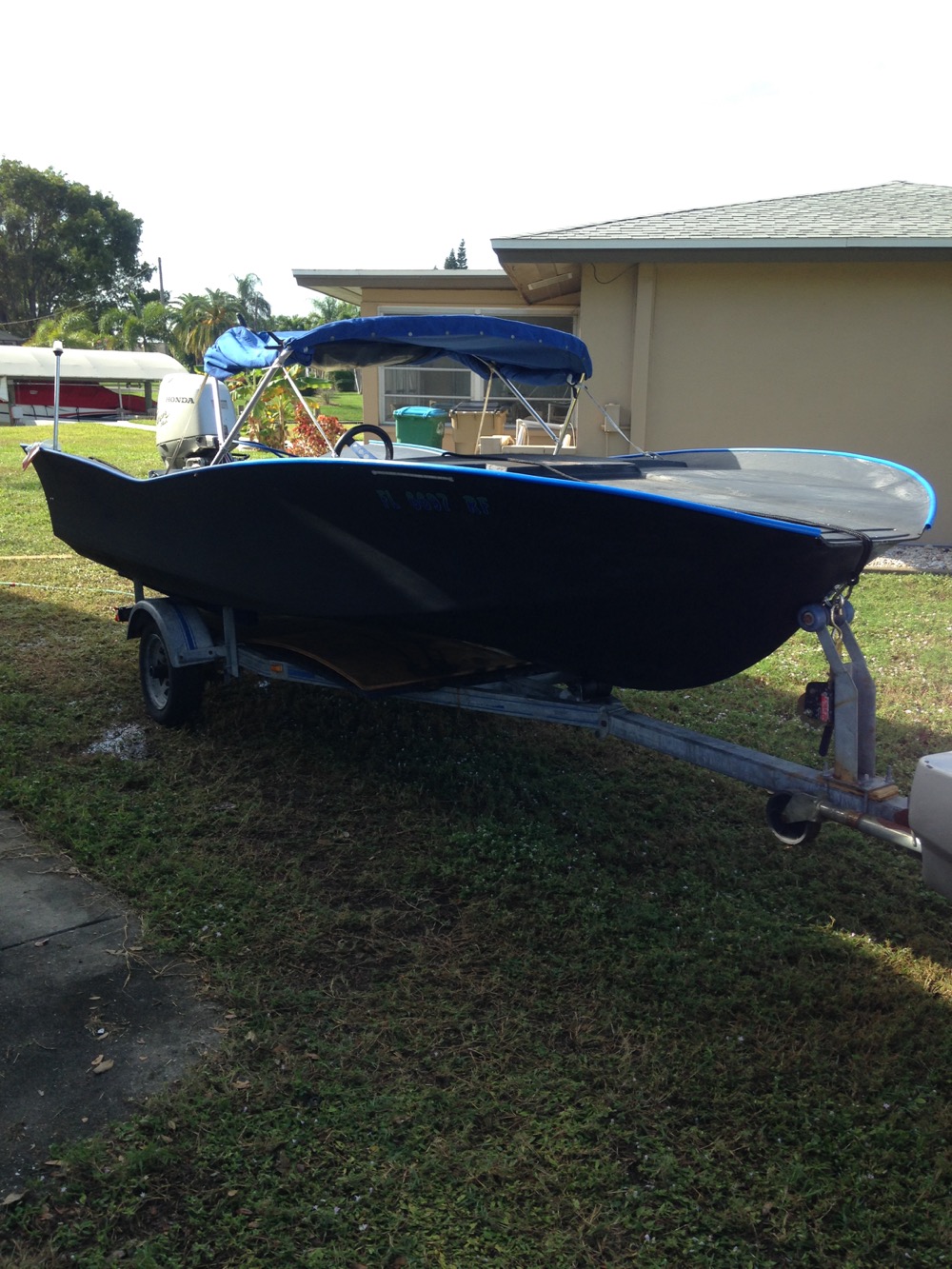

And putting the top on.
I then glassed over the top, but have no pics of that because it looks hideous! Ran out of resin on a hot day, then tried another layer on top, and ran out of resin again!! So I decided some dark blue carpet would be nice anyway ;)
I did drill drain holes at the bottom so WHEN water does get in, it won't saturate the foam.

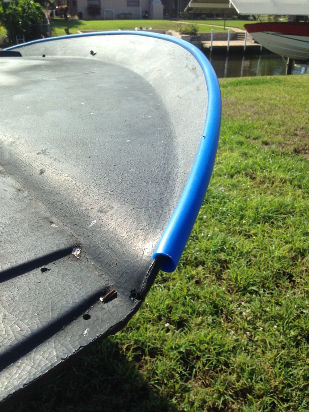

Considered many, many things to replace the missing aluminum perimeter trim. And I'm still planning to visit a metal supplier to look at aluminum channel, BUT, I decided to try slitting a piece of PEX and pushing that on for the time being... and I might just keep it!! It really looks great, it's cheap, and if it gets damaged, big deal, throw on another one. I have yet to use anything to fasten it down, it stays put just from the tension of the tubing.

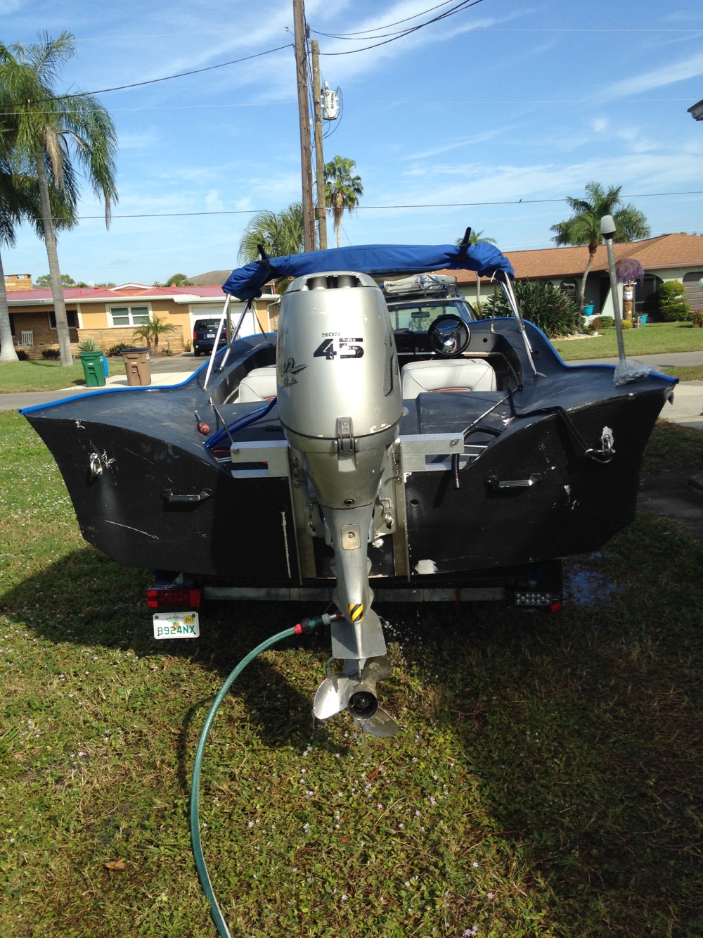

Now, I can't get a short shaft extension housing for the Honda, so I fabbed it up with aluminum angle. And the transom is pretty solid, but there are a couple of soft spots, so I added some struts just in case/peace of mind, till I replace the transom. Just really wanted to see if the 45 was going to be enough power, and it is. Leaps right up on plane and goes plenty fast (for now ;) ).

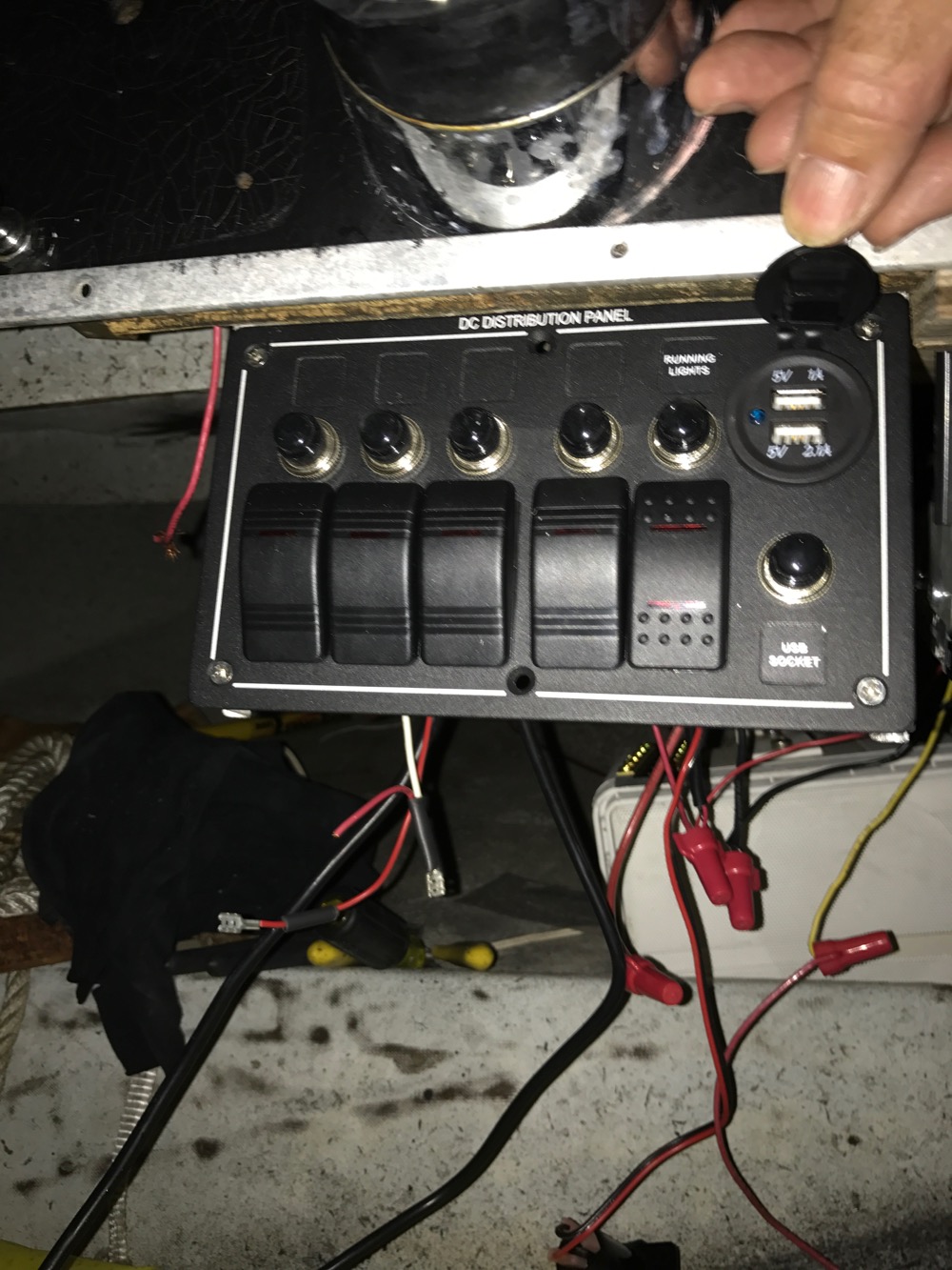

Got the new switch panel in, and cleaned up the electrical. Got rid of all the wire nuts :silly:
