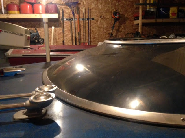

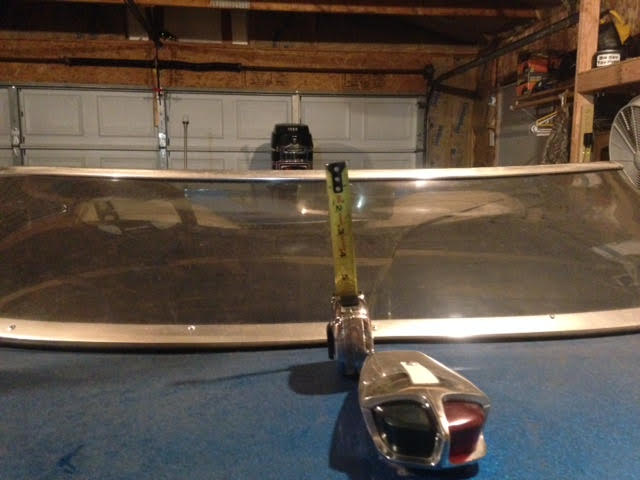

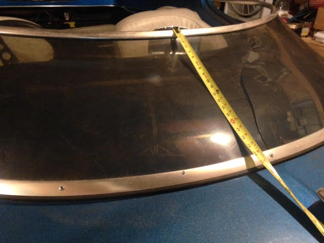

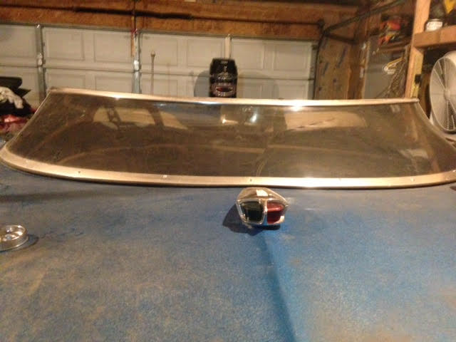

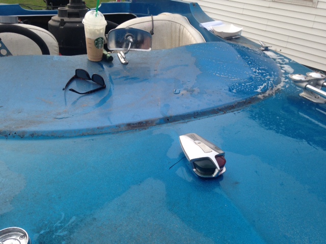

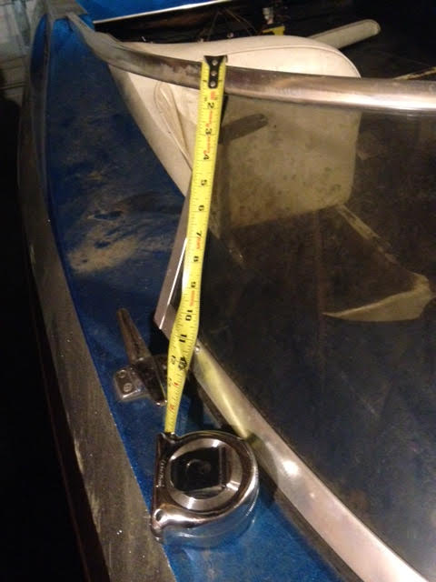

Here are some pics of the Marlin's windshield. Forgot to take pictures when I had it outside. I also did it by myself, so I will need to get better measurements if we find something. Hopefully what I post will give us a start to finding a replacement.

Agree - a nicer motor would help sell it. Don't mean to feed candy, just trying to help with the windshield (since I cannot break my own habit if Craigslist daily to find my motor)...I find lots of other stuff for other people while looking for my motor. I cannot break the habit because I missed 2 motors last year by being one day late on both. I have not seen once since.
A friend had a sidewinder with the 140 I/O merc...but it had a big turbo and huge custom motor cover...on that low boat, it looked huge...boat ran on low 60's with that turbo it was metallic PinkishPurple ...the previous owner named it Purple Haze.

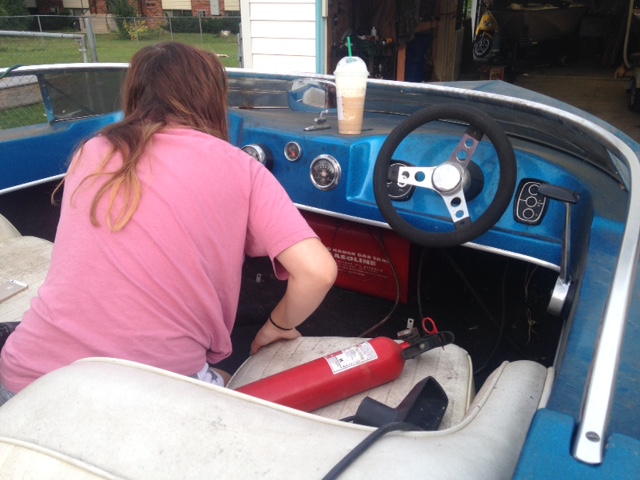

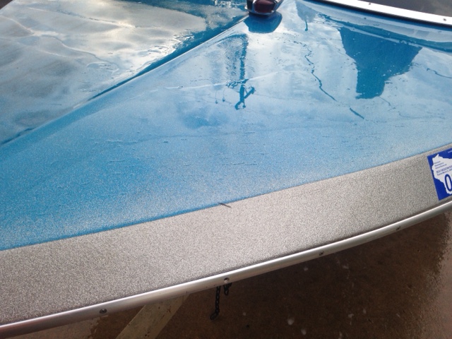

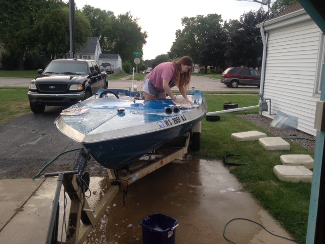

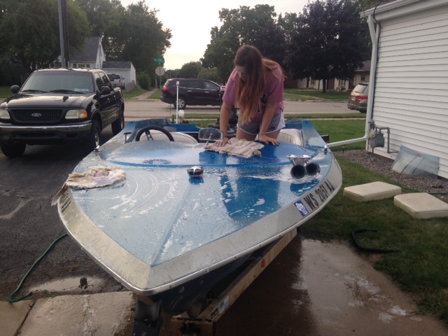

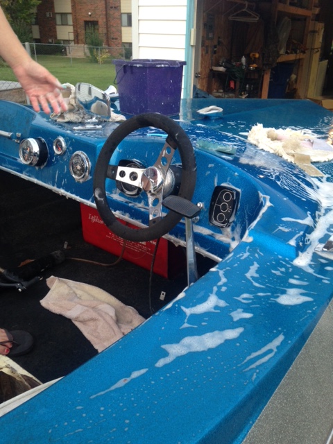

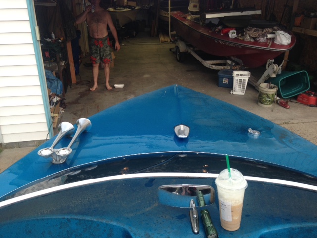

Here are some pics from Fridays clean-up. Everything seems pretty solid, just going to take some elbow grease. Biggest issue is getting the motor cleaned up and T&T working. Biggest cosmetic issue is the broken windshield
Re:1974 Marlin with 1971 Merc 1350 10 years 1 month ago #126359
what a gorgeous color!

Nice shorts you're wearing Mark :laugh:
PBR?
Boat is looking good.
Re:1974 Marlin with 1971 Merc 1350 10 years 1 month ago #126362
  • 63LStriton

UC - Thanks! Once you get the grime off the hull it really sparkles and shines. Can't wait to clean everything up enough so that it is ready for a coat of wax - or three. :laugh: Water just sits flat on it right now. :(
Cal - I figured Meghan would spray me with the hose - and I was right - so I a nice tropical camoflage swimsuit on. I was working on a boat project, so of course it was PBR. I might drink up all of your blue bottles if you don't get over here soon.

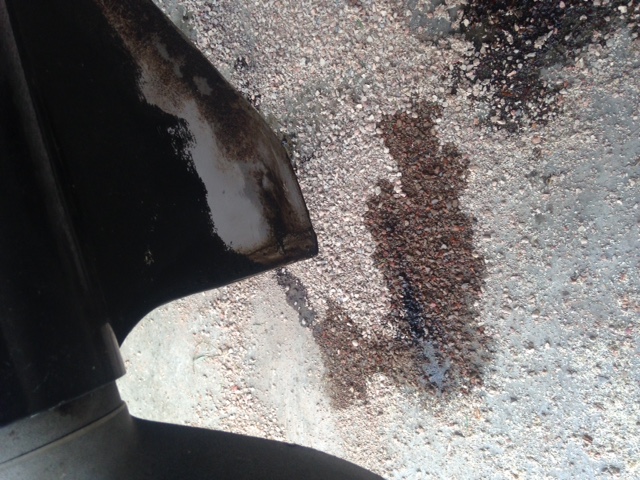

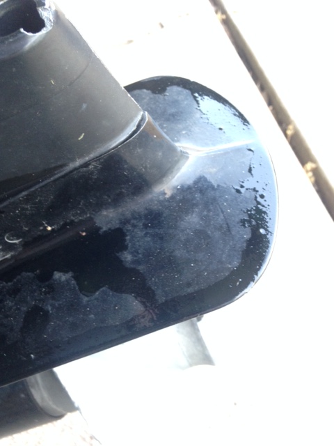

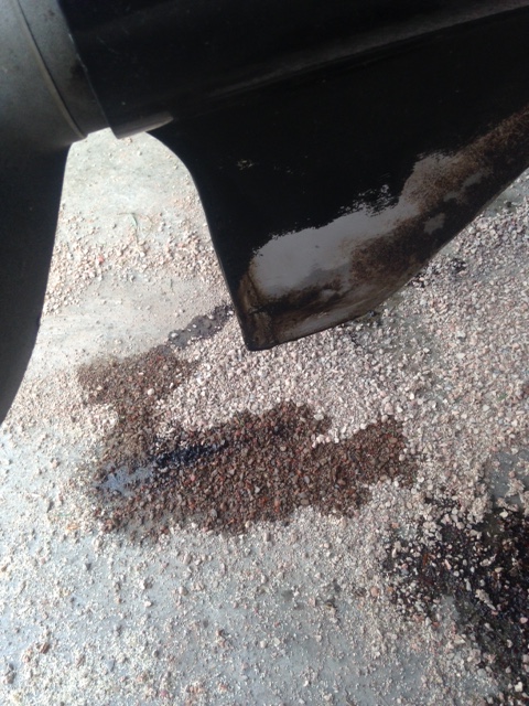

Probably a good thing, because I just went home for lunch and noticed this:
I had already had the oil dry down to pick up the puddle of fluid that came from the T&T. I probably didn't notice this because I thought it was from the T&T. But I put down some addtl oil dry yesterday, and this is a fresh patch on top of it. :angry:
Looks like a leaky lower unit. :angry: Guess now I am going to do that impeller change, and potentially a lot more. I will clean it off and see where it is coming from, but I am going to guess the propshaft area. If you look close you can see the line of drips coming down the back of the skeg.
Re:1974 Marlin with 1971 Merc 1350 10 years 1 month ago #126408
Are you sure that wasn't plan B? "Gee, can't do it, having LW problems" :laugh:
Dripping down the back of the skeg might just be unburned fuel? Check for milky oil.
See you tomorrow.

Looks like "snot" from the motor to me. If it doesn't stink of sulfur and smells gassy/oily, it's just discharge from the powerhead. Normal stuff.
Pop the drain plug on the L/U and if it's milky, that's a problem. If the oil is clean, don't worry about it.

Your Marlin is a copy of the Schuster Tahiti Torino. The Siderwinder SS is also a copy along with a number of others. The Hull is a Copy of the Glastron Carlson deep vee back in the days.
The windshield is next to impossible to find intact as no one ever made any aftermarket windshields for these. If you can find one (they are all the same windshield) they run around $500 and up. I would try to put yours back in the frame and maybe try one of those laser glue pens.

Cal and Ed - you guys are probably right that I jumped the gun on a LU leak. I looked "upstream" and saw clues that what is dripping is likely coming from the powerhead. When priming, each carb was dripping some fuel out of the front of it and dripping into the catch pan in the bottom of the cowl. I imagine that is what I am seeing hit the floor.
I will clean it up a little tonight and degrease the lower unit. That will give me a good clue if and where any future leaks are coming from. I will also hook up my compressor and try blowing open the telltale. I will probably want to replace the impeller anyway, but that will give me an idea of whats going on.

Karsten - All we have hit the boat with so far is a little Mr Clean / Dawn misture to get off the dirt and grime. We didn't graduate to wet sanding the trouble spots and then getting out the buffing compounds and waxes. I have a feeling that it will really take a shine.

Mark, if absolutely nothing works on your lights it is more than likely the ground connection. Don't trust the trailer frame to be a ground. I usually run the white (ground) wire to each light. A little more effort but will not fail if there is rust on the trailer.
Re:1974 Marlin with 1971 Merc 1350 10 years 1 month ago #126480
  • 63LStriton
  • 63LStriton's Avatar Topic Author
  • Posts: 500
  • Karma: 2
I'll give it a shot Marty. Only problem is one side is working and the other is not. There are grounds running to each light. I think there is a break in the yellow wire that I did not see
And yes - I did check the bulb!!!!! :angry:
