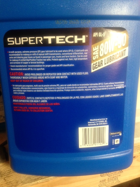

Ed - Picked up some lube at Wally World. $12 something a gallon, I will post a pic to make sure I am on the same page with you.

That's regular-old automotive gear oil, which will work in a pinch. If your lower unit has water in it already, not a good idea to use this stuff as it doesn't have the corrosion-inhibitors that Hi-Vis marine gear oil has.
I'm surprised you couldn't find any at Wally's. In my store they have a small boating supplies section next to sporting goods. In the Superstore about 10 miles down the road, all the oils are over in a different section in automotive. Some of the seasonal stuff they stop stocking earlier than you'd think, so guess what, it's already Halloween at Walmart and soon it'll be Thanksgiving!!
No issues if you're just using that gear oil for a run or two, I'd just check the oil after a couple of runs and make sure it's not getting milky. Any gearcases that show water in the oil should be drained & refilled before laying up for the winter, even if you don't get to the re-seal job until next year. The milky oil sitting in the L/U all winter will promote corrosion. Better to sit with clean oil.

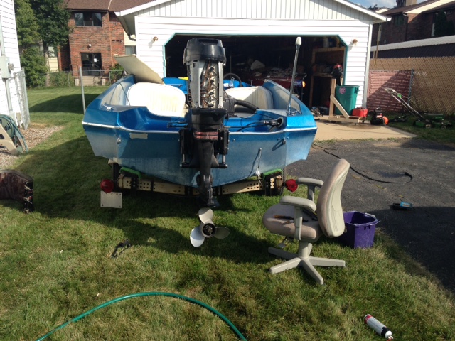

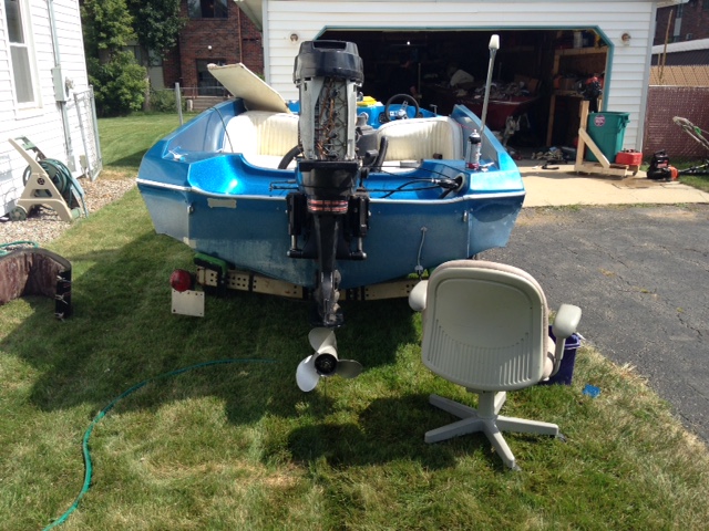

Ok - spent some time working on the 1350 tonight. The old impeller came right off with no problem. Getting the new one installed was a minor headache, but I think that job is done and ready for re-install.
There came problem #1 - with the T&T not functioning right, I quickly determined that aligned and putting the LU back on was not a one man job. Tried a floor jack and a ratchet strap, but no joy. The jack just tilted the motor up, and the ratchet strap didn't have enough oomph. Gave up and punted - sent a text to my buddy the mechanic to see if I can swing by his shop on the way up to sea trials tomorrow night. I am thinking that with two of us messing with the problem we should make short work of the reinstall. I figured that while I couldn't put back on the LU, at least I could change the oil....
Which brings up problem #2. Got the LU sitting on the drain pan with the driveshaft in the vice holding it upright. Took off the vent, and then took off the fill plug. Dry as a bone!!!!!! :angry: :ohmy: :angry: Less than pleased, but what can you expect. Filled it up to the top with new oil and will cross my fingers this weekend during sea trials. I will need to change out the oil after sea trials as I am sure that it will be dirty.
Started looking at pulling the carbs, but after #1 & #2 I was a little discouraged and didn't want to push my luck. Guess I will bring a can of starting fluid and a couple cans of carb cleaner this weekend. I will try pushing my luck with just fresh gas and some sea foam. Hopefully everything holds up!!!
Re:1974 Marlin with 1971 Merc 1350 10 years 2 months ago #126735

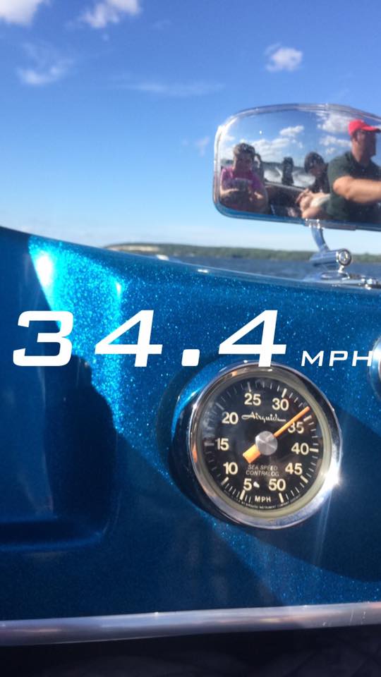

Kerry - speedo has issues, but I wasn't pushing it too hard. There are some issues with the throttle linkage on the motor being set to WOT, and the throttle cable sticks and is hard to get open.

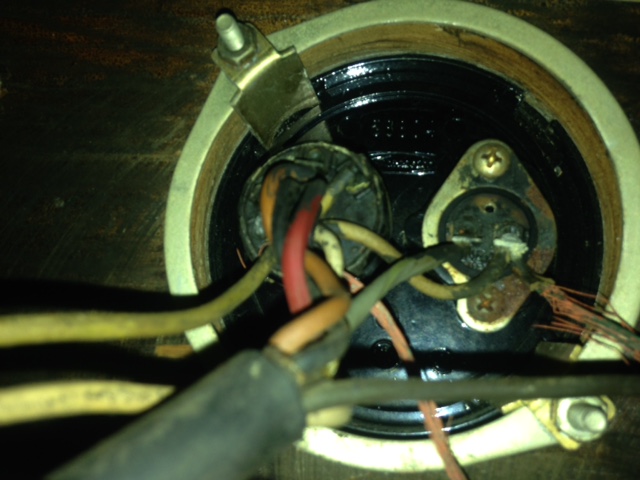

Spent the last 2 nights spending some time taking apart the control box and lubing up the control cables. It was incredibly stiff and I was concerned that something was either going to break or I wouldn't be able to cut throttle when I needed to.
Took everything apart in the control box and cleaned of the 40+ year old grease that was acting like rubber cement. Replaced it with fresh grease and cleaned and lubed the throttle line that was all gunked up. Working much better now!! Should be able to hit WOT this weekend!!!

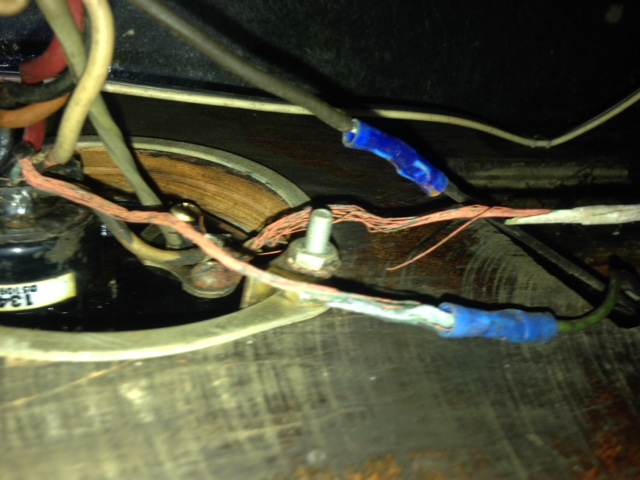

Also took a few pictures of the wiring behind the dash. They are posted below, and I have made a few comments
Bottom green wire goes to the tach, and looks like it is hooked to the switch for power. The other frayed wire is for the gas gauge - which does work - but that is hooked to the choke switch. Does it matter which one it is hooked up to, or can I hook both to the same source?
Re:1974 Marlin with 1971 Merc 1350 10 years 2 months ago #126884
  • ed-mc
  • Posts: 1482
  • Karma: 235
  • Thank you received: 131
Dem's some nasty looking wires! I expect things might work better once they're replaced.
Re:1974 Marlin with 1971 Merc 1350 10 years 1 month ago #126886
Mark, looks fairly normal for the age of the boat. Good thing you carry a fire extinguisher with you right??
Love the picture of your son with the stone quarry in the background. Lived on the bay shore drive until '63.
SOP for me with any boat is to completely replace all the wiring under the dash. Most of them have been Jerry rigged so bad you need a program to tell the players. It's always easier to put in a small fuse/distribution panel to make things easier.

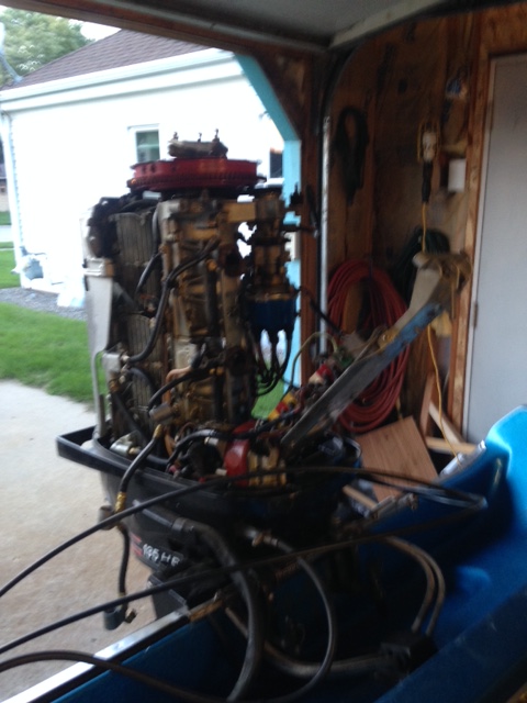

Ok - thought that I should take the advice and I spent some time taking off the carbs on the 1350 and cleaning them. I say a little time, because it was 5+ hours!!!! What a gigantic PITA!!!!
However, got them off, got them cleaned, and put them back on. Not exactly an easy task if you don't pay attention to the order that things came off. Finally got them on and was just finishing up putting the top on the bottom carb. Tightening it down, and it just kept going until pop!!! - it broke!! :angry: :angry: :angry: :angry:
Luckily a wise man, Ed, had turned me onto a dual carb from a 65 hp when I needed a part for the 110 I was working on. Went right back to that well and grabbed the part I needed. Put everything back together and it seems like it is holding everything together. Part numbers looked to be the same, but the gurus can tell me if I am asking for trouble. Seemed to be the same part
As it was, only the bottom carb was a little dirty in the bowl. Everything else seemed fine. Hope it ends up being worth the time!!!

Got the Marlin up to the cottage and hooked it up to the hose. To my surprise, it started up right away and idled like a champ!!! I needed to back off the idle somewhat as it was spinning a little too fast. I am going to drop it in the water tomorrow morning for a final tuning at idle in gear. Once that is done, then it's time for ludicrous speed!! Probably not, but it should run a lot better based on how it sprang to life

Sea Trials II went fairly well, found some more issues but making progress overall. Still need to tweak the mixture on the carbs as it is still idling rough and dying when idling in gear. I messed around with tuning it in the water and thought I had it good, and then no hole shot. Made it richer and then we had a hole shot but still had idling issues. Idle still seems to be set a little high as it is clunking when going into gear, but otherwise it is snubbing out. Even with the issues, we were able to have a great time on the water and I even got Meghan skiing!!
www.youtube.com/attribution_link?a=FkQMbkMpgEM&u=/watch%3Fv%3DjoA-m55V2R0%26feature%3Dem-upload_owner

3 - Speaking about cable adjustments - while I was adjusting the throttle cable this weekend I snapped the cam bracket that holds the cables at the motor. :ohmy: :angry: Quick zip tie fix, but I should probably try to fix it to original.
4 - This was the first time that I had it in the water with a proper drain plug for an extended period of time. It was a leak somewhere as I was taking on water. The drain hole itself looks like a mass of silicon, so that could be the culprit, although I did see a fairly serious case of keel rub. Probably a fairly quick fix, but that probably is having an issue with my top end speed!!
5 - I took a swing at fixing the wiring on the tach and gas gauge. Now neither are working!!! :angry: :angry: :angry: Not really a surprise as the tach was not working and I did not reconnect the line to the gas gauge as it was originally soldered on. Might need to take Cal's advice and just install a panel and wire everything to there. At least I will know what I am working with.
6 - Figured out the issue with the trailer wiring!! It is a problem with the van.... :angry: :angry: Need to take the back of the van apart to look at the module and quick connect. All I can hope is that it is a bad connection or ground, otherwise I have a bad module that needs to be replaced.

On the tach, do you have the rubber tach connector at the Fwd end of your control box? That's the best way to hook up tach wiring, Merc sells a harness that plugs into the box.
I've attached a wiring diagram for your motor, which shows the tach wire colors.
HTH........ed

- The control box is one of the "hidden" versions, and when I took it apart to lube the cables the only thing electrical that I recall was the neutral switch. Thanks for the diagram - I will look for similar one for the control box that I have and see where the tach wiring needs to go. I have one line going to the switch and the other heads in the direction of the control box / motor. Haven't followed that one yet to see where it is hooked up.
