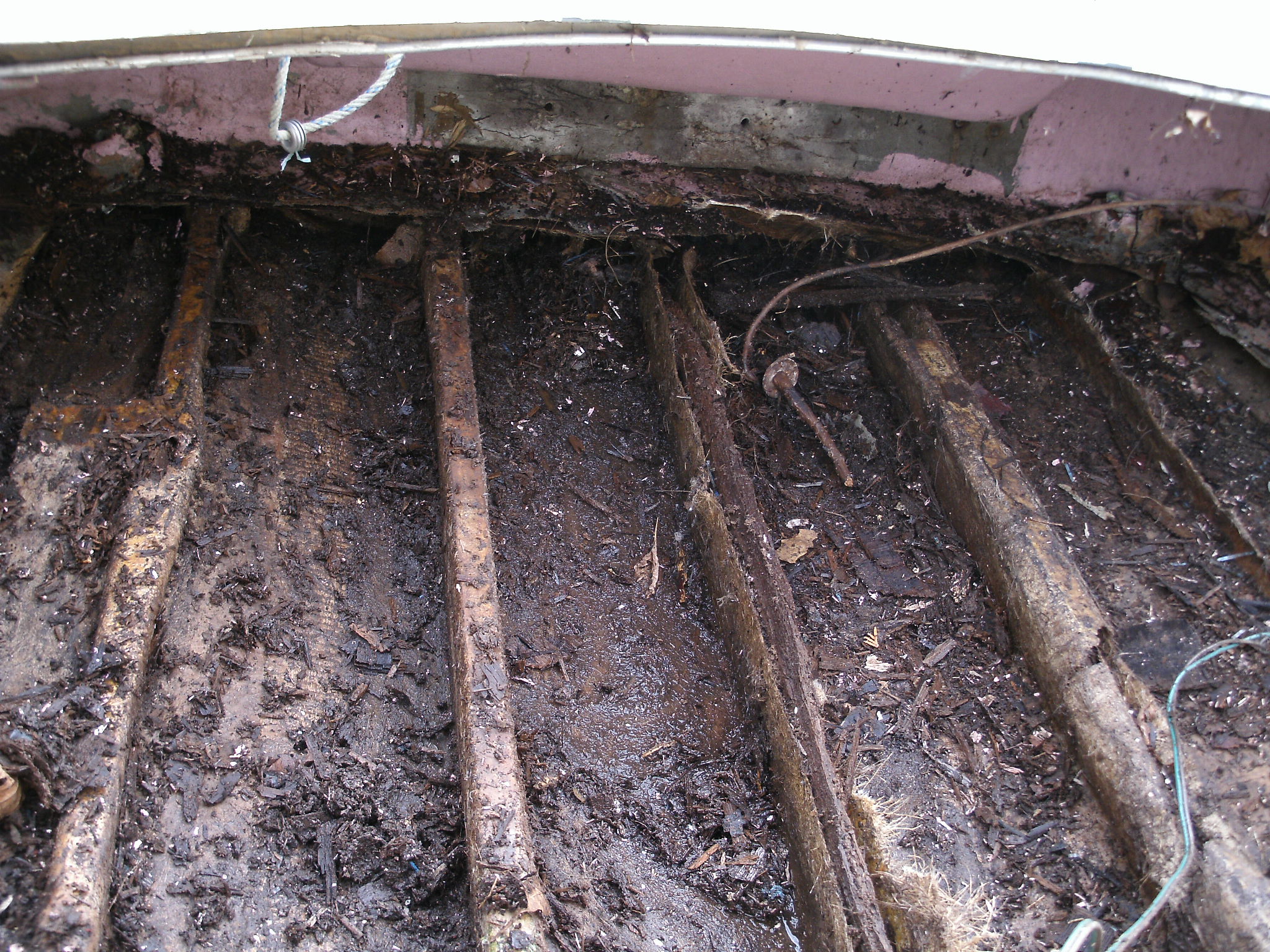

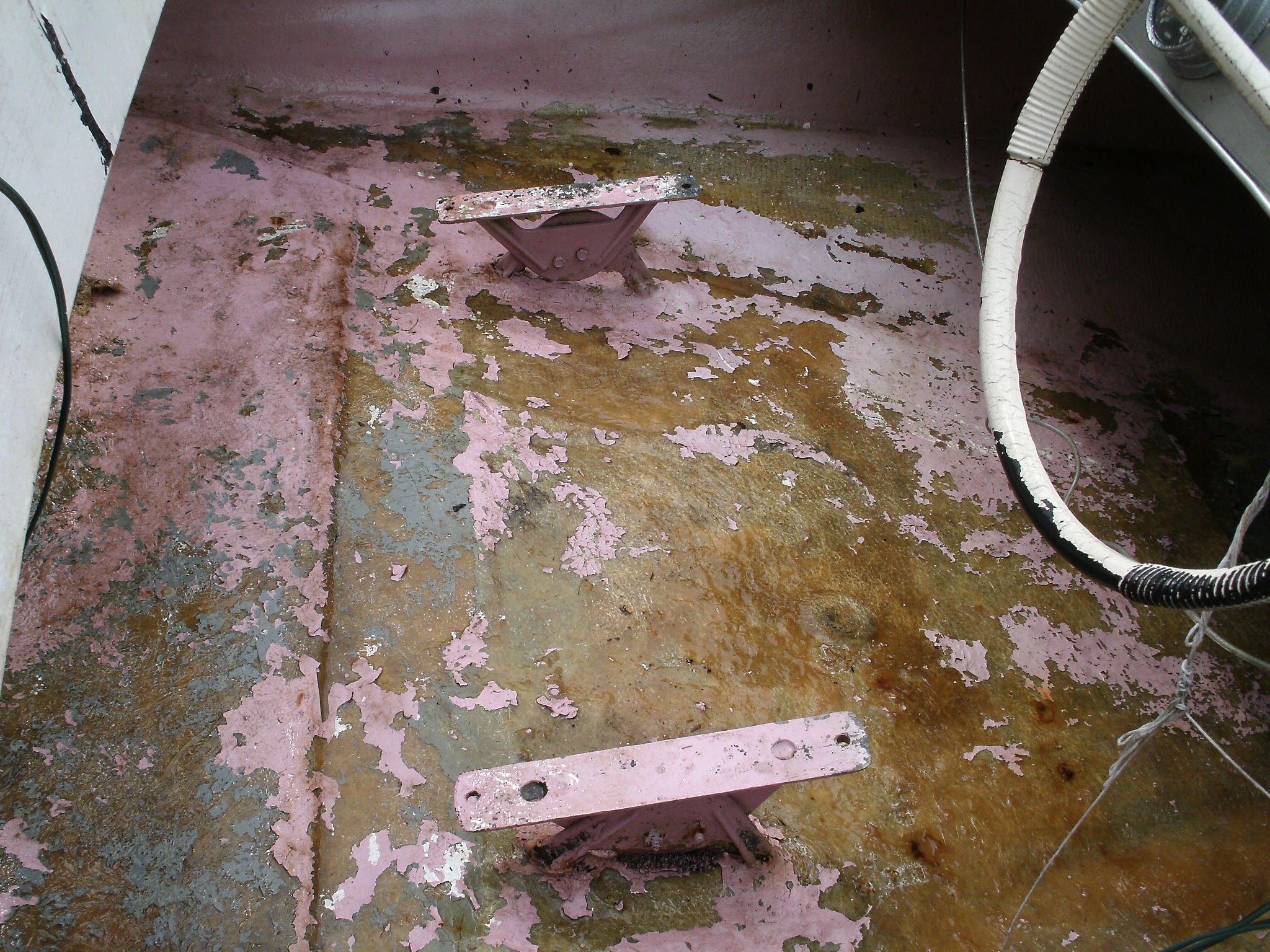

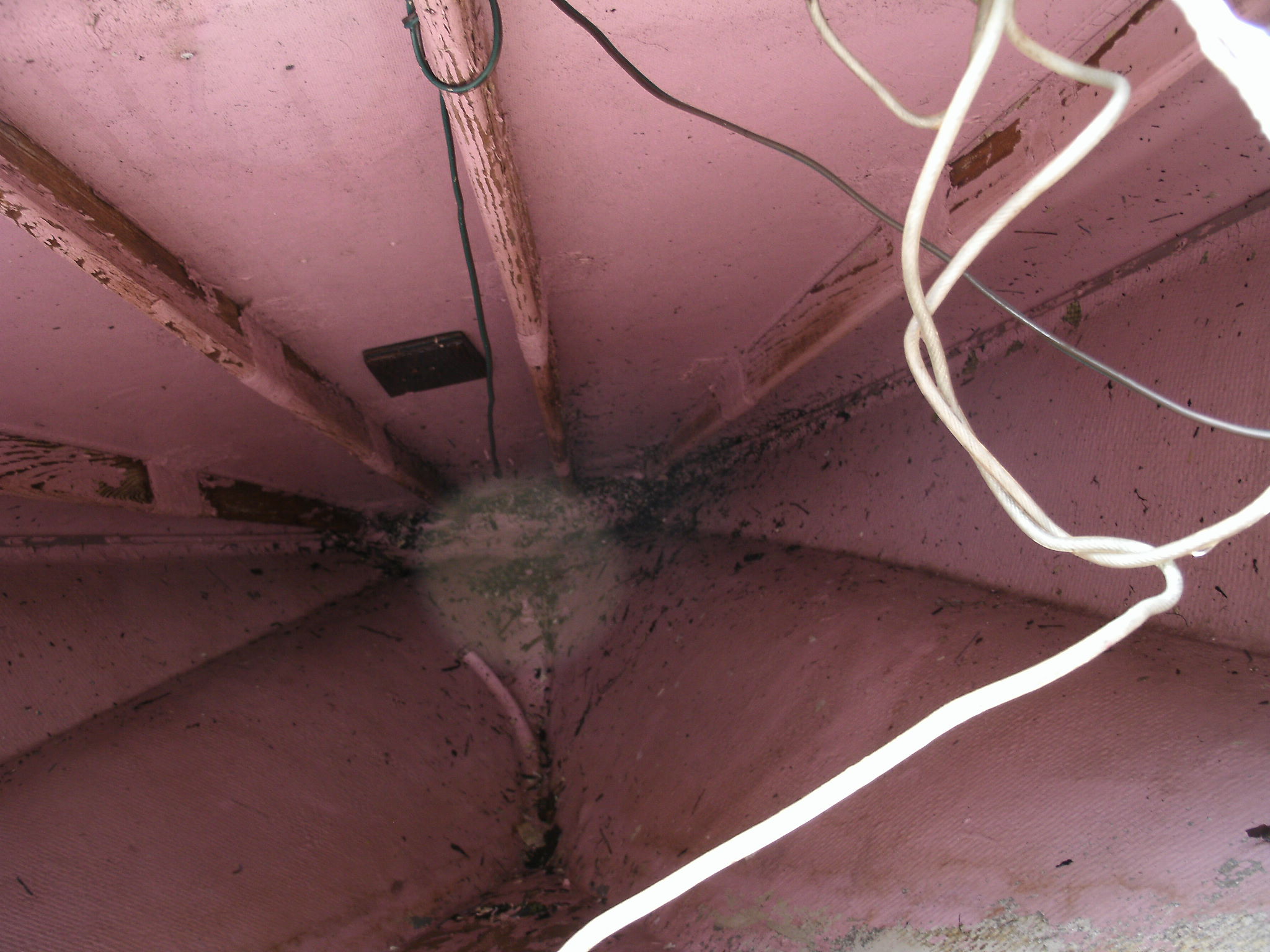

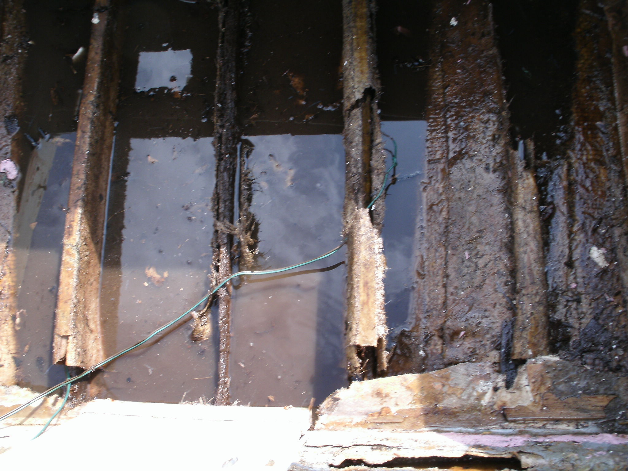

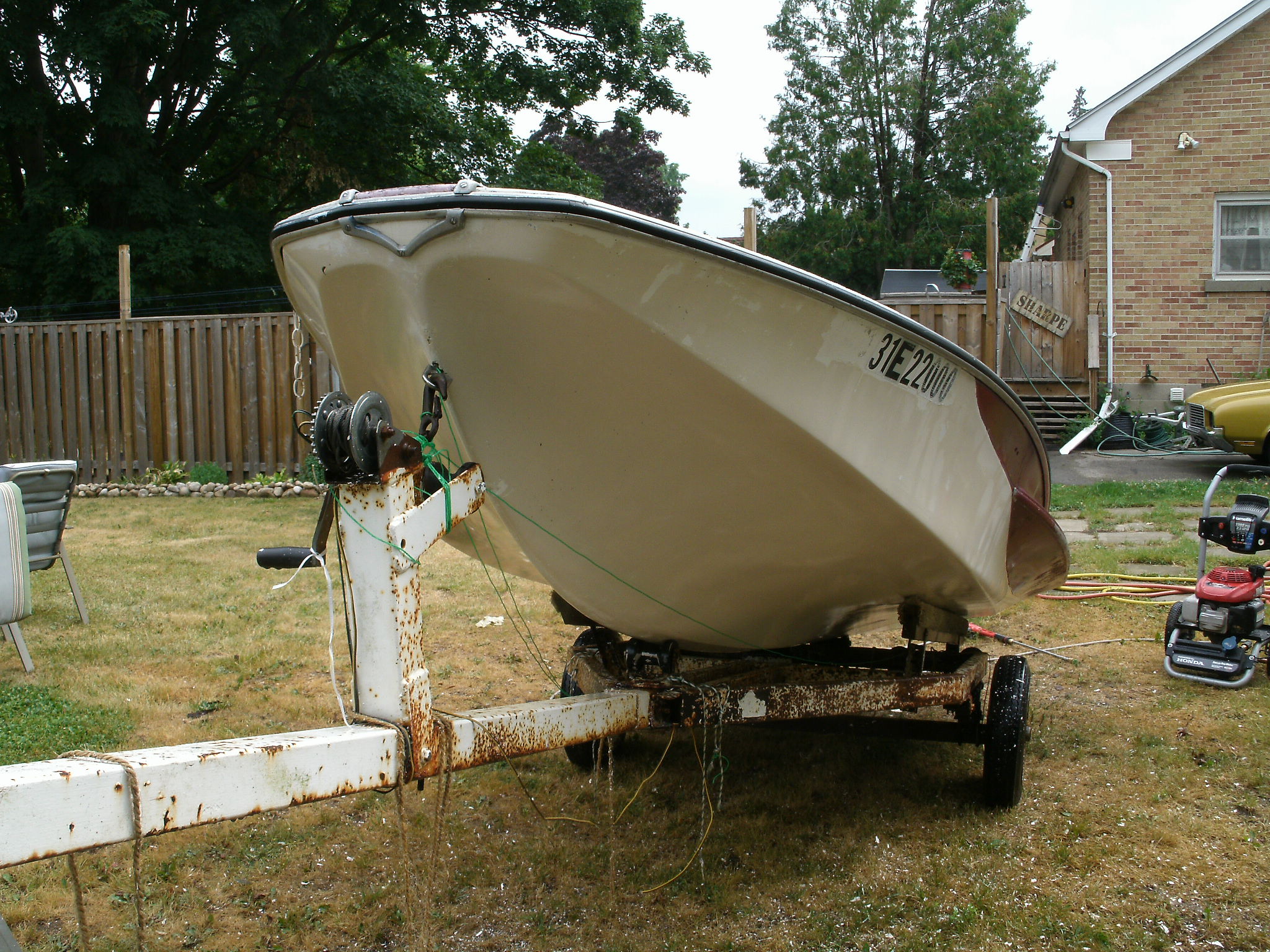

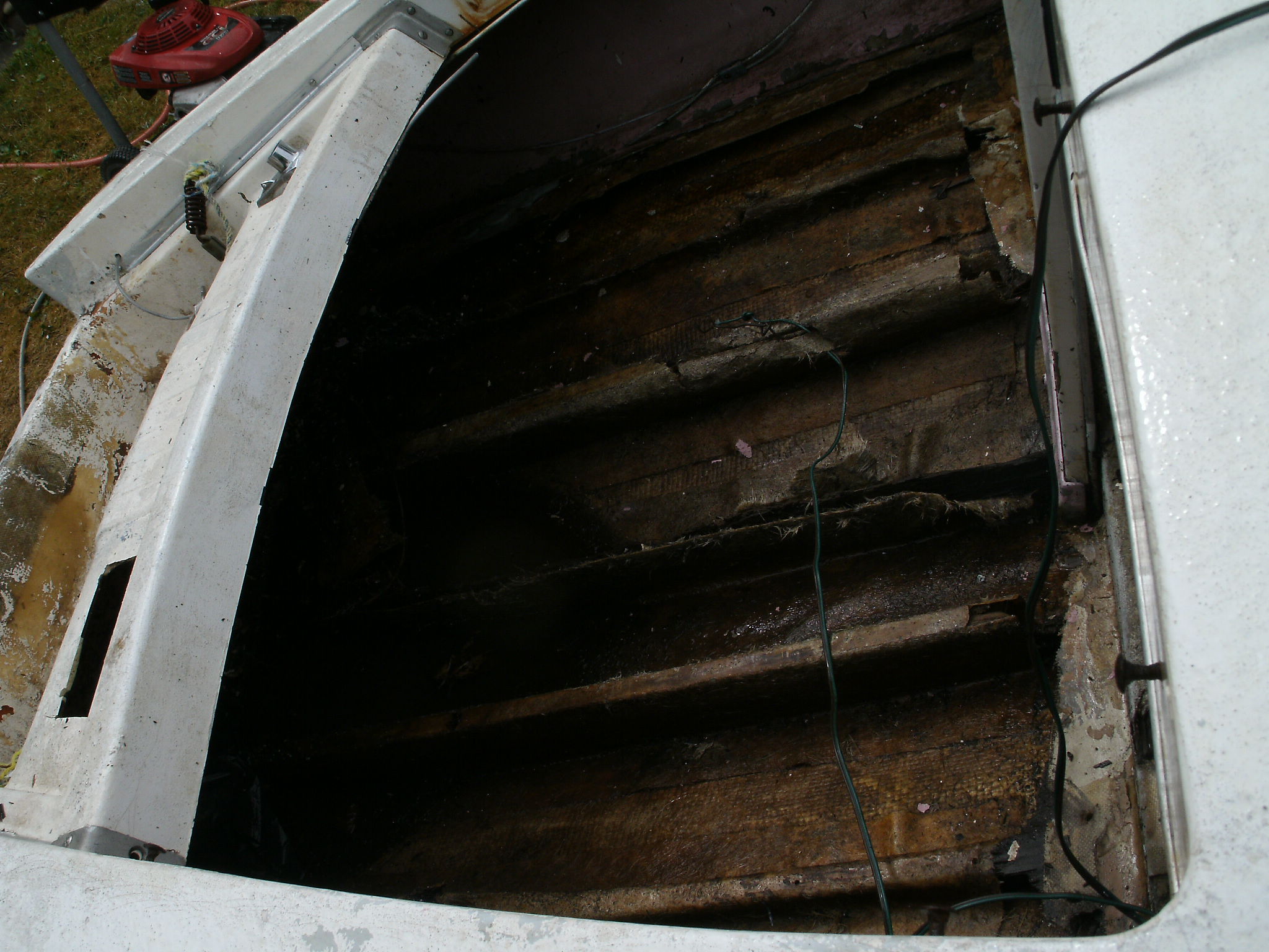

They say a coat of paint hides a multitude of sins but there's no hiding the way this G-3 was rebuilt the last time. The front seat surprisingly is the original frame but it was a write off upholstery wise. When they put in new stringers they didn't glass them in, they just sistered them to the rotten ones (!) and screwed a piece of regular plywood down for the floor. It looks like they took a horizontal slice off the dtern to redo the transom but then they glassed or bondoed over the seam ! This is going to be fun since I have to do the job without splitting the hulls as I have neither resources nor space and tools to do it that way. I'll throw up (no pun intended) some pictures and if you have any ideas I'll really appreciate them. I've got every similar project bookmarked so let the research begin.

But I was sure happy to find this in the bilge.

Here's that seam that makes me think they sliced off the transom. Am I wrong ?

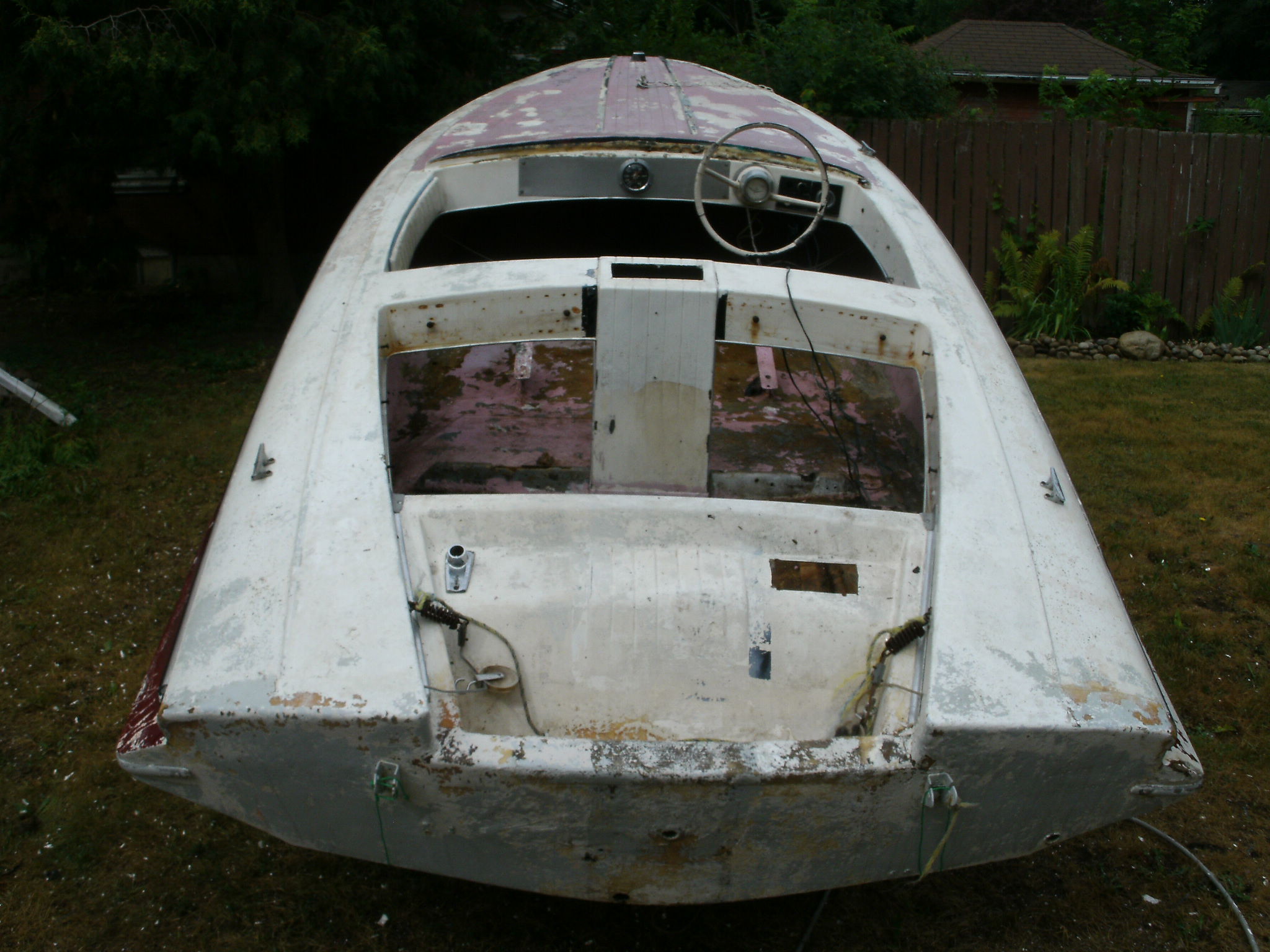

Since it's raining too hard to tear down the old Rude I figured I'd finish the pressure washing since you're gonna get wet anyway. LOL. Here's a few of the cleaned up version.
Damn the torpedoes, full steam ahead !
Re:One sad G3 tore up from the floor up. 10 years 4 months ago #123928
Pretty ugly.
Re:One sad G3 tore up from the floor up. 10 years 4 months ago #123929
But looks good up front.
Re:One sad G3 tore up from the floor up. 10 years 4 months ago #123930
Looks like they rolled on the white paint I've been blowing off right up to where they crawled UNDER the trailer and BRUSHED it. That's gonna require 60 grit. :angry:
Re:One sad G3 tore up from the floor up. 10 years 4 months ago #123931
That's about all I can do this year but I'll feel better about storing her till spring now.

I would add two suggestions. The first is another tool from Harbor Freight, the 4 inch cut off grinder. It costs about $14 plus $5 for the life time warranty which you should buy. I went through three of them and only paid for the first. HF also cells a diamond toothed grinder that is excellent for grinding off old fiberglass, particularly the fillets. The second is to consider removing the deck as it makes everything needed to repair the hull so much easier. It's not hard to remove the rub rail and rejoining the deck to hull isn't difficult if you build some top braces to hold the edges of the hull from spreading while you work on it. You can use long bar clamps but will risk cracking the unreinforced edge. I made very suitable braces from scrap 1/2 inch A-C plywood. Also, don't remove the outer skin of the transom if you can avoid it. If you keep it in place, you can use it to scribe the curves top and bottom to build a bending form to fabricate the new transom. I can provide some pictures if nee to see what I'm talking about.

Sorry I didn't respond sooner guys but it was a tough winter and we are just coming out of hibernation. :) I'm re-reading everything you folks have told me about doing the G-3 and it's going to be put to use as soon as my back yard can support my weight. It's a bloody bog back there right now. The good news is my other project, the 1960 Humber Regal is going to be getting wet as soon as Lake Erie is ice free and they pull the ice boom out of the water at Fort Erie. The outer skin on the transom of the G-3 was done VERY poorly as you can see and if I can't save it with some decent bodywork I won't hesitate to scrap it and start fresh. I have every intention of hanging a 100HP white and chrome Merc on her so it'll need to be solid. I was thinking about having an 1/4 aluminum bracket formed that will cover most of the transom inside and out anyway. If that's a bad idea please let me know. As always this continues to be the best site for old glass and I hope everyone came through the winter without too many scars. Thanks for your help and suggestions. Mark.
