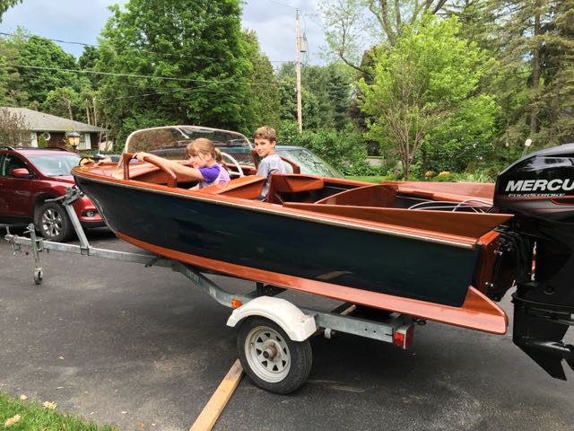

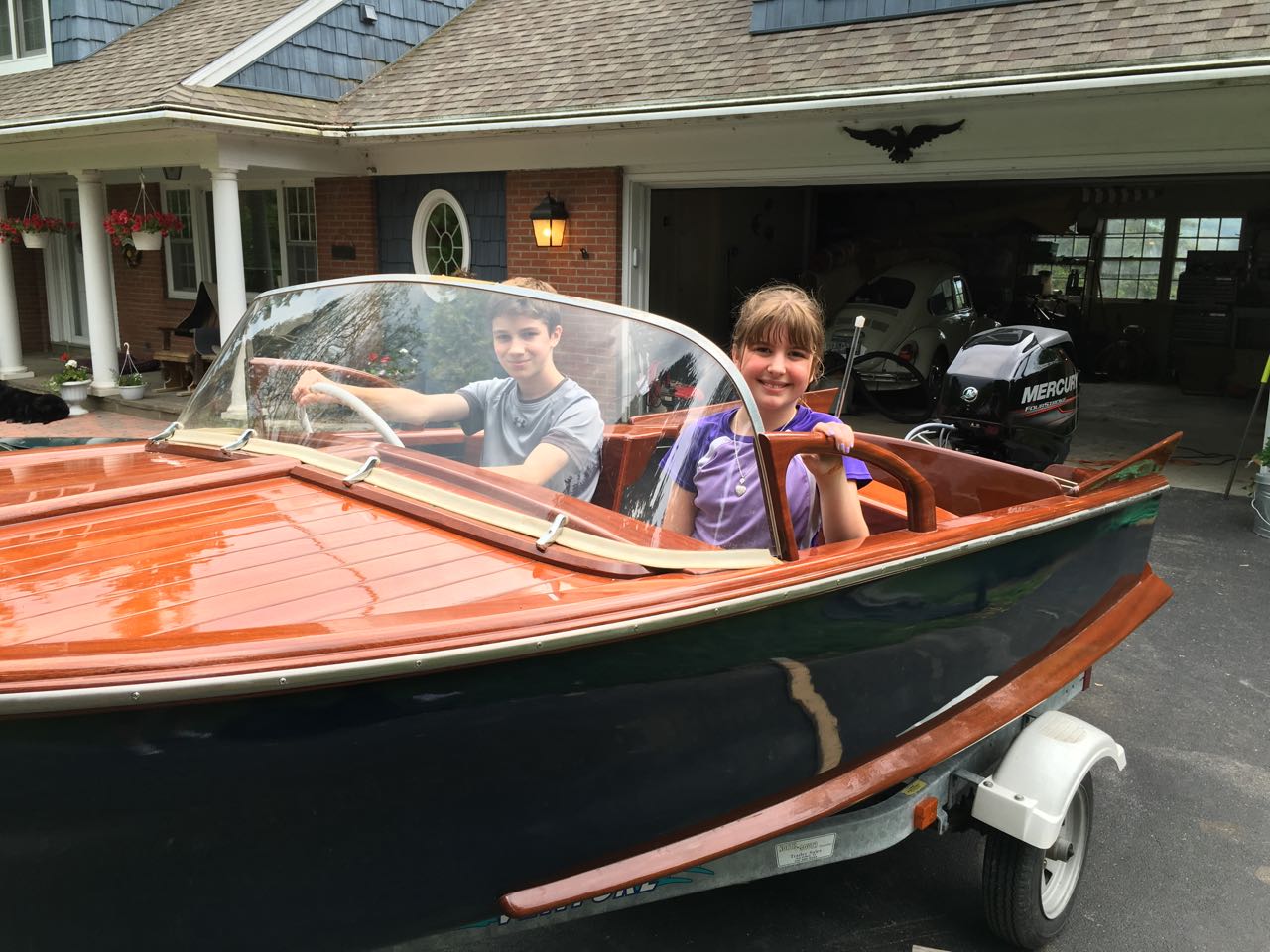

Finally completed the Fleetcraft!!
All wood was replaced except the seats and top deck.
I put a new Merc on the boat as I just mated to be able to start it and drive it... without having to doink around with an old motor.

Outstanding work ! Absolutely beautiful !!!!
I'm sure you will get stopped a lot to talk about it !

Fantastic!!!!!!!!!!!!!!

Fabulous looking boat just in time to enjoy the summer.
Re:My FLeetcraft Finished and launched 10 years 4 months ago #122829
Looks like she and the kids are ready to go!!
Post more pics when you splash her.
Very nice.
