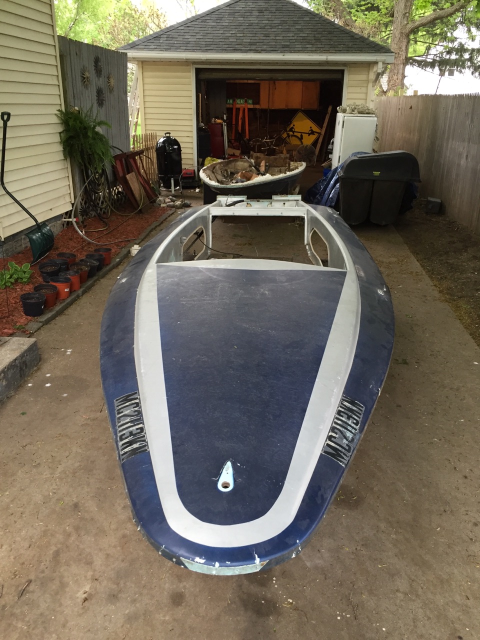

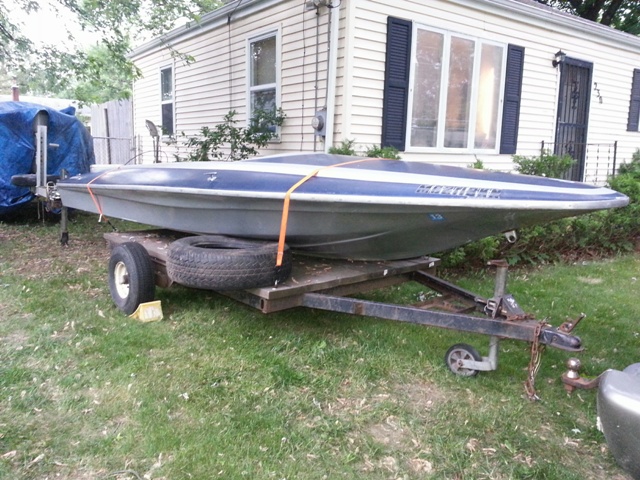

This is the start to my rebuild on the invader.

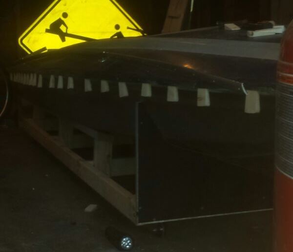

So I weakened the joint. I used wood block wedges

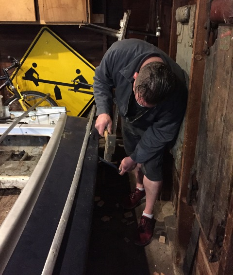

Many, many hours later it popped apart. I used 2 nail pullers to pry at it while the floor jack was inside pushing on the top. I was able to pound a nail puller into the seam and break it. Then I was able to go down the seam pounding the nail puller with a hammer and broke the seam further.

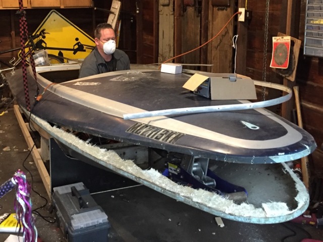

I need to cut through the glass at the transom before the top comes all the way off.

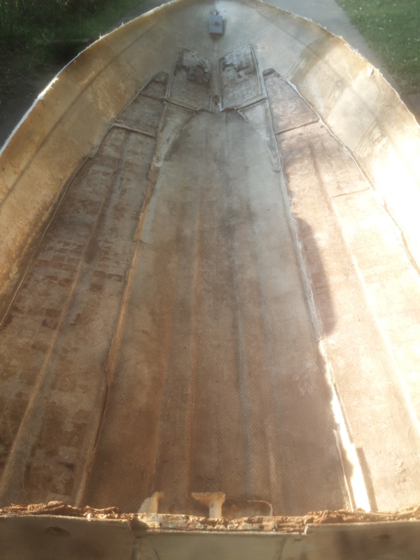

I finally got the top to come all the way apart. Lots and lots of prying and cutting at the inner seam.

Re:1972 g-w invader 14 foot redo 10 years 6 months ago #122054
  • curse
  • curse's Avatar Topic Author
  • Posts: 445
  • Karma: 5
What a mess

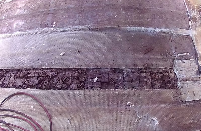

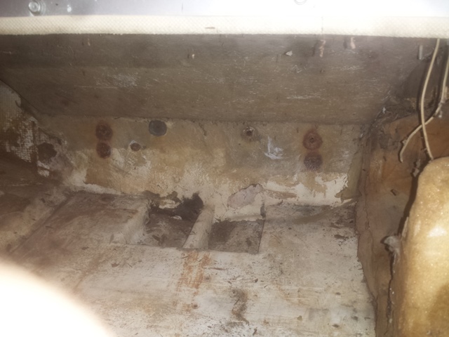

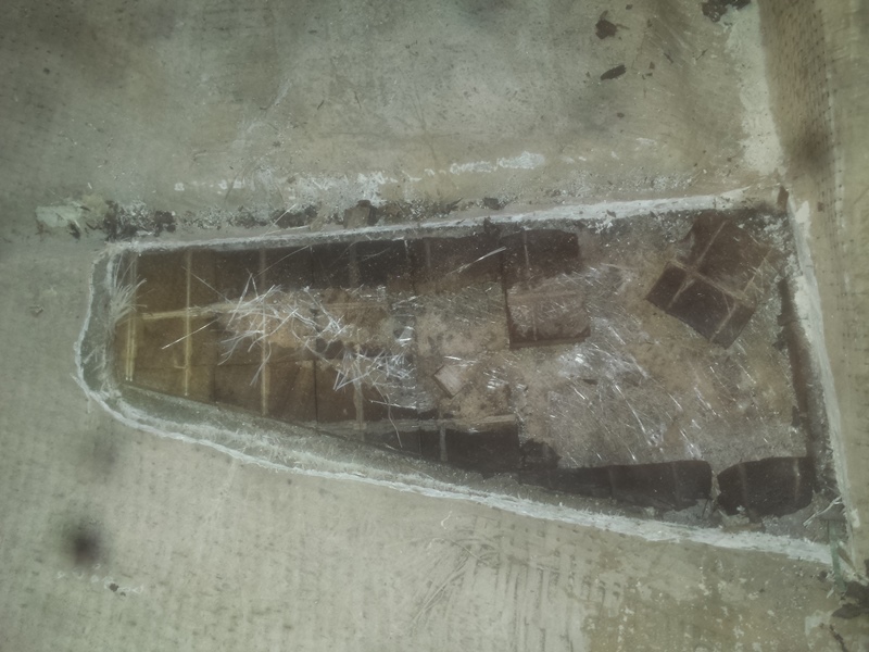

So I haven't had much time but I did cut open a few spots of my floor showing the balsa I need to replace

I'm close to having all the balsa cut out of the floor. Then I can do the grinding. New balsa should be here early next week.
I think I need to take some vacation days to get more done!

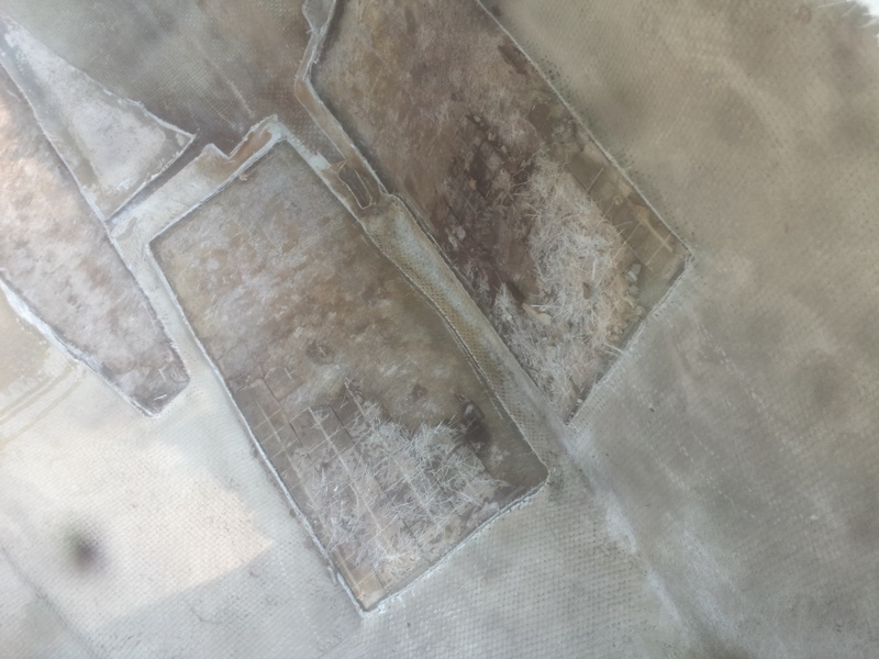

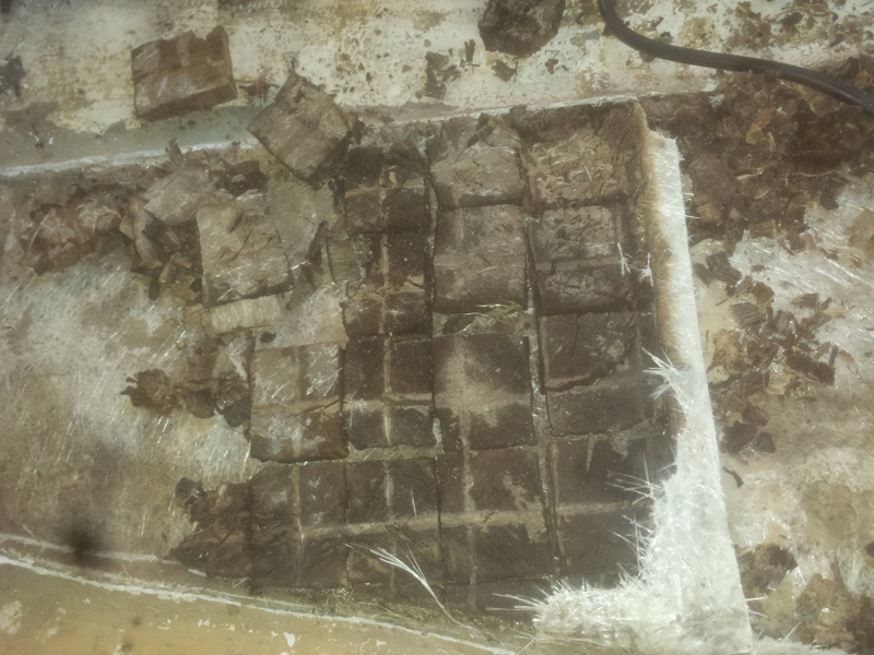

I got some more work done. The balsa is all cut out and hull is ready for grinding but i'm going to wait for a few cooler days.
The balsa will be here tomorrow. I plan on using the current floor as a template for the new balsa.

Oh yeah...I found 2 spots where the balsa was still wet and it's been sitting in the garage for 6 months!

How much balsa is in that boat? I have one to do sometime and it has no floor, stringers, or core.

3 sheets of 1/2" thick balsa. Each sheet is 2' x 4'

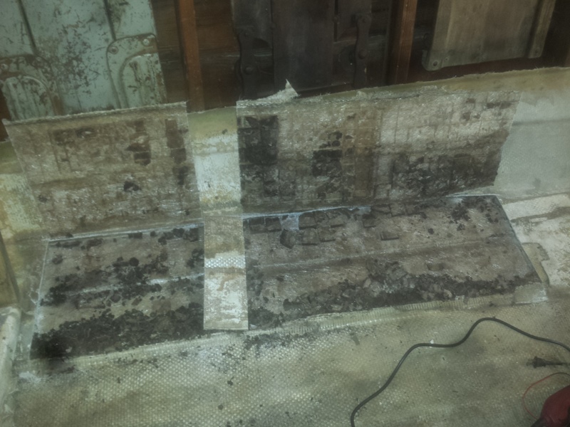

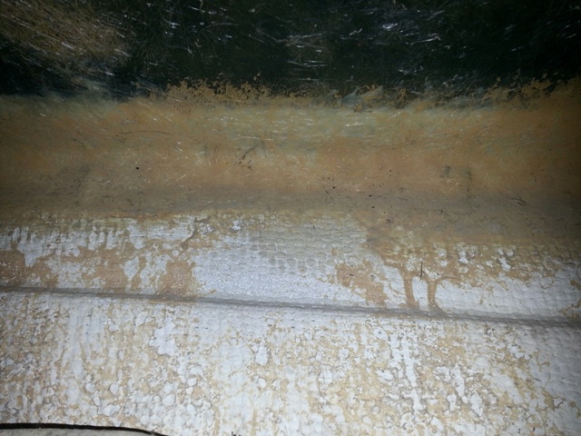

Today I decided to cut out some loose roving and found this.
The center of the boat was filled with balsa too! No wonder it stayed wet in the boat for a long time.
Should I replace the roving that I cut out with more roving or should I be safe using 1708?

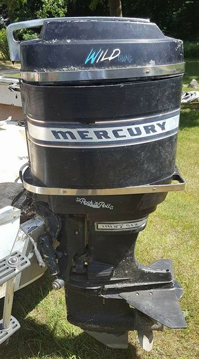

I guess I can revive this thread since I found a few motors.
Hmmmm, 280 pound boat with 110 hp tower of power.
1960 slickcraft catalina
1963 g-w invader ski-bird
Portage Michigan

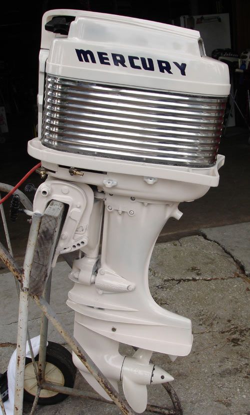

And this one

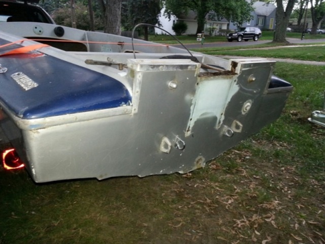

But my transom is 18" and I don't know if I should go long or short shaft. I've seen these 14 foot invaders with 20" and 18" transoms, why would that be? is it because the boat will be riding on the pad when on plane and motor does not need to be in the water as much because of that???

The pad i'm talking about is about 6 to 8 inches wide and the best pic I have of it is this
