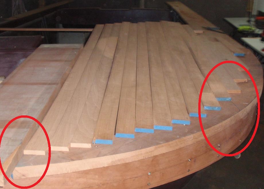

Re:thinking of starting my old project 10 years 8 months ago #120093
Greg, I used solid pieces for the upper edge of the bow area. No bending. Just lined them up where I could get the most board use and cut curves. I did steam the curve on the vertical board. It was an SOB to hold into place.
When I did screw down the deck edge planks I used 5200, screws and where I could reach I through bolted.
All the bling hardware, chocks, cleats etc. are through bolted. Just in case you have to get towed :laugh:
