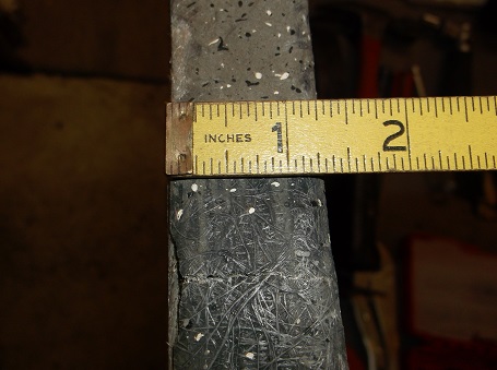

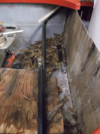

Just a clue the transom might be rotten...steel screws. Transom was only one thickness of 3/4" plywood with a 3/8" added layer for the motor. The previous owner ended up with a tear in the transom glass skin. Fortunate the whole back did not tear off and sink it.
Dr.Go!
Re:1958 Wilson Restoration begins (slowly) 10 years 9 months ago #119330
Dr. Go,
In my experience, about 99% of 50s & early 60s boats need the transom rebuilt, given the primitive plywood of that era.

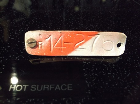

Can anyone help me interpret this Wilson Boat transom tag?
I assume the 14 represents the model is considered a 14 foot (13-6" actual). Does anyone think it is possible the number 275 means this was the 275th boat built in 1958 (or since they started building glass boats?)...I think they made glass boats in 1957, but think all wood boats prior to that. How could there be any way to find out? Maybe I should talk to Gene Gene since he said he has a retired friend who worked at that factory?!

I will say that having this simpler configuration on this older boat (no splash-well and open back) makes less work overall. Good thing because I can't be sure yet how good my results will be until I practice on some new scrap wood. I am glad I am not splitting the hull/deck, nor cutting out a splash-well or cutting out the back-side of the boat... Though I still want to do the best job I can to save this boat because I understand it to be very rare (simple, but rare).
Good new that I just found the bottom wood to be dry where I cut it back slightly to accept a thicker replacement transom (transom wood was wet, but floor was dry and no rotten after 52 years of use and 6 years dry storage). Kudos to the Wilson boat builders!

Re:1958 Wilson Restoration begins (slowly) 10 years 9 months ago #119604
Sorry for the late post.
Looks like a normal Wisconsin transom to me.
When I replaced transoms there is a tendency to over engineer it. Usually go about 1 1/2" by laminating two 3/4" exterior plywood pieces sandwiched with fiberglass mat and then overlaid with glass cloth. That way there is piece of mind knowing that even if you want to hang a larger motor it's not going to rip out. Start by making a cardboard template and get the fit as tight as possible

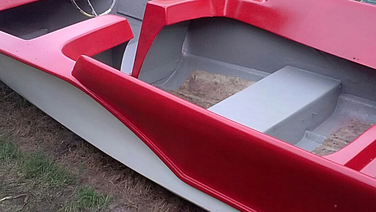

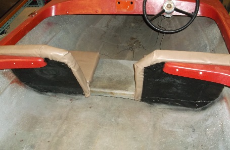

Need more advice:
The original interior hull was finished in Gray with the black and white flecs splattered all over:
1. Do I clean it (interior hull) and try to put a clear epoxy coat over it to preserve the original color? (since it looks like seat areas show fibers from sitting wear)
2. If I clear coat it, how do I remove the red and black paint overspray from the PO rattle cans used on deck and seat backs? ...see picture (note: seats are now removed and will make new removable)
3. Could I just use white top side paint and cover the entire inside hull and make it cleaner looking? (since whole outer boat will be white?...or does this ruin the "original" factor? (note, though my boat is originally red top with white bottom, I believe the Wilson info said a white on white was another factory version)...if it had fins and a good windshield, I would likely keep it red, but it is a simple boat with no fins and I will not have a windshield, so I was thinking simple white on white with white interior to make my first restoration easier...Thoughts please...all comments and ideas welcome.
Thanks Dr.Go!
Dr.Go!
Re:1958 Wilson Restoration begins (slowly) 10 years 8 months ago #119704
We just used grey porch and deck paint on ours. It was economical, looks nice, and will hopefully be durable.

Re:1958 Wilson Restoration begins (slowly) 10 years 8 months ago #119723
We left the bottom unpainted and glued in some outdoor carpeting (also grey). There are a lot of guys on here that can give you better advice than I can. We were working with a tight budget and schedule.

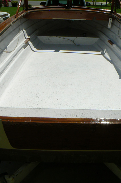

Re:1958 Wilson Restoration begins (slowly) 10 years 8 months ago #119737
I stripped the inside of mine, painted it with Pettit Topside white then used a toothbrush dipped in Black rustoleum and flicked it by pulling back on the bristles with rubber gloves. Came out pretty good I think. Did this 4 years ago and it's still going strong.

Re:1958 Wilson Restoration begins (slowly) 10 years 8 months ago #119761
Oops I lied sorry, I used Interlux Brightsides white and I also mixed in some Interlux Allgrip for the bottom, it's basically a non-skid, works great no slip in bare feet and won't tear up the bottoms of your feet.

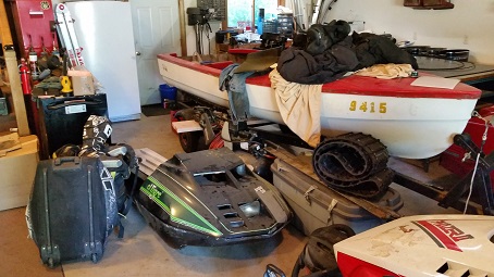

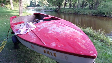

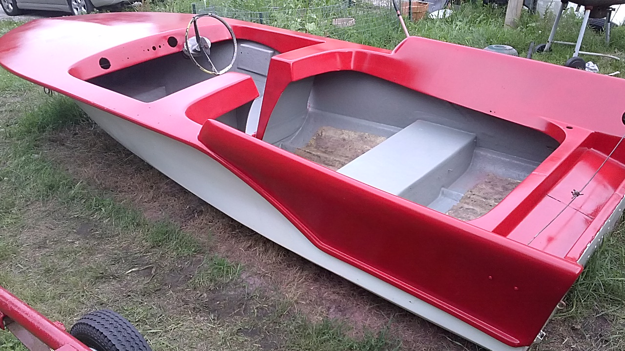

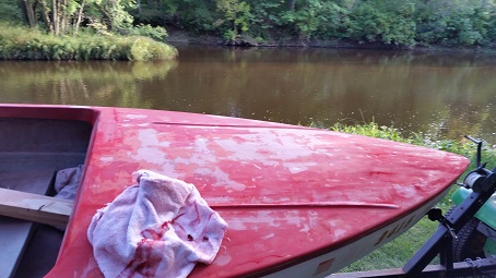

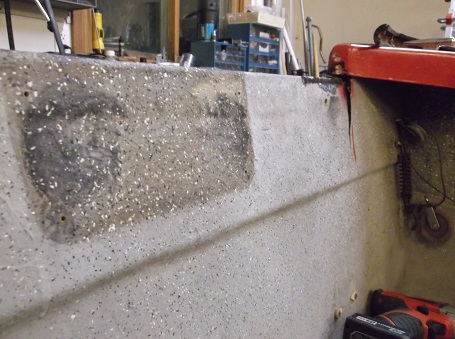

I think I see how easily my distractions lead to NO Progress.
First picture shows how the boat restoration somehow got buried.
Next pictures shows how getting junk put away and bringing a priority back to the top of the "to do" list allows for possible progress.
Last picture shows a small amount of progress. PO painted red over faded lighter original red. Sadly, a rough grinder was used and left gouges I removed. Do I sand until I remove all red original outer coating down to cloth? It can look smooth and good in spots that still have red. Ultimately I will use filler to sand to all flat surfaces, but I just do not want to dig deeper than I need to. I can see where patience is needed during these steps. I still can also use opinions on my previous post...can't believe it took me so long to get back on this!
