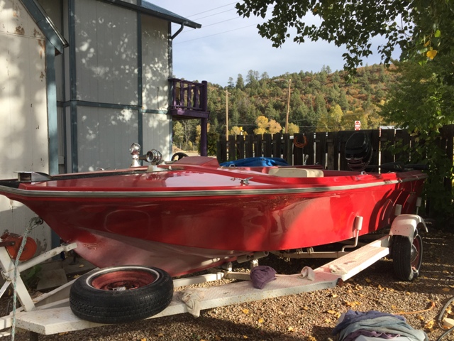

Hi, and thanks for the replies. I was trying from the compound stage without sanding because I thought the article said that the most aggressive steps (i.e. sanding) may not have to be done, and that I should start with the less aggressive steps first. Did I read that right? I can wet sand if need be.
So, here is a picture of the boat as I got it, and one of the beginning of the compounding. It seems to be coming up pretty nicely, but I've just gotten to the place that I mentioned in the original post... where it is coming up somewhat orange in color. I don't have a photo of that yet, I'll work on it some more today and see how it goes.

You read it right, try the least aggressive methods first! I've even done several sessions of rubbing compound with a buffer to avoid the wet-sanding, sometimes it works out. Looks like a nice project, please do keep us posted on your progress.

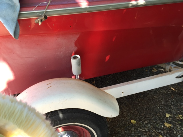

So here is a picture of the 'orange' spot that has come up. Has this boat been patched maybe? I haven't wet sanded yet, I'm going over it all with the compound first to see what I've got. I'm a little afraid of this spot, to be honest. Everything else is coming up nicely (albeit with tiny cracks in some areas, it is only 6 years younger than me...).

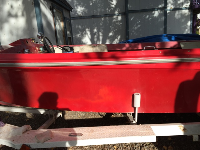

On a happier note, she's looking pretty good. Still a long way to go.

Brenda, sorry late to this one. Welcome aboard and your making great progress. From what I can see it doesn't look like it was patched but hard to tell without being there. Take a good look down the side and see if it bows out any in that spot. If it does it may have been patched because it's almost impossible to make a patch blend in without affecting the shape of the hull in that section. It's like plastering drywall so to speak. You may actually have to break down and wet sand that area. If so, I'd start as with the 1000 like Mark said and go from there.
Re:New to me 1966 Arrow Glass 17' 10 years 10 months ago #115646
Thanks, Bob. I haven't seen any bowing out in that area. I will do the wet sanding... so we will see! I appreciate your input.
